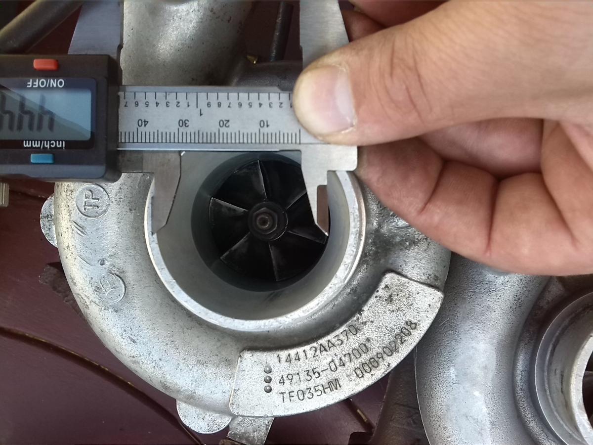

5e colin Posted September 30, 2016 Author Posted September 30, 2016 (edited) happy days my ct turbo arrived she is a good bit bigger then my tfo tfo35hm compressor wheel in/ex 38m / 49.mm ,,, turbine shaft in/ex 42.3 / 36.2 hybrid ct compressor wheel ( CT12B ) in/ex 43mm / 58mm ,,, turbine shaft is ct9B from starlet Edited December 7, 2016 by 5e colin Quote
starletezy Posted September 30, 2016 Posted September 30, 2016 Looks the same size as a td04 that Quote
5e colin Posted September 30, 2016 Author Posted September 30, 2016 looks ya but the verniers tell a different story its bigger on the comp side Quote

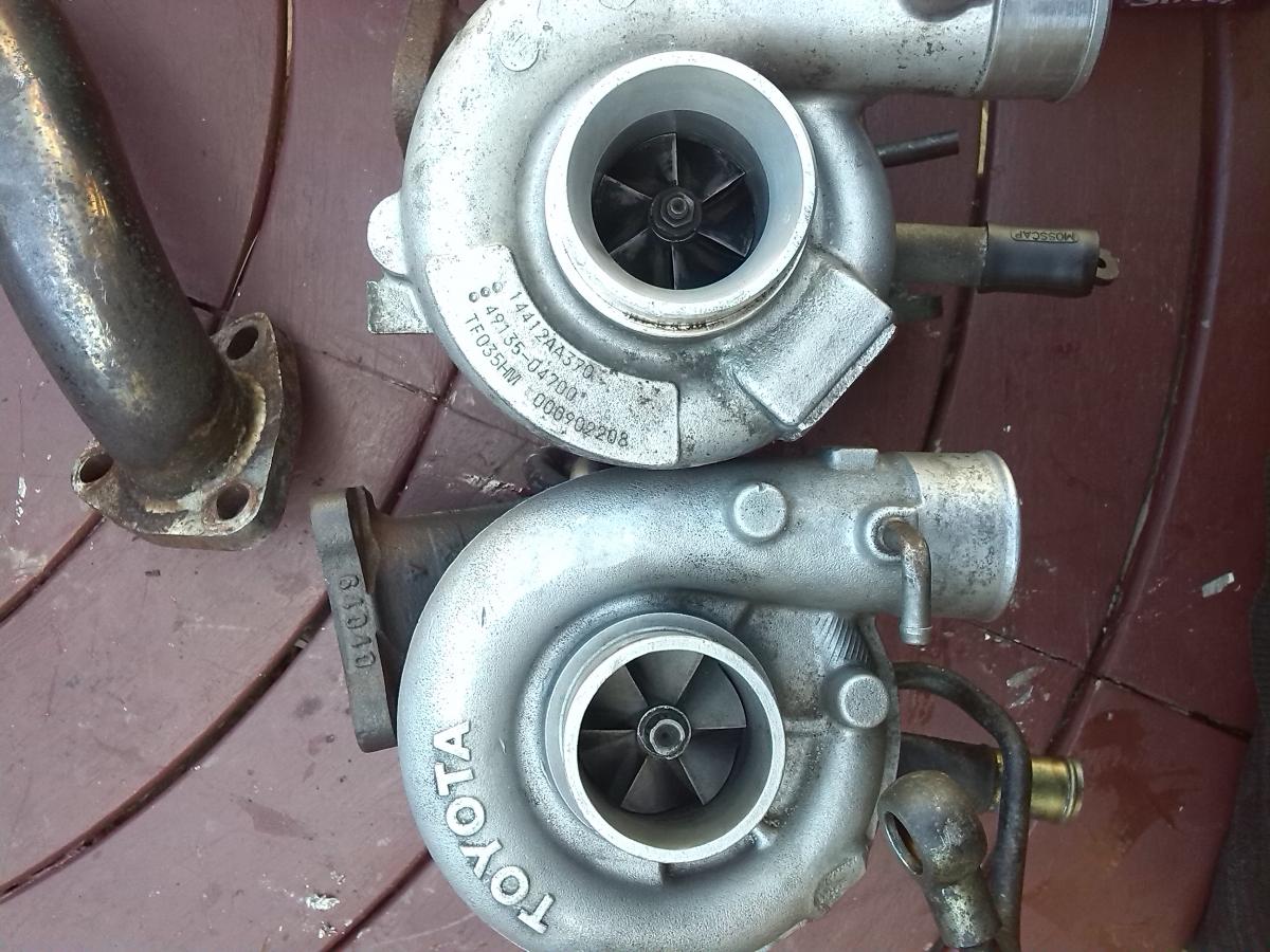

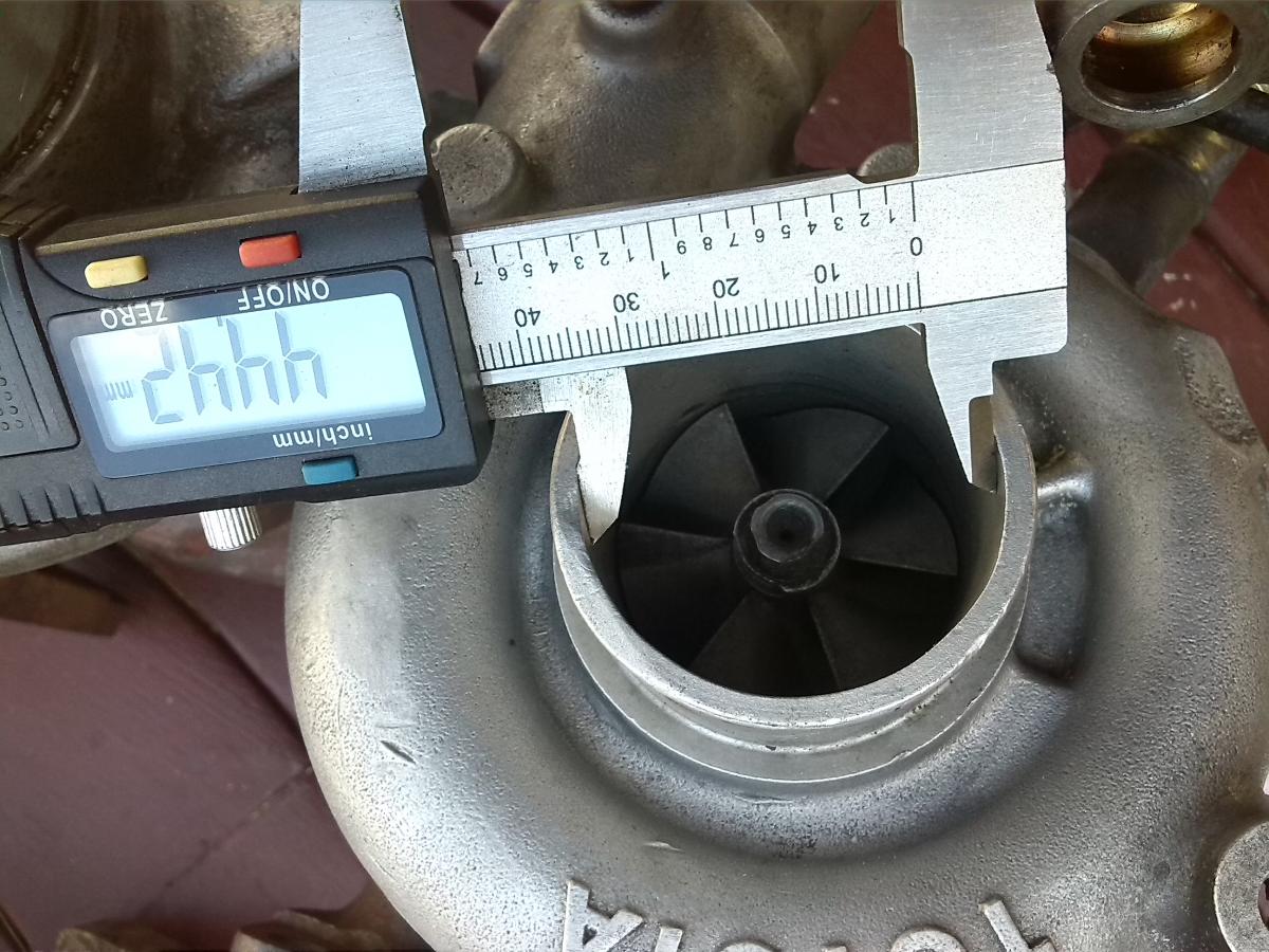

5e colin Posted October 1, 2016 Author Posted October 1, 2016 (edited) going to see how far the mines is going to fuel it gainzy , the mines did the tfo/tdo4 to 1.2bar no problem made some more comparison pictures it compares to tfo35hm compressor side and we al know by now there the same size on the inducer on tdo4l-13t and tfo pics say it all side by side hey gainzy is a k1 bigger then a tdo4 on the comp side ? Edited October 1, 2016 by 5e colin Quote

Gainzy Posted October 15, 2016 Posted October 15, 2016 Wow that little turbo is a litte monster I am at 1.1bar pulls way harder top end then my last tdo4l-13t axis engagement is where it's at / but it's smoking on boost so I must send it off to get her rebuild , doesliam do this turbo lads?The inlet on the k1 is almost the same size a stock slight bigger so the spool is awesome the outlet is ct12 I did measure it if I can find pics al post em for you Quote

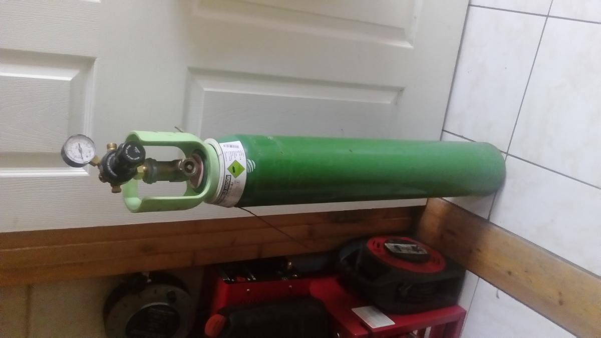

5e colin Posted October 24, 2016 Author Posted October 24, 2016 (edited) if you could get them measurements that would be great amigo gor some gas sick of the smaller bottles wonder how lon g these bottles last Edited October 24, 2016 by 5e colin Quote

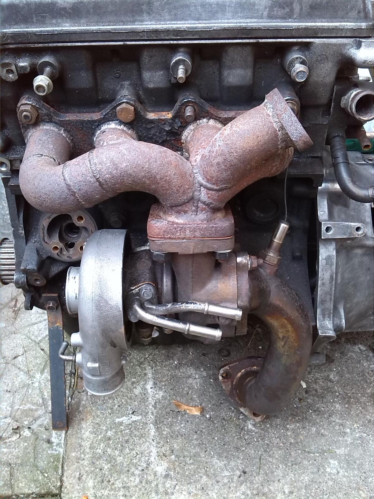

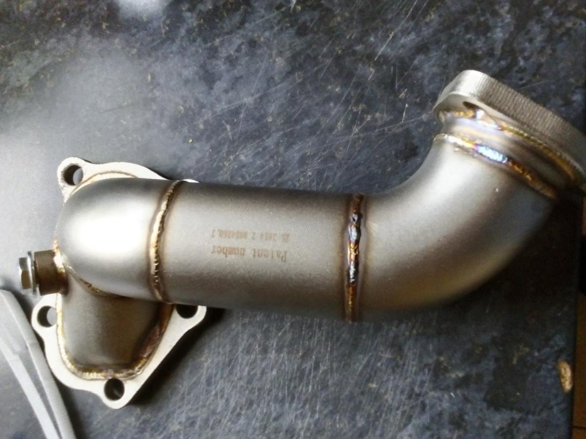

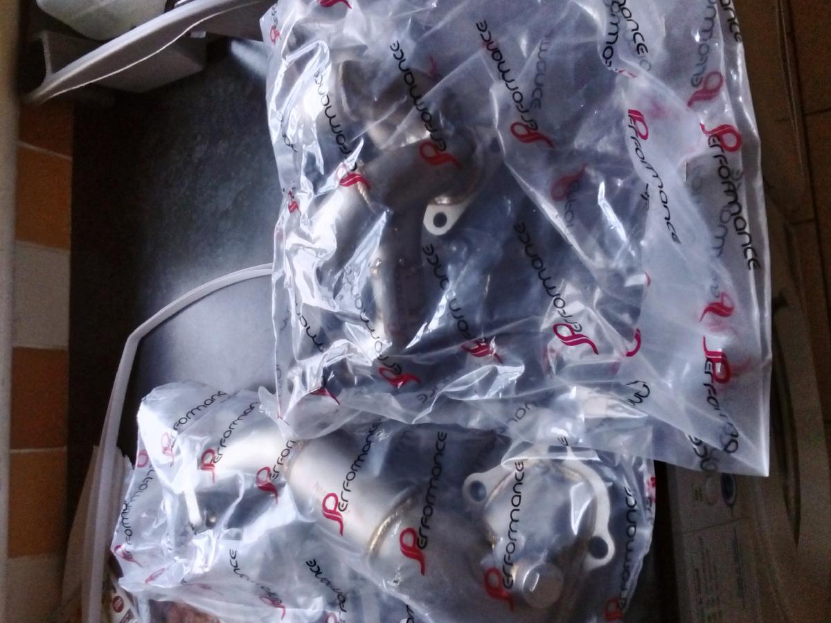

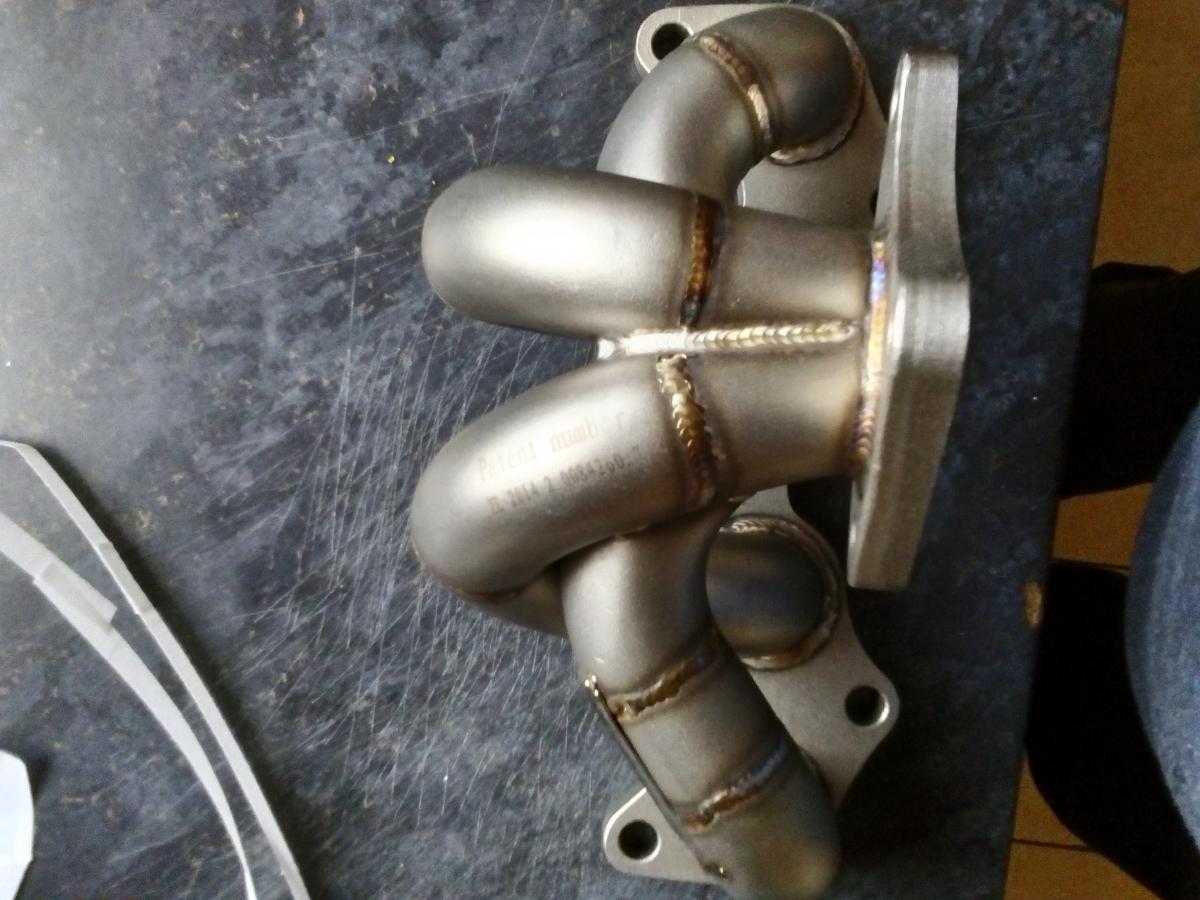

5e colin Posted December 1, 2016 Author Posted December 1, 2016 (edited) happy days selling of the hybrid stuff and going back td got this kit from japanese performance strait away its heavy as kit much better then the old toyosports ss kits also its in diferent location as a toyosports decat will not fit turbo is angled price was a big factor in me purchasing this was a black friday deal ha ha Edited December 1, 2016 by 5e colin Quote
SpikeyJp_68 Posted December 3, 2016 Posted December 3, 2016 Let me know what it's like pal. Just bought the same kit myself Quote
5e colin Posted December 3, 2016 Author Posted December 3, 2016 Will do getting oil line made up on Monday going to run 7 psi tilly standalone arrives I am going to weld some braces to the kit so it will never crack better safe then sorry you better of getting Don to Joe Quote
SpikeyJp_68 Posted December 3, 2016 Posted December 3, 2016 Will do getting oil line made up on Monday going to run 7 psi tilly standalone arrives I am going to weld some braces to the kit so it will never crack better safe then sorry you better of getting Don to JoeI'll wait and see how you do yours and follow that becuase I can see myself making a mess of it Quote

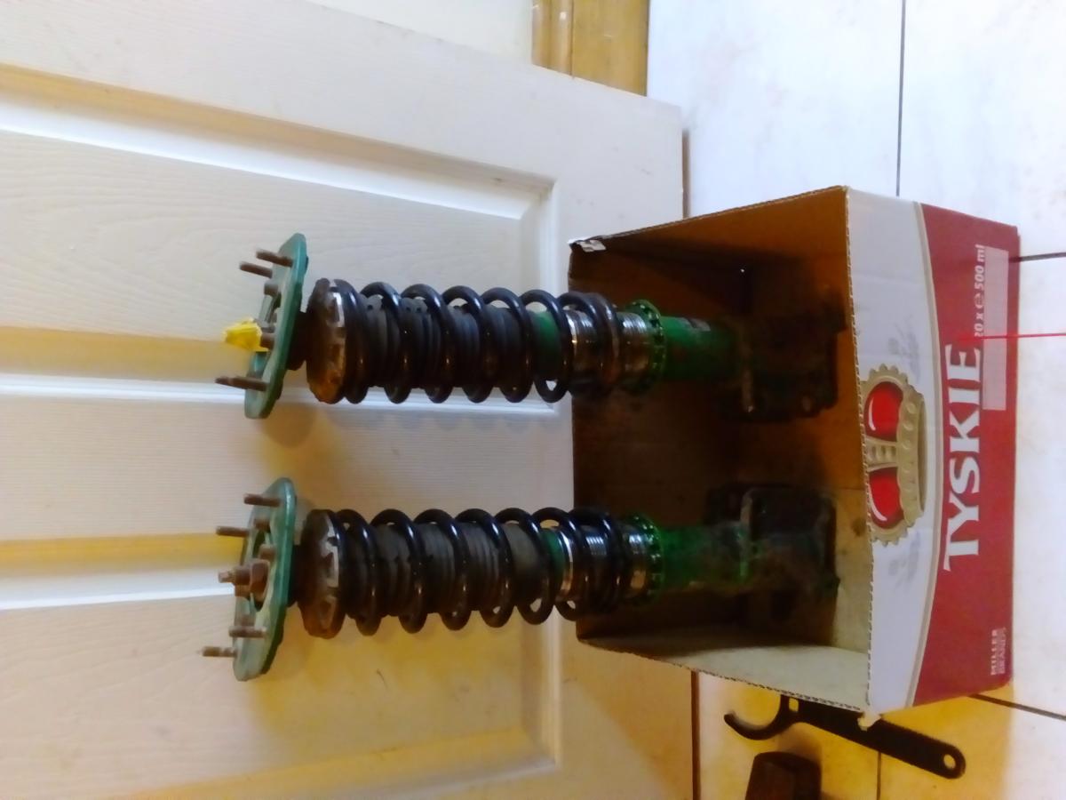

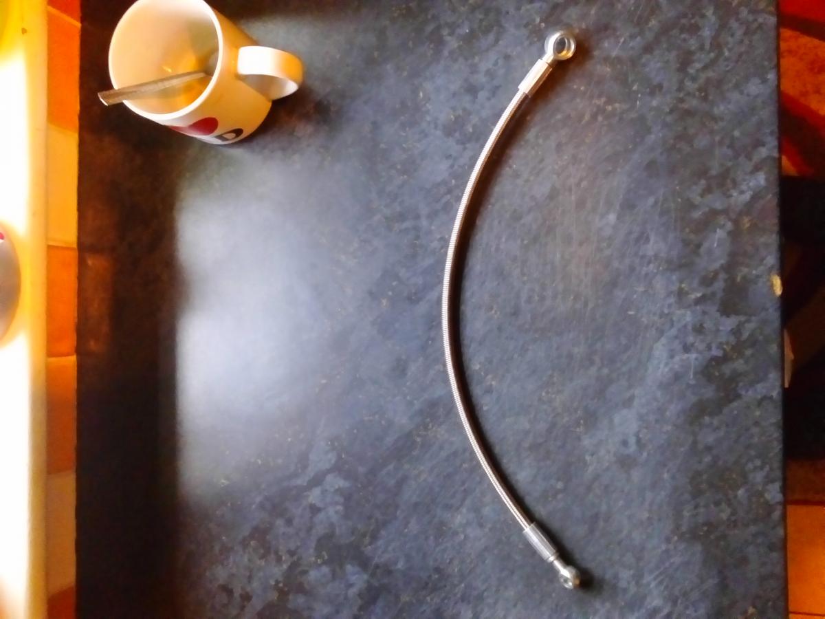

5e colin Posted December 7, 2016 Author Posted December 7, 2016 (edited) tein fronts landed this morning still in good condition so happy days top collors i was able to free up but bottoms would not move so there going to soak for 48hoours in wd40 in the hope they free up also got a new braided oil line made up 33e not bad attal Edited December 7, 2016 by 5e colin Quote
Chops Posted December 7, 2016 Posted December 7, 2016 wd40 is balls at that sort of thing bud i dont know why everyone loves it so much, id grab a proper penetrating oil like rp90 if it doesnt work! Quote
5e colin Posted December 7, 2016 Author Posted December 7, 2016 thanks for the info guys i drenched them in wd40 for 4 hours when i got home after shopping a light tap with blunt chissel and heavy hammer and they came both loose / happy days no i can fit them tomorow if its not raining and adjust ride height to just have to get some for the rear now as my car is a death trap atm Quote
gorganl2000 Posted December 9, 2016 Posted December 9, 2016 (edited) happy days selling of the hybrid stuff and going back td got this kit from japanese performance strait away its heavy as kit much better then the old toyosports ss kits also its in diferent location as a toyosports decat will not fit turbo is angled price was a big factor in me purchasing this was a black friday deal ha ha which kit is this exactly (link)?....is it stock radiator, p/s and a/c friendly? took a quick look at their site but only saw ct9 kits Edited December 9, 2016 by gorganl2000 Quote
5e colin Posted December 9, 2016 Author Posted December 9, 2016 (edited) i bought the last kit affaik there is no stock anymore of the tdo4 kits gorganl2000 stock rad freindl;y there big heavy ass SS 304 kits well worth the money but still no support brackets welded on them they still havent learned that way im waiting on 304 flatbar and round bar so i can weld some in Edited December 9, 2016 by 5e colin Quote
gorganl2000 Posted December 9, 2016 Posted December 9, 2016 solid kits are always better for reliability plus the extra support brackets you will add....should last a long time thanks colin Quote
