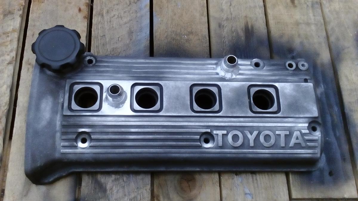

lukEp Posted April 5, 2017 Posted April 5, 2017 Spray oven cleaner. Spray, soak for 25mins (keep topping up), rinse.Get the stuff from pound shop it's awesome. Quote
Chops Posted April 5, 2017 Posted April 5, 2017 Just soak it to death in some degreaser and pressure wash Quote

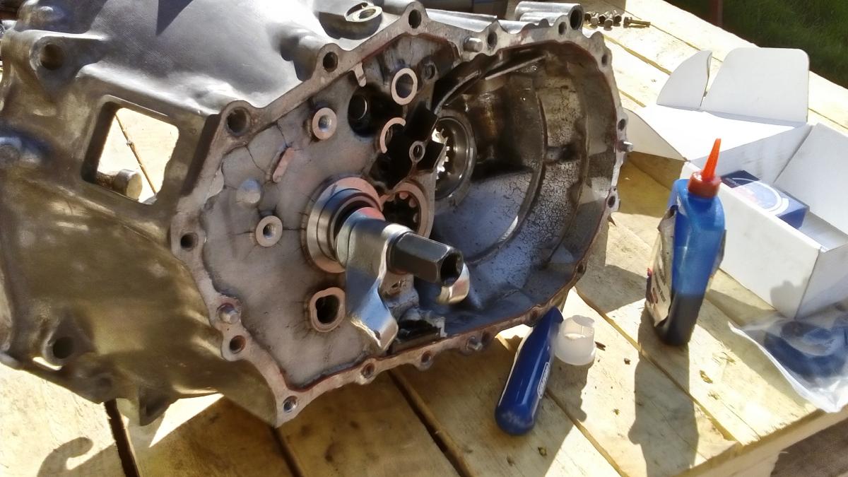

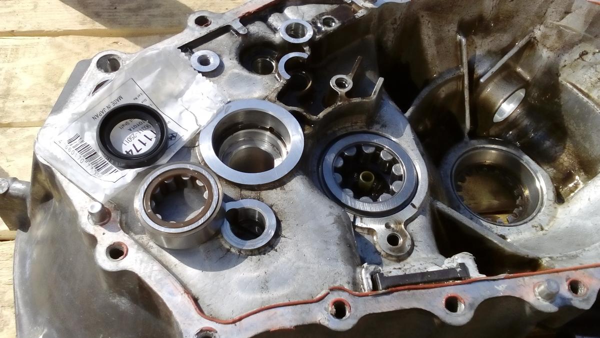

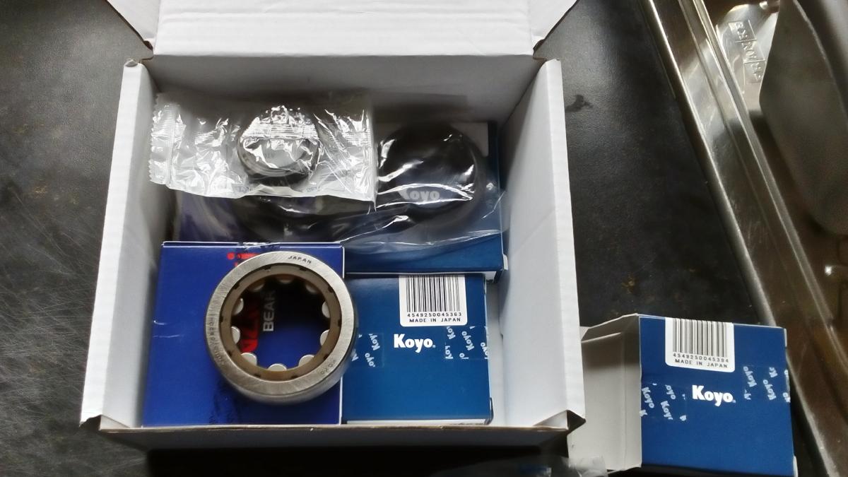

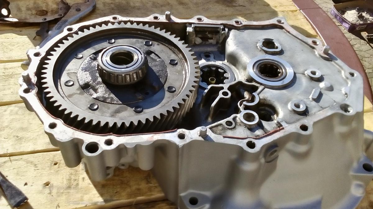

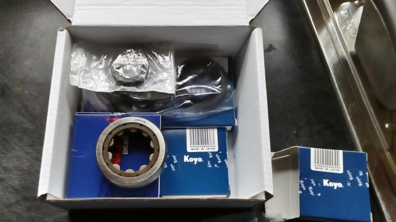

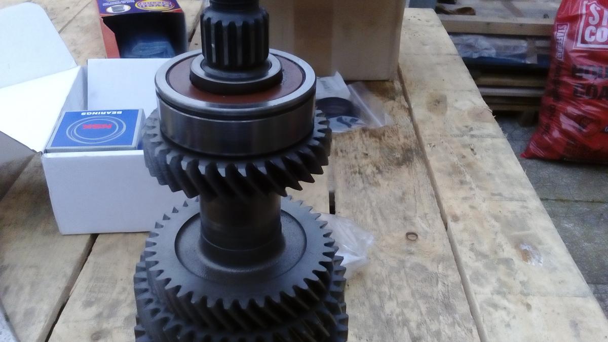

5e colin Posted April 6, 2017 Author Posted April 6, 2017 (edited) cheers guys going to get some of that oven stuff to try my japserviceparts bearing kit from ebay just arived and the quality is very good al jap made oe quality wel worth the money TBC Edited April 6, 2017 by 5e colin Quote

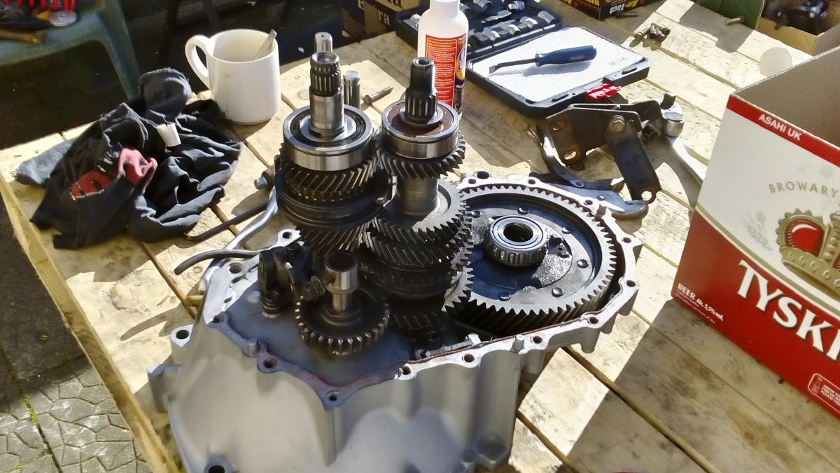

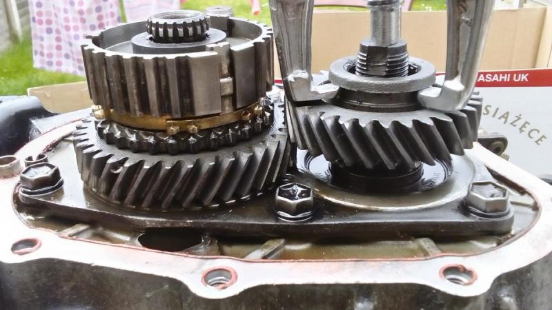

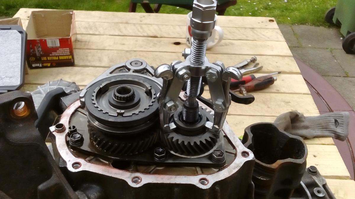

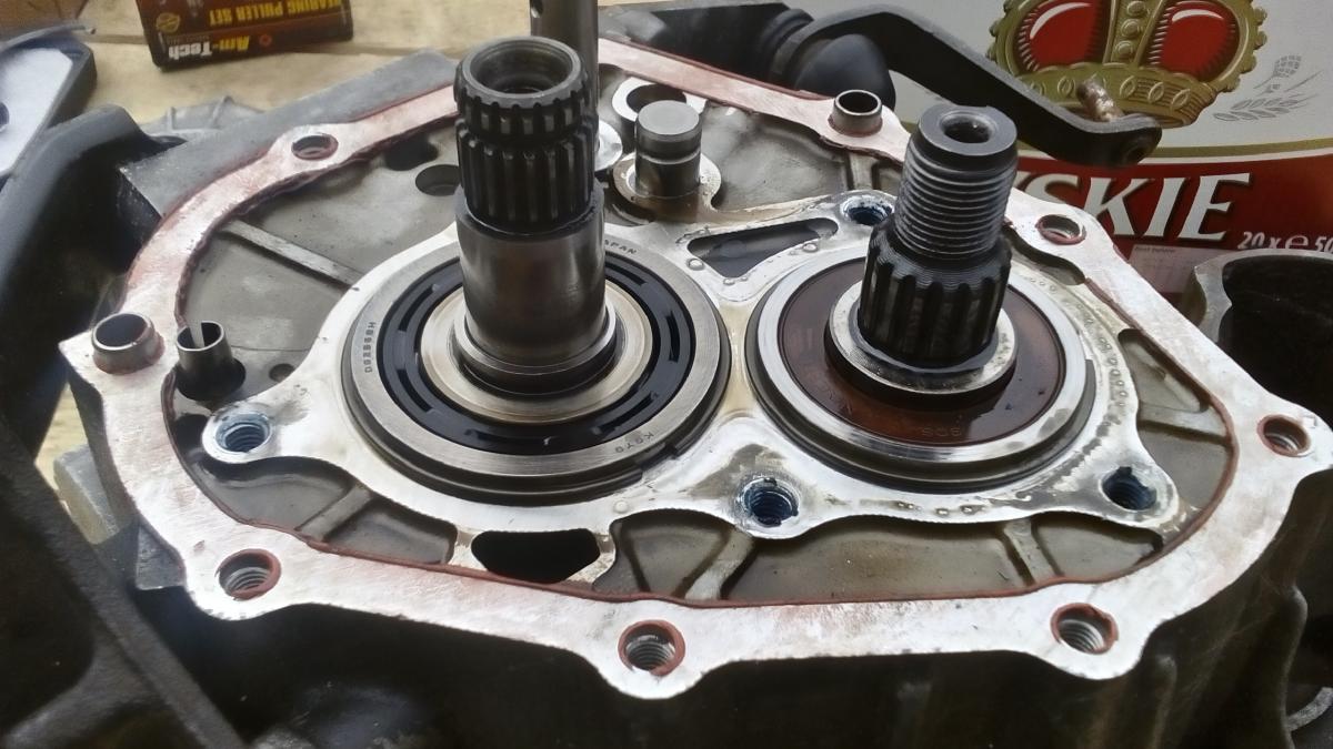

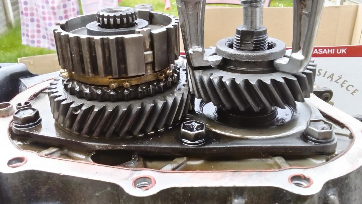

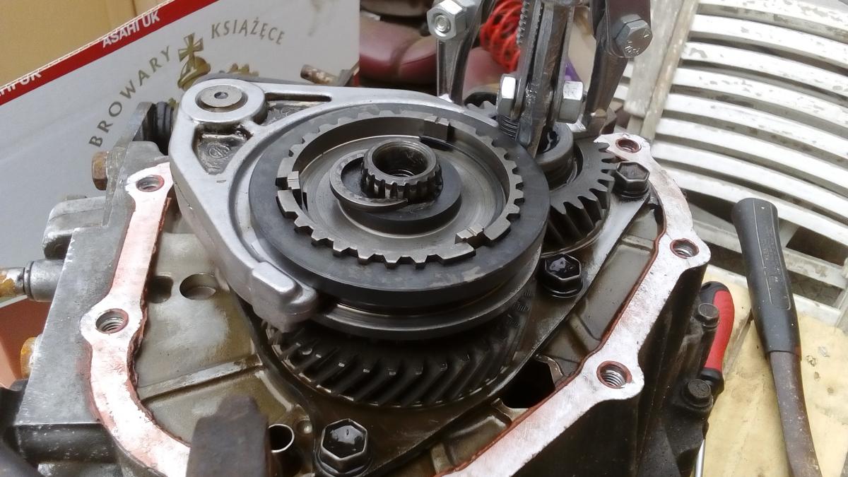

5e colin Posted April 6, 2017 Author Posted April 6, 2017 (edited) http://www.ebay.co.uk/itm/301907061127?_trksid=p2057872.m2749.l2649&ssPageName=STRK%3AMEBIDX%3AIT there you go got the 5th gears off had to grind down the 3 legs on the universal pullers to get them of that went wel but fucked now on getting the bearings of the input/output shafts as there special design pullers so rebuild on hold till i come up with something Edited April 6, 2017 by 5e colin Quote

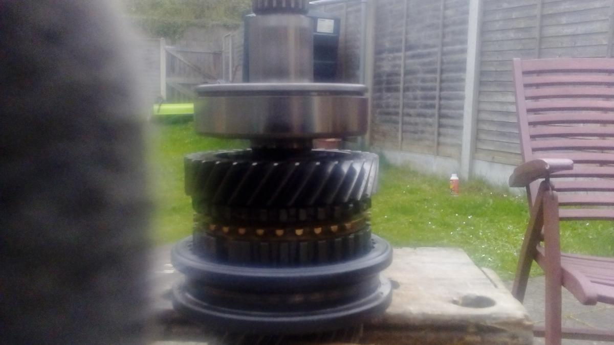

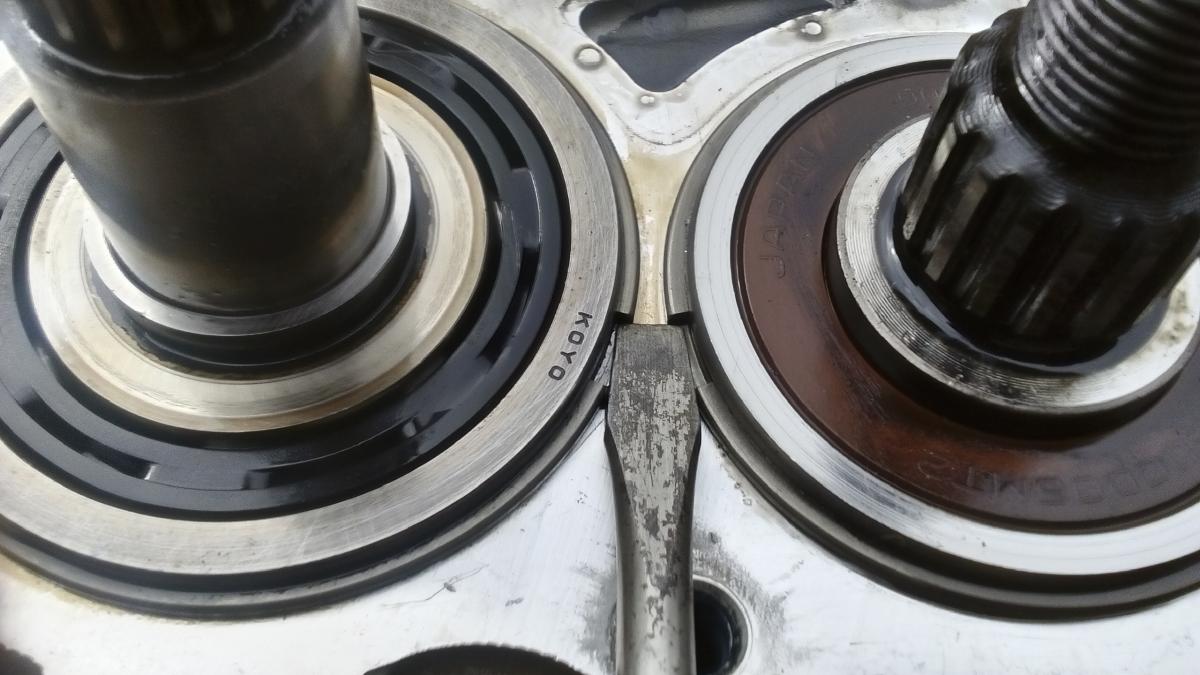

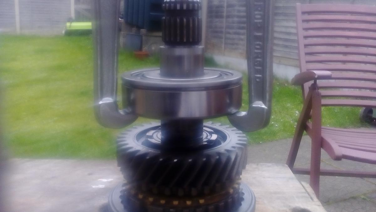

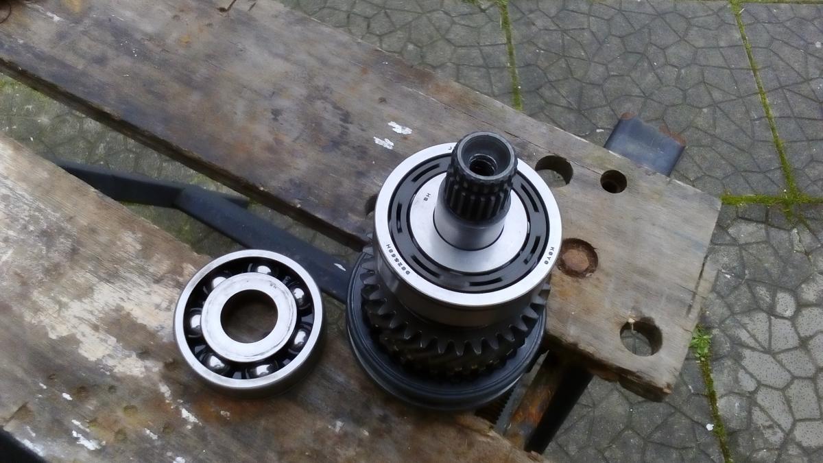

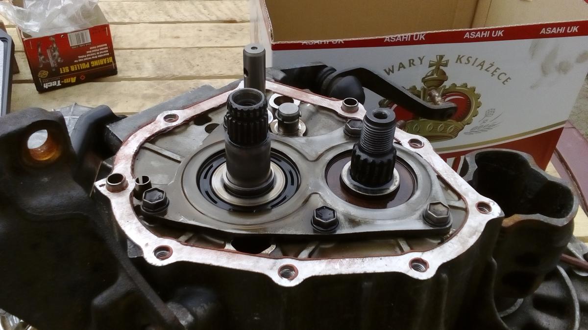

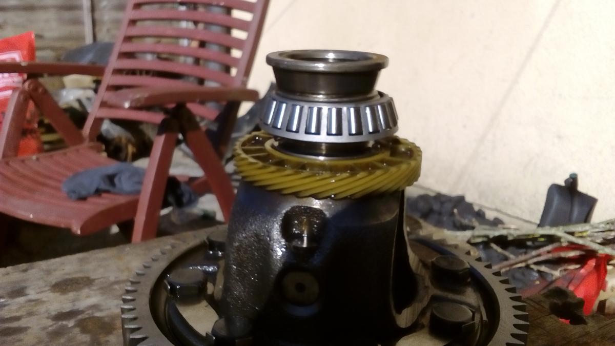

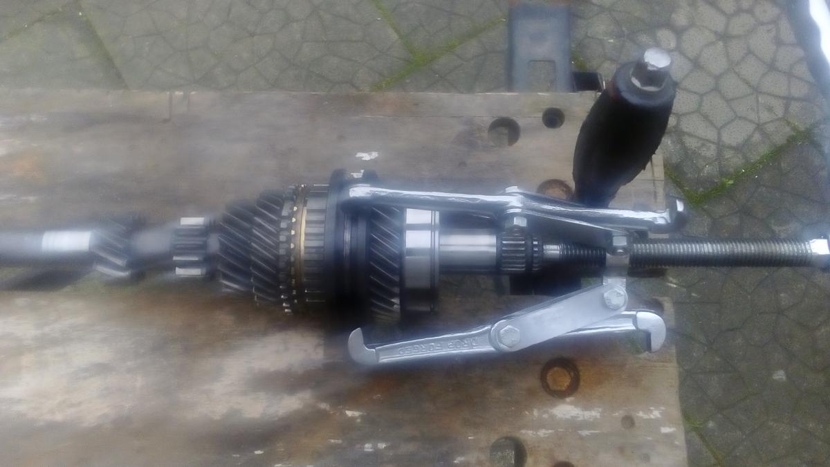

5e colin Posted April 6, 2017 Author Posted April 6, 2017 (edited) wel got the input shaft bearing rear done used the tripot on the 3rd gear hub it worked happy days but fuck it no joy on the output shaft i clamp on the gear under the bearing to help push it of but it wint budge think i need a much heavier puller !!!! and bar or get specialist puller for the groove on the bearing bottom pic is of the fucker that wont come off Edited April 6, 2017 by 5e colin Quote

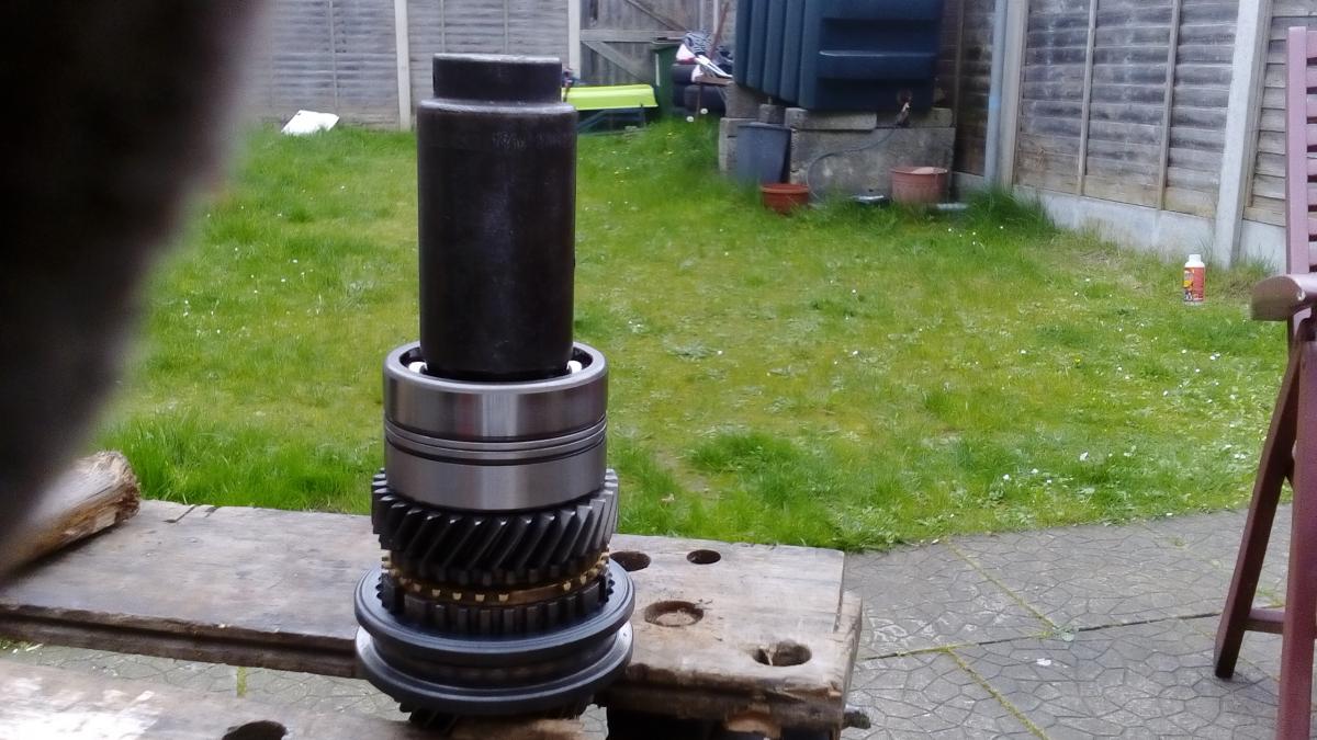

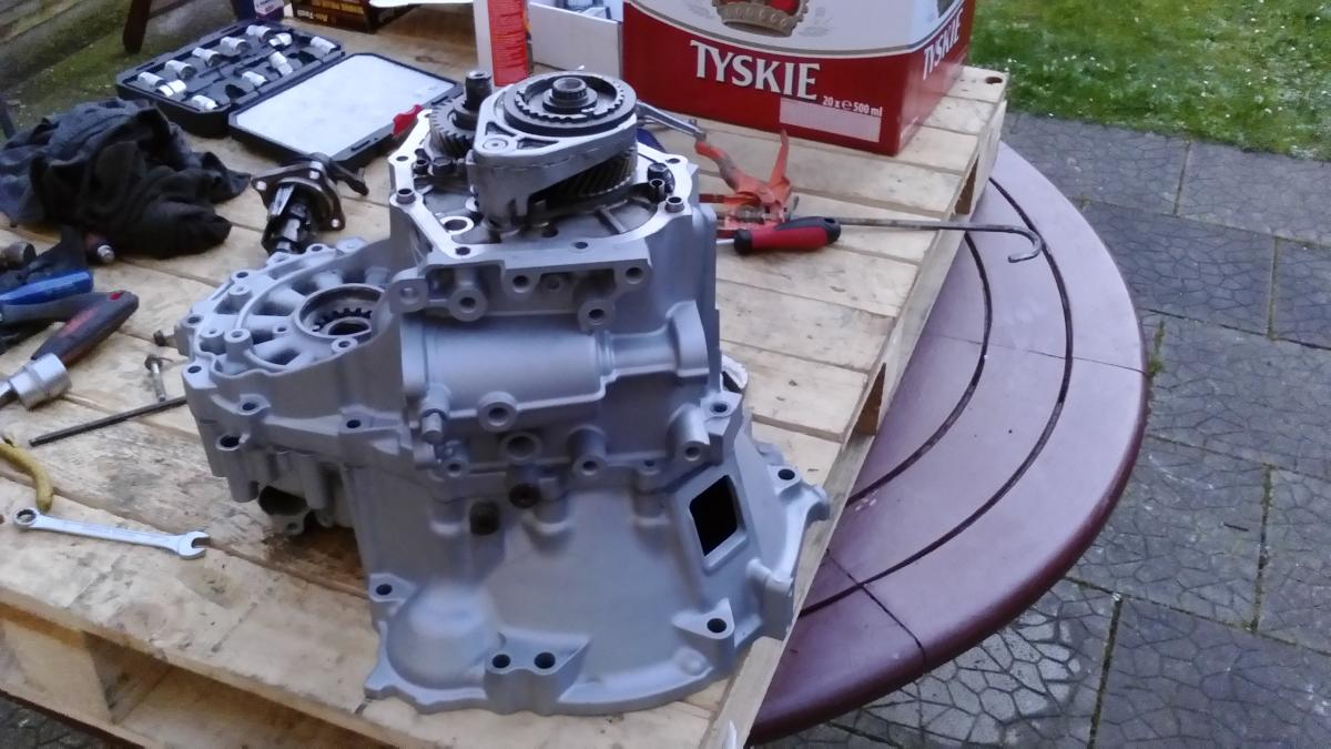

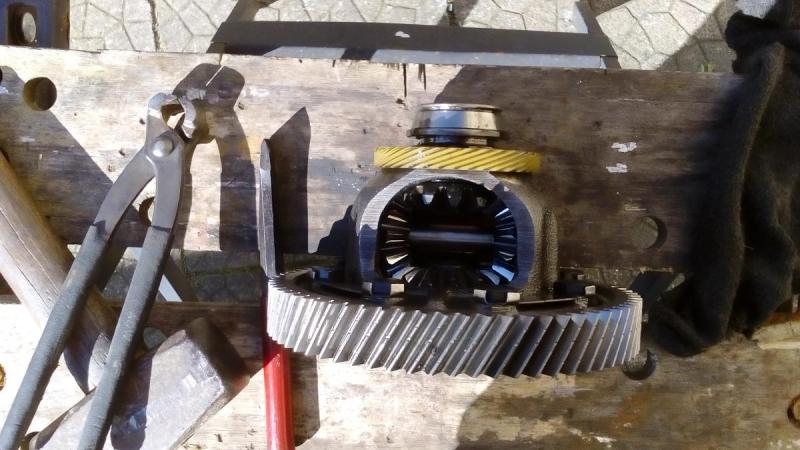

5e colin Posted April 7, 2017 Author Posted April 7, 2017 (edited) thats how far i got todaymade some progress today al bearings in yay happy days no way i am doing 2 boxes in 1 month bwhaaa fucking cunt of a job i forgotten how annoying it is and rookie mistakes made being so long ago sinds i did 1 ha ha opened the box 3 times in total improvised bearing press Edited April 7, 2017 by 5e colin Quote

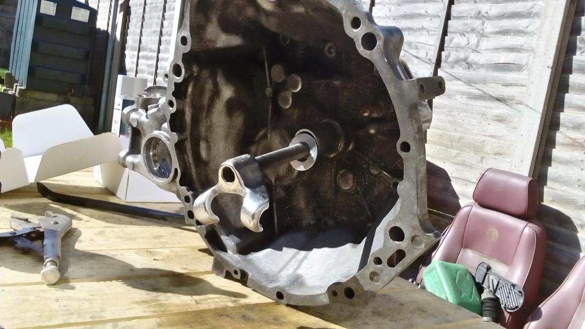

5e colin Posted April 8, 2017 Author Posted April 8, 2017 BOLLOX BOLLOX BOLLOX i have an isseu the box locks up brrrrr fuckin cunt of a thing TBC !!!!!! Quote

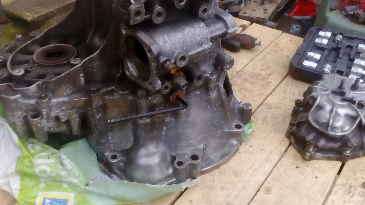

5e colin Posted April 9, 2017 Author Posted April 9, 2017 so another day an other adventure i have 2 mini bals left over !!! Quote
5e colin Posted April 9, 2017 Author Posted April 9, 2017 ha fuck me what a stupid mistake the 2 balls are from the reverse gear selector shaft i put them in and put box back together and everything works perfect happy days new gearbox is ready to be fitted Quote
