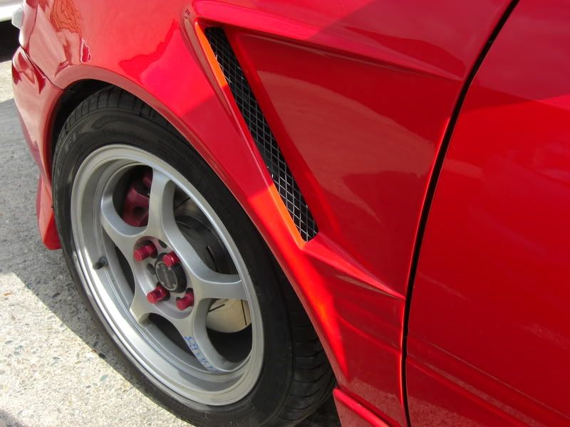

Jozinobi Posted August 21, 2008 Author Posted August 21, 2008 Another Update (must be christmas ;) ???)Levin Twin Pot Conversion Finally CompletedUltra Racing Room Bar Finally Installed (extra bolts added for strength)I've also had the rear tyres switched to the front for even tyre wear purposes, felt pretty good on the road.Initial thoughts on the twin pot brakes are positive and altho still in the bedding in process I can feel there is a lot of potential to be had from this brake setup.Joz Quote
Rich Posted August 21, 2008 Posted August 21, 2008 They look fricking awsome nice match to the wheel nuts aswell!Noticed any difference with the your bar? I guess it all adds up, is there anymore handling mods left? or are they all on the EP ;) Quote
Jozinobi Posted August 21, 2008 Author Posted August 21, 2008 Im glad you like mate.Thats all I have for the moment Rich.The your room bar is quite stiff now thanks to the extra bolting point on each side, every little helps of course.All Im missing is the rear lower arm bar and a full roll cage ;).Joz Quote
Guest Enzo Posted August 22, 2008 Posted August 22, 2008 minted man, whats the pedal feel like compared to before?and where did you get the colour to match the lug nuts bro? totaly apreaceating your work ;) Quote
Jozinobi Posted August 22, 2008 Author Posted August 22, 2008 The pedal feels a lot more refined Geo. Gradual braking and braking distances are far safer and shorter than before.I think its the Endless pads, they seem to be on another level.Time will tell as the bedding in process is still going on, so a little while until I can do some spirited braking.The way I have the calipers and discs fitted, there was no need for spacers or longer wheel studs thanks to the thicker disc.As for the caliper color, I matched the color best I could from a car colour book.Am seriously considering using that color for other dress up parts, what you reckon?Joz Quote
