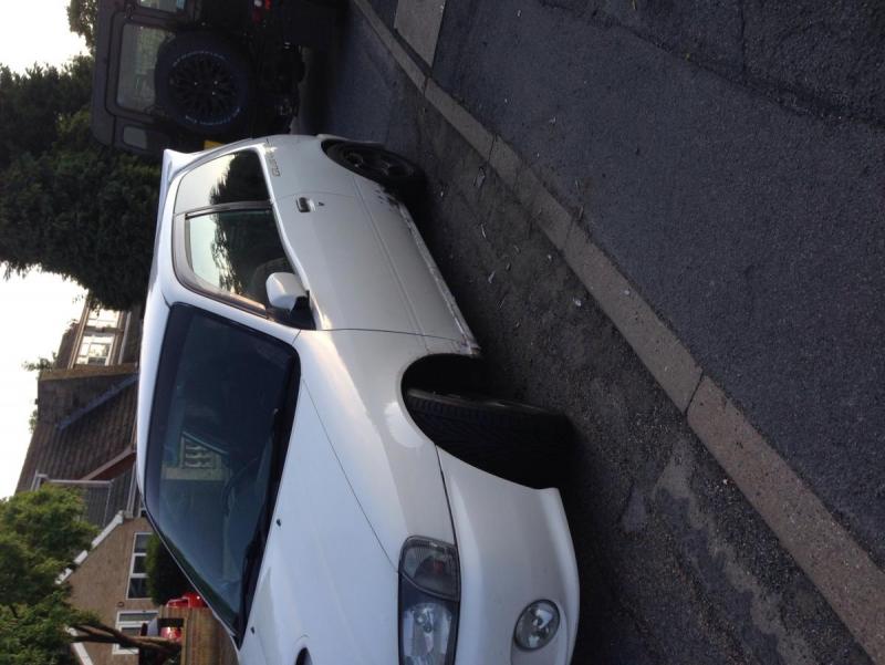

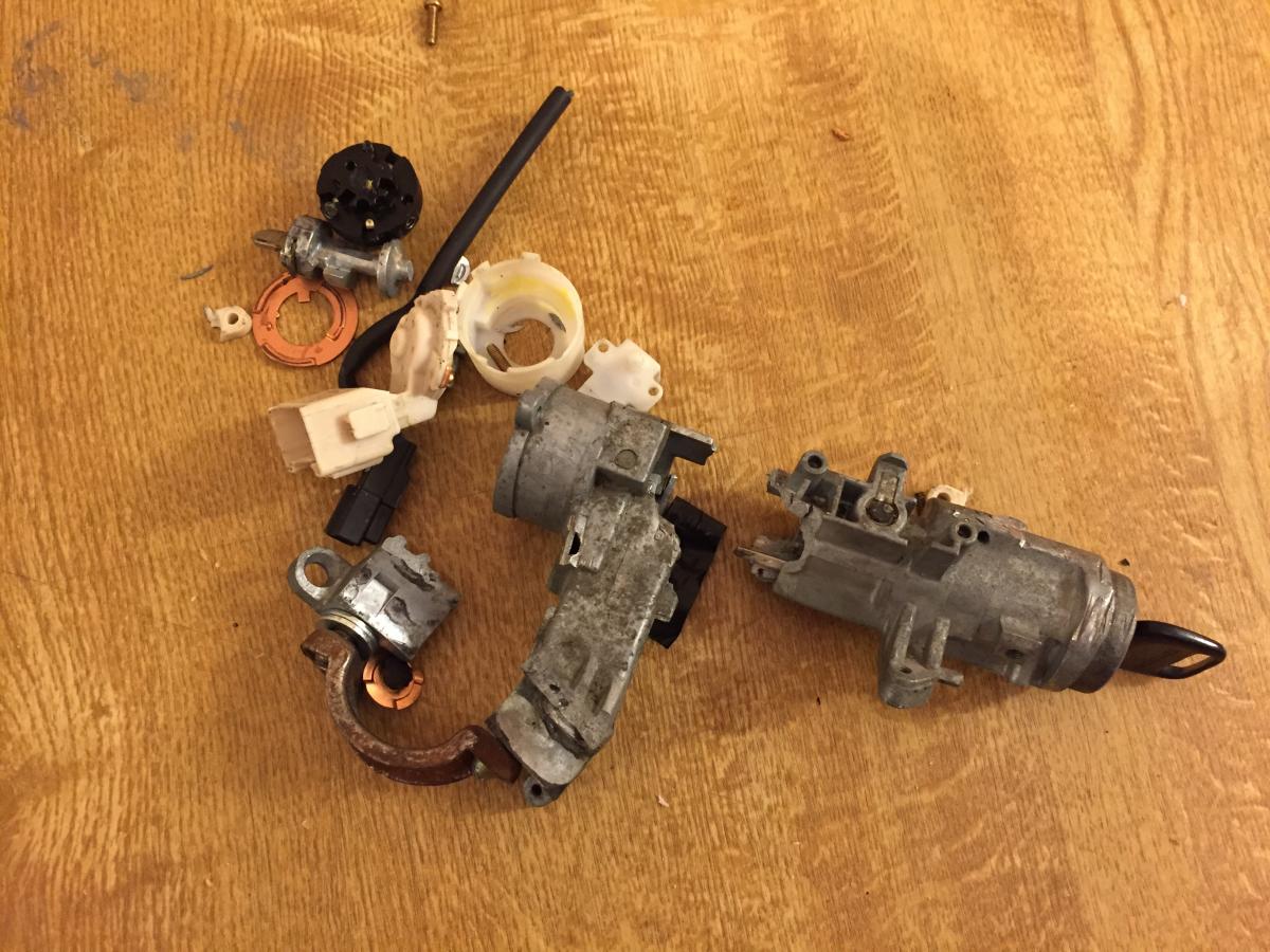

ReeceGolliker Posted October 6, 2015 Author Posted October 6, 2015 (edited) Cheers, I was just happy with how it was then this happens, I guess these things happen, I've only been in this house a month before they scouted it out and tried stealing it! How much will that roughly set me back? And does anyone have one? Haha Edited October 6, 2015 by ReeceGolliker Quote
fordie_glanzaV Posted October 6, 2015 Posted October 6, 2015 I might have a barrel and key.. let me have a look 1st thing in the morning dude Quote
adzy Posted October 6, 2015 Posted October 6, 2015 That's the remains of mine from a few weeks ago.Is any of the wires that are from the plug that goes to the bottom of the ignition barrell damaged? If not just plug in a new ignition barrell, thankfully that got me back on the road Quote
ReeceGolliker Posted October 6, 2015 Author Posted October 6, 2015 Ok thanks guys! i'm going to try get a mechanic to come look at it, unless someone in manchester want to come have a look for a few beers? Quote

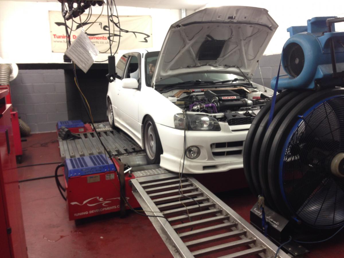

ReeceGolliker Posted November 25, 2015 Author Posted November 25, 2015 (edited) Been up to TD today just to stick my car on their dyno to make sure it's running as it should! And it is, 137bhp at the fly, nice and stock! (Thanks again Mike)! I'm now going tf035, just need to start collecting up parts! Edited July 28, 2016 by ReeceGolliker Quote

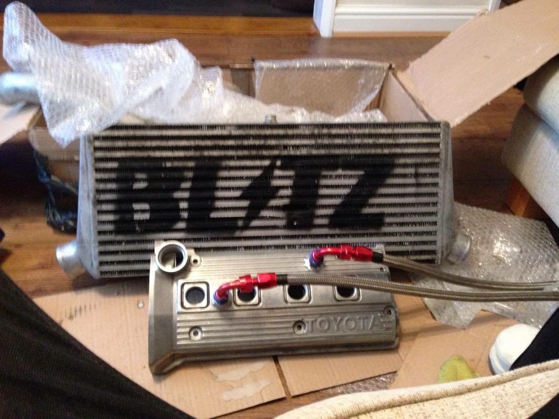

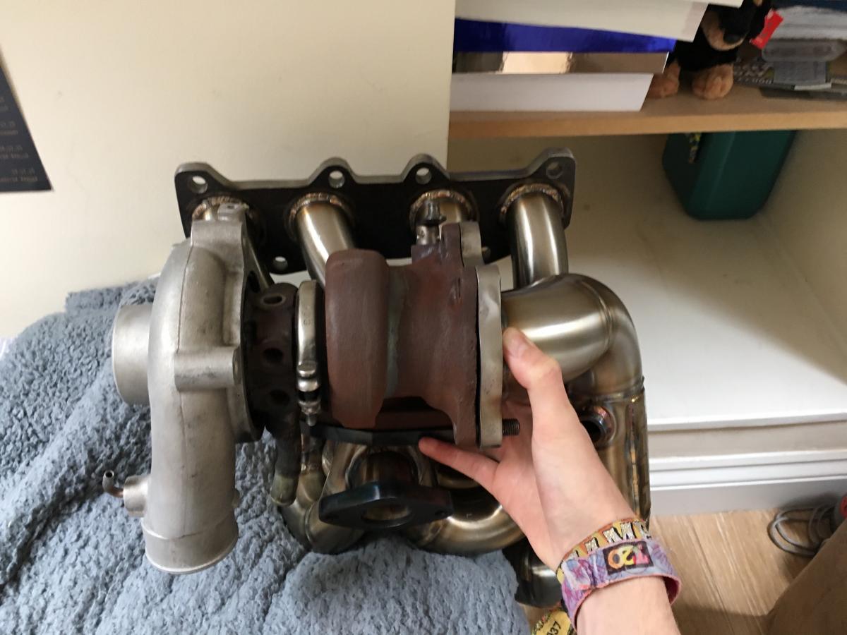

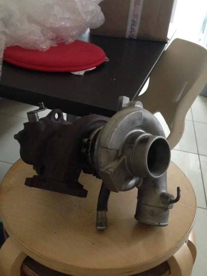

ReeceGolliker Posted December 24, 2015 Author Posted December 24, 2015 So I've started collecting a few bits from members on here; race spec rocker, FMIC and a pretty much fresh TF035! Manifold kit is ordered and should get here min January! Quote

FMuscle Posted January 23, 2016 Posted January 23, 2016 You could have "deleted" the barrel, just leave it for show but have ignition switch somewhere else in the car. Re-run the wires and if someone tries to steal they pop the trim and, oops no wires to jump start I bet the reaction would be even better if you leave the connector in the barrel with a note on it: "you are being recorded" Quote

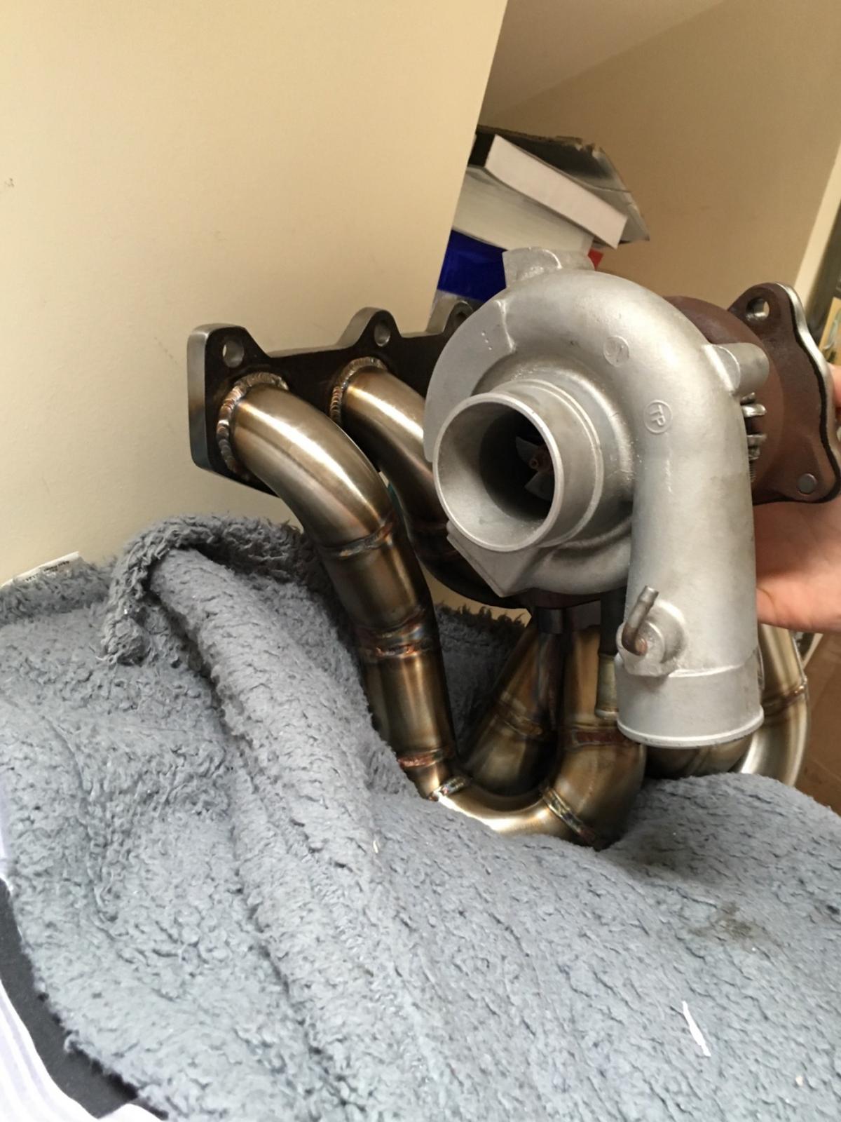

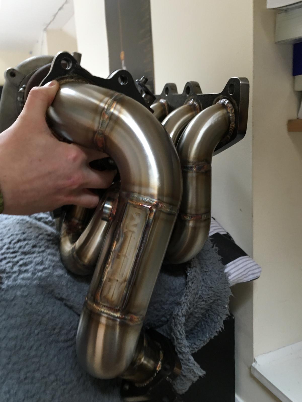

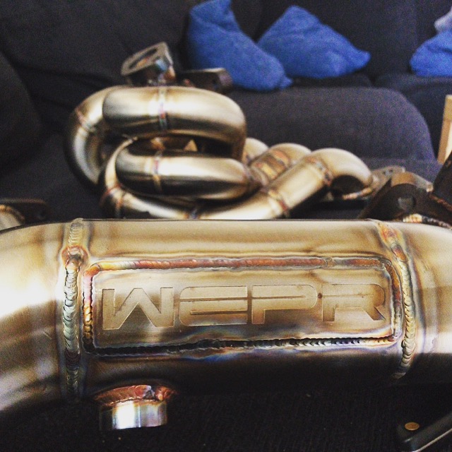

ReeceGolliker Posted February 29, 2016 Author Posted February 29, 2016 (edited) So as some of you may know the glanza is up for sale, however I'm not going to take a low price for it and I don't need rid so It'll probably stay with me unless a serious enthusiast wants it and won't break it. On a more positive note my kit from sasha arrived and I went big, stainless steel drag style manifold! And it's an absolute bit of kit, thanks again sacha! Edited February 29, 2016 by ReeceGolliker Quote

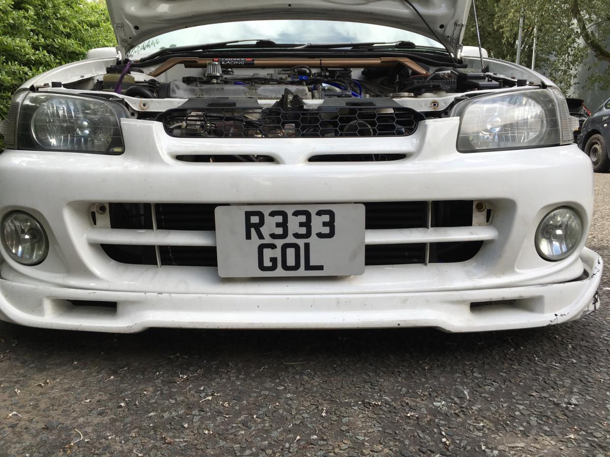

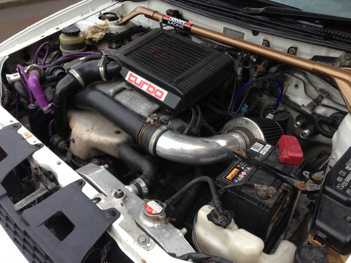

ReeceGolliker Posted May 19, 2016 Author Posted May 19, 2016 (edited) So I'm getting back on track with this now as I couldn't bring myself to sell it, I've got a little collection of parts now, AC has been ripped out and half rad fitted, got the turbo kit, turbo, rave spec rocker and front mount. I'll be booking it in at TD once I decide a date but hopefully mid June for everything else that it needs and mapping. Shouldn't be long now ???????? Edited May 19, 2016 by ReeceGolliker Quote

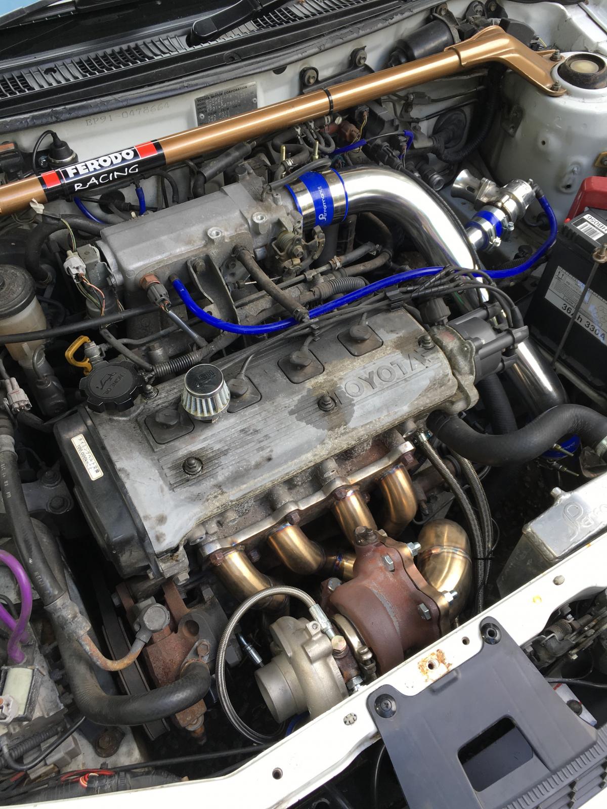

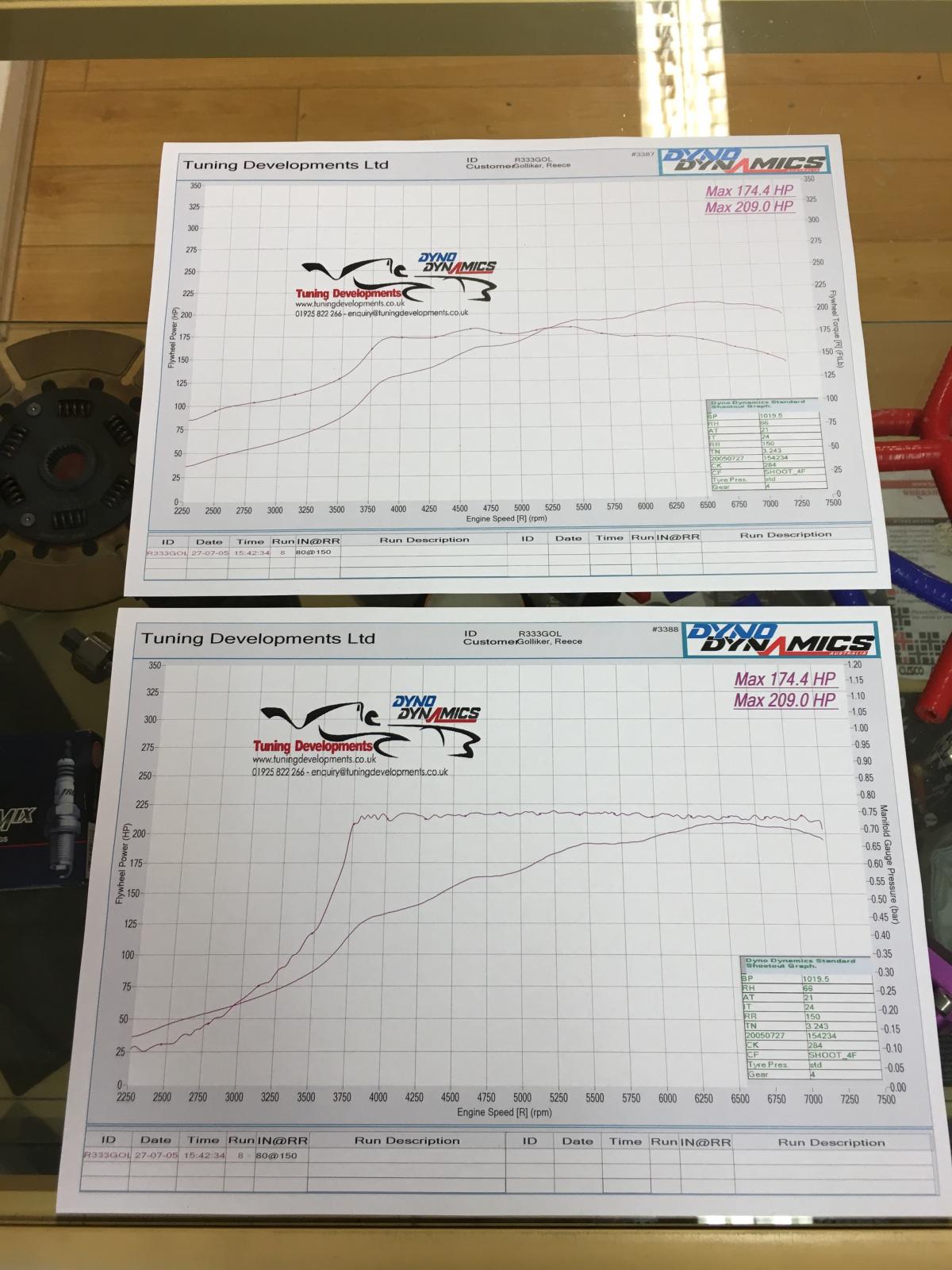

ReeceGolliker Posted June 24, 2016 Author Posted June 24, 2016 (edited) Picked the glanza up and it's crazy fun! Definitely enough power for the time being, I'm very surprised how well it can get the power down. Just running Spring pressure .8bar, making 209bhp. Couldn't be happier with it really, cheers Mike for sorting it. Need to get some mesh on the turbo and my race spec rocker on then I can enjoy the car over the summer. Edited June 24, 2016 by ReeceGolliker Quote
5e colin Posted June 24, 2016 Posted June 24, 2016 stock intake is making the turbo drop of again get bigger intake manii for more top ends or are you only on stock ecu limiter ?? thats 1 sweeeet ride by the way wel done Quote
