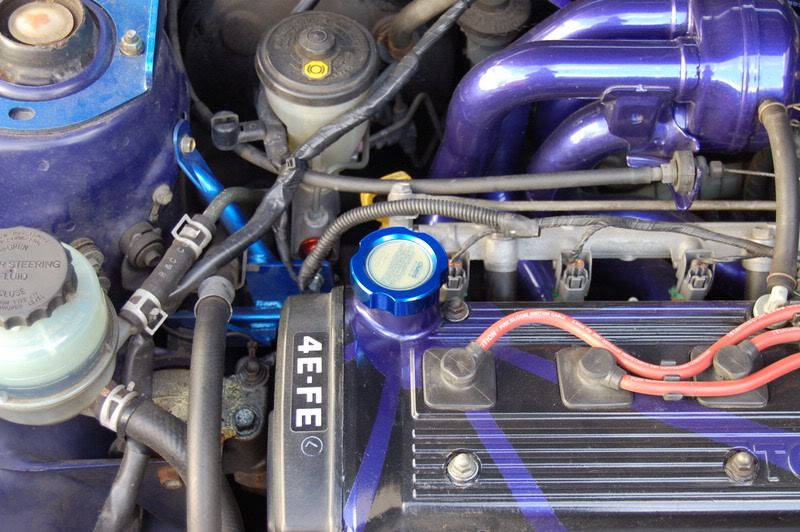

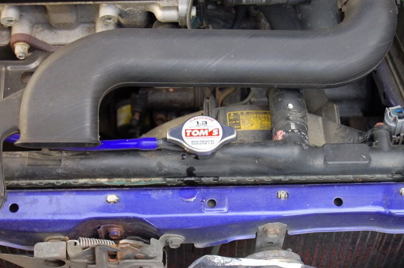

Nanglebadger Posted October 19, 2007 Author Posted October 19, 2007 pics as requested:Tom's rad capSard oil capThe over all effectthe more eagle eyed of u will notice that the pipe between the rolla mani and the rocker cover has been changed back to the OEM pipe, the blue silicone pipe was nice but it wasn't thick enough and the oil was slowly seeping through it, so if anyone has anythinker bits of hose lyin about that they think would work please feel free to make a donation or i'll pay for it, i'd also take red pipin for it if thats wot anyone has used and has some spare!Phil. Quote
SiCaln Posted October 19, 2007 Posted October 19, 2007 nice additions there boyocould u not just put the blue piping over the original pipe? Quote
Idrees Posted October 19, 2007 Posted October 19, 2007 Engine bays looking pretty good now, my cheap ebay silicone pipe seems to be working okay between the inlet and PCV valve... Quote
Jozinobi Posted October 19, 2007 Posted October 19, 2007 Nice to see you got some cool wee bits in Phil.My pcv valve pipe had to be removed too.It was also too wide, a mm too wide.The stuff I got was 9mm which was fine for my 'other' bits not shown in public yet lol but a fraction too loose for the pcv hence the slight leakage.8mm is needed mate to keep things tight .Joz Quote
