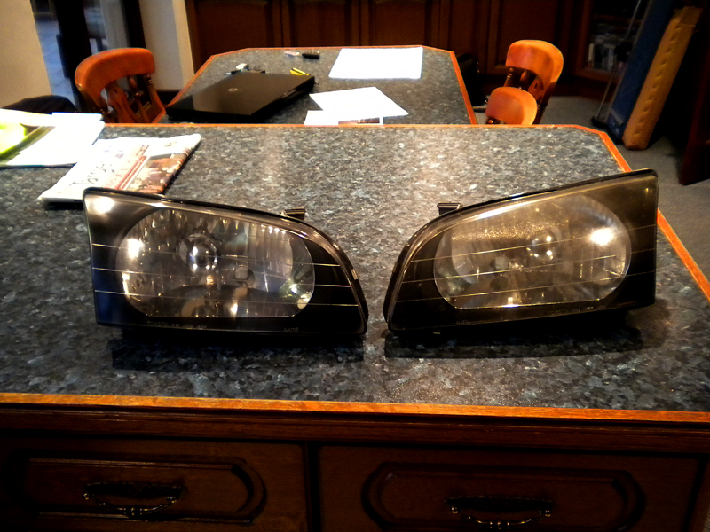

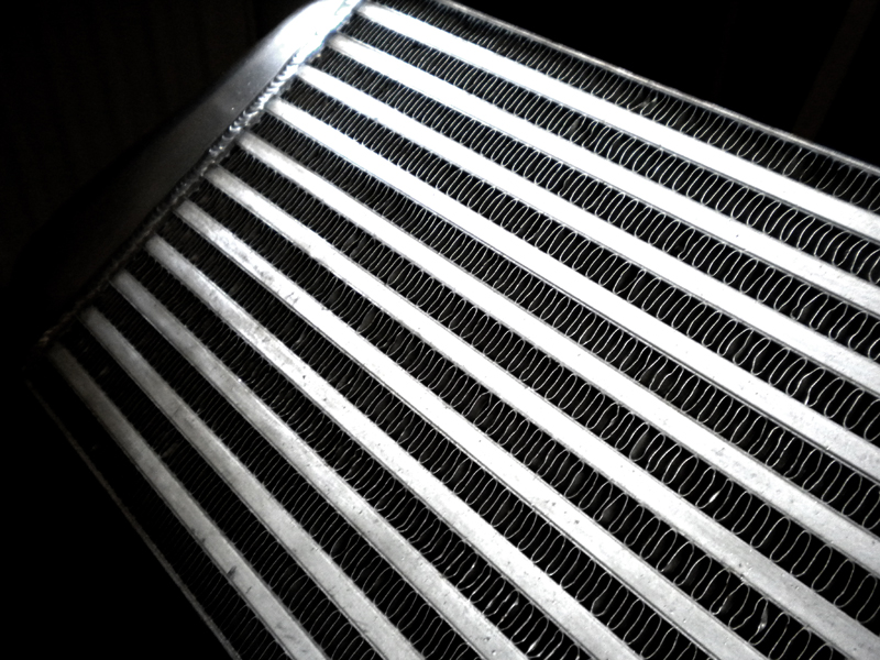

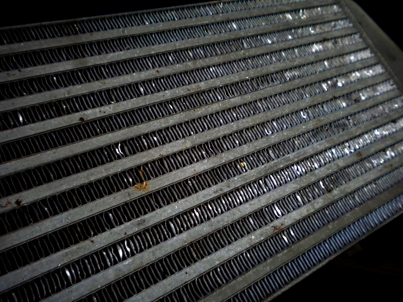

Socks Posted January 22, 2011 Author Posted January 22, 2011 Few Small Updates:I set to work on my intercooler core... These things always get battered by flies, stones, road shit... and after a abuse all last summer it needs some attention!What she looked like:so after hours of straightening fins with a knife, cleaning, polishing. etcnot perfect but alot better ;)Also... Bumpers Home ;)Polished part of the wings and its like a perfect paint match and finally, ive started to refurb my headlights...my glanza was suffering from the typical glazed rough surface from 10years of shite....But ive been sanding down smooth and its coming on quite good, there uber smooth now!Started with 400 grit and then 600 grit wet n dry... and there now smooth as hell, but i need to keep increasing to get rid of the cloud but i reckon i can get them looking like new ;)Also ordered brand new reflect rear clusters too, and shipped my old ones off to LukeSR!Should have my engine back next week according to Ricky@Race-Tech so watch this space! More to come people! Quote

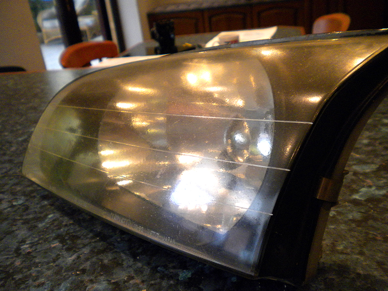

Socks Posted January 22, 2011 Author Posted January 22, 2011 that picture is sexual!! potm material!!thanks bigman ;)Awesome work mateySo you going to make it to the Trafford centre meet thenthanks bbe!unsure tho! if not in my car it may well be in my fiesta ;)ill try tho Ah that ID-workz front looks absolutely sexual if I must say so myself!u dont need to do anymore advertising dude, uve had to shut down to catch up on orders ;) but yes... it looks great!wow i forgot how sexy your motor is! good work matecheers dude! Hope to see this tomorrow! looking sweetc u soon jon! looks awesome bud, good work with the intercooler too dudecheers buddy!Right, ive finished one light and im very impressed with the results! Cost me in all about 3quid in paper and polish.. Got a reet sweat on tho picture really doesnt do it justice....i gave them a regular polish throughout summer, they were a bit better, but this has truely transformed them! There so smooth!I did 600, 800, 1000, 1200 wet n dry, then meguiars ultimate compound.... they look like NEW!infact.... im gonna do the foglights too! ive just decided lol! Quote
