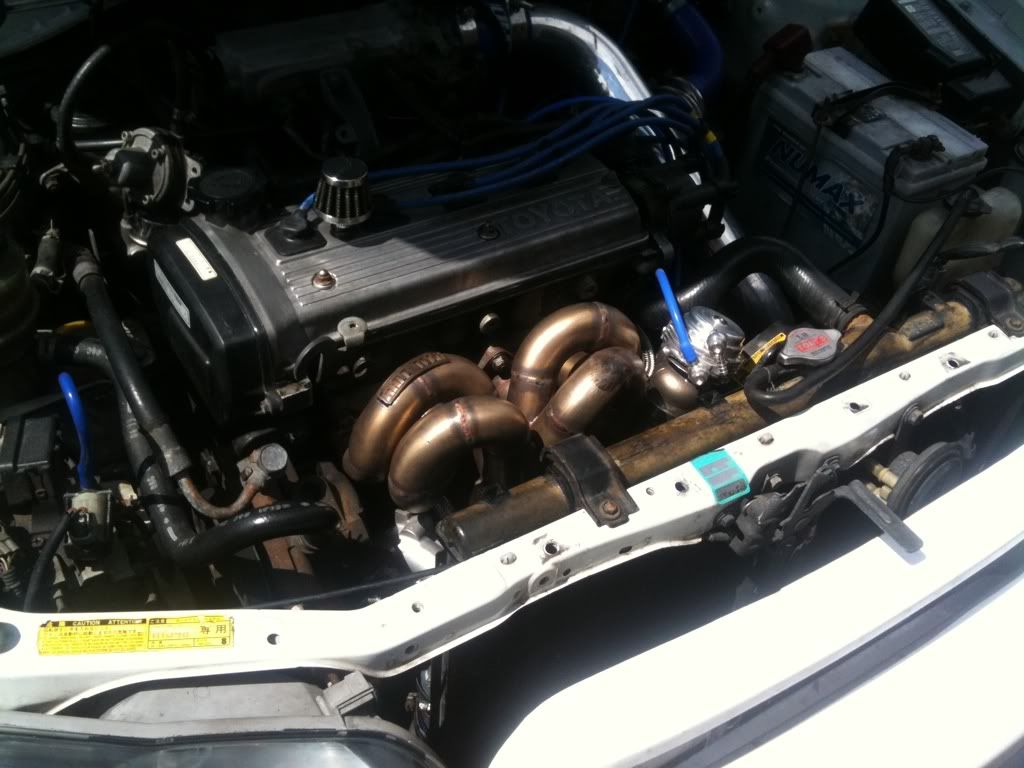

N80Jamie Posted June 19, 2011 Author Posted June 19, 2011 Well as some of you may know, i sold the WEPR kit i bought from Quadcorecraig as i didn't want to chop the exhaust blah blah. Went for a trip to Derby to see 'Saun Glanza V' (Think thats the right spelling ) and bought his basically brand new Racetech TD04 Kit! Spent the last couple of days getting things on, chopping intercooler pipes etc lol. Heres a few pictures of the result:The raditor was a very very tight fit so will be getting a civic rad asap. Also, need to get hold of an electronic boost controller and an ecu! I'm not sure if i'm safe to boost yet as im only running a FCD and RRFPR with the fuel pressure at 2.4bar. I removed one of the springs in the external wastegate, tested it once and i peaked at 0.74bar. I can take this spring out and put the other one in but i think i'll only have 0.3bar of boost then. Ideas until i get an ecu? Just not boost? lol. Quote

rorenapier Posted June 19, 2011 Posted June 19, 2011 If your on a standard ecu, it will fuel fine at .74 bar.Just get it checked on a wideband to confirm.Why are you running a FCD at them boost levels anyway? Quote
N80Jamie Posted June 19, 2011 Author Posted June 19, 2011 If your on a standard ecu, it will fuel fine at .74 bar.Just get it checked on a wideband to confirm.Why are you running a FCD at them boost levels anyway?Really glad to hear that! I'll have to try and find someone local with a wideband to help me out with checking the fueling. Only running a FCD because it was installed from Japan lol. I'll probably rip it out and sell it on as i don't need it anymore.Race-tech is just I no! Fell in love with this kit when i first saw it so im over the moon i have one now! Quote
Sparky Posted June 22, 2011 Posted June 22, 2011 RaceTech FTW I am running .6bar and Ricky says I was running a little bit lean so I would be careful mate, up the fuel pressure a bit and get it on a dyno for now to be on the safe side.How you finding TD04 power? Quote
N80Jamie Posted June 22, 2011 Author Posted June 22, 2011 RaceTech FTW I am running .6bar and Ricky says I was running a little bit lean so I would be careful mate, up the fuel pressure a bit and get it on a dyno for now to be on the safe side.How you finding TD04 power? Aahh no more foot on the loud peddle until i mapped then lol! Tbh i havn't really been testing it too much because of fueling but from what i've experienced so far is awsome! Totally outperforms the ct9 hybrid!I'll get the fueling checked as soon as i get paid and i may even stick in the 0.3bar spring if it doesn't make me run too rich. I think to start with i'm going to get a plug and play, run that for a bit and as soon as i've got fuel pump, injectors etc i'll sell that and get an EMU! Can't wait until i'm set up at 1bar-1.1bar! Welcome to the club Haha cheers Giggz, best turbo kit club everzz Quote

rorenapier Posted June 22, 2011 Posted June 22, 2011 Remember it will run lean the lower the pressure Running 0.3 bar and it will run lean, as the tables in the map wont be fueling that much..Same as 0.6 bar Sparky..Hencde i said 0.74 bar fuels fine.. Quote
