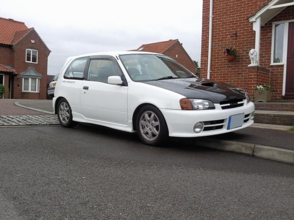

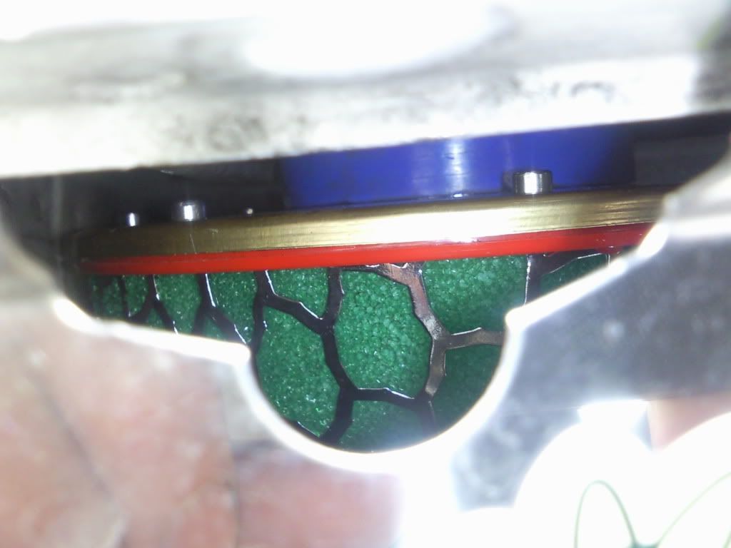

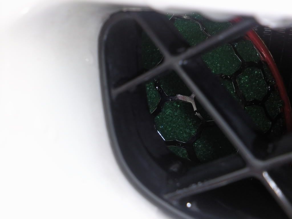

Liam_D Posted May 29, 2011 Author Posted May 29, 2011 Yeah decided to not wrap it in the end, as ive heard from a few people in the know that it doesnt help anything so no point wasting my cash getting some heatwrap. Right some good and bad news, Took the trip to monster motorsport again yesterday to get the coilovers dropped at the back. Everything went sucessfull so it now sits like this Much better! Also managed to fit the HKS Mushroom and relocate it too the front like so. Sounds awesome and goes awesome! Also chatters like mad if i block the BOV off. However im now hitting fuel cut in 3rd,4th and 5th So it looks like the turbo is gonna have to come off and were going to have to port the wastegate. Also going to have to get some sort of catch can as i now have a random breather pipe facing the floor Think im going to pick on up from Mike tomorrow which i can have for free so that should hopefully be sorted tomorrow. Mixed emotions on the Glanza right now! Quote
