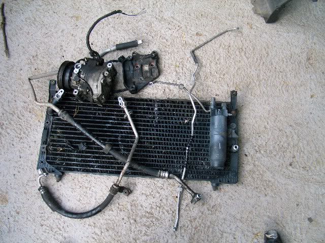

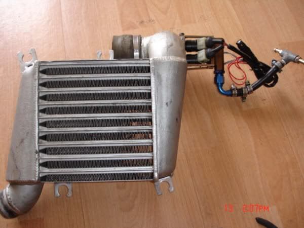

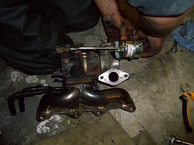

Guest Enzo Posted August 26, 2006 Posted August 26, 2006 sound budalright people just a little update,last wknd set about gutting the ac, if your thinking about htis you need to remember and purchase a na powerstearing belt, took about 1.5 hours to do in allalso flew to dublin to pic up my arc on tuesday, then toured up to baz's new paint shop in troon to fit it, he has a minted set up in his spray shop.after driving it up the road the car did seam to pull abit cleaner.the shit bit was tonight, toured up to haggis's to get my manifold, and actuater fitted along with gutting the cat.check out the heavy restriction in runner number threegutting the cat was a piece of piss, just attacked it with a chizel and hammer, you need to wear a dust mast though as the cats full of nasty shit.here in lies one of the problems, there was no pin supplied in the hks actuater kit, so in the mean time haggis managed to sort out a temporary solution,does anyone know where i can get a pin though, i need one pretty urgently tbhthe second part of my problem is my head has a heafty crack in my, felt like shedding a tear after seing it with the manifold off, its masive !!!so i might need a new head to sort this out, last thing i was expecting and its totaly set me back on my game planthis crack is an underlying problem on glanzas, just check around the right top of the manifold ITS PURE AIDS!!!! Quote

Guest Enzo Posted August 26, 2006 Posted August 26, 2006 on closer inspection this morning as it was dark when we finnished, it seams the blow is coming through the gasket on the new manifold and not the crac which is a weight off my chest, ill just have to take it off and double up a couple of new ones asi reused the old gasket there, i also need to turn down the actuater so ill do this when servicing the glanza today if the manifolds warped ill have to get my mate to mechine it straigt, hopfully its not,also on the actuater im sure something is mising in the kit, ep82s have the pin type and ep91s the hole type yea?????? Quote

ecksjay Posted August 27, 2006 Posted August 27, 2006 is it a wepr mani mate? if so, it'll be blowing because the flange is too thin, meaning the nuts holding it on aint actually sealing as tight as they should be (due to not catching the thread), plus as the flange is thin they obviously warp etc, thats mainly why i sold my wepr on, it was brand new and may well have been perfect but i couldnt be bothered to take the risk if it wasn't. i'm far too lazy to inspect problems etc.whats that on the pipe of the arc going into the inlet? silver foil or something? either that or its a whole lot of welding? looks mightily wierd! Quote
WallaceGlanza Posted August 27, 2006 Posted August 27, 2006 Looking good bud, but you got it the wrong way round wi the actuator. The ep91's are pin type and the older ep82's (not all of them) are hole types. You don't get the pin with the actuator the whole screw on arm bit is different, just try an find someone with an ep82 that needs a hole type arm and swap, i had to do this with mine. Quote
Guest Enzo Posted August 30, 2006 Posted August 30, 2006 yea man its abit of a shitter that.....@well spotted ekwhoever had it in japan went to the liberty of plumbing in two injectors which was a nice surprise,the holes are blocked up with two rubber plugs and that capi have some different rear lenses that im gona fit on tomorrow,i know what your saying with the manifold thats why i used washers as you can see in the pic, shouldent have chanced it with the gasket though, in that pic to the right of the nut is where its blowing.the actuater seams to be holding up the way its mounted but its far from idealim gona divert the whole of friday to taking the mani off and fitting a new gasket, hopefully that should solve the problem, if not il have to divert to the old mani Quote
