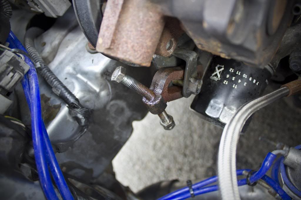

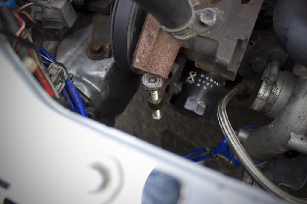

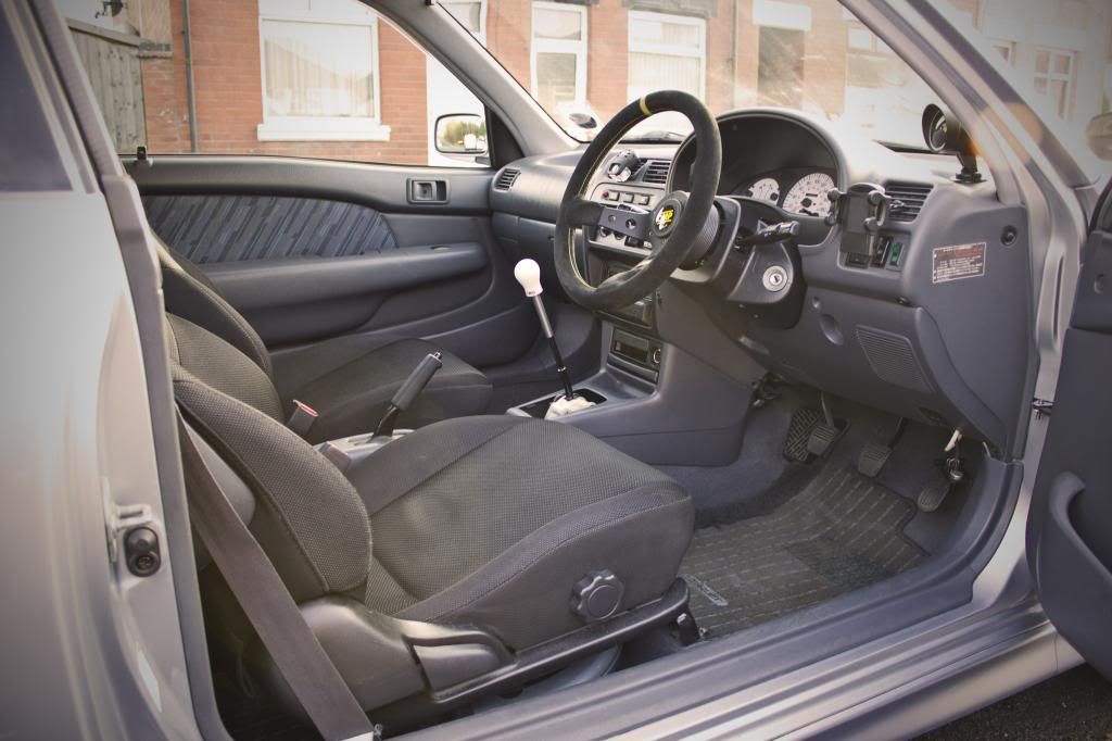

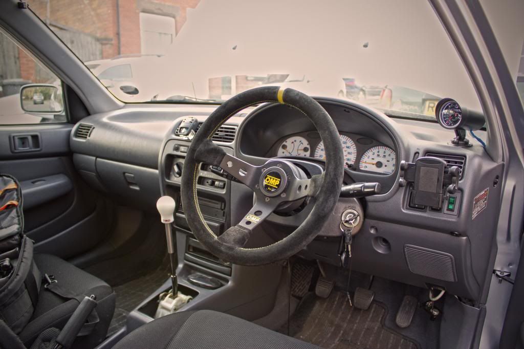

Spoon_tuned Posted February 17, 2013 Author Posted February 17, 2013 Ok weather finally got a bit better so today i got round to fitting my OMP deep dish from off my EF9 even the horn works hahaha car feels so much better to drive now so glad i fitted it after agaes of waiting plus my power steering belt was'nt tight as the tensioner bolt was bent somehow so i hack sawed it off and replaced it with a genuine bolt from toyota Enjoy! New one fitted Quote
redline Posted February 18, 2013 Posted February 18, 2013 Might sound stupid but I've got a omp wheel coming through in the post how do I go about taking the old one off it's got a air bag and stuff? What screws do I take off and stuff to remove it? Quote
Beastmode panda Posted February 18, 2013 Posted February 18, 2013 Might sound stupid but I've got a omp wheel coming through in the post how do I go about taking the old one off it's got a air bag and stuff? What screws do I take off and stuff to remove it? Undo the two torque screw on the side of the steering wheel to remove the airbag, then inside is a big 19mm bolt, put the steering lock on and crack the 19mm bolt off all the way then wiggle the old steering wheel off. Done. Looks sick man good job! Quote
Spoon_tuned Posted February 18, 2013 Author Posted February 18, 2013 Undo the two torque screw on the side of the steering wheel to remove the airbag, then inside is a big 19mm bolt, put the steering lock on and crack the 19mm bolt off all the way then wiggle the old steering wheel off. Done. Looks sick man good job!As rob said its pretty simple mate tbh add an extra wire to the horn earth it to the alan key bolts on the steering wheel. Job done!!As for the airbag light mines not on as the previous owner must of had an after market steering wheel on before and had the light took of or removed the bulb.Cheers rob just about to polish it!! Quote
LukeSR Posted February 18, 2013 Posted February 18, 2013 Loving the wheel dude! miss my dished one haha! Quote
Spoon_tuned Posted February 18, 2013 Author Posted February 18, 2013 Loving the wheel dude! miss my dished one haha! thanks mate glad i kept itLove the wheel.. Looking wellcheers dude yeah me too it's off my EF9 SiR glad i kept it when i sold it.. lovely bit of genuine Quote

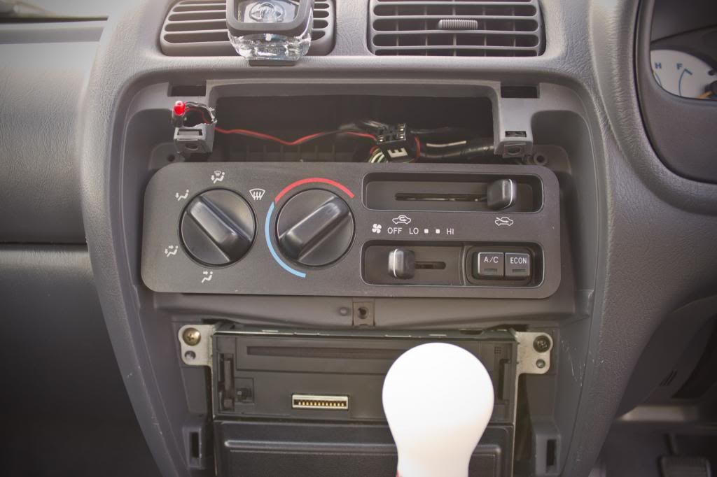

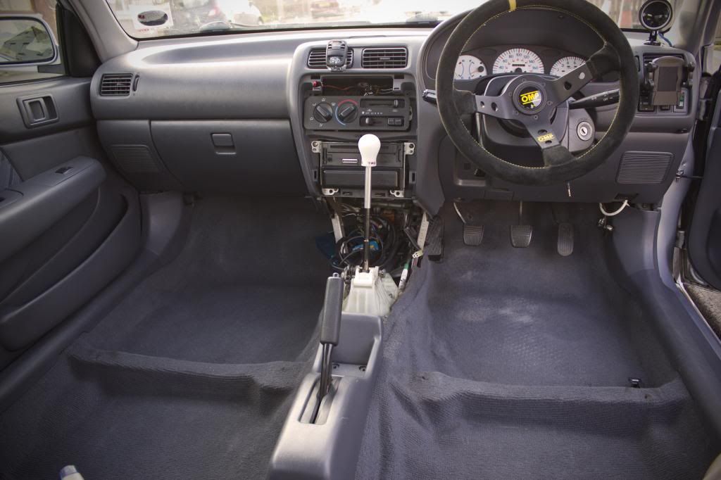

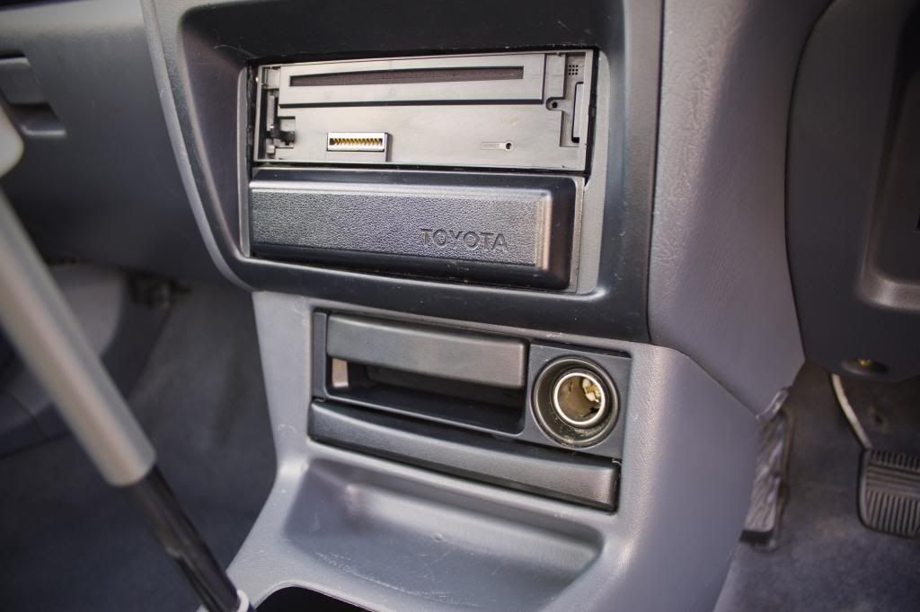

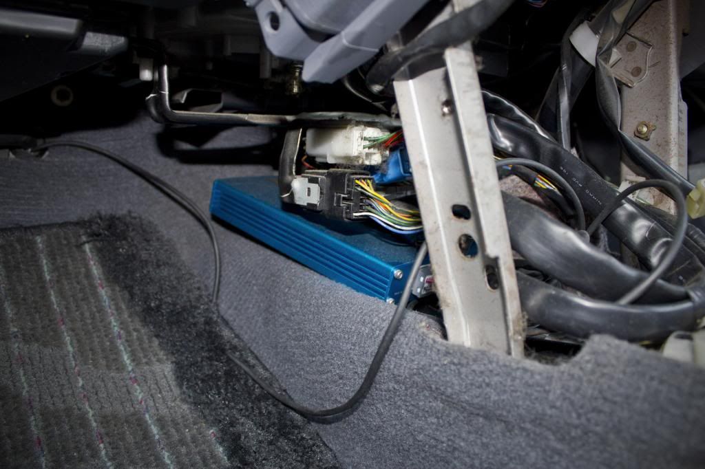

Spoon_tuned Posted February 18, 2013 Author Posted February 18, 2013 (edited) Right Update Time *************************** So glad the weather has been picking up i can actually get stuff done. Not many new parts on my car as people like but my car has most the stuff on it i need right now i just like maintaining and cleaning up my car to get it mint step by step!! So today i wanted to give the car a real good clean as i havent had the chance too since i've owned it and i like to strip the interior and clean the shit out of it like ive done with all my cars it's like putting my stamp on it so it actually feels like it's mine...if that makes sense. Sun was shining but didnt start til like 12 but still made good progress today started off with taking out the seats & the mats then stripping some of the plastics. It was all dusty and horrible years of shit had to be got rid of! I found the Ecu where the shifter cables run not to keen on it being there i'd like to tidy it up a little bit more maybe re wire it into the glove box to neaten things up but i will get cracking on that another day. Anyway i found some carpet cleaner stuff and sprayed all my carpet and mats with it then just hoovered it off car smells so fresh now feels like a new car and all i've done is cleaned it...Cleaned all the plastics up from all the dirt and crap and all the dials and buttons and sliders all free of dust and dirt which i'm happy about even though the plastics are abit scratched i might get some spray in the summer and spray them with black interior spray.. Once all the inside was done i polished the outside and cleaned the bay but i didnt get any pictures of that as battery ran out on my camera..but it does look clean after months of shit & snow all over it i have jet washed it but not thoroughly cleaned it with polish & stuff even got the tyre shine out on the the tyres!! Real happy with the car atm lots more to do like with the engine bay and cleaning up the turbo and the block etc etc but i will get that sorted in the next few months and in past its MOT last week which i'm pleased about... To Get List:Greddy EBCBraided Brake LinesRear ArbService PartsNew SeatsTD04 Gaskets Anyway Enough Chattin Rubbish Heres Some Pictures!!! Much Better All Back Together Edited February 18, 2013 by Spoon_tuned Quote

akyakapotter Posted February 18, 2013 Posted February 18, 2013 I like where you have your emb dosen't it get a tad hot there though ?? Quote
Spoon_tuned Posted February 18, 2013 Author Posted February 18, 2013 I like where you have your emb dosen't it get a tad hot there though ??Not really mate its been fine so far. Quote
akyakapotter Posted February 18, 2013 Posted February 18, 2013 Not really mate its been fine so far.May have to move mine to there so I get my glove box back lol Quote
Spoon_tuned Posted February 18, 2013 Author Posted February 18, 2013 May have to move mine to there so I get my glove box back lol haha.it's worth a go just the wires are everywhere i like it neat Quote
