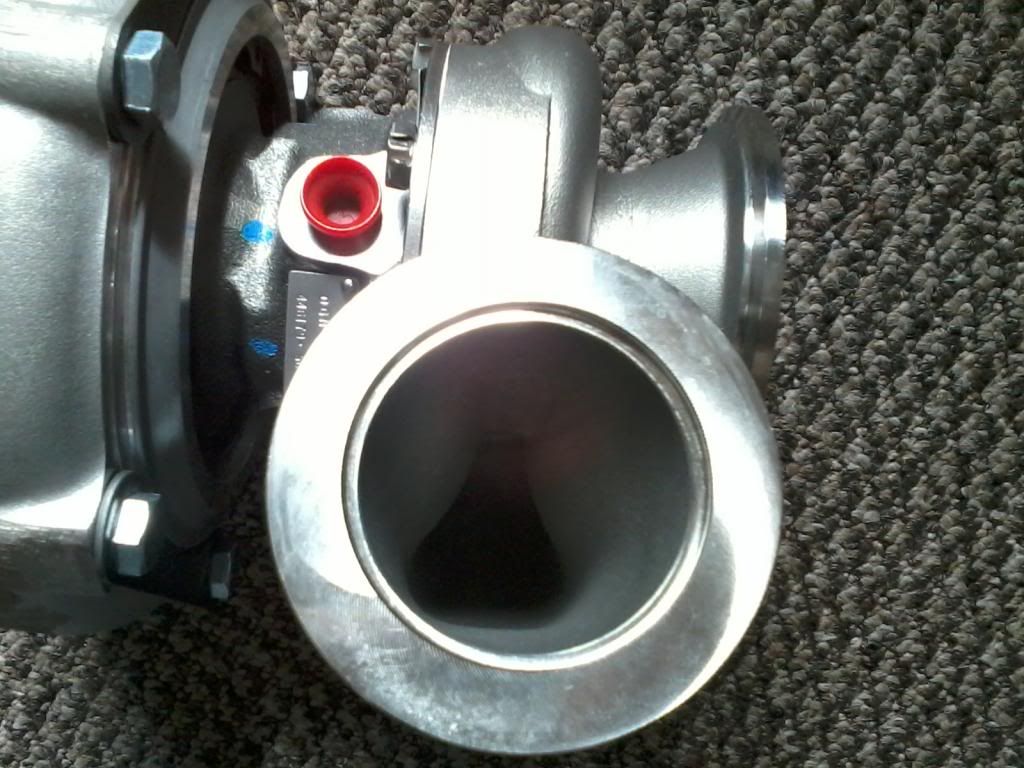

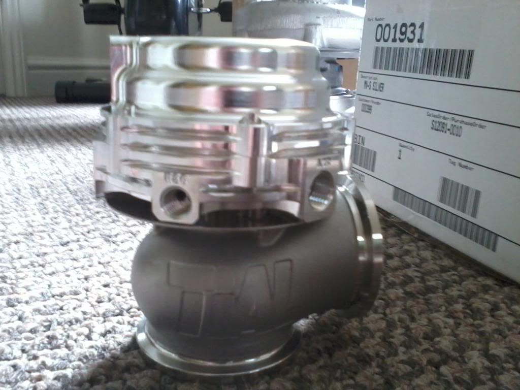

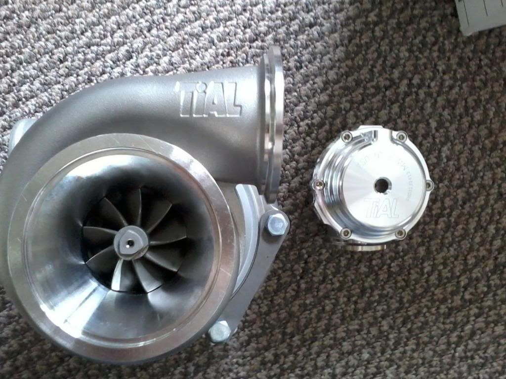

AdamB Posted May 8, 2013 Author Posted May 8, 2013 (edited) Well I took the turbo down to Owens yesterday (Tuesday) at 3pm, and got it back today at 3pm with everything I had asked for! Cracking service and I can't fault them at all.I had the Tial .64 AR V-band turbine housing put on with Owens own 360 degree thrust clamps as they told me the Tial ones are prone to coming loose. They also rotated the turbo for me and I grabbed a Tial MVS 38mm wastegate whilst I was there also. Anyway some pics Here's the 360 degree thrust clamp set http://s164.photobucket.com/user/BoobZ18/media/Toyota%20Starlet%205E%20Build/TialTogether_zpsb1f649eb.jpg.html'> Edited May 8, 2013 by AdamB Quote

AdamB Posted May 8, 2013 Author Posted May 8, 2013 Sweet mate, A very similar looking turbo to the one I have The tial housing will hopefully stay rust free You got a 28 mate? Thought you went 30, must have another read of your build thread lol. Am sure it will stay rust free, mine won't be driven in shit weather anyway, and will try wrap it as much as I can. Lovely bit of kit mate Cheers Todd, appreciate it Bloody hell that's nice!!! Ta fella, still got plenty more goodies up my sleeve yet Quote
Azz Posted May 8, 2013 Posted May 8, 2013 Well I took the turbo down to Owens yesterday (Tuesday) at 3pm, and got it back today at 3pm with everything I had asked for! Cracking service and I can't fault them at all.I had the Tial .64 AR V-band turbine housing put on with Owens own 360 degree thrust clamps as they told me the Tial ones are prone to coming loose. They also rotated the turbo for me and I grabbed a Tial MVS 38mm wastegate whilst I was there also. Anyway some pics Here's the 360 degree thrust clamp set Well I took the turbo down to Owens yesterday (Tuesday) at 3pm, and got it back today at 3pm with everything I had asked for! Cracking service and I can't fault them at all.I had the Tial .64 AR V-band turbine housing put on with Owens own 360 degree thrust clamps as they told me the Tial ones are prone to coming loose. They also rotated the turbo for me and I grabbed a Tial MVS 38mm wastegate whilst I was there also. Anyway some pics Here's the 360 degree thrust clamp set Sweet mate, A very similar looking turbo to the one I have The tial housing will hopefully stay rust free Very similar to mine aswell, we have a few interesting builds between us here but who will make the most bhp ;) Quote

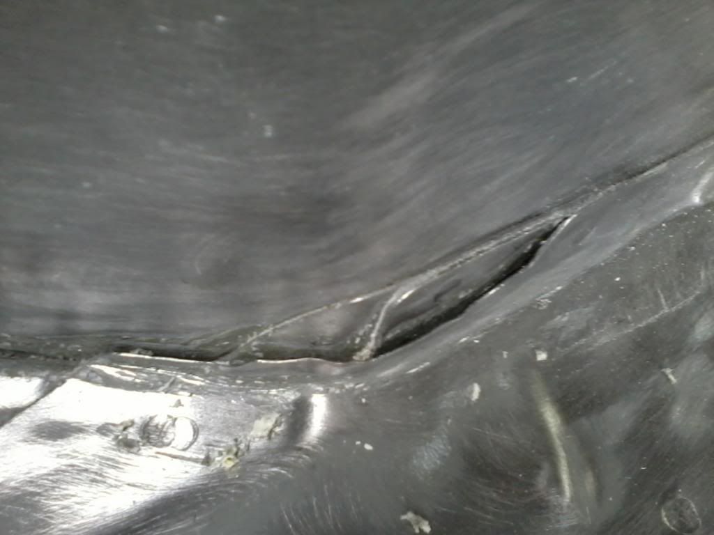

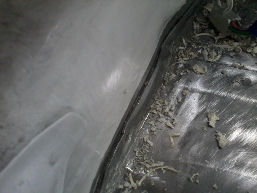

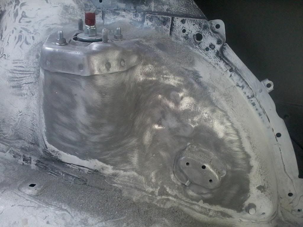

AdamB Posted June 12, 2013 Author Posted June 12, 2013 Well not updated this for a while but I have been working on the car behind the scenes. Been cracking on with preparing the shell for seam welding, where the rear has been painted with a paint brush and is fairly uneven all the way around its taken a bit of time to get it done. But it's nearly there now and I can't move onto the front.I can't believe how weak, flimsey and the gap between the panels actually is, its hard to see with paint and the seam sealer in the way, but after removing most of the sealant I was amazed at how little effort you have to put in to move the panels. This is how it started outhttp://s164.photobucket.com/user/BoobZ18/media/Toyota%20Starlet%205E%20Build/Start_zps559d8630.jpg.html'> Excuse the dust in the rest of the pics, I need to get the hoover in there but it started raining http://s164.photobucket.com/user/BoobZ18/media/Toyota%20Starlet%205E%20Build/Total_zpscb696cc1.jpg.html'> Suspension strut seam with all paint and sealant removedhttp://s164.photobucket.com/user/BoobZ18/media/Toyota%20Starlet%205E%20Build/Strutseam2_zps2c7edad3.jpg.html'> http://s164.photobucket.com/user/BoobZ18/media/Toyota%20Starlet%205E%20Build/Strutseam_zps257d64ed.jpg.html'> Boot seam where the floor pan meets the boot, you can still see some of the sealant on the left sidehttp://s164.photobucket.com/user/BoobZ18/media/Toyota%20Starlet%205E%20Build/Bootfloorseam_zps796c2190.jpg.html'> http://s164.photobucket.com/user/BoobZ18/media/Toyota%20Starlet%205E%20Build/Bootfloorseam2_zps394fe5c6.jpg.html'> This is under the rear light, you can see all the sealant I've picked out http://s164.photobucket.com/user/BoobZ18/media/Toyota%20Starlet%205E%20Build/Rearlightseam_zps620cad3a.jpg.html'> Thats all the pics I have as I didn't think anyone would just want to see a car with less paint lol.It has been pretty time consuming doing it, but after seeing what I've seen its deffo gonna be worth it. The tools I used were a drill, wire drill bits, punch, chisel, hammer, stanley knife.Used the drill with the wire bits to remove the paint and remove as much of the sealant around the seams as possible, then using the stanley knife cut a long the seam sealant and use the chisel/punch to pull it up. Hoping to have the rear completely finished tomorrow, I've only got the offside rear seat well to finish off, which won't take 5 mins as the paint is very thin there. Then it will just be a case of going round and pulling out the rest of the sealant. I'll be removing the dash and getting that flocked a long with the A pillar plastics, not sure if I should go all black or have the dial surround and stereo surround in white to match the car? Think it might look a bit tacky. When the dash is out I'll be looking to remove any wires that aren't needed just to clean it up, any wires that will potentially be on show will be covered in braided sleeving and shrink heated. Quote
