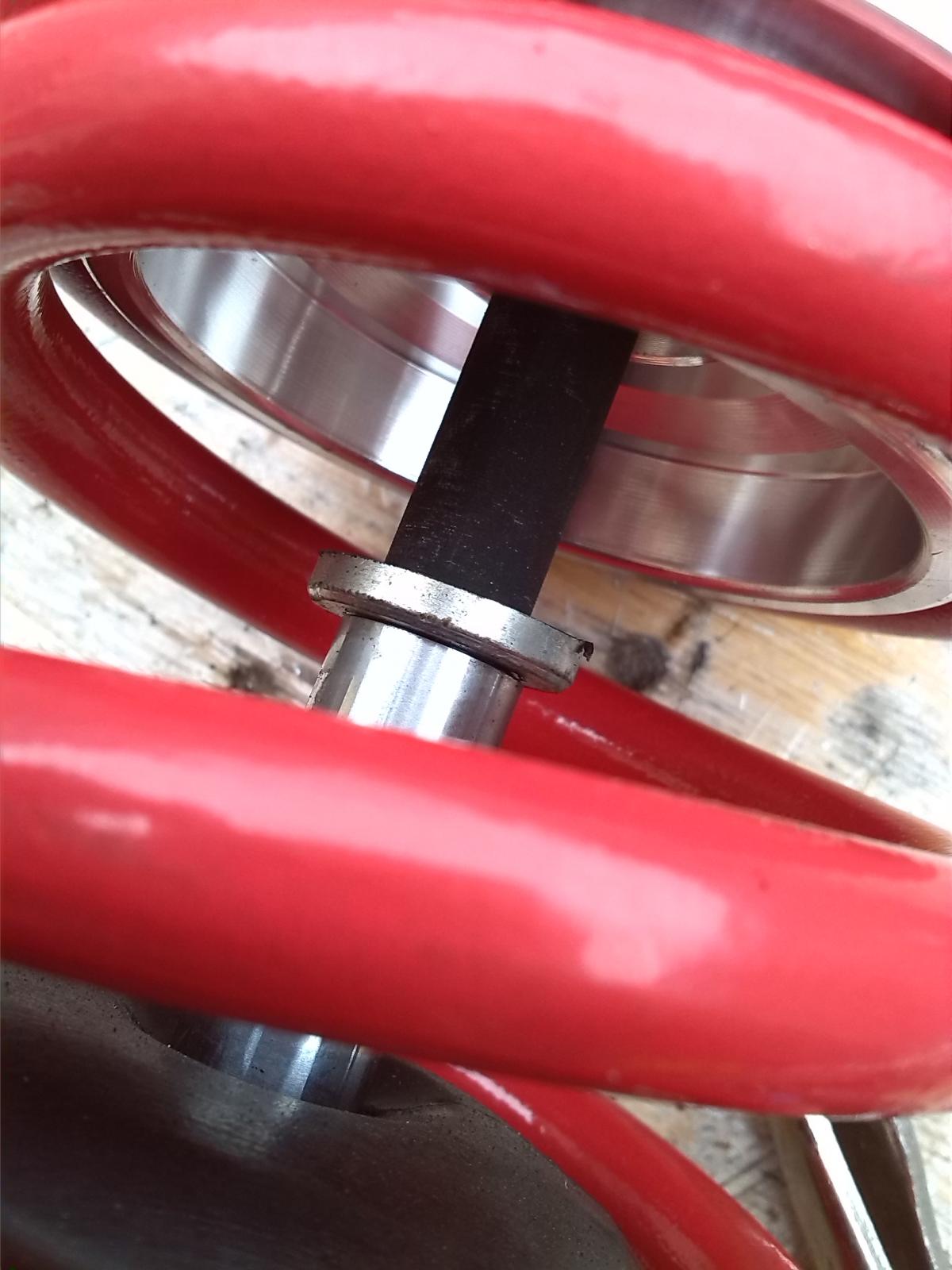

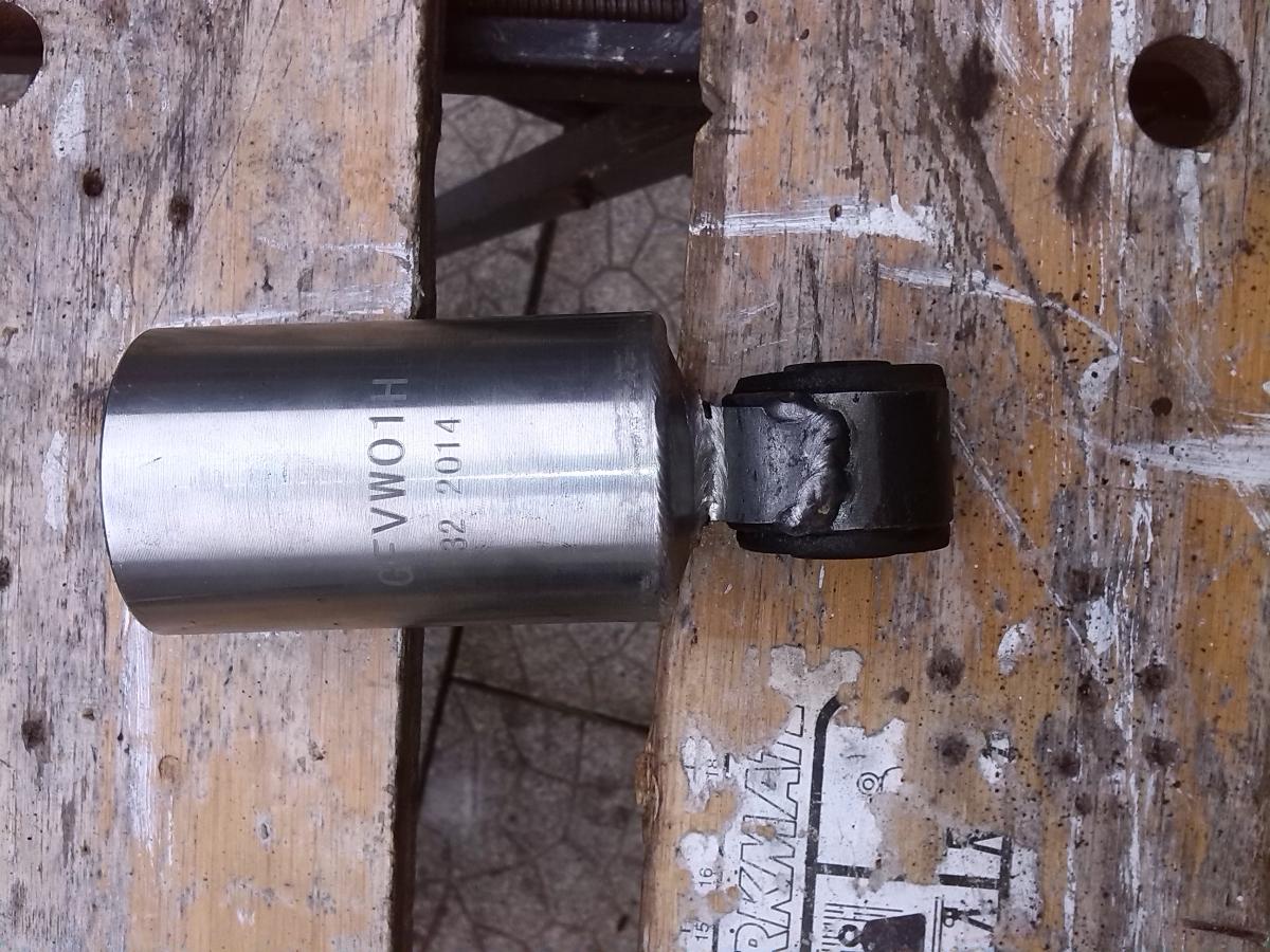

5e colin Posted August 11, 2015 Author Share Posted August 11, 2015 (edited) so got another set seeing we still didnt come to a ( propper solution ) for the rear bushes wel i found the best solution ever im also only using a 3mm cut of washer on the shaft seeing on the pic below for extra lowes and get as much rod travel as possible Edited August 11, 2015 by 5e colin Quote Link to post Share on other sites

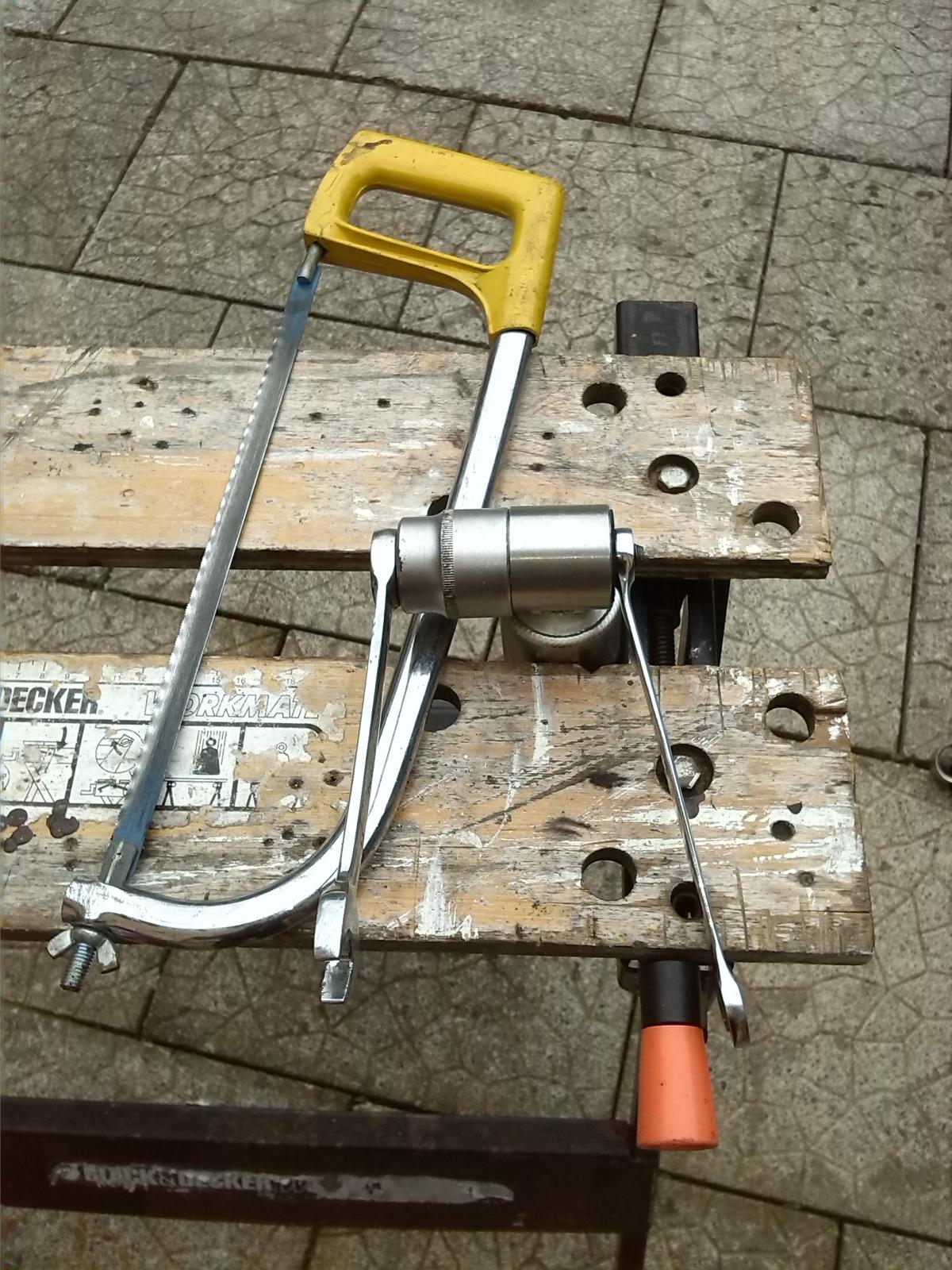

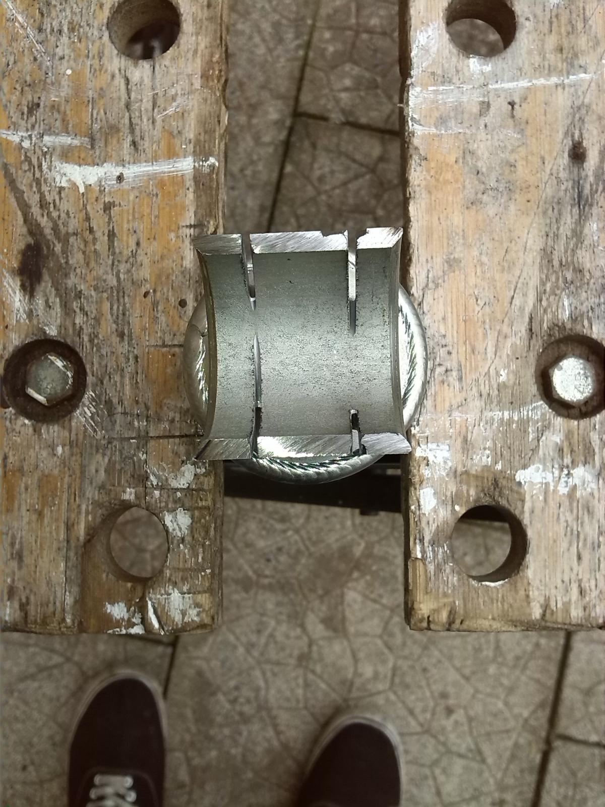

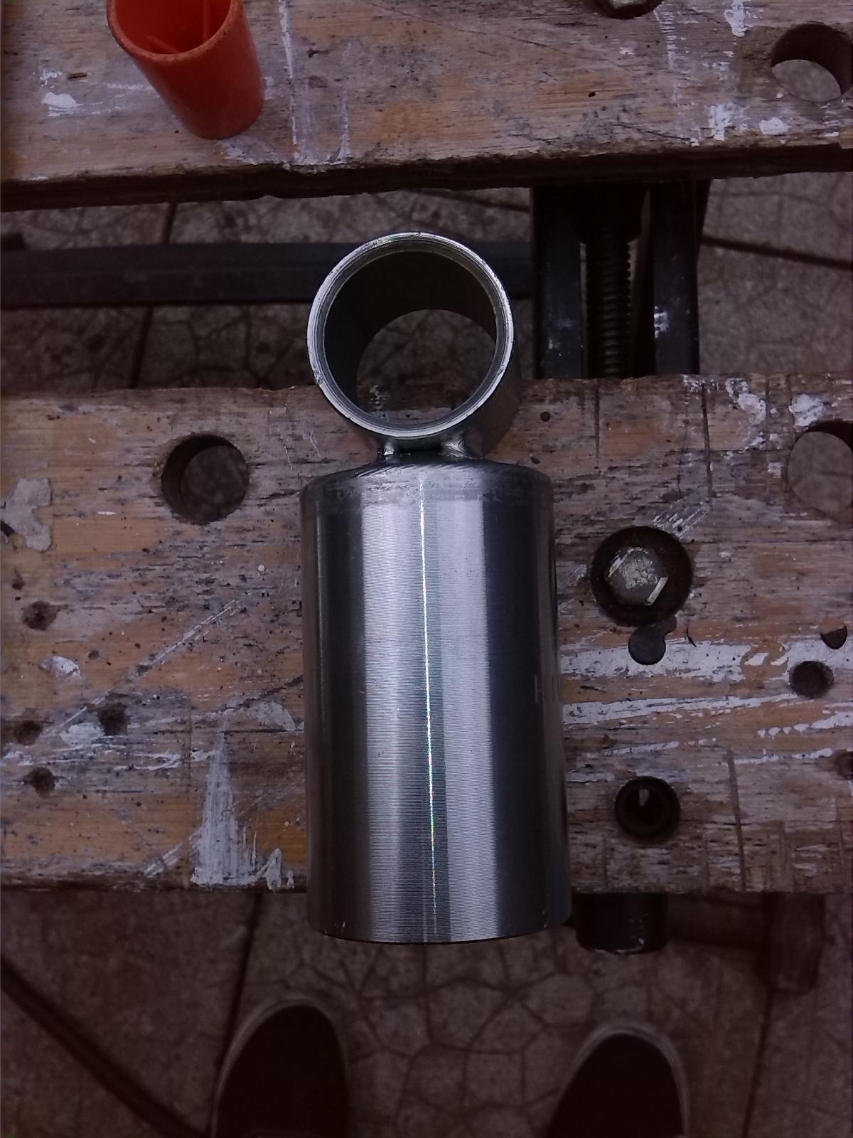

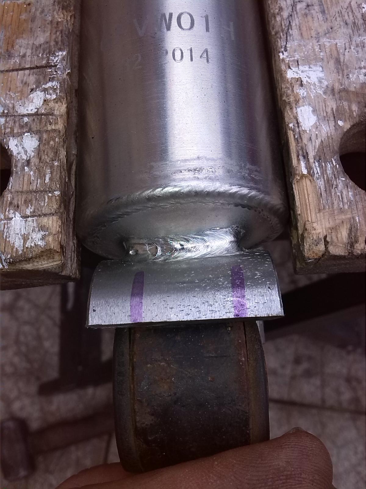

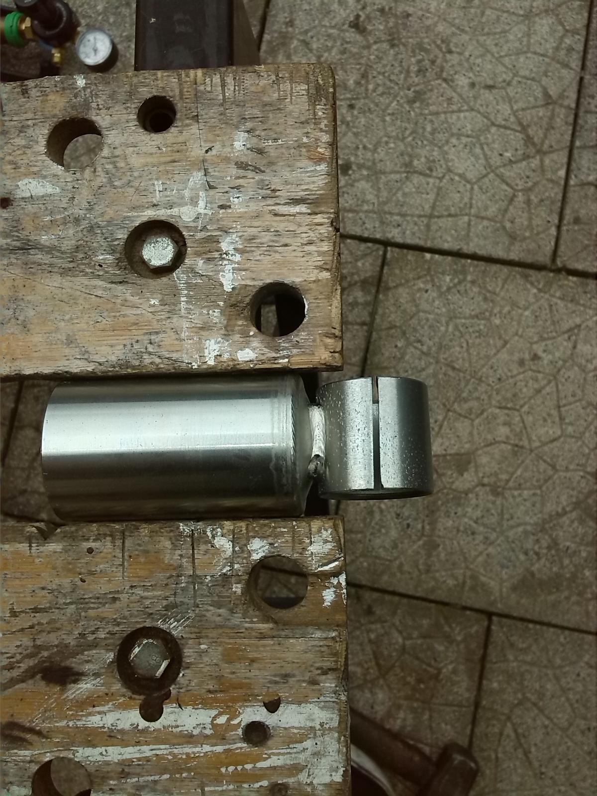

biggy_ep70 Posted August 21, 2015 Share Posted August 21, 2015 been reading this threadnice finding colini was wondering if you could explain the last pictures.......cuss i have no clue what ya didthanxs in advance Quote Link to post Share on other sites
rwdrev Posted August 21, 2015 Share Posted August 21, 2015 still alot of faffing for the bottom mount. just cut the tab and re-weld. easy to move again if ever needing to go back to standard or proper coilovers. Quote Link to post Share on other sites
5e colin Posted August 22, 2015 Author Share Posted August 22, 2015 rwdrev its a lot easier to weld on the bush to the bottom bit thats for sure 1s its welded on u can re use them on other , chopping of the bracket on the axel of the car could fail mot /nct biggyep70 i used long bolt with washer and big socket i pressed out the bush with that setup those pics are upside down bottom 1 should be ontop going down Quote Link to post Share on other sites

5e colin Posted September 22, 2015 Author Share Posted September 22, 2015 soooooo mmmmhhhhhh i updated my thread on toyotaownersclub.irl and got hammered because i welded on the bushes and dipped them in water for a few secs to kill the rubber burn they told me there not roads safe and are going to fail and locking my thread for the rubbish i put up etc etc ( tho there still perfect after 2,5 months of pot hole back roads ) if they where going to fail they would of done the first week of abuse so just for safty to anyone reading dont weld them on or do at own risk and check them often will have to come up with a nylon insert option or poly push in the next few months Quote Link to post Share on other sites
