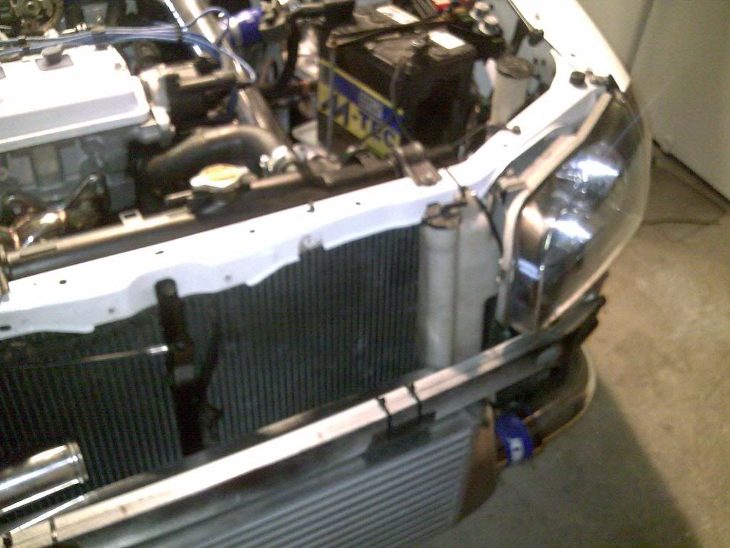

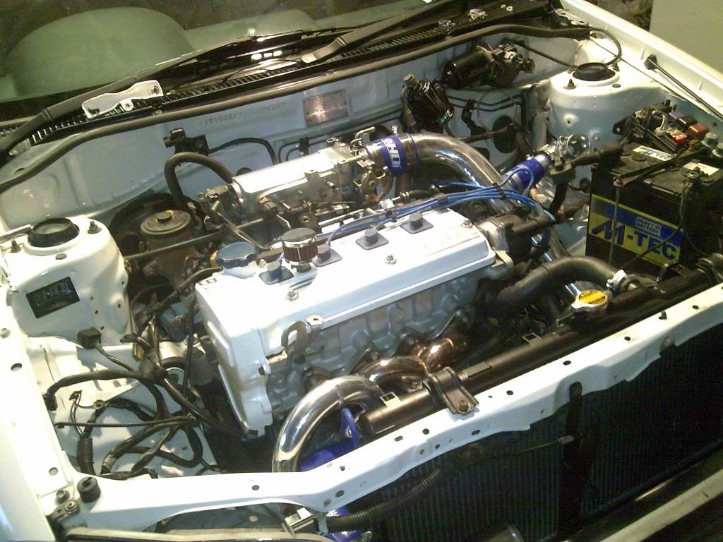

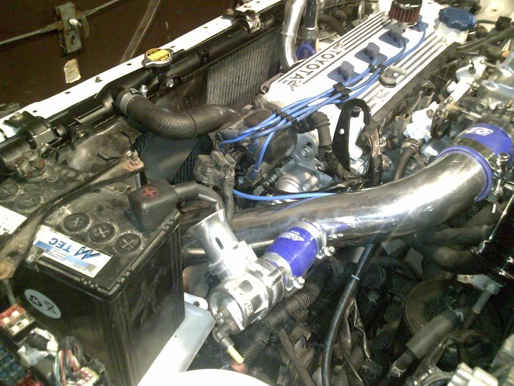

200sx-Starlet-Jay Posted May 4, 2009 Author Posted May 4, 2009 *ENGINE UPDATE*old work collegue mike from monster motorsport came accross today and gave us a hand at ticking loads off the long list!did following:Fitted Blitz decatFitted glanza radiatorFinal mock up of front bumperTouched up front bumperFitted dump valveFitted batteryMade engine water tight, ready for coolan on turn overRelocated header tank to next to headlightOrdered carbon for control panelOrdered 6mm ID vaccum hose for a few places on engineFabricated a bracket for throttle cableLooked into choosing a filterFitted centre section of exhaustModified the bonnet latch bracket to fit with FMICFitted bonnet latchheres a few pics of progress:almost at the point to tick engine over and get all air locks out the system ect, then its just wiring and DONE! altho done is still a mile off because the answer to wiring is also the same! Quote

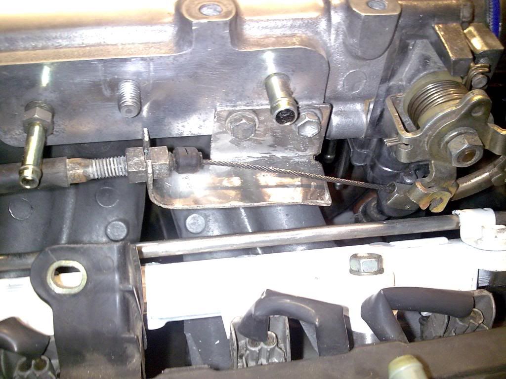

Dean @RW-Developments Posted May 6, 2009 Posted May 6, 2009 looks wikid mate! jw did you make the throttle cable bracket because there was slack i the pedal??? i have this problem.. Quote

200sx-Starlet-Jay Posted May 6, 2009 Author Posted May 6, 2009 looks wikid mate! jw did you make the throttle cable bracket because there was slack i the pedal??? i have this problem..yeah was slack as, Na one made it tighter, but was way to low, sat below the fuel rail then cable had to bend back up to the throttle body so wouldnt have worked. this one does jobs spot on, no play at all. and when pedal is down to the floor, the throttle body wont turn round anymore by hand under the engine bay. problem solved!@ idrees, i used a wired brush attatchment for a drill, then painted it in VHT silver paint using a half inch brush, looks alrite dunt it! Quote
