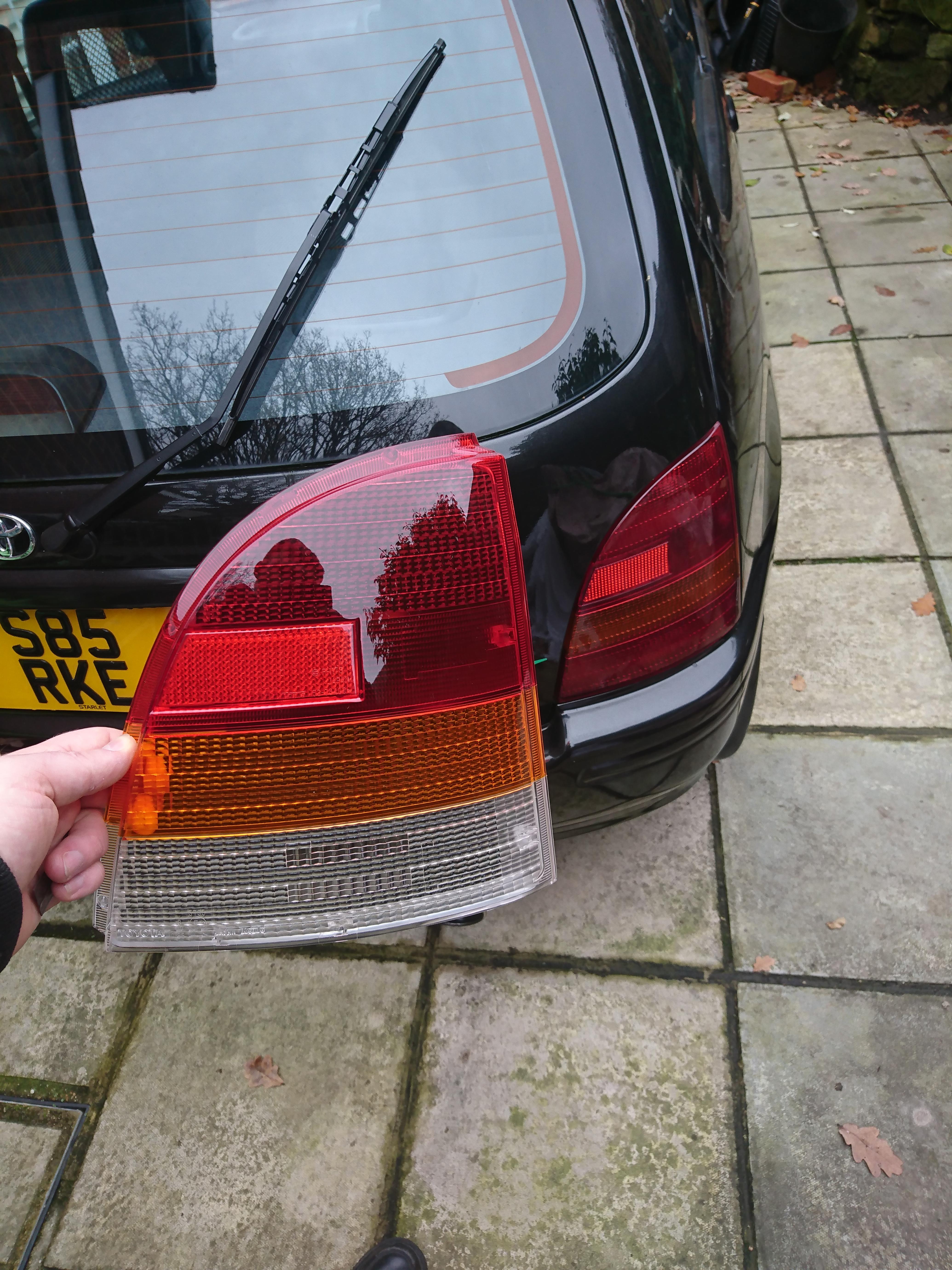

Or I could retrofit chrome tail lights, projector head lights, custom wide body kit, roof scoop, air ride suspension, neon lights, custom interior with a ps2 wired up to tvs in the side of the doors and a fluorescent pink or baby blue paint job if you prefer?? Maybe MAX POWER magazine will drop me a visit 🤣🤣🤣
that bronze did look well tbf suited the speedlines  but keep a set in silver ambers or clears ive had clears on since ive had car only just put the ambers on ,uk plates on a uk bumper for me everytime

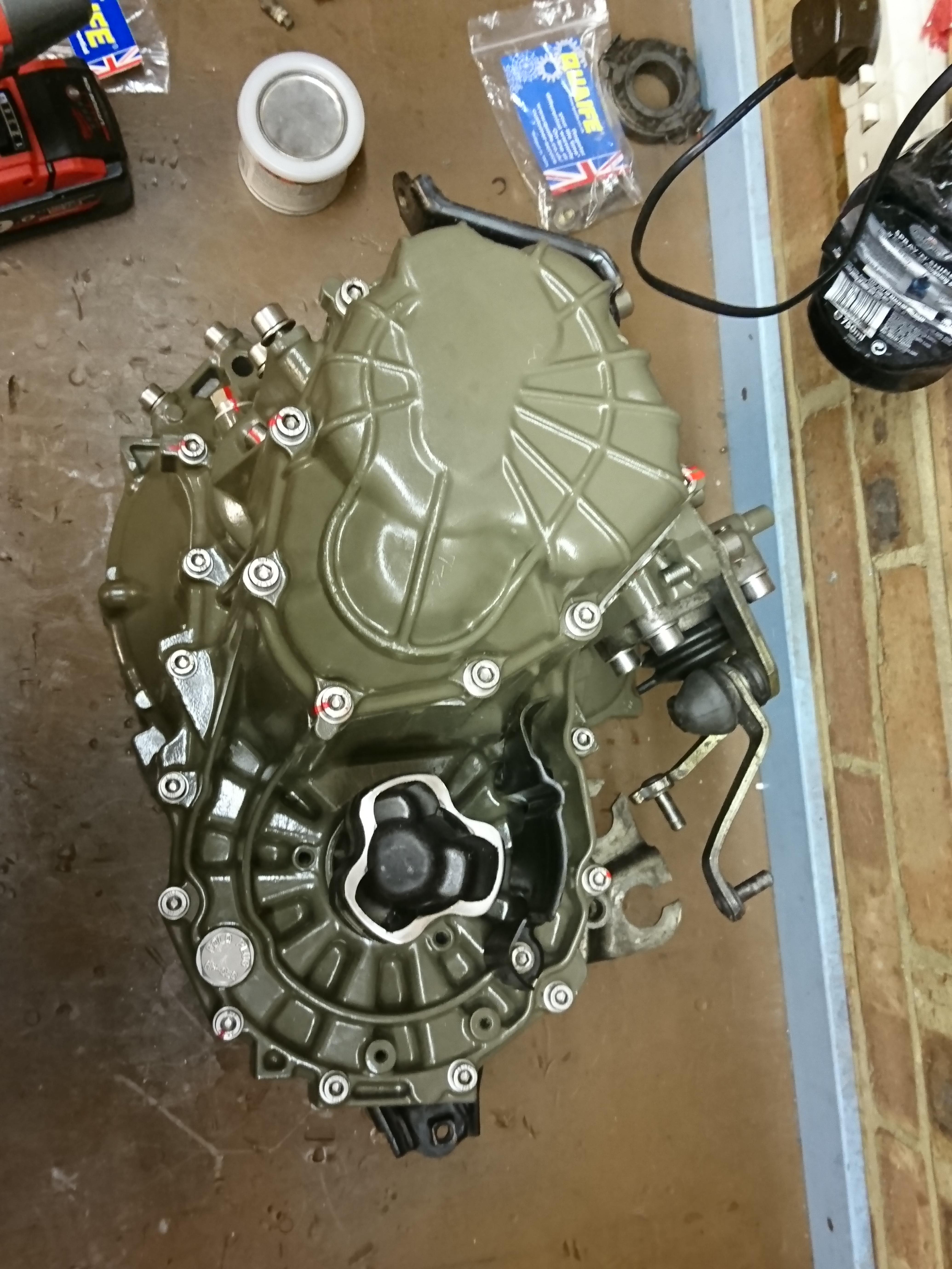

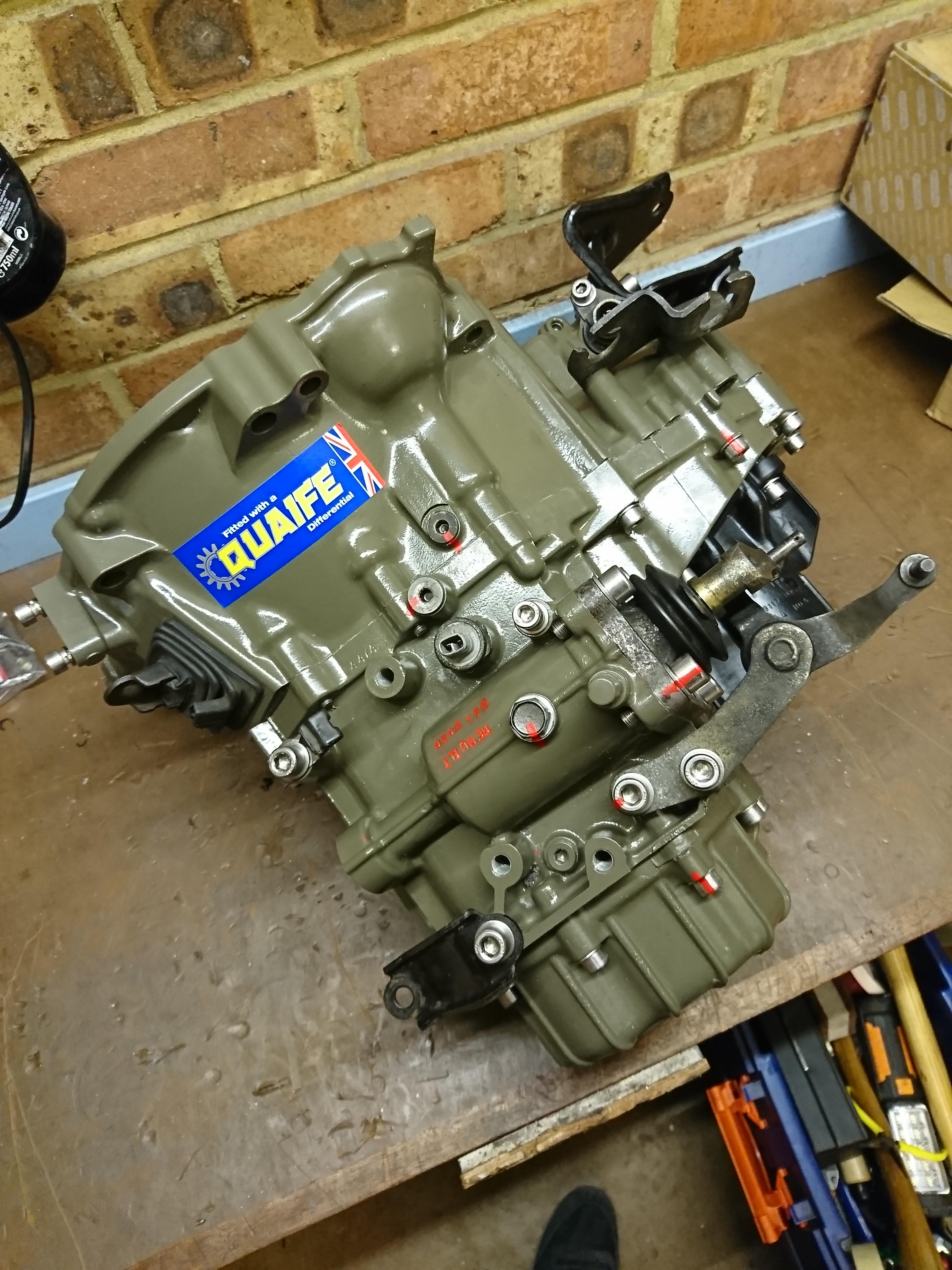

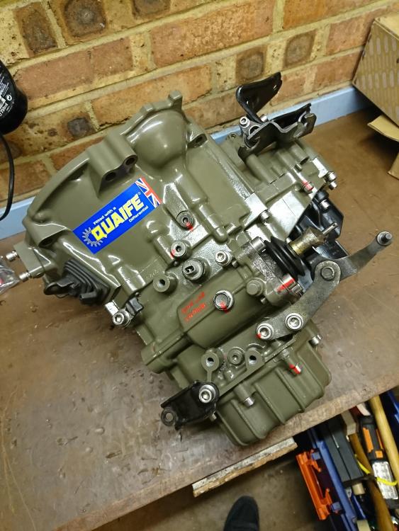

On a lighter note, I now officially declare that the gearbox rebuild is finished and complete!
DSC_0246.thumb.JPG.6d4d0c63e858d807741557ca205199f3.JPGDSC_0245.thumb.JPG.3104e5531c9edf6b81fde6acee4a5207.JPG
Quick recap, It has now been fully rebuilt with:
- All new bearings throughout     - New syncros
- Brand new 2nd gear    - Brand new 3rd gear selector ring
- All gears superfinished     - 4.312 final drive
- Quaife ATB LSD     - Diff shimmed to appropriate preload
- New seals & gaskets     - Casings 2 pack epoxy coated
- 98% of external bolts replaced with stainless steel fixings     - Stainless steel magnetic drain plug
Gearbox mounts will also be powder coated at some stage but I am in no rush at the moment

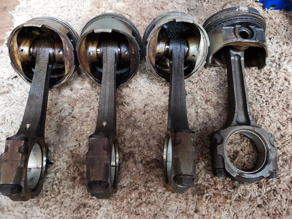

DSC_0242.thumb.JPG.540a0128fdf8af8971c8ca4d592812c8.JPGIMG_20201012_163445.thumb.jpg.73729a3890eac3d54e662f69d459c435.jpg.7b4673c31cc06d8e8684c0e40b004efb.jpg

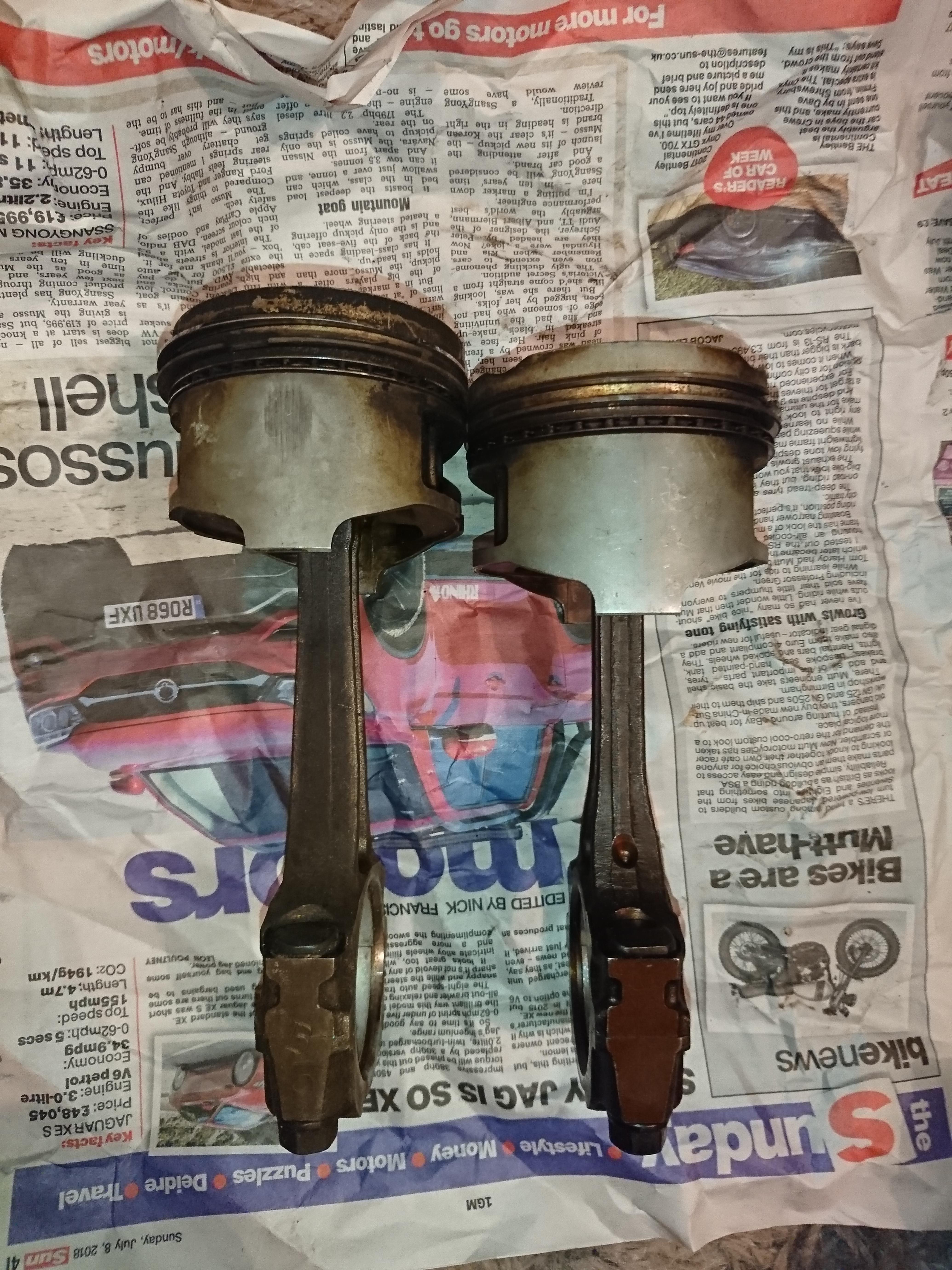

I find it odd that 5efhe rods are thicker than 4efte rods, would have thought the fte rods would be the same thickness or thicker 🤷🏼‍♂️
(5E-FHE left, GT Turbo 4E-FTE right)

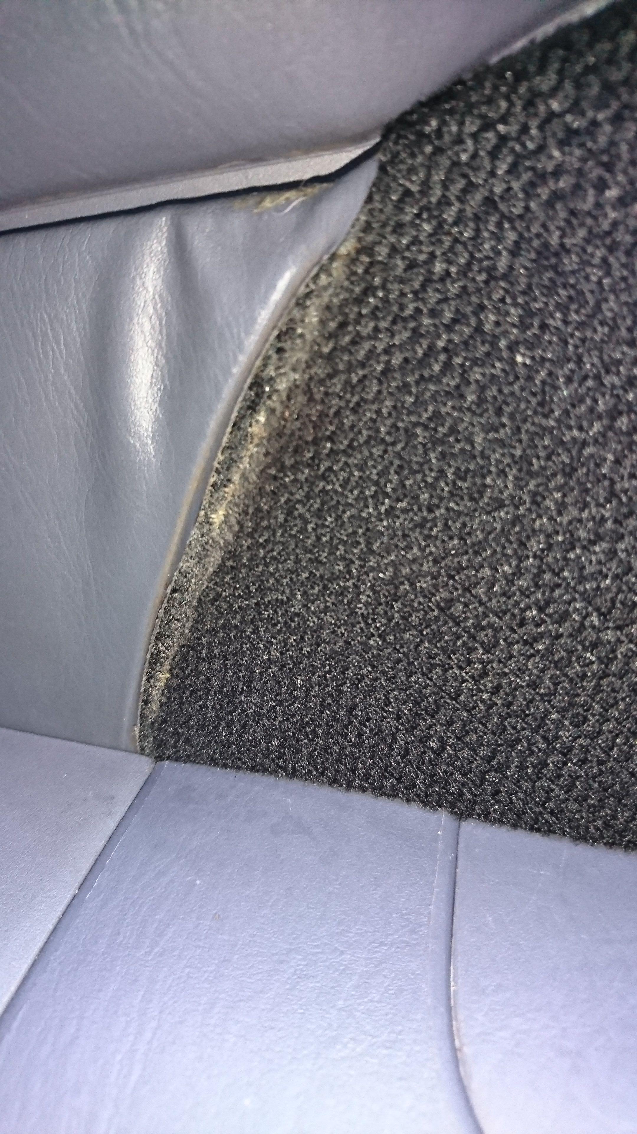

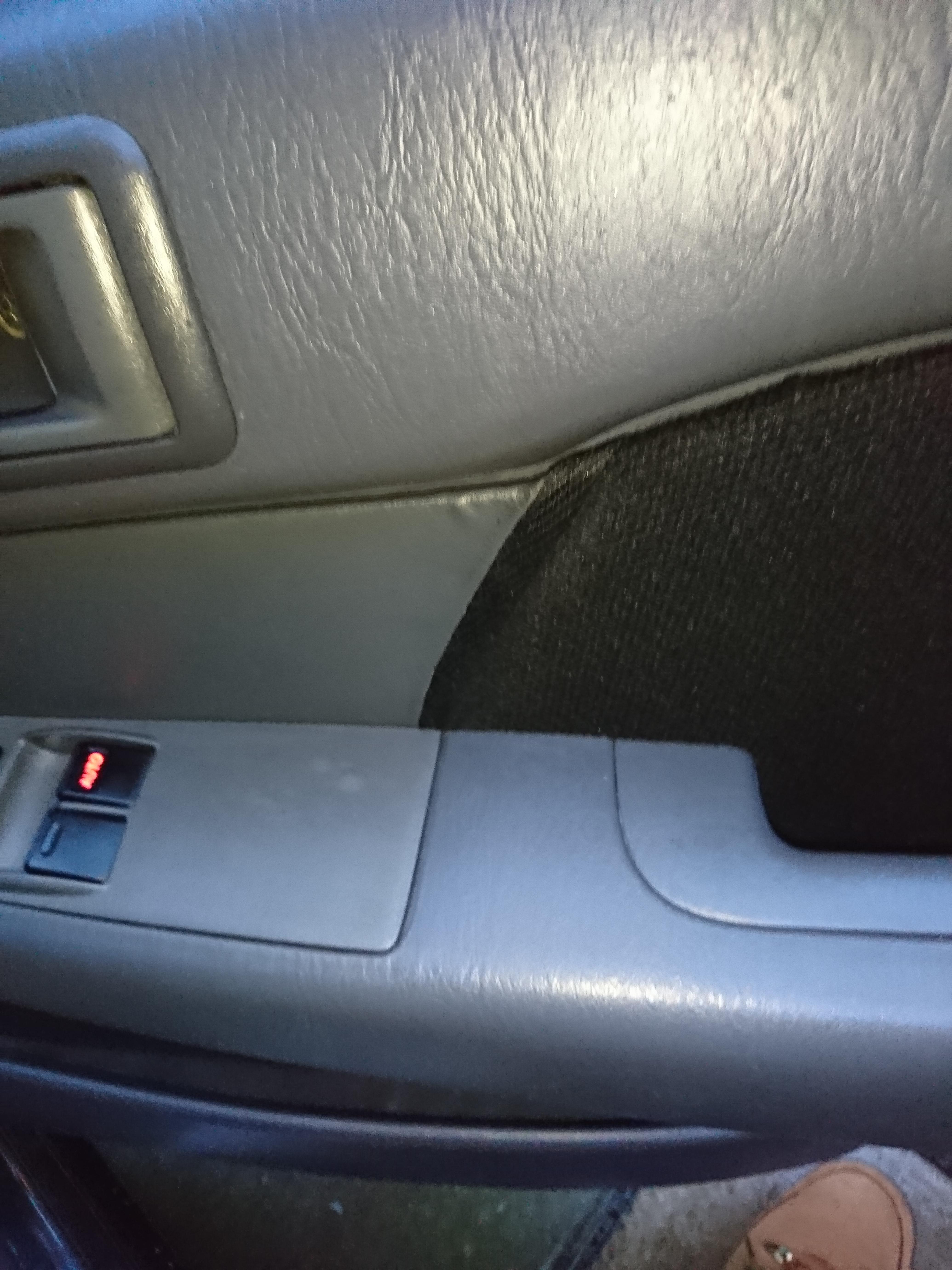

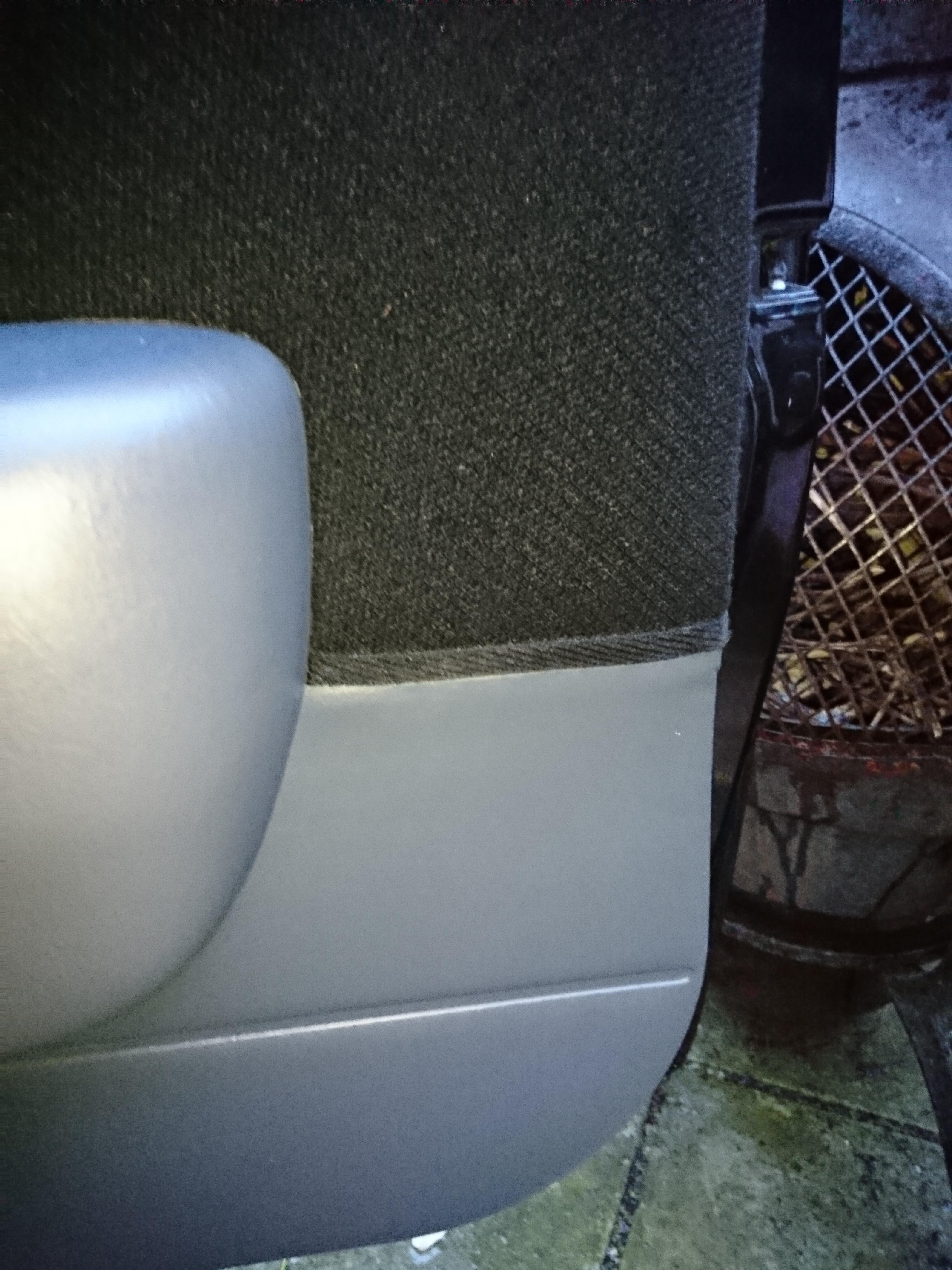

A while after Jase picked up the car to look after it for a time, it was noticed the door card vinyl had started to pull away from the material. As I didn't get the door cards with the Recaro seats I had to retrim the door cards in Recaro material (shits expensive!). It was clear that the glue I had used had degraded over time probably due to sitting in the hot sun (when we once had hot weather), and because it was just crap glue.
So I took the time to re-glue the door cards using a different type of glue, ened up using Loctite vinyl, fabric & plastic, which is pretty expensive for what you get in a tube (£13.99 for 30ml) but seems to adhere to the vinyl a hell of a lot of better. I put the glue inside a syringe (with a blunt needle...obviously), so that I could control the flow and apply it where I needed it, and used a big 6mm aluminum rod bent to the contour of the lining and clamped down over the top as it dried. If any of you happen to use Loctite vinyl, fabric & plastic glue on your door cards, the vinyl will wrinkle temporarily, so don't worry, just use ice lolly sticks and clothes pegs, or any other clamp of your choosing, to pin it down flat to be sure.
I also added a sort of piping to the edges where the vinyl meets the material as a way to sandwich the vinyl to hold it better just in case the glue turns to shit later on down the line 🤞🏻😬 Plus to be honest, I actually think it looks really good anyway!
DSC_0022.thumb.JPG.8efe2a729b5c00387cbcb04ab0187903.JPGDSC_0021.thumb.JPG.da48151928d73022033075e92fd47751.JPG

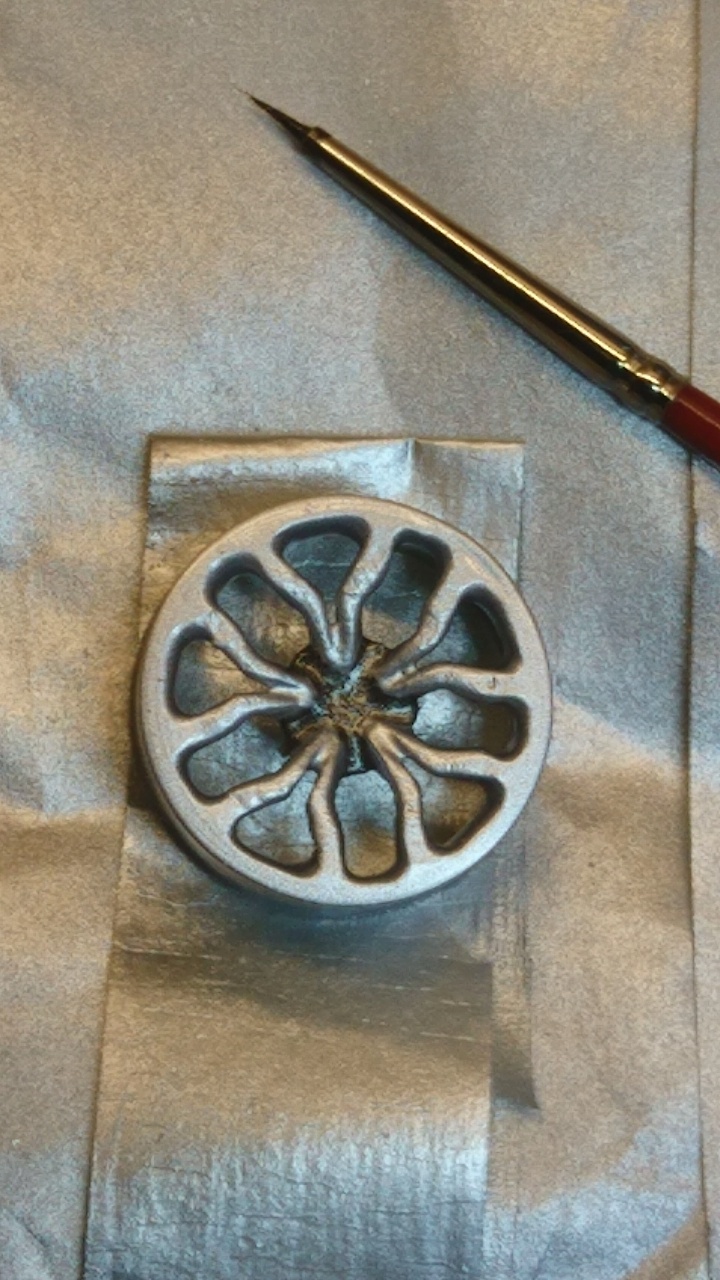

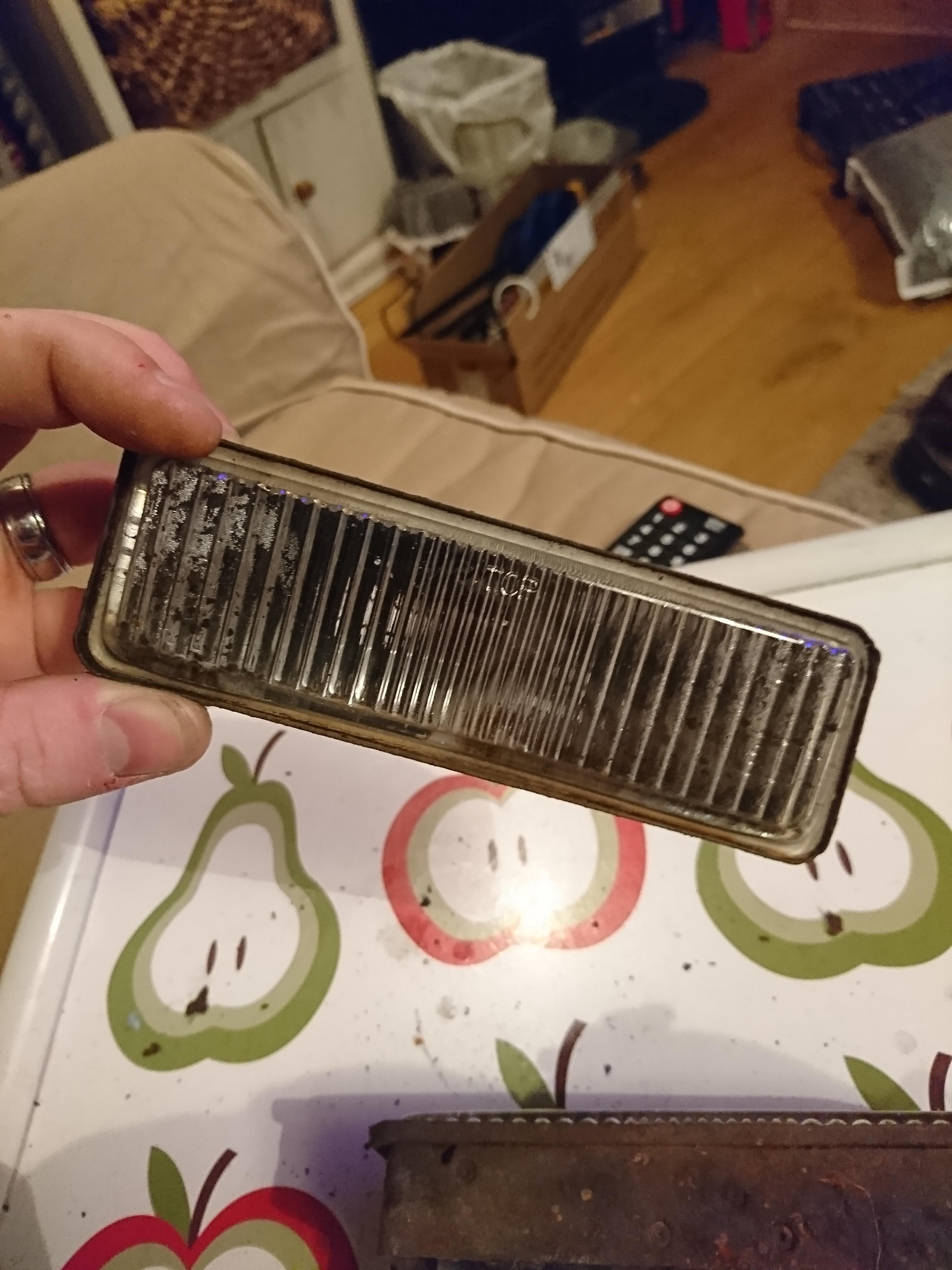

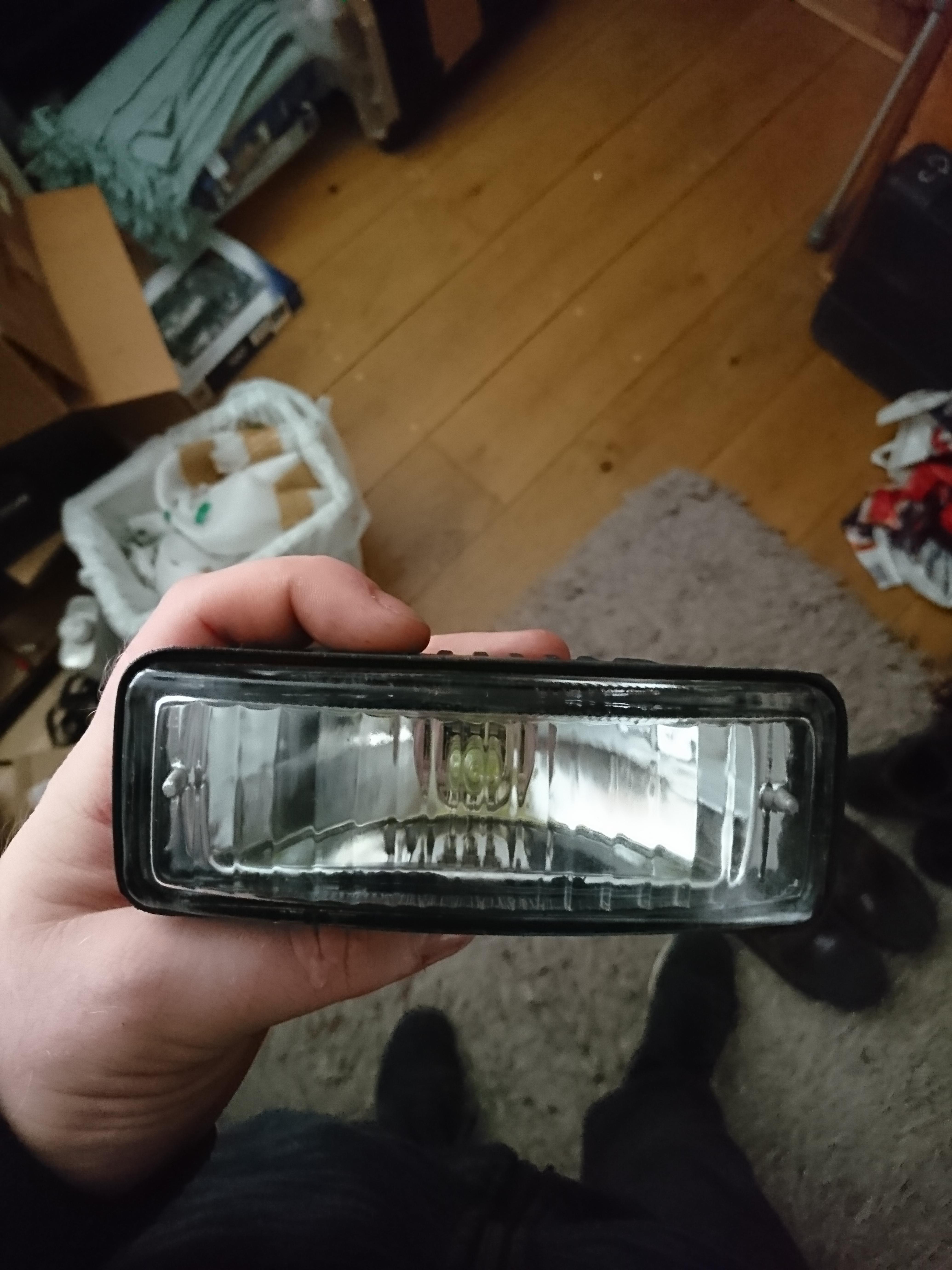

The old fog lights have seen better days, one even has a hole in it and sounds like a babies rattle when you shake it!
DSC_0072.thumb.JPG.db67858c8ebdd21a827a8805a7ed531b.JPGDSC_0071.thumb.JPG.fb662b24d435f8d42080f2b98a05655e.JPG
I had actually been looking a long time for a pair of fog lamps that meet the measurements required to fit, and recently I found these for a semi-decent price, unfortunately they had to come from the USA, but this is what I found
Personally I think these will suit the crystal headlights well, and I also got some yellow tinted bulbs for them.
On closer inspection though, I could tell these were poorly designed and poorly put together, the wires were being squashed at the back of the housing and the seal around the glass was not sealed properly, so I popped the glass off and resealed it with silicone and went ahead and tested them anyway to see what happens, but as per usual things are not that straight forward (such is my life).
To cut it sort, literally within less than 20 minutes one of the bulbs burnt itself and the yellow tinting (turned out to be knock off osram bulbs). As for the fog lights themselves, on both the plastic housings started to melt a hole where the housing is in such close proximity to the rear of the bulb, the edge of one of the housings started to deform due to the heat, the 'chrome' coating inside the lamp itself appears to be some sort of chrome paint and has bubbled & lifted off due to the heat, and there was a build up of condensation inside.
So clearly this is a bit of a wash, problem is I just don't know when to quit
As these are the closest I have ever found to the measurements required to fit, I am now having some NEW housings 3D printed from ABS plastic for better heat tolerance. These will be made to my specifications to allow for more room inside the housing so there is room for the wires to not be squished and so the rear of the bulb isn't as close to the rear of the housing.
I also popped the glass lense off on the actual lamp again, cut in a small slot at the bottom of the lamp itself to act as a drain/vent, and I have taken these to be nickle plated so that it is reflective but with better corrosion resistance. Pictures to follow once I get the bits back.

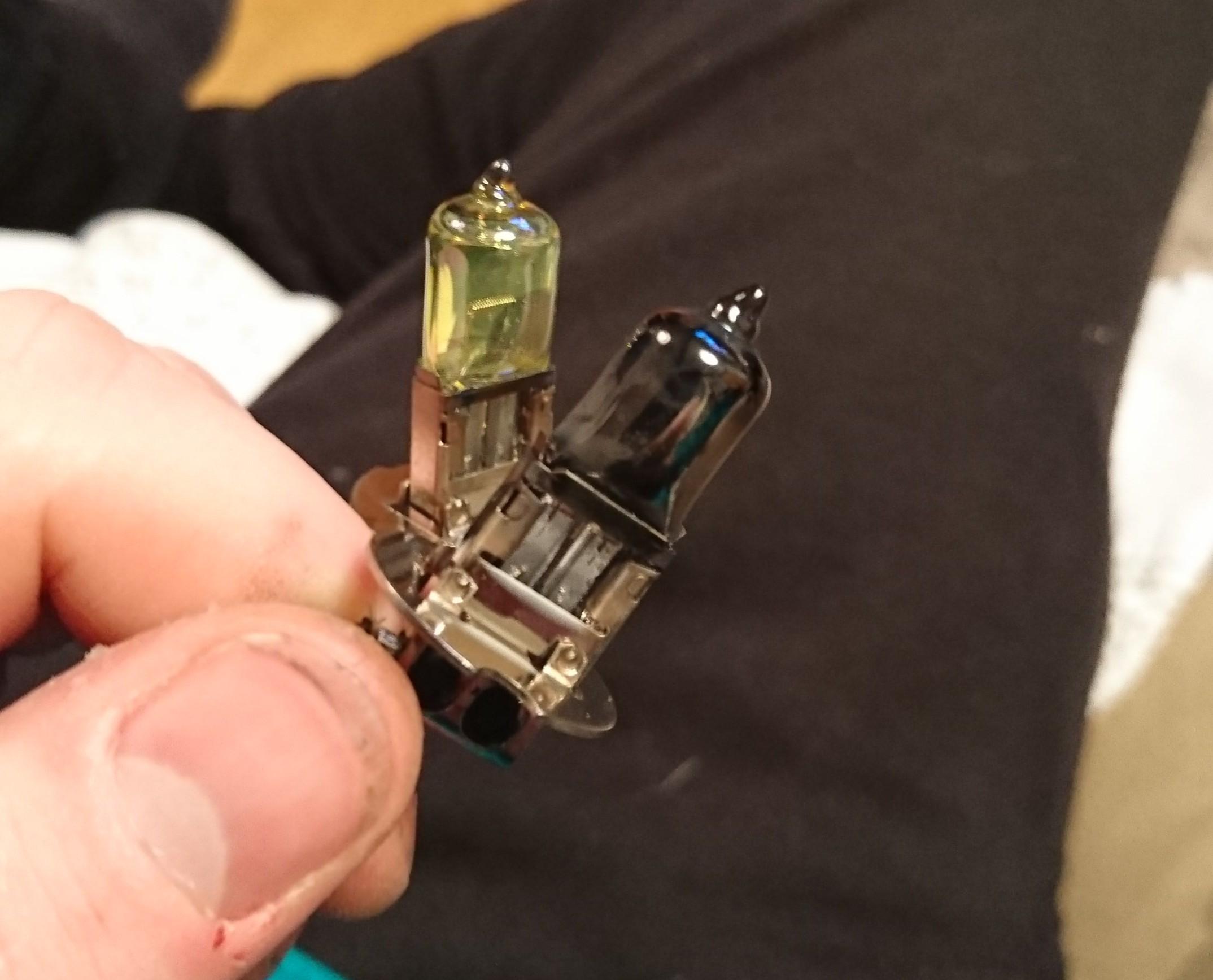

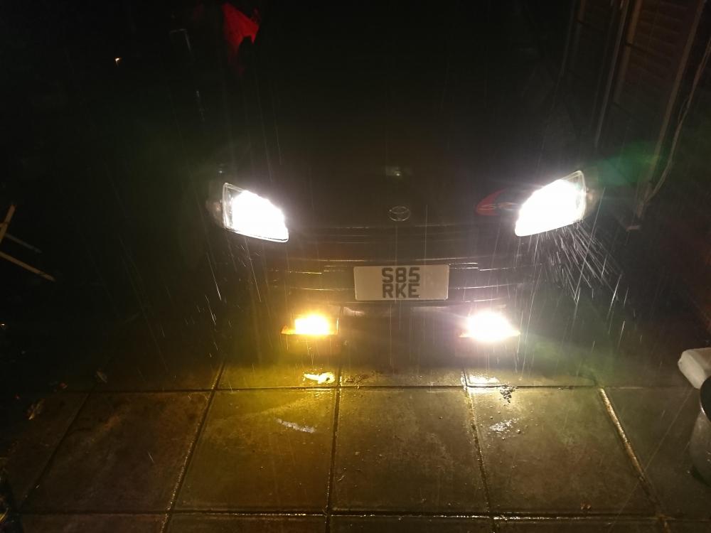

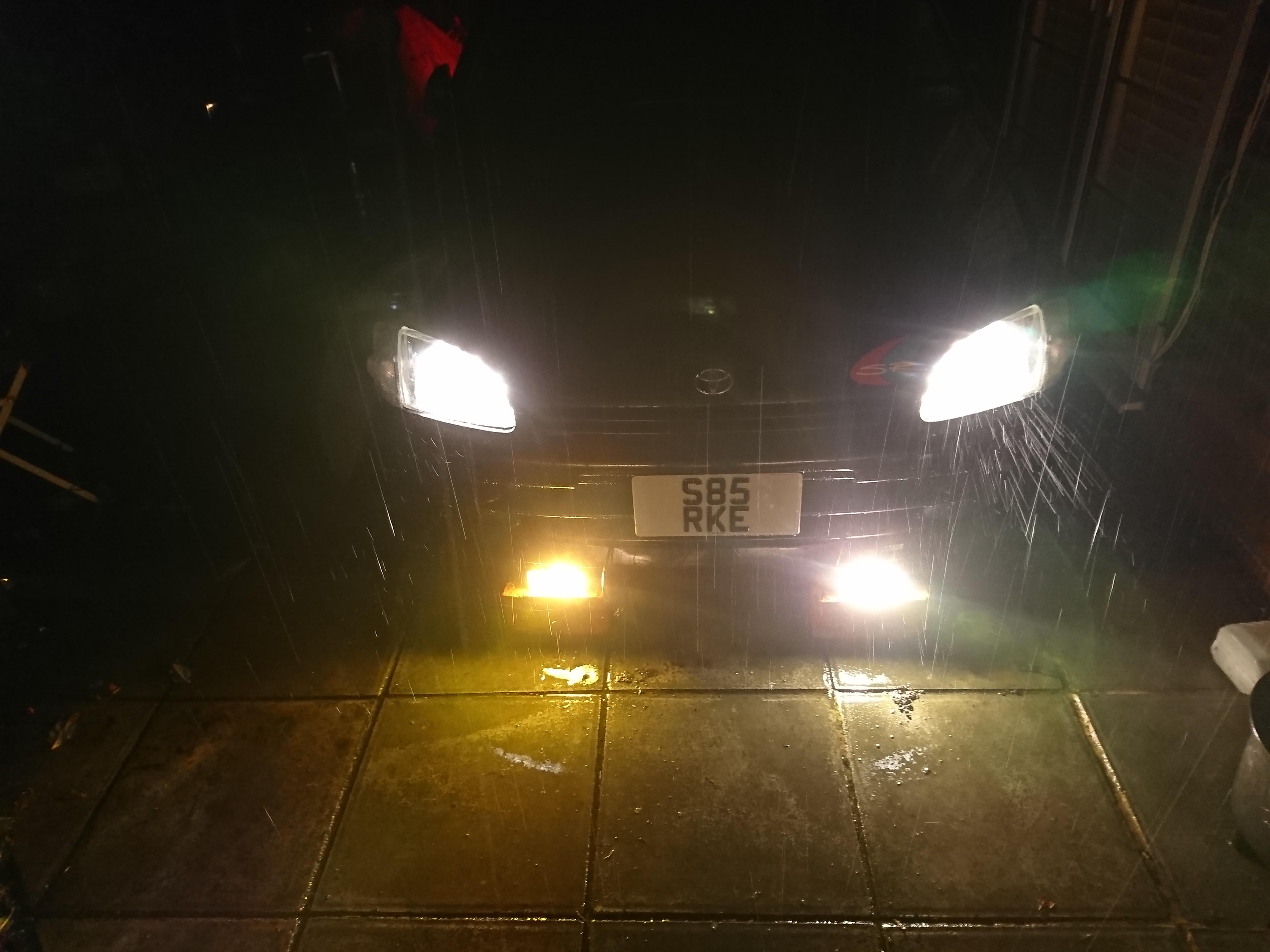

The night before I took the lamps to be nickle plated though, I got myself 2 new sets of bulbs (one yellow tint, one standard) to test out. They both lasted over an hours run time with no problem so I will be using one of these when they're fully on the car
I like the yellow fogs over the standard bulbs as I feel they make viability a bit easier on the eye in harsh conditions, particularly fog, and there are some areas around the west/east sussex border that I drive that is pretty susceptible to fog and dears, so I'd like to be able to see them!

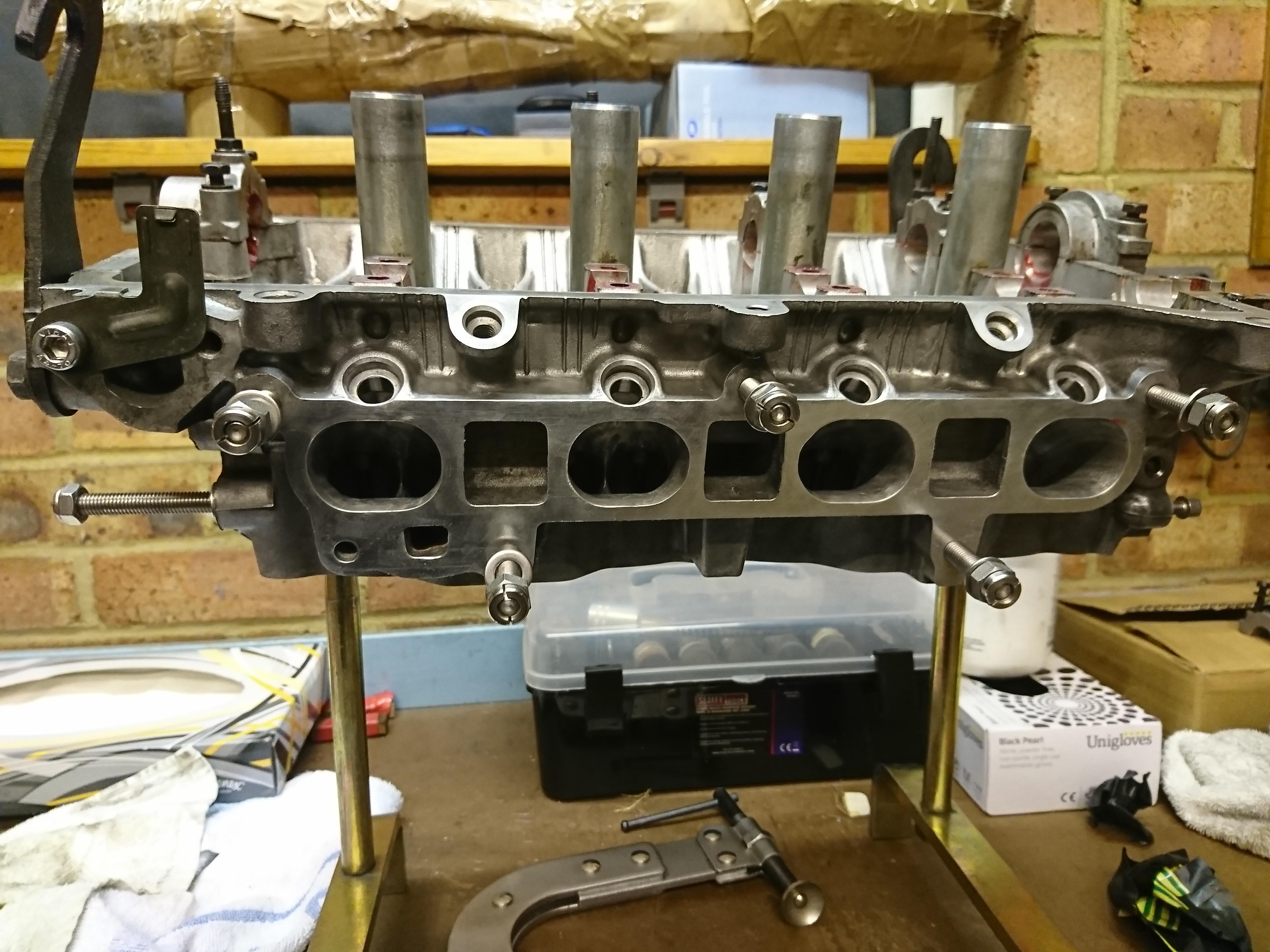

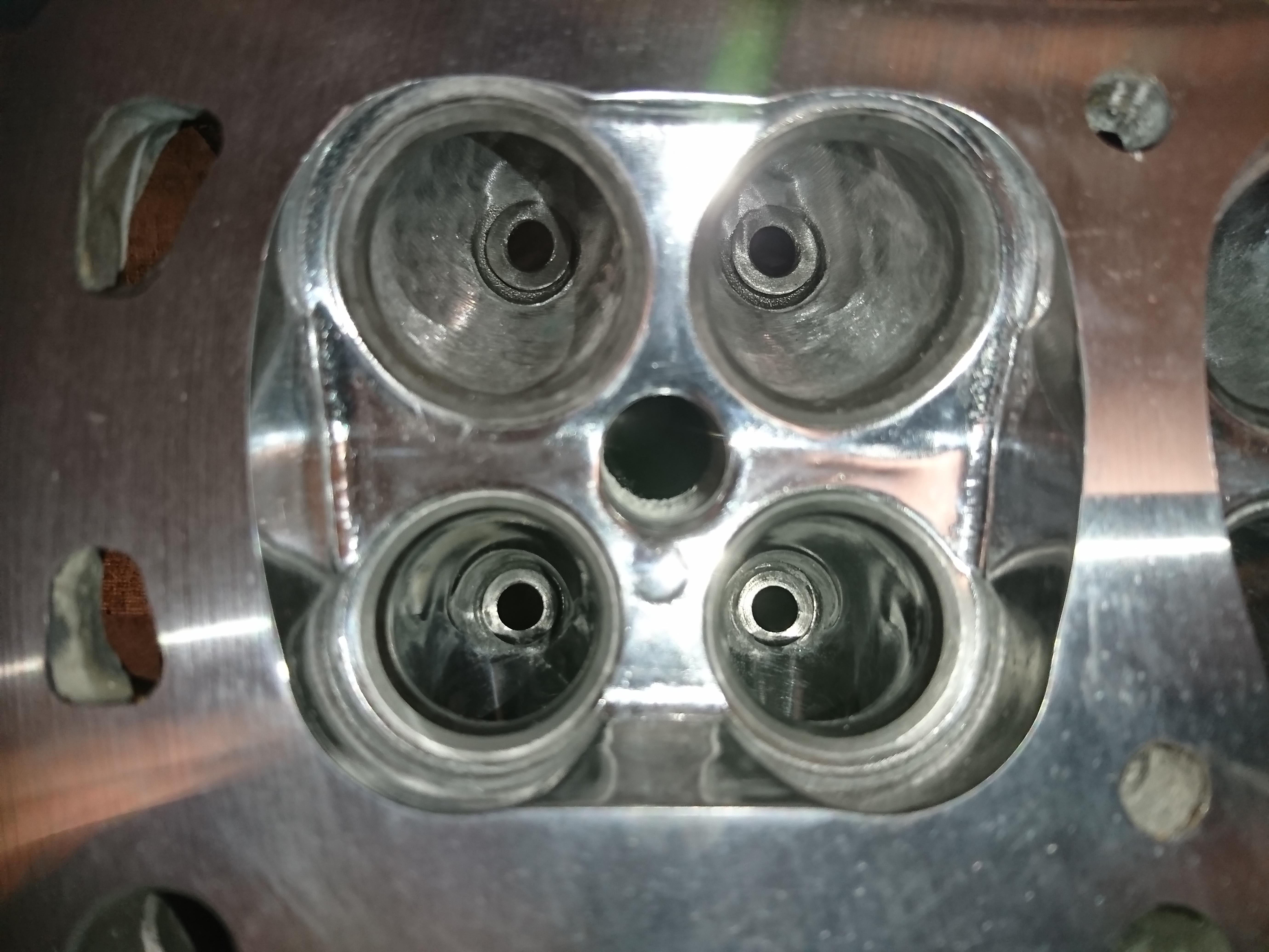

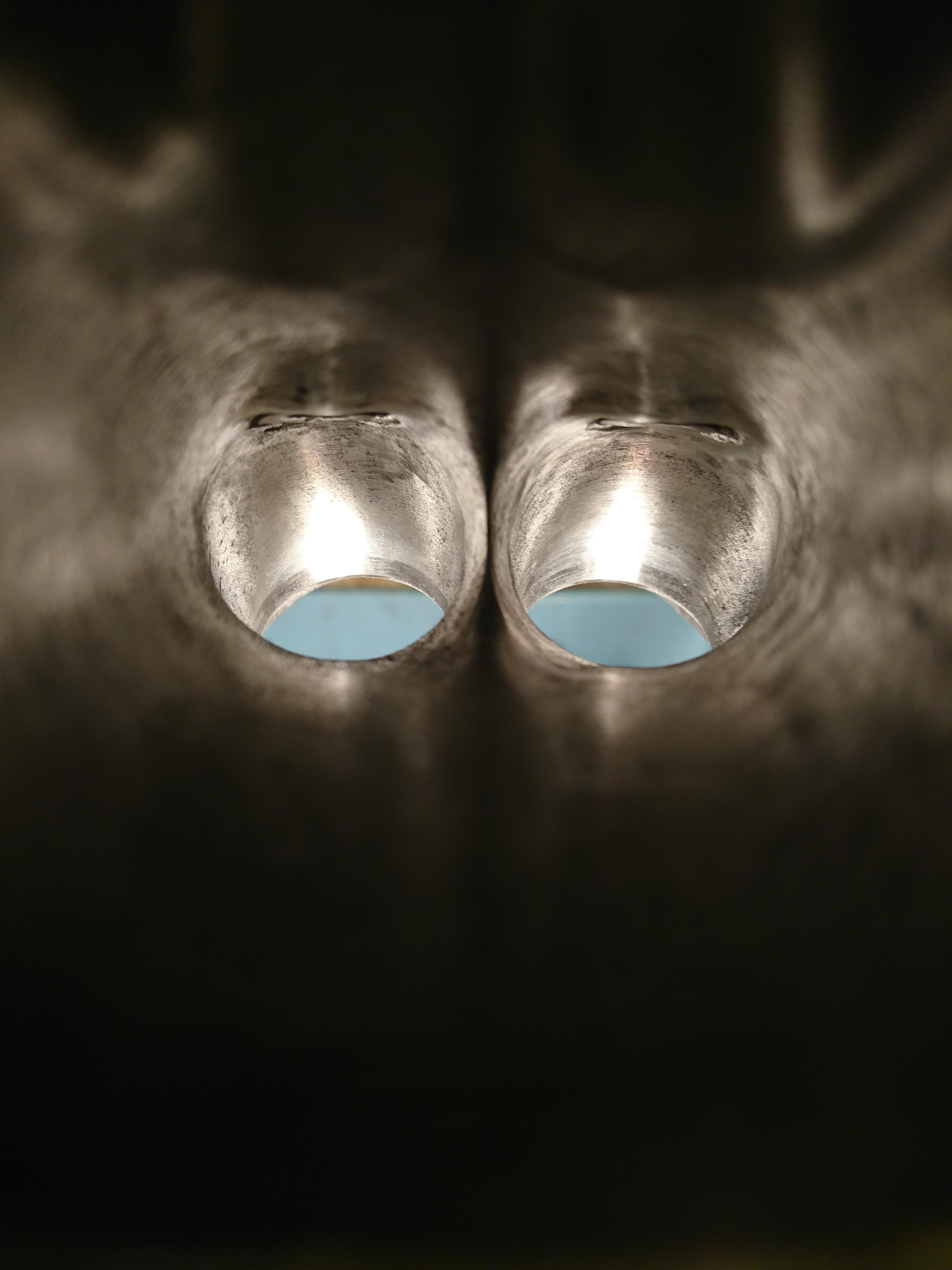

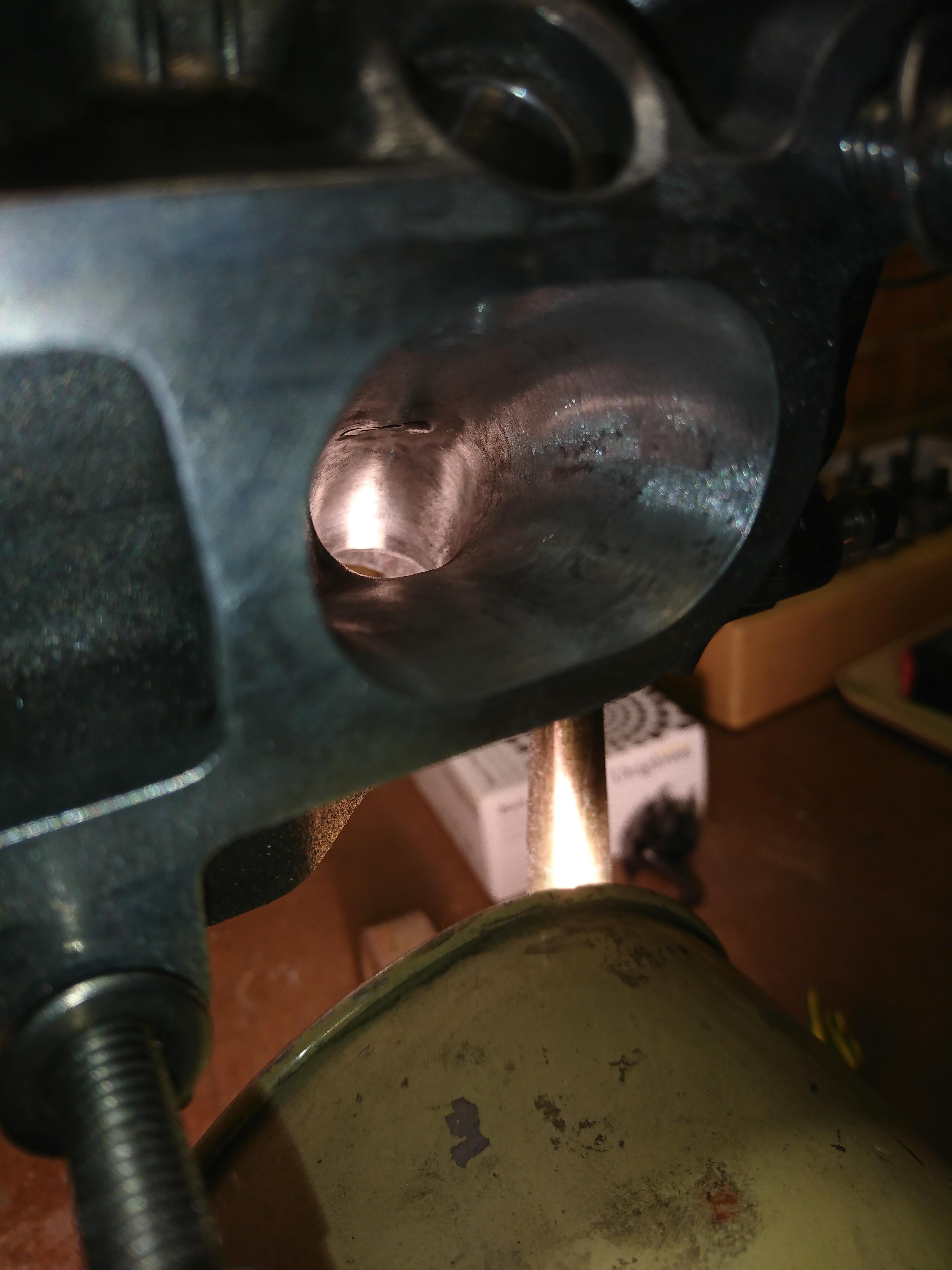

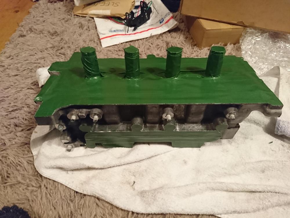

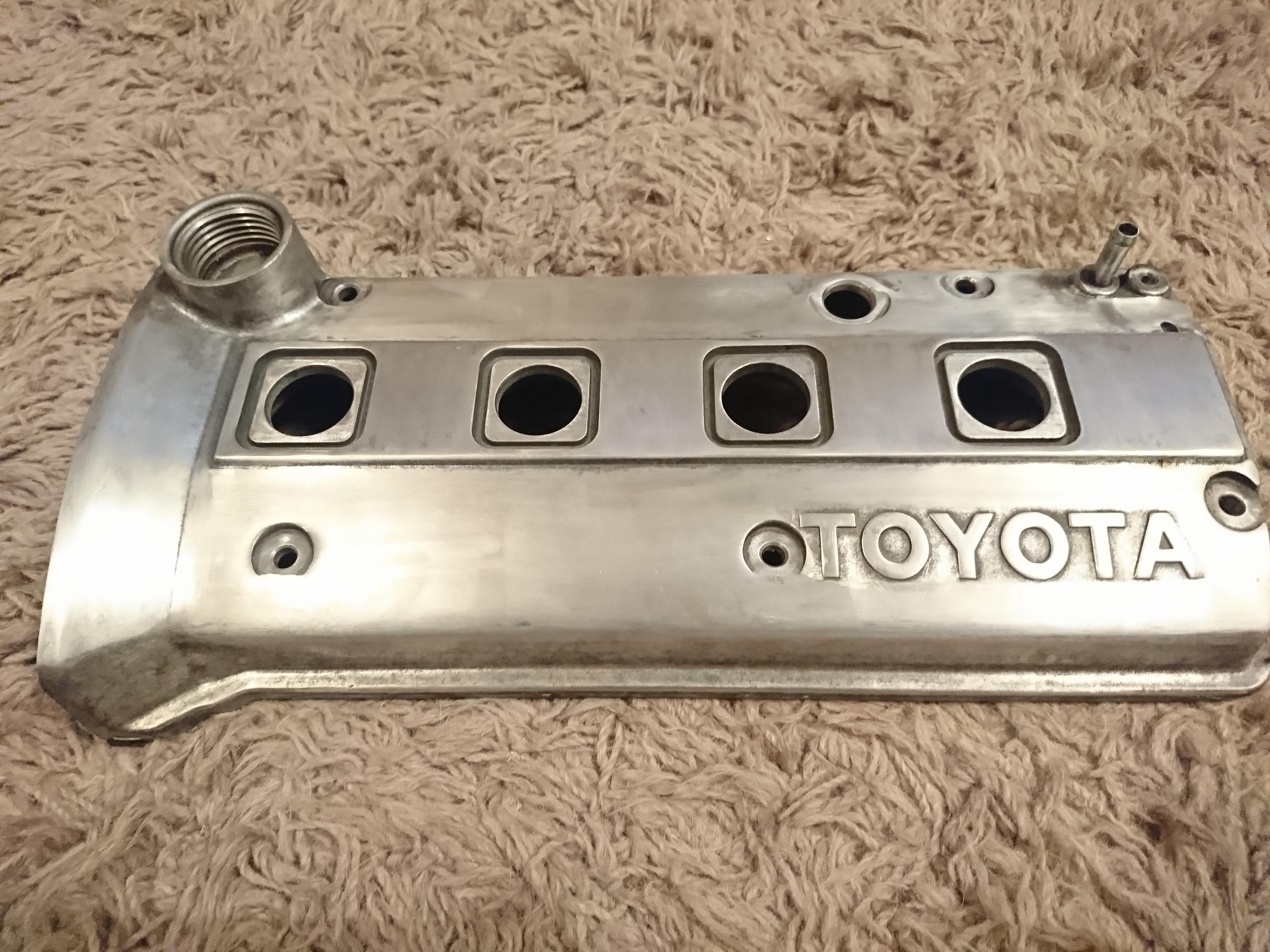

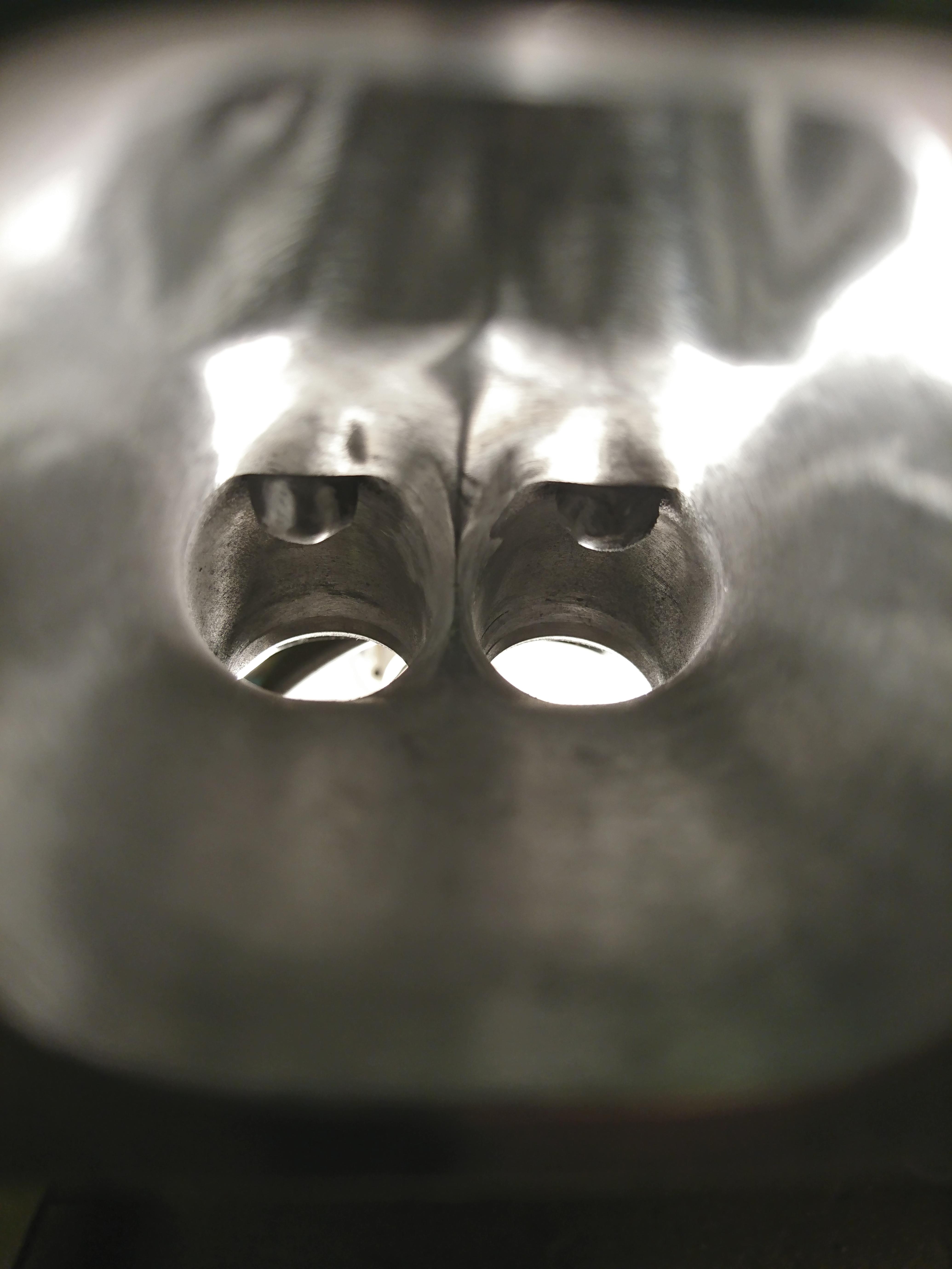

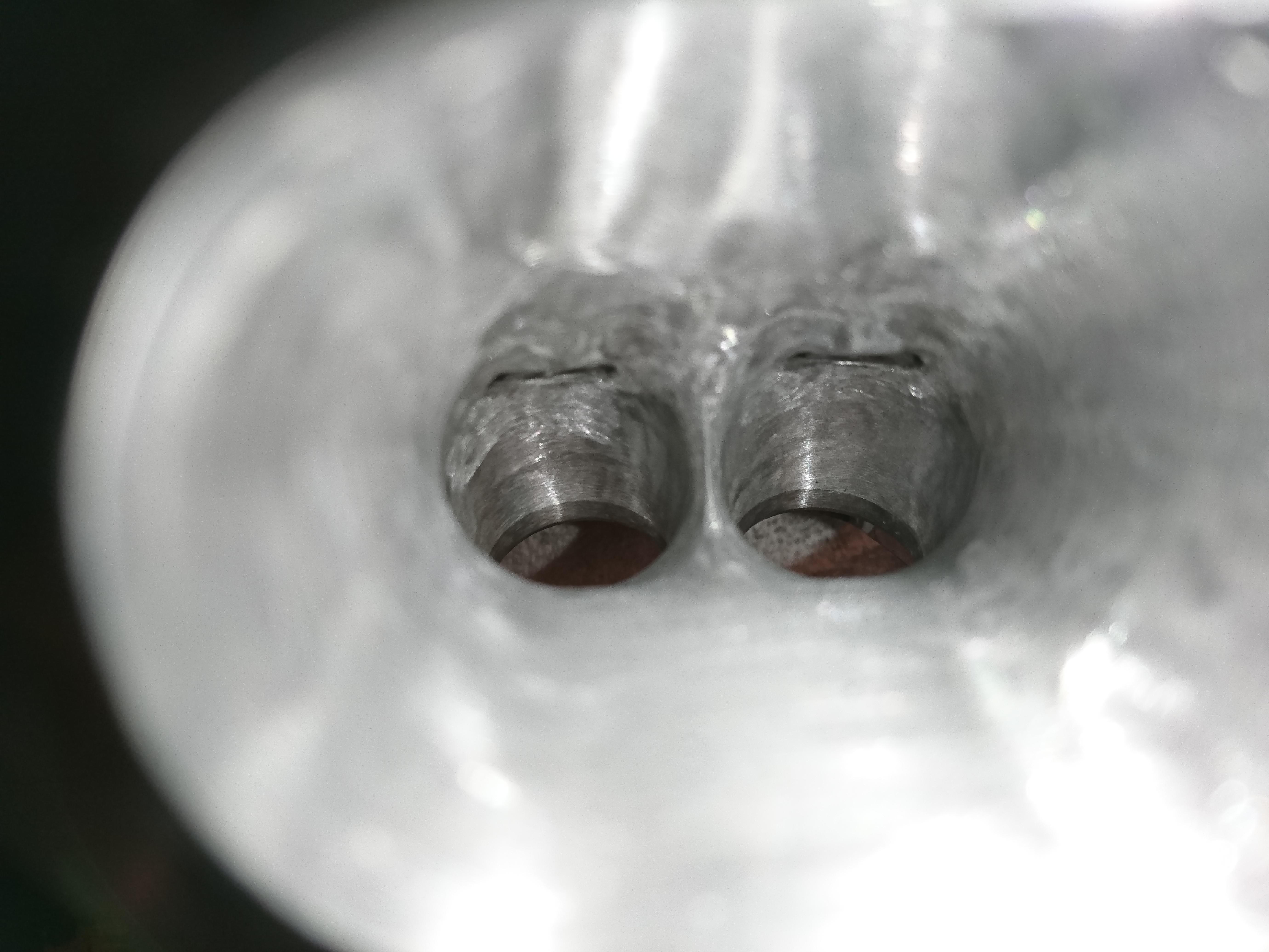

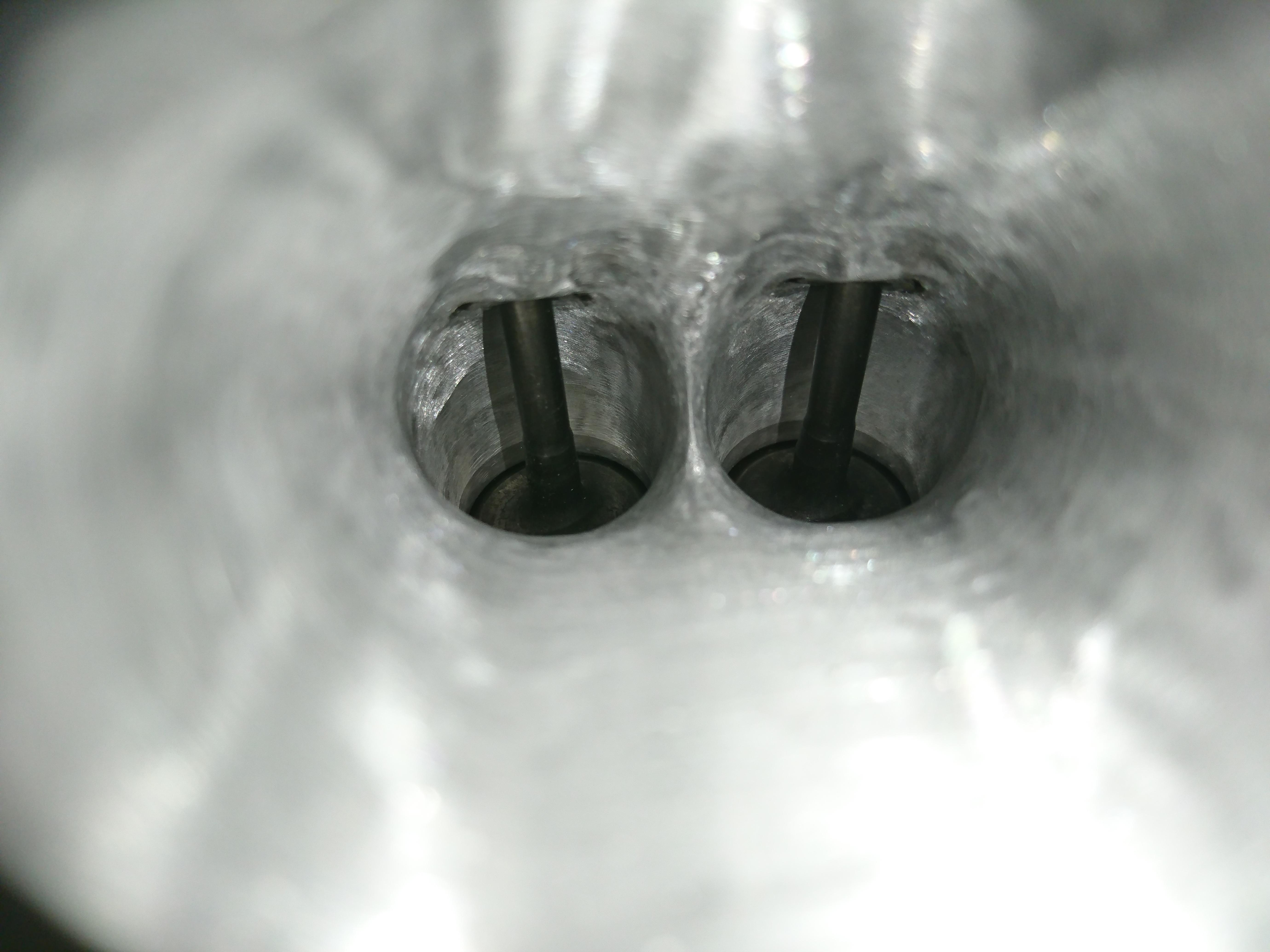

As promised, next on the agenda was to revisited my cylinder head. While I was doing the porting, I didn't give any thought to the valve guides on the inlet side which protrude into the runners, obstructing the flow (exhaust side guides are recessed) so I decided to grind them down as I should have done the first time.
Before:
After:
I also re-finished the inlet side to a 80 grit so it's slightly rougher than whatever grit I finished it with before, as advised by LC Porting (check out his work on Instagram)
DSC_0103.thumb.JPG.83a336e9ecdbd615d5303f180529fcc8.JPGDSC_0105.thumb.JPG.057076e32fb05e96685bd69ffe38acc4.JPGDSC_0104.thumb.JPG.cd479f1f7561b8bc4e1c68d93c445304.JPG
With the valves in place, a fair bit less obstruction:
Compared to other people's work I've seen across the net I guess this would be considered a 'stage 2' port job as I haven't reshaped the runners or made the runners considerably larger, but I have removed all the casting marks, smoothed out and uniformed the runners with an 80 grit finish, 'knife edged' the split section, and flushed the valve guides. Once I come to assemble the engine I shall gasket match the entrance of the ports and the manifolds if needs be for a smoother, uninterrupted flow.

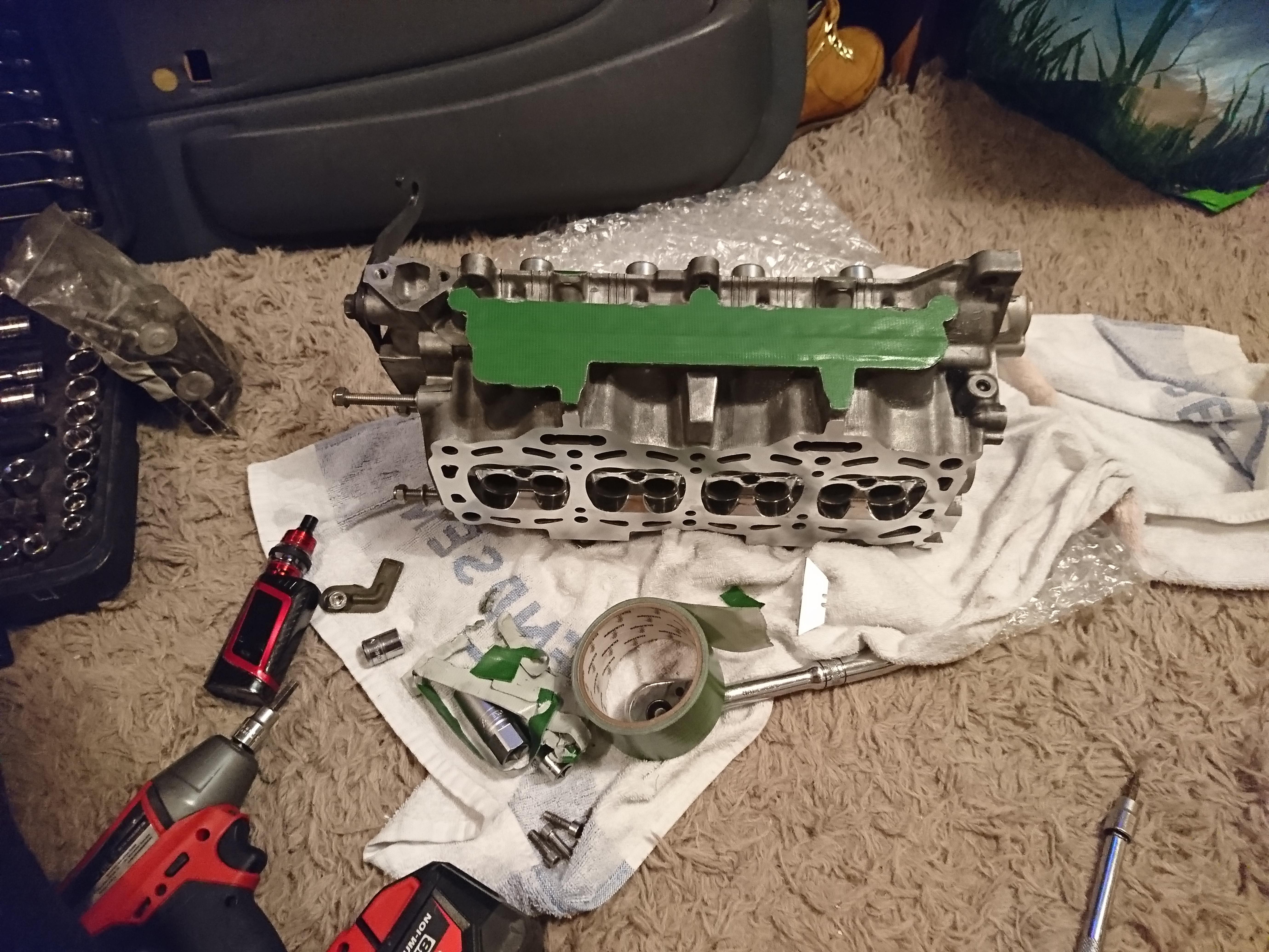

Next I'm just masking up the entire cylinder head, valve cover and a few other bits ready to go for powder coating/2k epoxy
DSC_0131.thumb.JPG.e67b3ff310853e01881dd95f6594a7b5.JPGDSC_0108.thumb.JPG.45629d3cdb9bfb2c38dc25db4f69292e.JPG

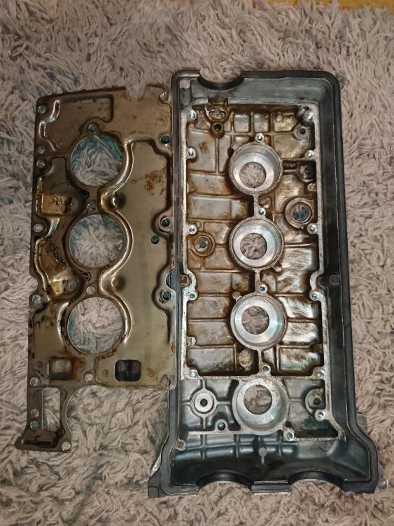

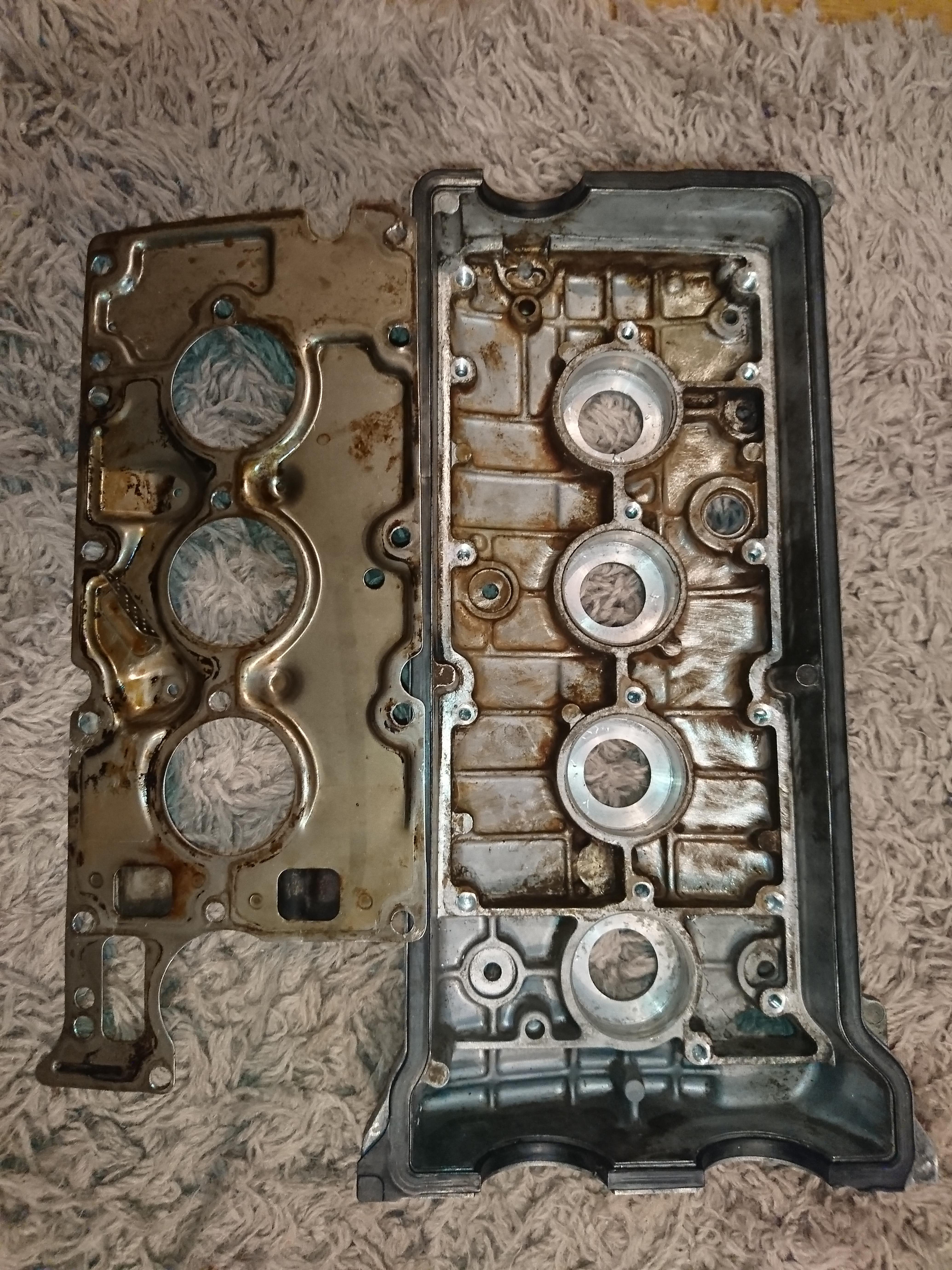

Drilled out and removed the baffle from the cam cover so shit don't get all clogged up in there and stop any grit working it's way around the engine
I am also going to be ordering some bits from the land of Japan tonight, so stay tuned 😉

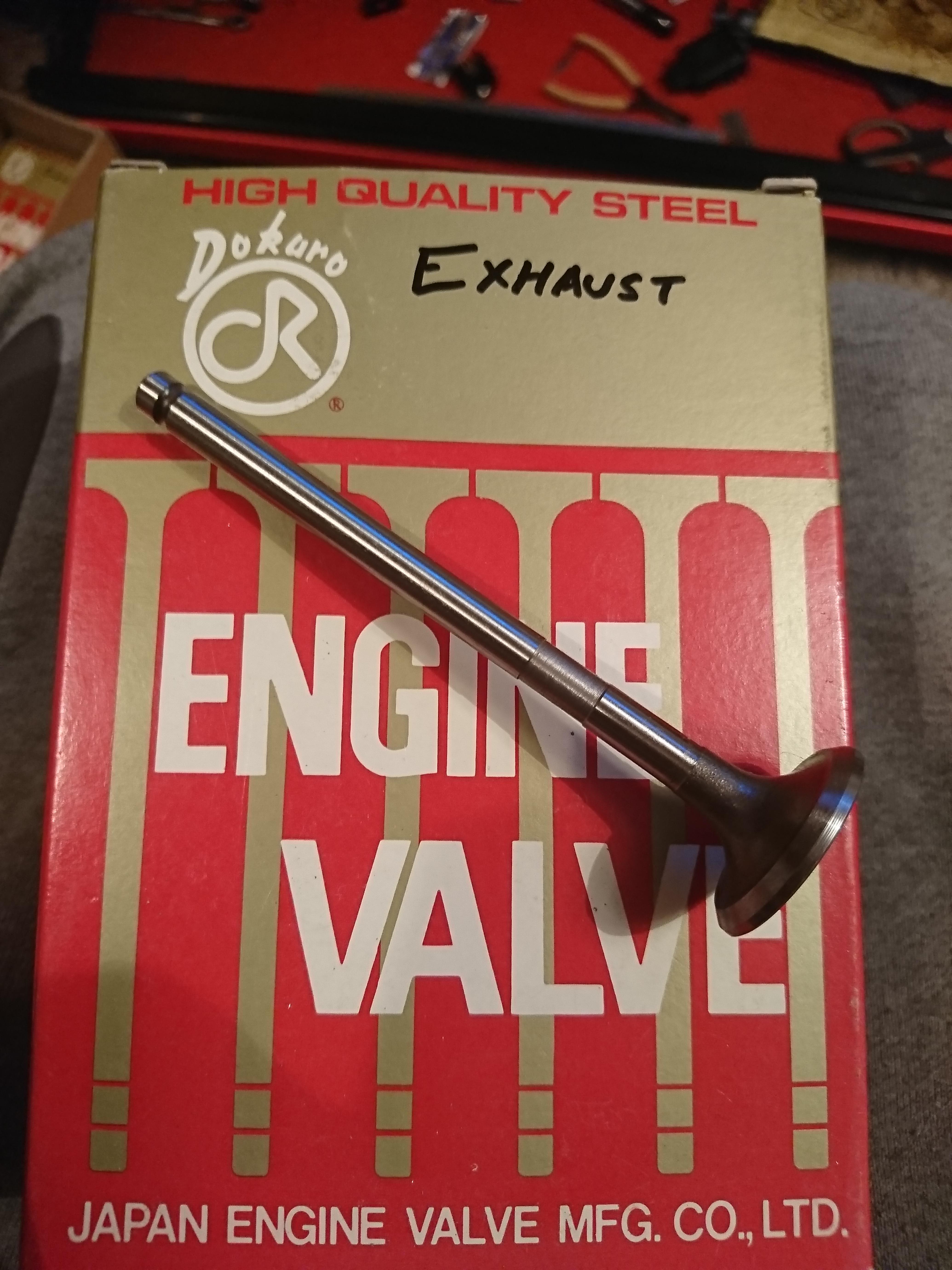

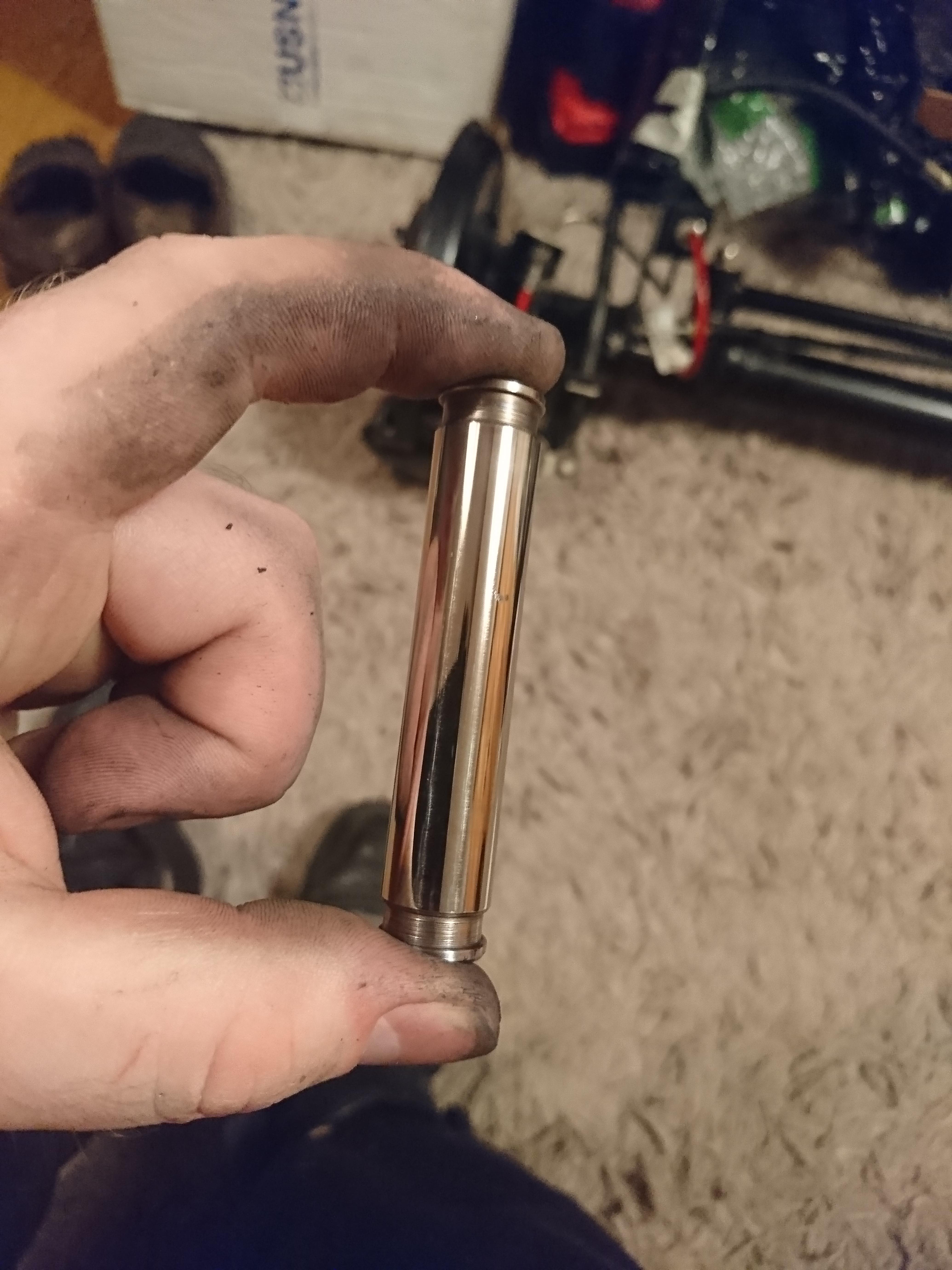

Got some brand new Dokuro inlet & exhaust valves from Japan which I will have a multi angle job done and then send them away to be Nitron CA coated to reduce friction & wear, and increase heat resistance.

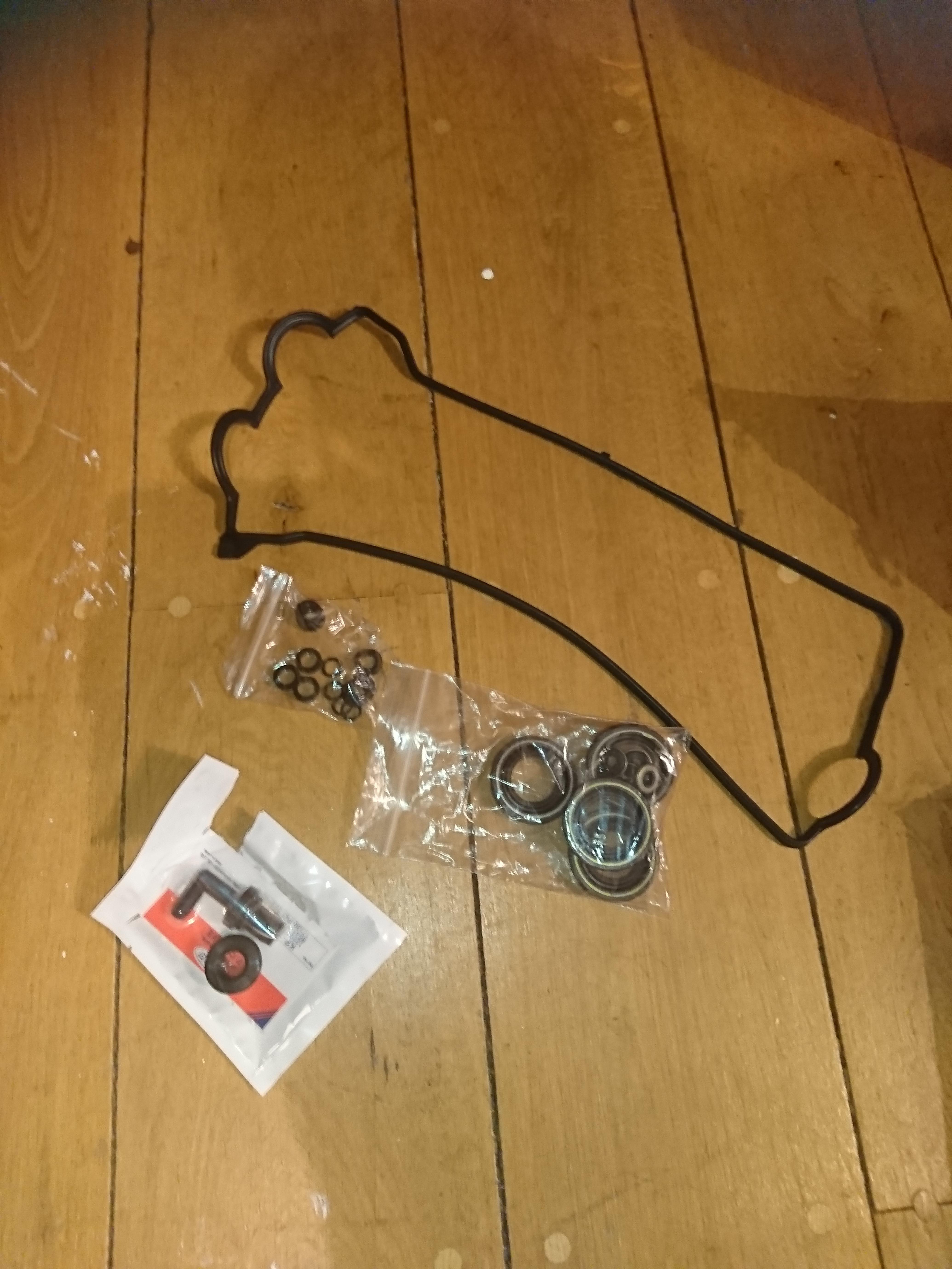

Got new gaskets, seals & PCV valve for the valve cover and seals for the 4e-fte injectors that I need to have cleaned.

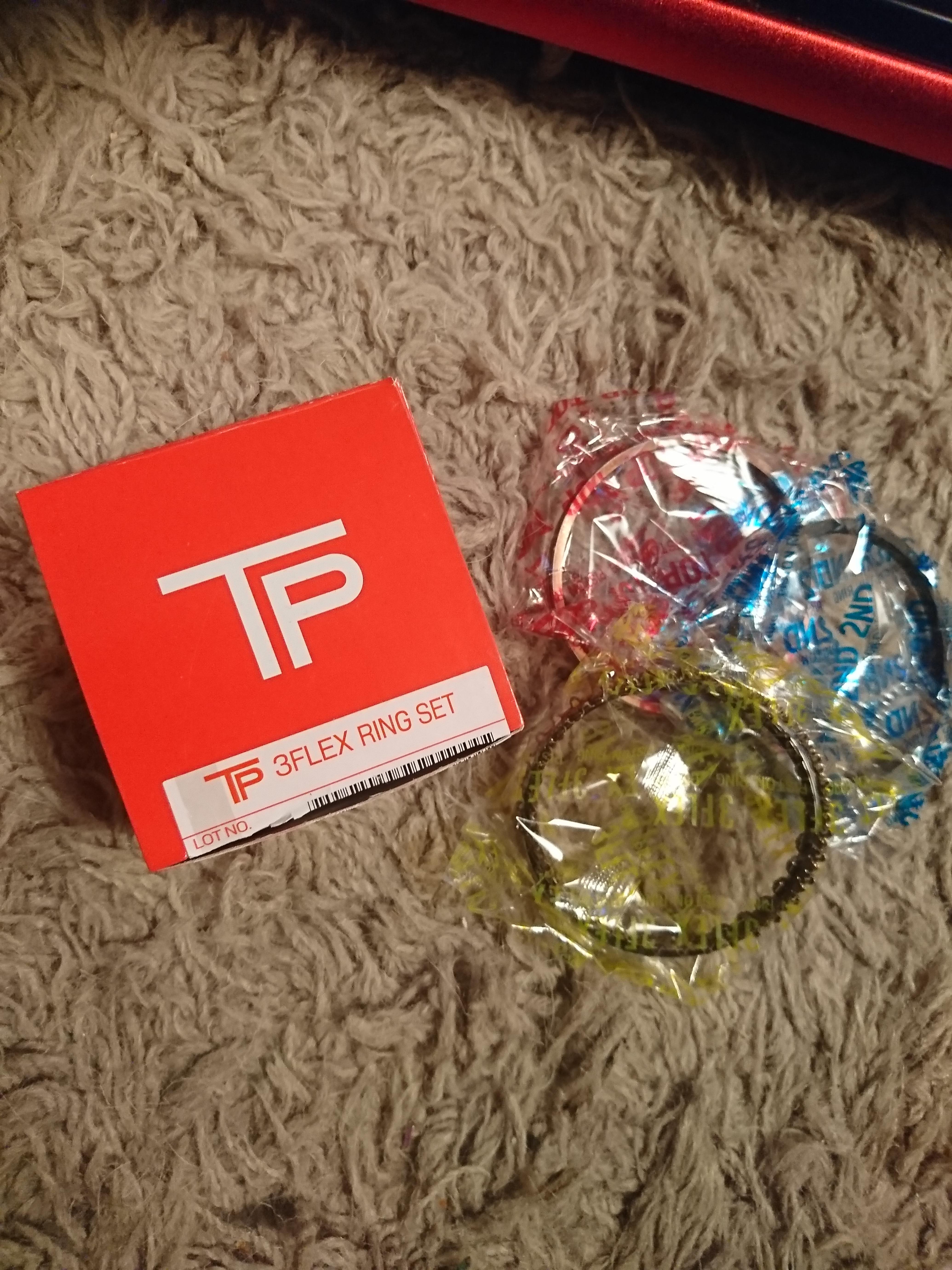

Also got some new TP piston rings ready to send away with the valves to be Titanium Nitride coated for reduced friction & wear.
DSC_0160.thumb.JPG.d713de60d7fd5a2ff30a16f5775f3d38.JPGDSC_0161.thumb.JPG.d63119ea9f7eb306215bc2a2fd76f54e.JPGDSC_0164.thumb.JPG.55c987a0ed4f2625935ef7d44a1423a3.JPG
After the valves and pistons rings come back I will be having the piston tops, combustion chambers and valve faces coated with cerakote to increase heat resistance.

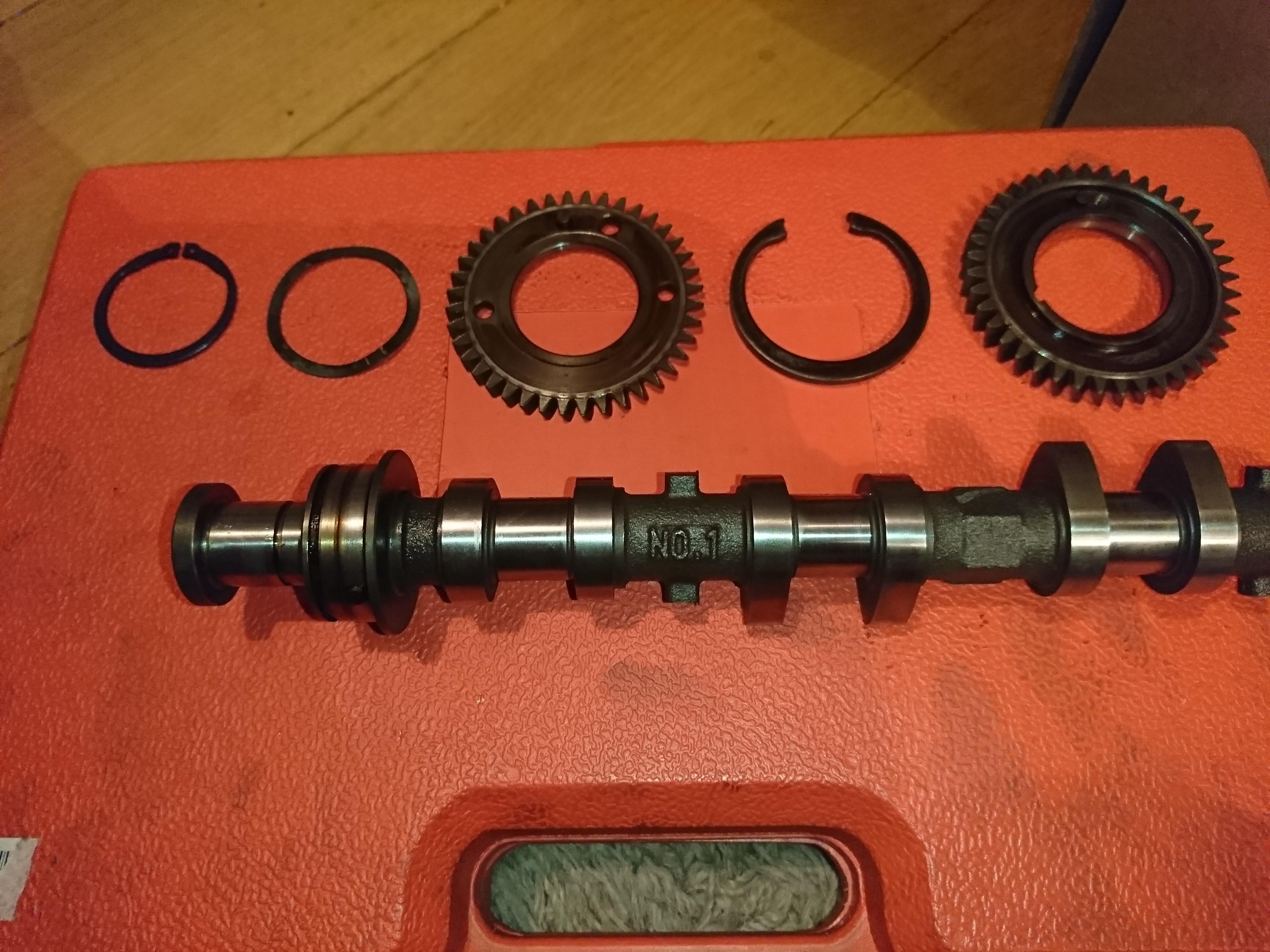

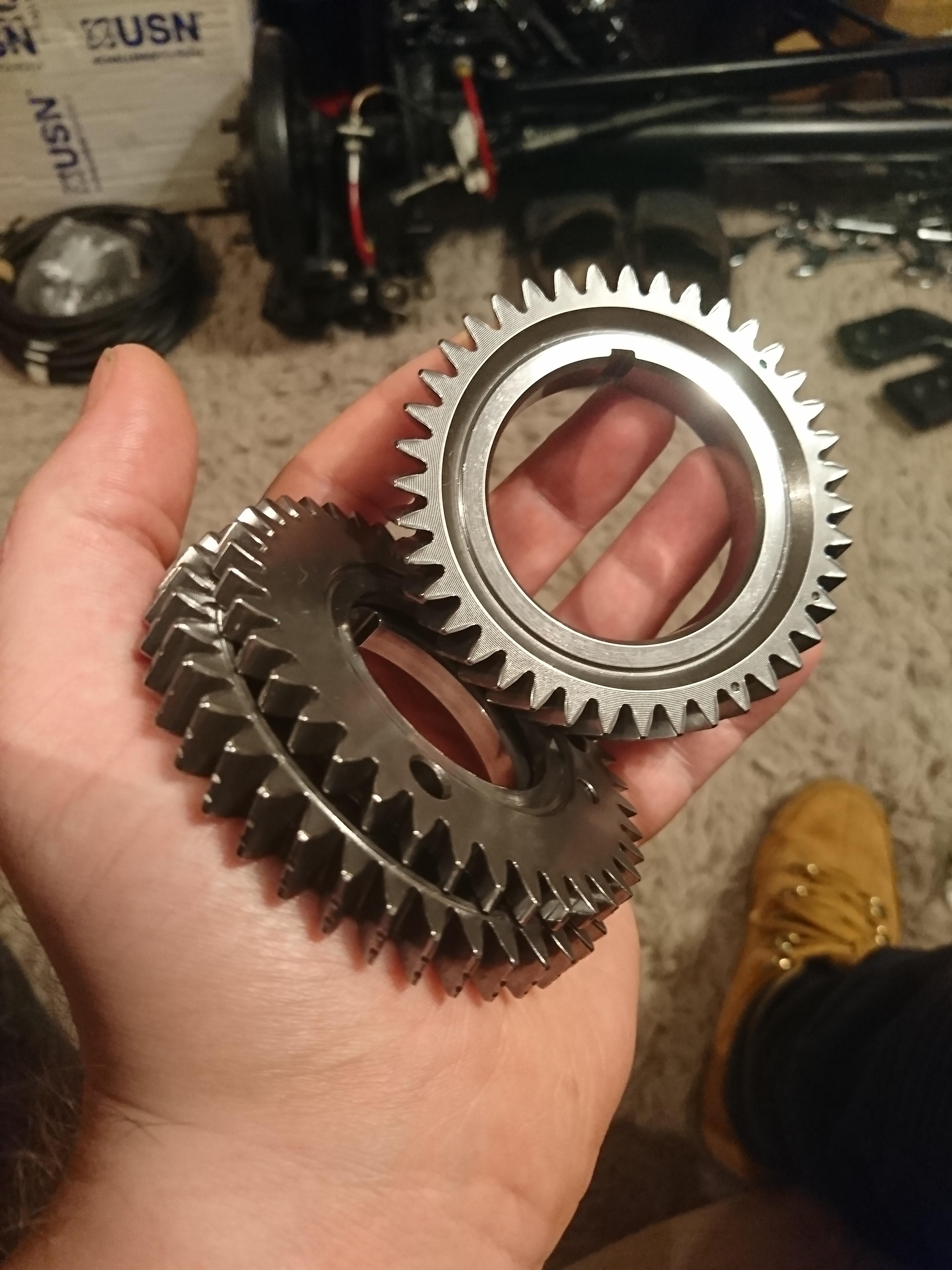

I have also taken apart the camshaft gears and taken those to Nova racing to be superfinished and will also be taking the camshafts and shims at a later date to be superfinished also to reduce friction and wear.
The idea behind having all these bits whatever-coated or superfinished is to reduce friction, this not only reduces carbon build up & increases the life of the component, it also makes it easier for the engine to turn itself over, which in turn equals less wasted energy, and more energy to put down on the road. And as you know, this is gonna be an N/A, so I need to squeeze every bit of power I can out of it!

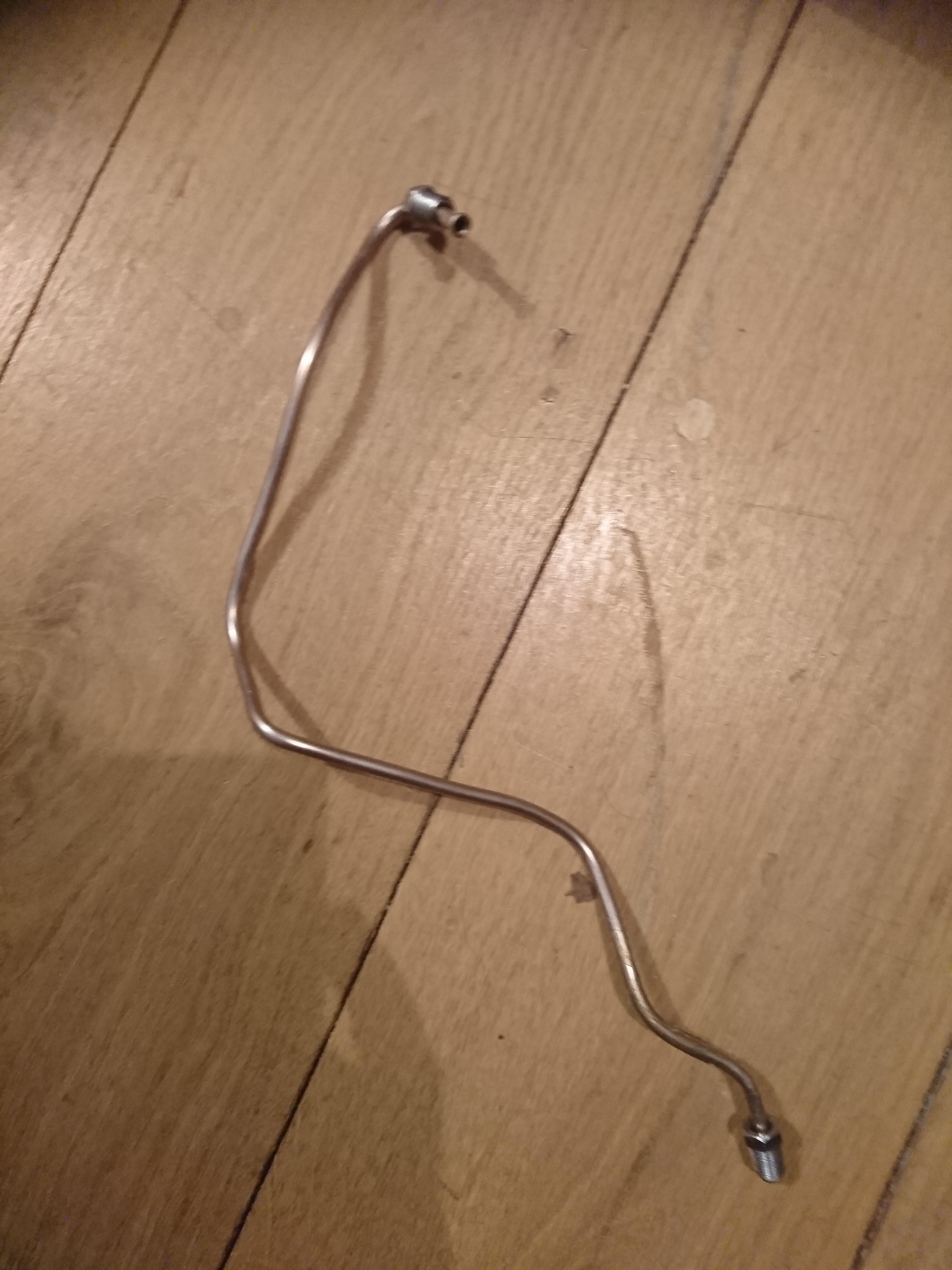

Meanwhile I've been doing a few little bits and pieces. Made a new clutch line for the gearbox out of a nickel/copper alloy with stainless steel fixings for little to no corrosion there

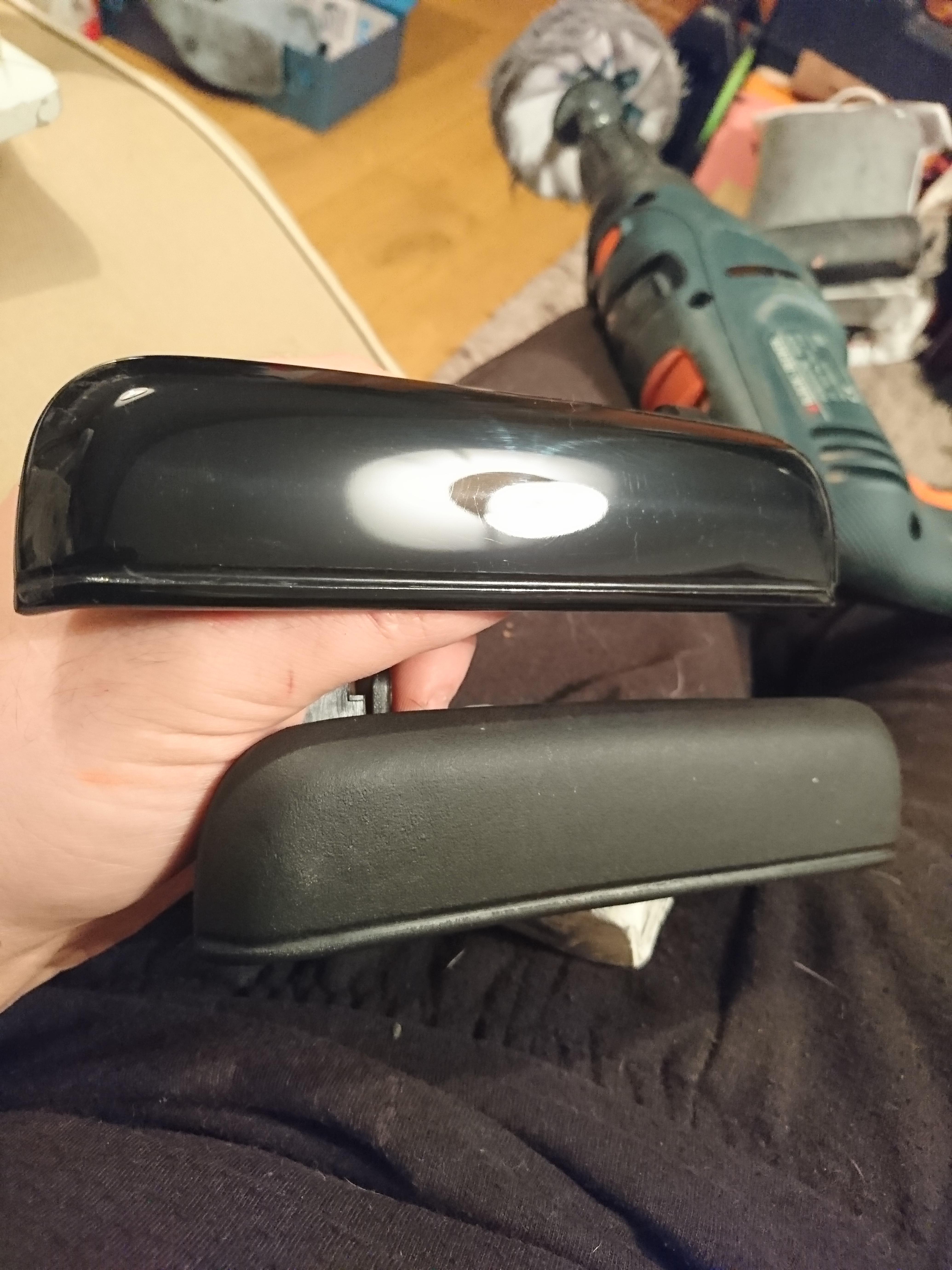

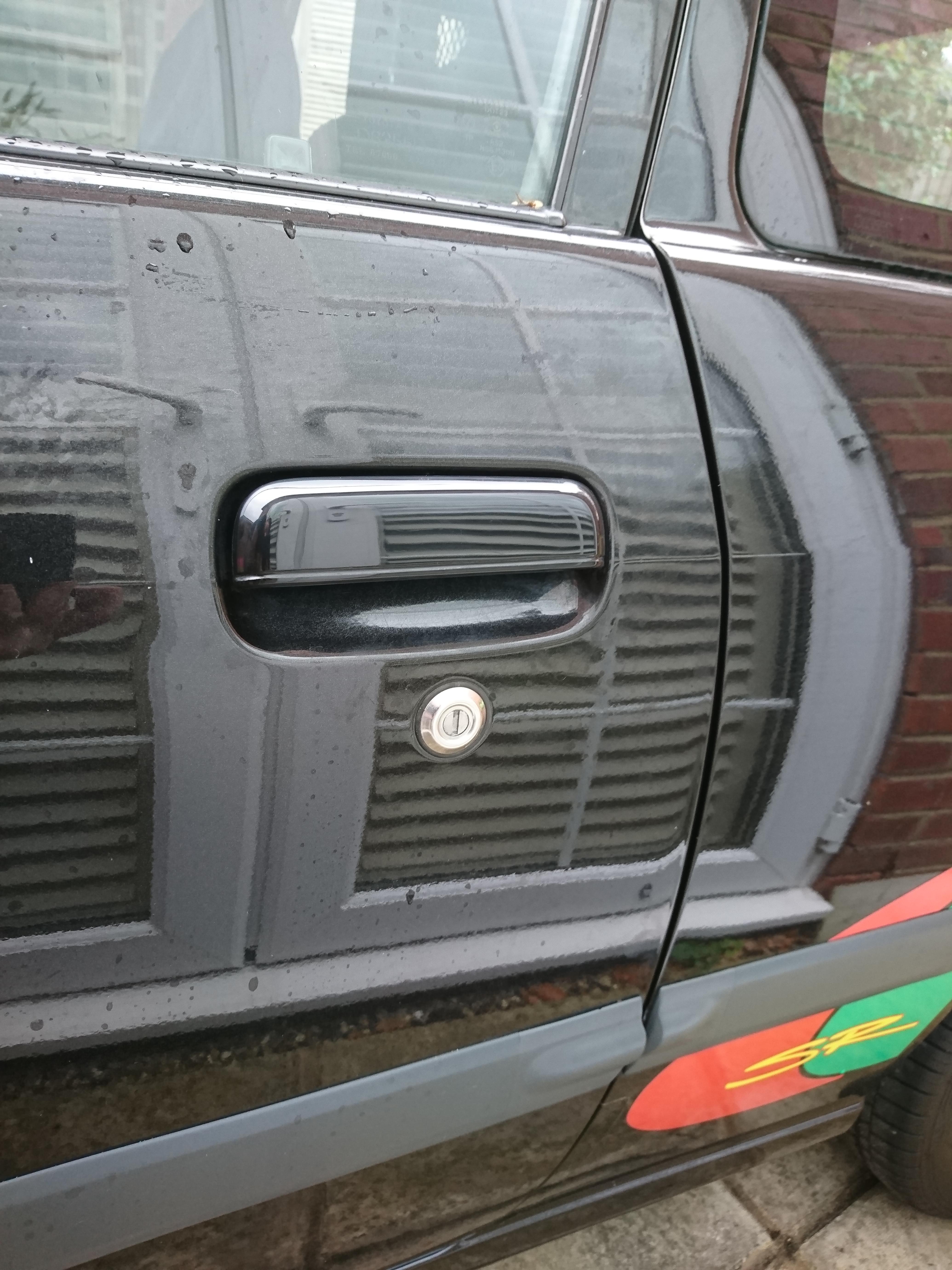

Got some reproduction door handles off ebay which are actually pretty good quality but I'm not a fan of the rough matte grey texture so I polished them up and they turned out a right treat

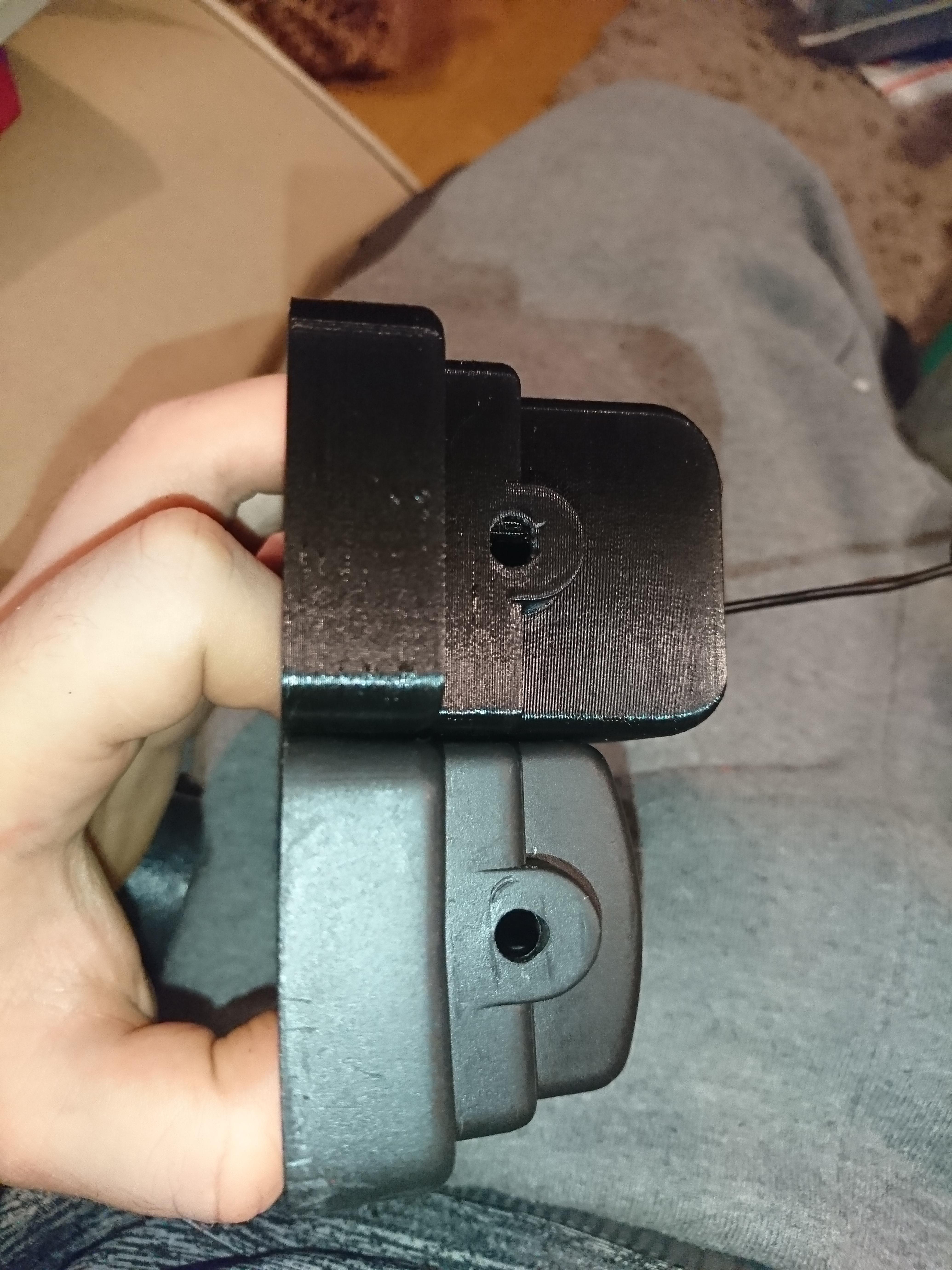

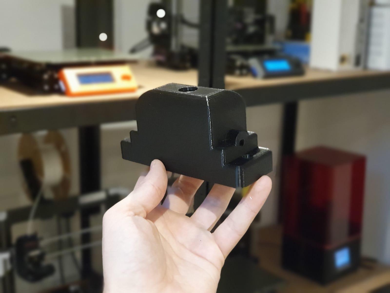

Got the new 3D printed fog light housings which even just feel like better quality. Still waiting for the lamps to come back from being nickel plated as it needed to be re-done because the first attempt didn't take very well apparently

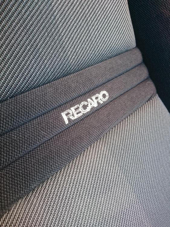

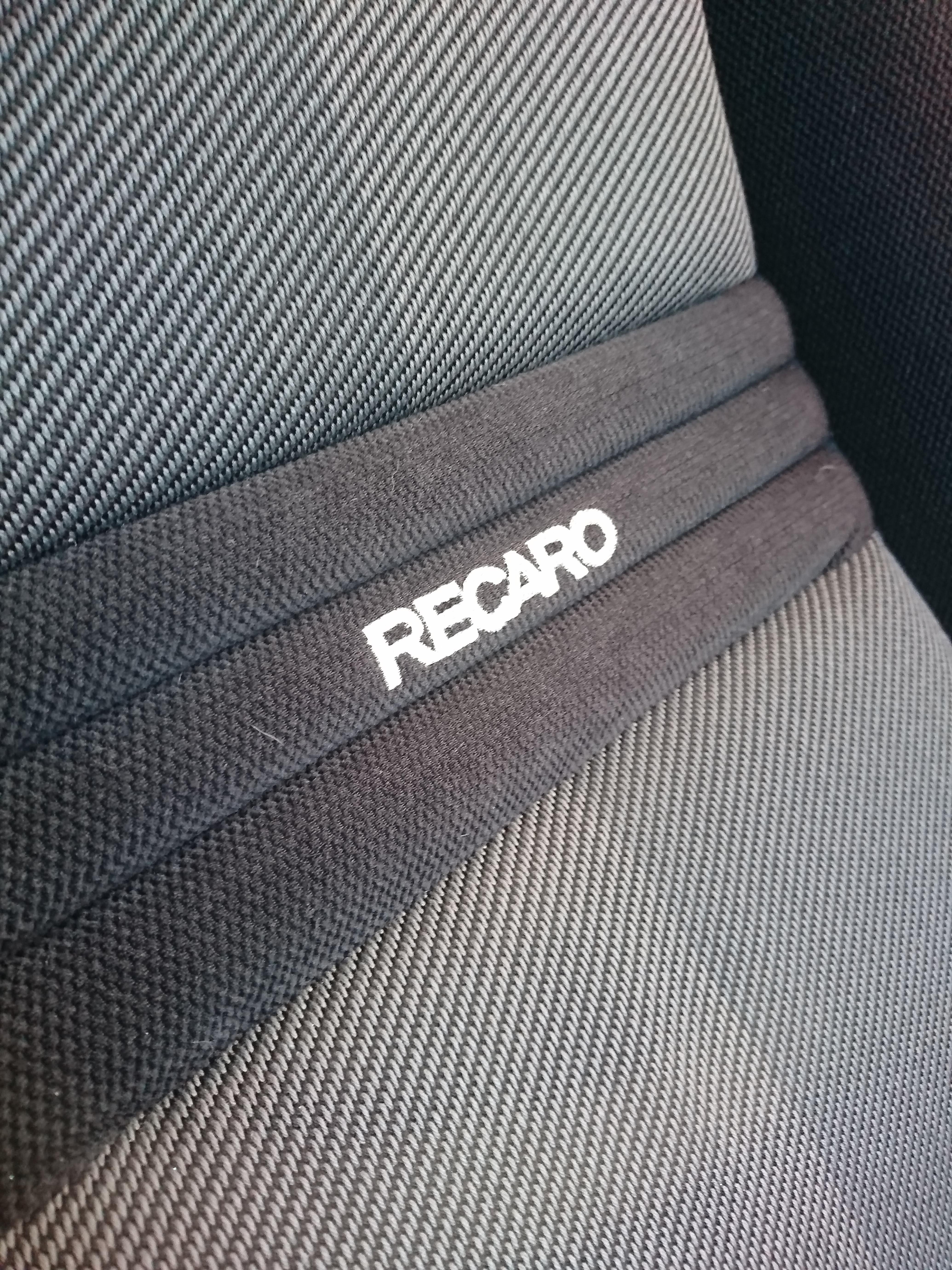

Also got myself one of those white fabric pens to liven up the RECARO lettering on the seats
DSC_0151.thumb.JPG.2232903529c2604ee0ae2ec0a90c1dd4.JPGDSC_0153.thumb.JPG.15026df772edc504e31bfe83dc8b9e65.JPG

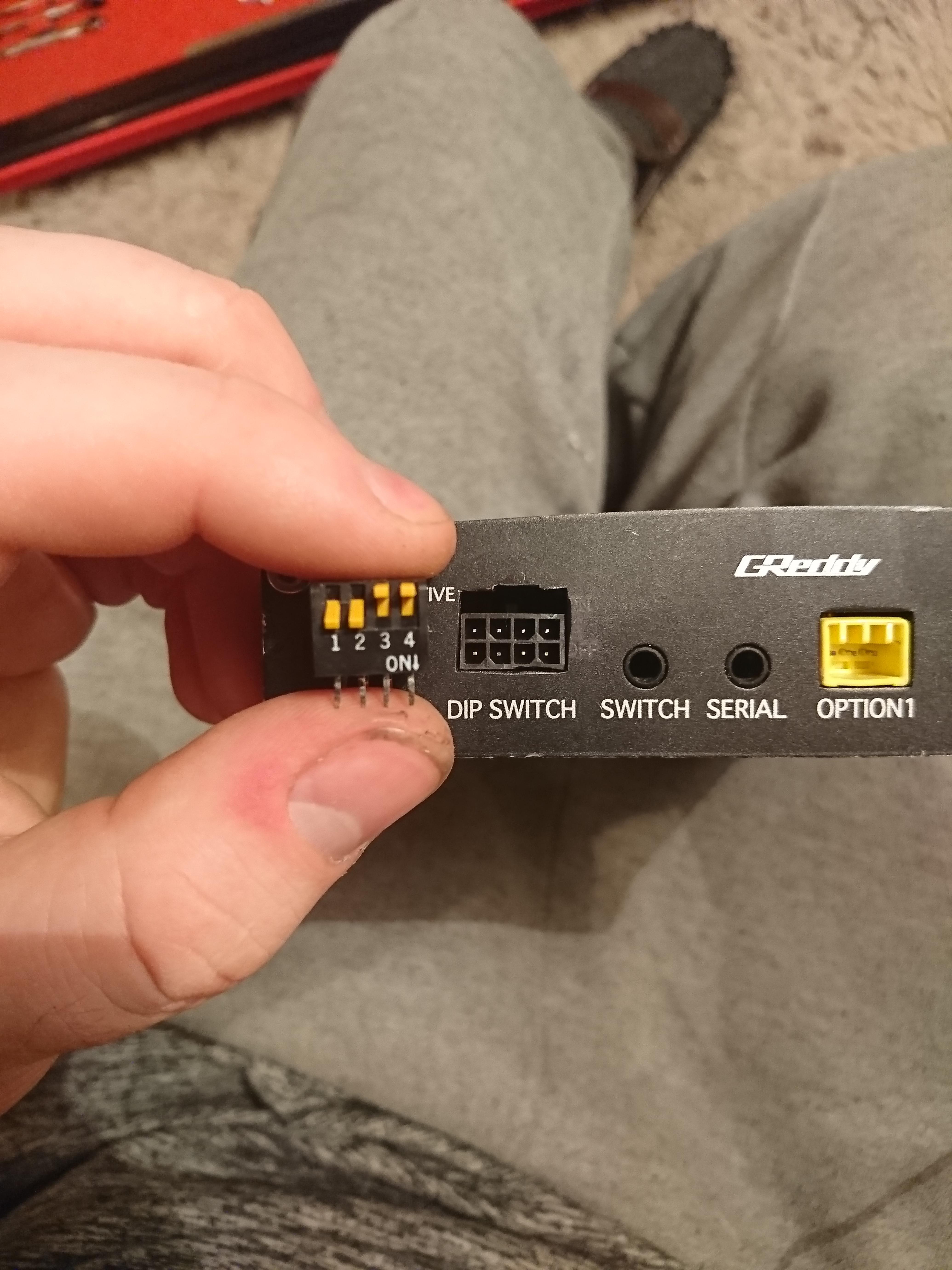

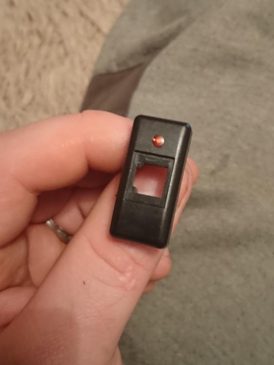

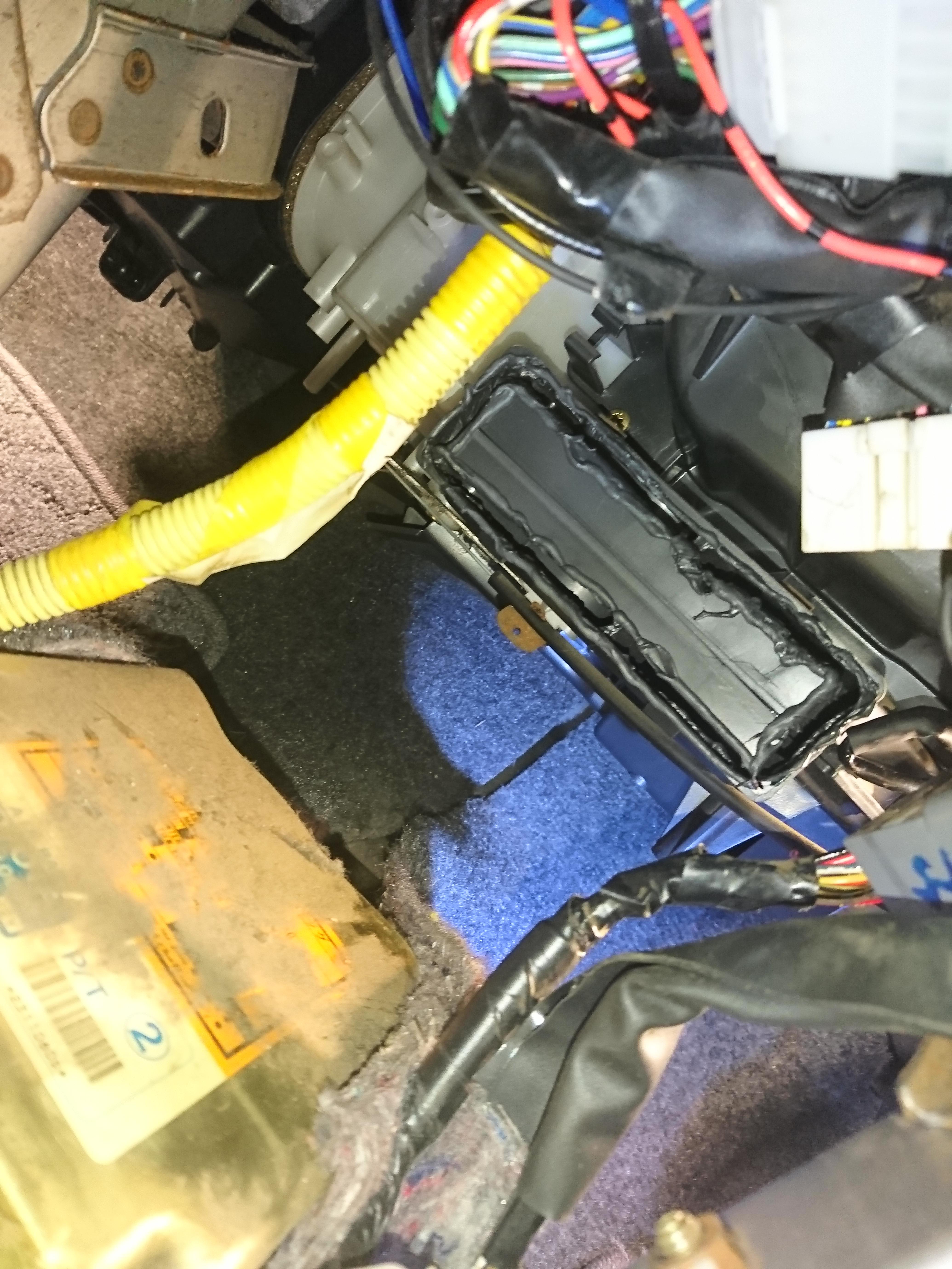

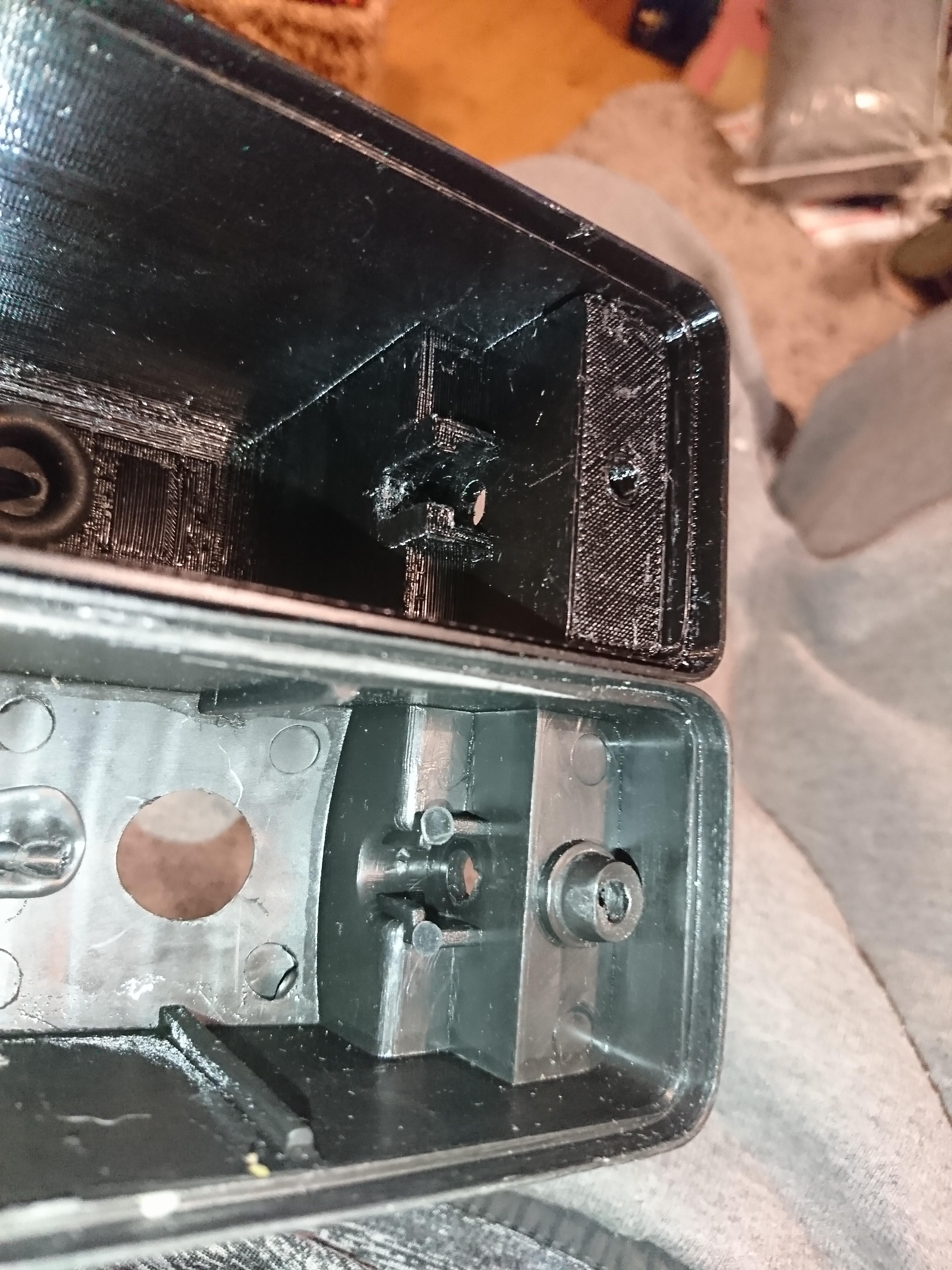

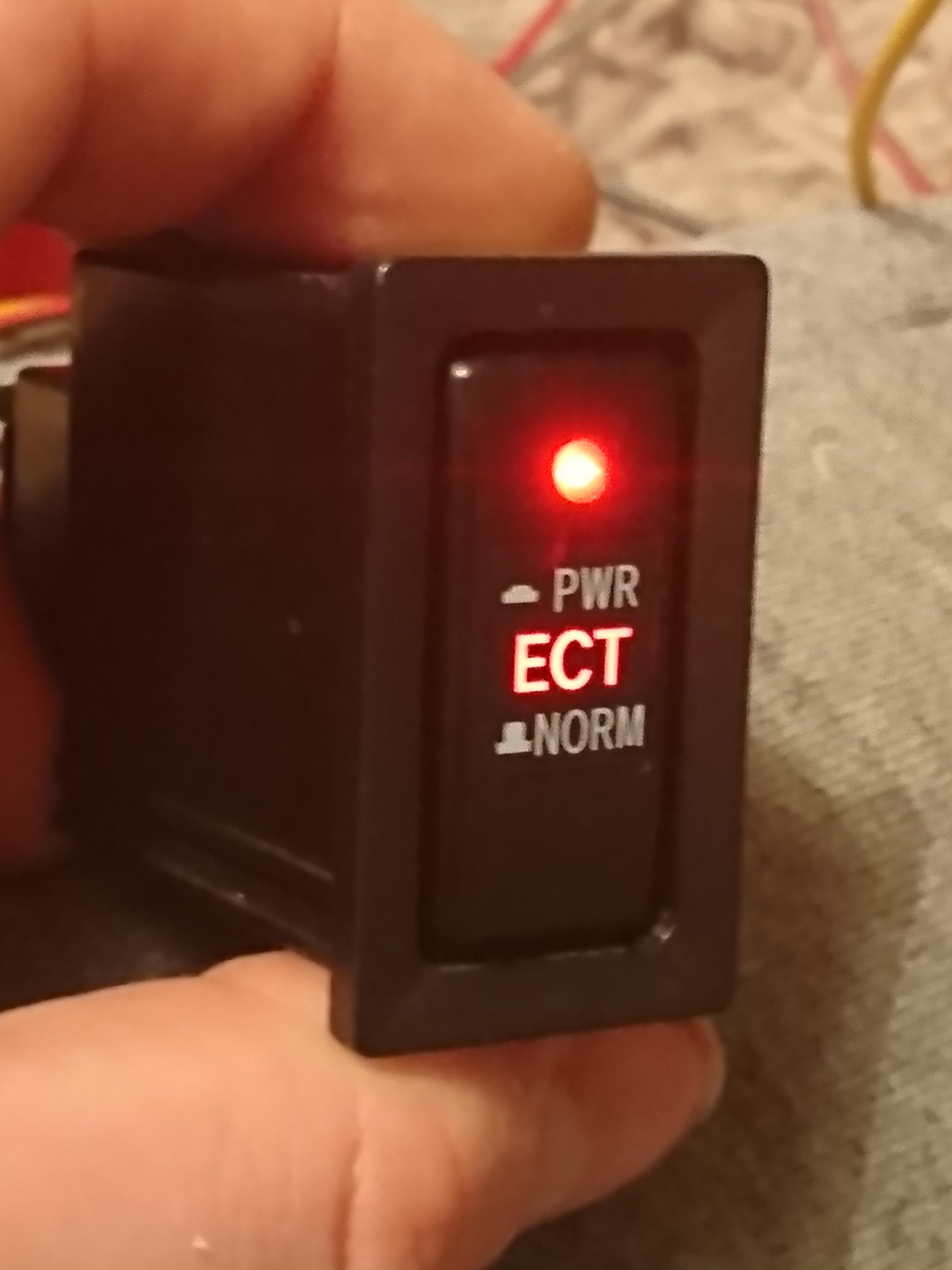

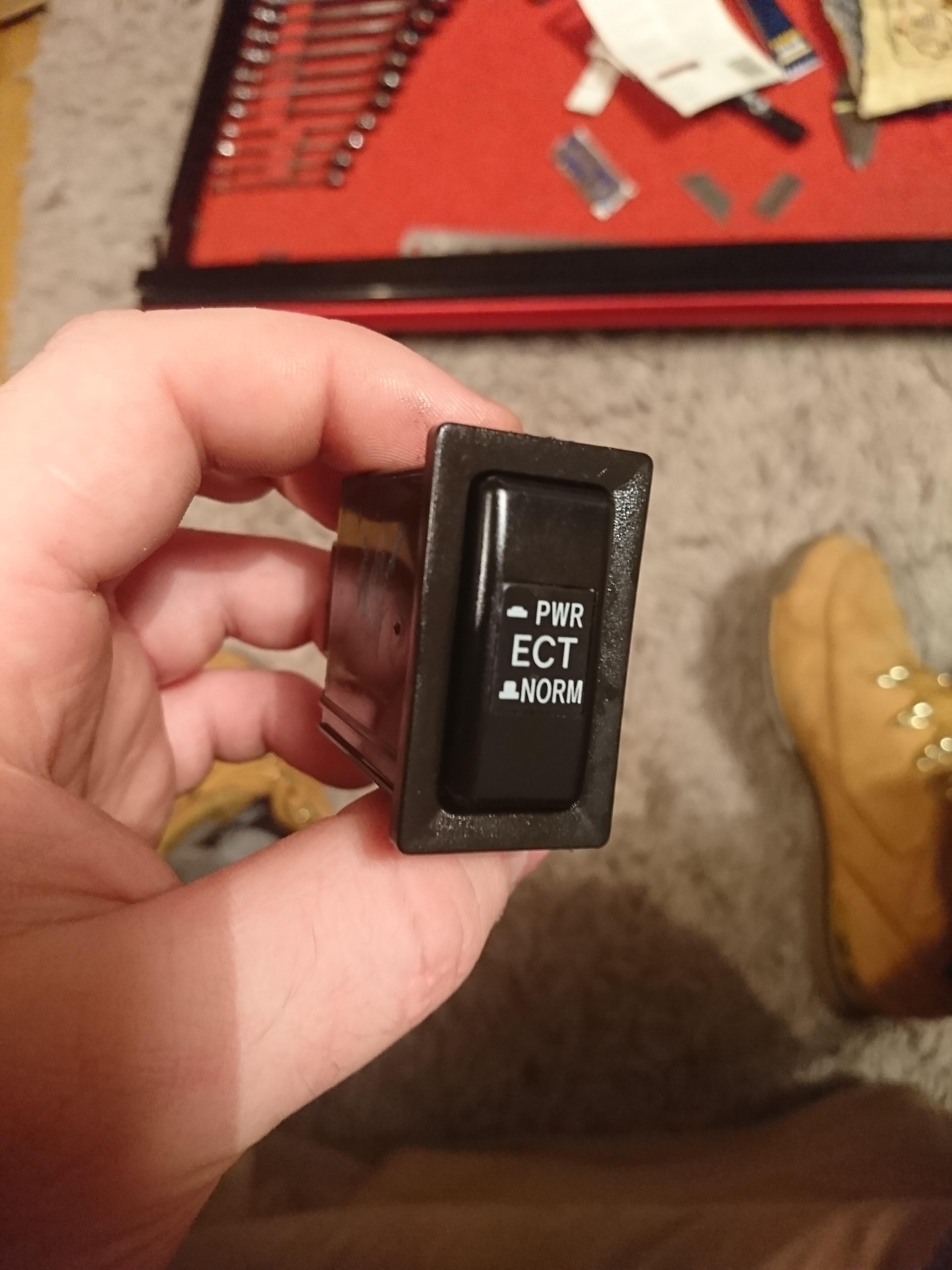

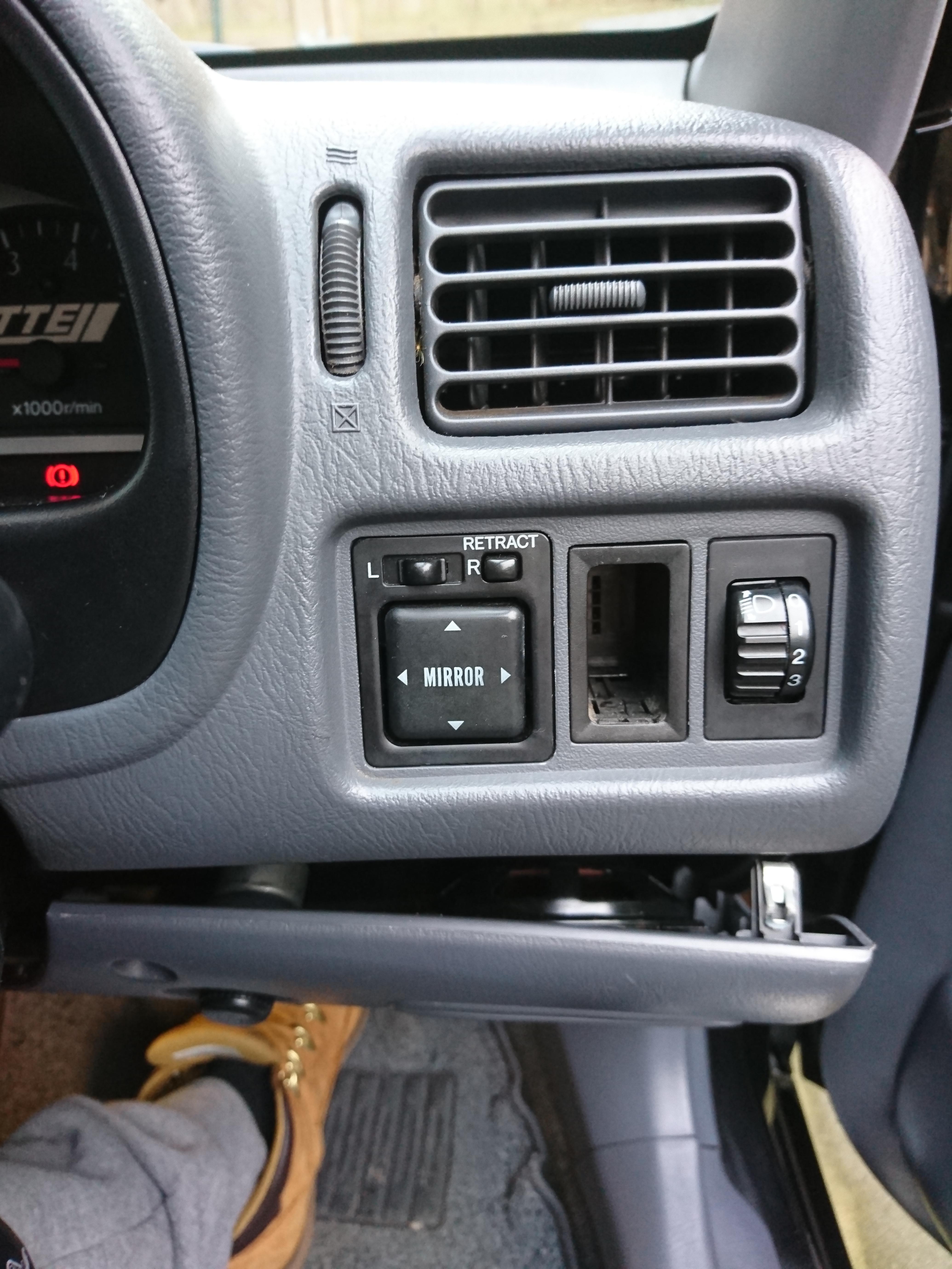

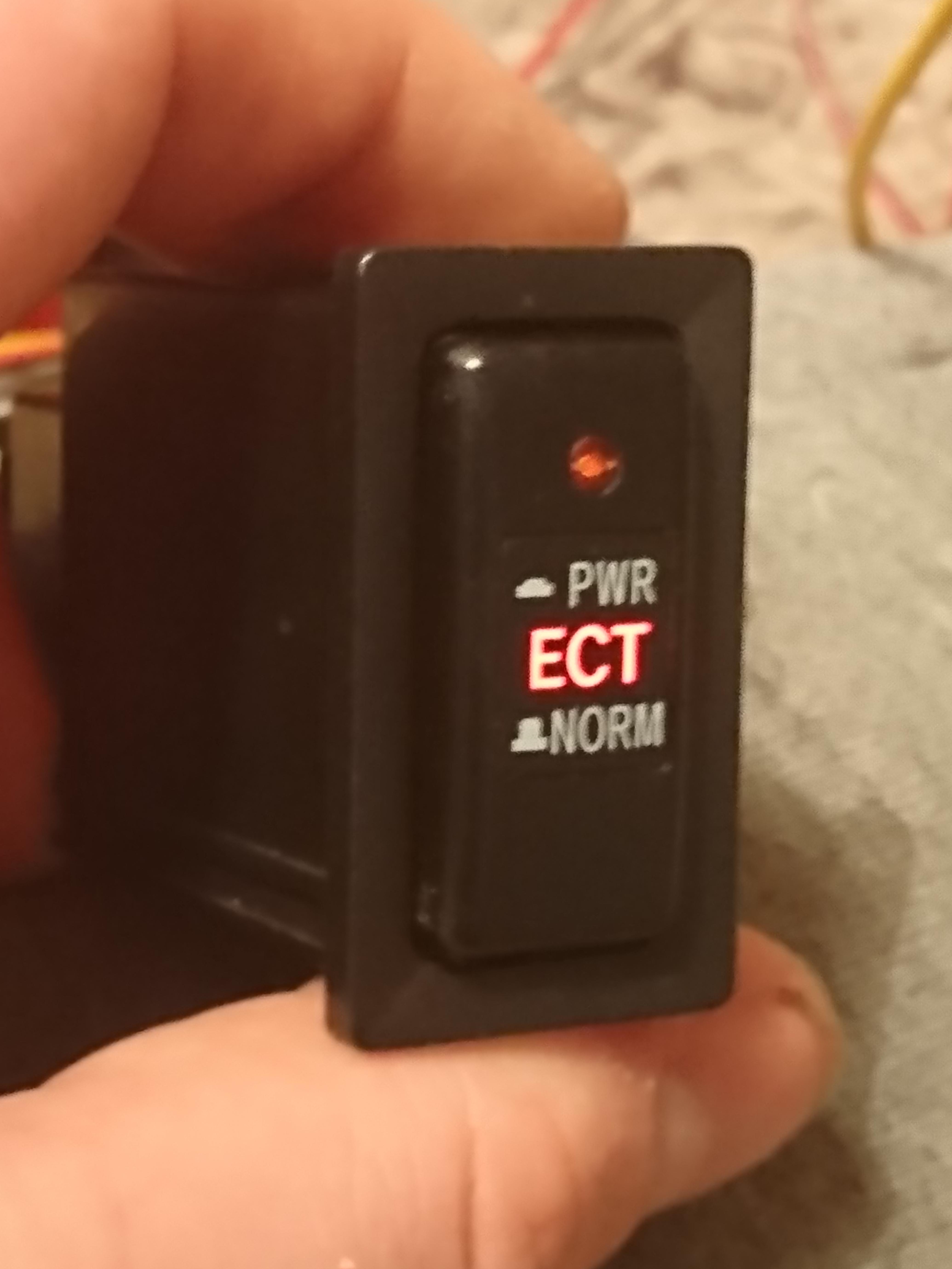

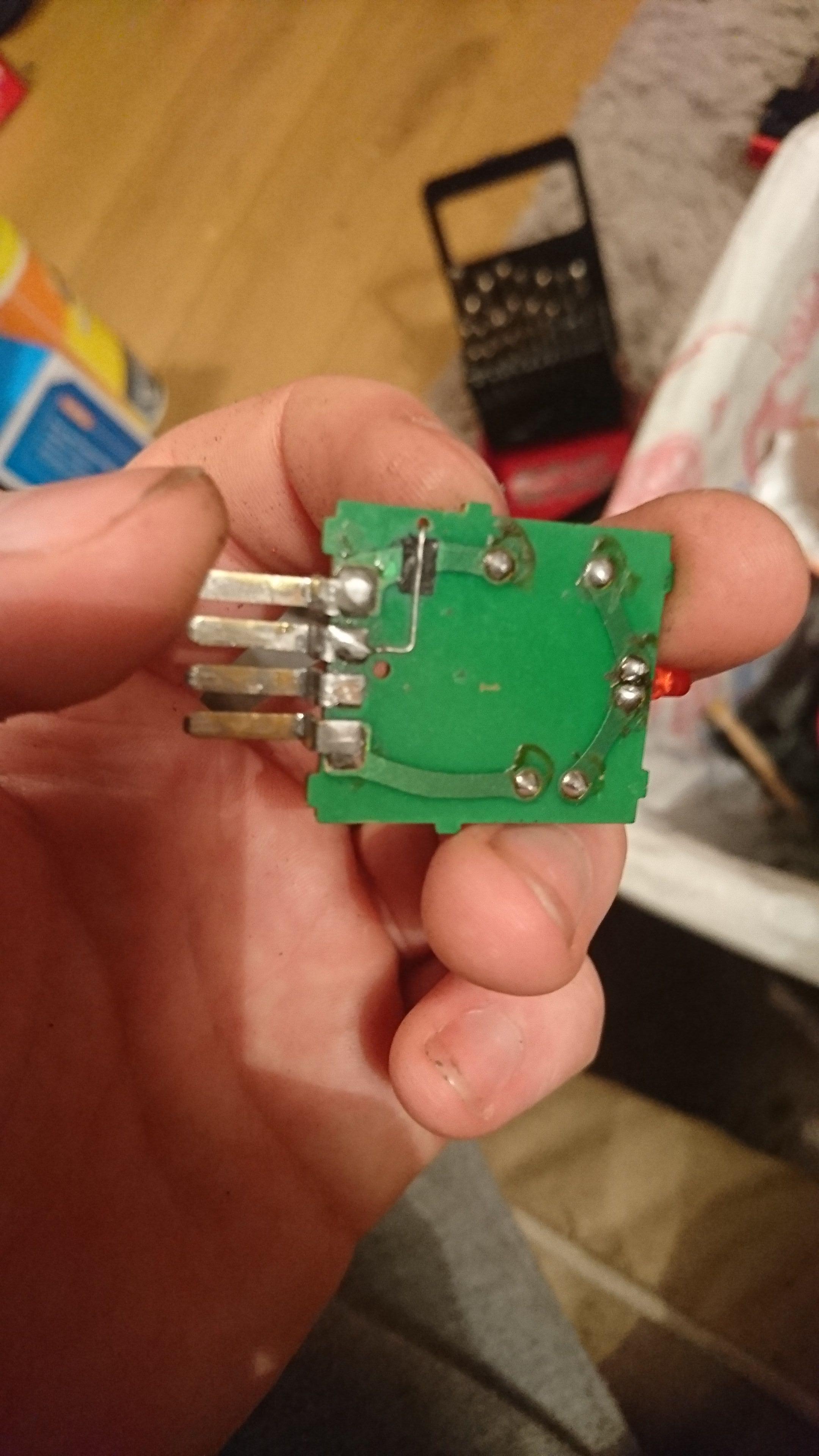

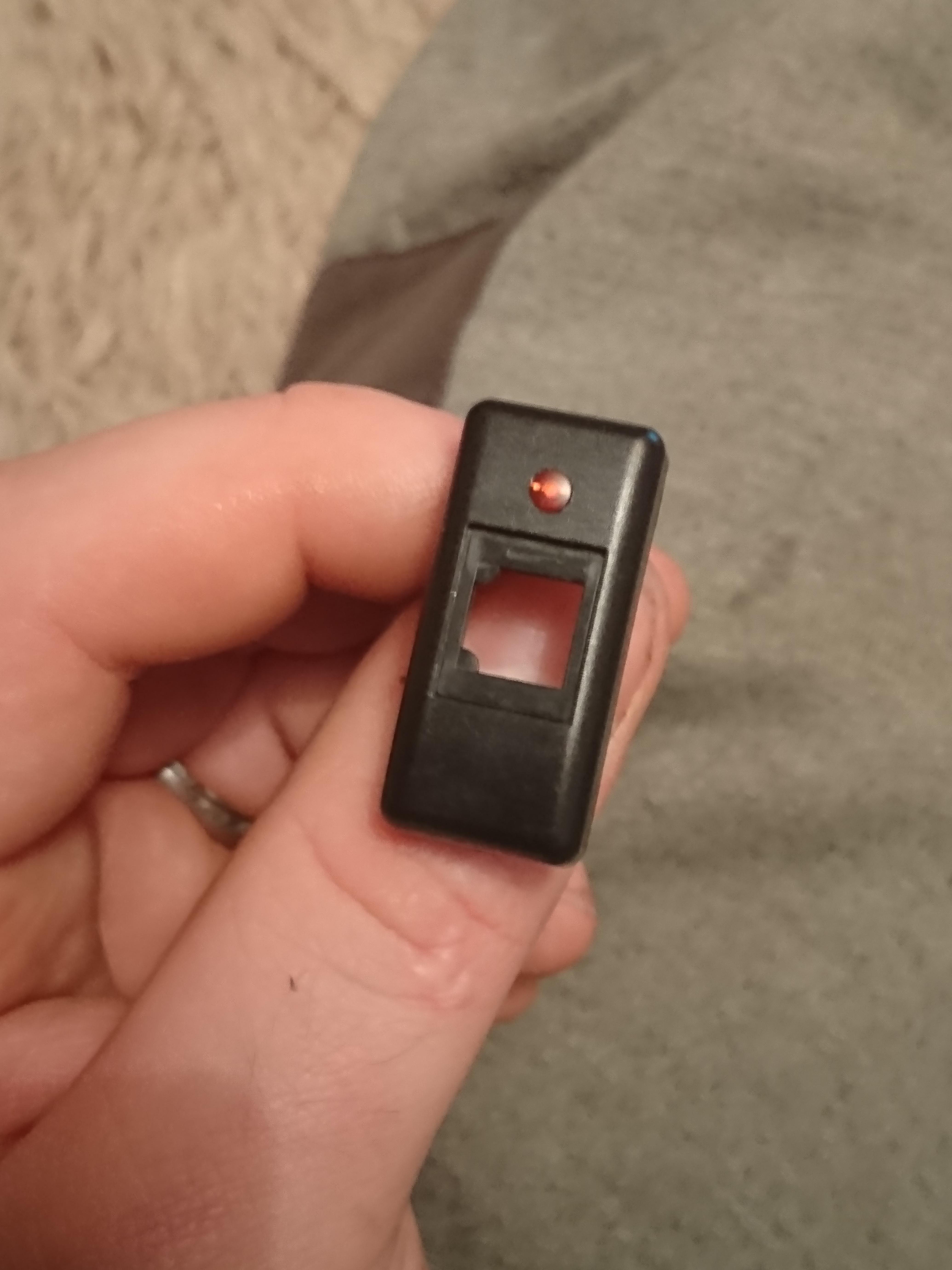

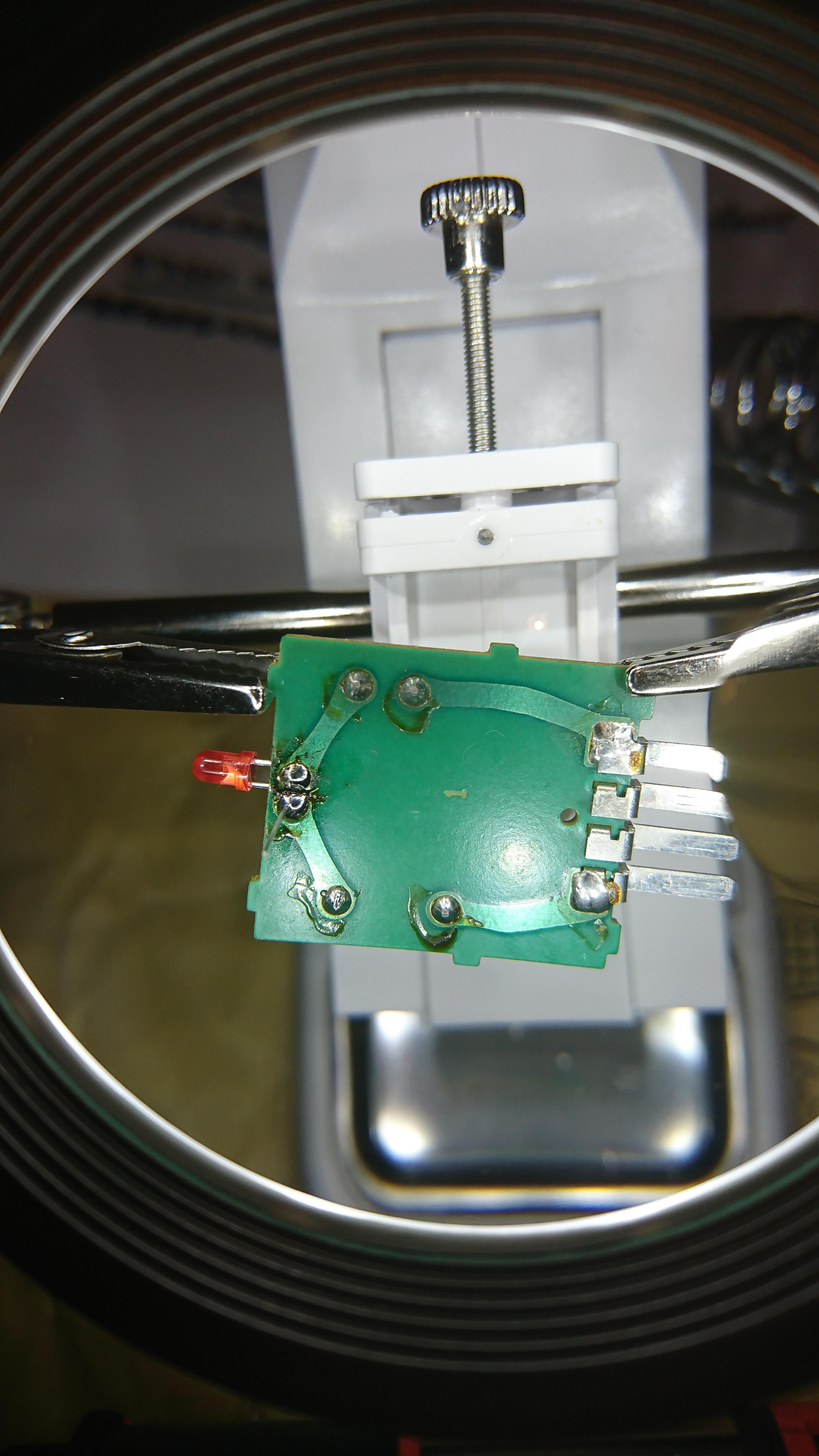

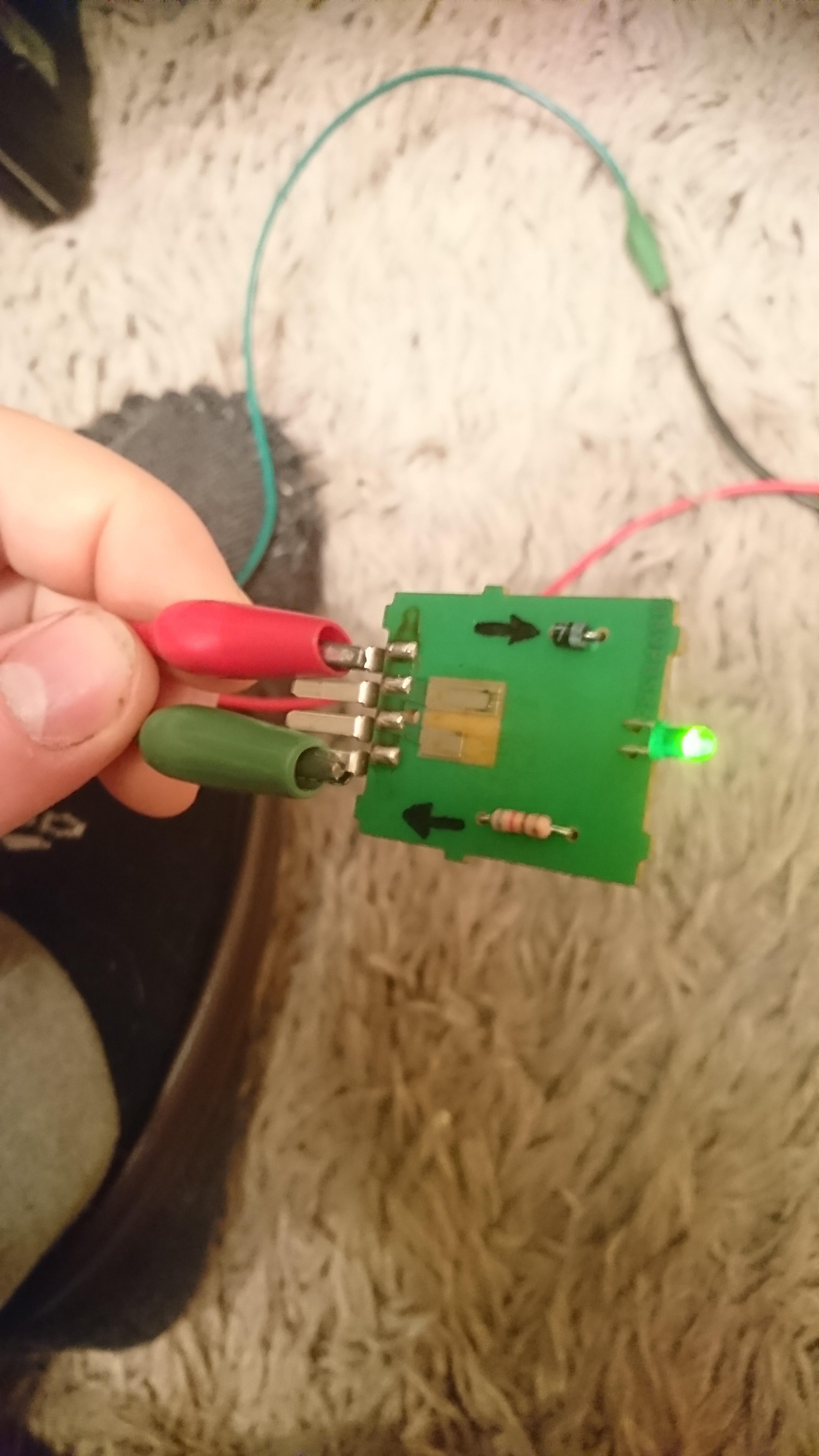

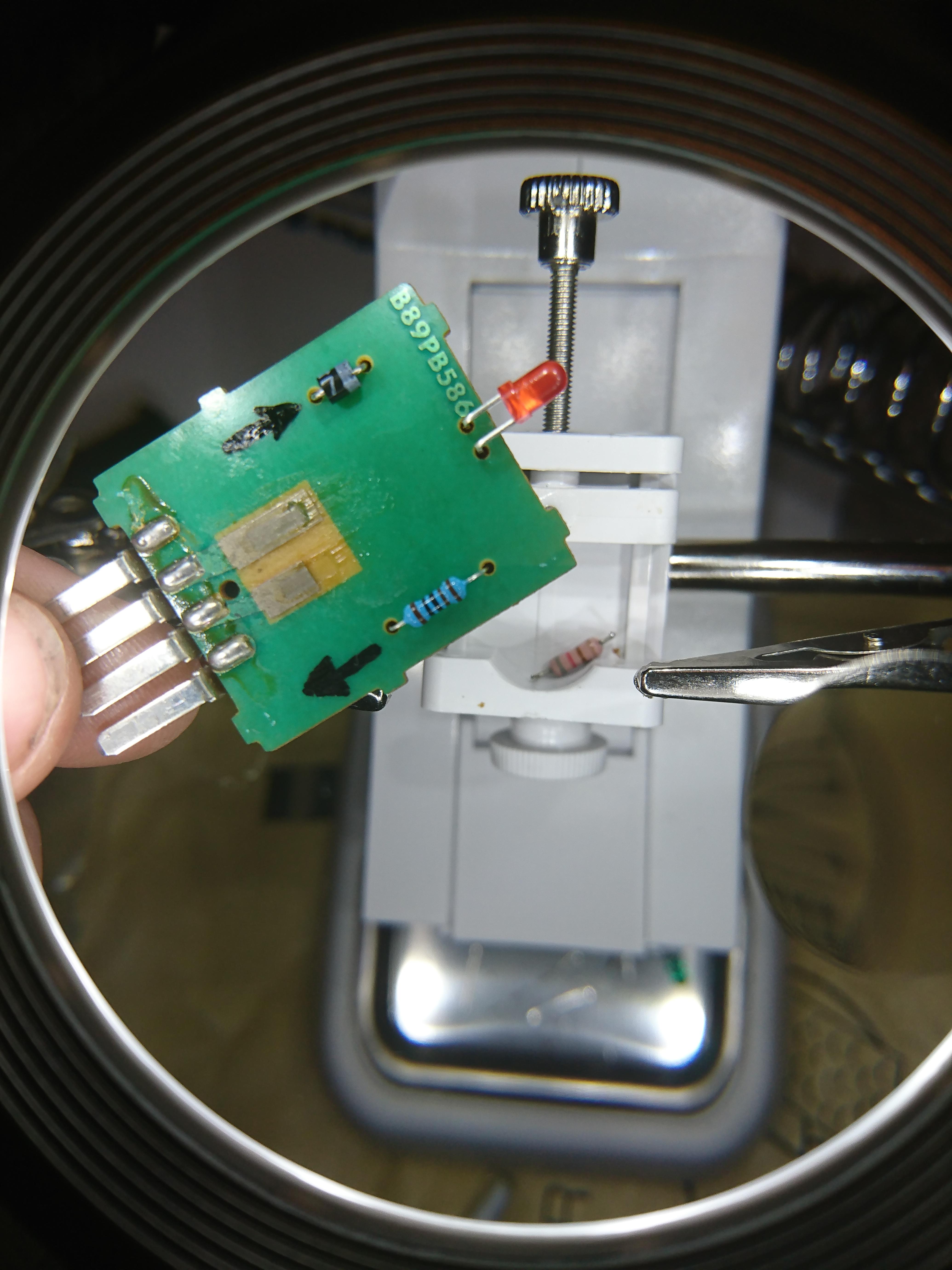

And I've also been working on a new mode/map switch for the E-Manage.
Started out in life as a ECT switch out of a Toyota Hiace and it fits in the slot perfectly next to the mirror adjuster switch. As I hoped, the circuit board is just a simple on & off toggle switch which is exactly what I need to operate the relay board I have made which will operate the modified dip switch.
For those that have no experience with an emanage, the dip switch is a little 4 channel switch on the front panel of the emanage that turns on and off certain parameters of your choosing through the software. For example you can switch between fuel map 1 & 2, or ignition map 1 & 2, or launch control on & off, or auxiliary outputs.
But I have modified the emanage and have replaced the dip switch with an 8 pin plug which goes to a 4 channel relay board. This way I can operate all 4 switches with just the one switch, utilizing it like a sport mode button to activate the shift light I put in the rev counter, launch control, and a more aggressive fuel & ignition map
First I changed the green backlight LED for a red one and put in a different resistor to alter the brightness. And then I went and modified the switch further putting in another red LED on the button itself that will light up when active
DSC_0142.thumb.JPG.38824801d61d0ccab475d38519ba7978.JPGDSC_0143.thumb.JPG.9013a6a38559fd4431e4ac0dc7c8d9a2.JPGDSC_0146.thumb.JPG.4313f01eacbc6b72c6b1c96fec091e61.JPGIMG-20201208-WA0044.thumb.jpeg.b50240b35fbaa28d6d7db52697c8b644.jpegDSC_0149.thumb.JPG.7b7a84bca954d0577ec36721436ae6c5.JPG
Then what I plan to do is modify the switch facia so that it illuminates 'MODE' instead of 'ECT'. But to give you an idea as to the final product:
DSC_0156.thumb.JPG.d75d96b82a7a73481cf08d8977a4cbaa.JPGDSC_0157.thumb.JPG.653c67e1f6892d3486b964463747dd55.JPG

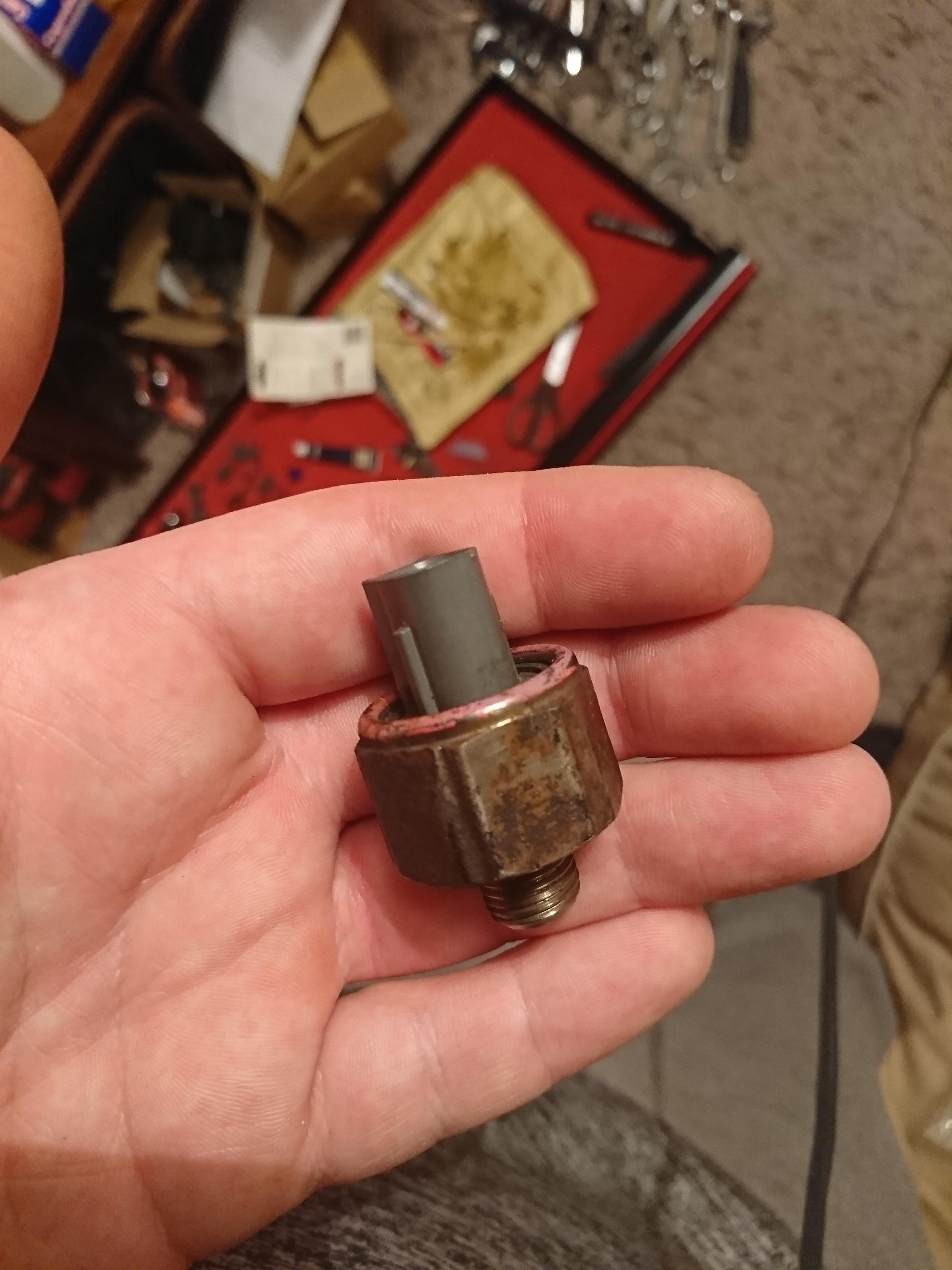

Talking of E-manage, I bought a 4e-fte knock sensor to help protect against any knocking, just in case

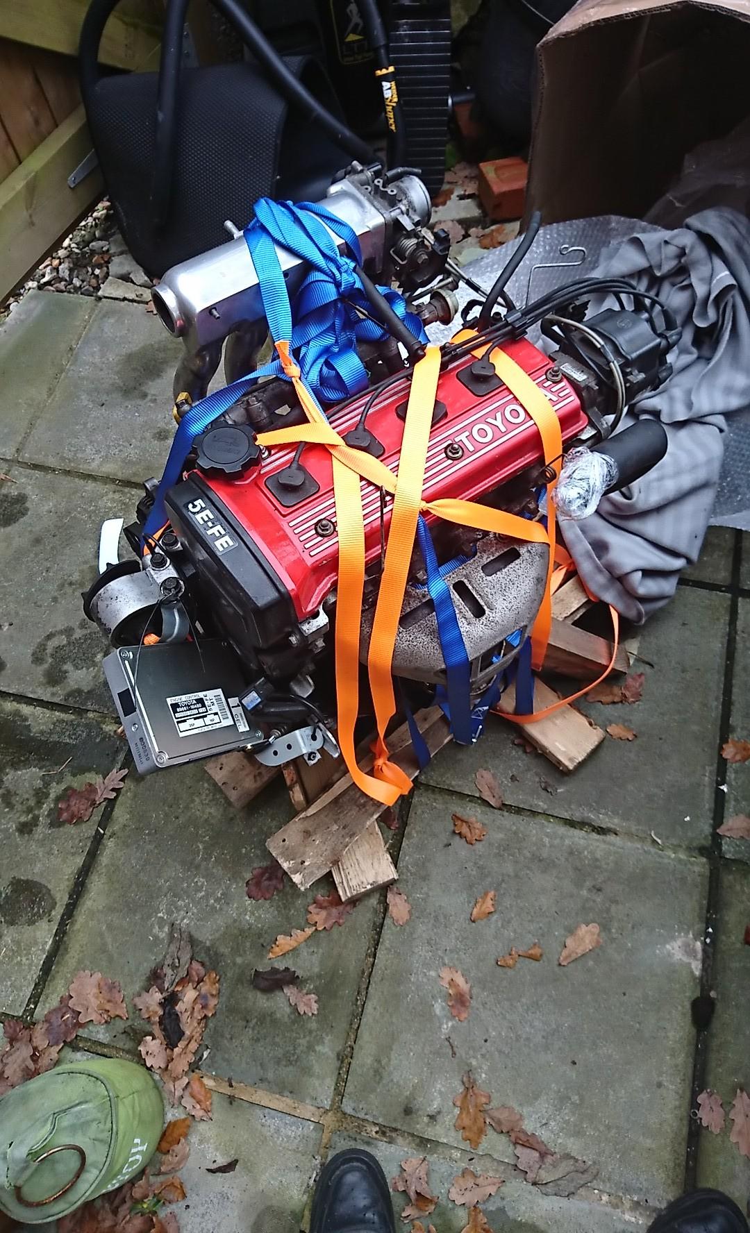

But there is also something else that just got picked up from the Netherlands today 😁

And from the Netherlands...

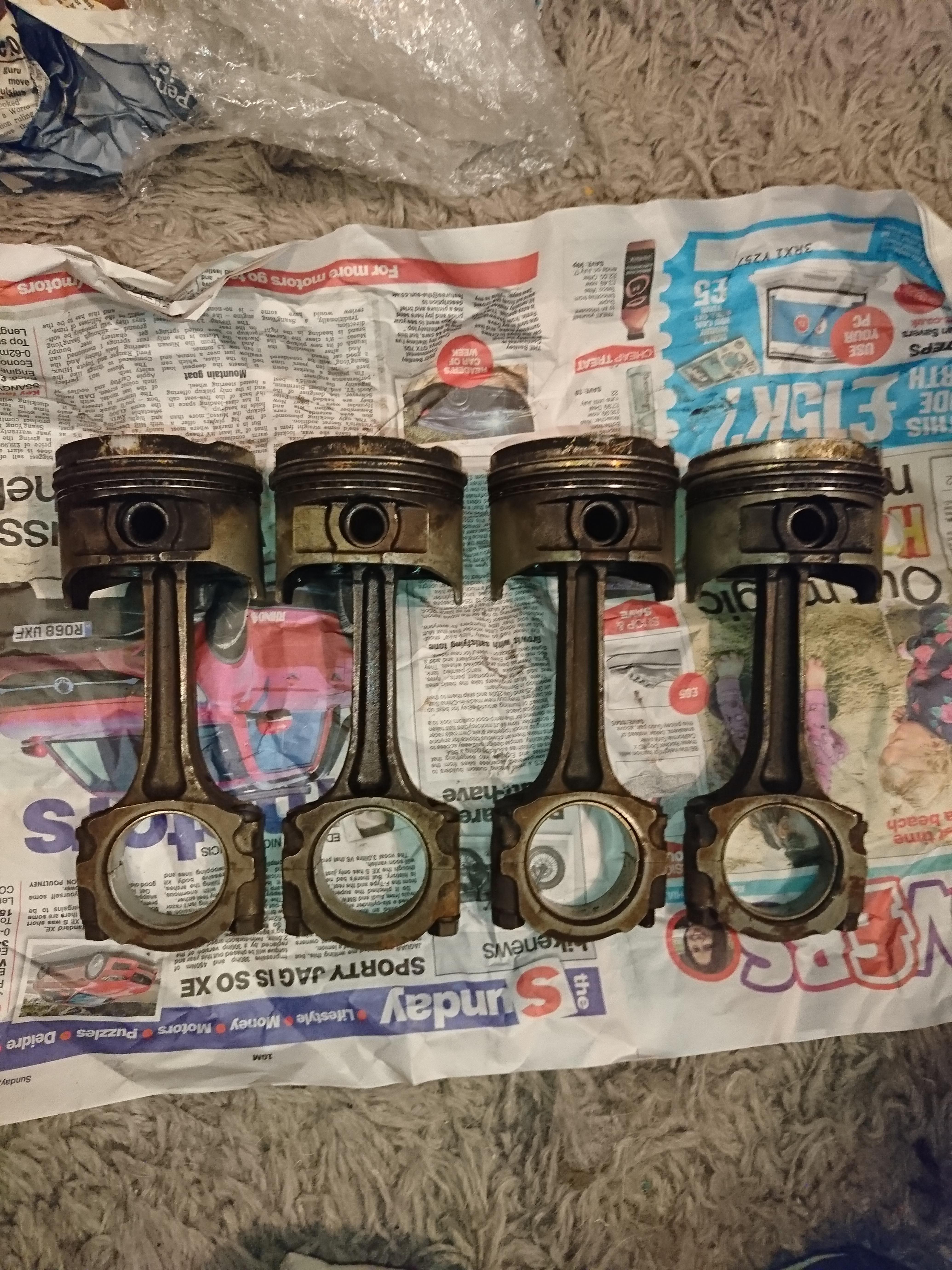

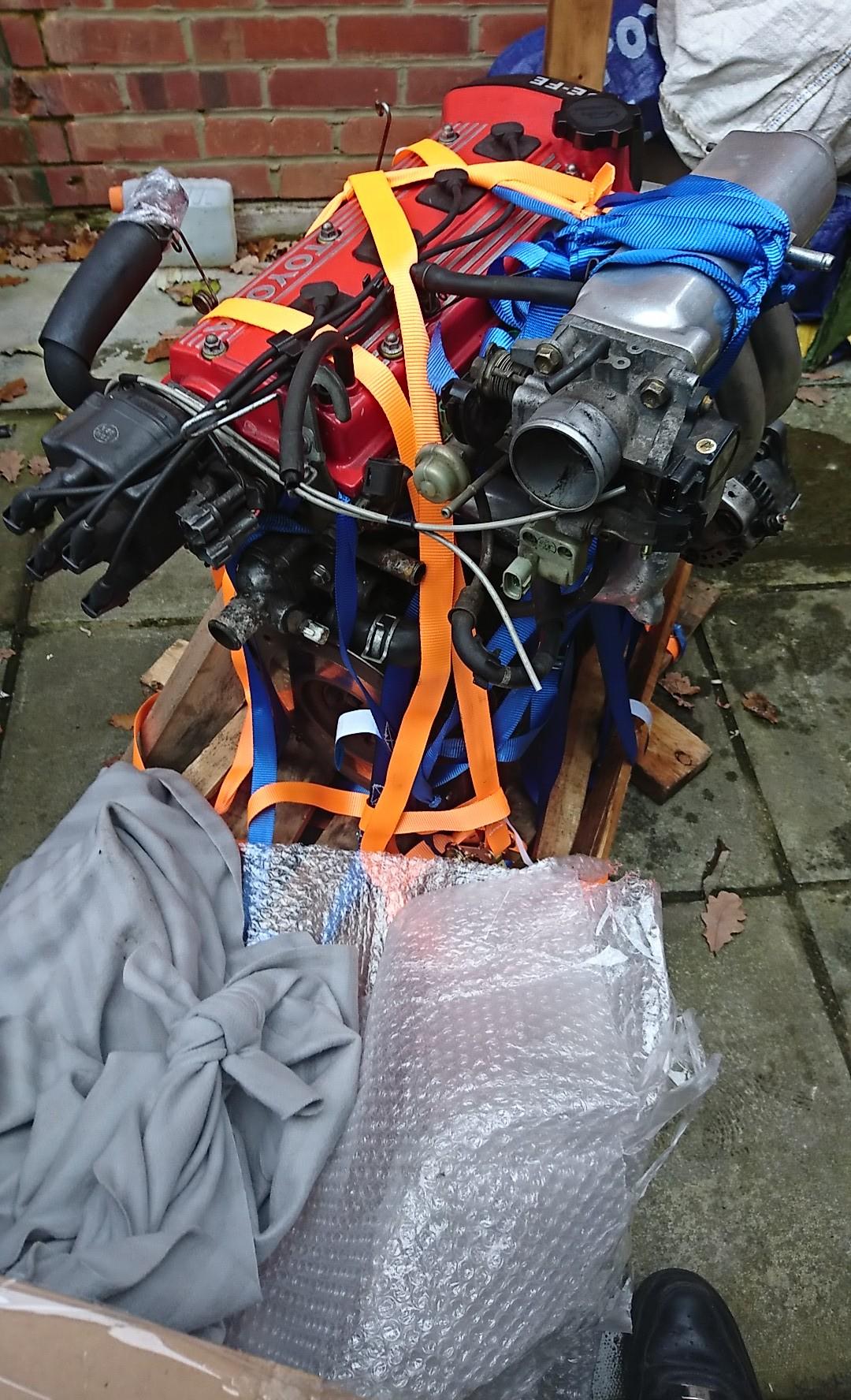

USER_SCOPED_TEMP_DATA_9003b43b8bce961f4ea9b44c3e05838d25025523414025b1aea670aa42de98b9.thumb.jpeg.7c5196d15bf99899d8e0be1d6ef1cddb.jpegUSER_SCOPED_TEMP_DATA_26fab3ad98028ffc2daa35552dddcfc926f512ba43bd17abfc73b7d3e4c319cd.thumb.jpeg.56db15c99e690fa20bf39b671bc884e2.jpegUSER_SCOPED_TEMP_DATA_8883553f502e21f3657e222586ae3ef812c150e3bdc03c1d707c24b14855eeb8.thumb.jpeg.430f21df2ae473f22ec8c706017585de.jpeg

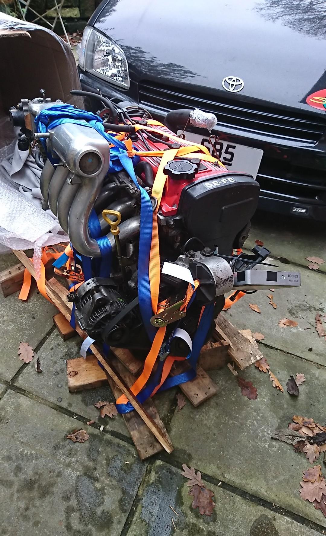

The long awaited 5E-FE that I have been searching for! Got it for a good price, only the shipping hiked it up a bit coming from the Netherlands obviously, but a massive thank you to the guy I got it from for not being greedy and all his assistance making the process as easy as possible
The engine is very clean and looks well looked after, it even came with all the sensors, an ecu and even the power steering bracket, so literally everything is there ready to bolt up and plug straight in. But obviously that's not the plan just yet 😉 still got a lot to do!

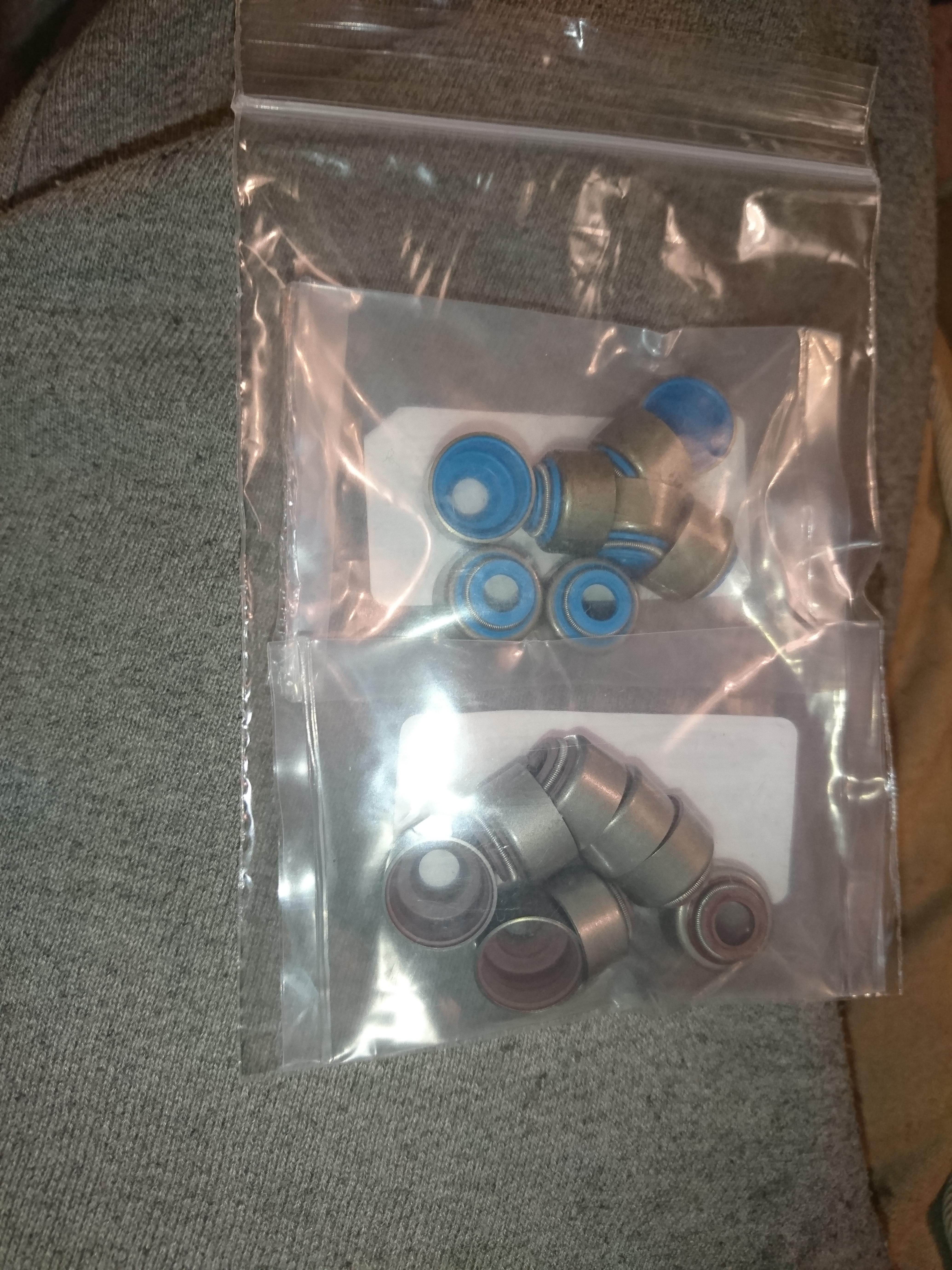

I also bought some supertech uprated valve stem seals but they don't feel as tight as oem seals so im probably not gonna actually use them and stick to the OEM ones. They had mixed reviews anyway but they were cheap enough, if anyone has any experience with these let me know

Not much has been happening still although today i got my camshaft gears back from NOVA racing. They had actually been done a while ago but i have only picked them up today. I will still be taking the 5EFHE cams in to be superfinished also after christmas as I had been exploring the posibility of getting the 5EFHE cams ground to gain a little more lift, but given that they already have 8.4mm lift on the intake side and speedvision cams (which are said to be aggressive) have 9mm lift, I dont think there is that much to gain without effecting the driveability, plus I dont see the point paying £254 for the sake of having less than a milimeter of material removed to match the speedvision cams.
If I was in a position right now to properly check what the maximum valve clearance was to know how much I could actually take off & what effect it would have on day to day driveability then maybe I would go ahead.

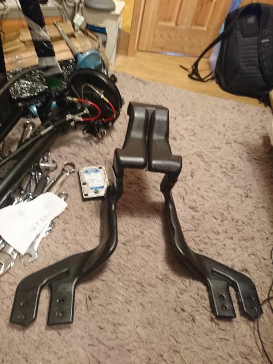

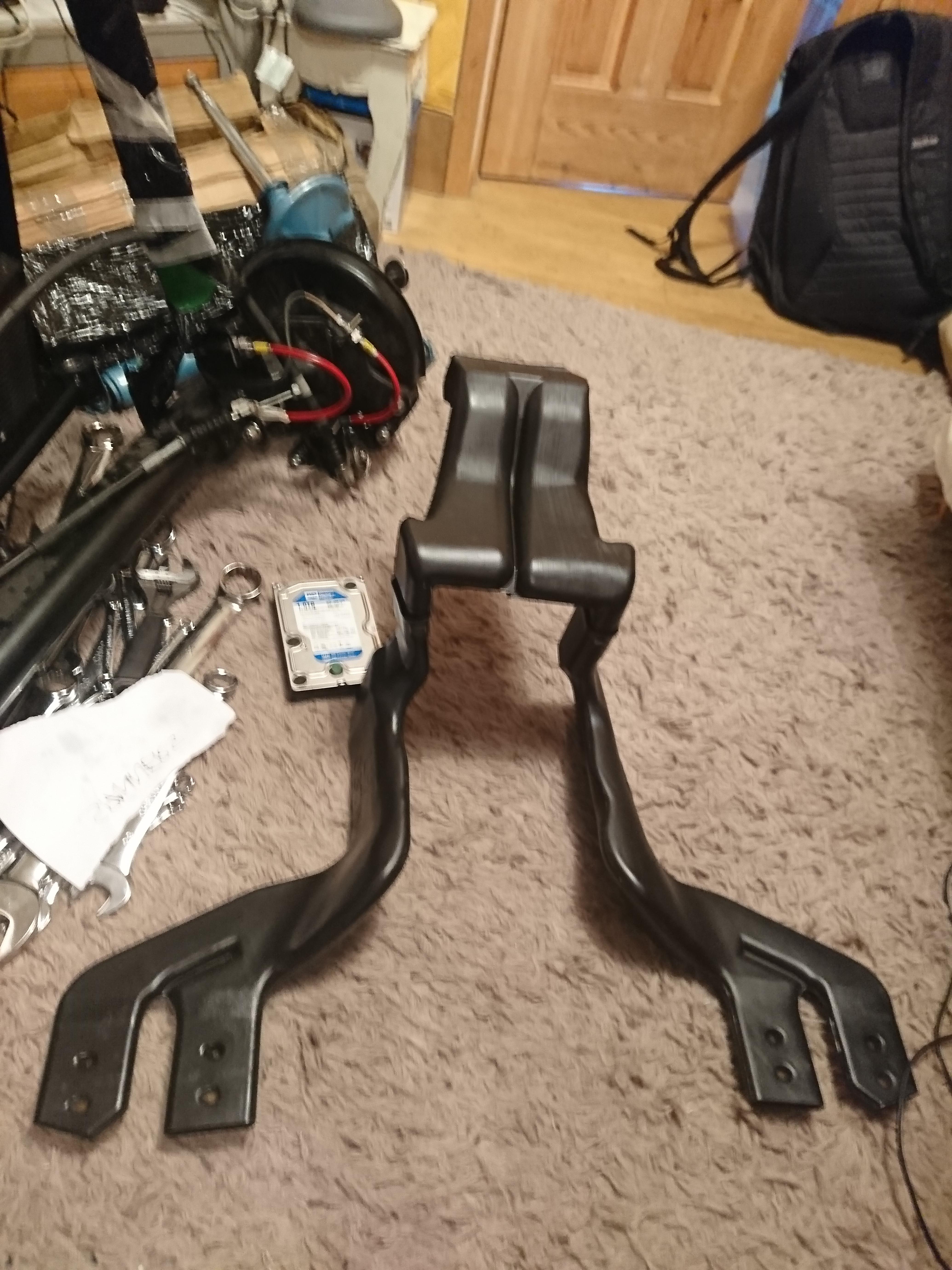

Had a delivery from the USA! Some optional extra rear heater ducts, well, they would be optional extra for a starlet although these came off a Toyota Tercel (they share the same part numbers!)

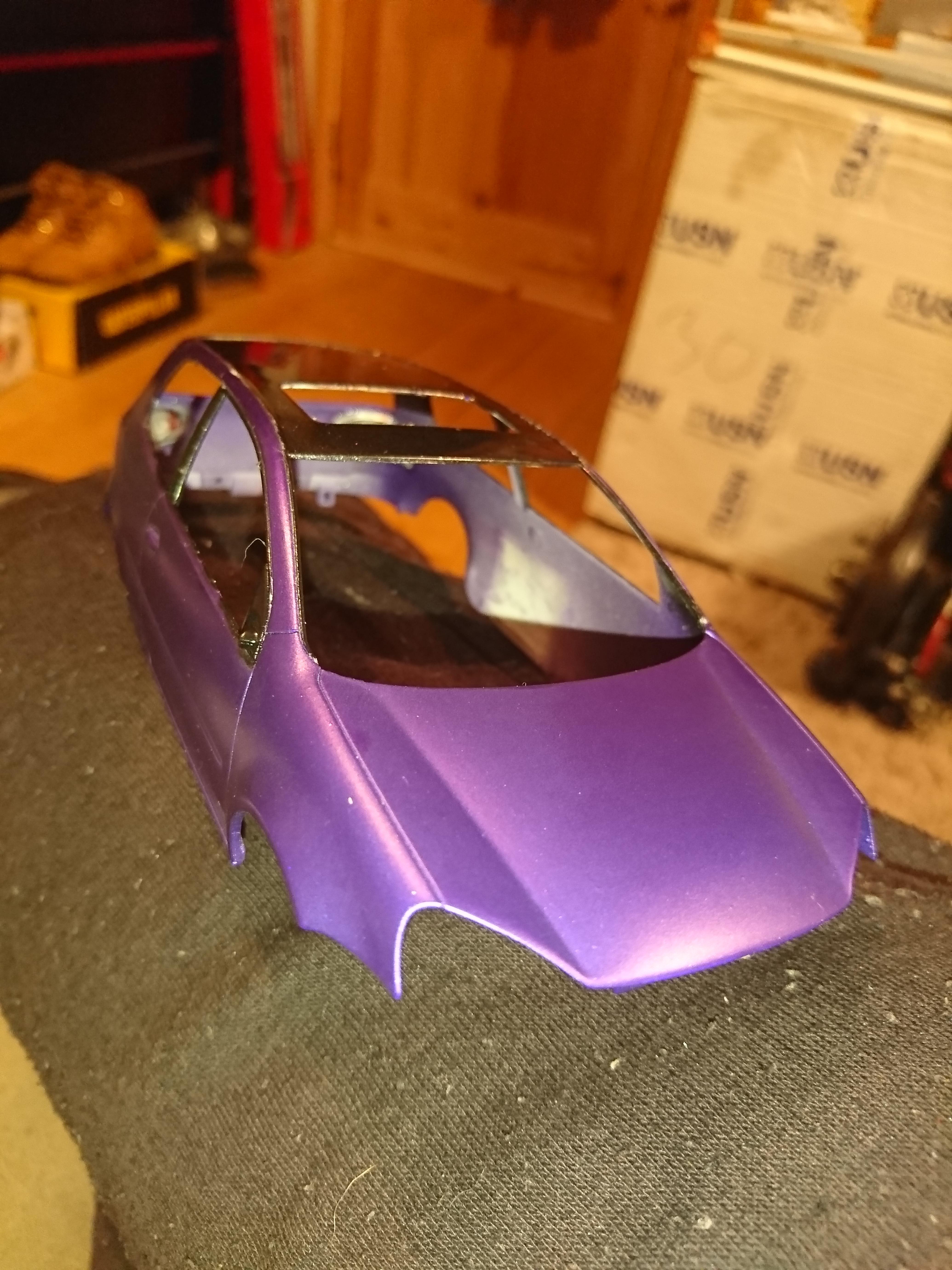

Lastly, even though this is totally unrelated to the SR, I have been getting on with the replica model of my pals car that I started a few years ago & mentioned in earlier posts. I have finished the most of the airbrushing (Matt metallic purple body, gloss metallic black roof with purple pearl, and Audi R8 Spyder wheels), just need to get on with the assembly which is quite fiddly
DSC_0176.thumb.JPG.a95ff5e7c5e175c8cb394cd4bd0af4e5.JPGDSC_0177.thumb.JPG.06b2a430dc294d7316f70a1d60b7ec41.JPGDSC_0178.thumb.JPG.01898ce55fc33b9afabd631367ae92d5.JPGSnapchat-1080673673.thumb.jpg.734e841ead3f93eeea94fe765e006d28.jpgSnapchat-703645222.thumb.jpg.3eff748bb3ec306566c889f4cebc40e2.jpg
I really wish they made a model kit of an EP91 starlet, Glanza or even an SR, would love to build one. I have even been asked by an old member here to make him one of his Honda Civic EK9 Type-R.

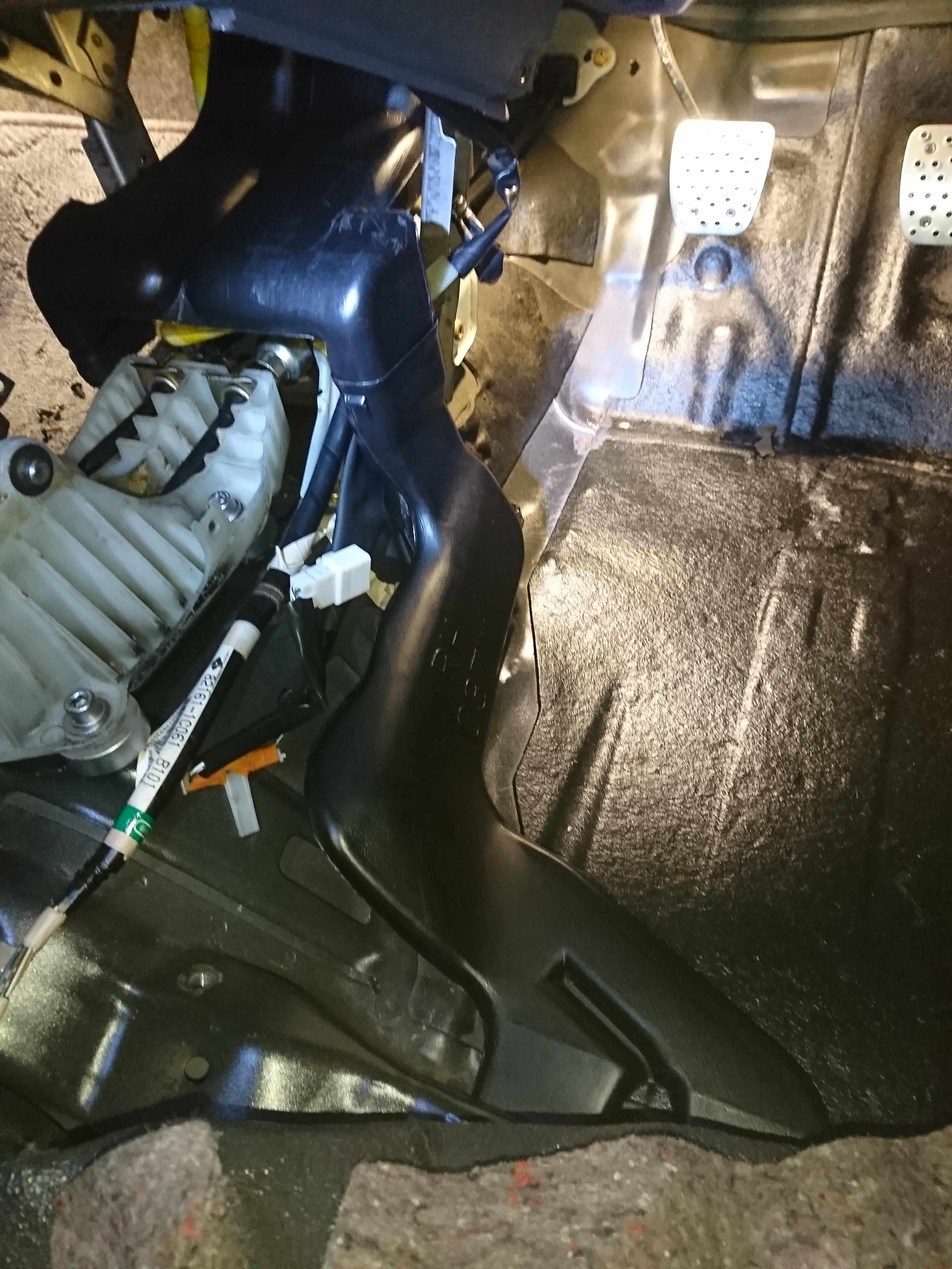

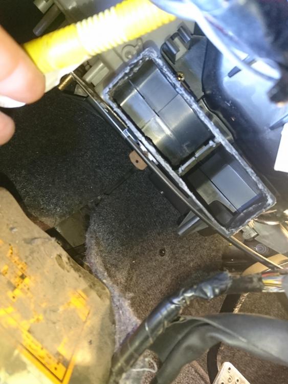

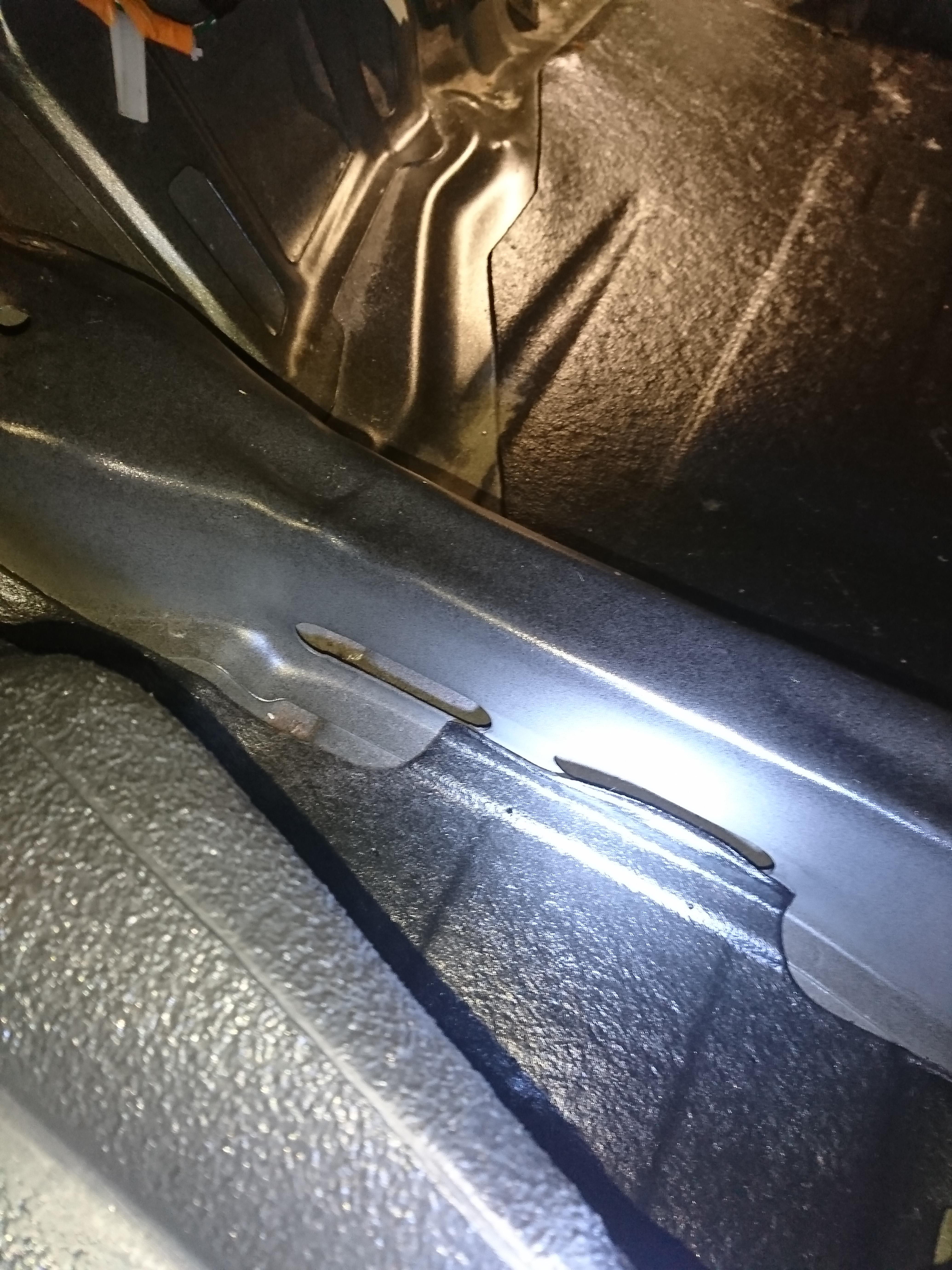

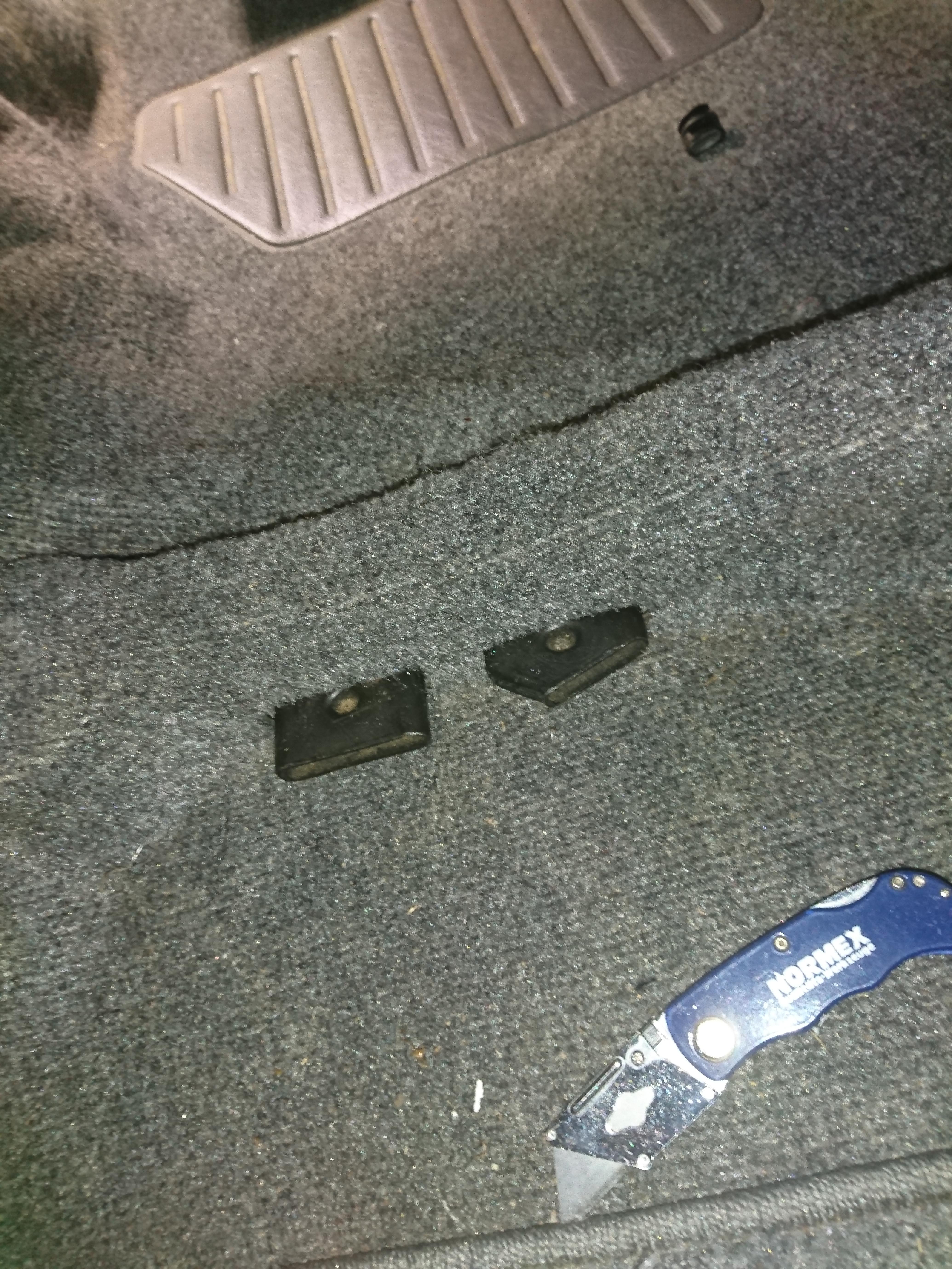

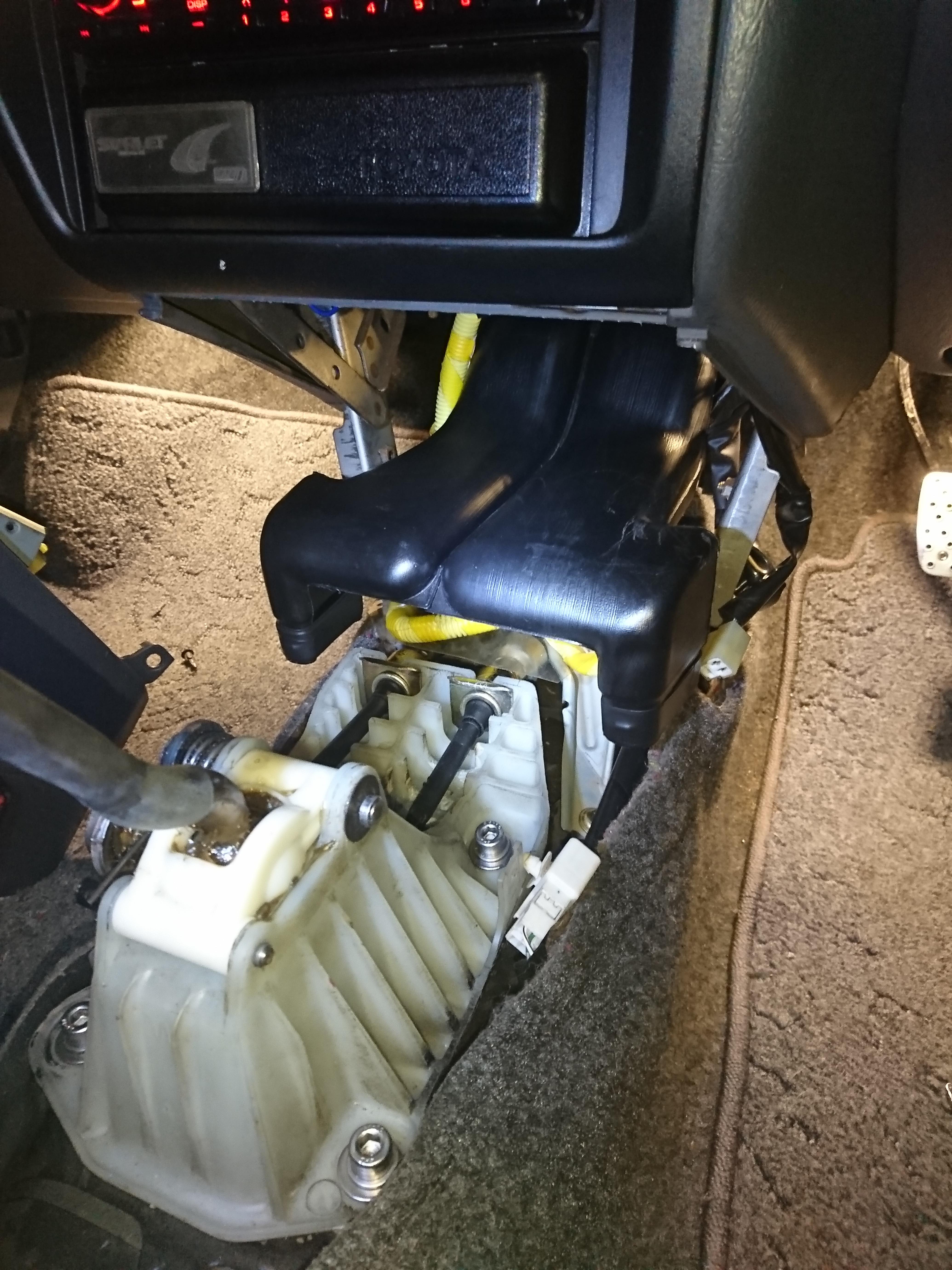

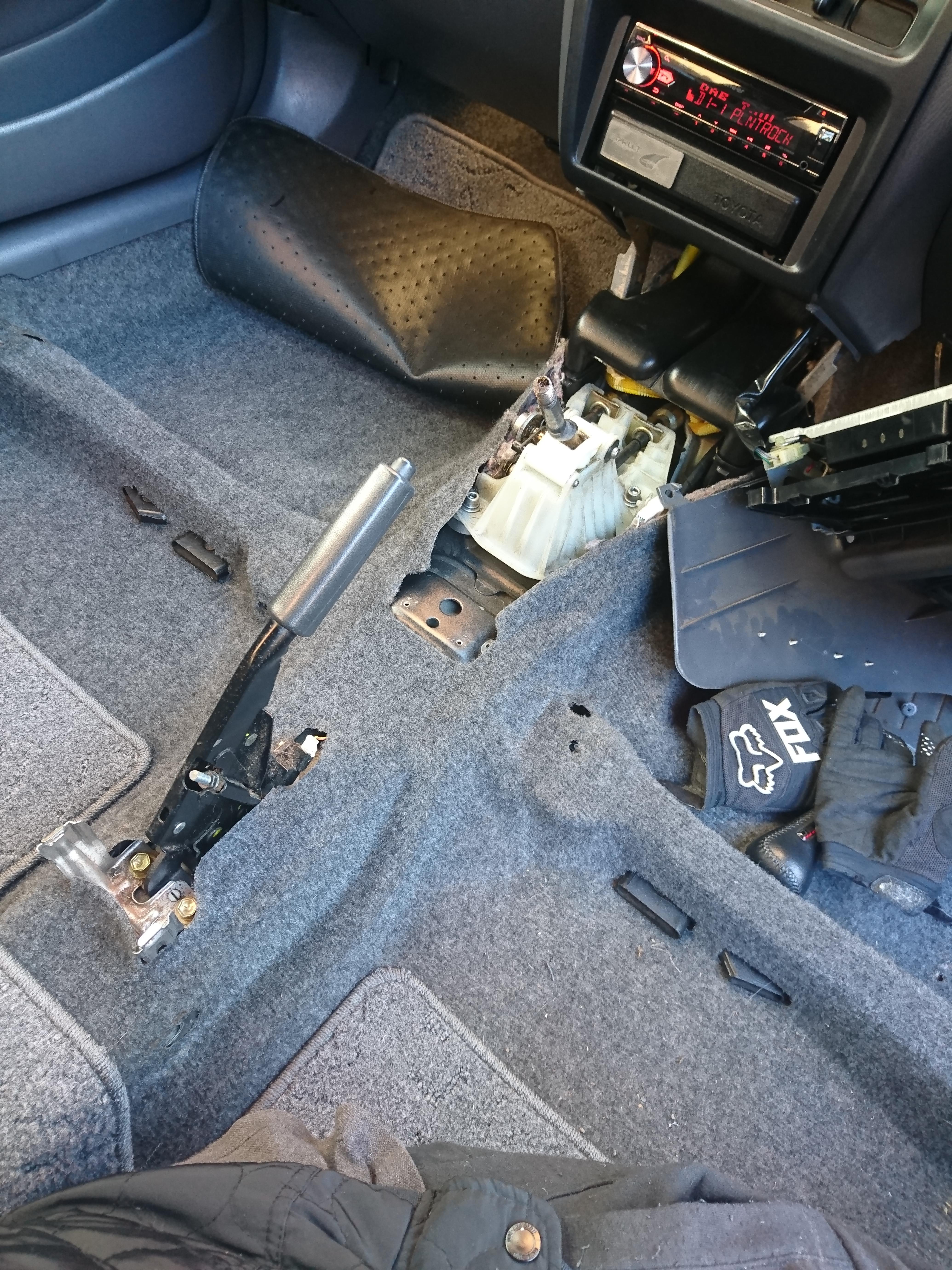

Fitted the rear passenger heater ducts. First had to cut out the part of plastic that blocks where the ducting would be, I did this with a hot knife
DSC_0196.thumb.JPG.a4b4027648727e72b449102acea968bd.JPGDSC_0198.thumb.JPG.ff7f720704df275a3c8e2b4dd67dfb63.JPGDSC_0199.thumb.JPG.cd277bc3c22edfcc92f006a5dd9e33d7.JPG
Holes/slots already cut out from factory specifically for these 👌🏻
DSC_0201.thumb.JPG.f1dfebdbb1a8914c0742a523cdbef3f0.JPGDSC_0203.thumb.JPG.77c990ba537eff06d7839443a6c2bffc.JPG

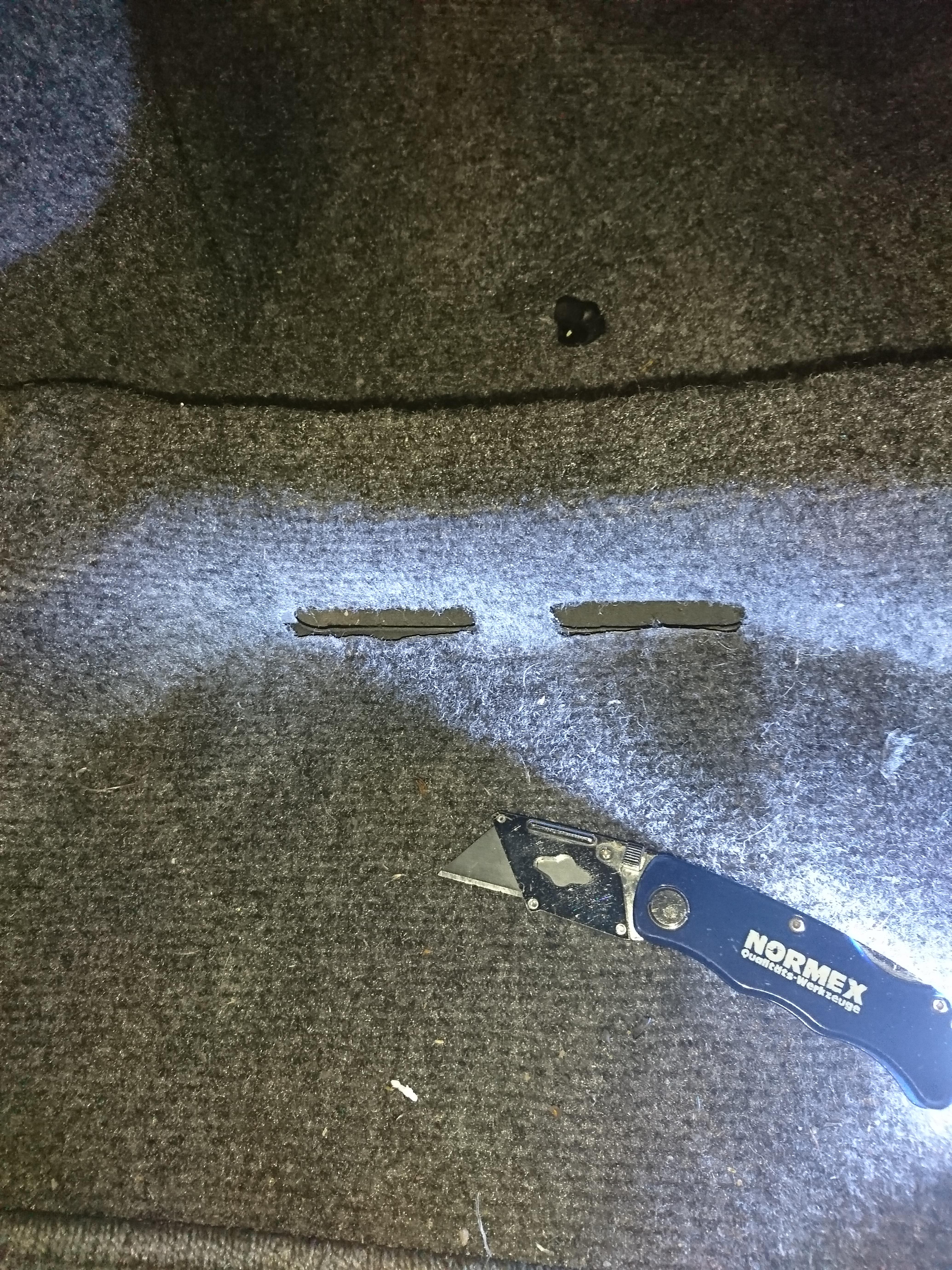

Then all I had to do was cut out slots in the carpet to suit
DSC_0202.thumb.JPG.4dfff5cf6d5f372985589b5652ab9d4f.JPGDSC_0204.thumb.JPG.e4ccc27076697e7c1fb278bc700365d6.JPGDSC_0207.thumb.JPG.7843507cadee5b435f8beece0f99df09.JPG
One observational note is that clearly there is a specific carpet that is supposed to go with these that forms around the ducting. It's not a massive issue but it just means the carpet around the center console doesn't quite sit right, but I think it's in the summer once the weather picks up, the heat will probably help it form itself over time.
Was it worth it? Probably not 😂 but c'mon, it's another optional extra on the list!
