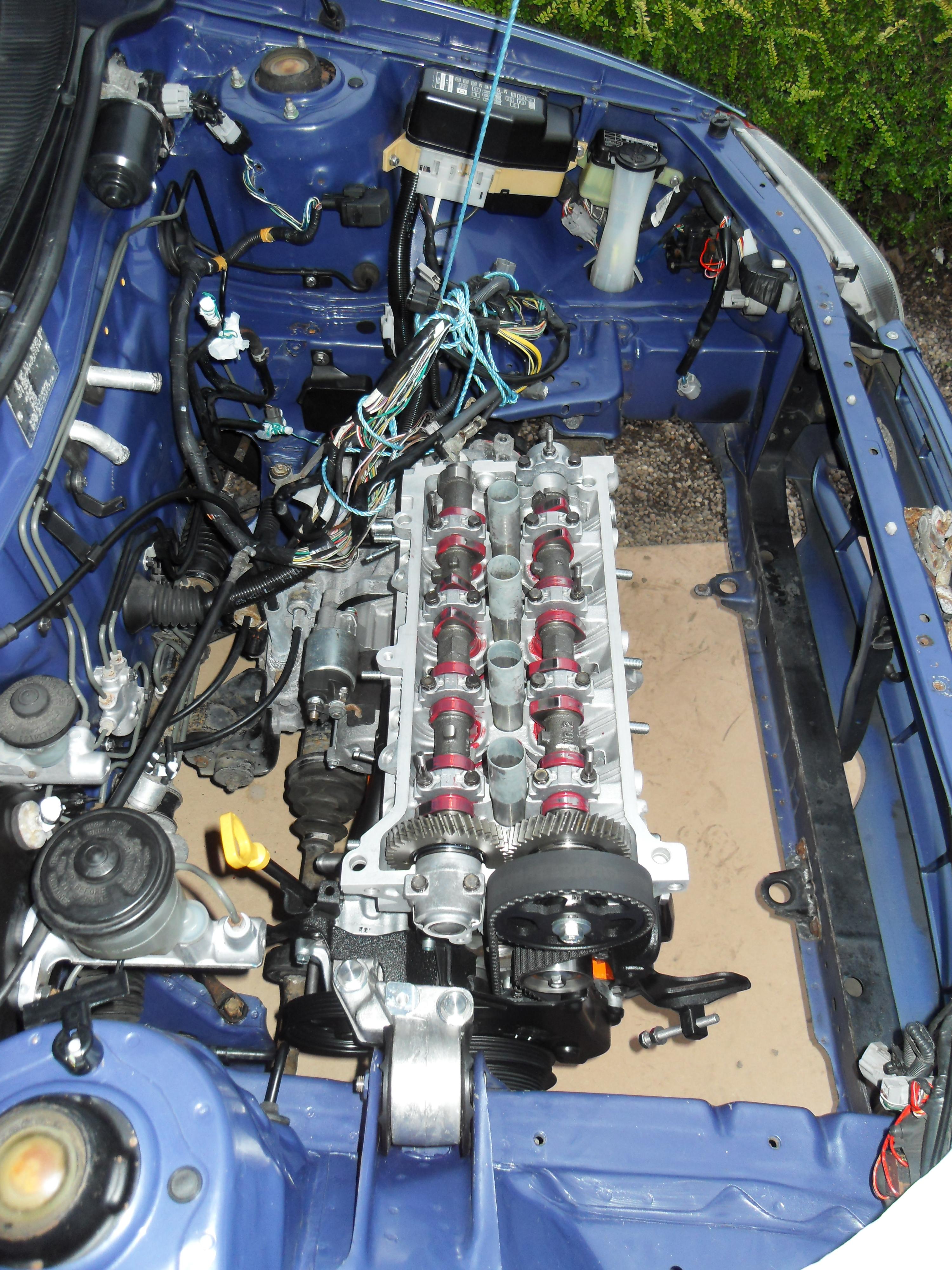

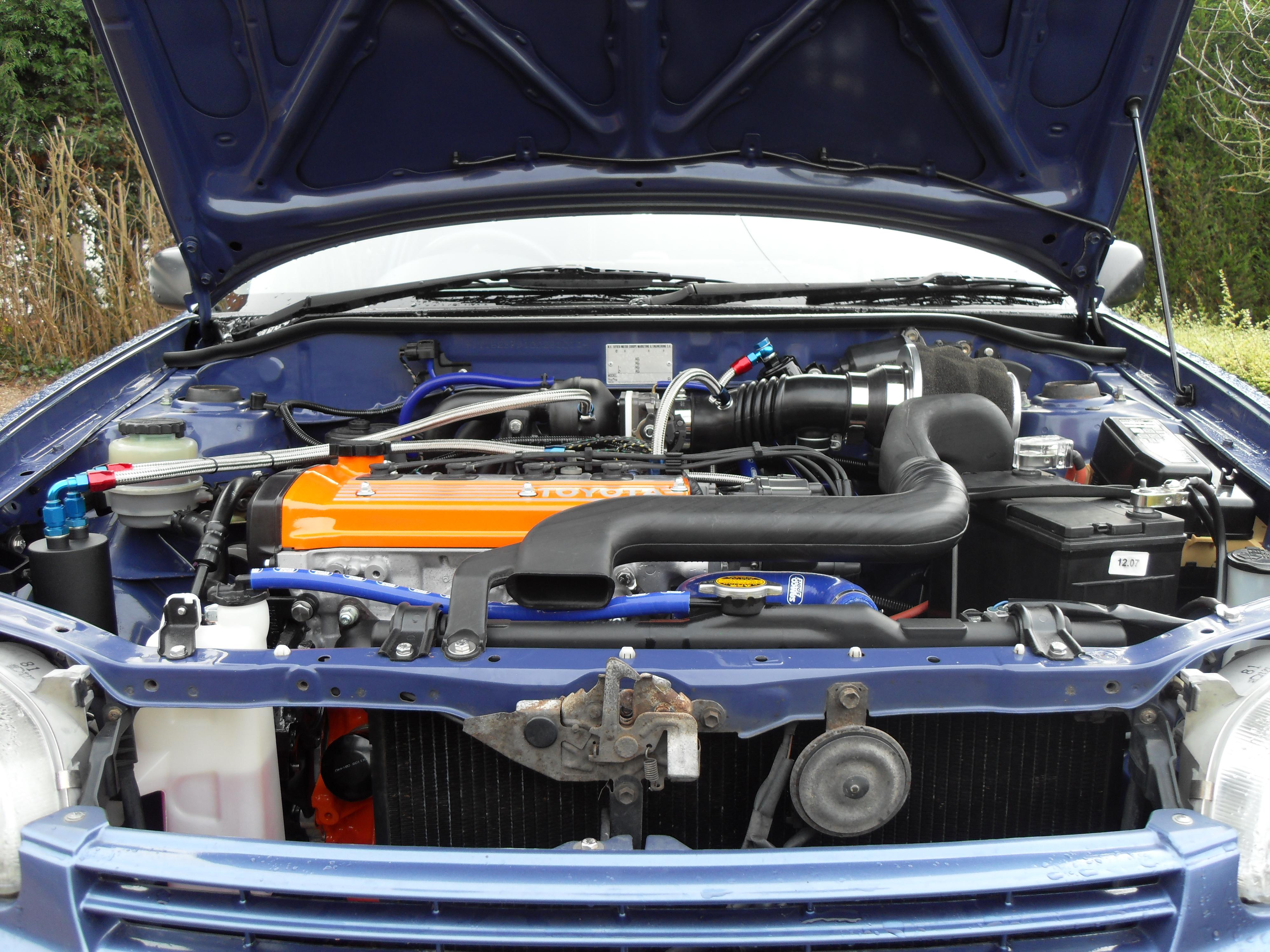

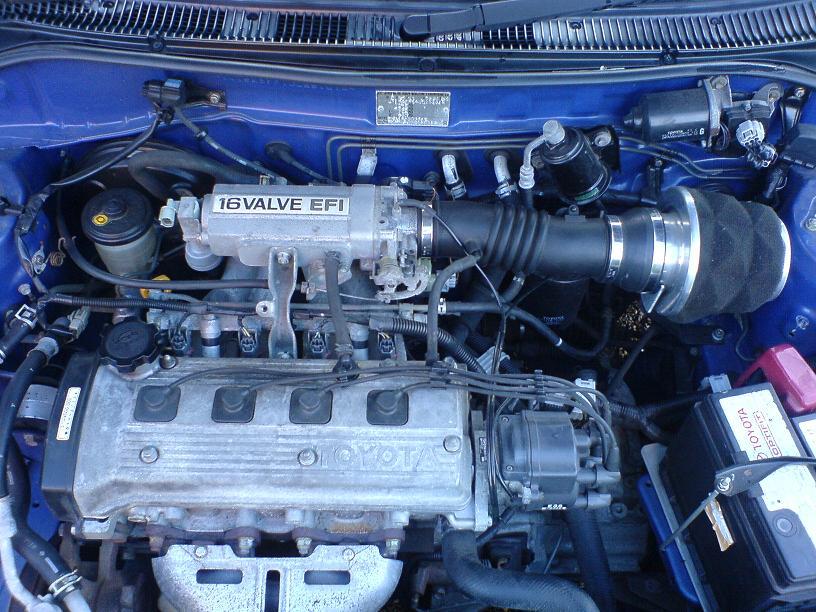

Old photo for reference

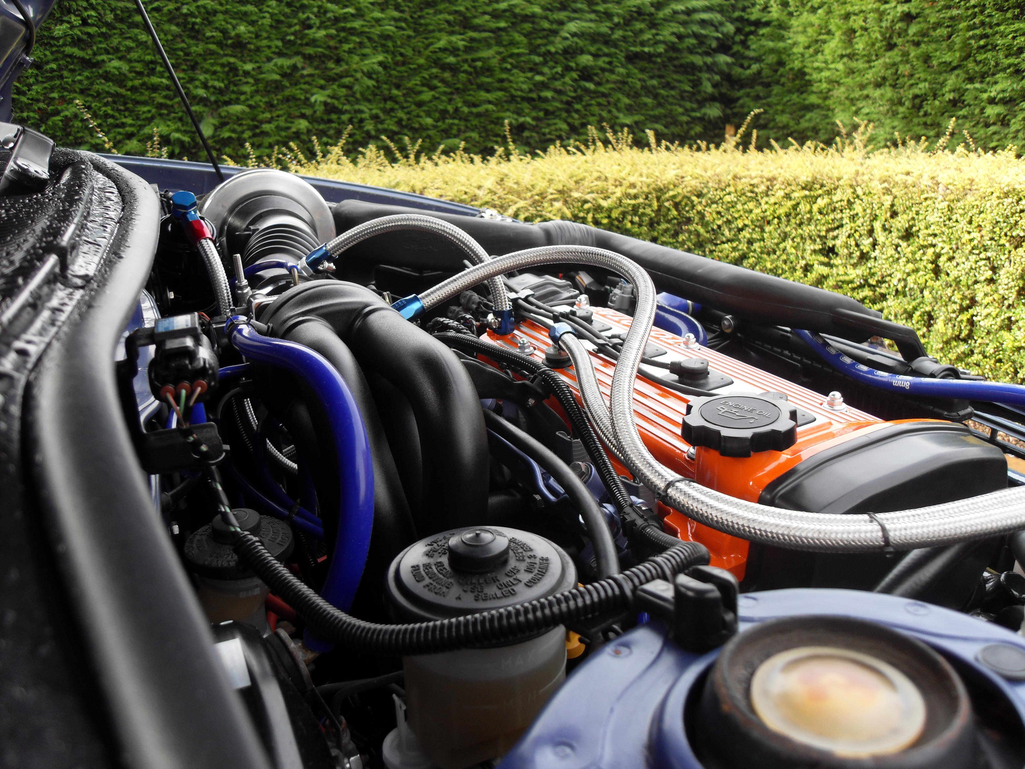

How the engine stands now

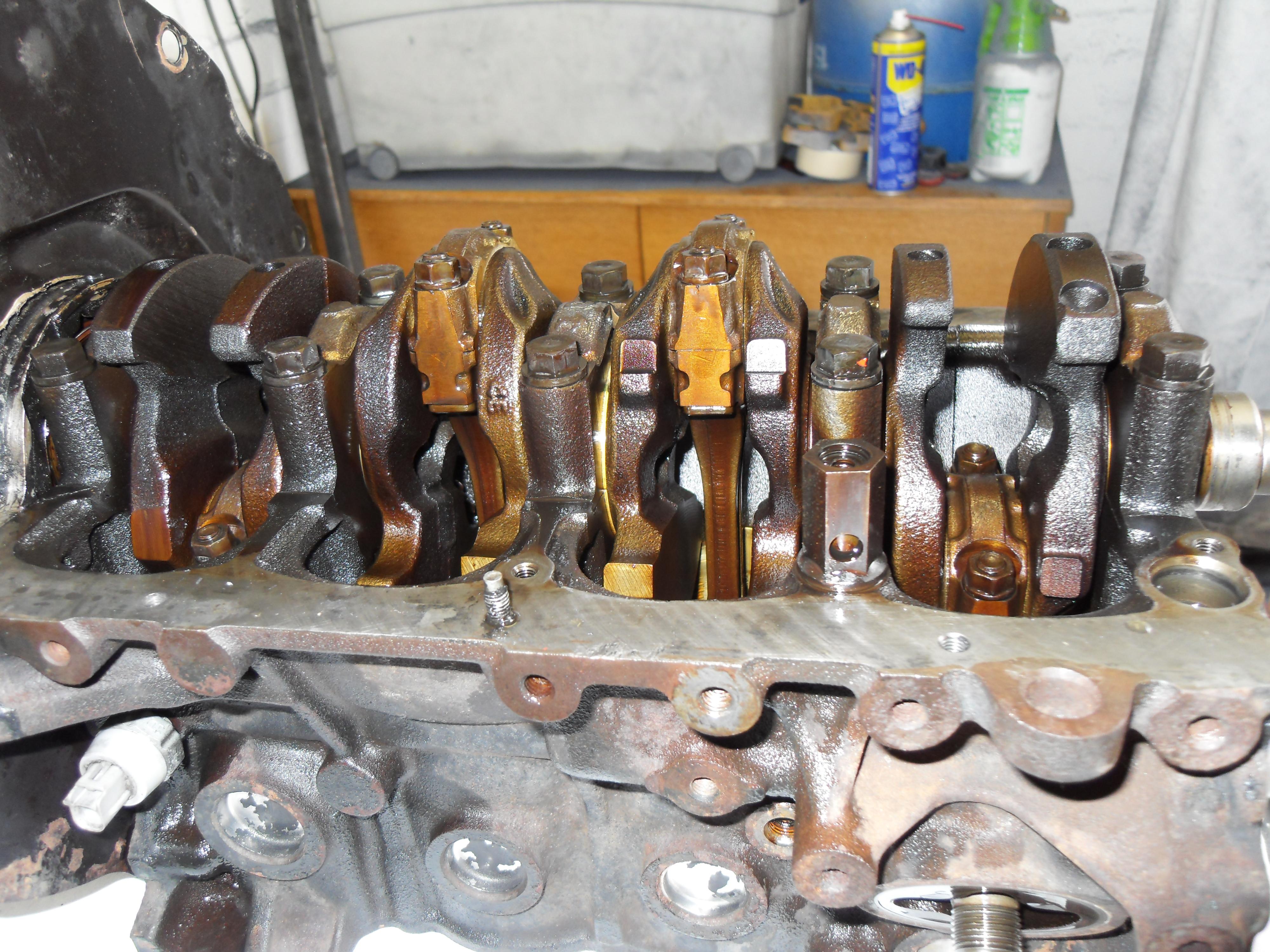

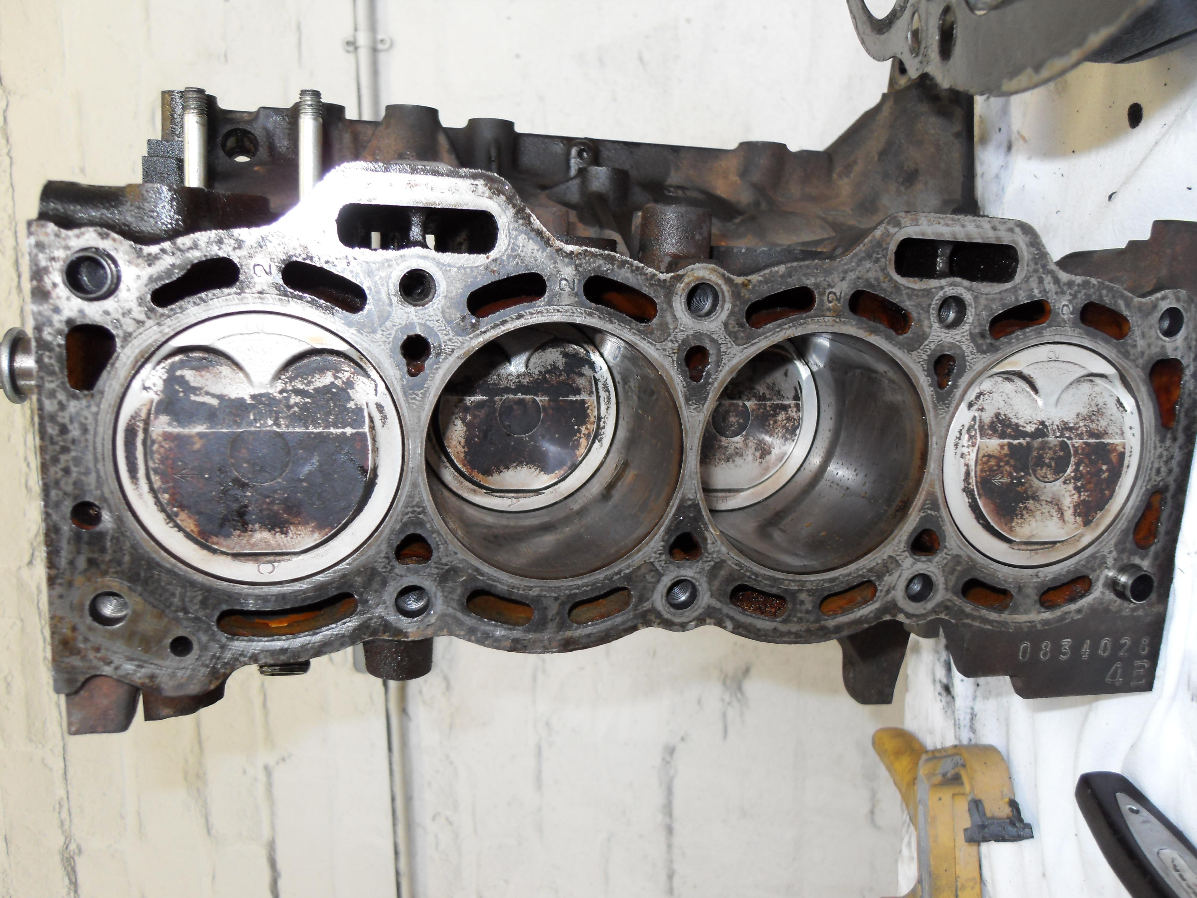

I've had my 1997 Starlet Sportif for four years now un-modded apart from an engine from a Gi and a filter. I drove it hard and it started to burn oil lots of oil.
I thought of a turbo conversion but I like instant N/A power so I decided to rebuild with one or two little tweeks.
I love Toyota!! After an estimated 100,000 miles I pull this engine apart and there is very little ware.
First this is a before shot

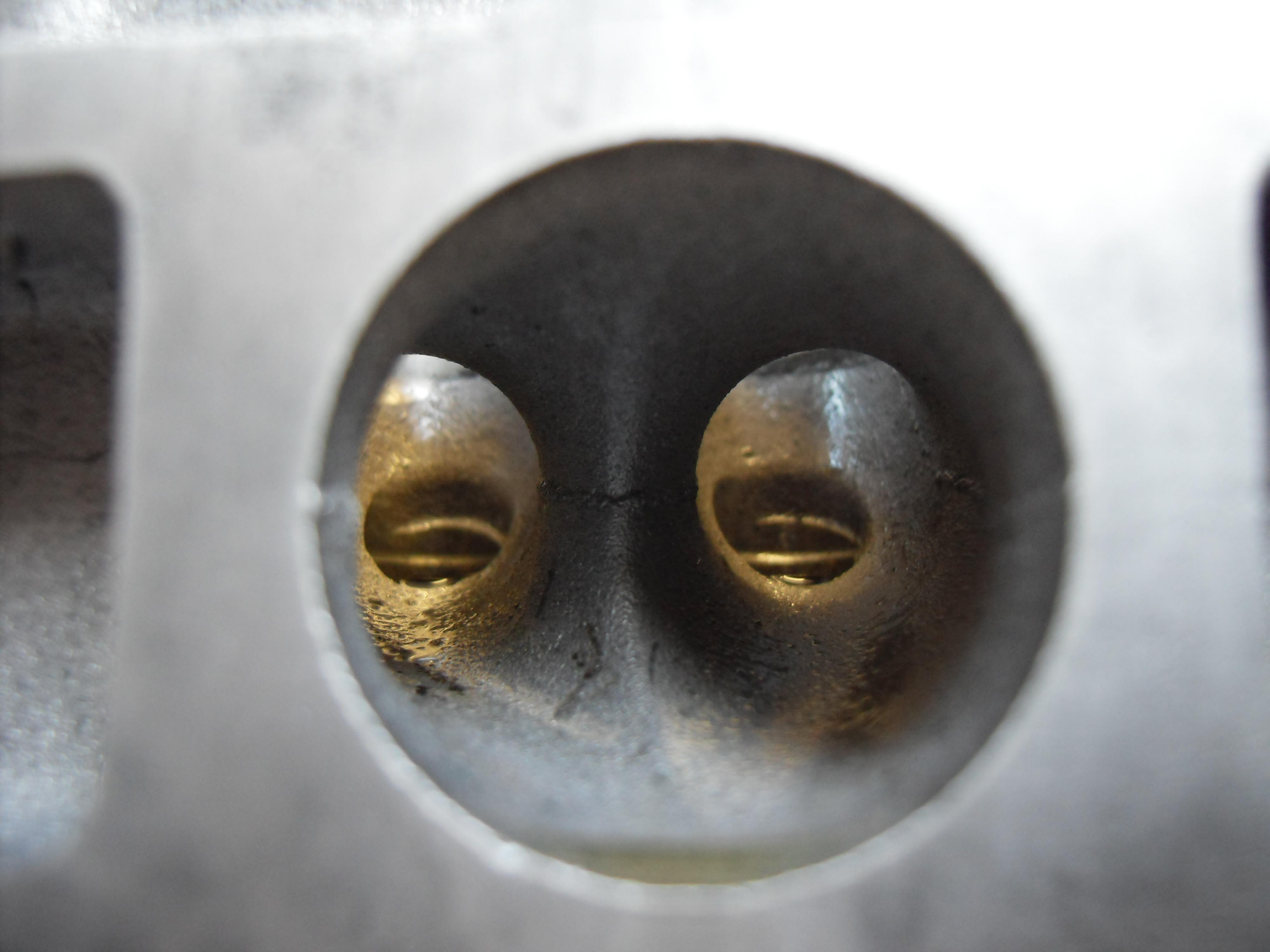

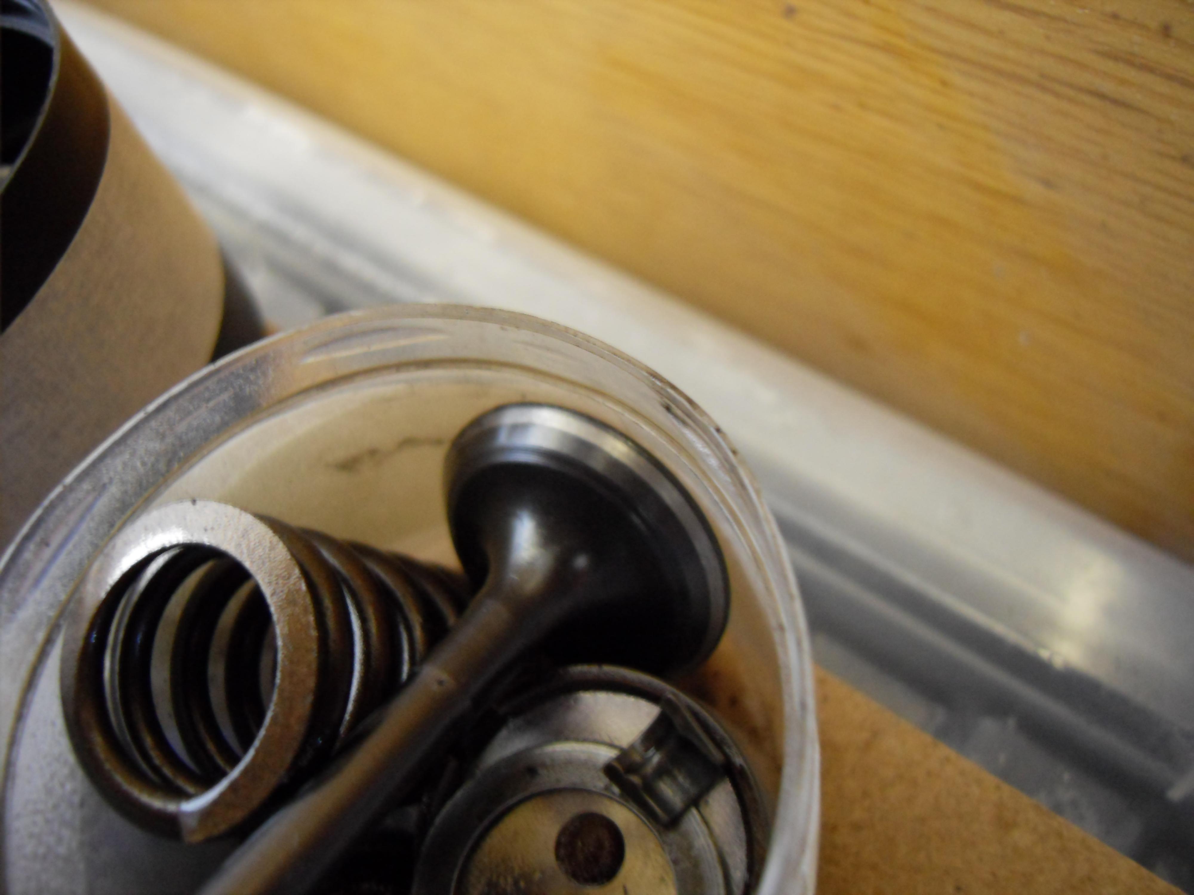

I would like to take this opportunity to further confirm that I believe this engine to be assembled from mainly turbo components this is my guess...
Rods = Looks like 4E-FTE
Valve Springs = Look likes 4E-FTE
Sump = 4E-FTE (It's Baffled)

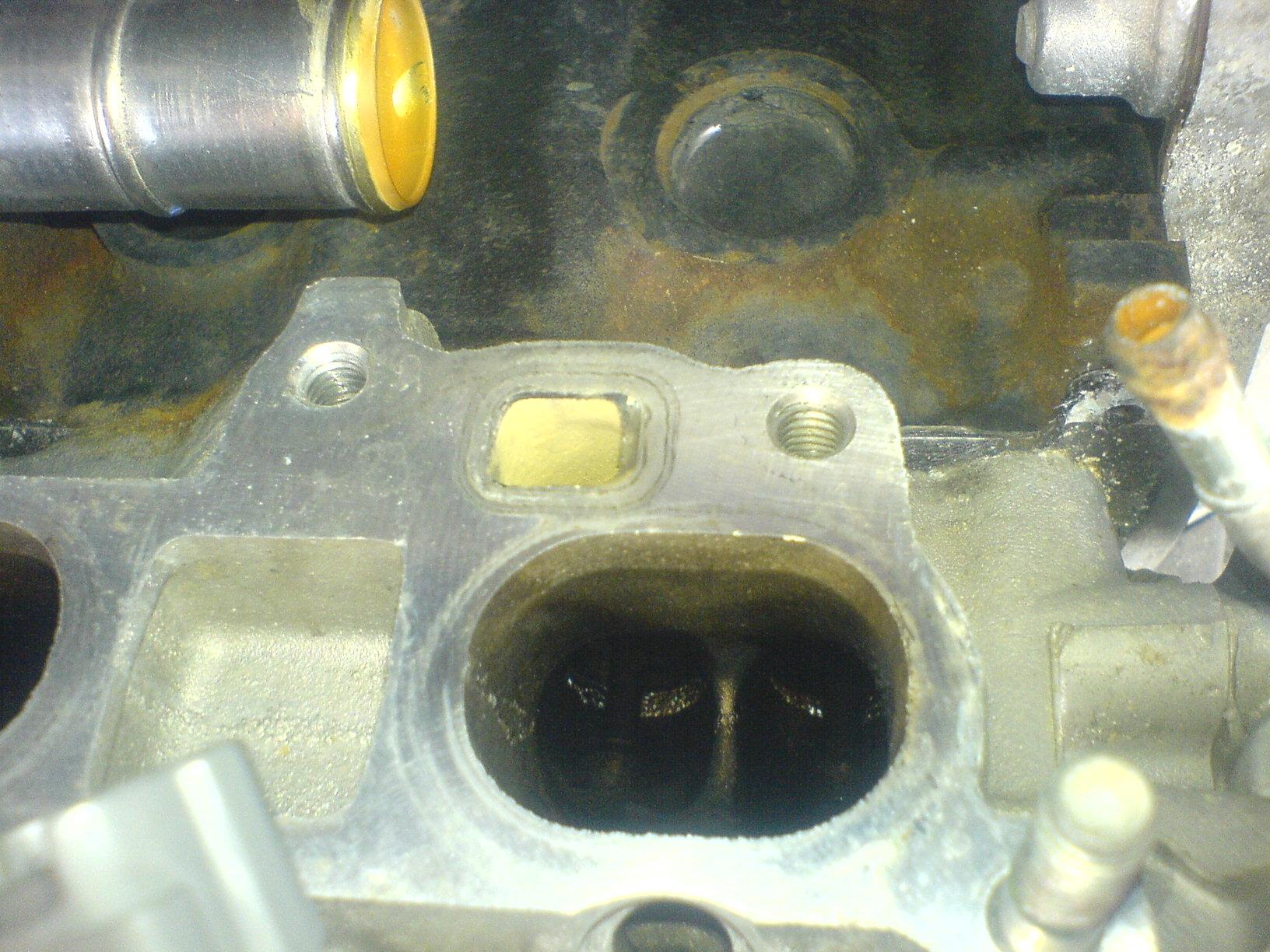

Head = Early 4E-FTE (Not to sure has an extra water channel in the head)
Crank = Who knows
SDC10403.thumb.JPG.d2f5c8ab3fd4d9368aee8d24daf70a78.JPGDSC00433.thumb.JPG.8ac9a89c34773b6966ac4af583eca93d.JPG

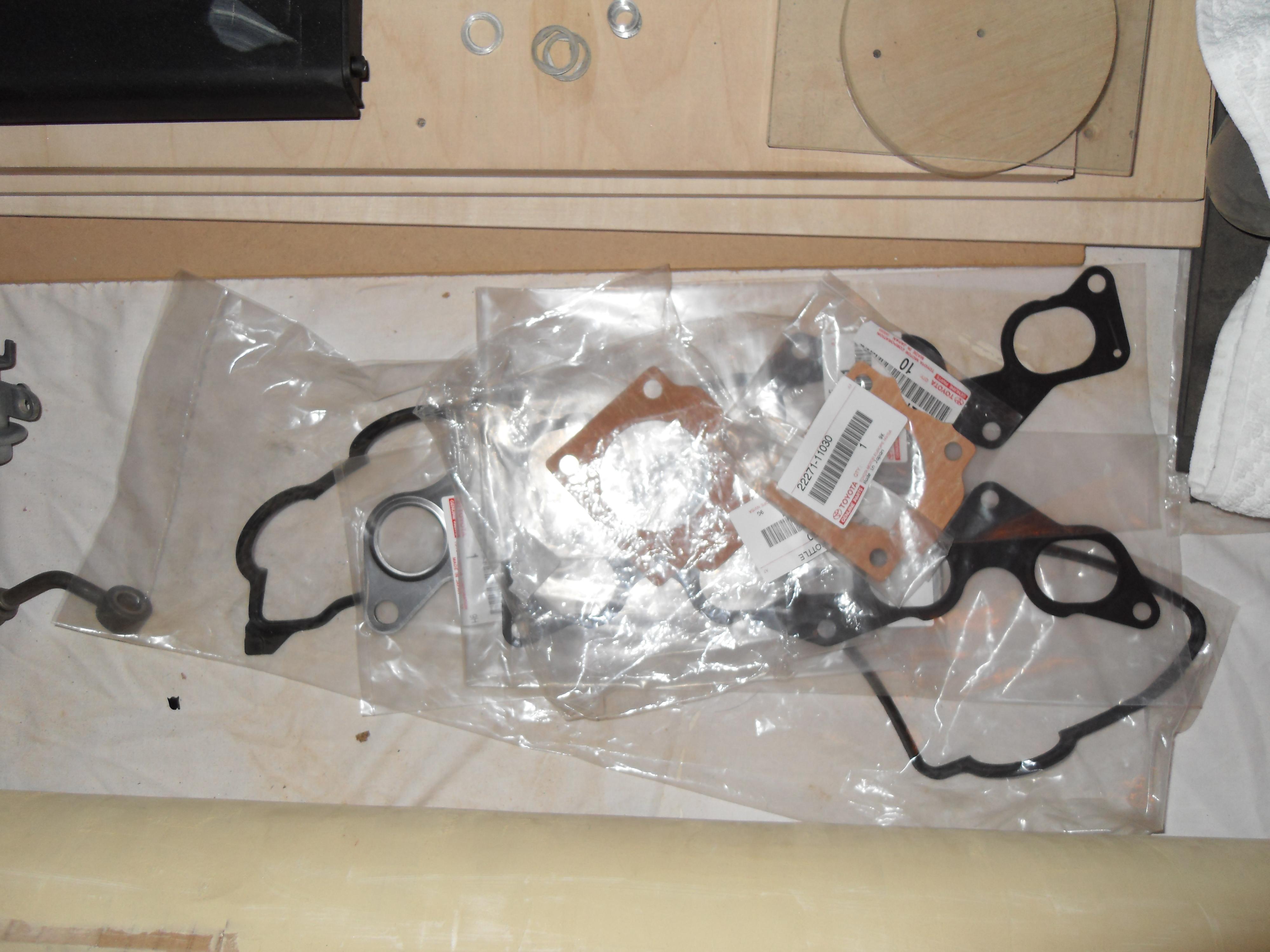

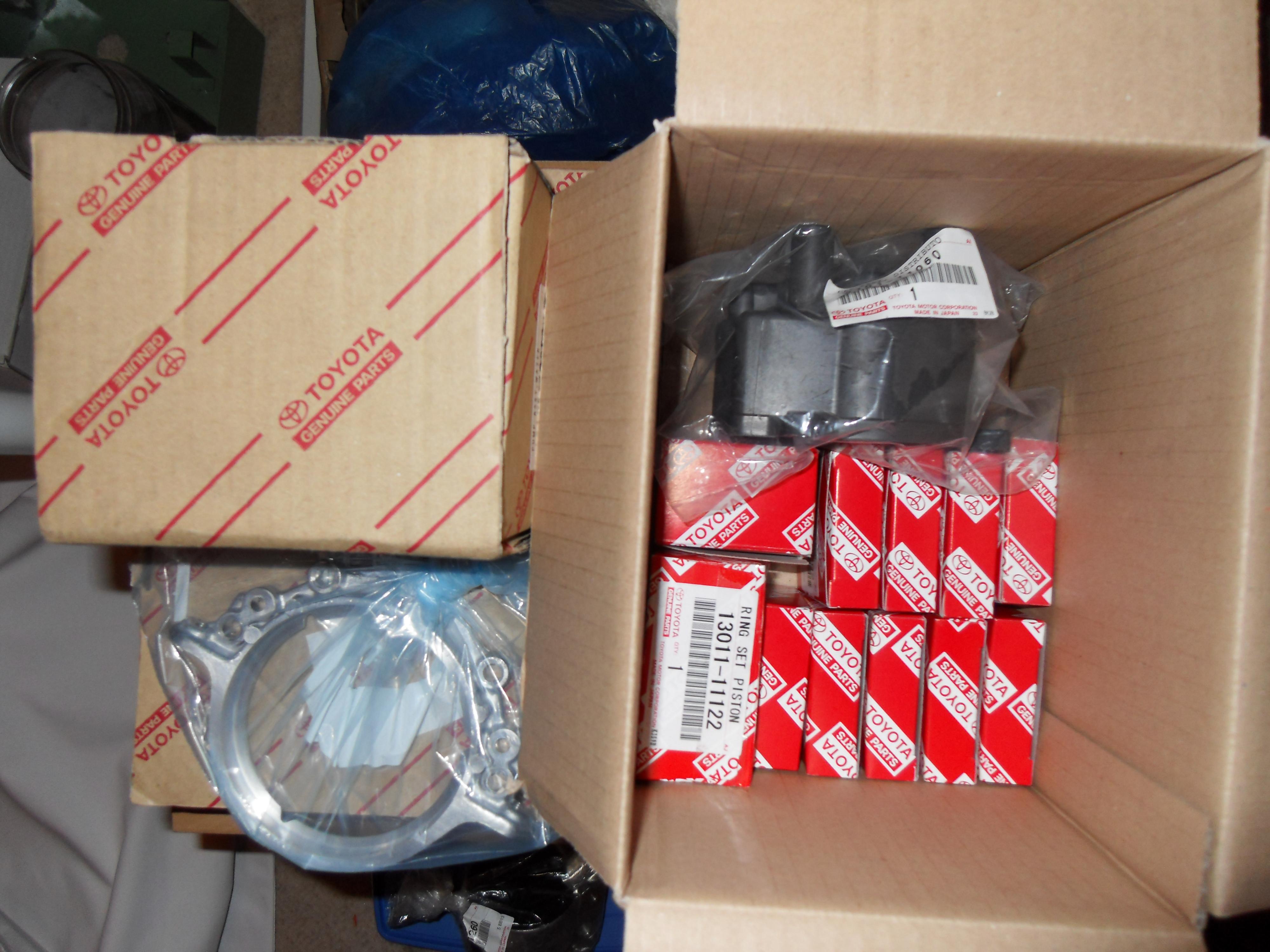

This engine is going to be rebuilt with...

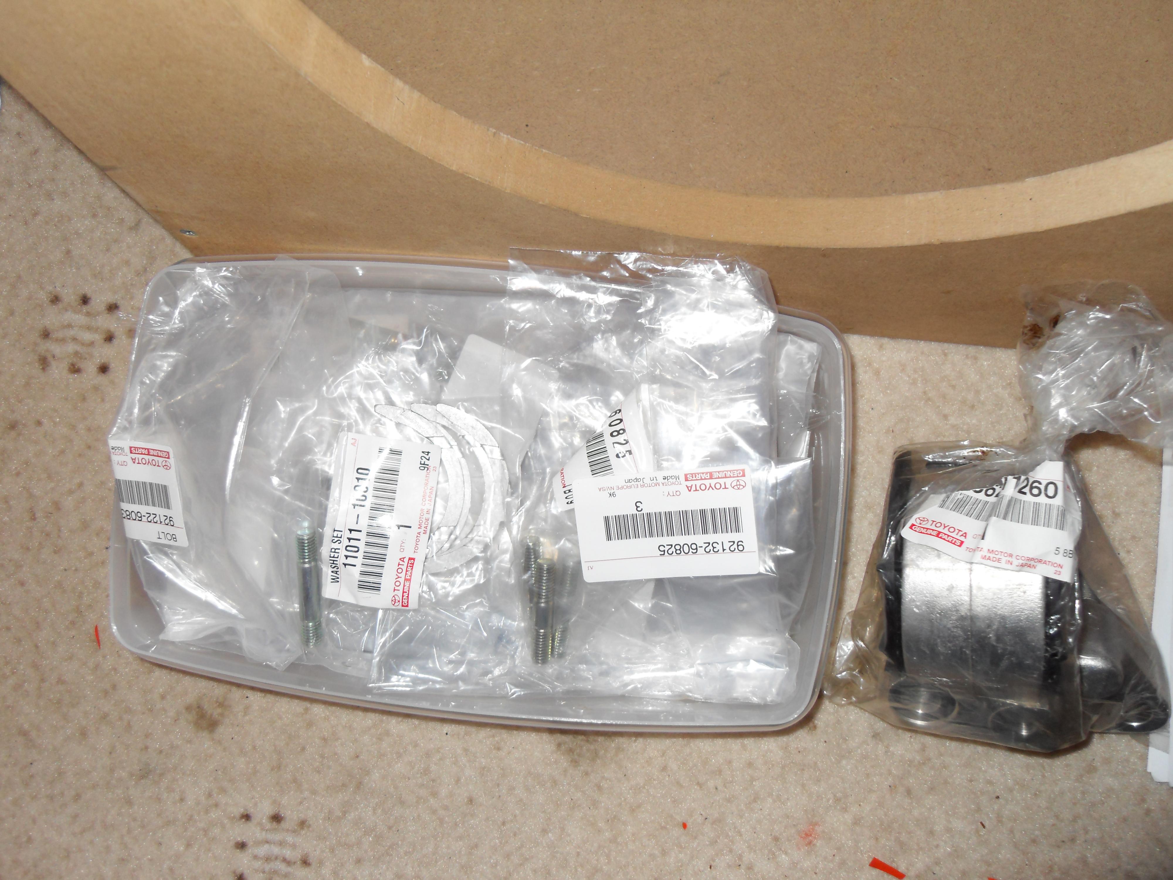

New genuine toyota parts consisting of...
Oil Pump
Water Pump
Gasket Kit
Main shells
Big end shells
Piston rings
Thrust bearings
Distributor and rotor arm
Trd 0.6mm head gasket
a second hand Glanza/Corolla intake mani

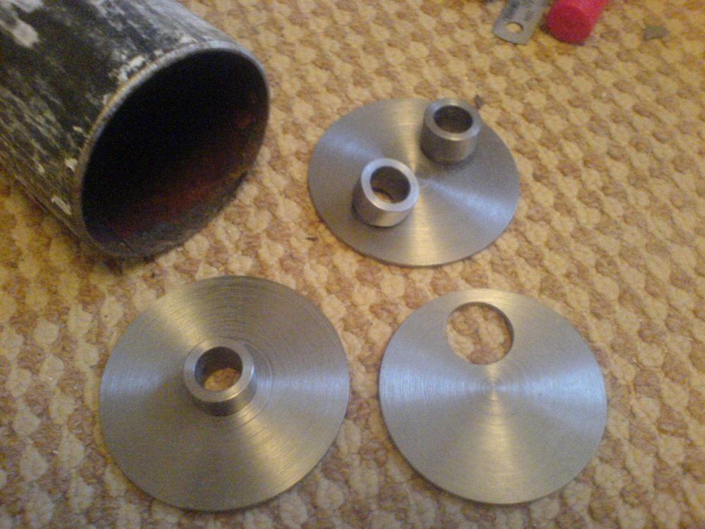

Some custom made (by me) parts consisting of
Catch can

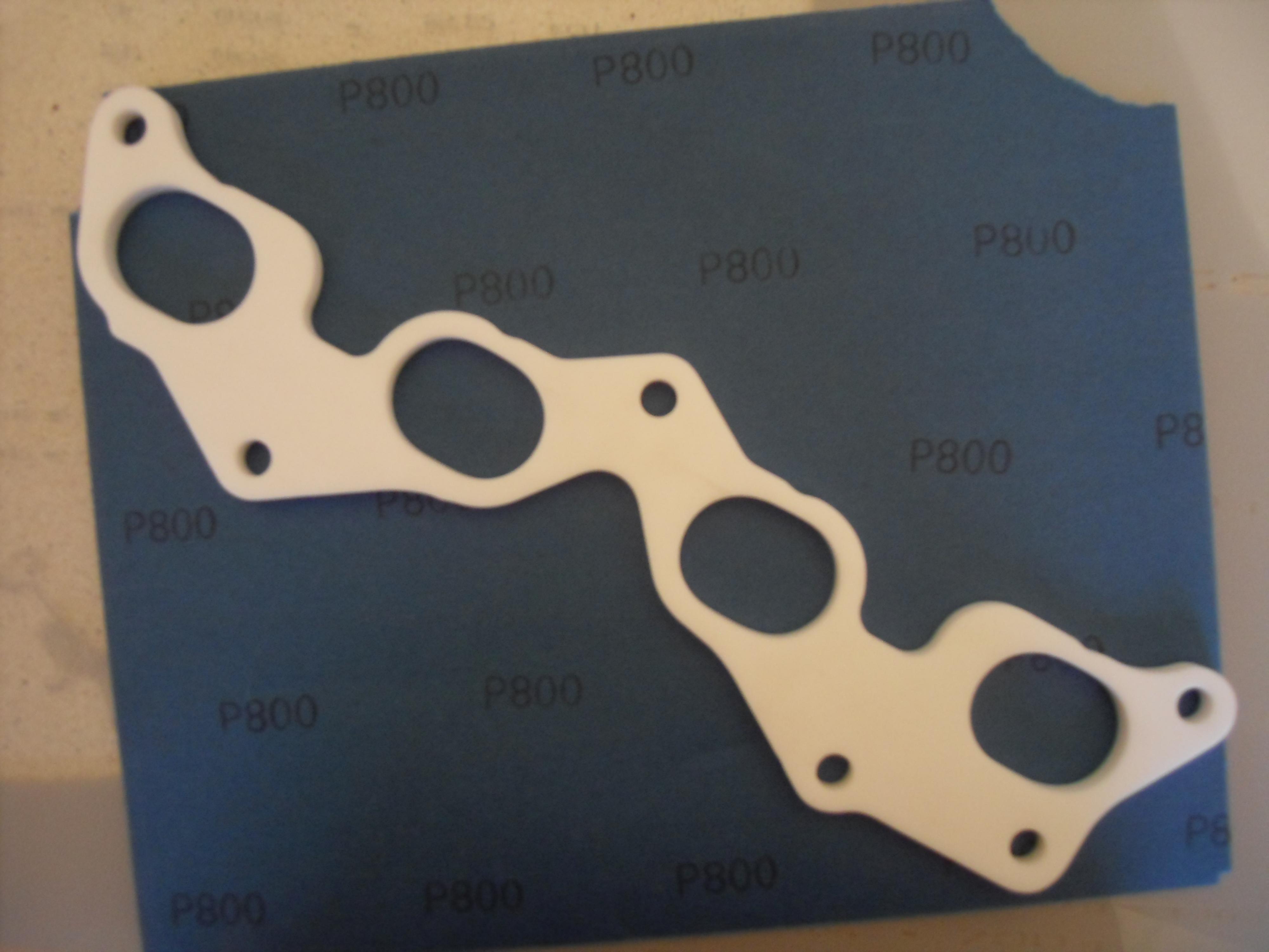

Teflon manifold insulator (To insulate and to seal the extra water channel in the head)
Teflon thtottle body insulator

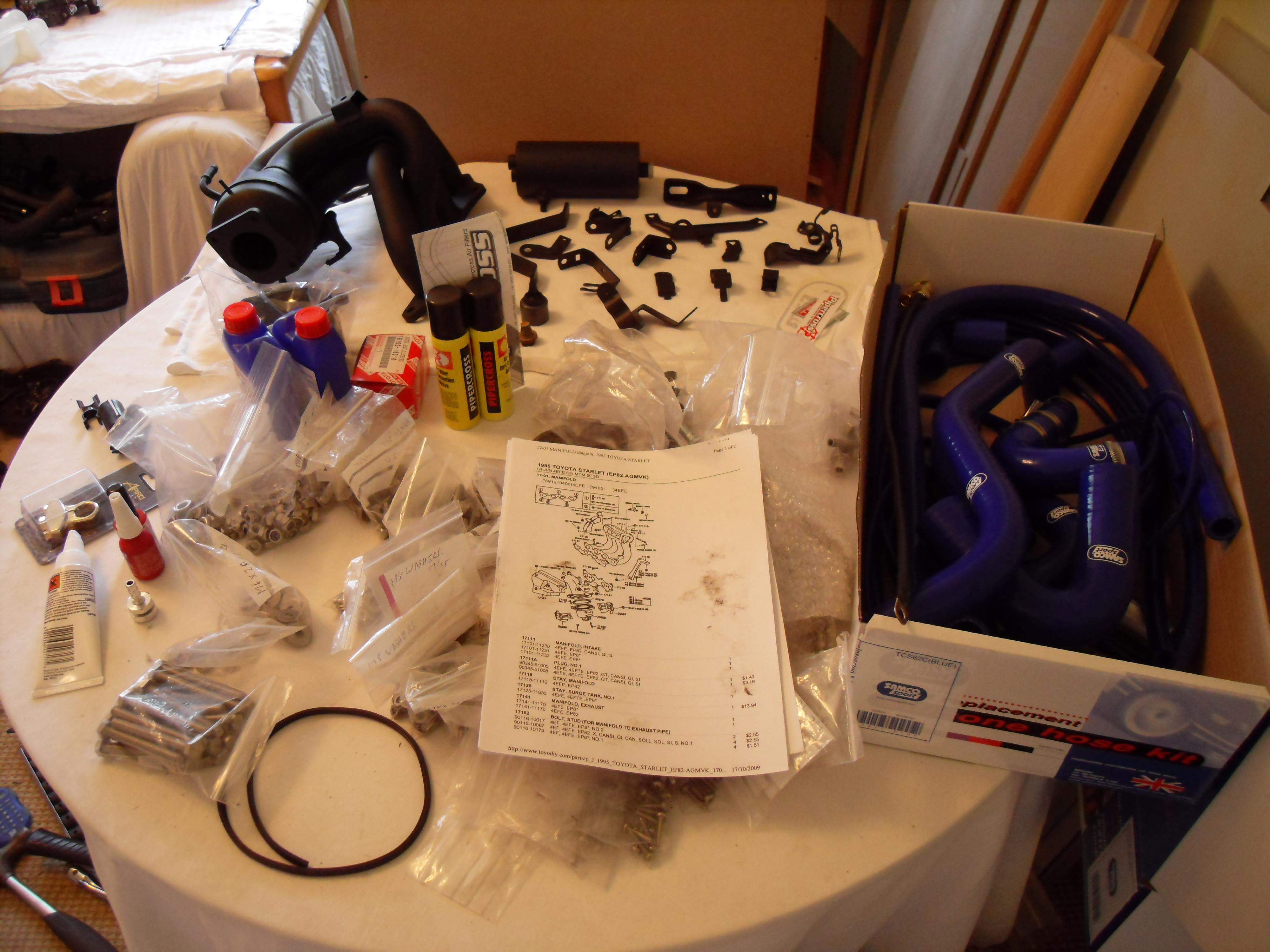

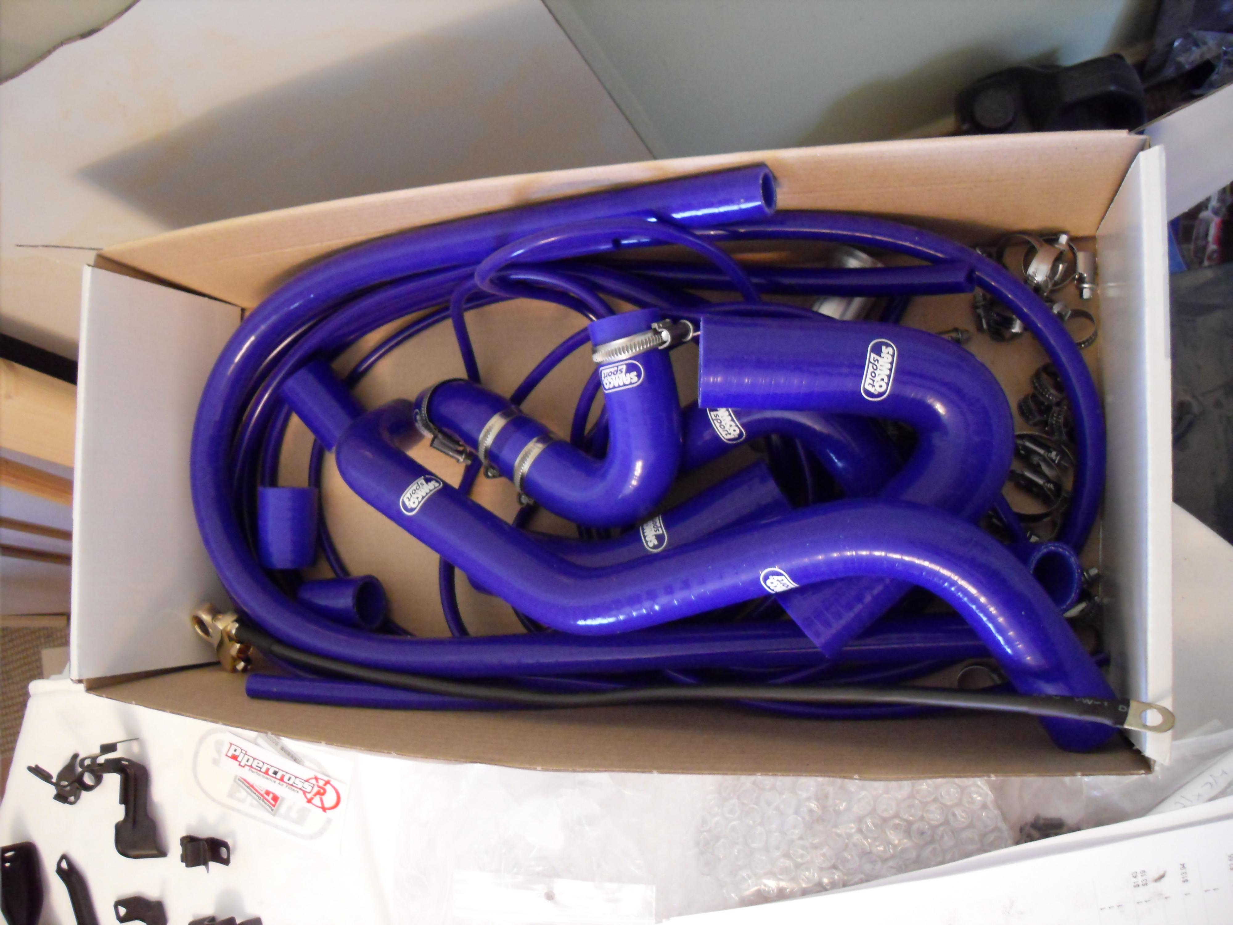

Stainless steel fasteners all round apart from critical locations (Head bolts, main bolts etc)
Samco Silicone all round and I do mean all round

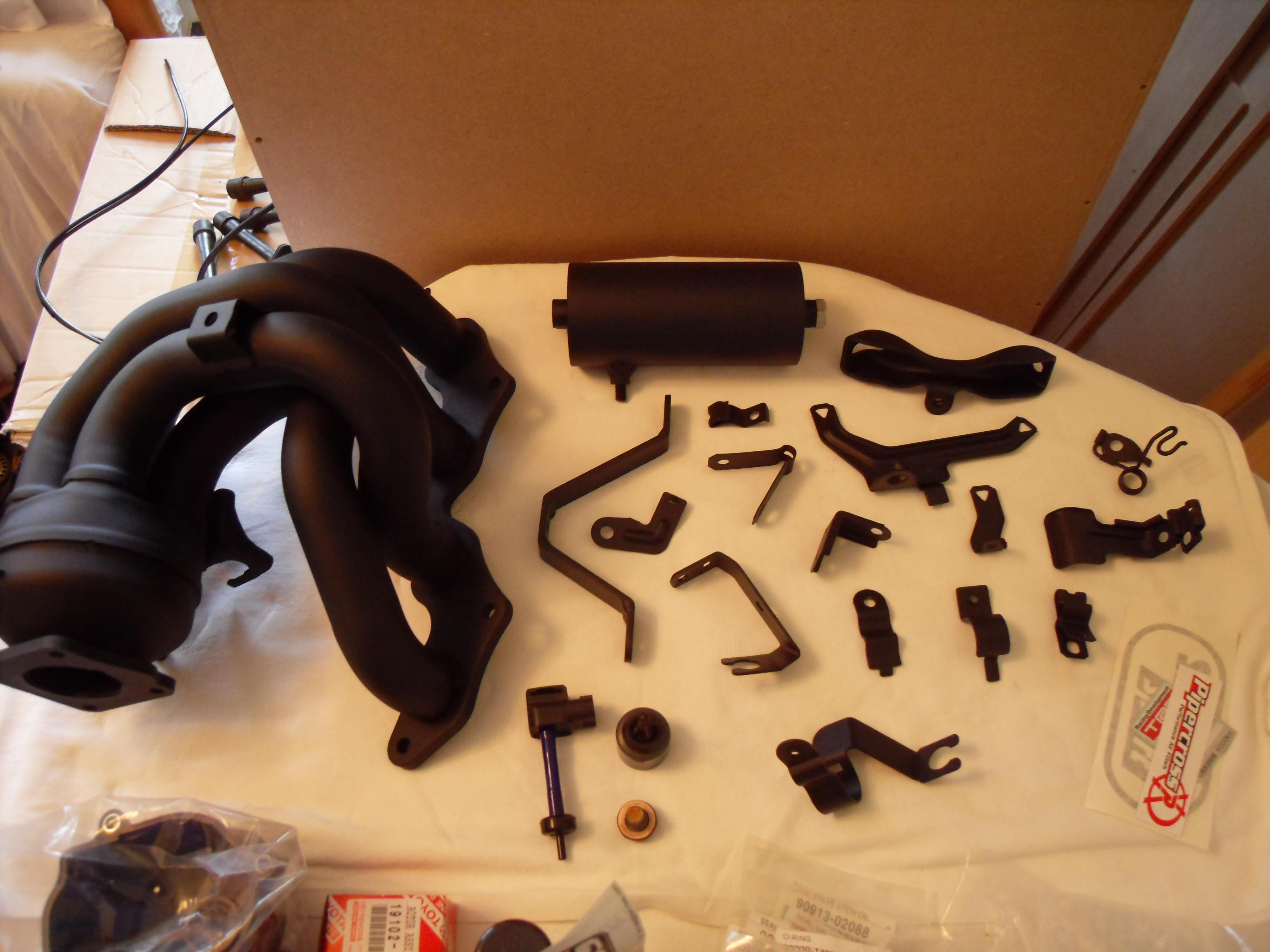

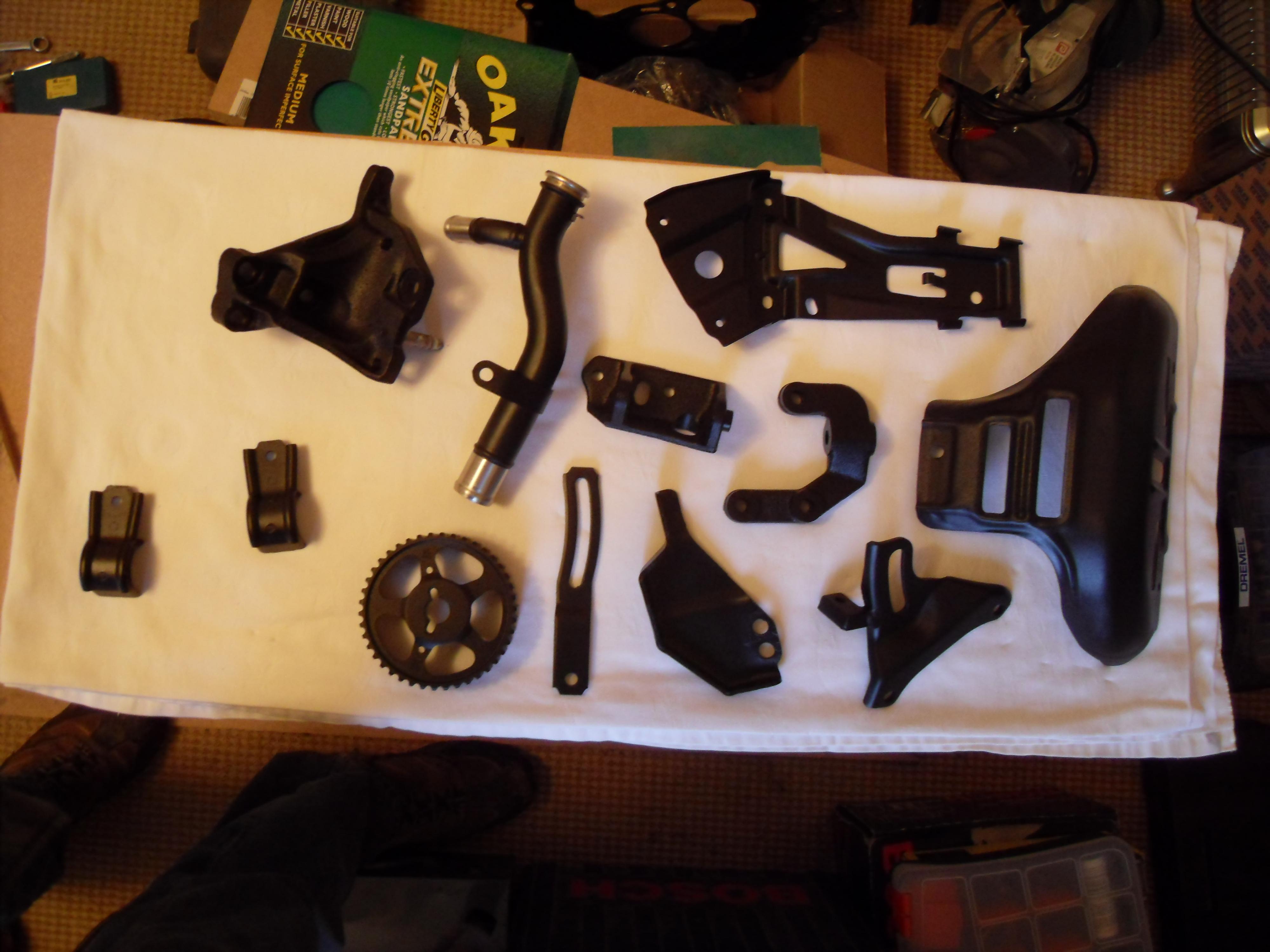

Almost every metal bracket in the engine bay has been striped of rust chemically, etch primed and sprayed.
SDC10388.thumb.JPG.8a3cee433f9a567a2142524591348742.JPGSDC10393.thumb.JPG.182afd931bac261e2b1c3223cefdb9fc.JPGSDC10394.thumb.JPG.32a192ce50e9238c991dcdb89262d7dc.JPGSDC10392.thumb.JPG.59d96f39d5b494e3b4e7a9a560237001.JPG
I didnt decide to write this untill after I started so photos start half way through engine dismantling.

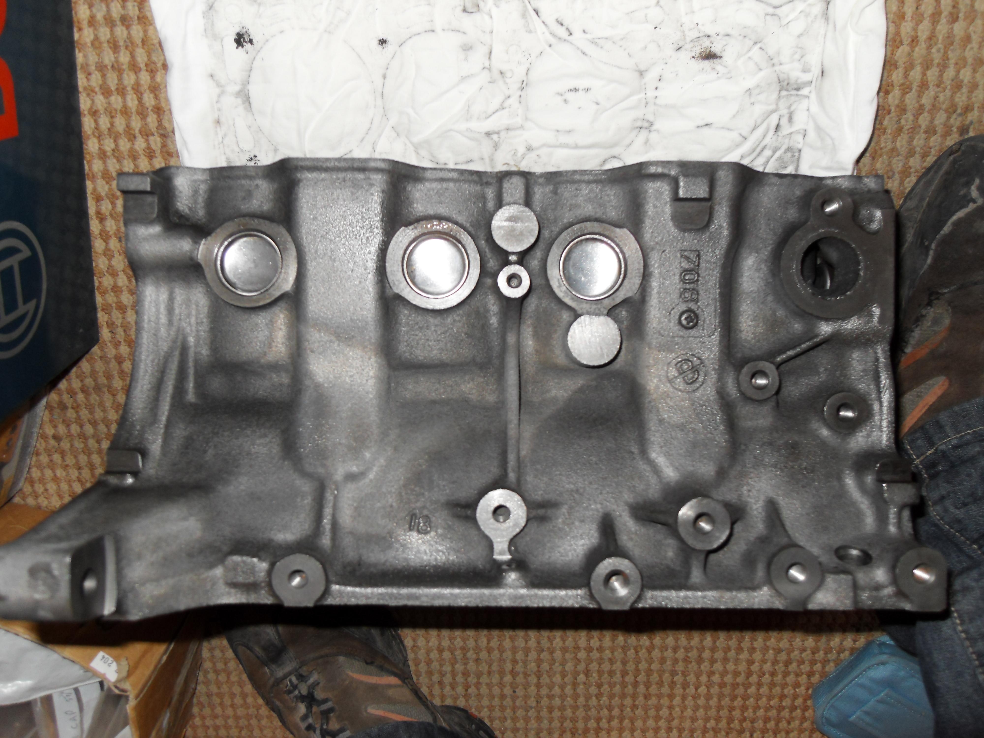

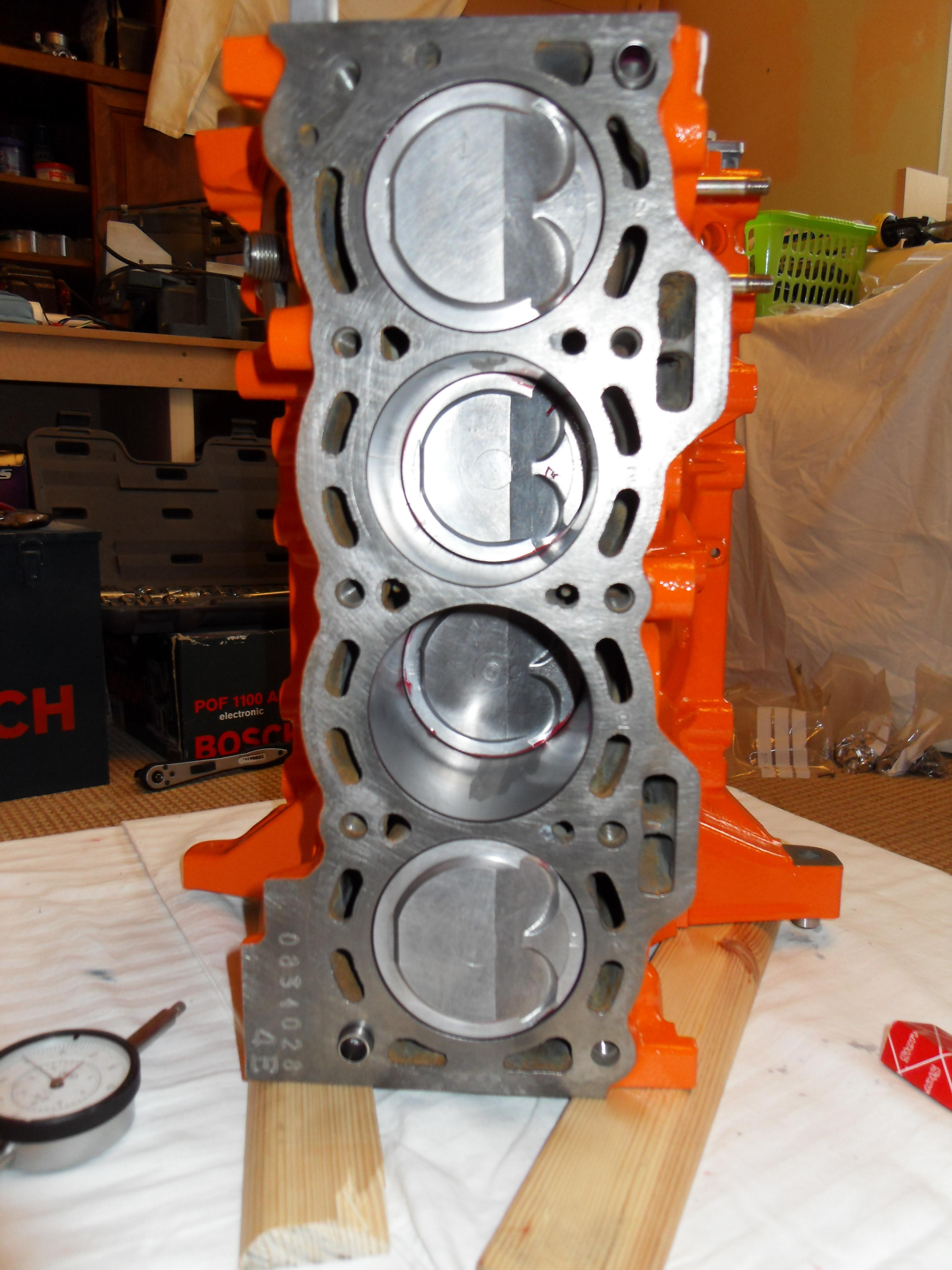

Block on bench almost dismantled
SDC10411.thumb.JPG.648a0512f41a96c8179c9ef7ca7ac443.JPGSDC10413.thumb.JPG.b662762f46c1808990958113b3f4c006.JPG

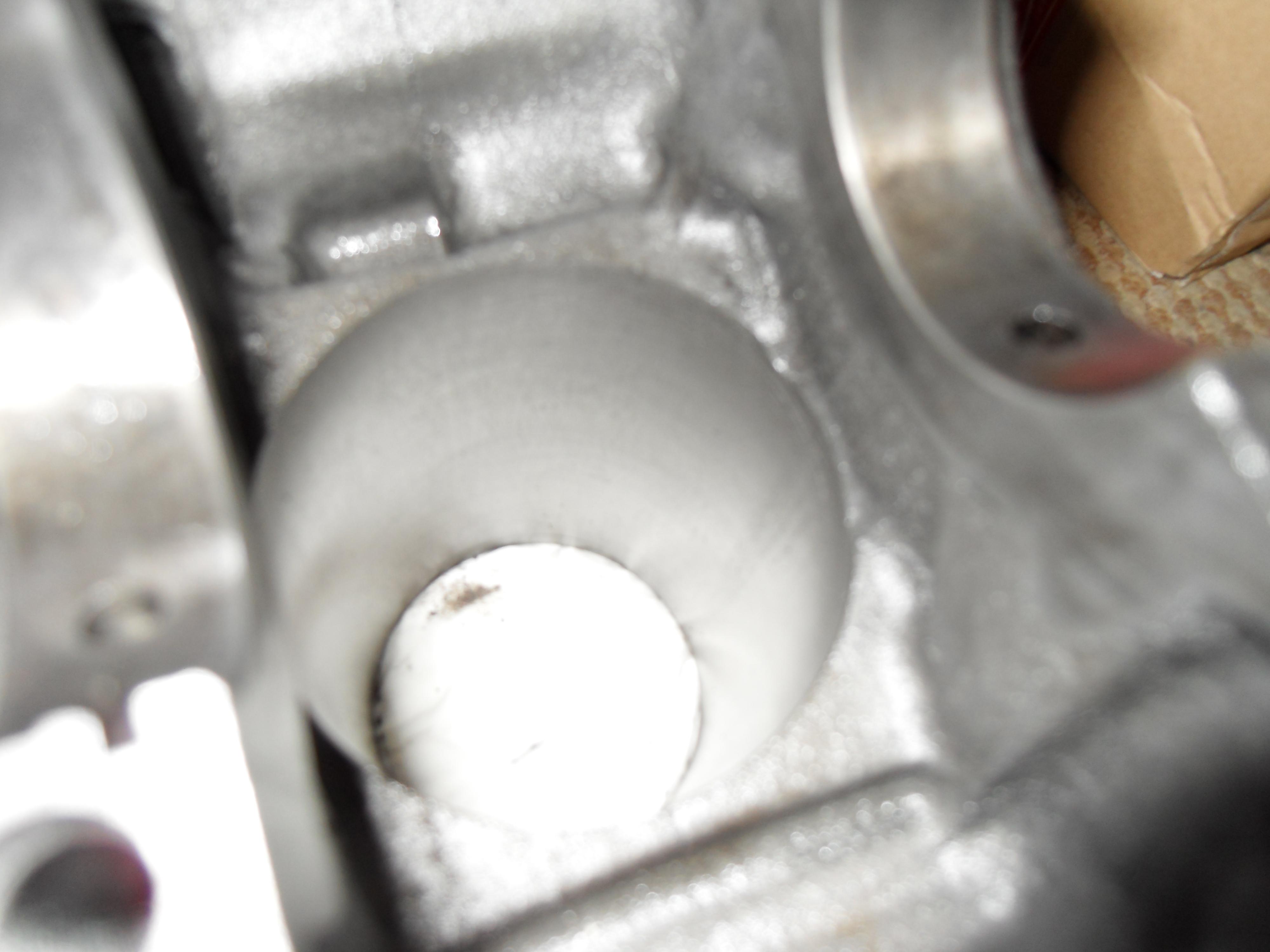

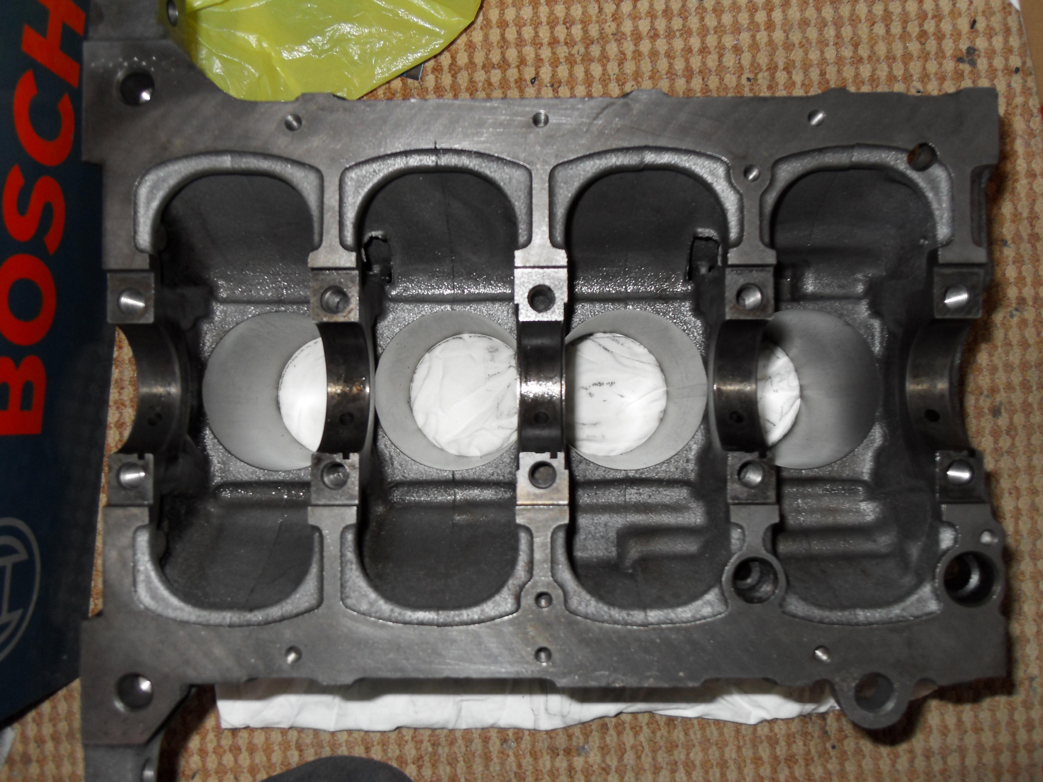

Block dismantled, acid cleaned, and cylinders horned
SDC10456.thumb.JPG.25d7eb30a0490240cf76d74fed2d5861.JPGSDC10458.thumb.JPG.2cbc7e135e3a37b80e7c87188caec3f1.JPGSDC10457.thumb.JPG.07a185b9d0abf1a5e317210d6141afef.JPG

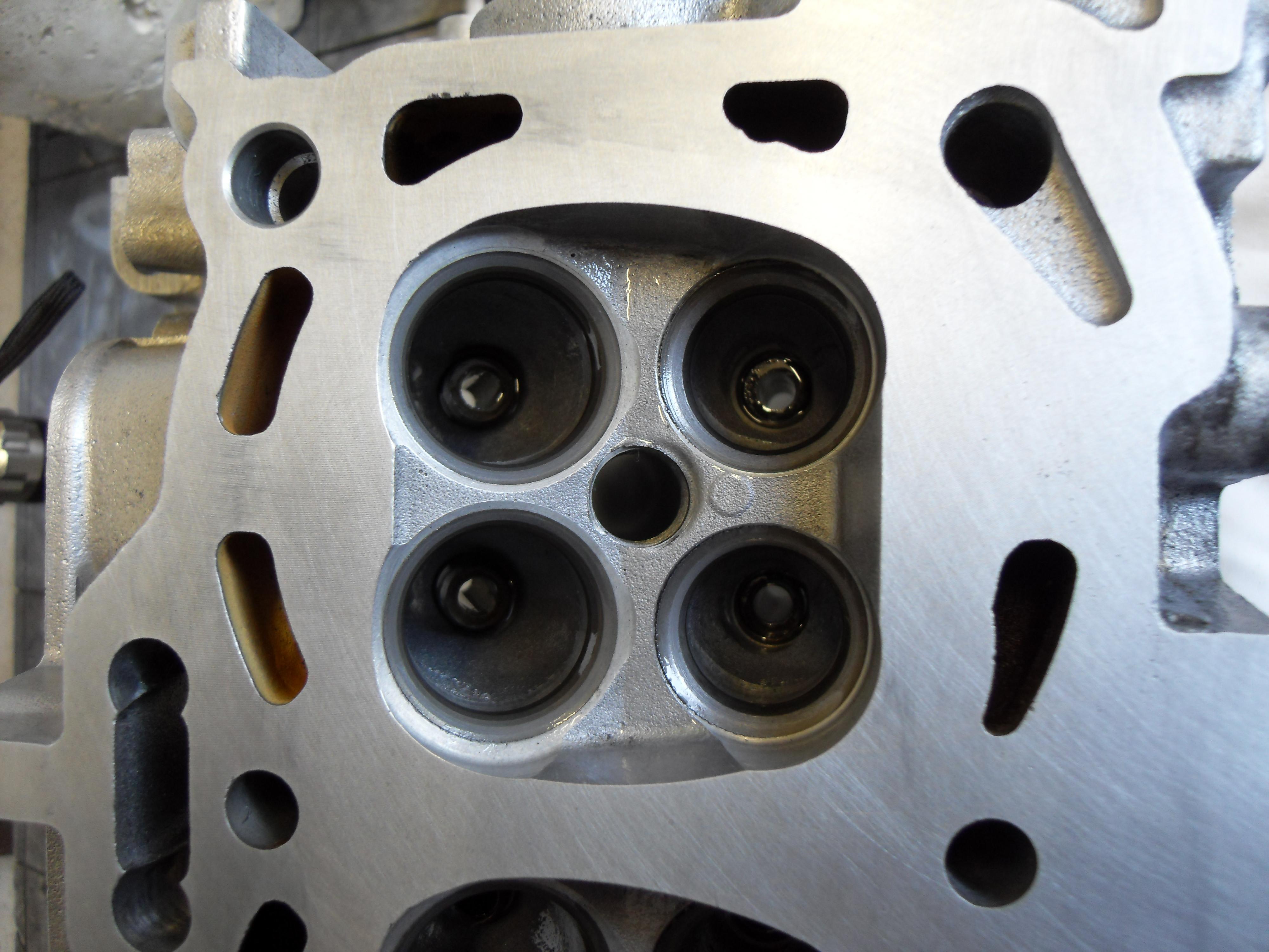

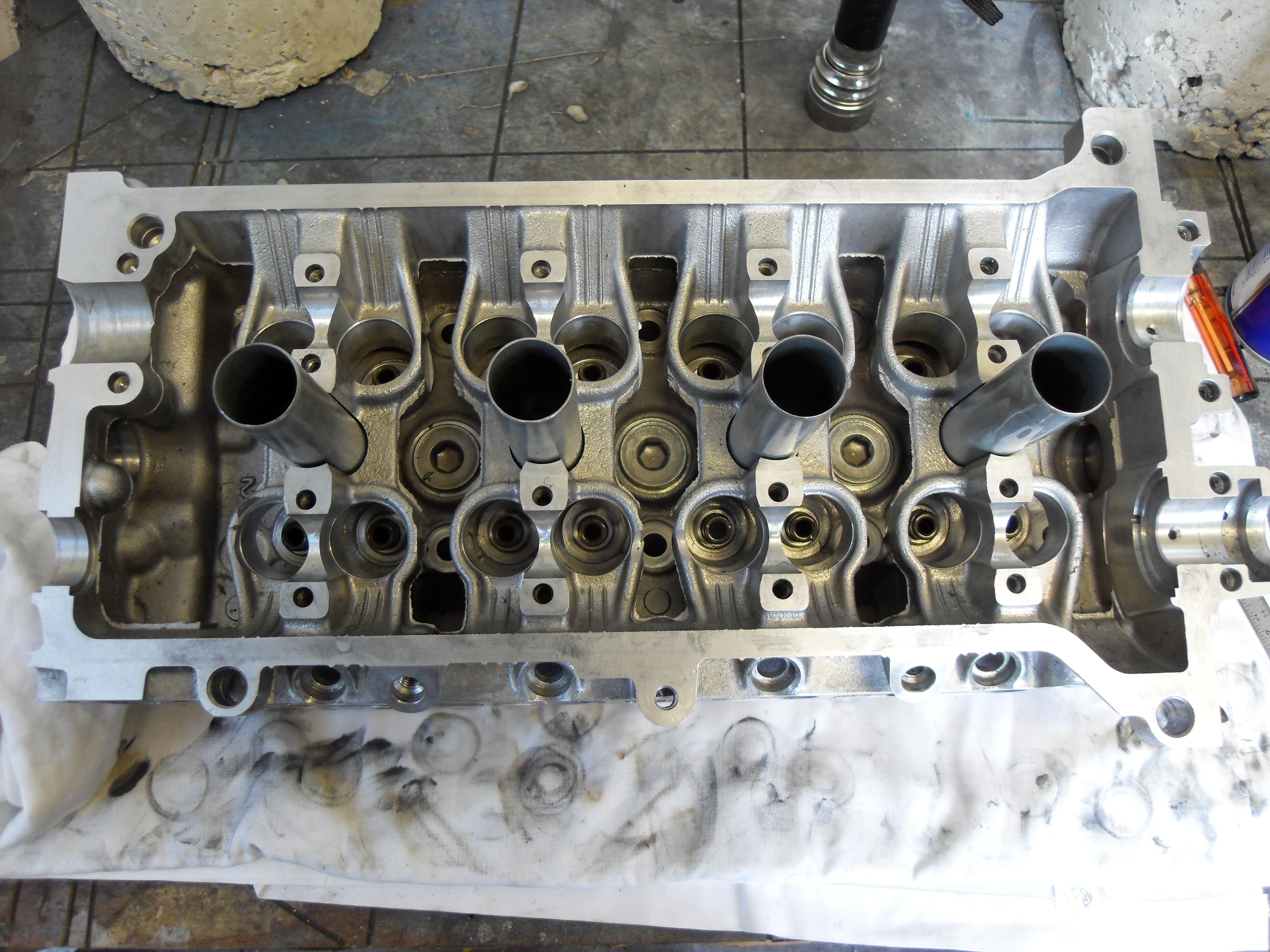

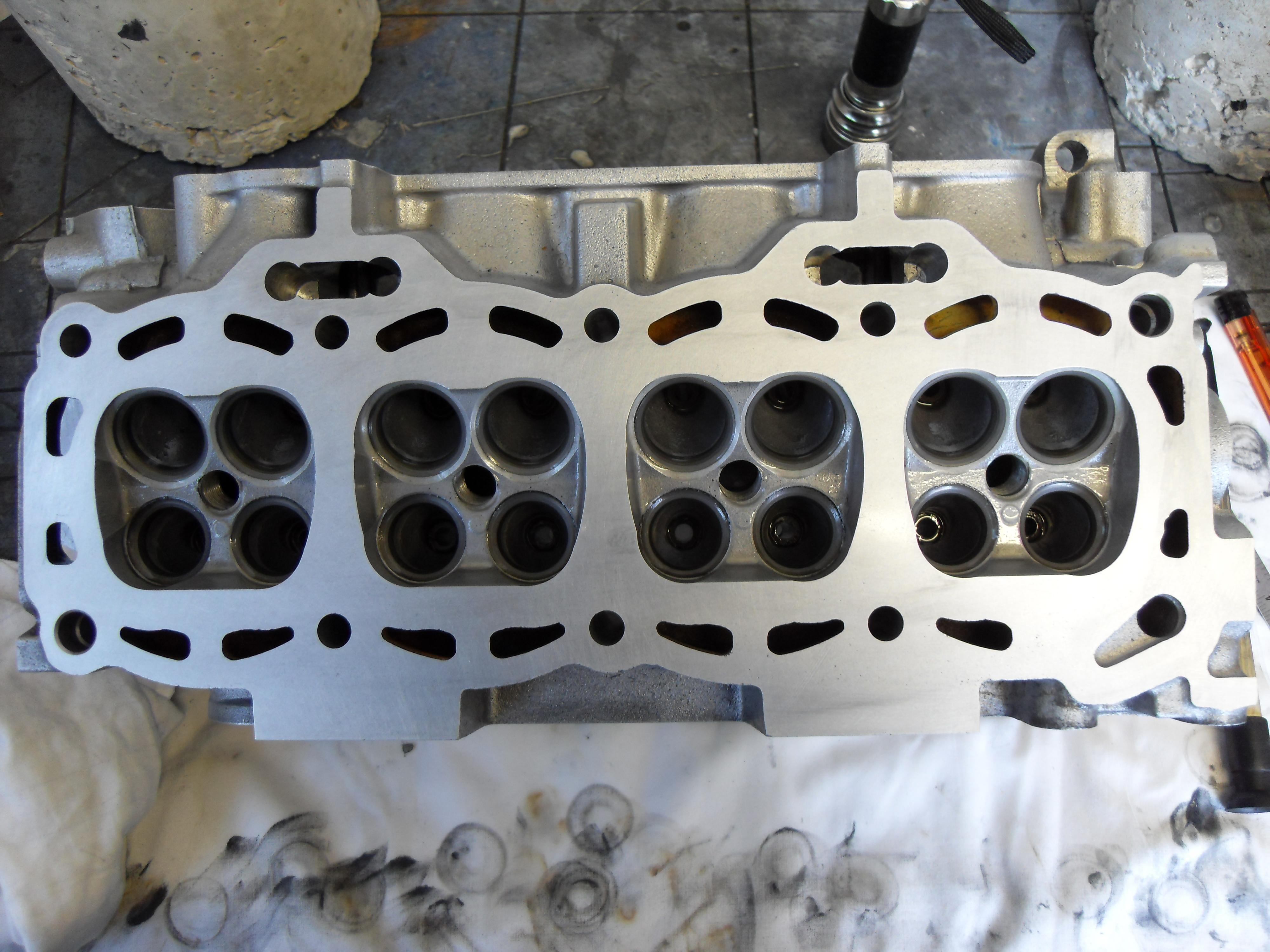

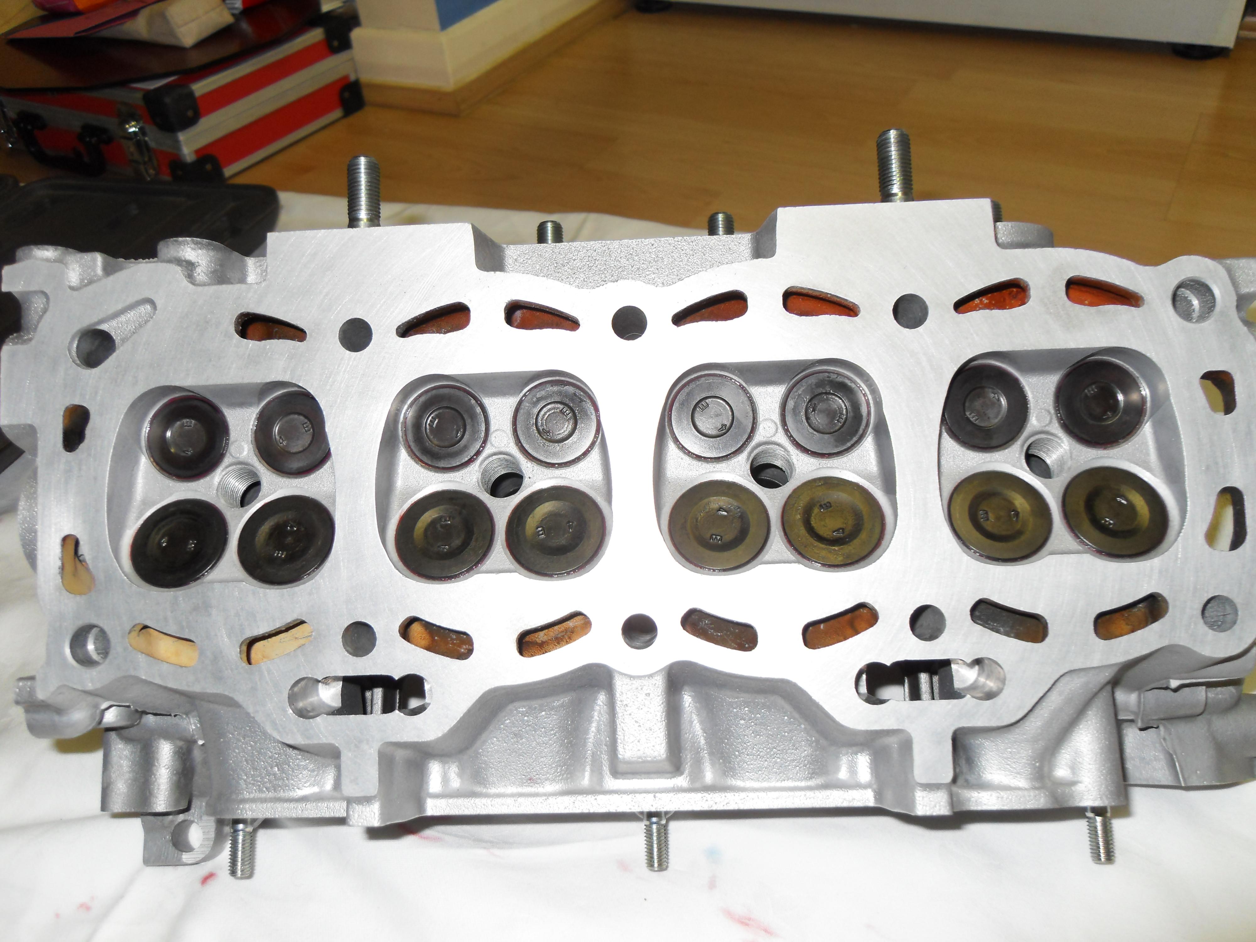

Head hot tanked, decarbonated and skimmed still to be phosphorus brightened
SDC10466.thumb.JPG.91ef5643e40c3ede5b08f3868f06f5a3.JPGSDC10452.thumb.JPG.6cac455a65d5935774616b826460d753.JPGSDC10462.thumb.JPG.2f8b12aa5458d2d70c7c828c53dc9d0d.JPGSDC10463.thumb.JPG.788eb70fc9ee01cc5ea4136e14eff275.JPGSDC10465.thumb.JPG.d3e6a80ac56230f01a2f871a63072f84.JPG

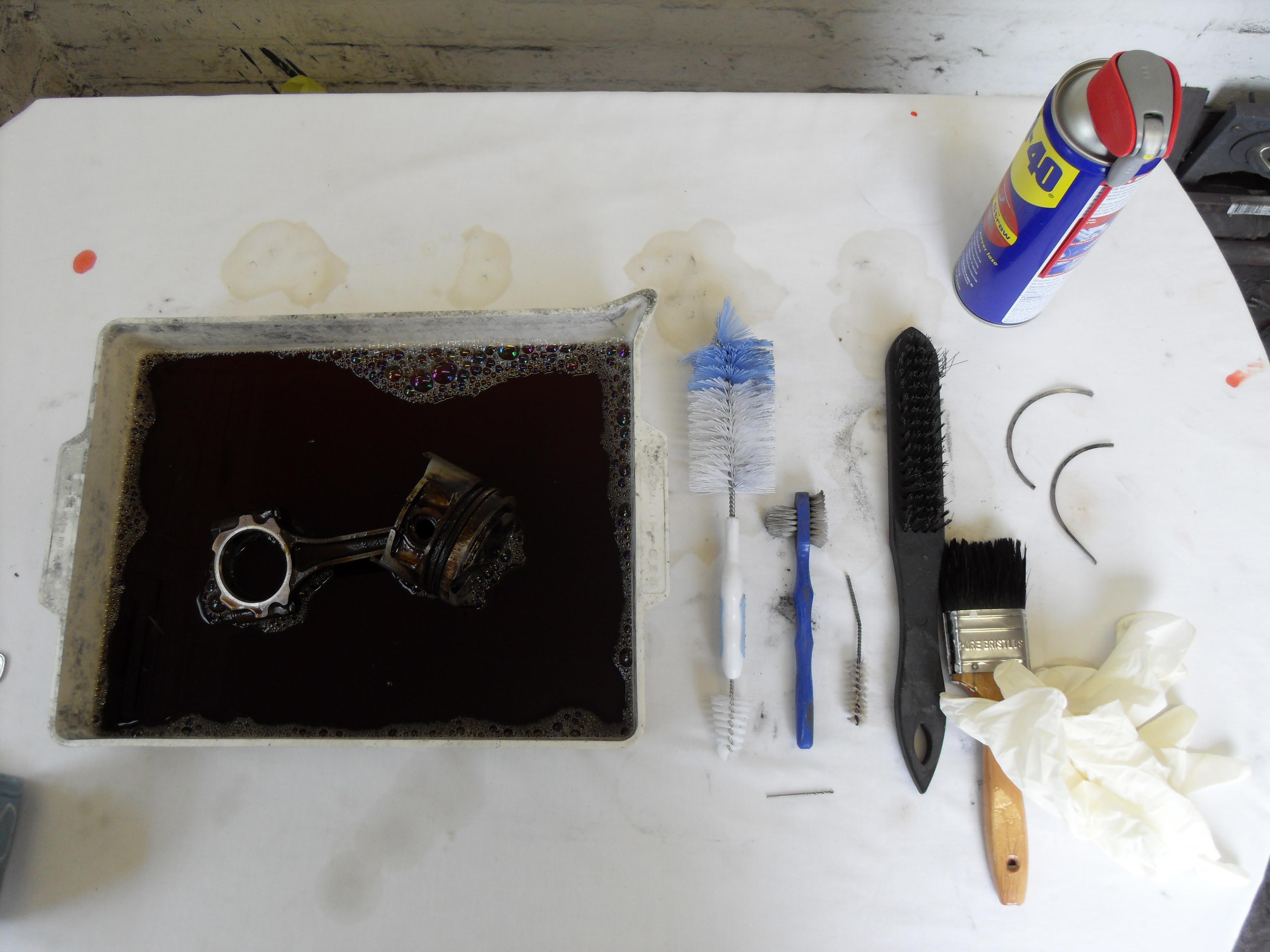

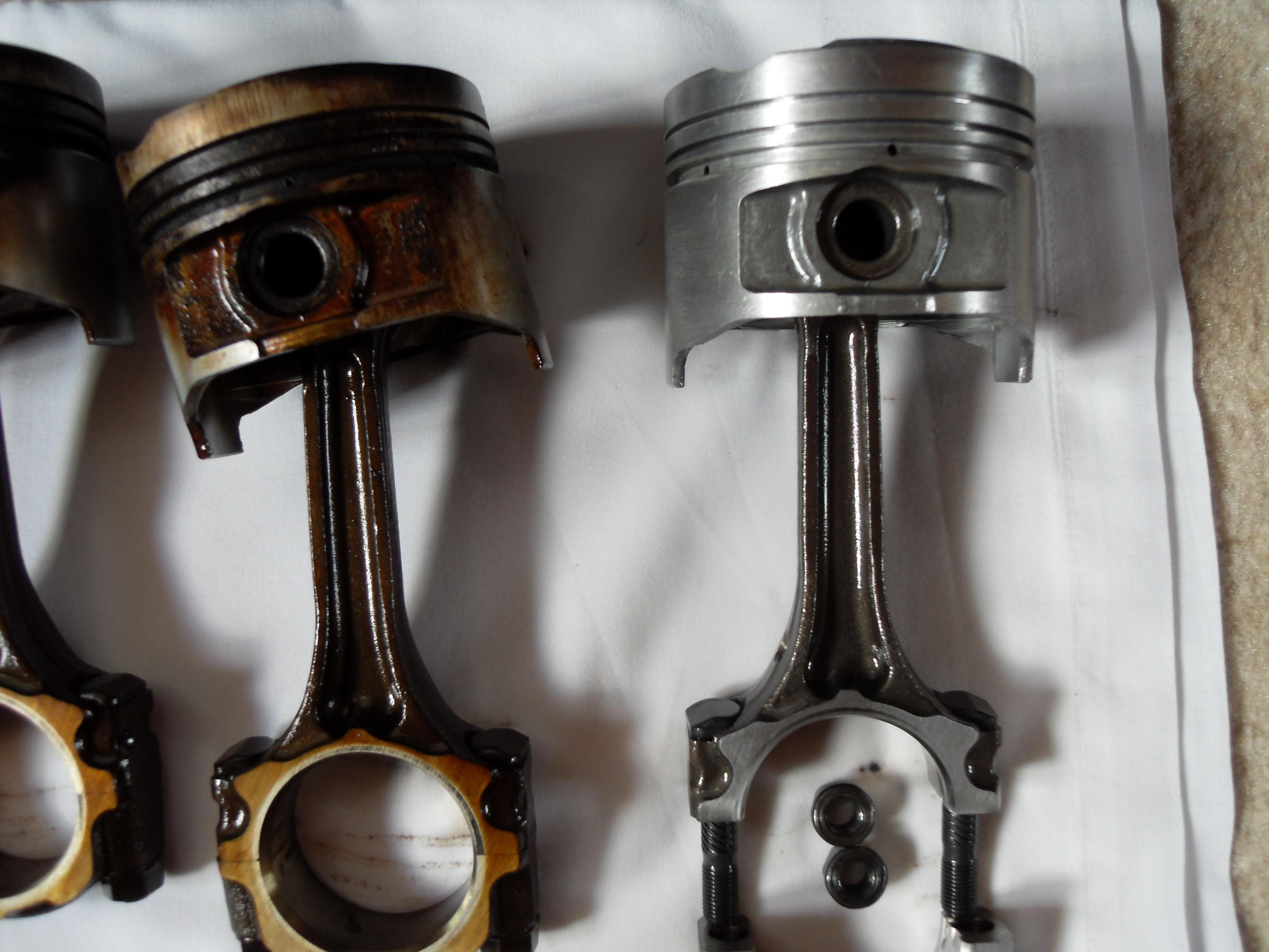

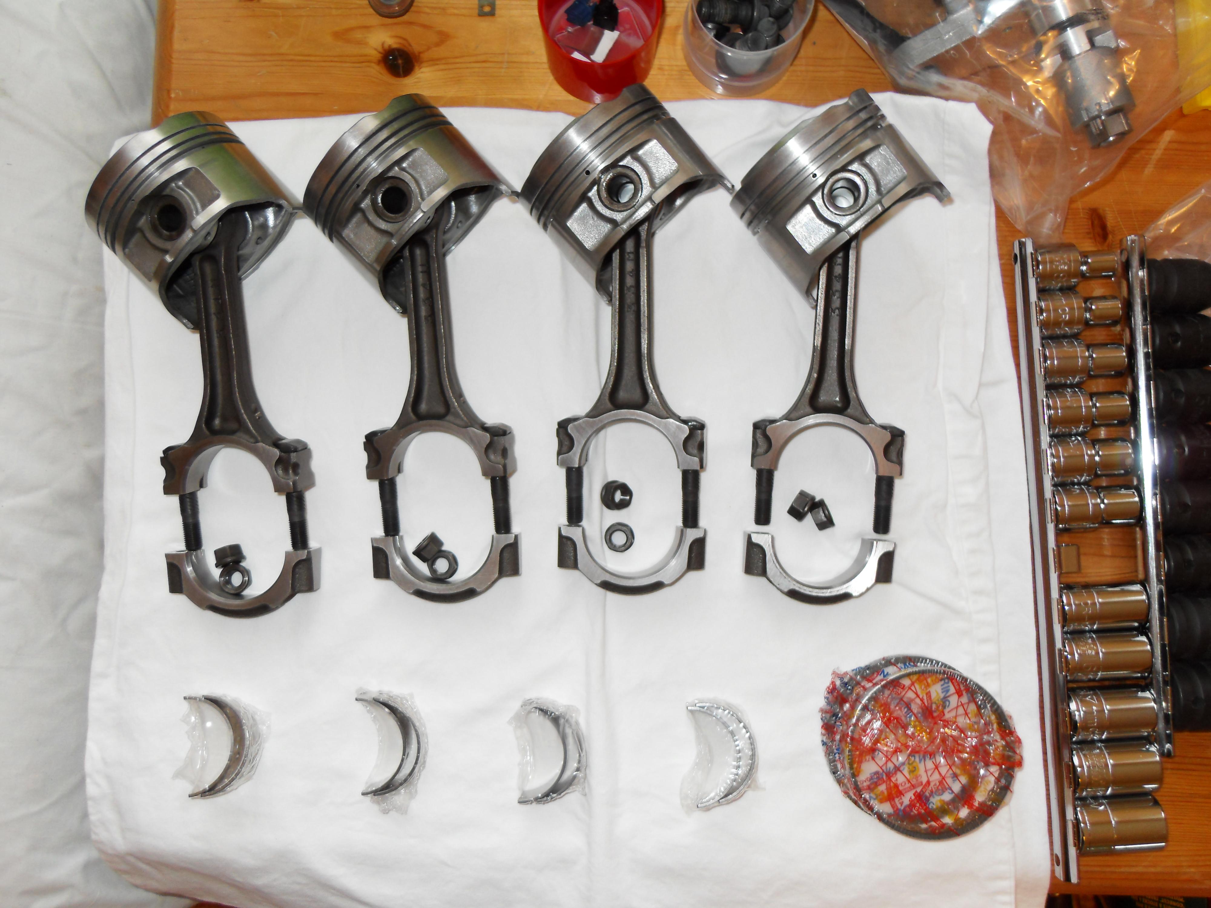

One piston cleaned (2 hours lol)

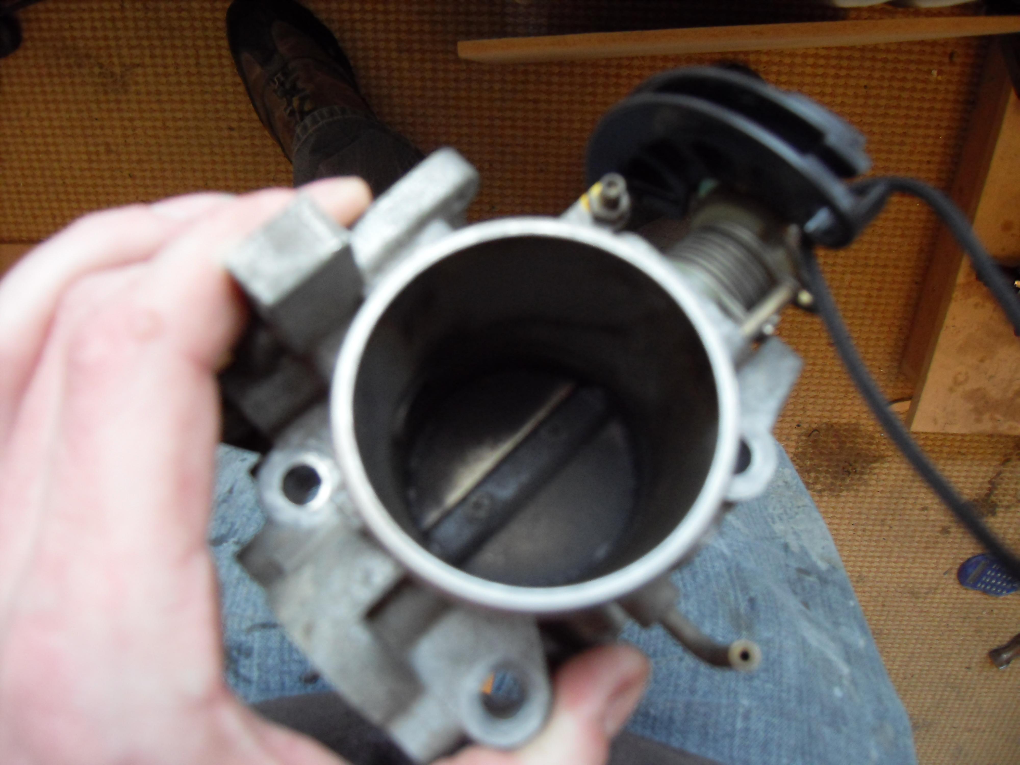

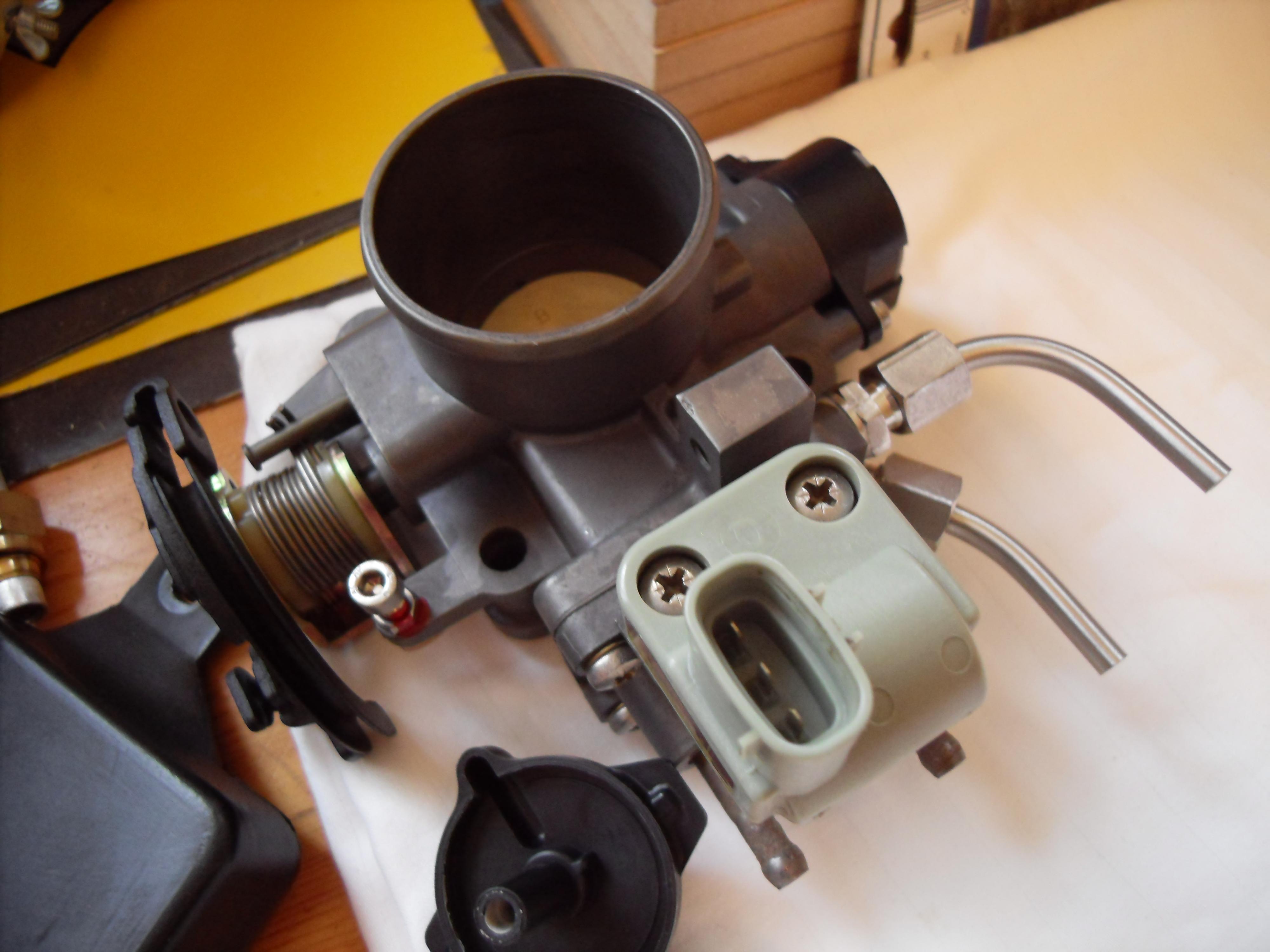

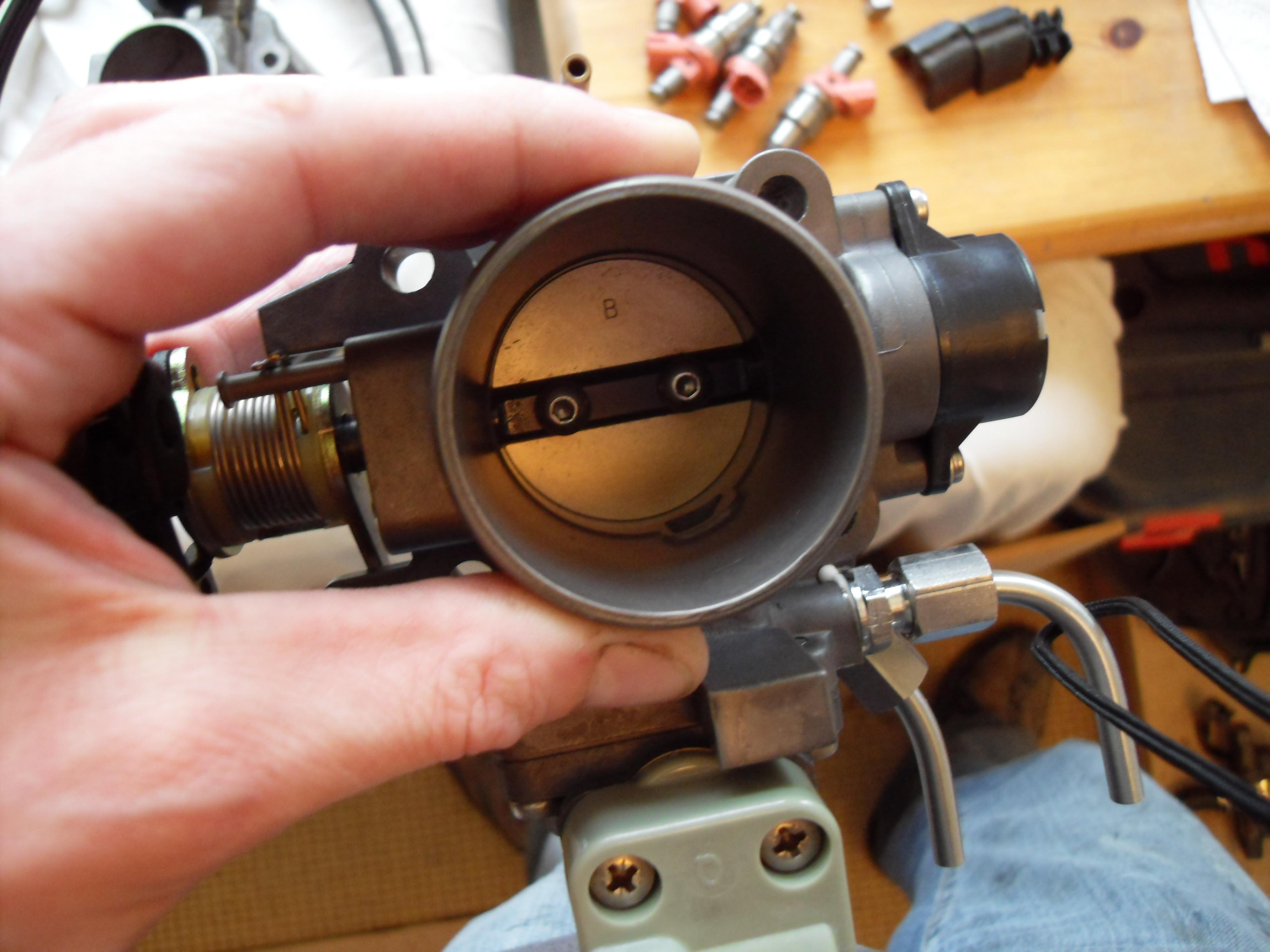

Throttle body before dismantling and clean
after
SDC10398.thumb.JPG.b9b2b454bb809ce4e6cf440dbe987e7e.JPGSDC10389.thumb.JPG.66bd053c60000795ef30384870135b1c.JPG

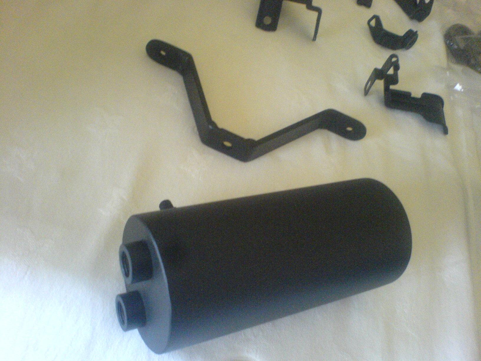

Catch can
DSC00379.thumb.JPG.2de42dd1cdb1da009a6985dd122f31e5.JPGDSC00380.thumb.JPG.1ecdf0597a5b65e4ecef62db8b6b5dc0.JPGDSC00422.thumb.JPG.ae3910da2816b529e5c2add8abe294d9.JPG

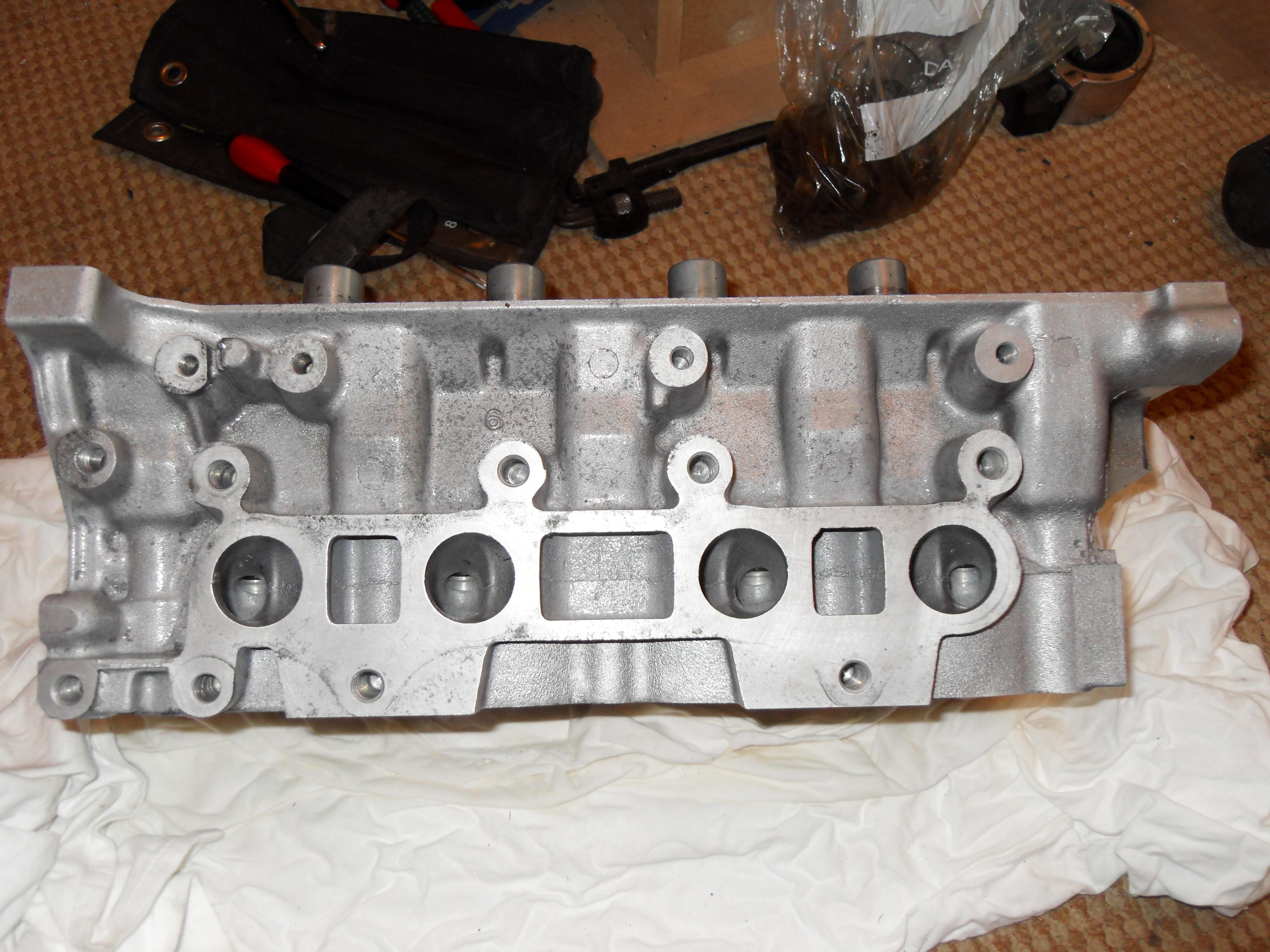

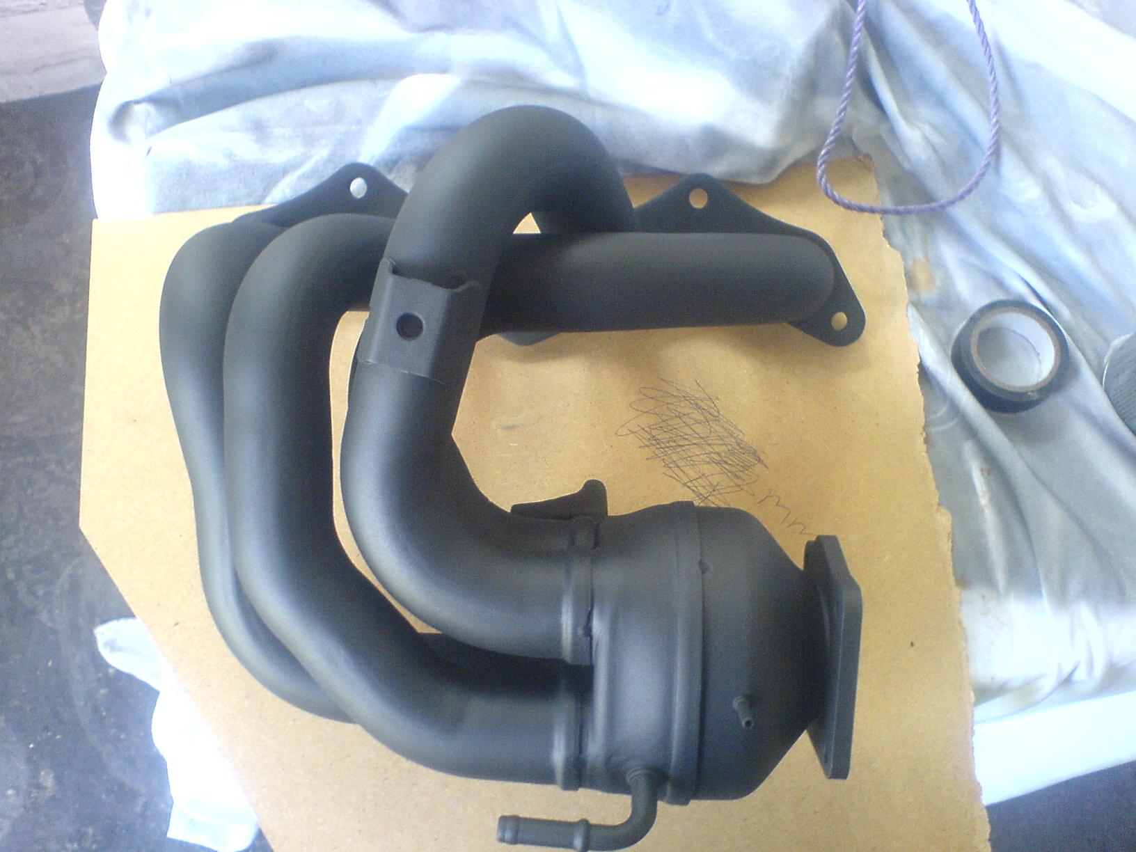

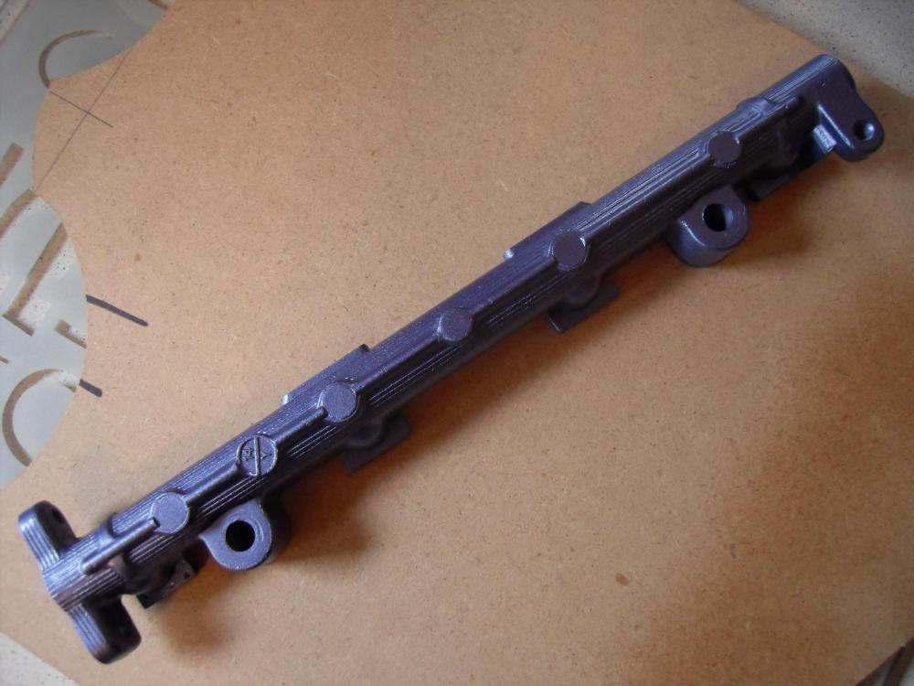

Manifold

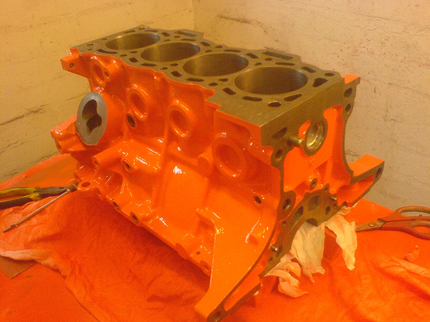

Last for now colour engine block is going to be.
orange my fav colour.

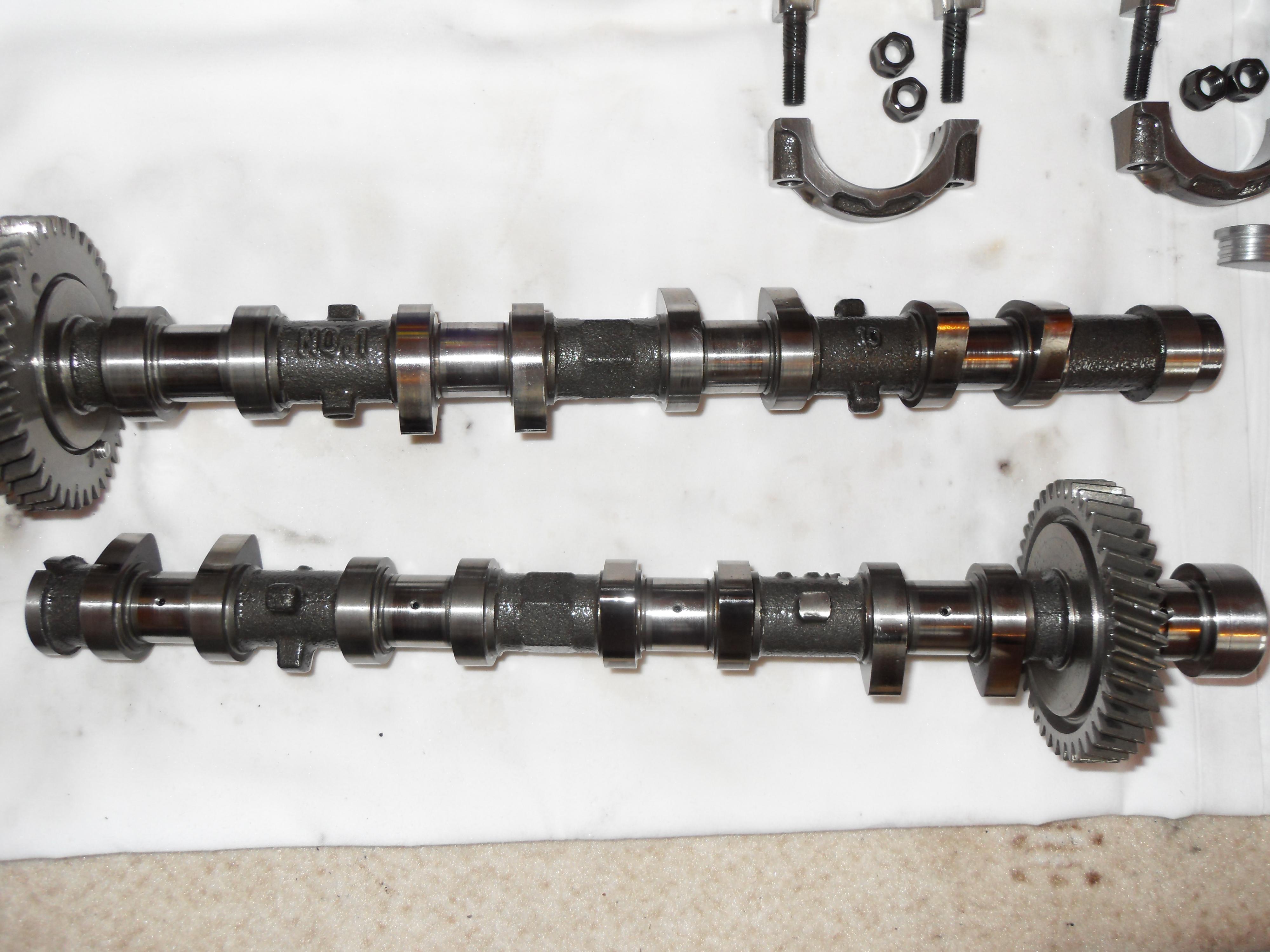

Tools of choice for today
Cleaned cams

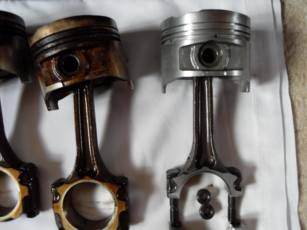

Cleaned another piston and rod

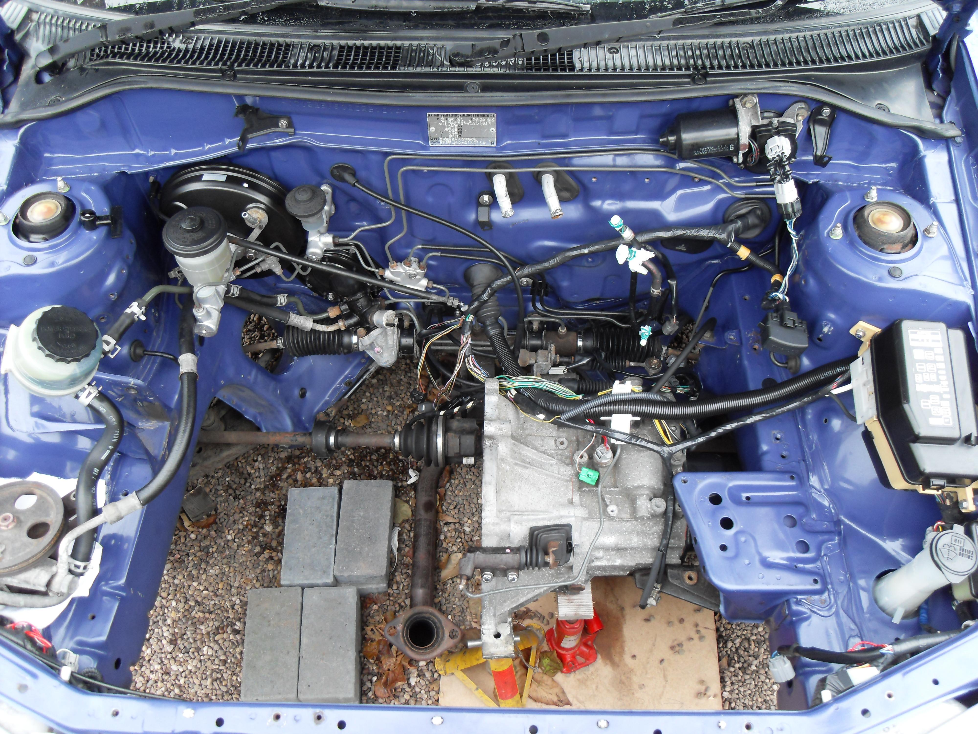

Cleaned engine bay

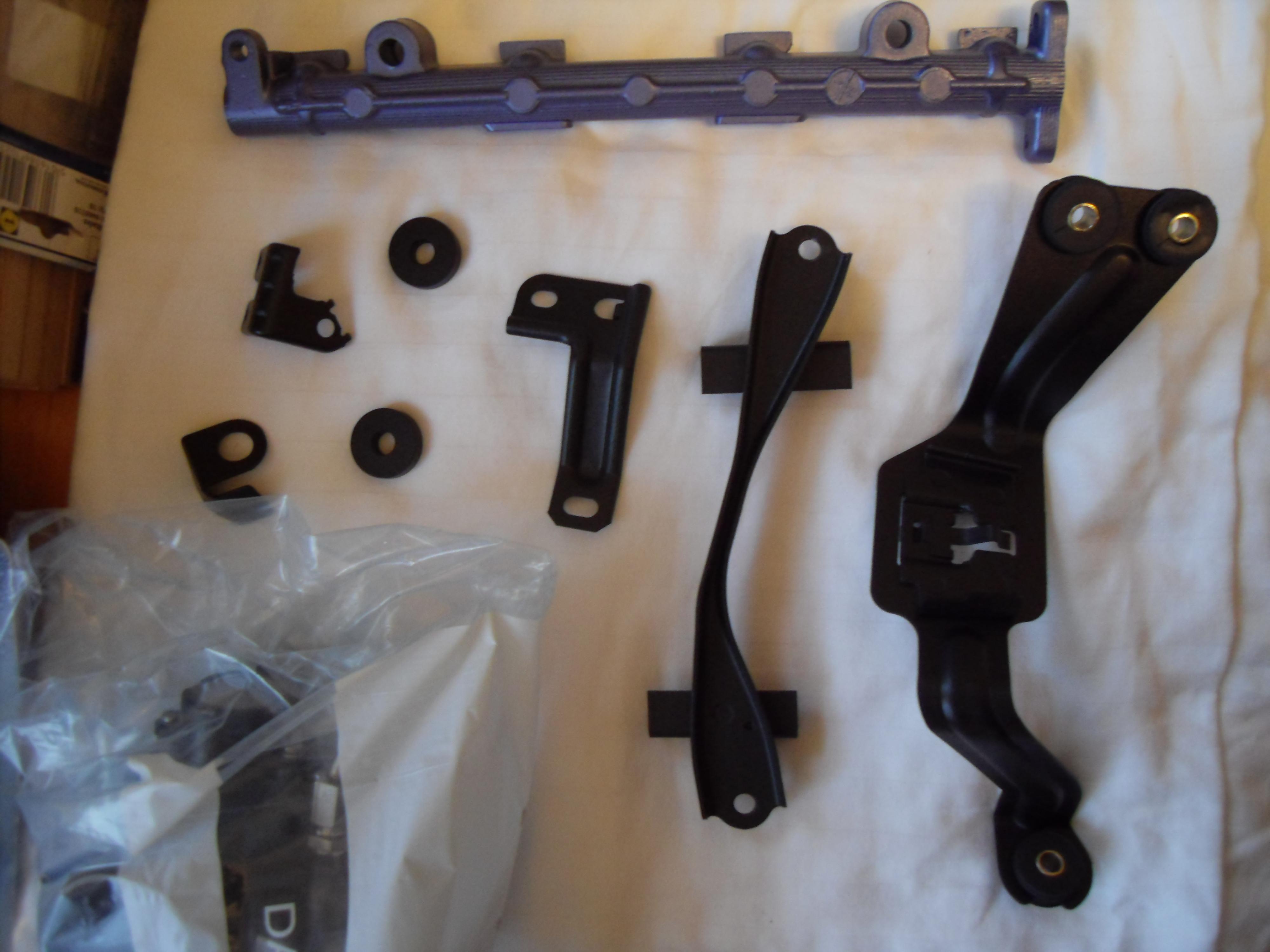

More painted brackets I missed in yesterdays post
SDC10472.thumb.JPG.52f6a8050267f9c285eb521227b2b000.JPGSDC10473.thumb.JPG.86bf031cb014a5d9665b69e32b40b221.JPG

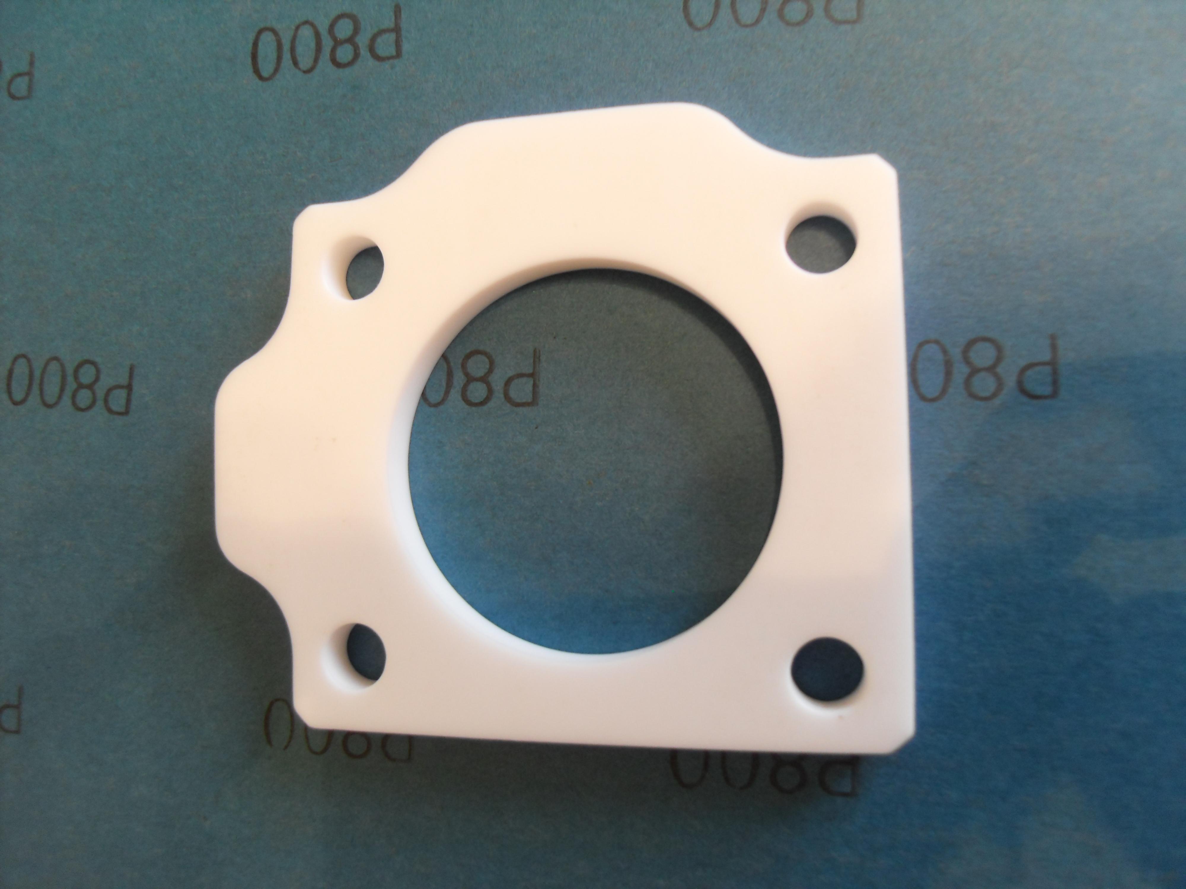

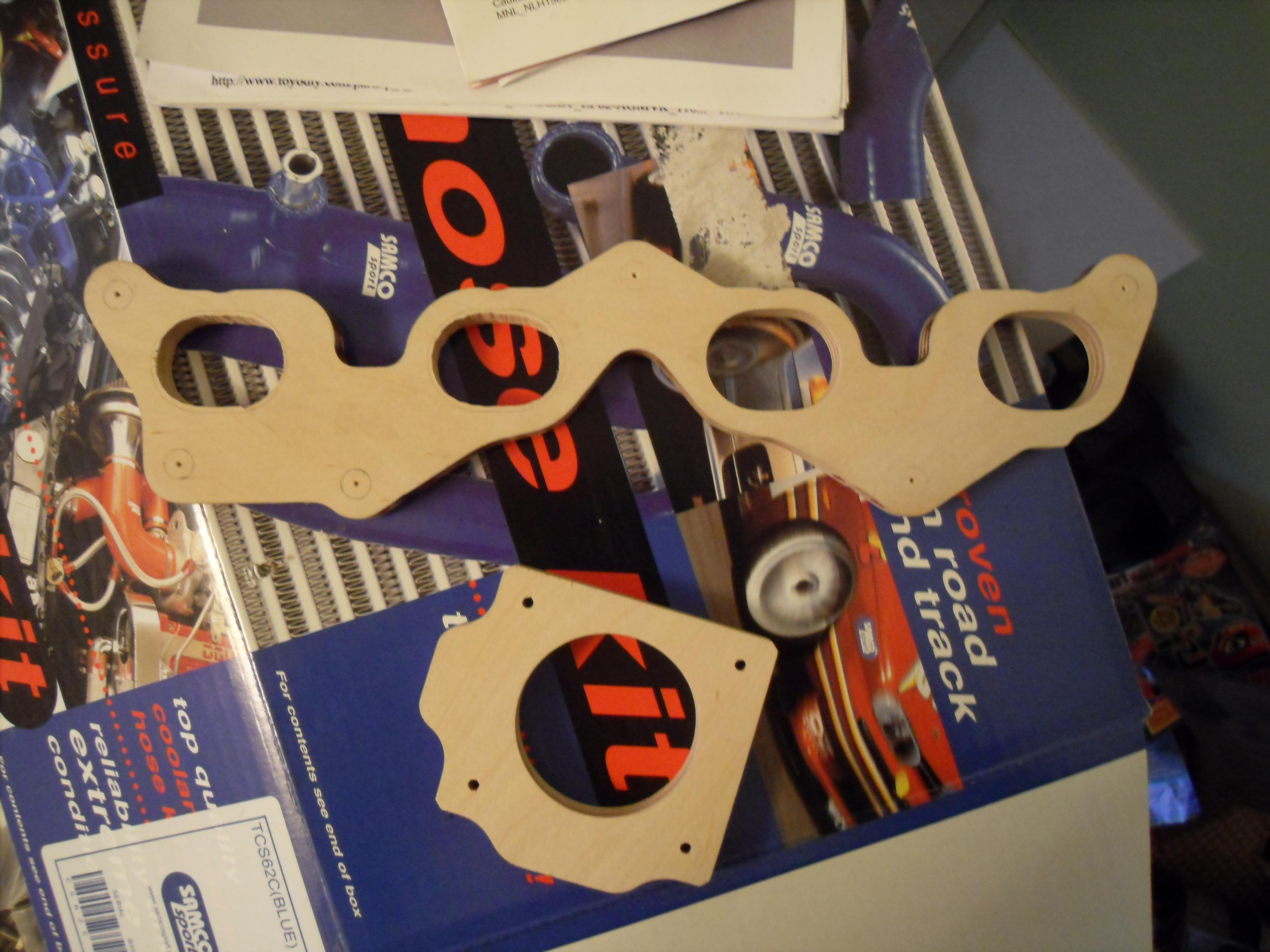

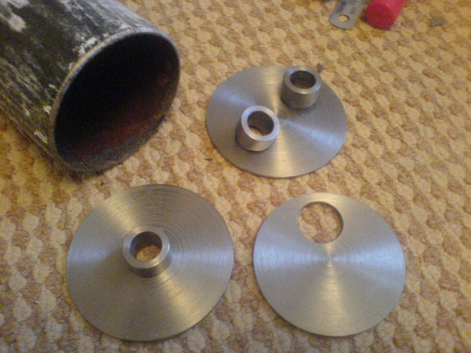

Manifold and TB insulators templates almost finished

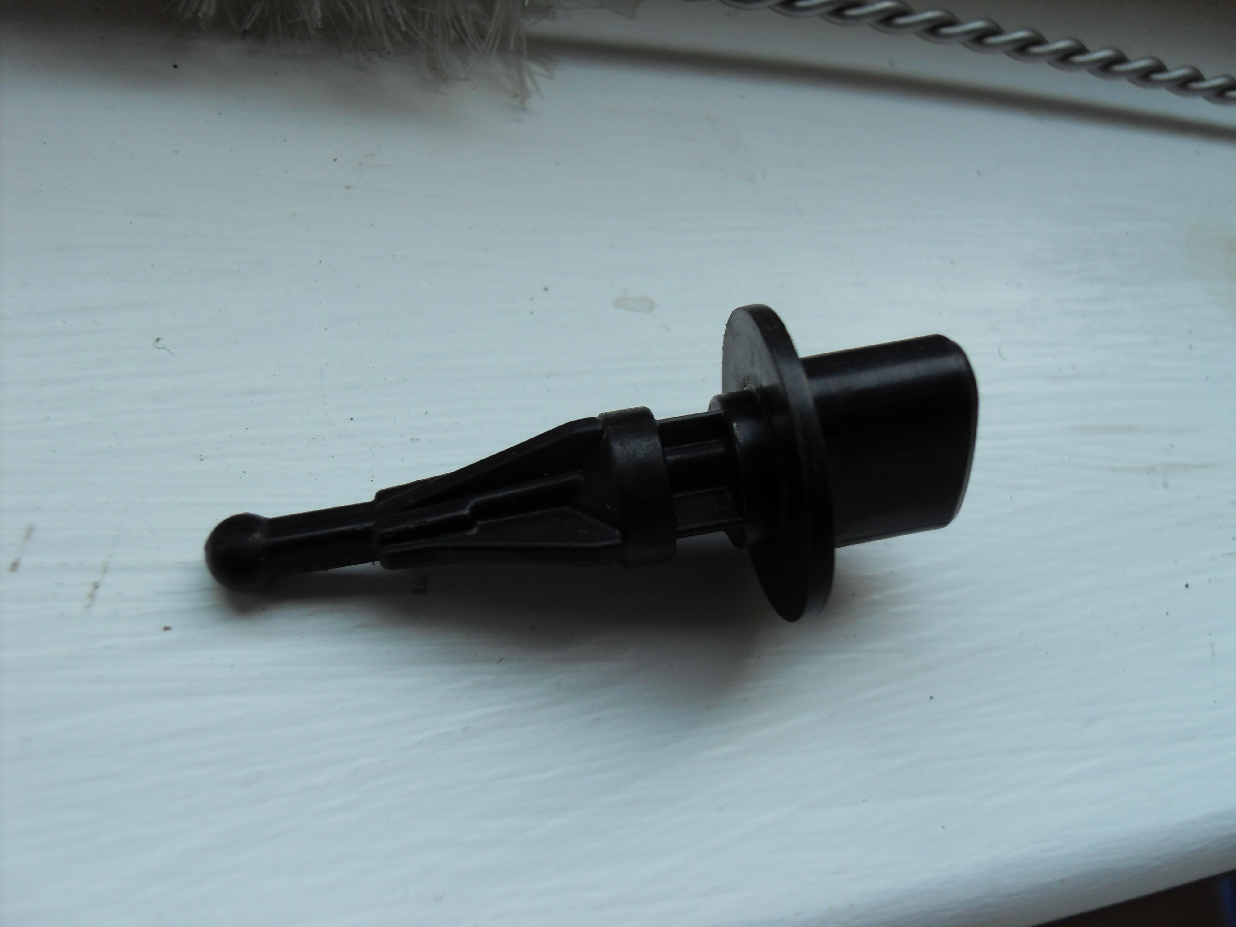

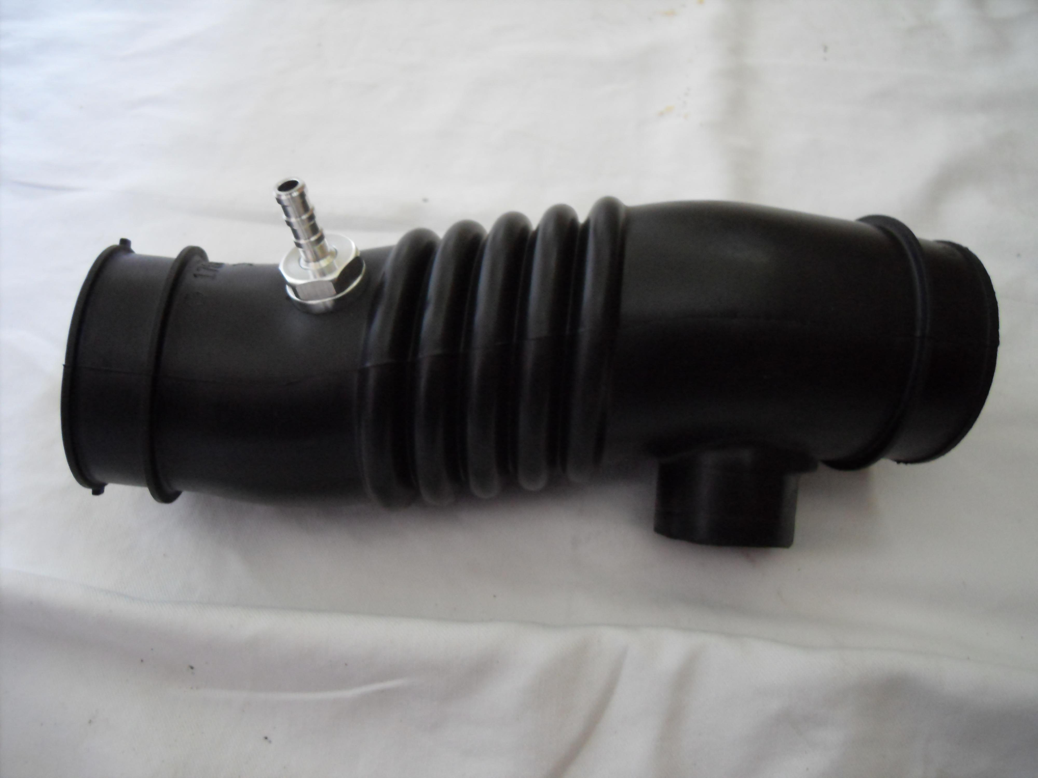

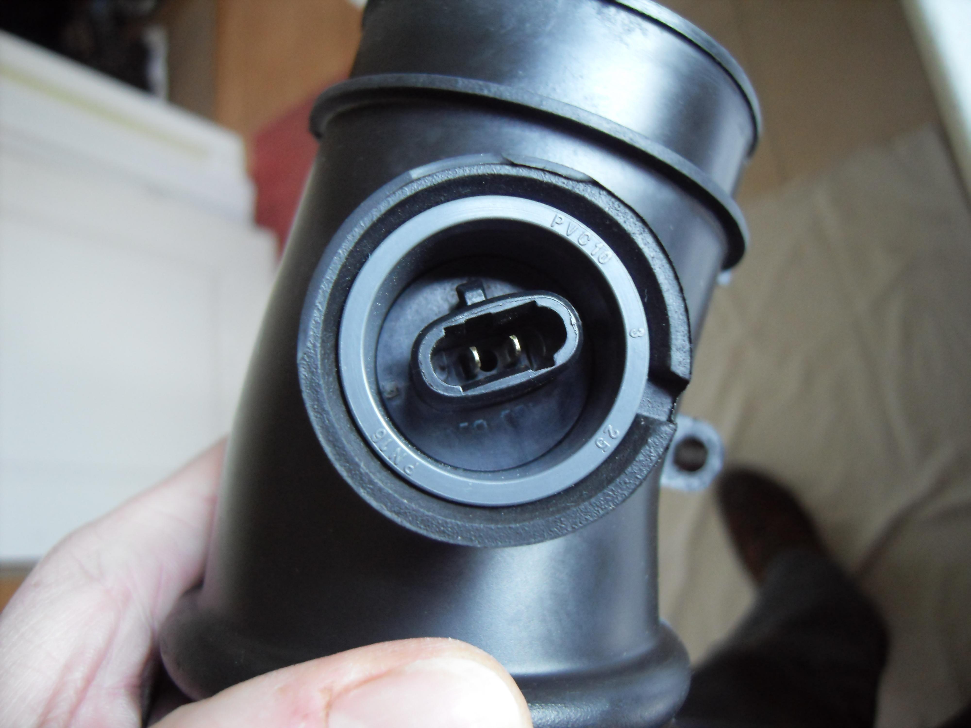

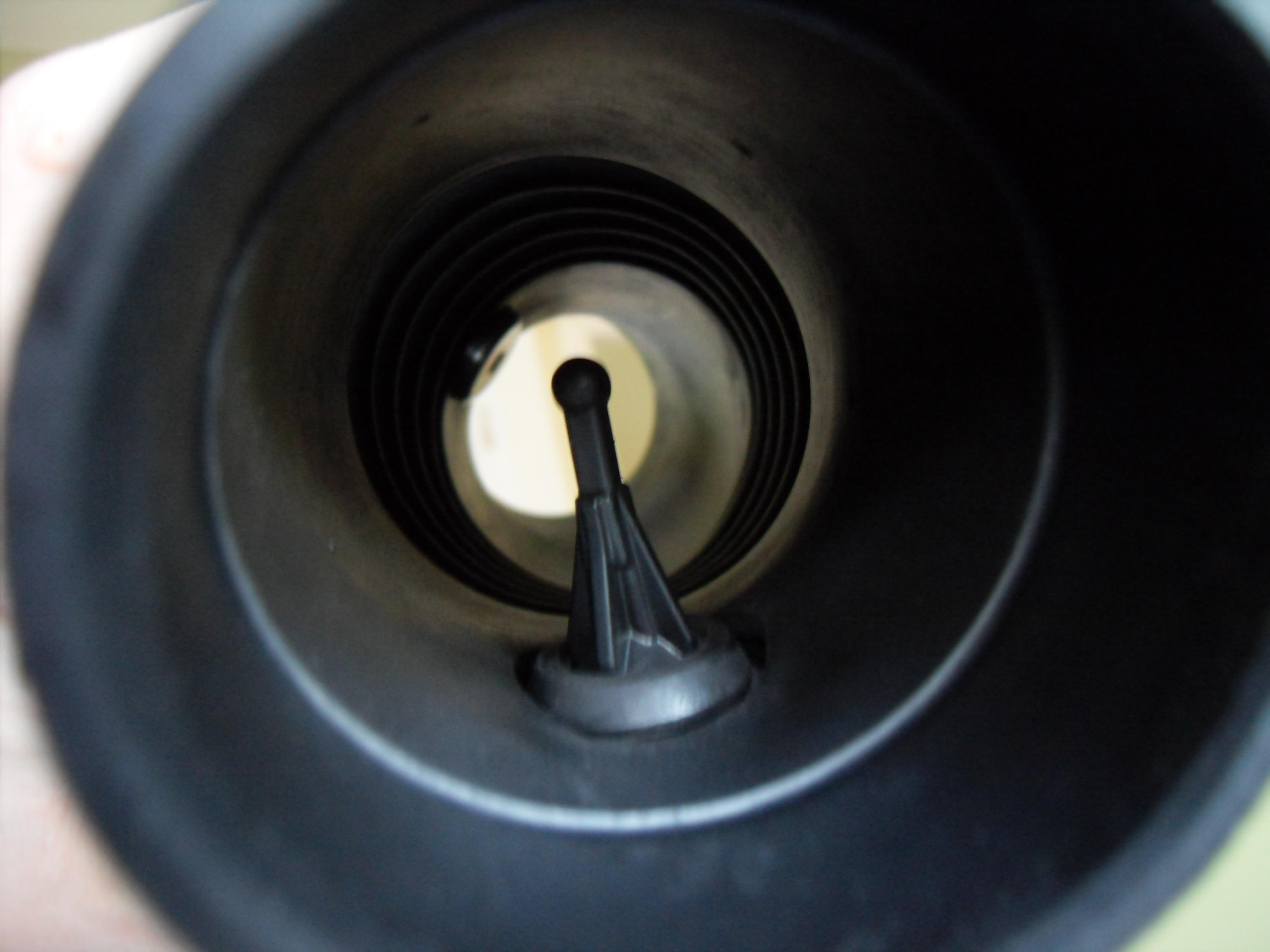

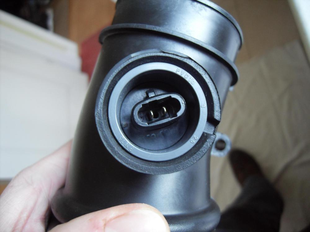

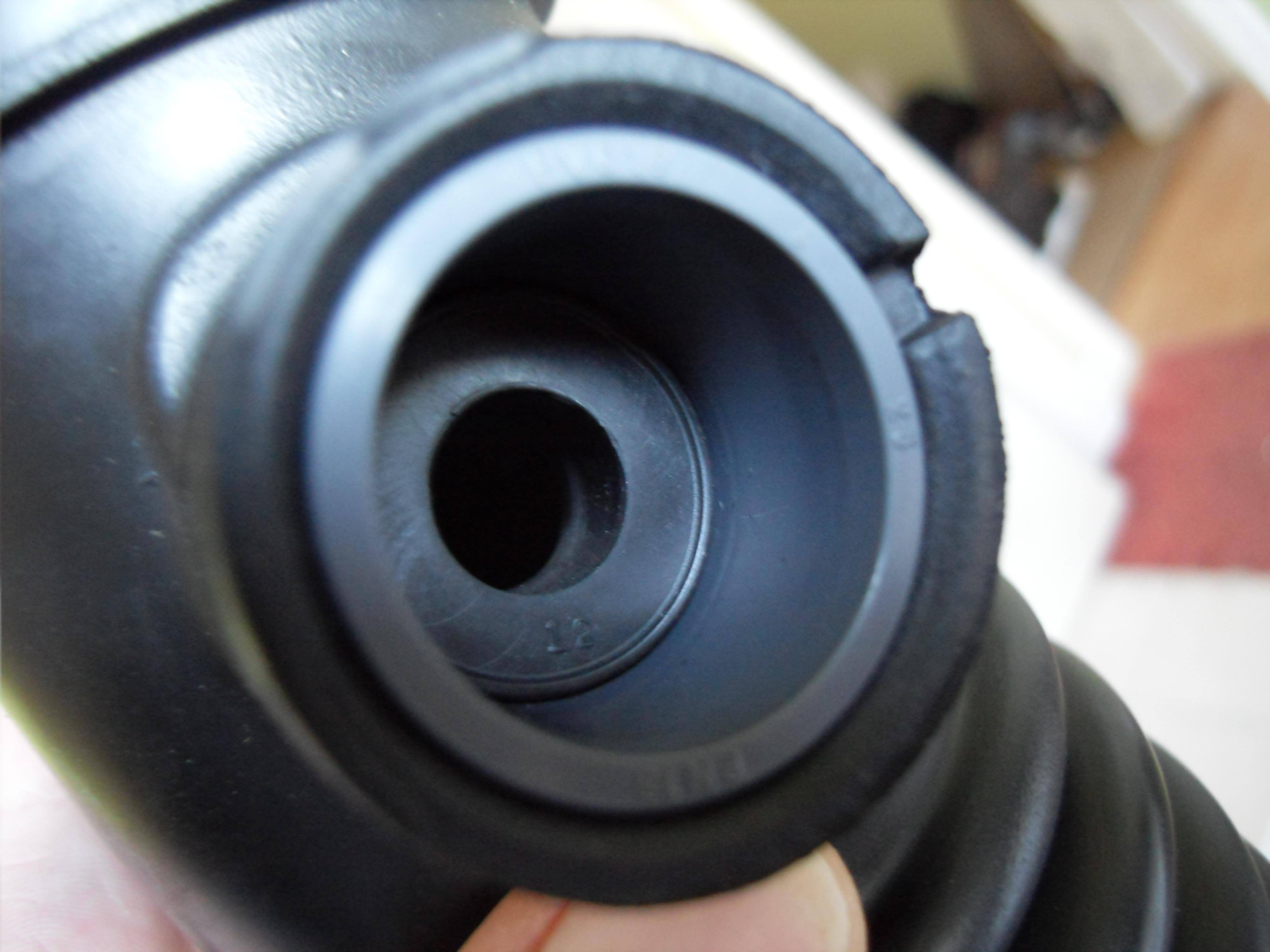

First i'm going to share a brainwave I had eriler today...
If you remove the stock air box you loose a place for the air intake temp sensor but if you keep the stock black rubber intake pipe I have a solution for you. Remove the intake resonator. Get ahold of a 25mm PVC plumbing end cap (I got mine from a aquarium supply place fishfurfeather.com). Use the grommet from the stock air box and make a hold in the end of the end cap and insert the grommet. Trim the round disk section of the air intake sensor and then insert that into the grommet. Now fit this assembly in the hole left by the resonator. Photos below...
SDC10487.thumb.JPG.0452c34cbeed324513ab6d8ec11963f0.JPGSDC10489.thumb.JPG.970f34bab649cf6709c3df5d8030744c.JPGSDC10490.thumb.JPG.5112e87694cdfd2098b00acf8ebb8c61.JPGSDC10486.thumb.JPG.0011f3d23c2b10d44cfb9dddd36b6a5d.JPGSDC10488.thumb.JPG.f438b47b923fc731650ceaabe6b55b63.JPG

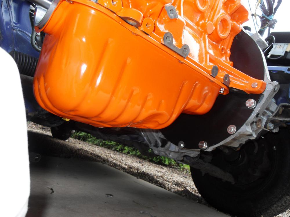

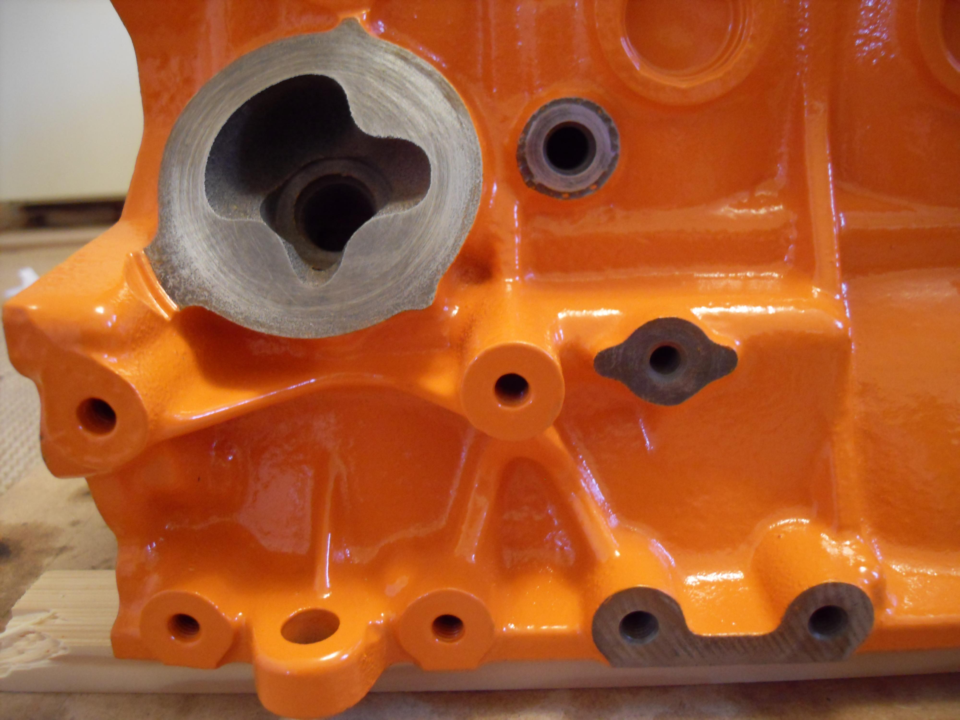

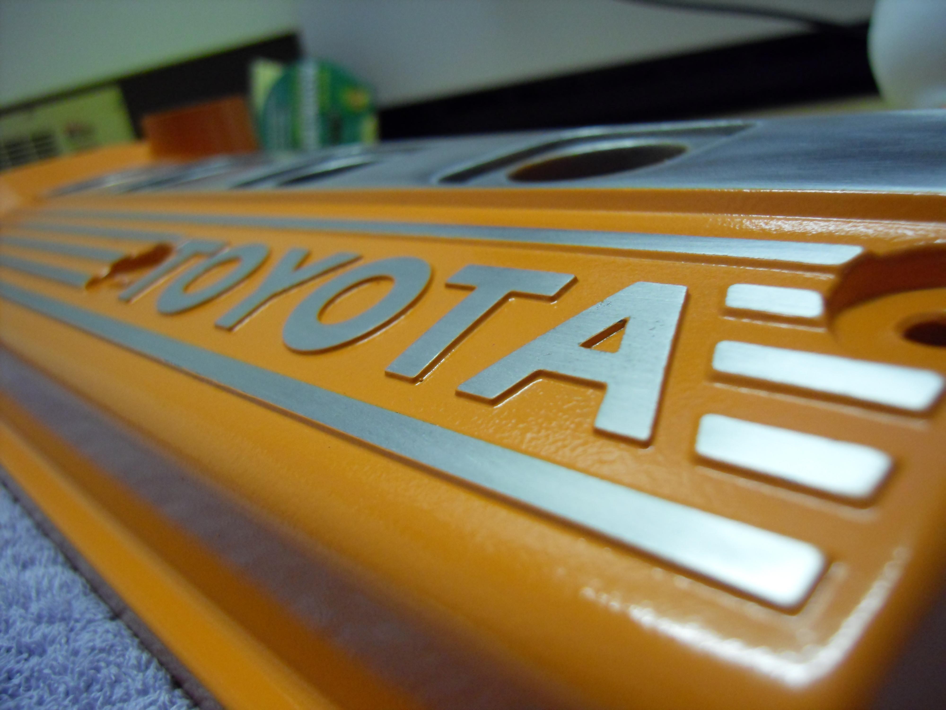

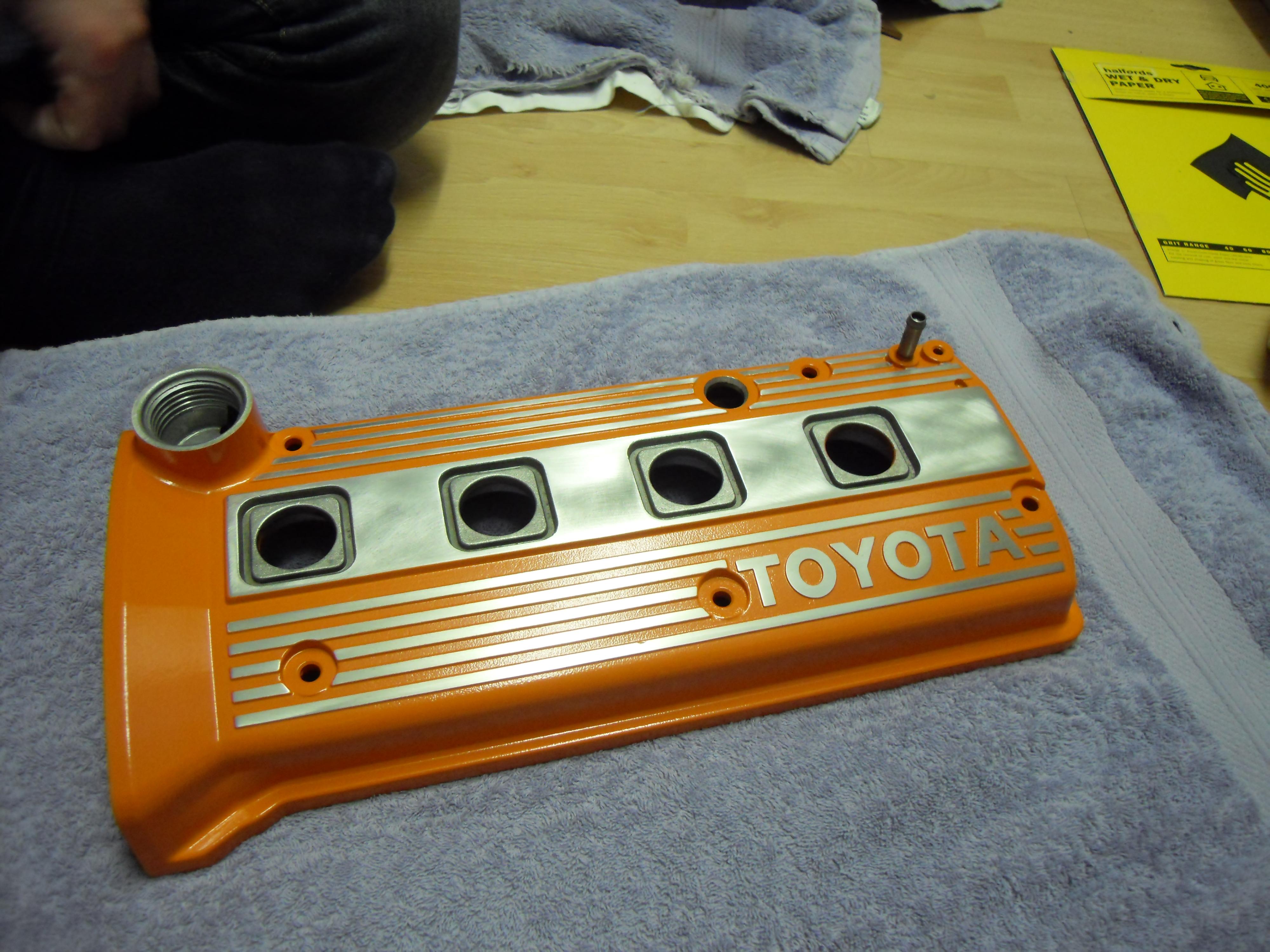

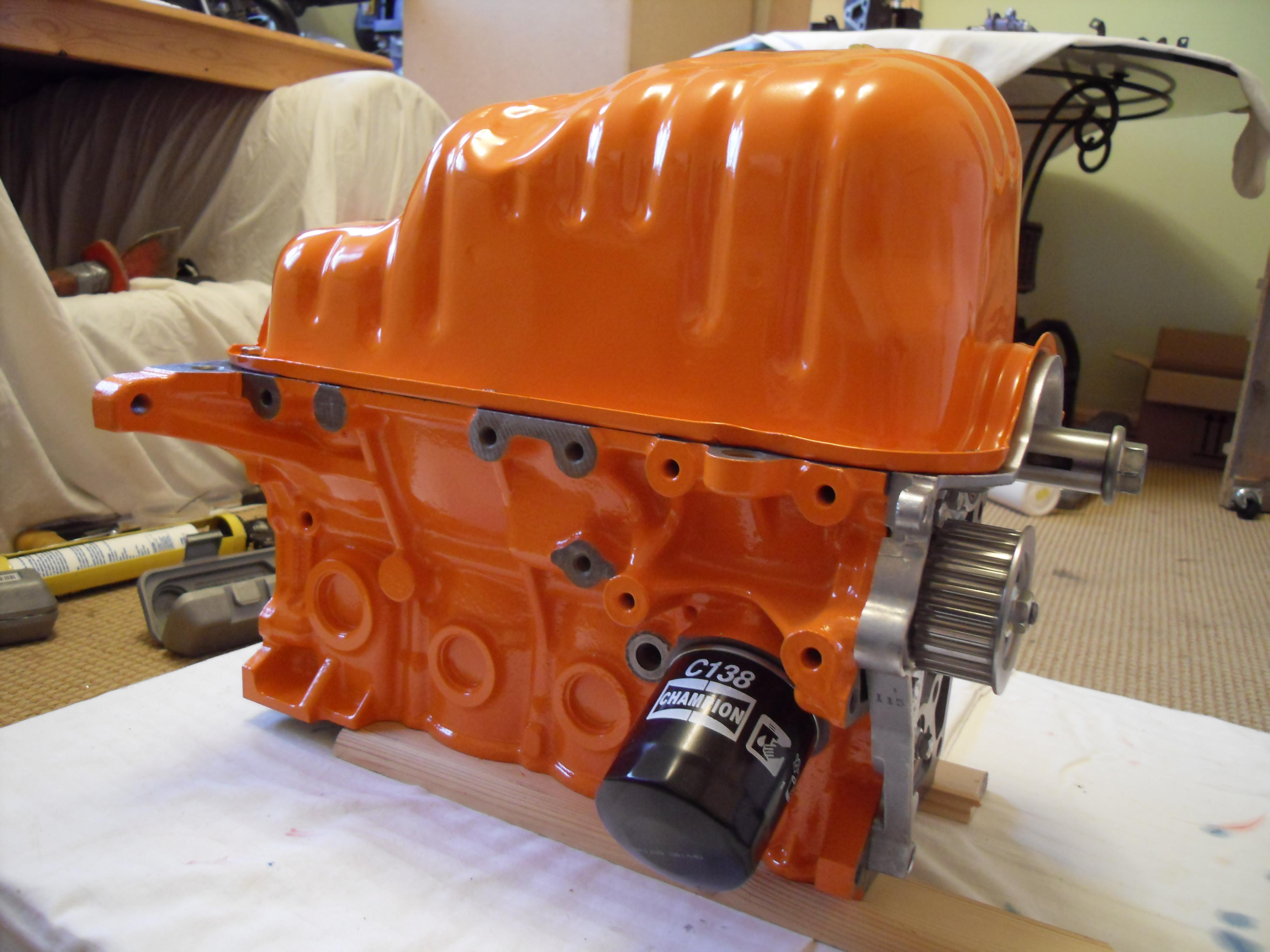

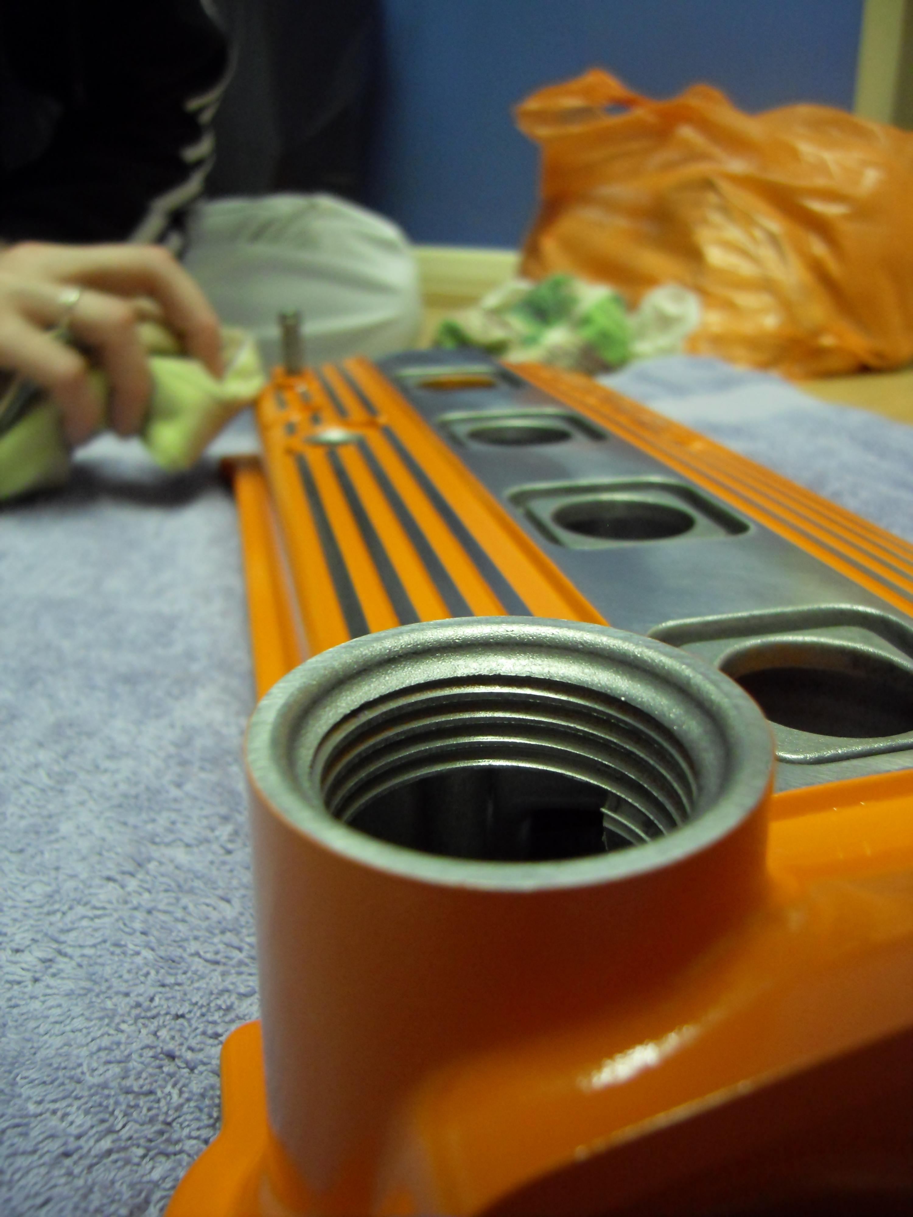

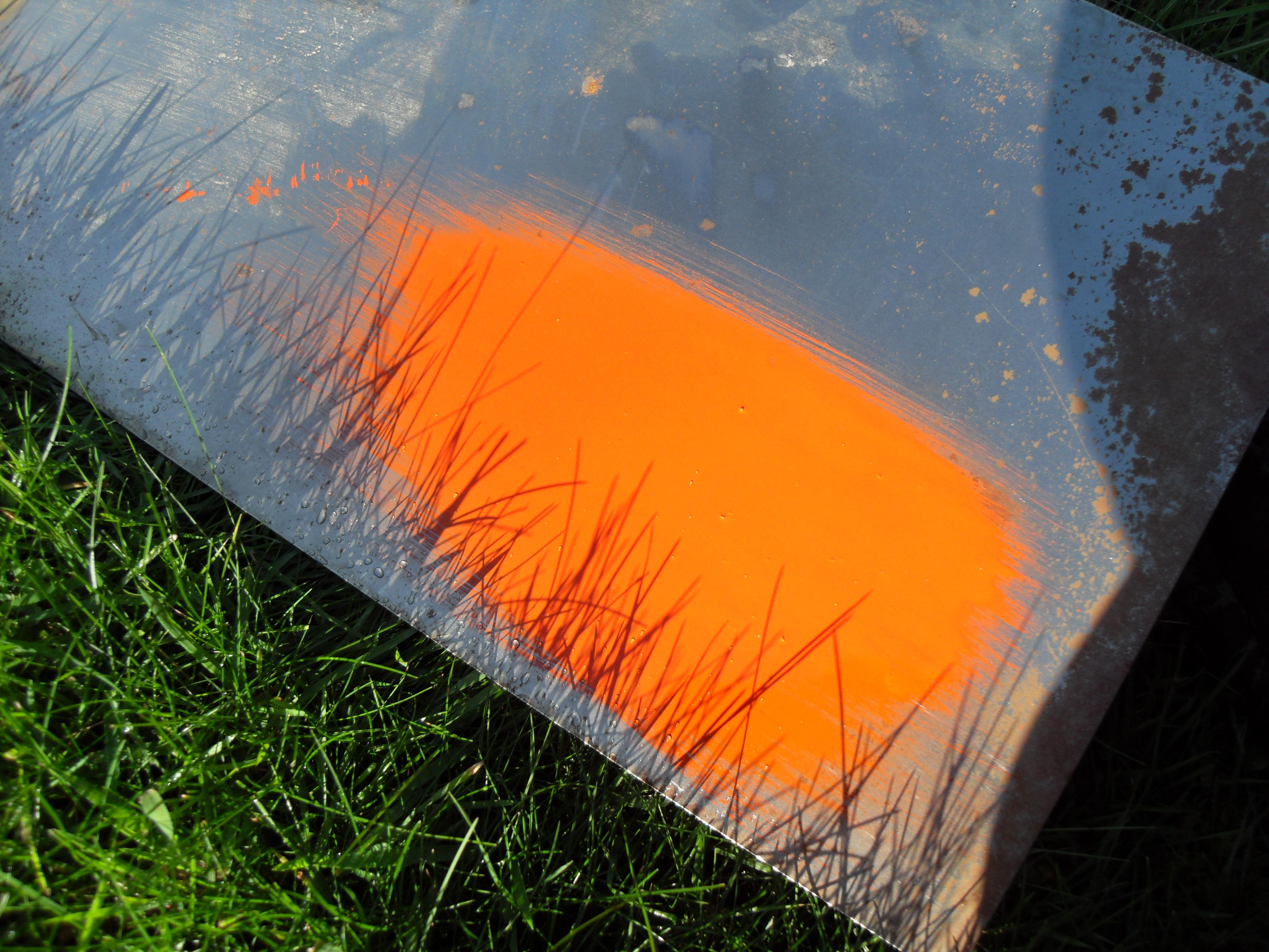

Now for todays update wicked, super, fantastic, chevy orange engine enamel
SDC10491.thumb.JPG.e0d96b1cf5e10beed14e06b2827afd5a.JPGSDC10492.thumb.JPG.b7baef85a1c190787e85841a5741c208.JPG

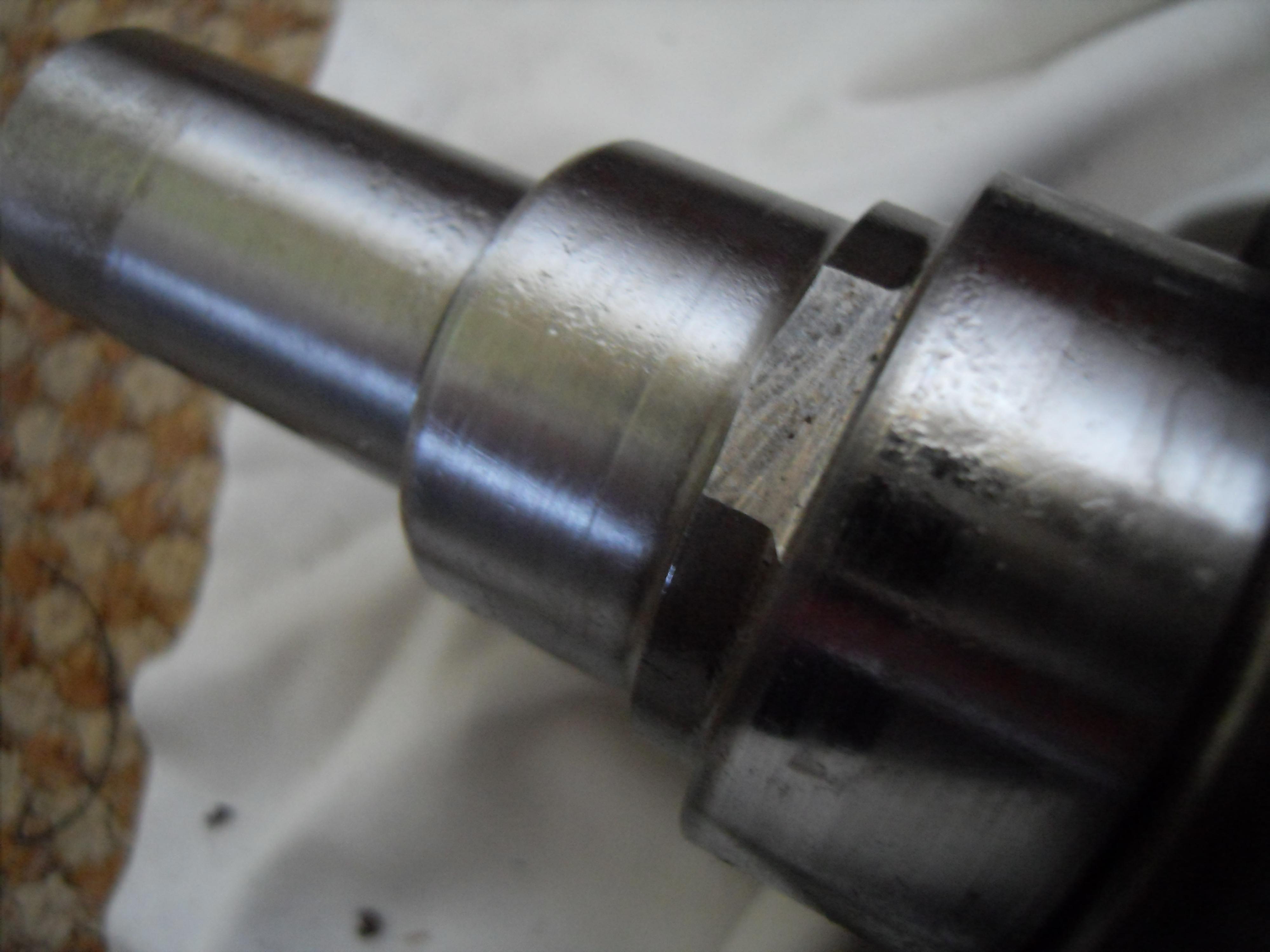

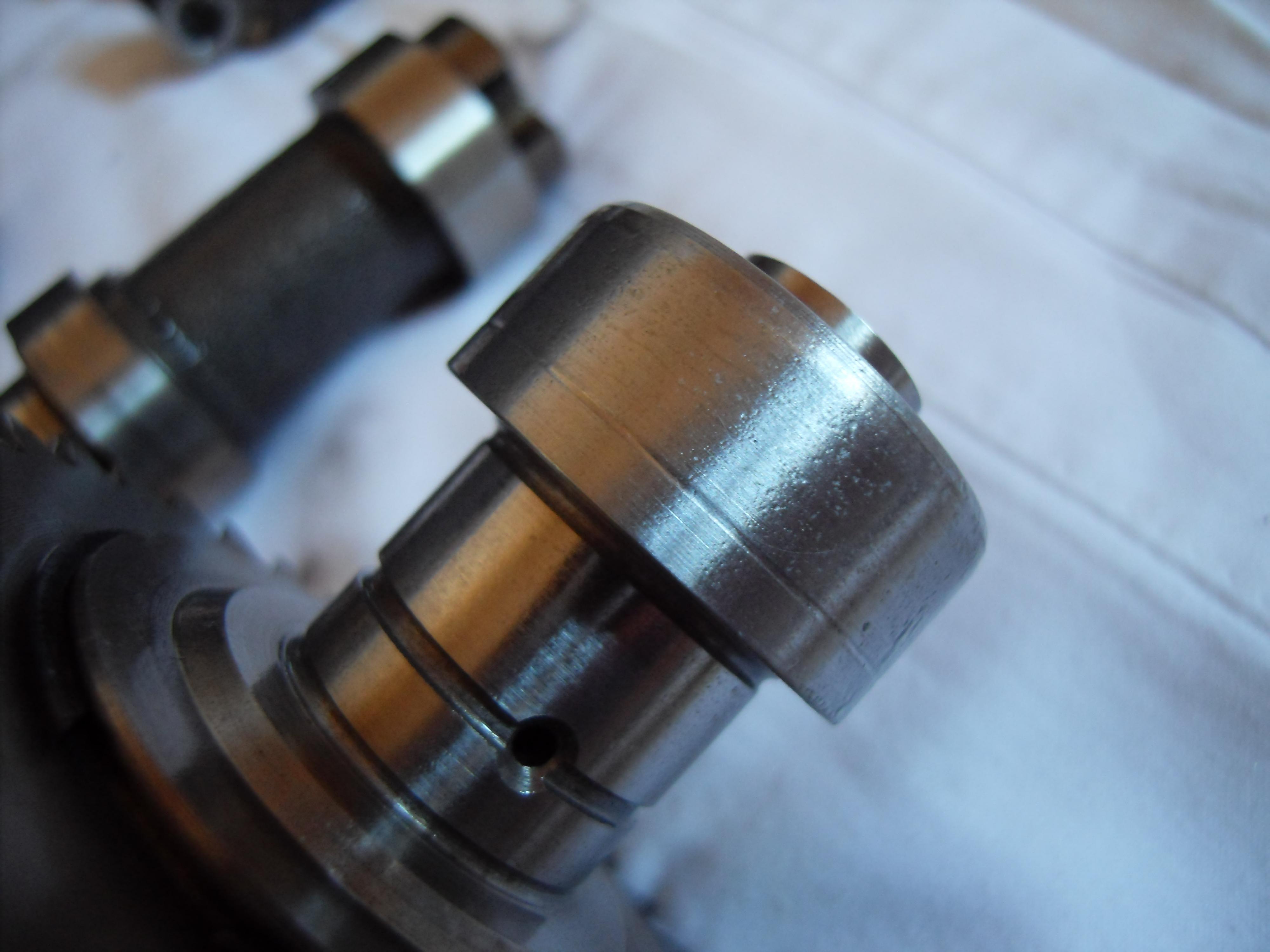

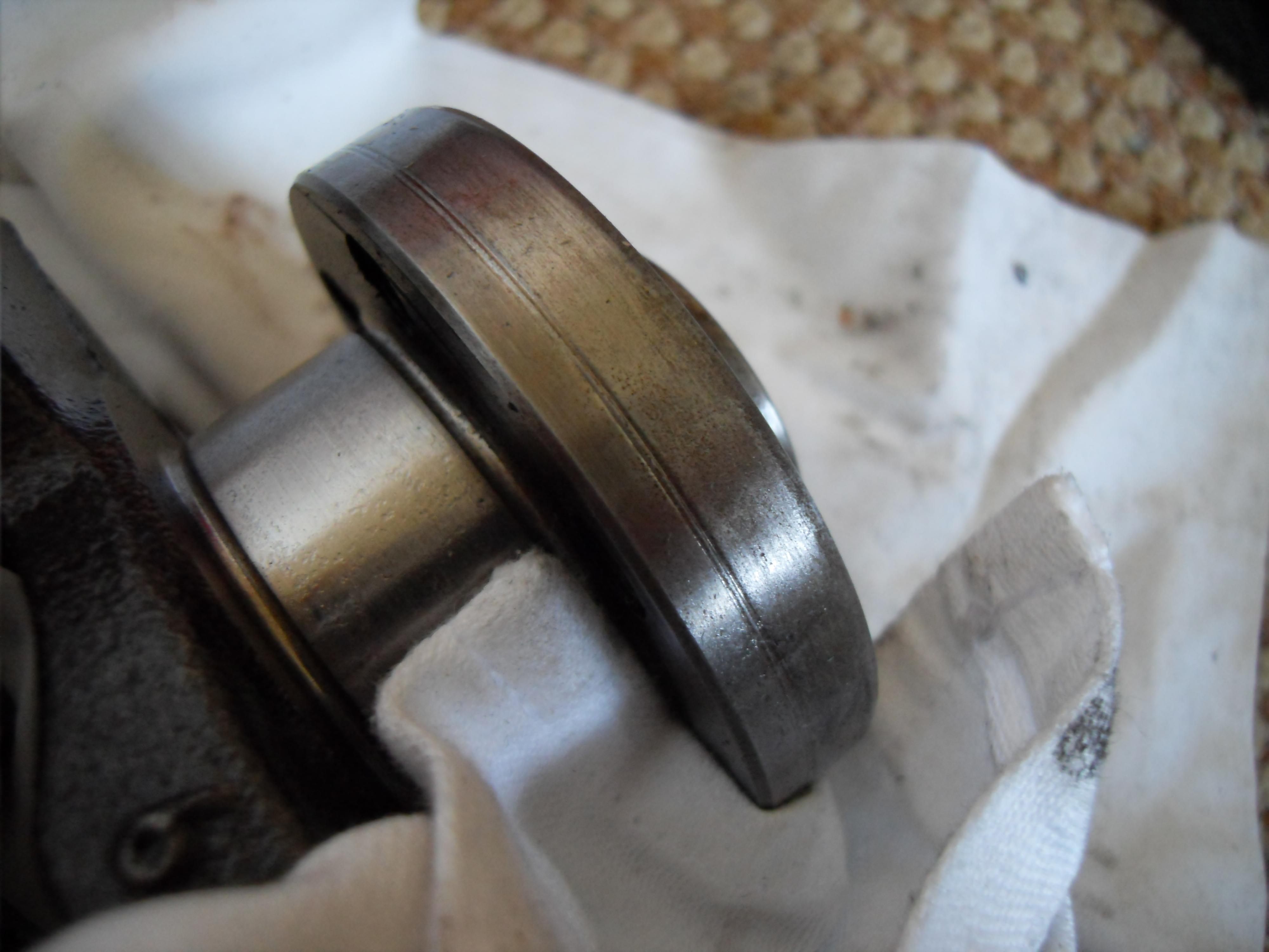

And something I find really funny there is more ware on the oil seal riding faces made by the lips of the seal than in the rest of this engine. lol How can rubber do this?
SDC10483.thumb.JPG.9bfe6a5808ade516d3ab4b7d83d1187d.JPGSDC10484.thumb.JPG.894cd9b930af299f7e9630ad74572112.JPGSDC10485.thumb.JPG.7b331839eac8bc357df672e566b0b541.JPG

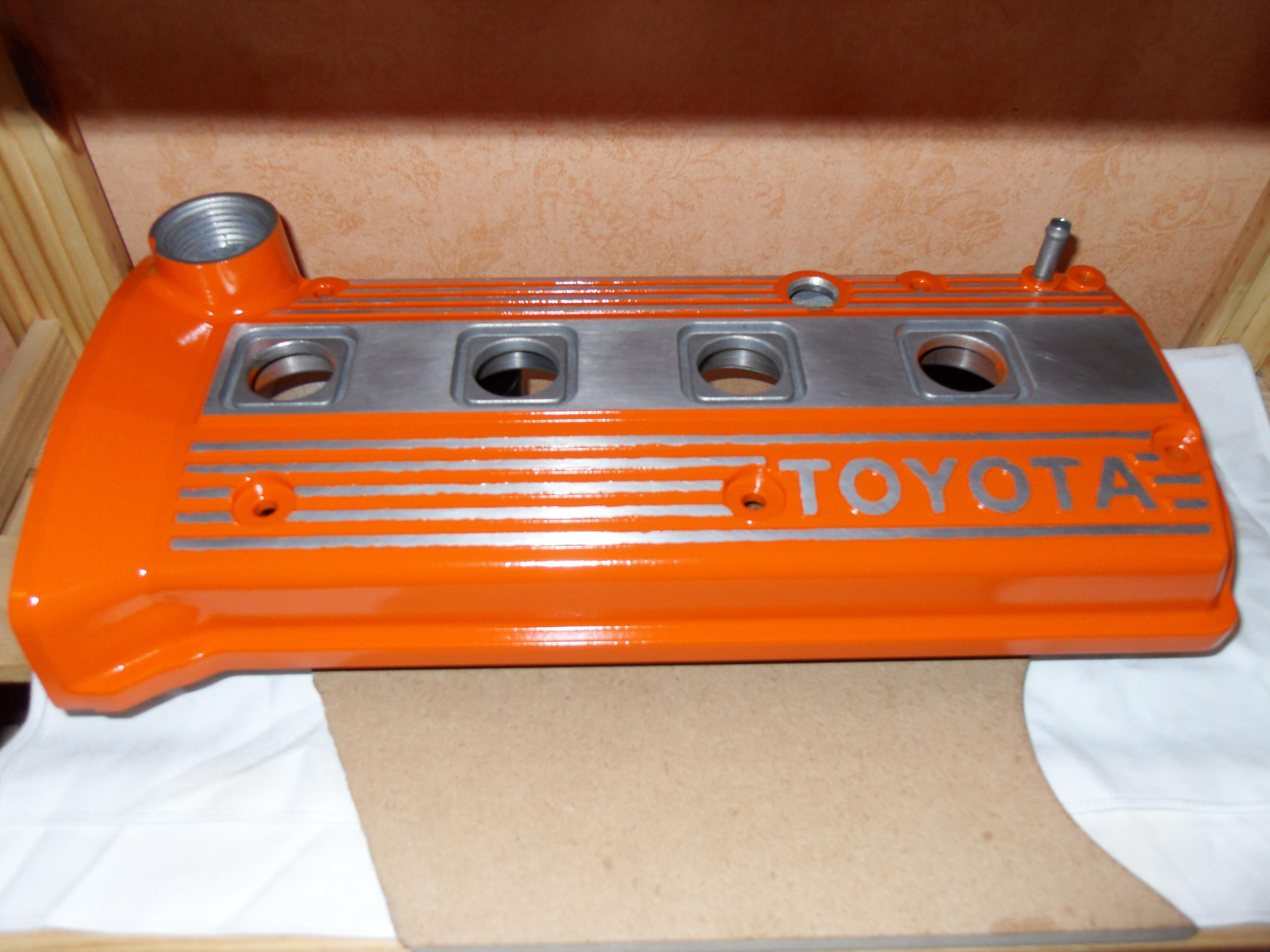

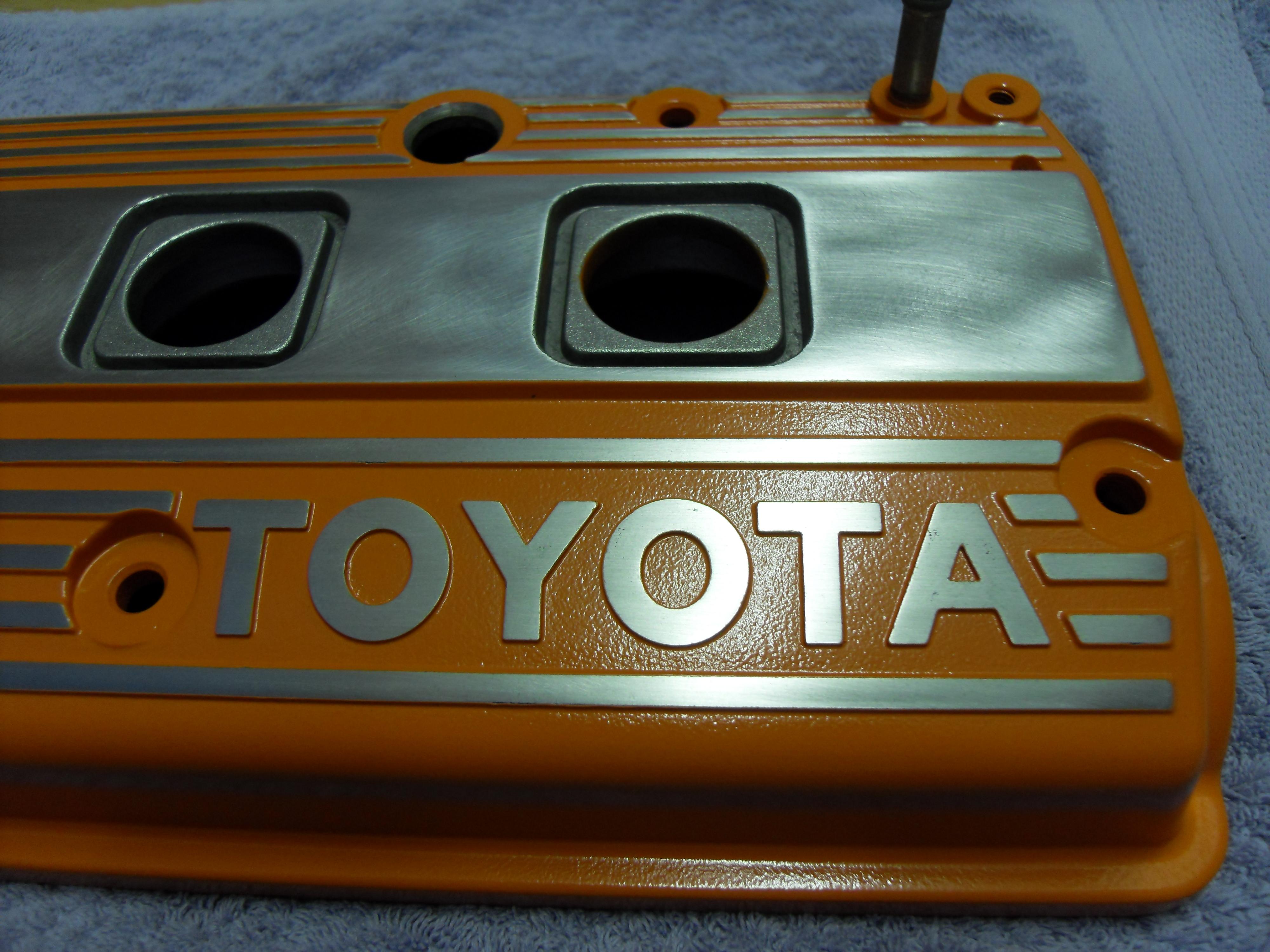

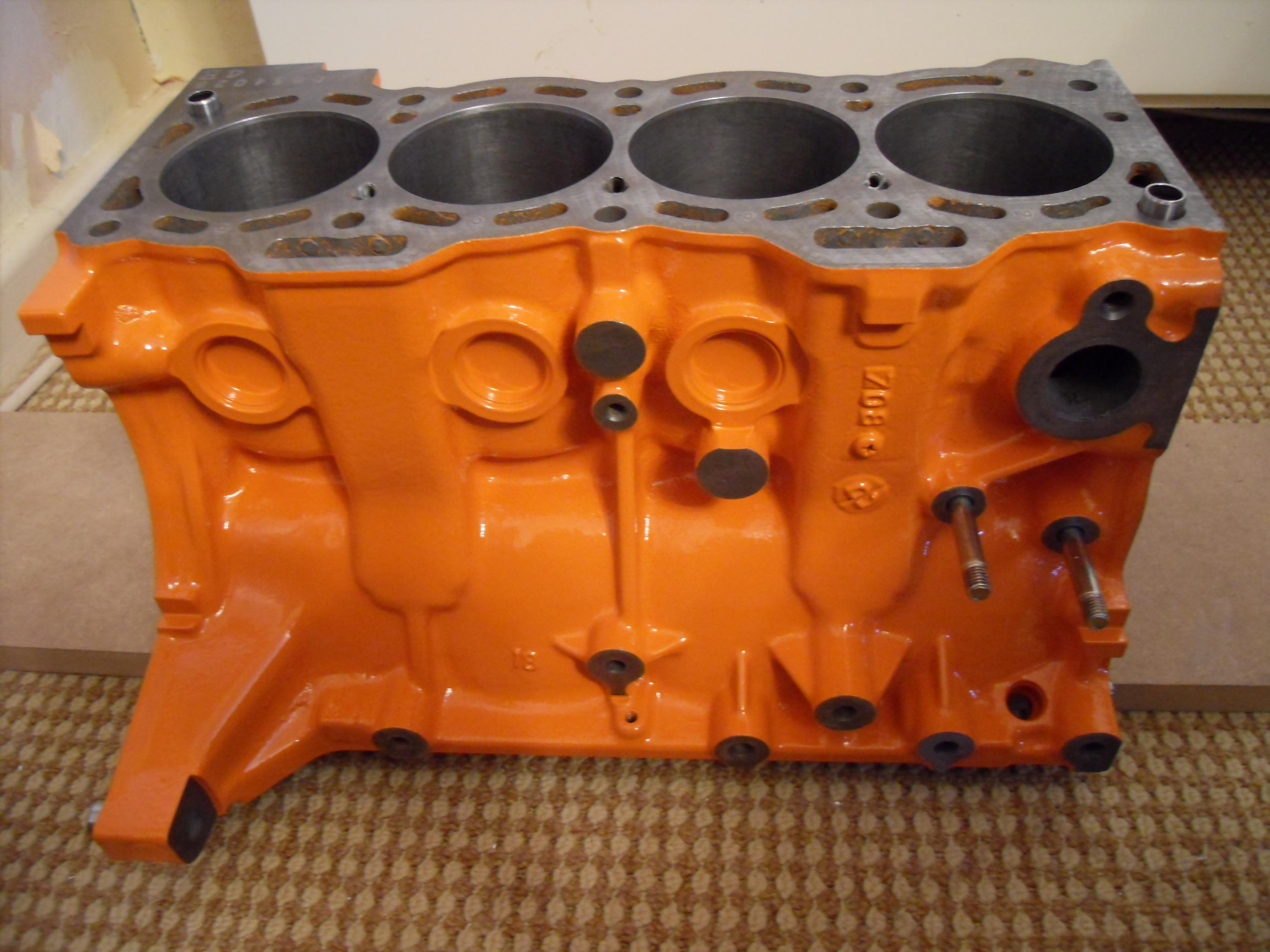

Sorry it's been a while since I mentioned a small orange coloured update above^^ which was going to be photos of the block and rocker cover painted. I had an orange artistic tantrum. in other words I didnt like the shade of orange so sent it all out to be acid diped again.
Rocker cover and block painted but not cleaned up/polished.
SDC10501.thumb.JPG.732e086c92ef982d528fa070d1167a6a.JPGDSC00453.thumb.JPG.20670c89f56f41114400a47c524fea34.JPG

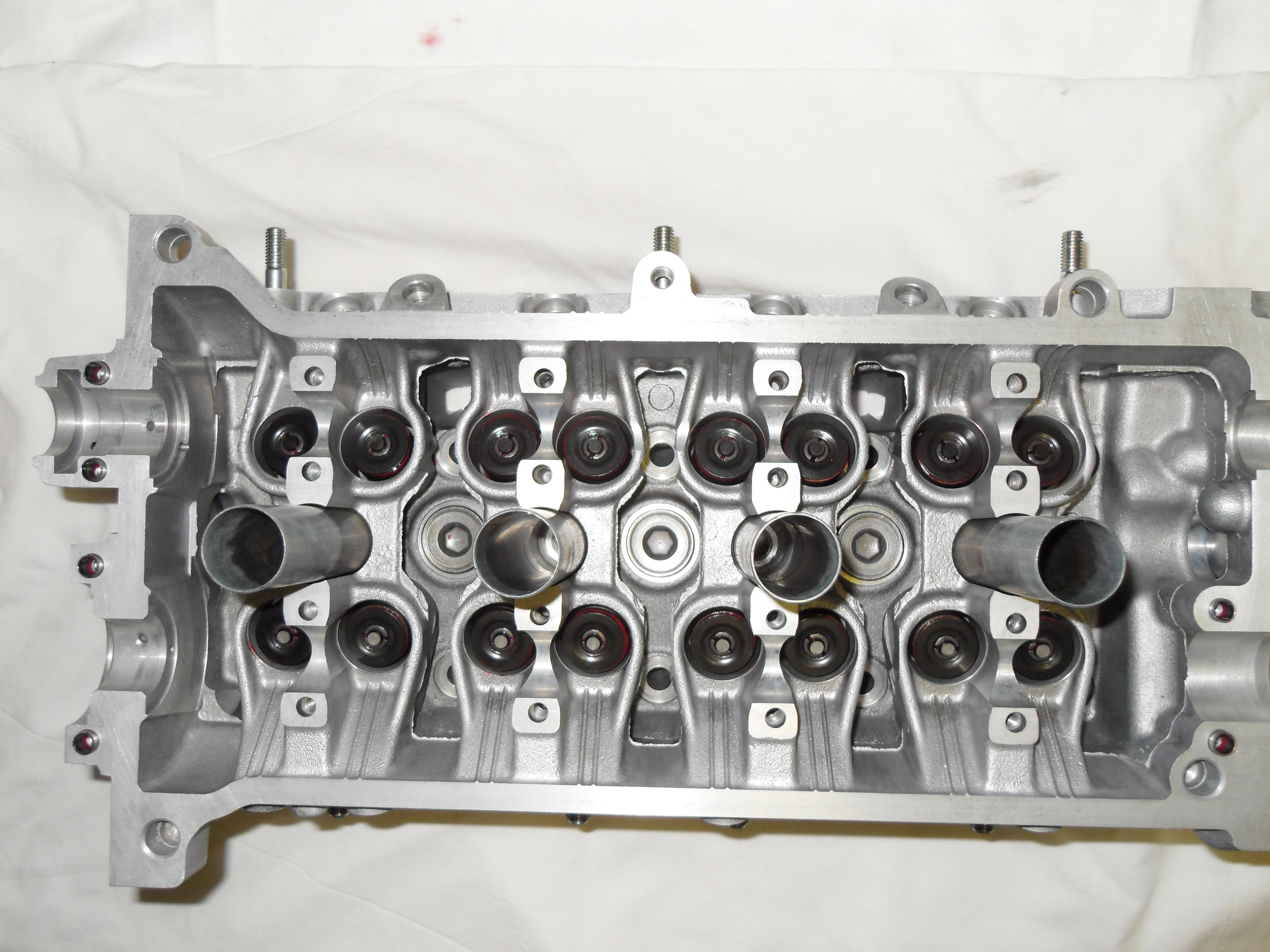

I just thought I would post a little update to let people know that im still working on this.

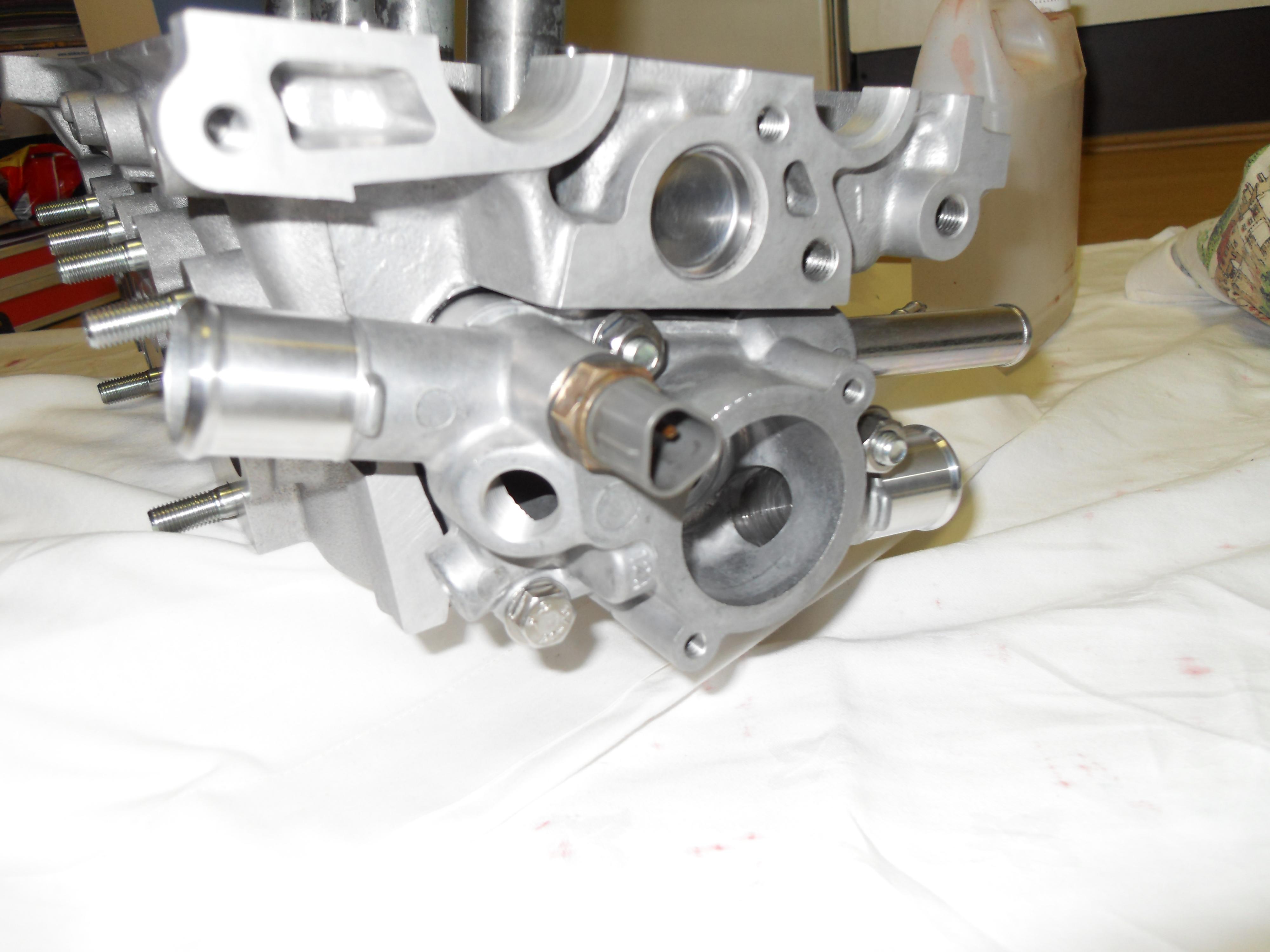

I rebuilt the head last night and I simply cannot wait untill its finished. Its been in bits about 2 months now and I really miss my car but it is starting to look kinda like an engine again. yay
SDC10535.thumb.JPG.896824e6572109be5c6acd95abf36095.JPGSDC10534.thumb.JPG.233505a51bde13fb2e30e9816664f833.JPGSDC10536.thumb.JPG.dea3ec5d0190b6b20523714135b3d3f1.JPG

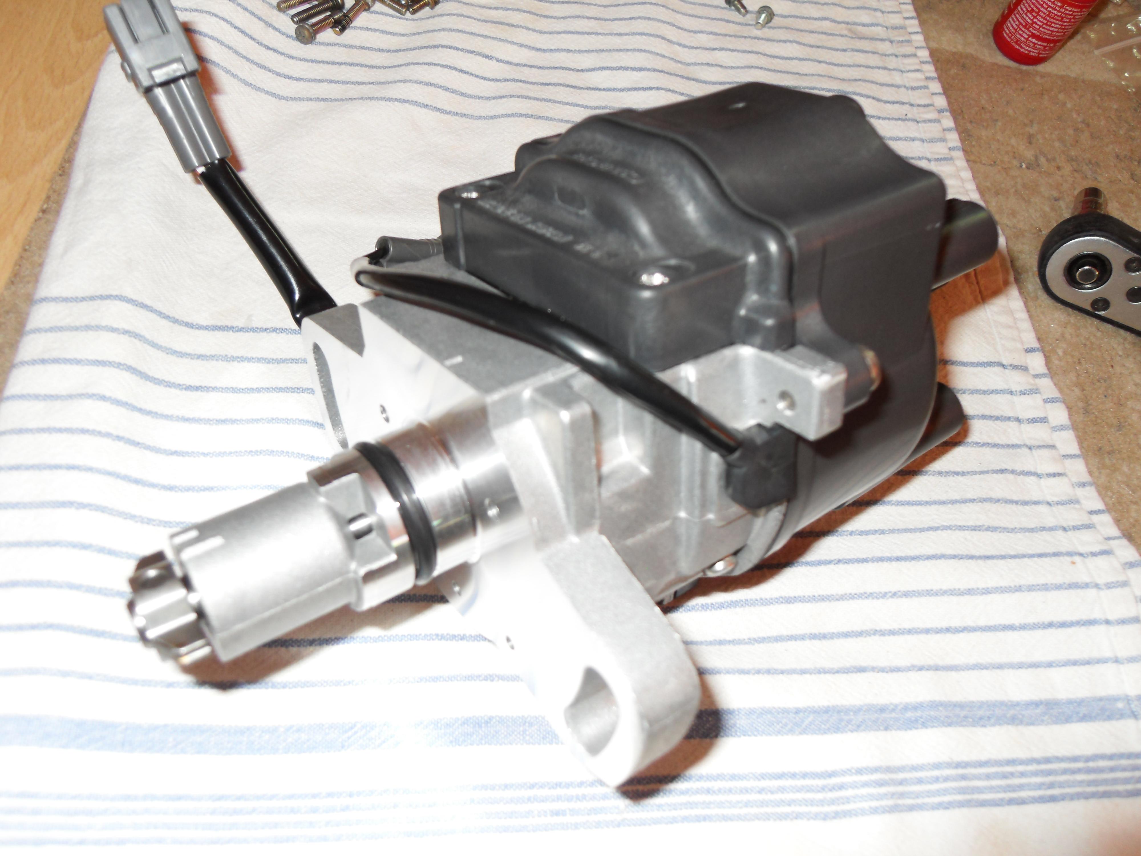

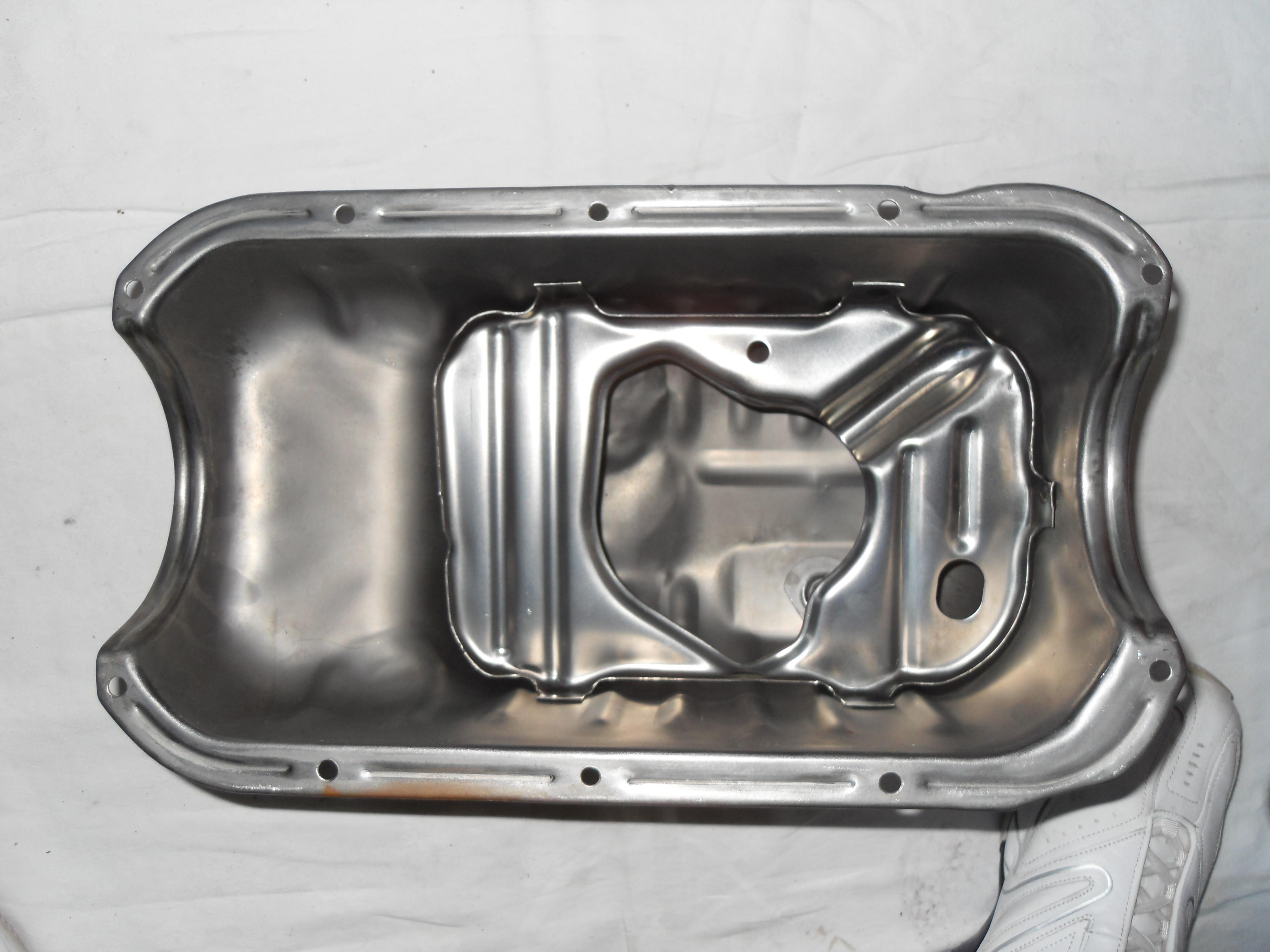

I have now finished cleaning everything and hope to start the rebuild on monday. I have lots of little assemblies cleaned and ready and waiting to make the rebuild easer.

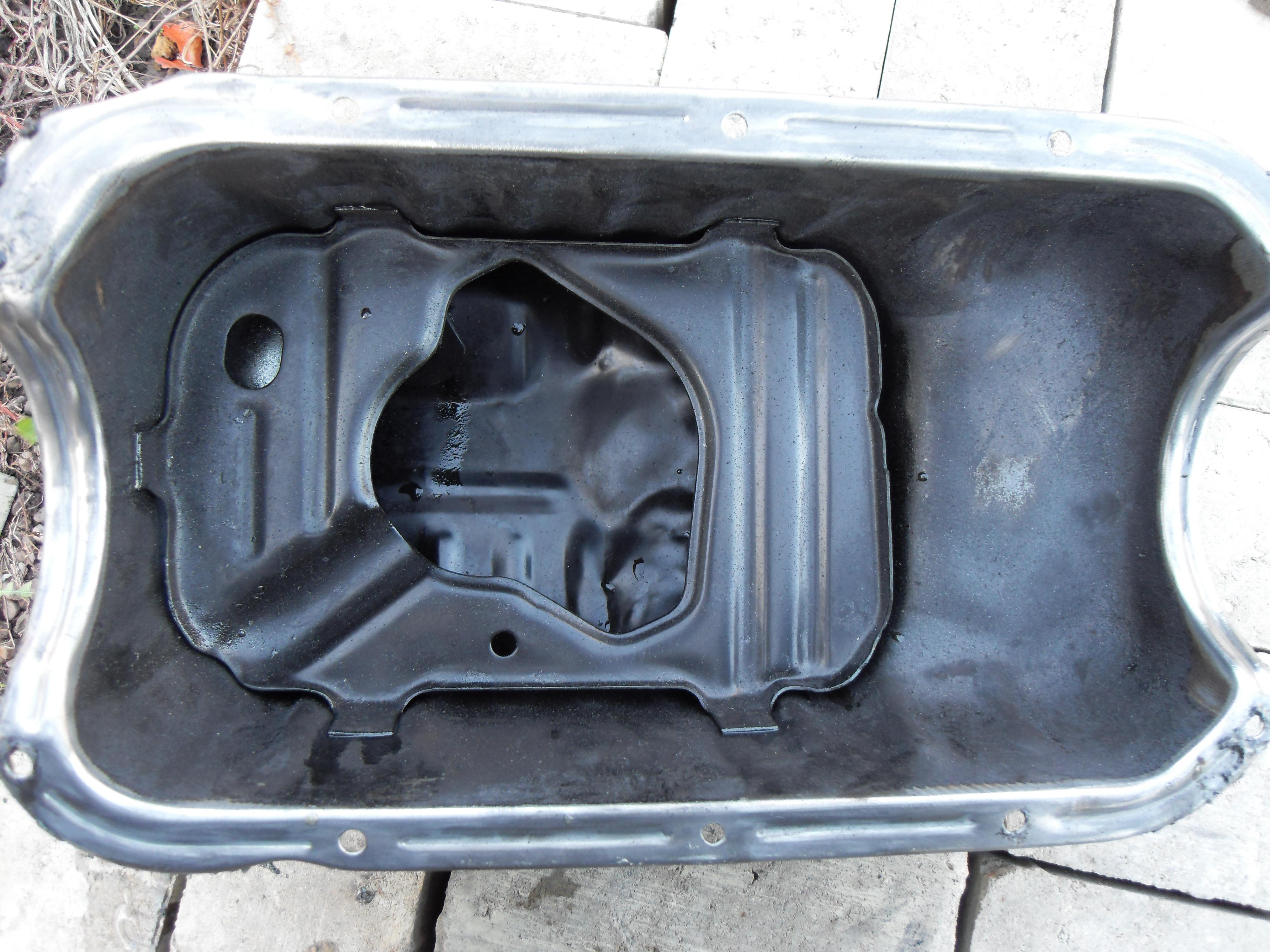

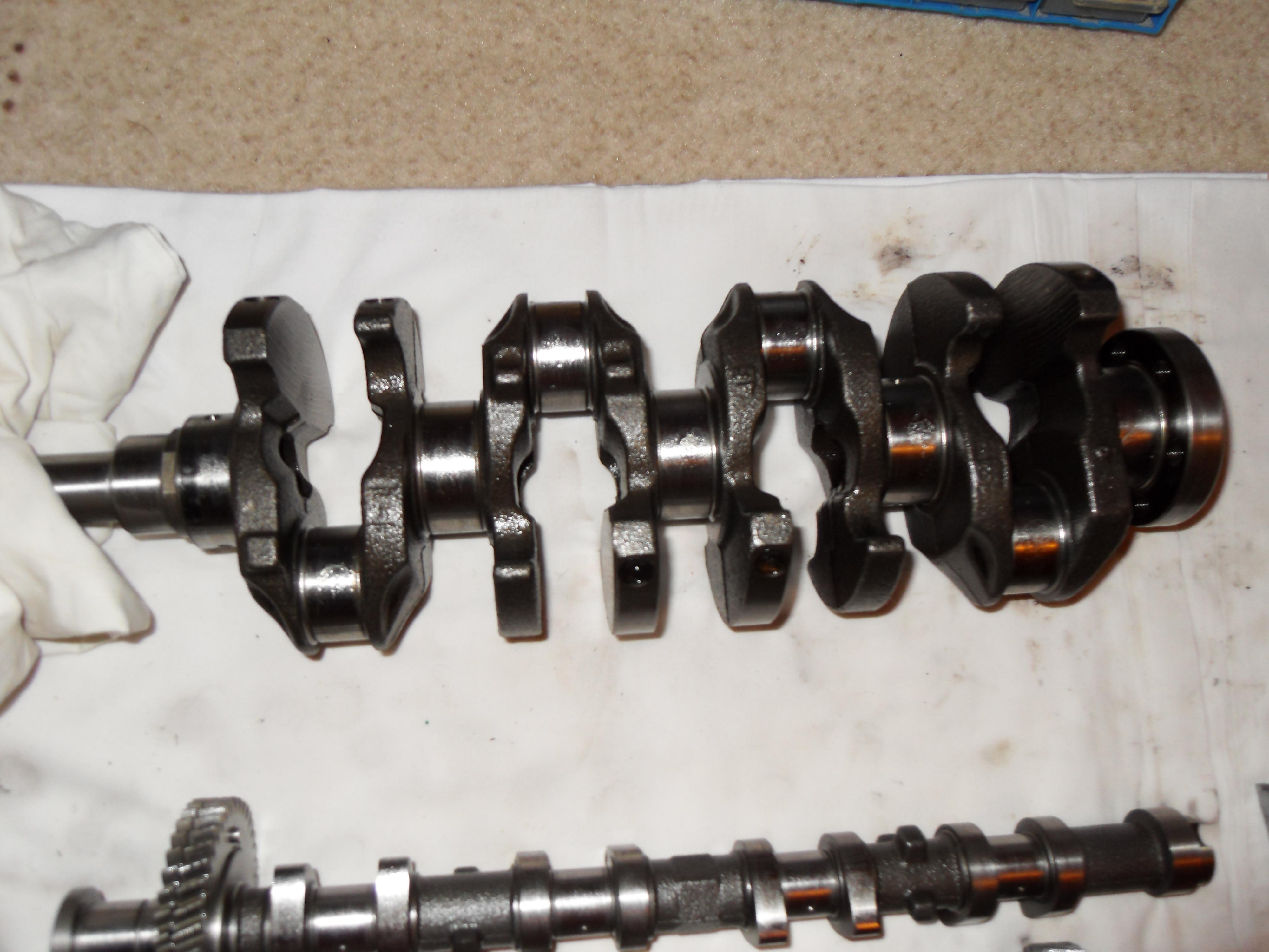

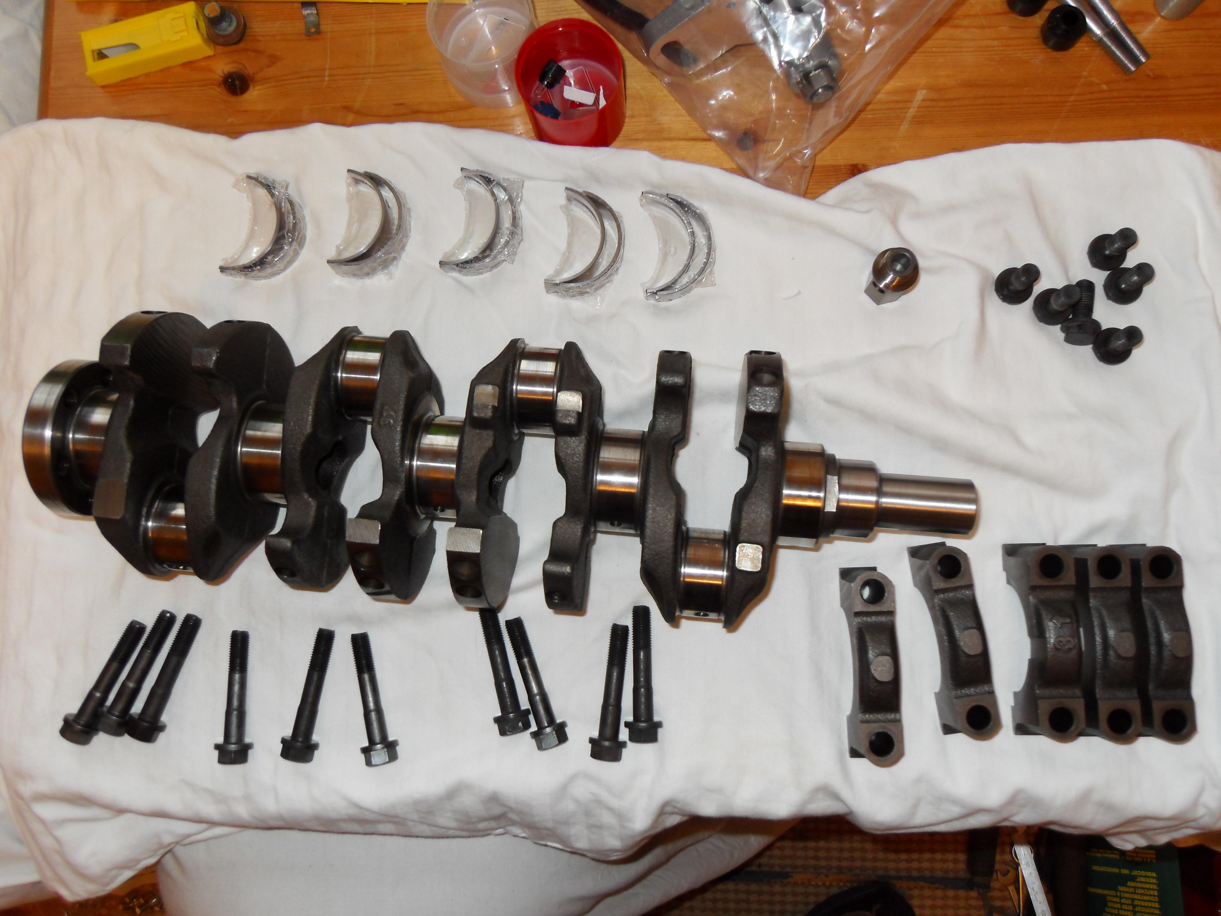

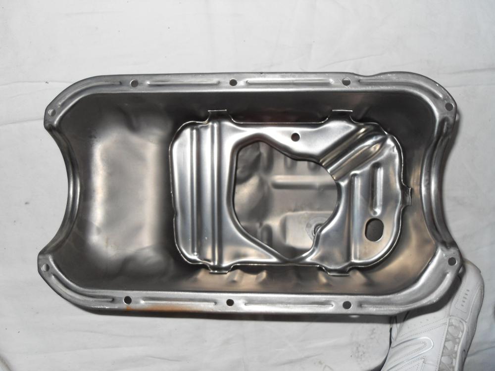

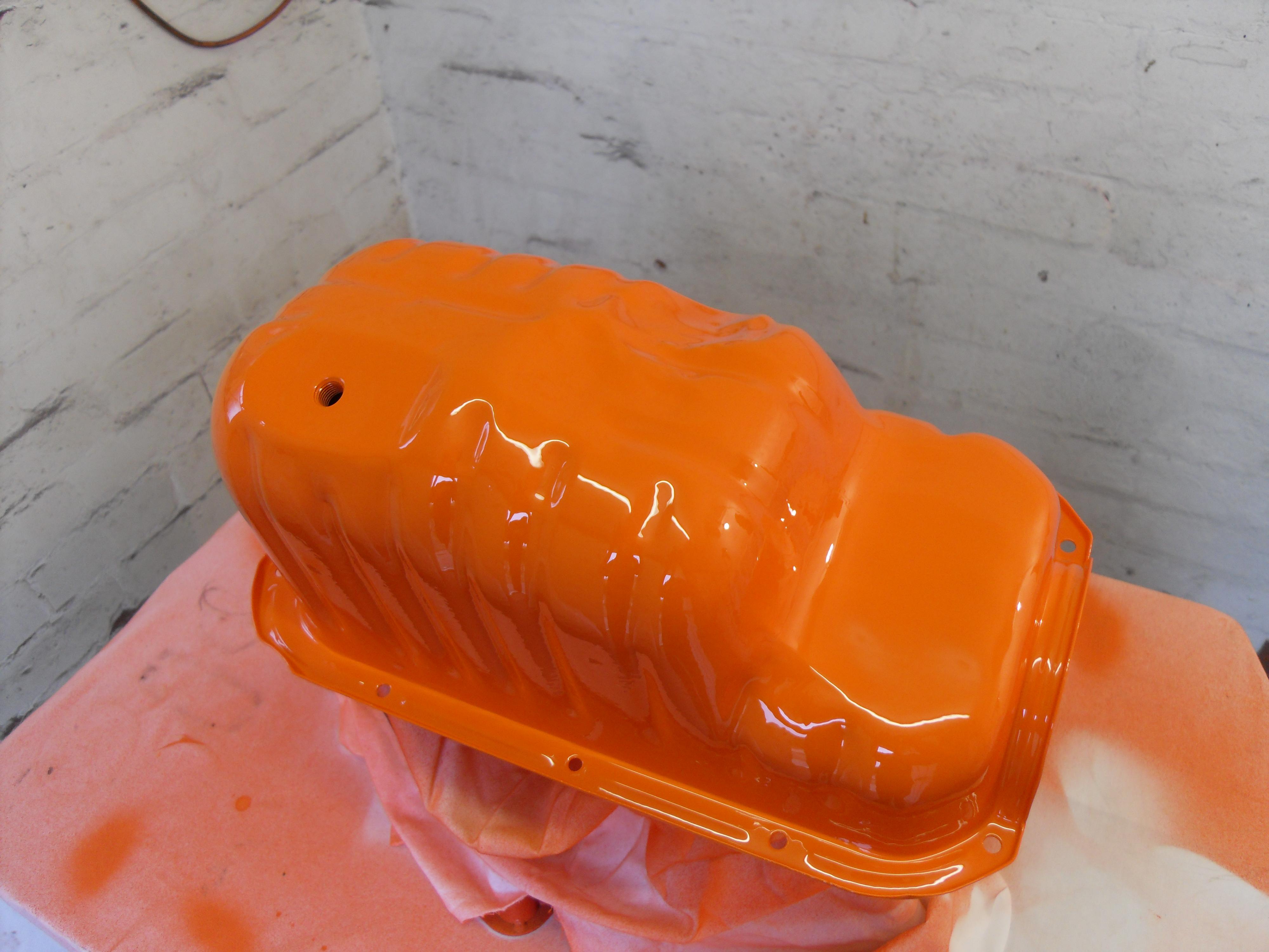

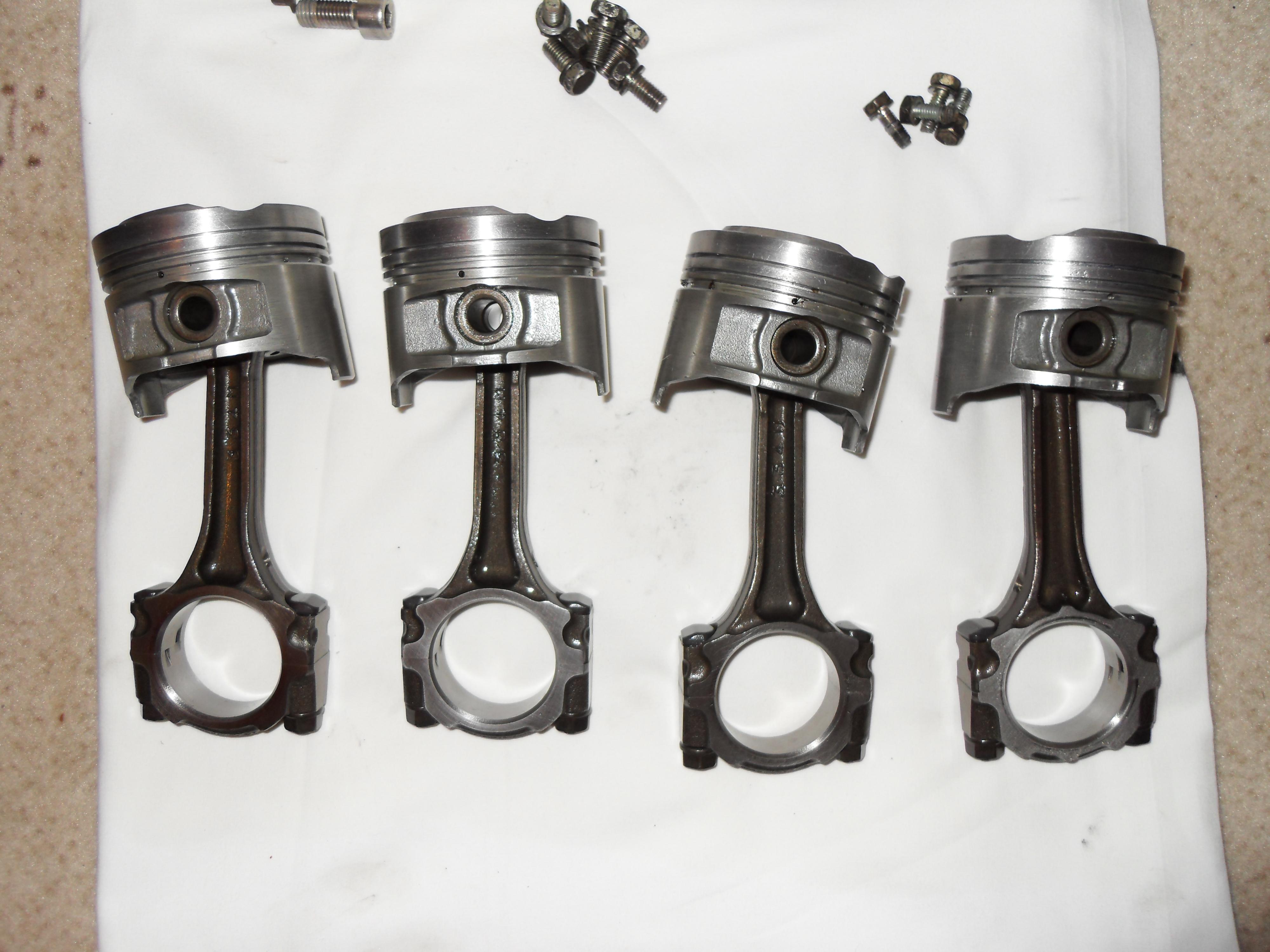

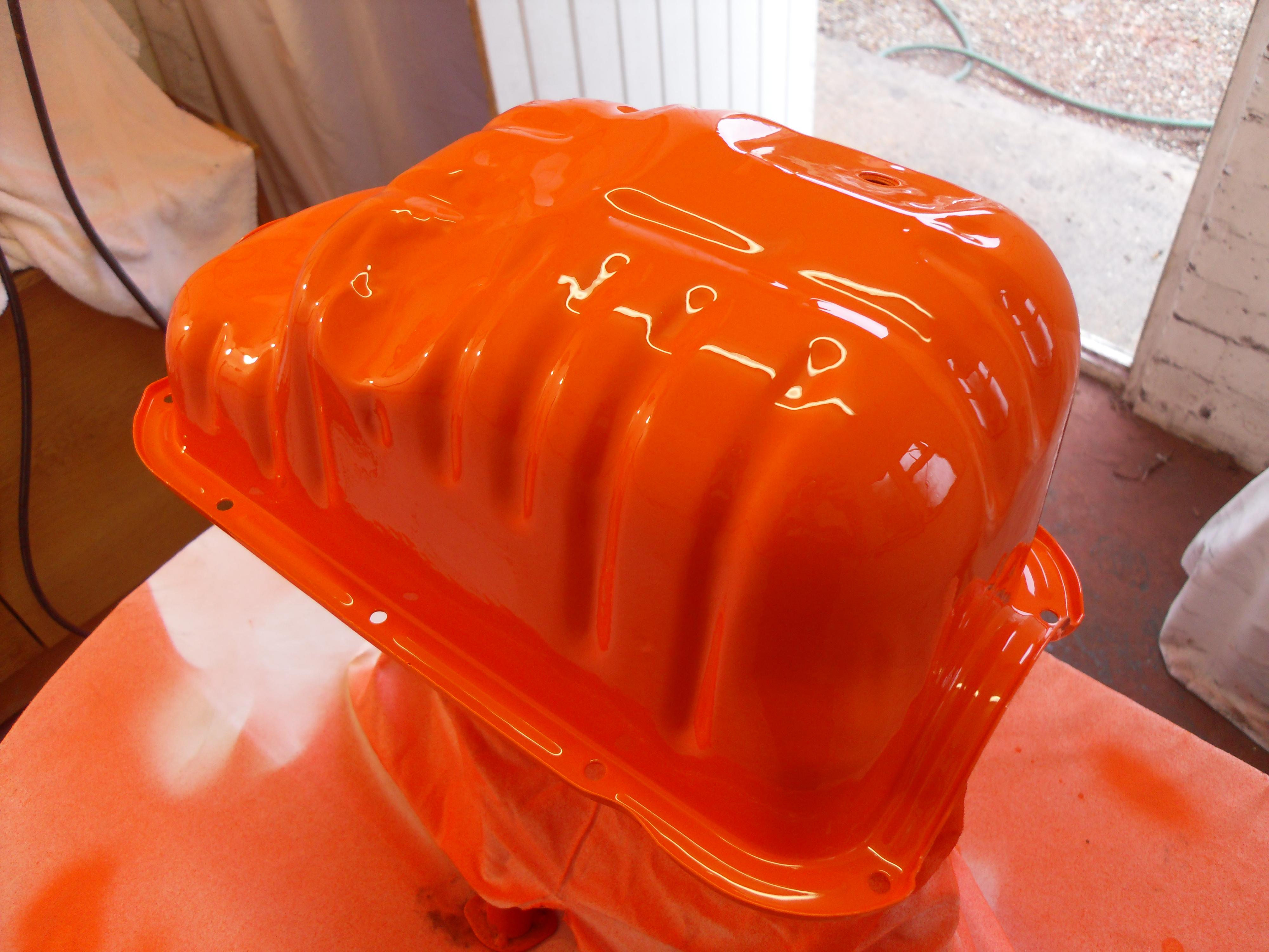

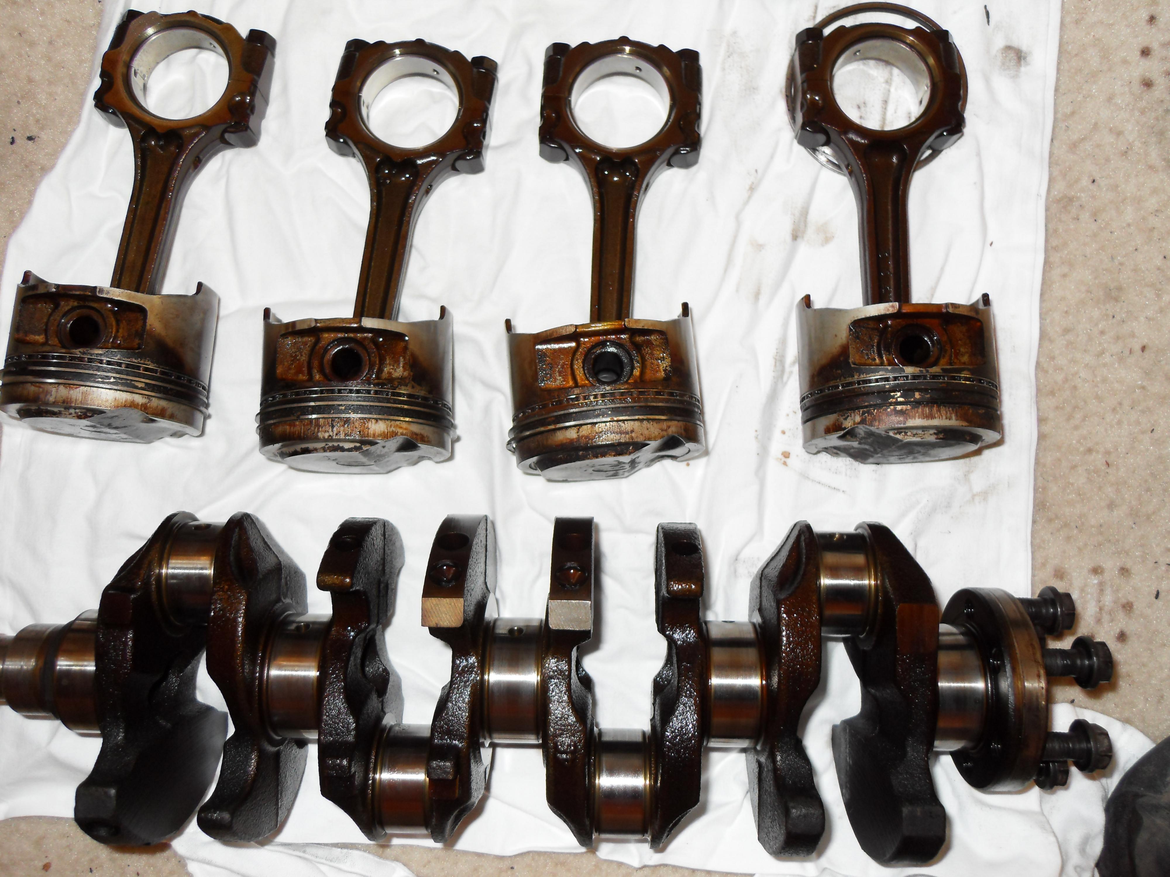

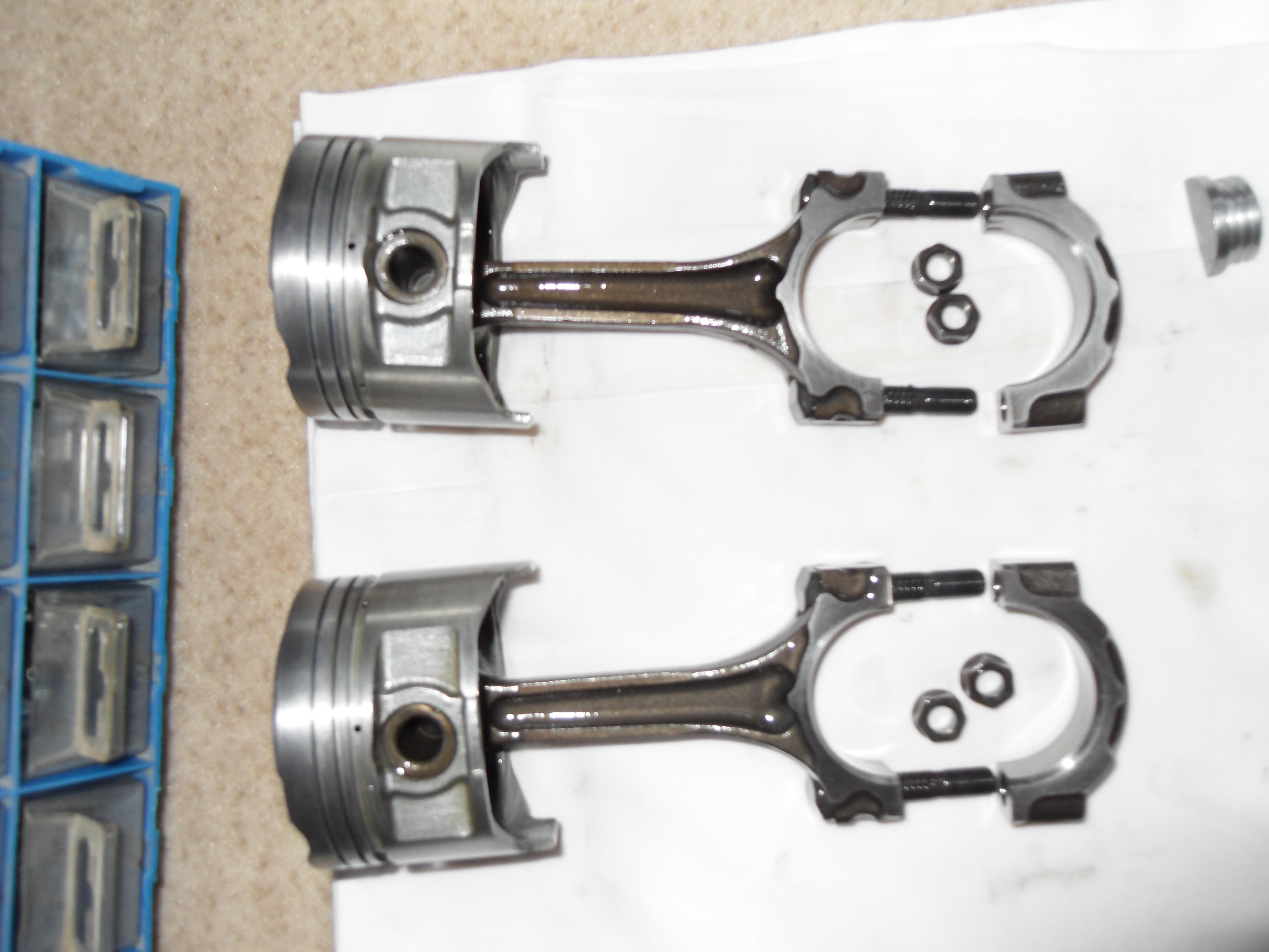

I want to stress how important I believe a clean rebuild is. I think pics are in order
Sump cleaned before painting
Crank cleaned

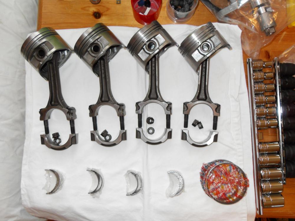

Pistons
Distributor cleaned and rebuild

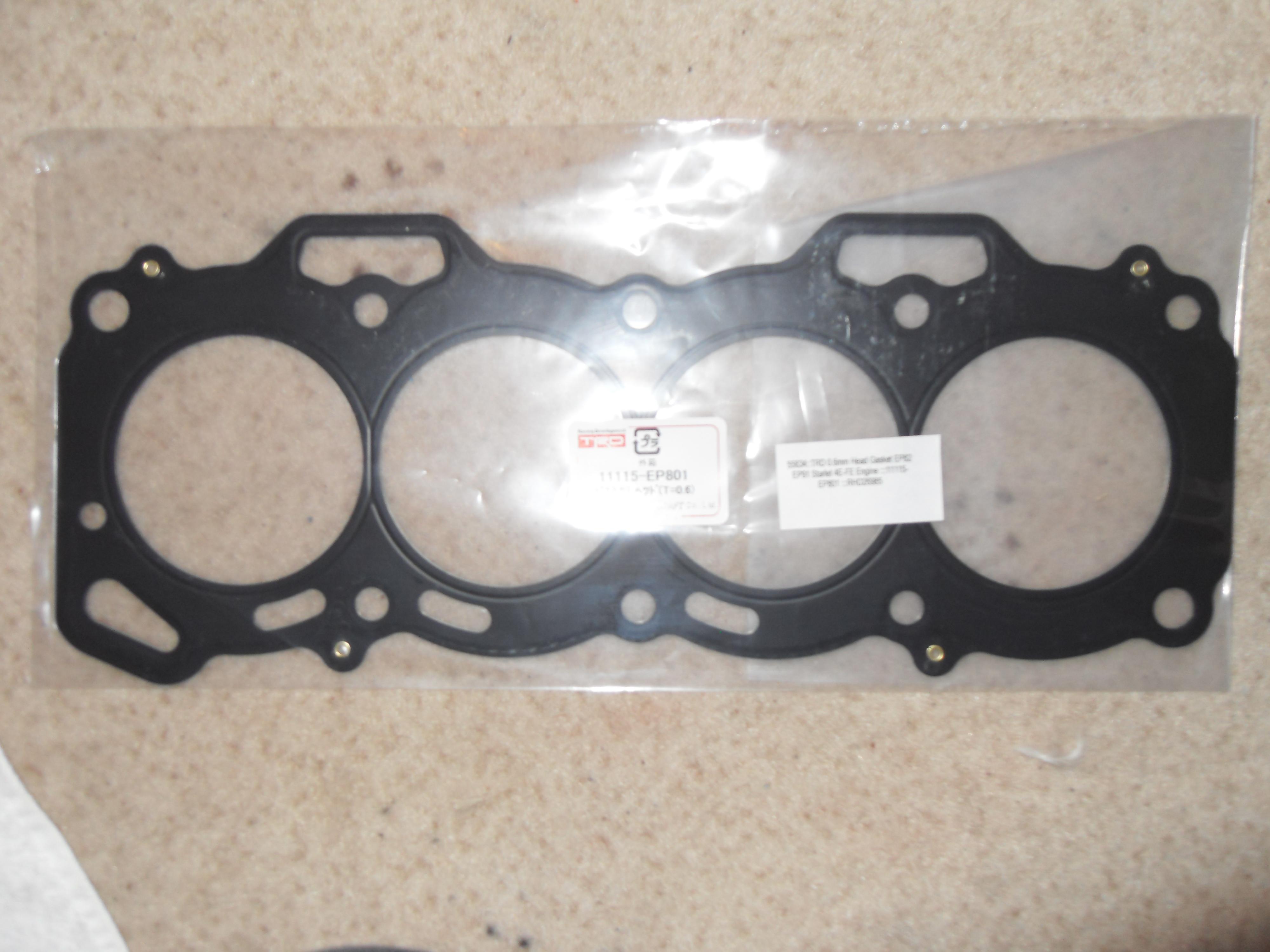

And I finally have my TRD head gasket. YAY

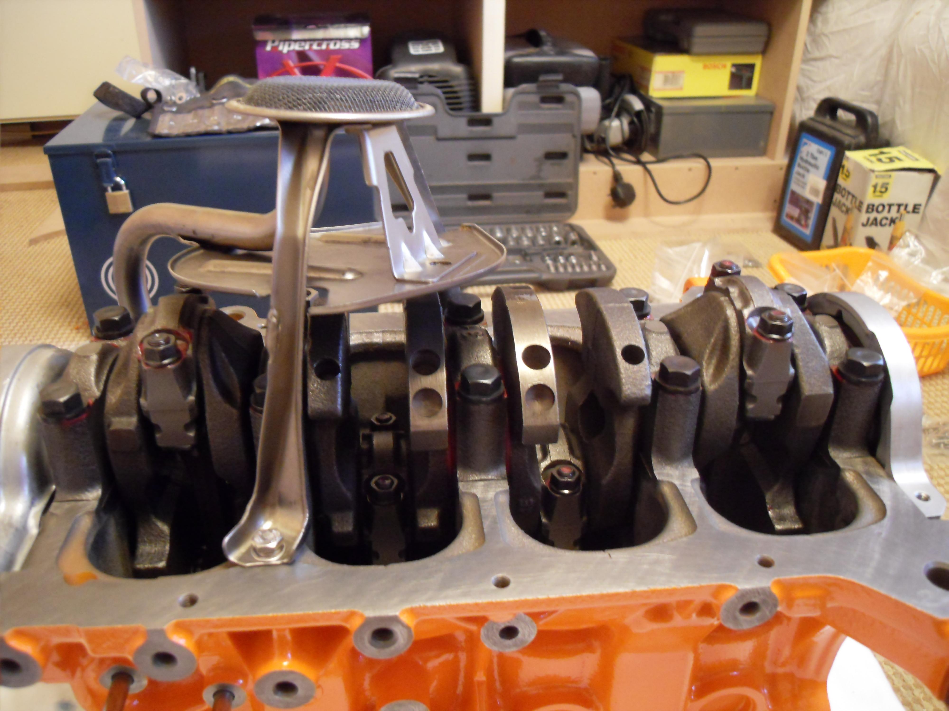

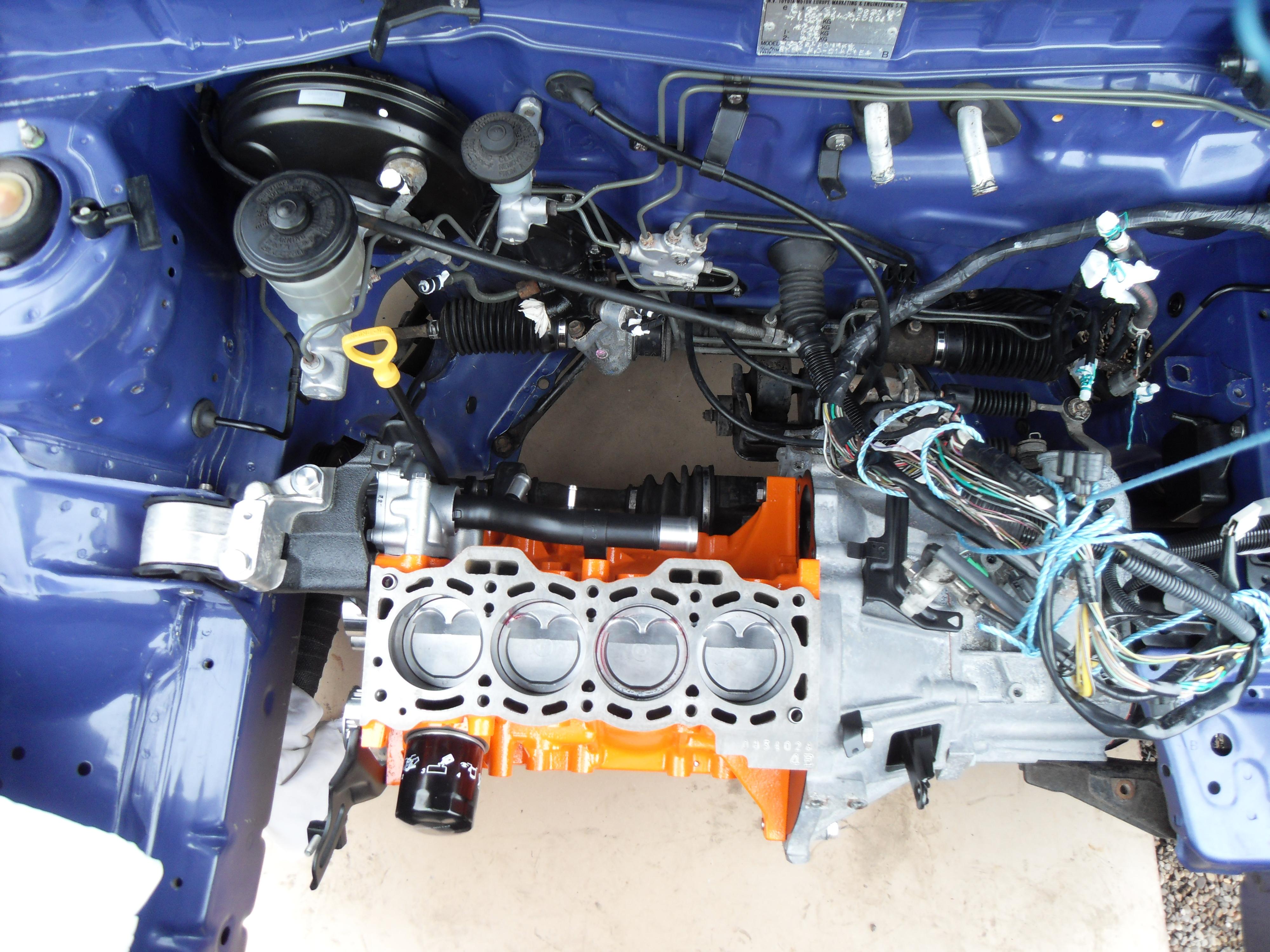

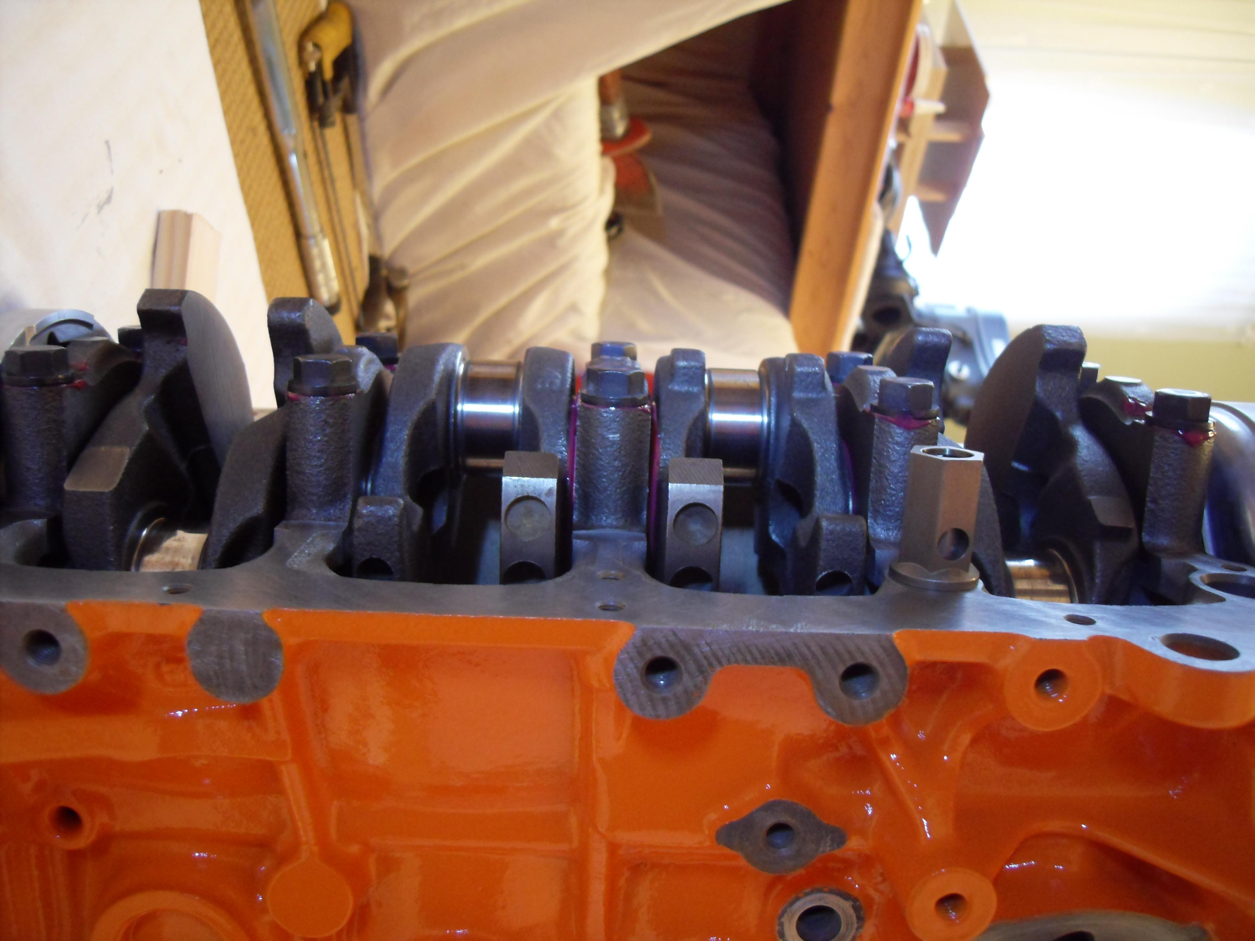

Today I prepared the Block and installed the Crank, Oil Pump and Rear Oil Seal Housing.
So this
Plus this
SDC10573.thumb.JPG.257c41fb0ba8ea2150d389156c007aa5.JPGSDC10577.thumb.JPG.f9839c3c399b90fb818c4d6641e57658.JPG
Equals this
Gavin

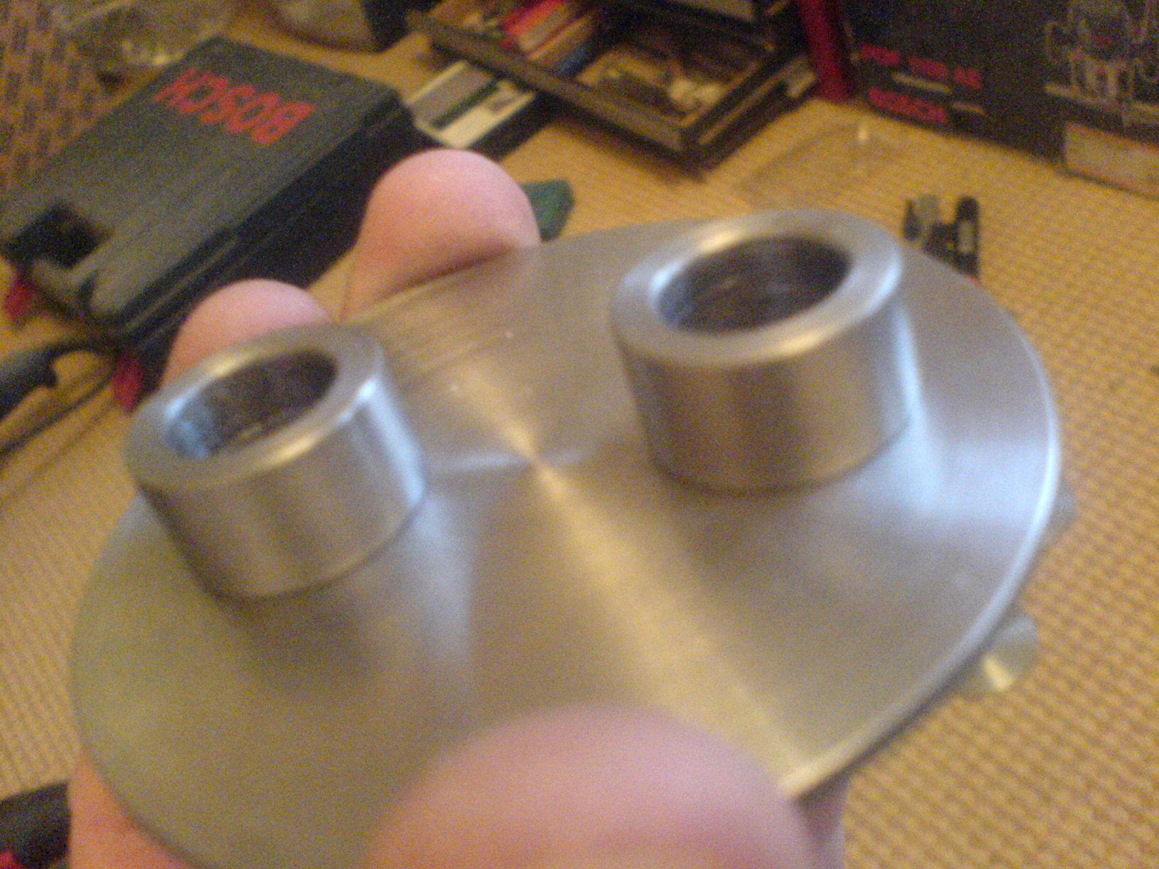

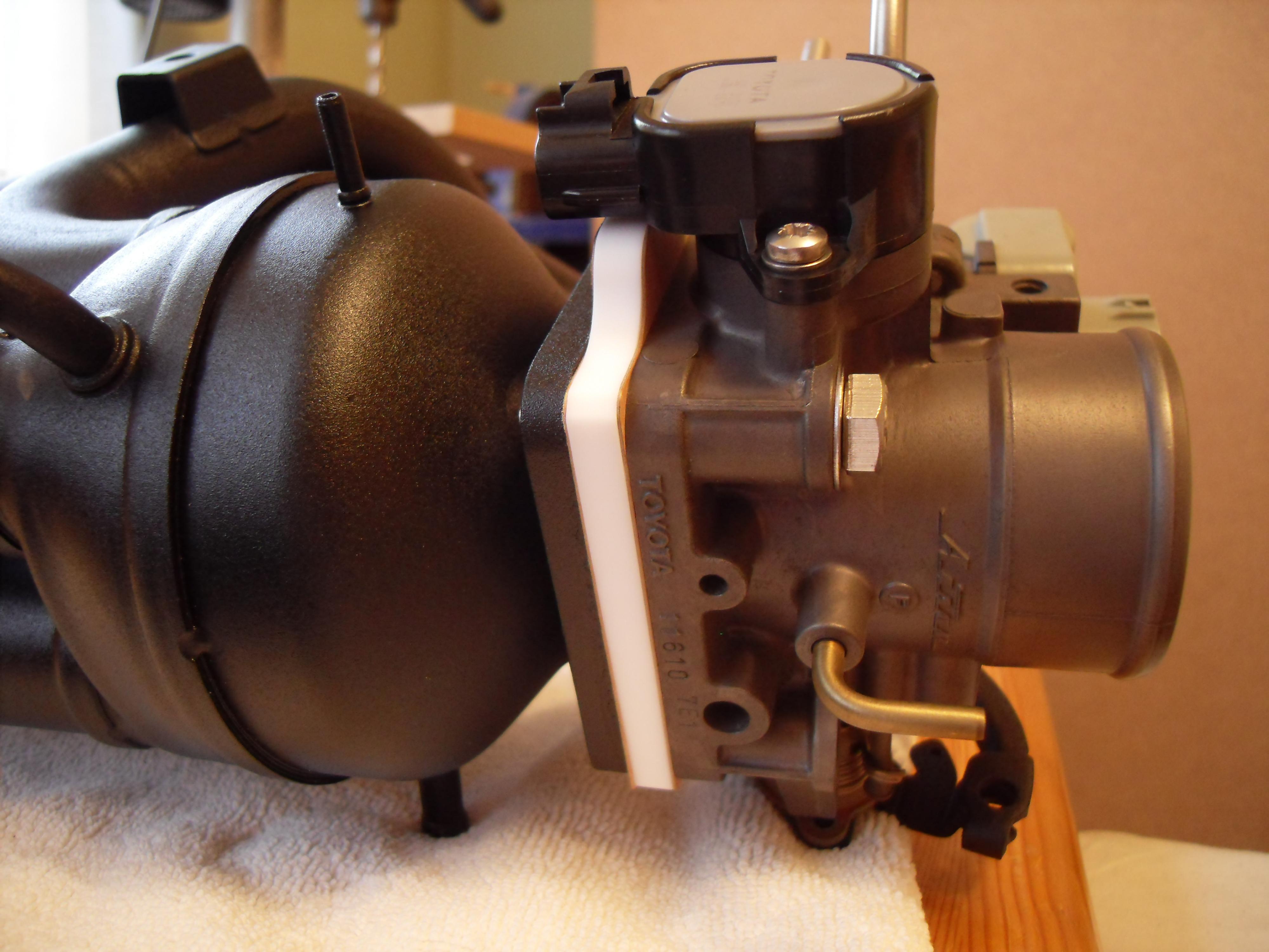

I also machined the Throttle Body Insulator
And trial fitted it with two bolts

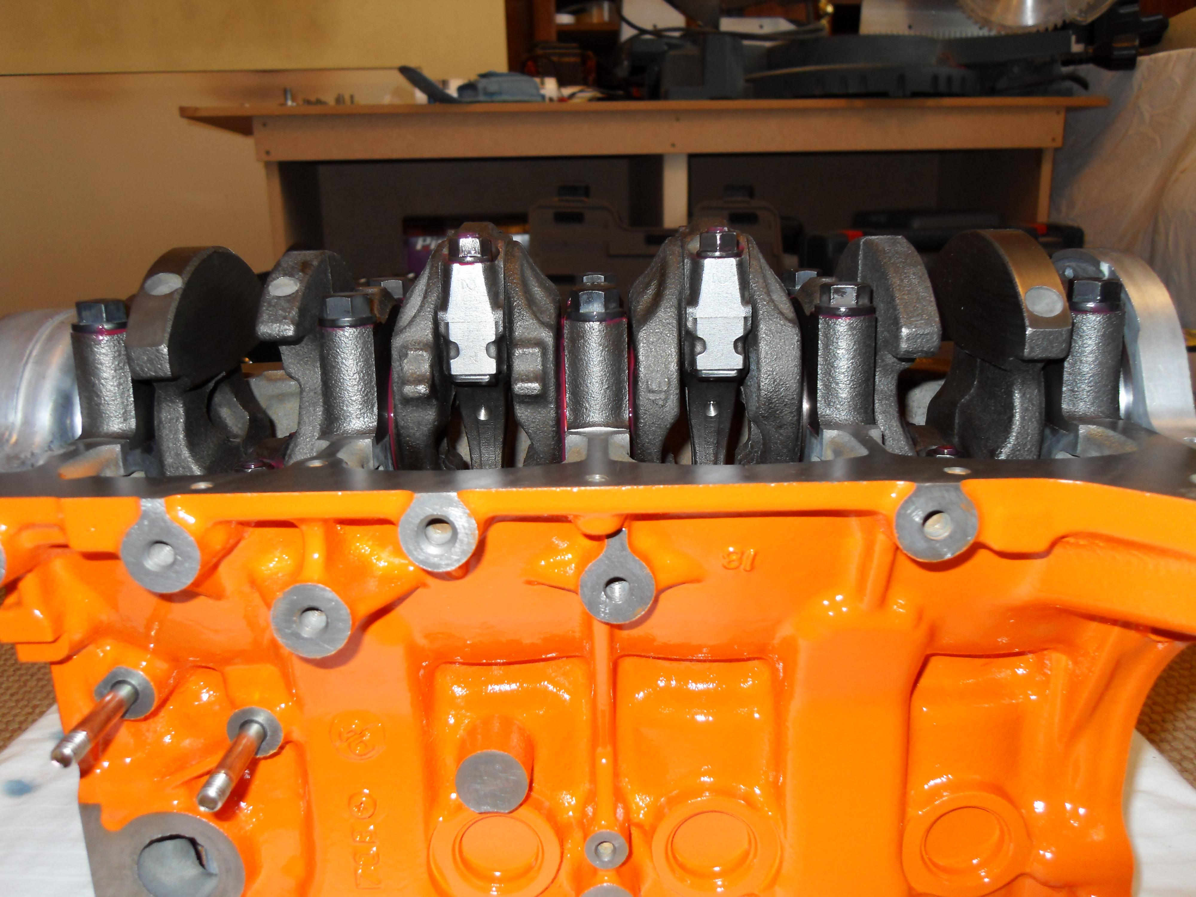

Ok I checked the Main Bearing and Big End Bearing Cap toruqes today after 48 hours and installed the Oil Strainer, Sump, Rear End Plate and Flywheel. Photos...
SDC10610.thumb.JPG.87e72a3d417b50ef692591a6de172e13.JPGSDC10612.thumb.JPG.430598244907df896acea6afc518e7d0.JPGSDC10614.thumb.JPG.128bdd3c98ca4f25686fad363aa93f43.JPG

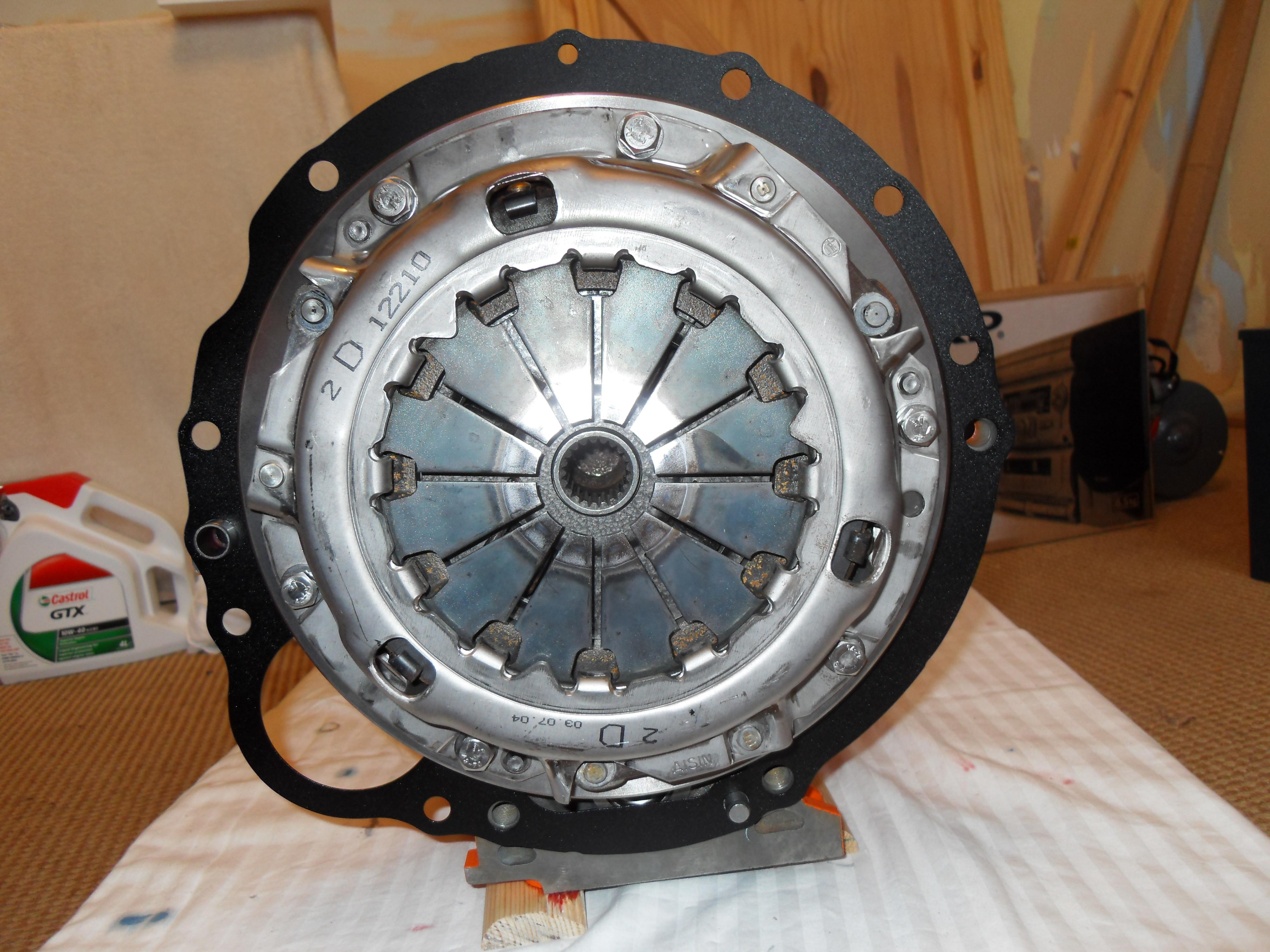

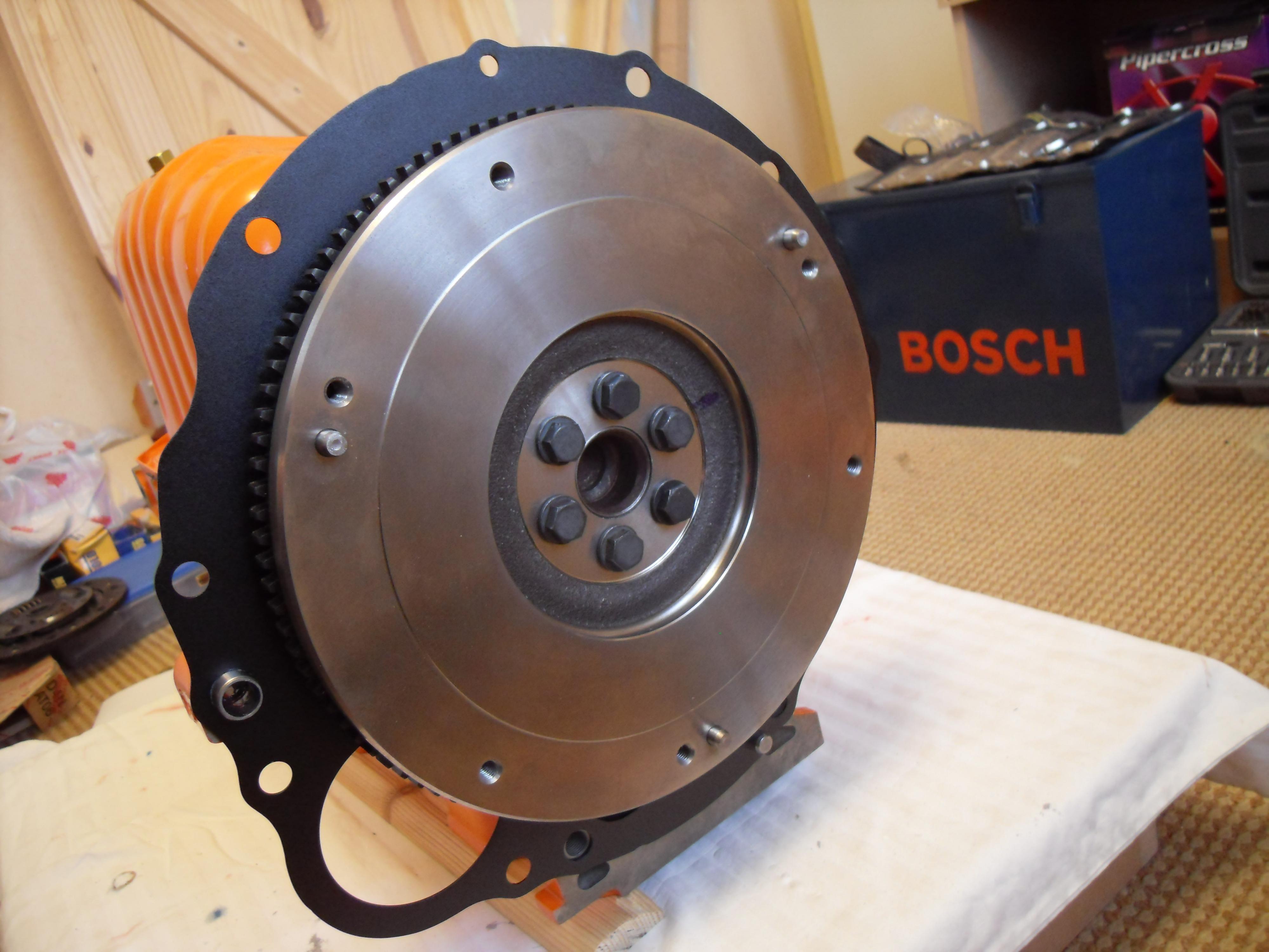

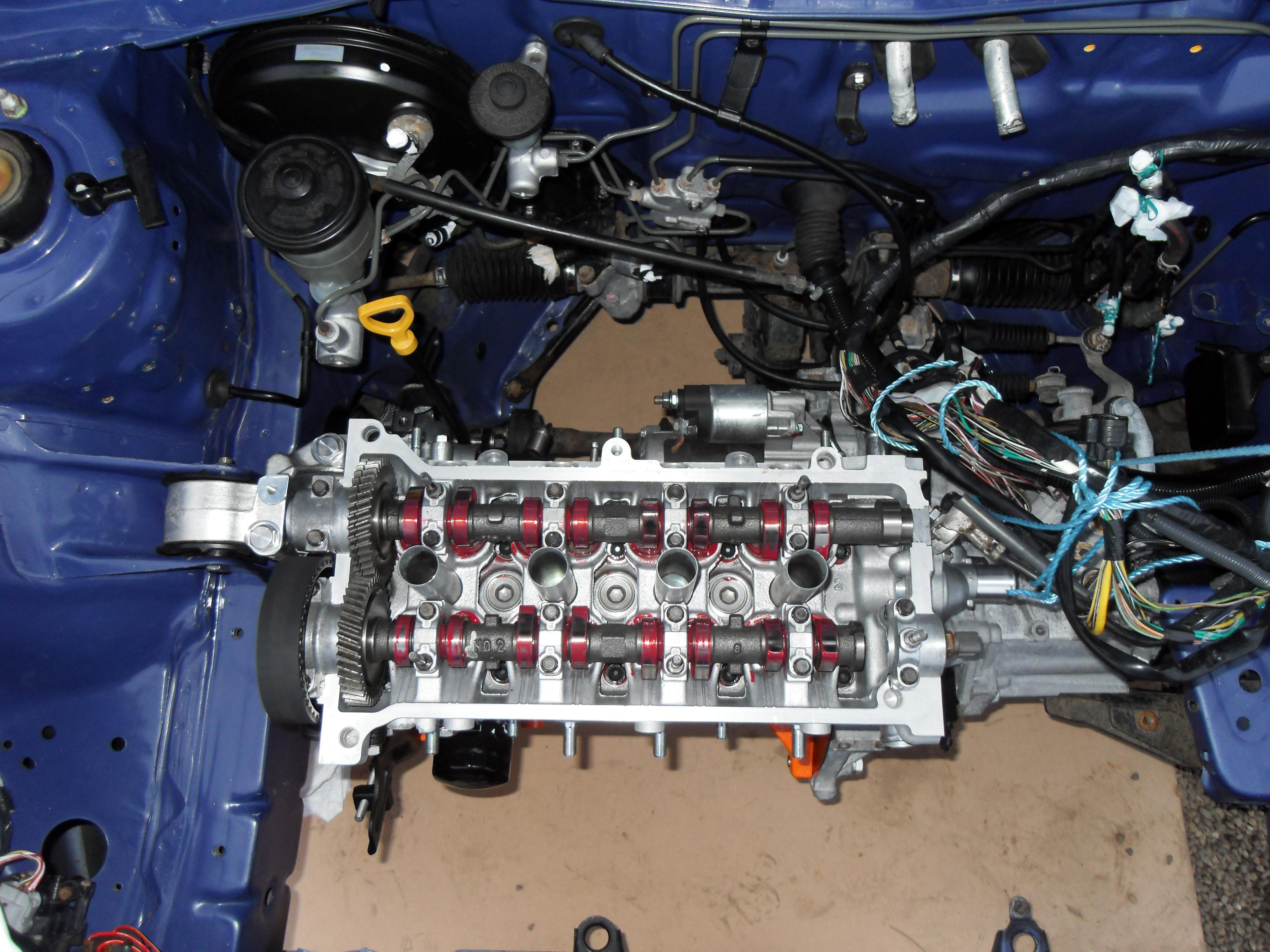

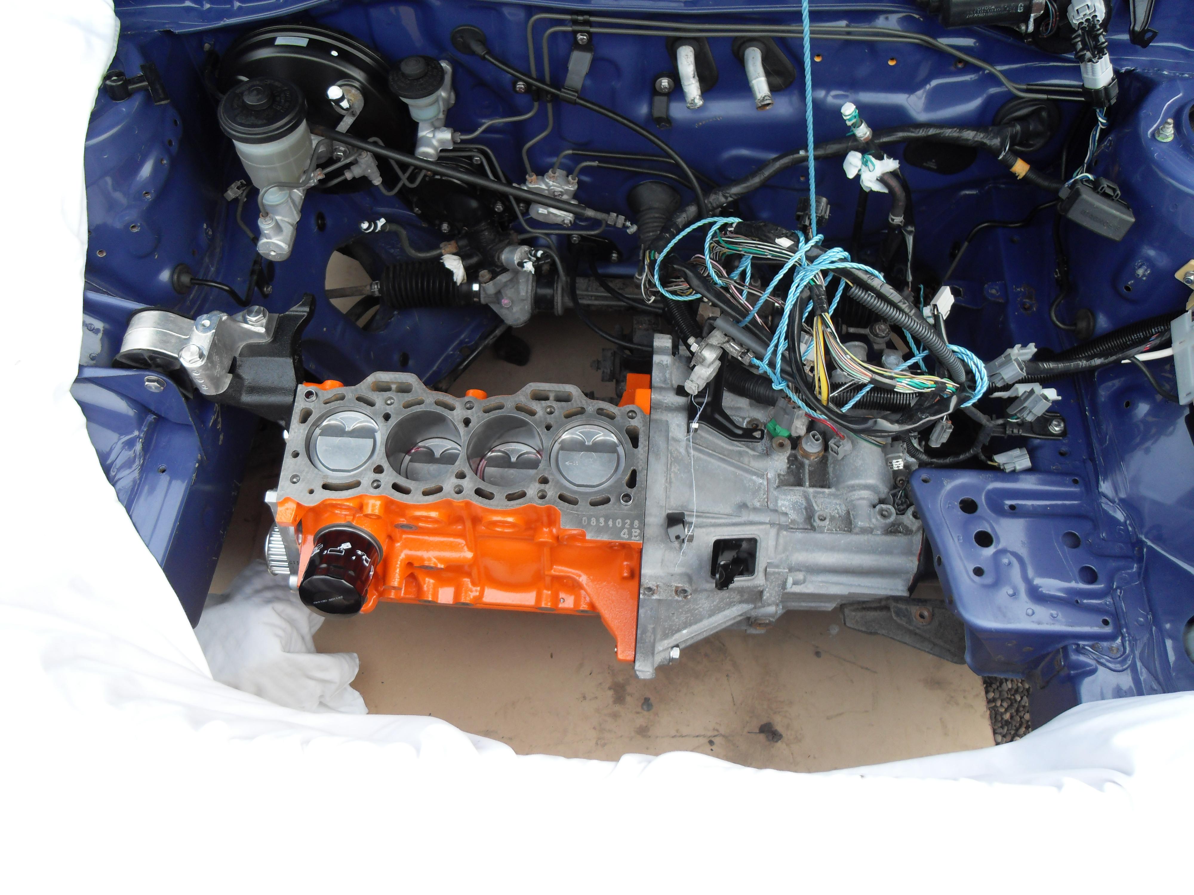

I installed the Clutch and Pressure Plate and got the Engine and some other bits and bobs in today. Will do Head, Cams, Timing Belt and few other bits tomorrow, then I have got to do the wiring loom in new black (not dirt gray) split loom. Still loads to do. Photos
SDC10627.thumb.JPG.e9d209d7b6dc1e8f429c268c3729ce48.JPGSDC10632.thumb.JPG.5256ca9a22a5828f3c0d1632fbeb8fea.JPGSDC10633.thumb.JPG.89cb326b4dfd36b9797bbf2f58414968.JPG
Gavin

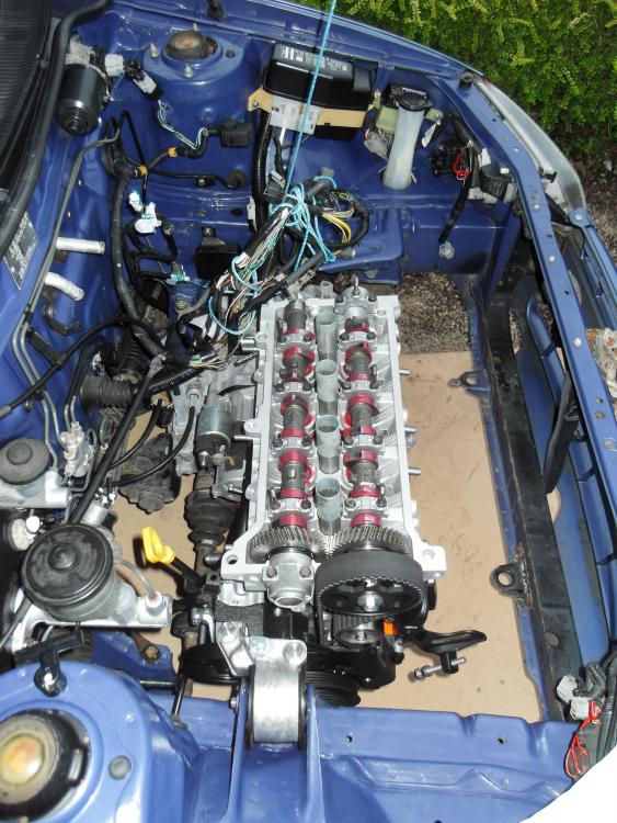

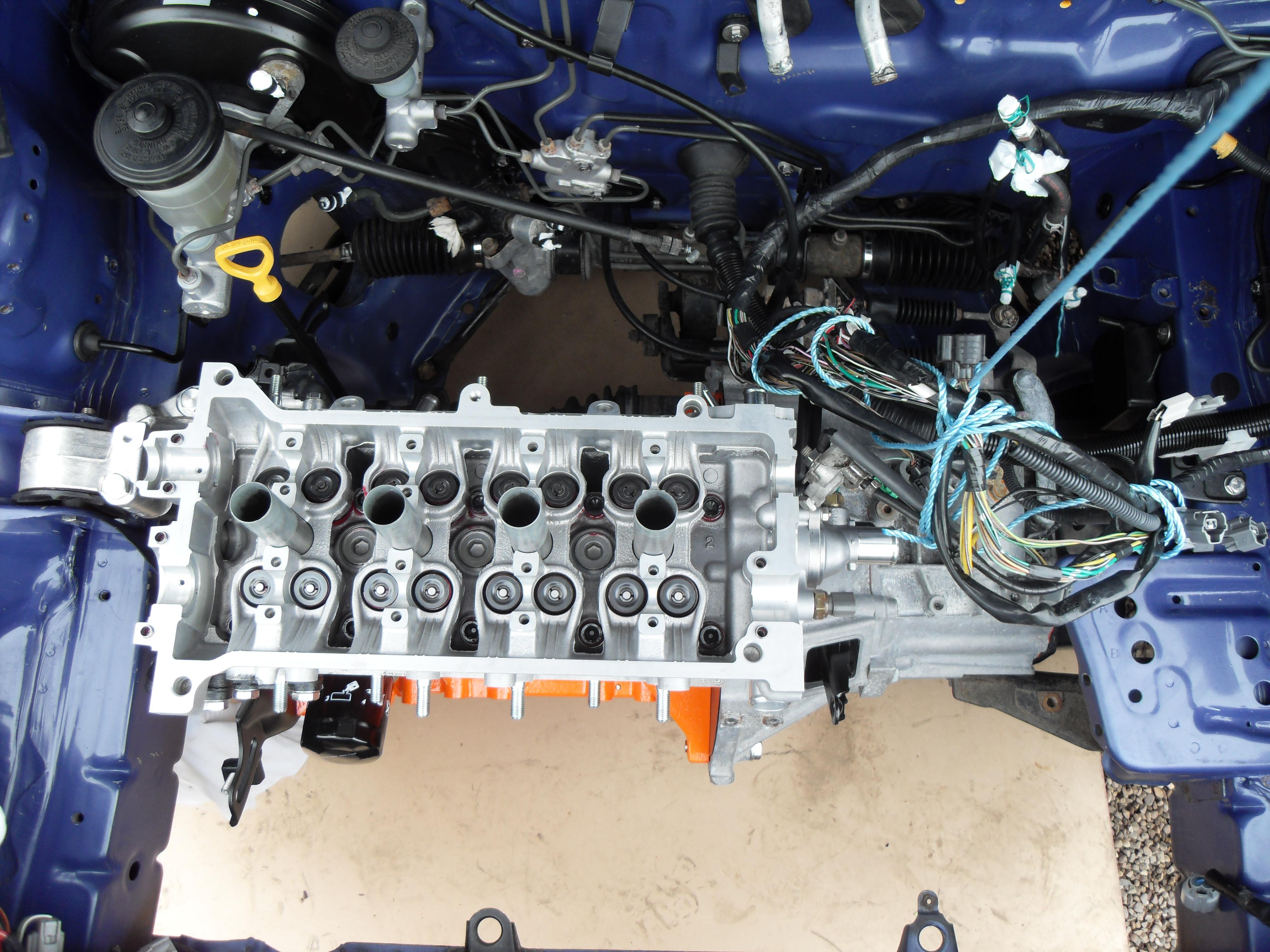

Today I installed the Water Pump, Head, Cams, Timing Belt, bottom Timing Belt cover, Crank Pulley, Starter Motor and the Alternator. Tomorrow a day doing the new split loom.
SDC10634.thumb.JPG.fcd721dc743415f741f85d2ae5666db4.JPGSDC10635.thumb.JPG.7731b438bdf6944b29c9b46d477b06f2.JPGSDC10639.thumb.JPG.59ec4a188d6c0debc4cd17c36c3d2639.JPGSDC10637.thumb.JPG.506e40868aa71fd3cc670db4d4ed22a3.JPG

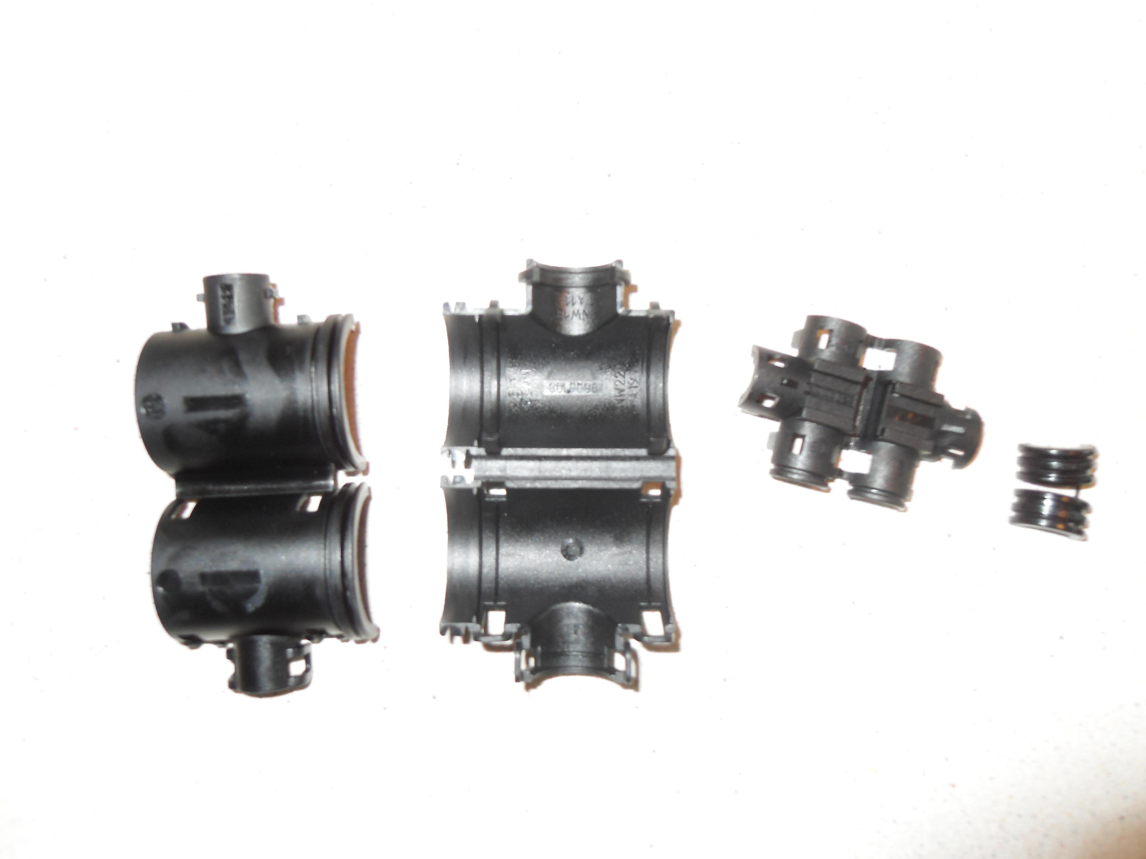

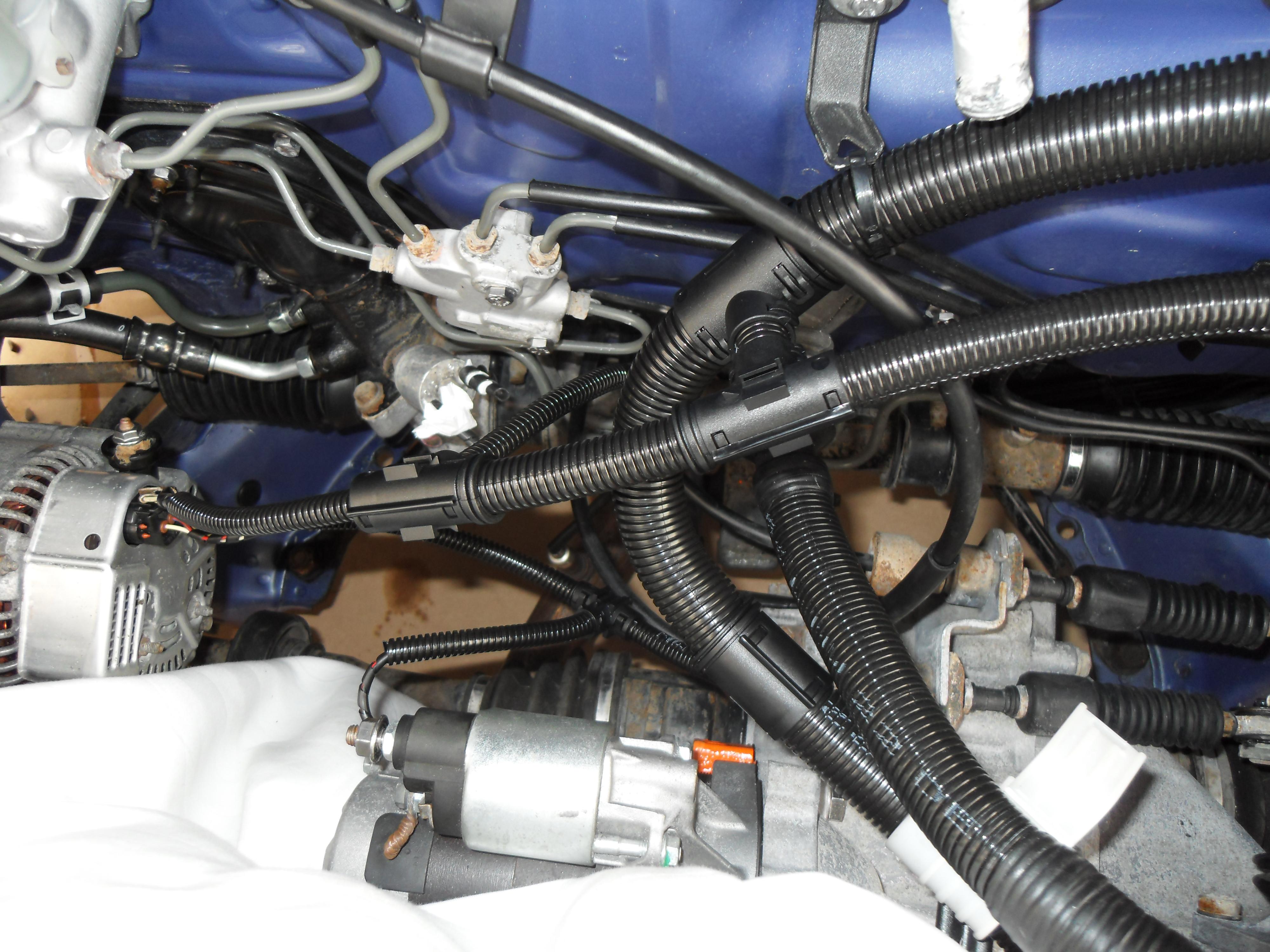

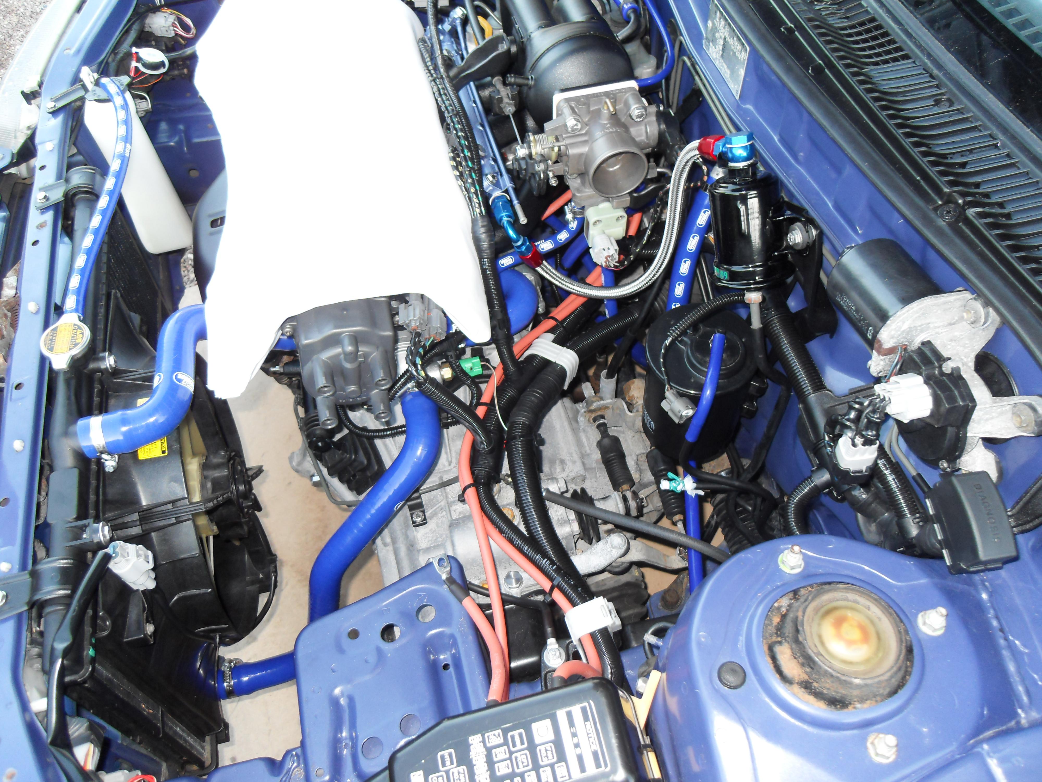

Thought id update this. There has been a little delay. I decided to get ahold of the tees that go with the split loom and have had to wait for them. They are now here and I have startrd. While I was waiting I managed to get all the other little bits sorted and got the manifold insulator machined. I also got my earls today.
Split Loom Tees
Wiring taking shape
SDC10659.thumb.JPG.29e10a21872499b6072e7e75f75bba89.JPGSDC10664.thumb.JPG.06dda3f62723185a06ee09bb9db5f601.JPG

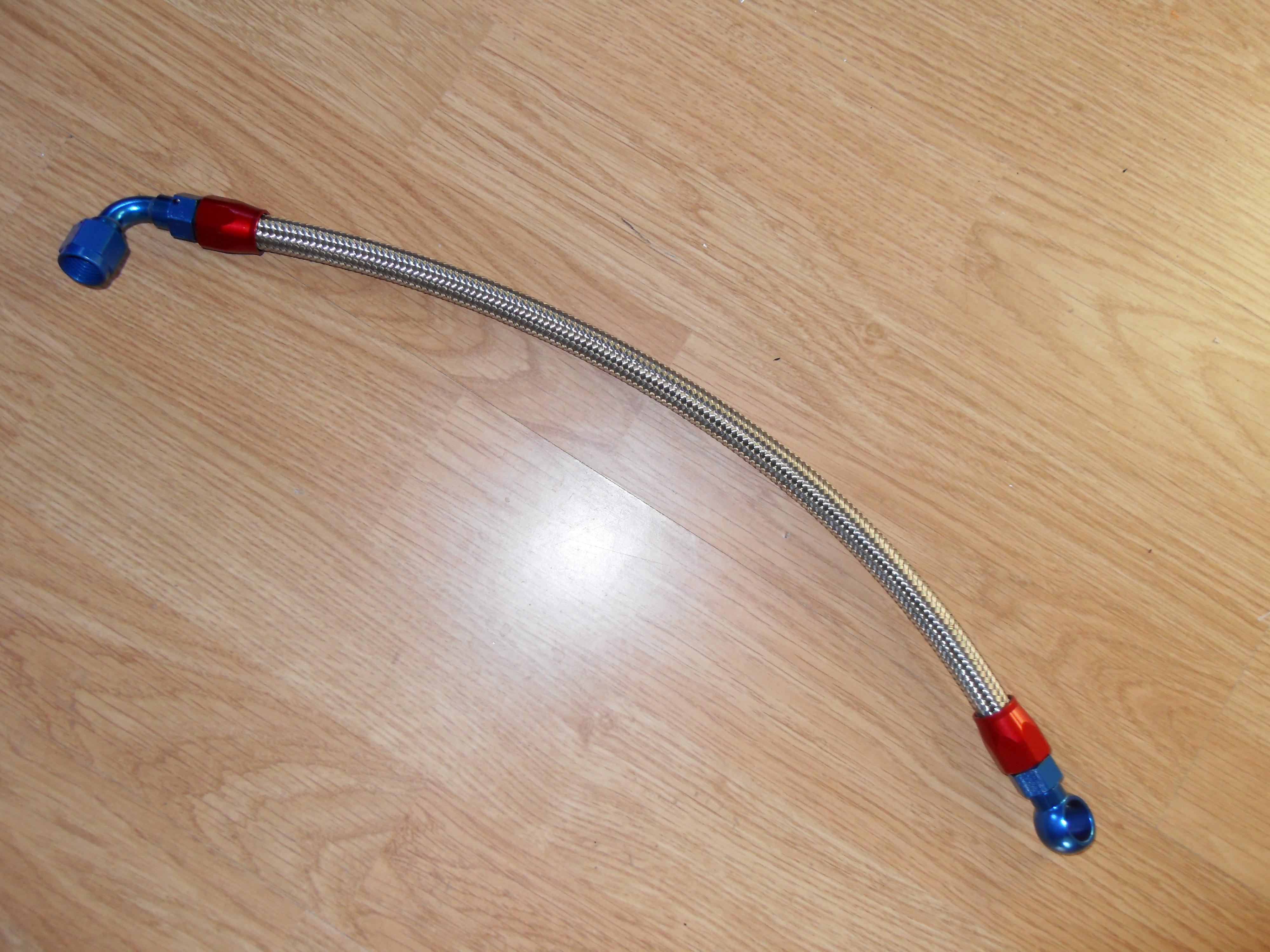

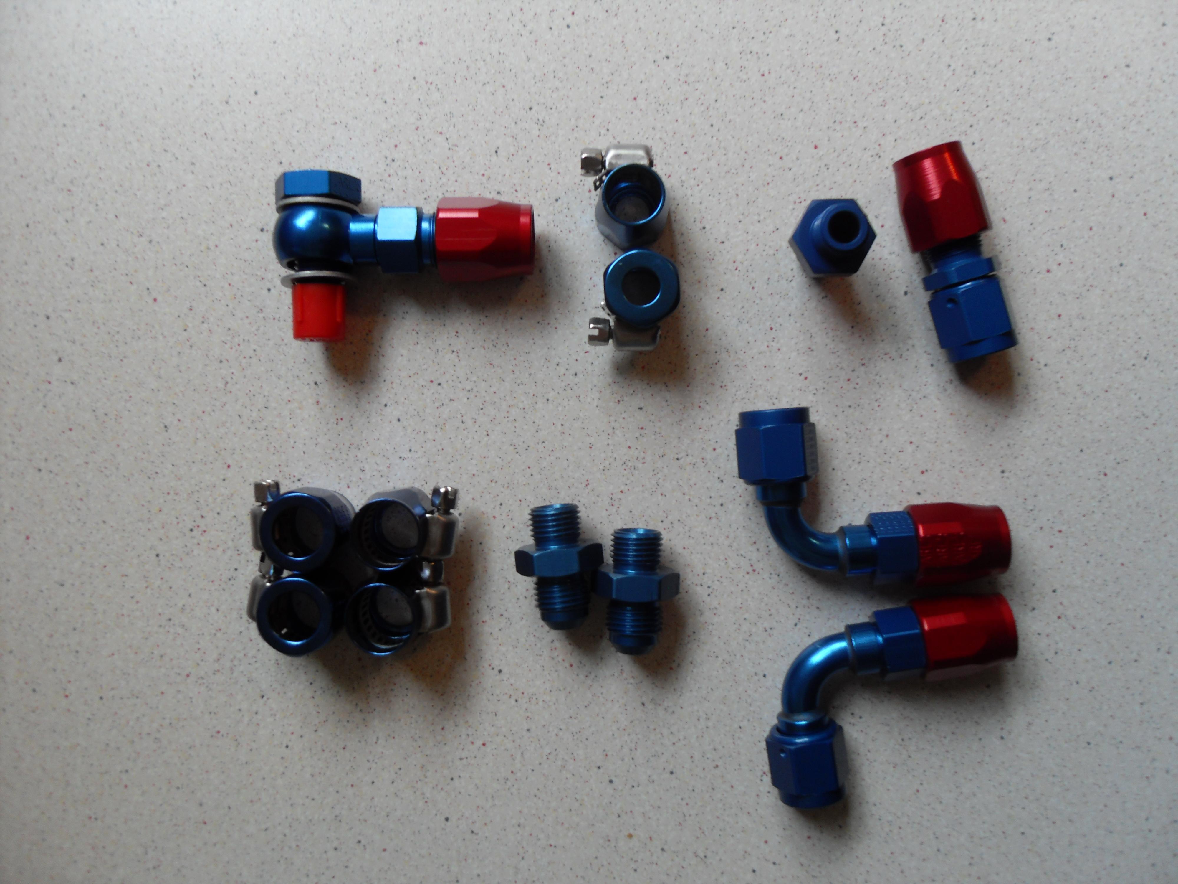

Manifold Insulator
Earls Fittings

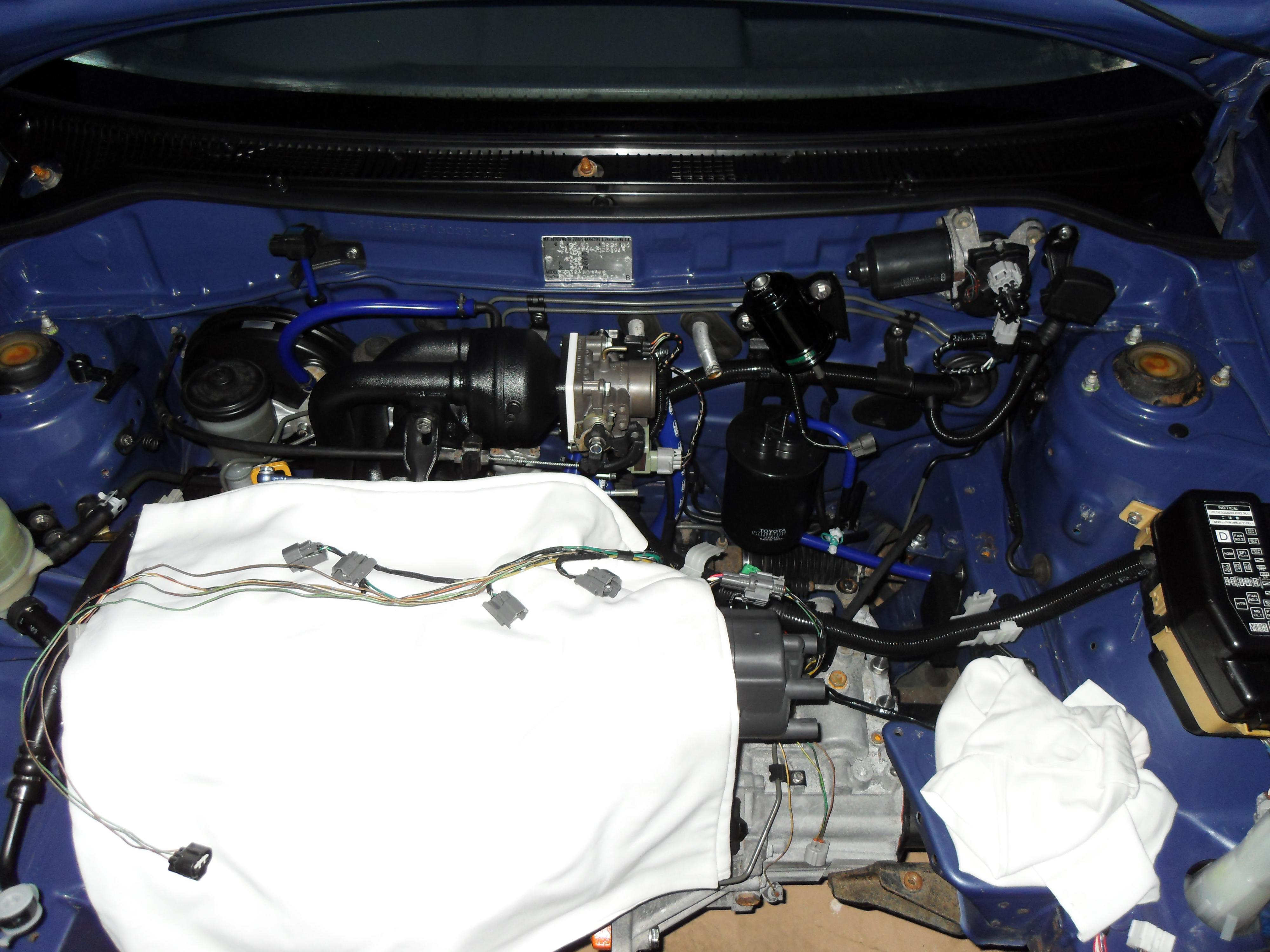

I'm getting so excited now should only be a few days.

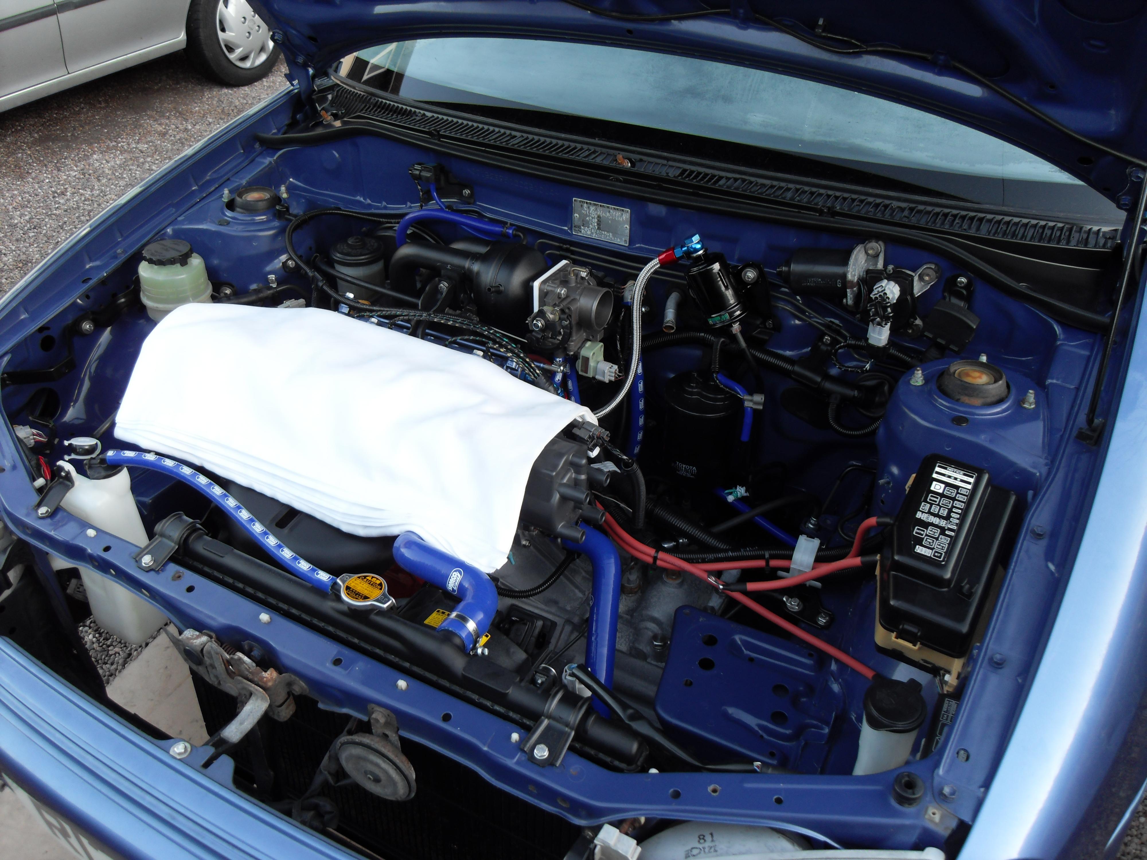

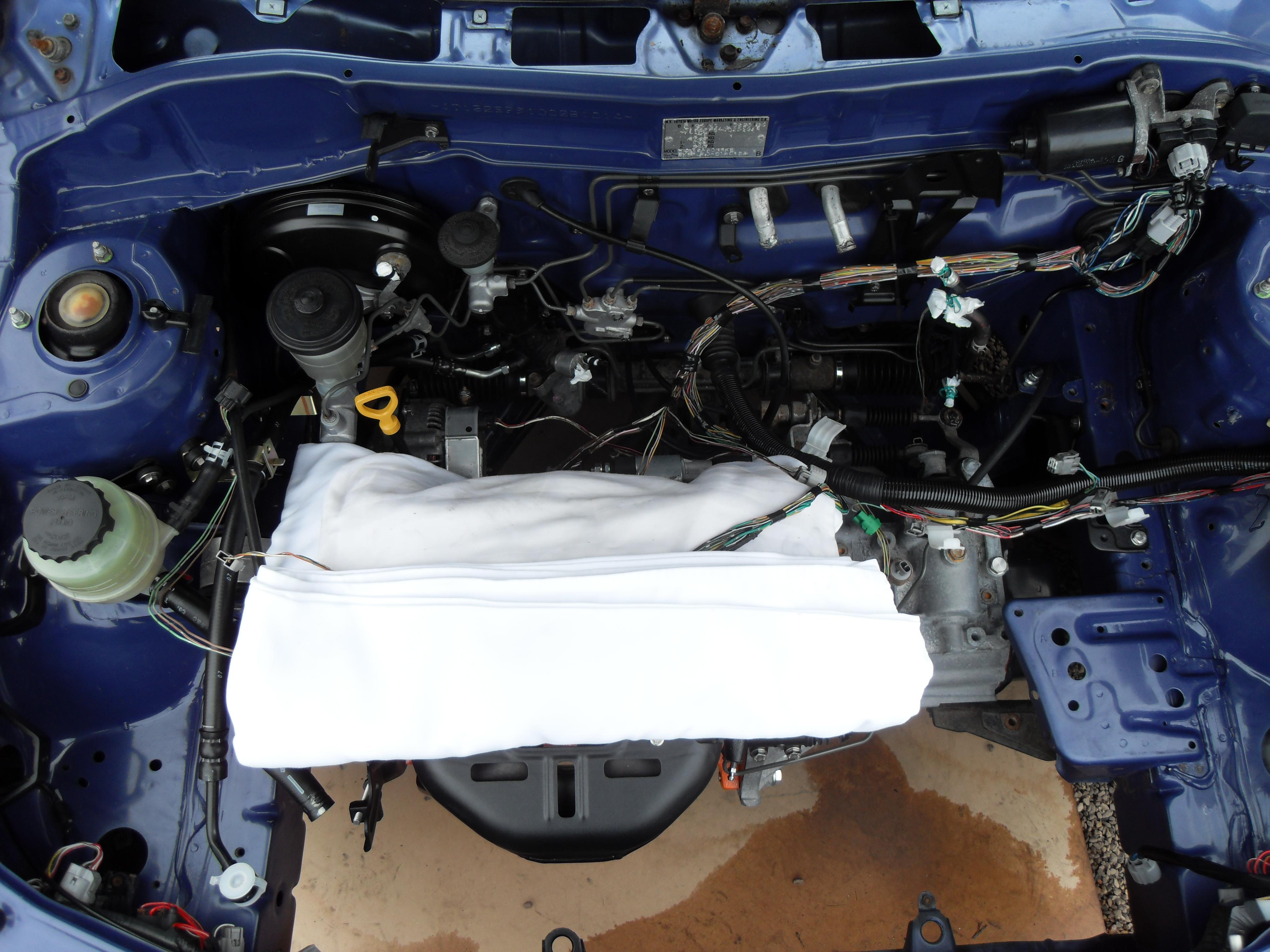

I had a break from wiring looms today I will finish them tomorrow and installed the manifold/throttle body, distributor, a few other bits and some samco.
Only one photo today. Please excuse the sheet youll see under it in good time. lol
Gavin

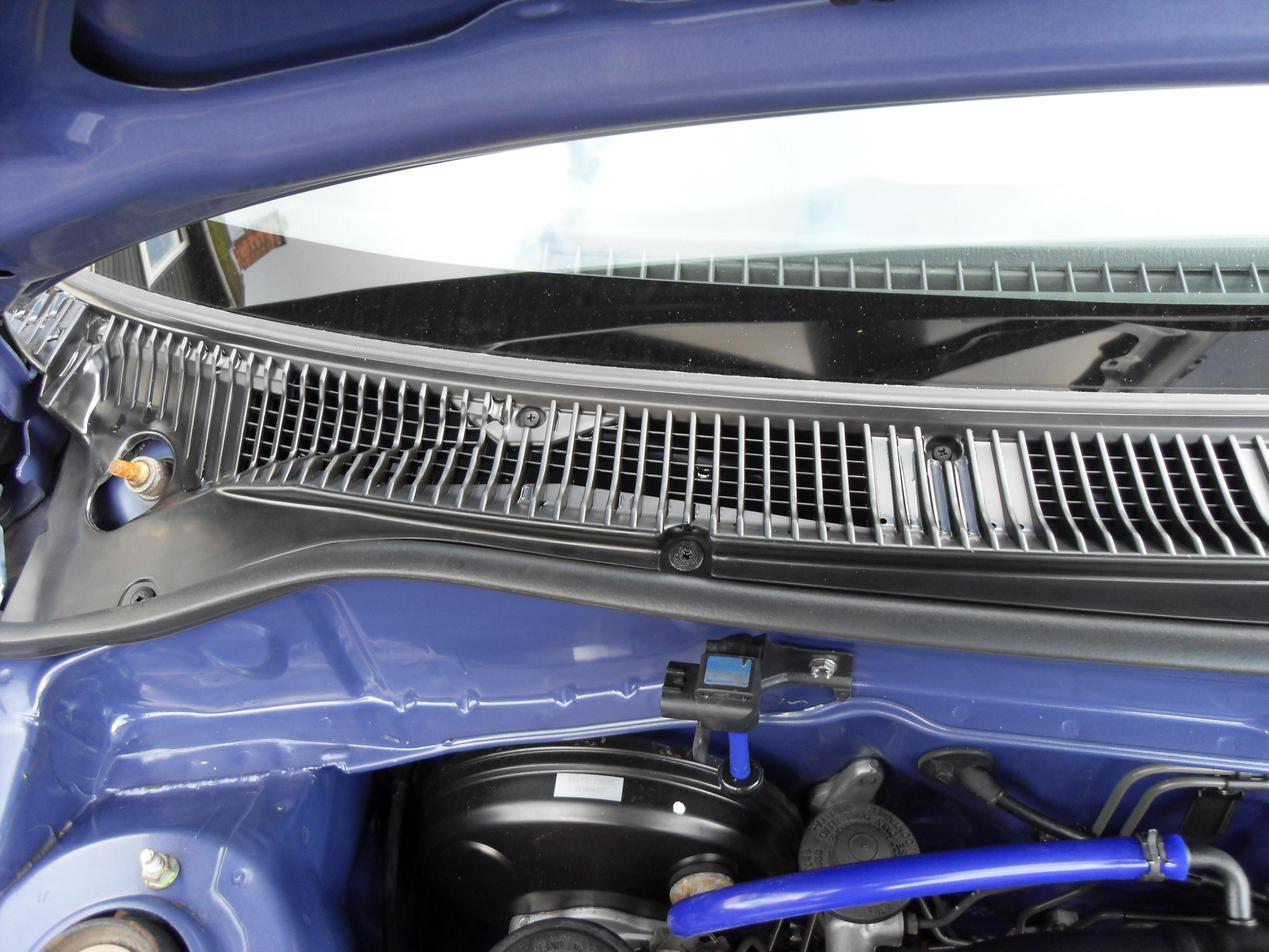

I didnt do the wiring loom today, I cound not be bothered. I did however get the air filter bracket made, made some new earths and fitted a new drivers side weather strip, passanger side tomorrow.

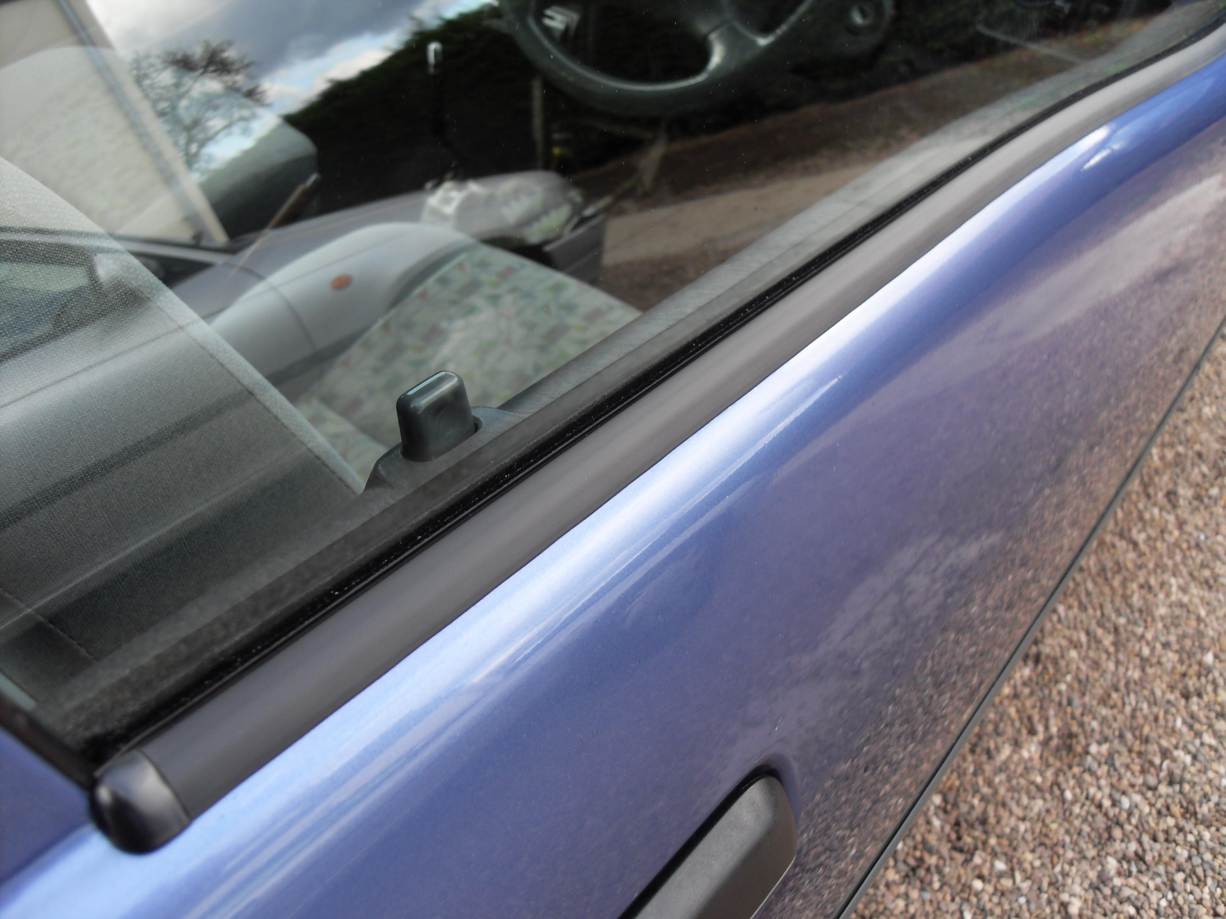

I forgot to say yesterday that I fitted a new scuttle panel and with the weather strip it makes a real difference. I have new indicators for both sides to go on aswell. I will be replacing both headlights in the summer and when I do they will be the toyota clear ones.
Also I have forgotton to say for weeks now I have replicated the rubber diped ends on some brackers, it had to come off for painting and it was peeling anyway. I used black Plasti Dip
Earths
SDC10669.thumb.JPG.695c33eef2ea3917dad049f4d45f3347.JPGSDC10670.thumb.JPG.383be7cf9c42256c5a96136aefe7cb0d.JPG
Weather Strip
Scuttle Panel
Plasti Dip

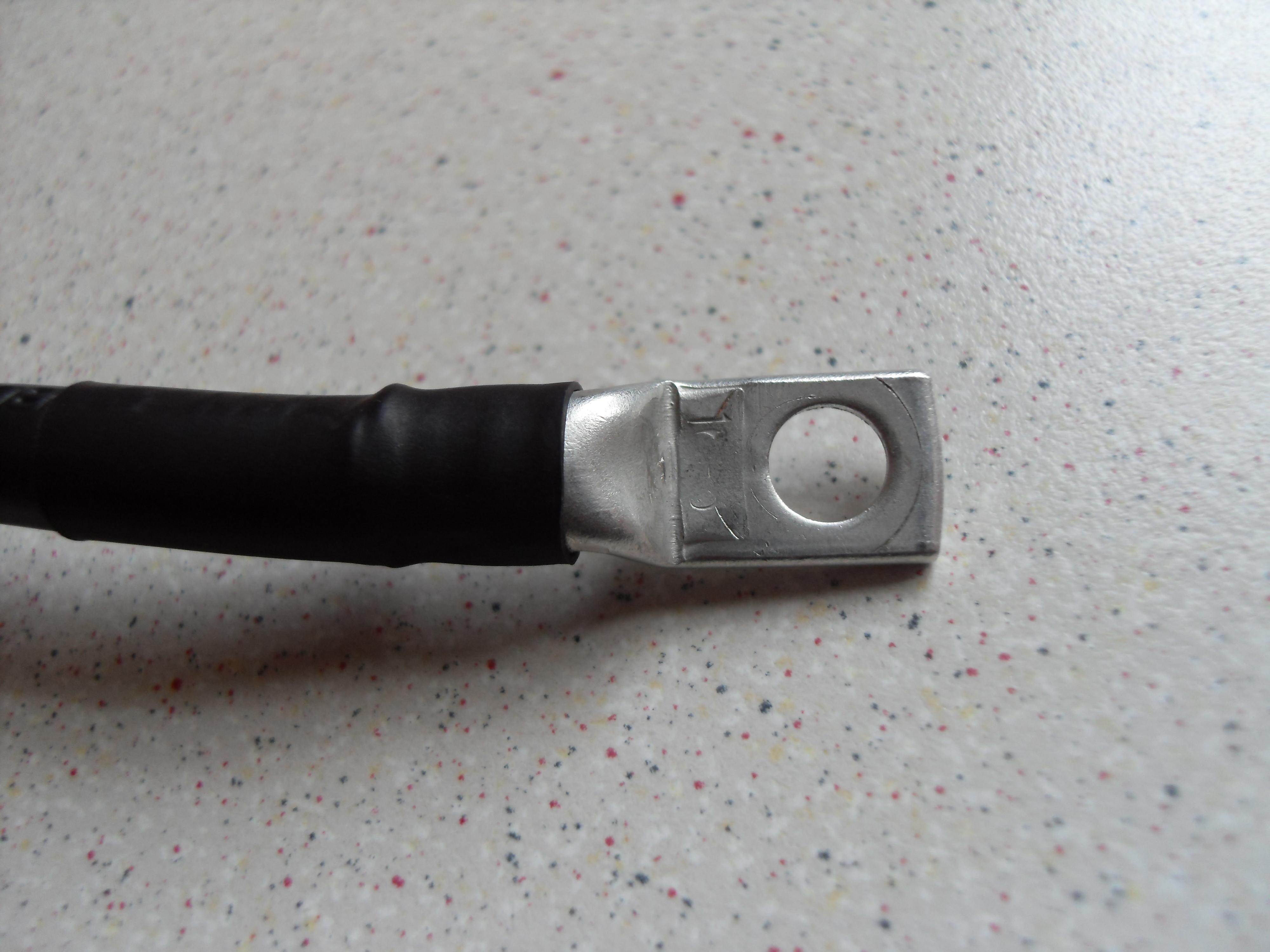

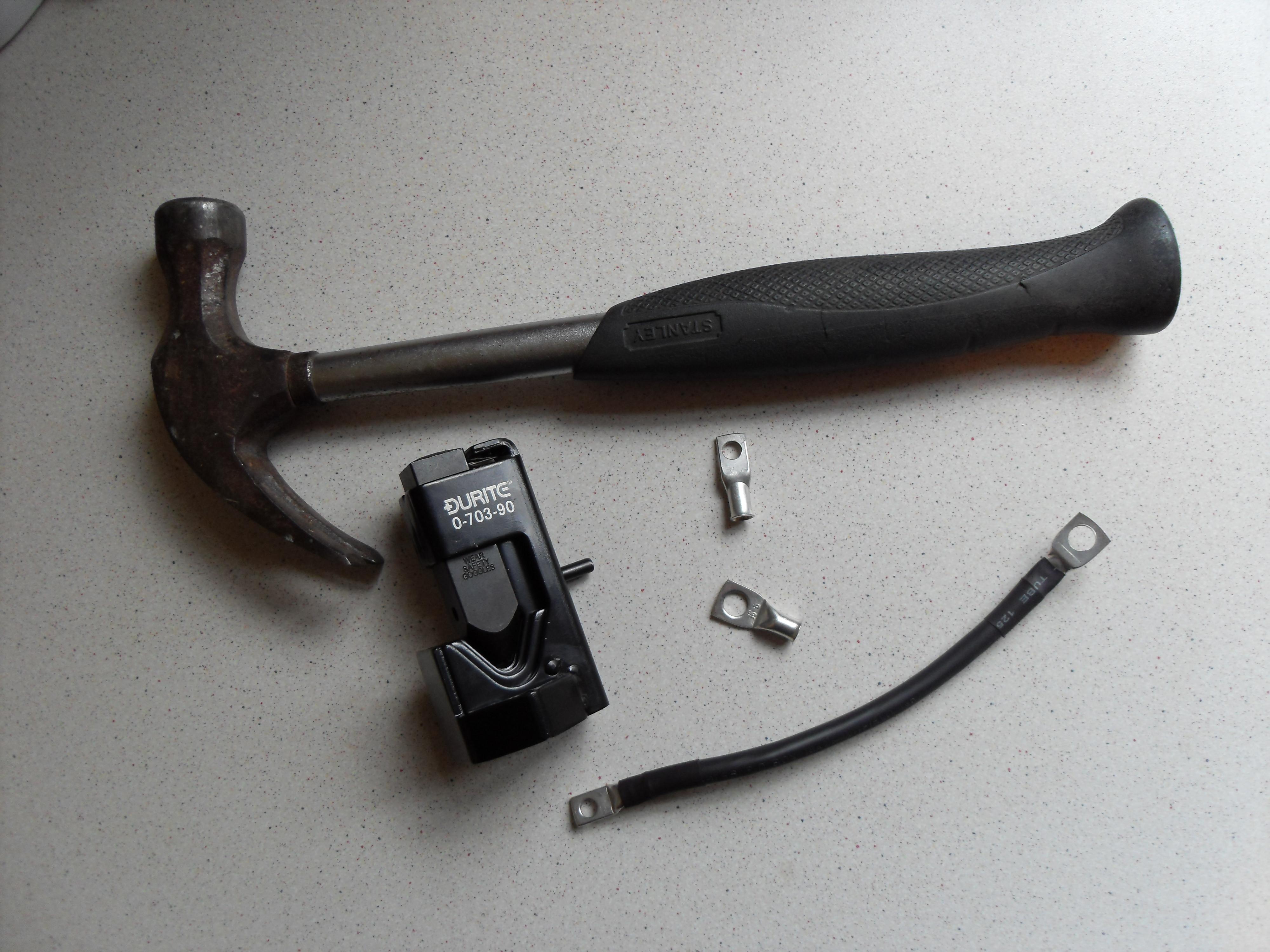

Yesterday I finished the wiring loom and today I made new starter and alternator cables, made my first earls hose and installed it, installed the radiator and expansion bottle along with a bit of Samco. Getting very close now.
SDC10683.thumb.JPG.0442906e599af7b6670f63f2afeab509.JPGSDC10685.thumb.JPG.0a3225c867f0ee4aac0966cb65ffc90b.JPGSDC10687.thumb.JPG.1926e957b8e5e7831a7d7f5e4fad87ba.JPG
Gavin

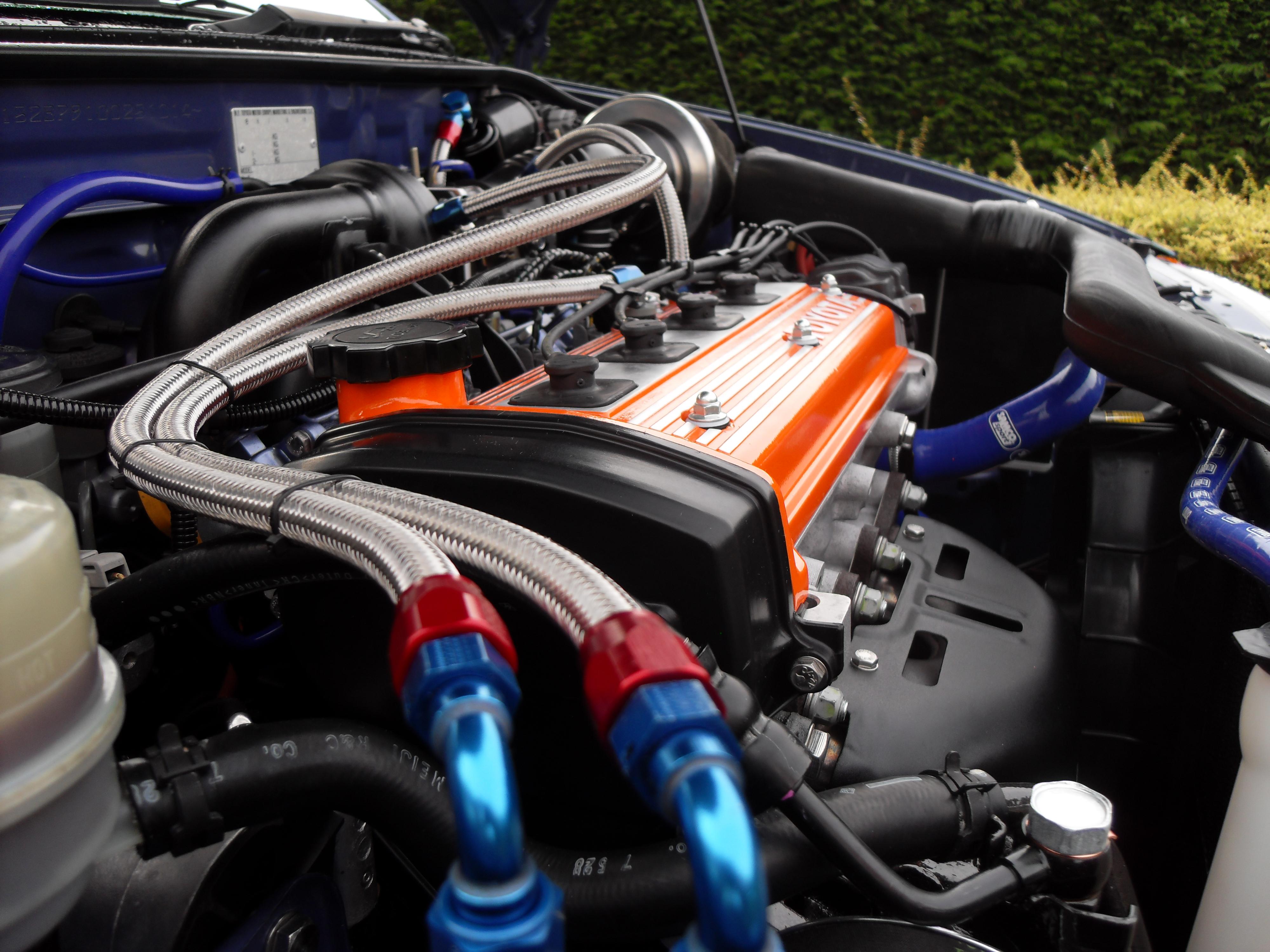

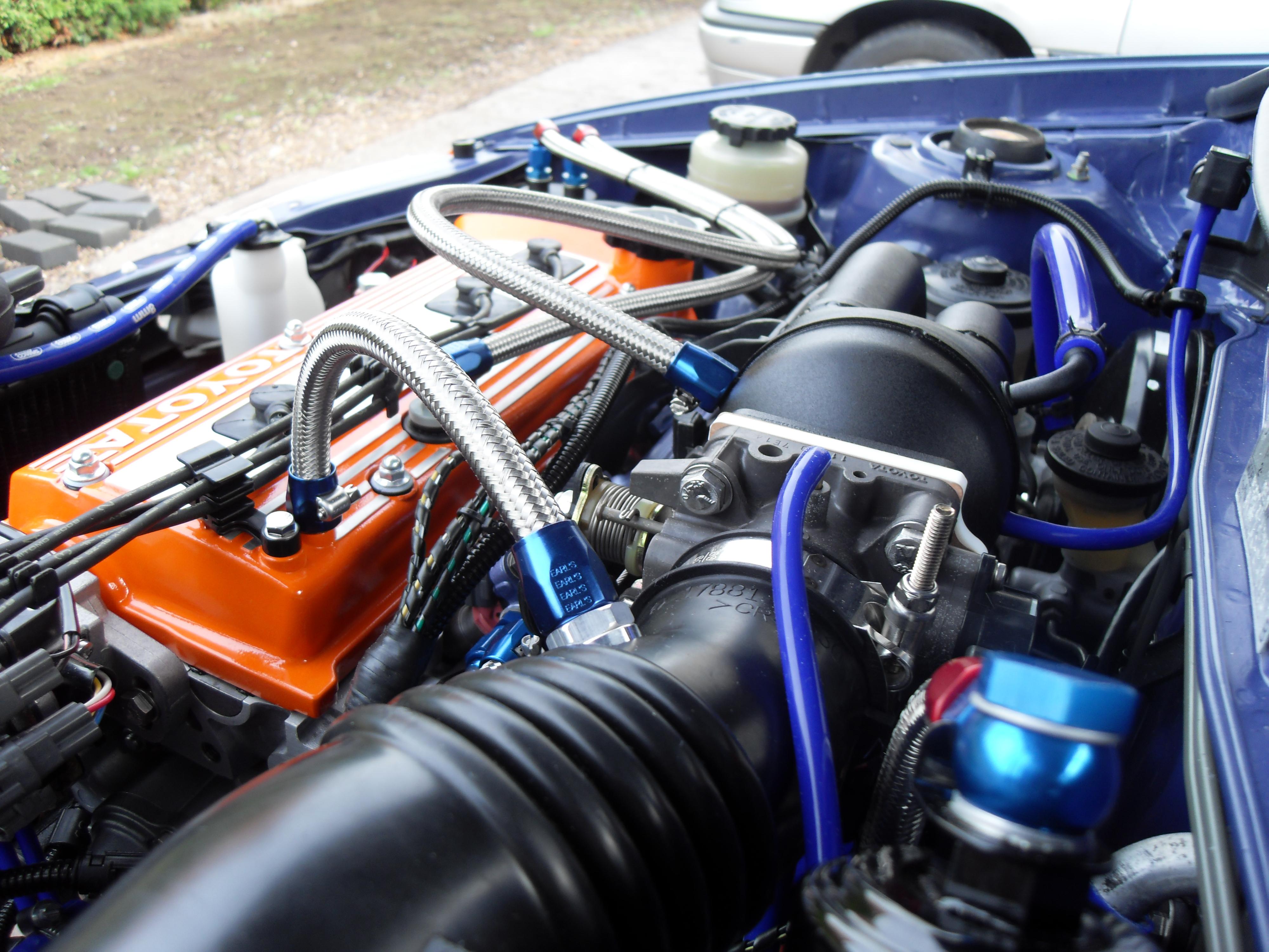

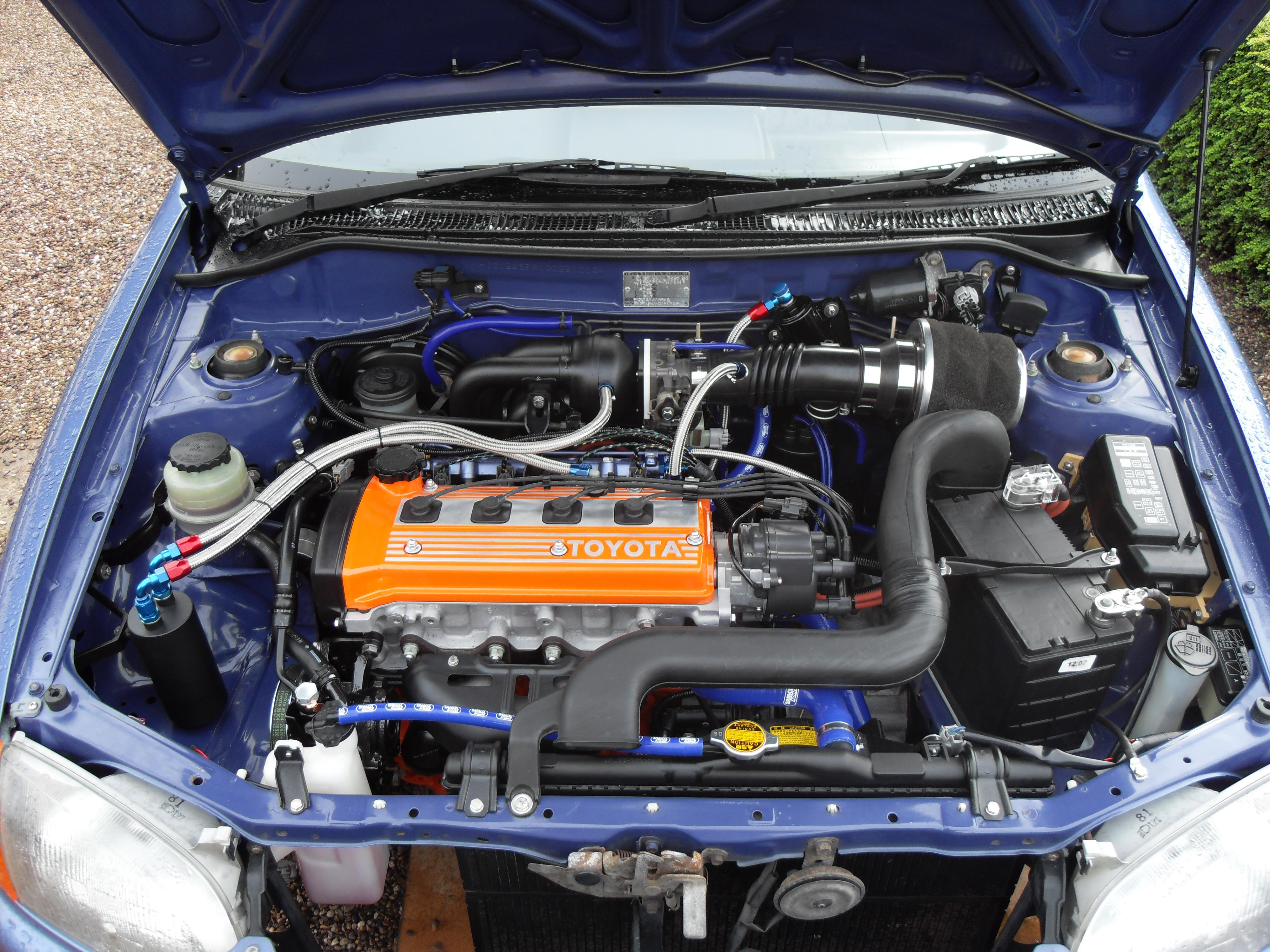

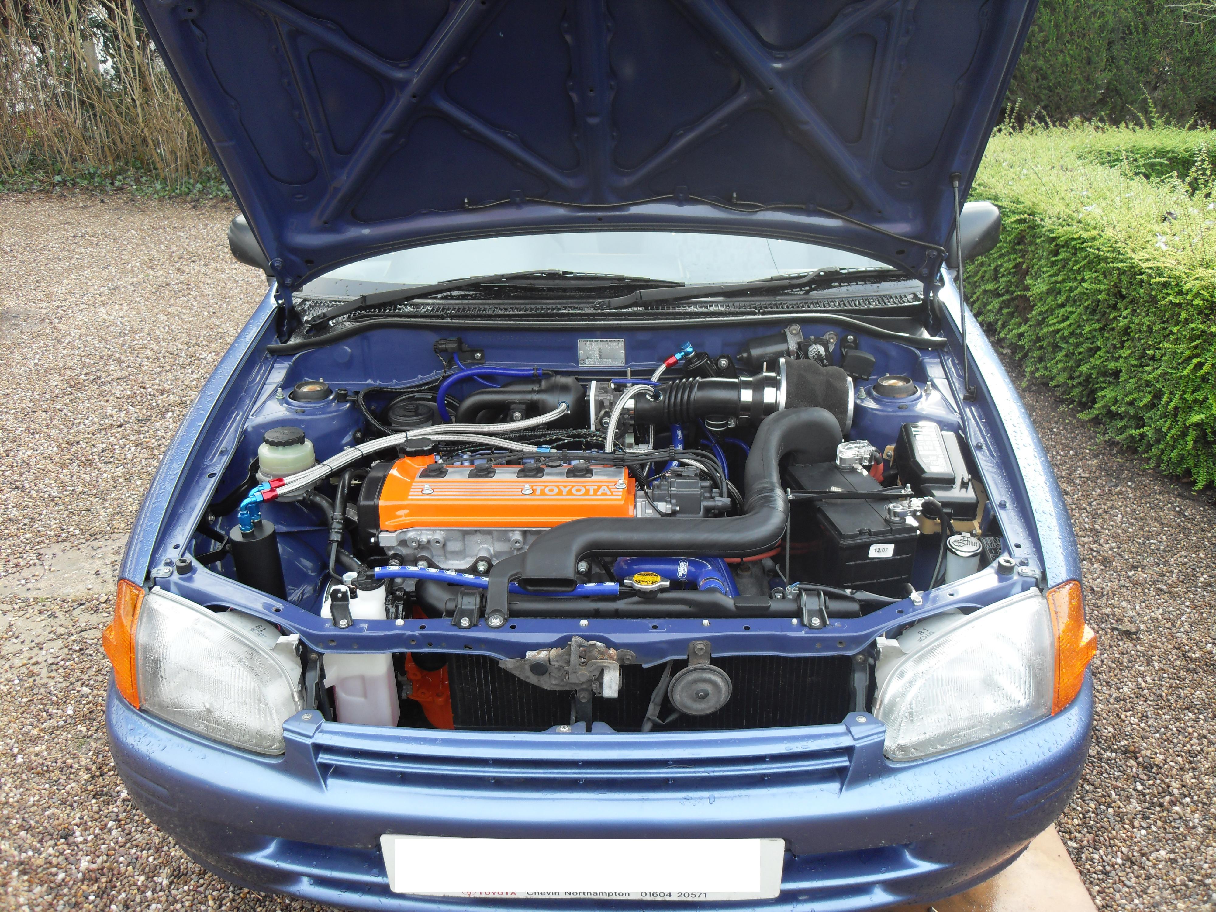

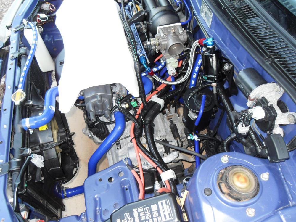

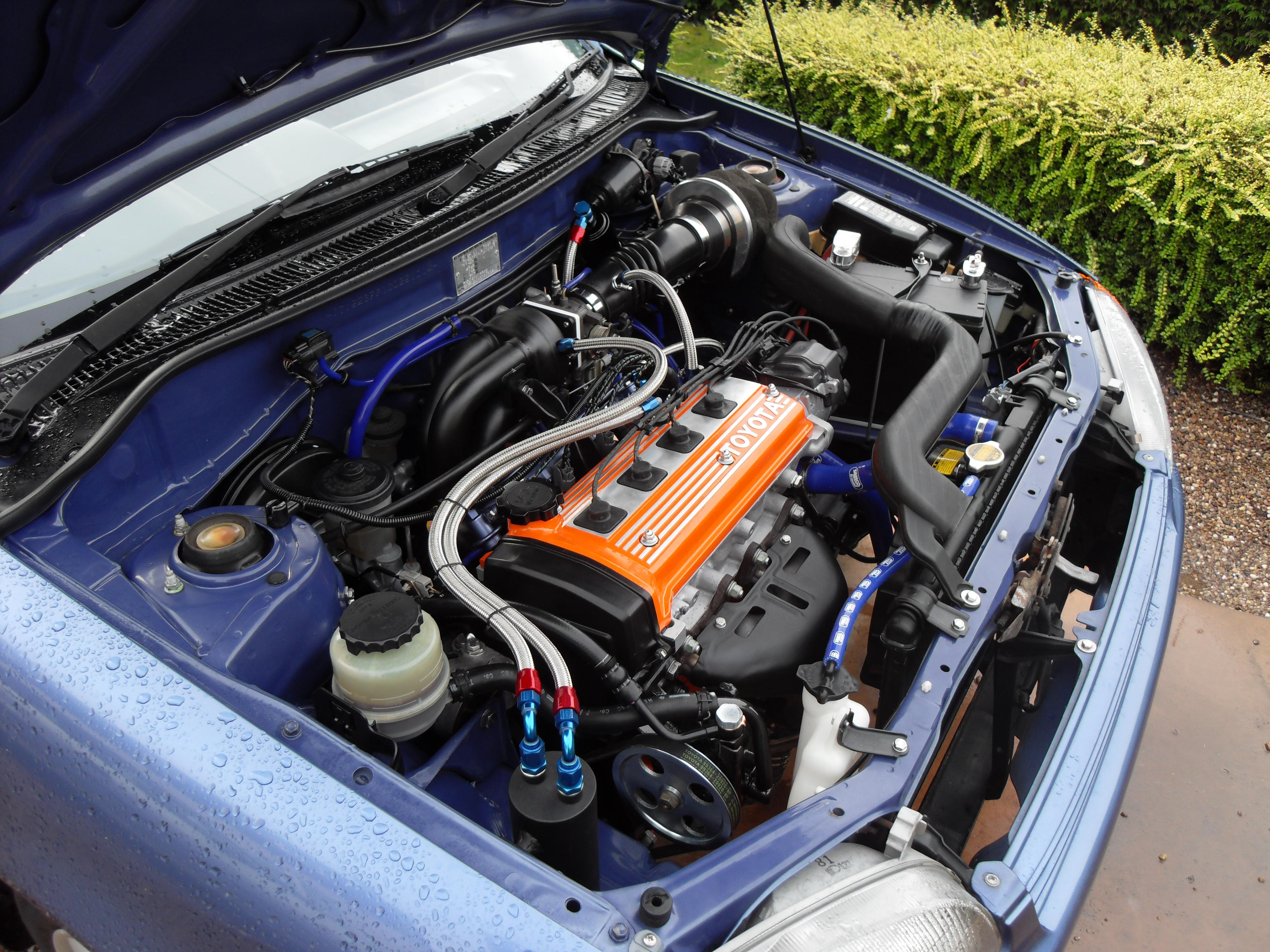

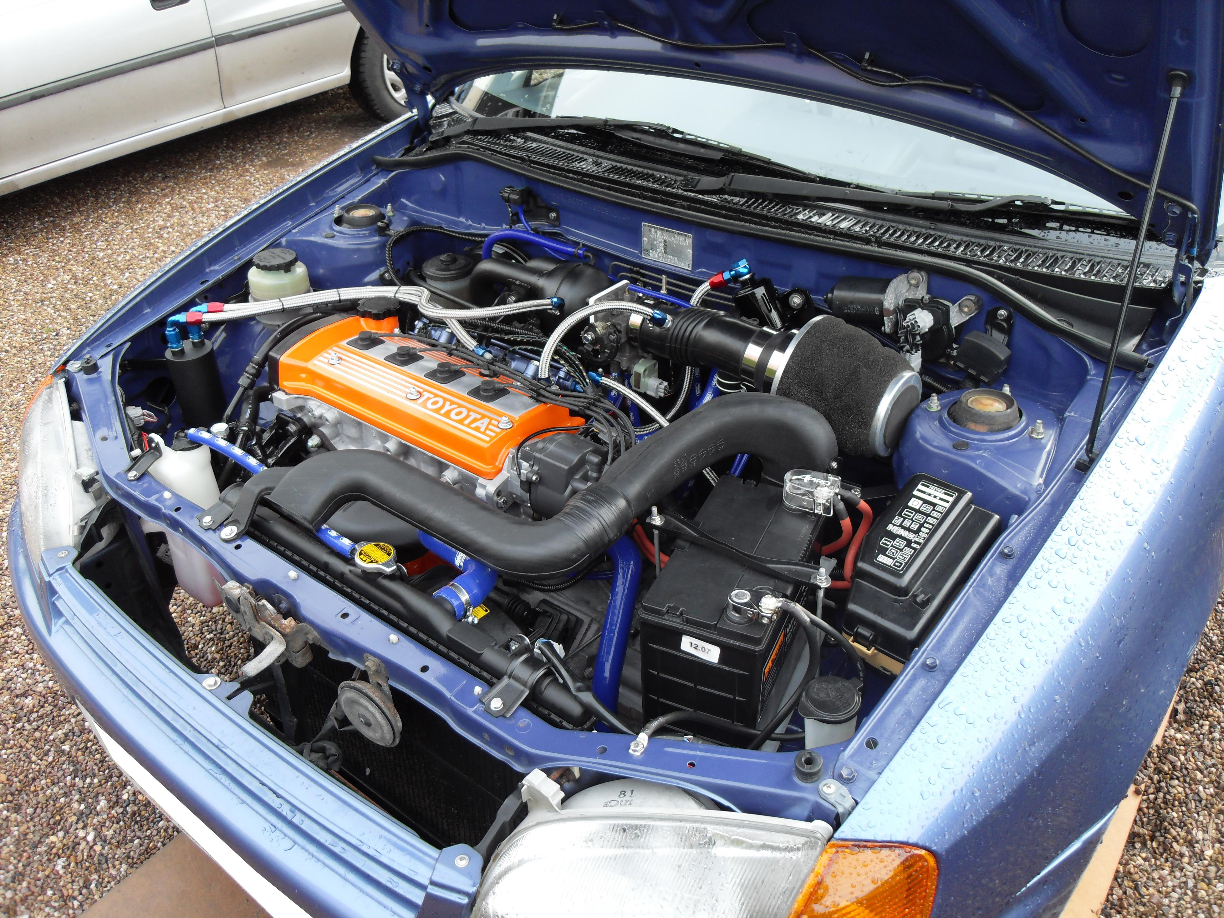

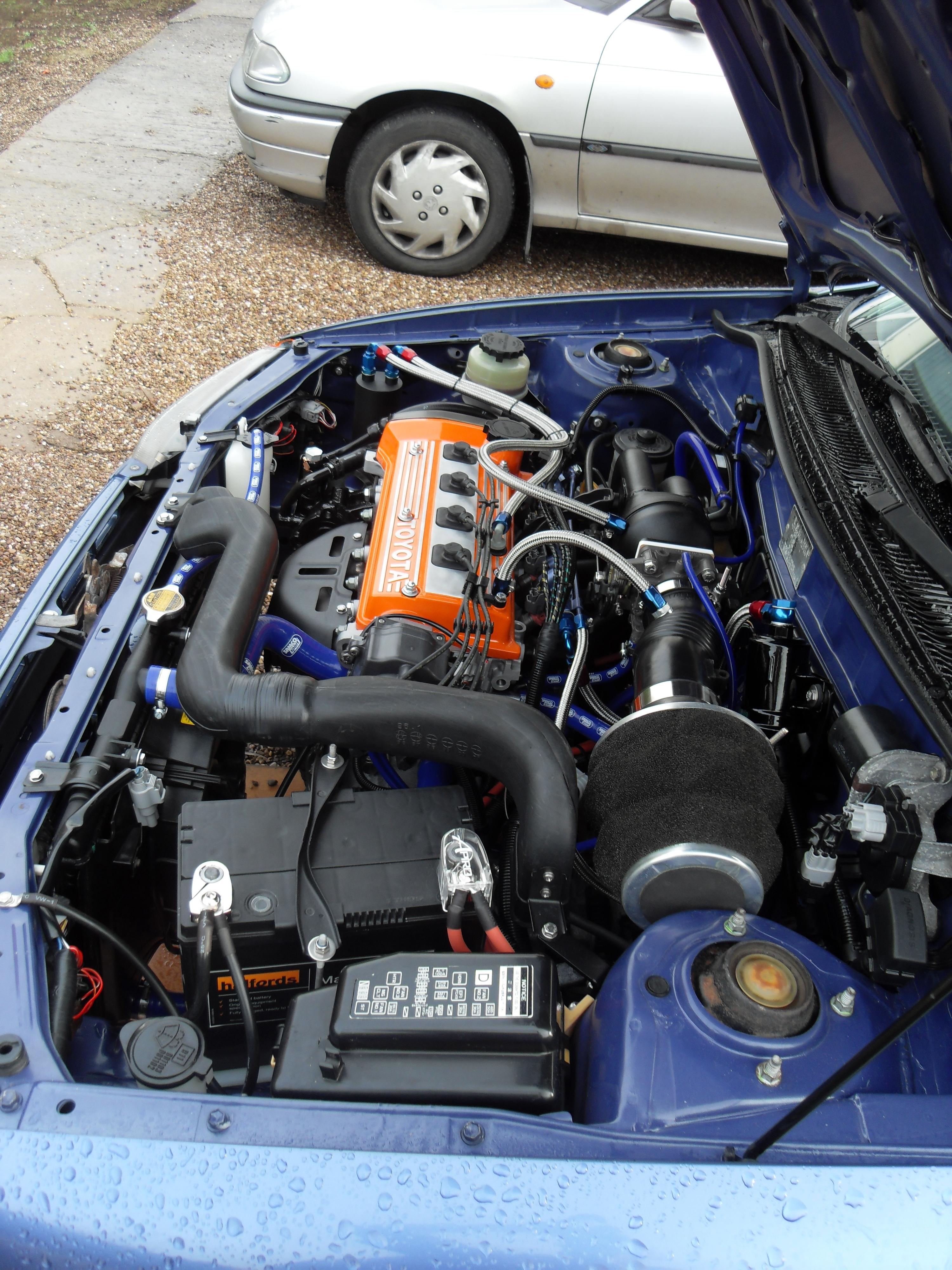

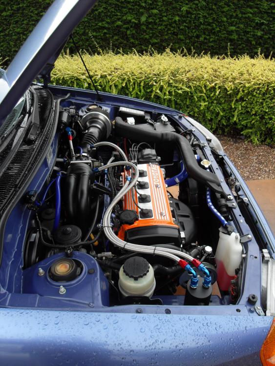

I am very happy to say that yesterday after building up oil pressure she started on the first turn of the key. Needless to say im over the moon.
I did the ignition timing and took her out and everything seems ok, no leaks.
Time for the good bit, photos...
Photos are now in the first post.
This update ends the engine phase of this build stay tuned tho because in the summer there is more to come.

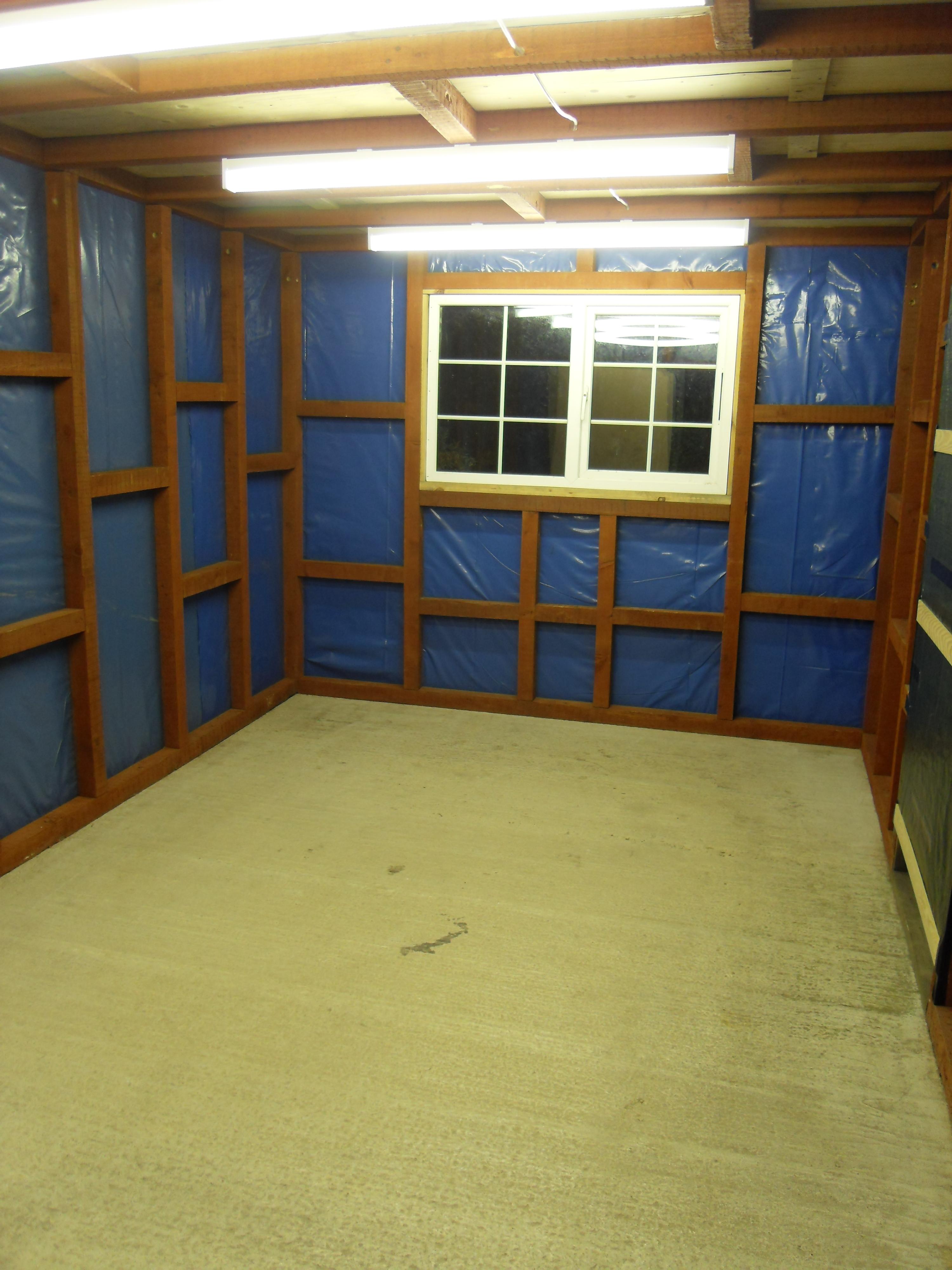

I have evicted the wide arch Peugeot 205 and cleaned the garage as a make shift workshop / spray booth. Its cosy at 3M x 5M but it will do.

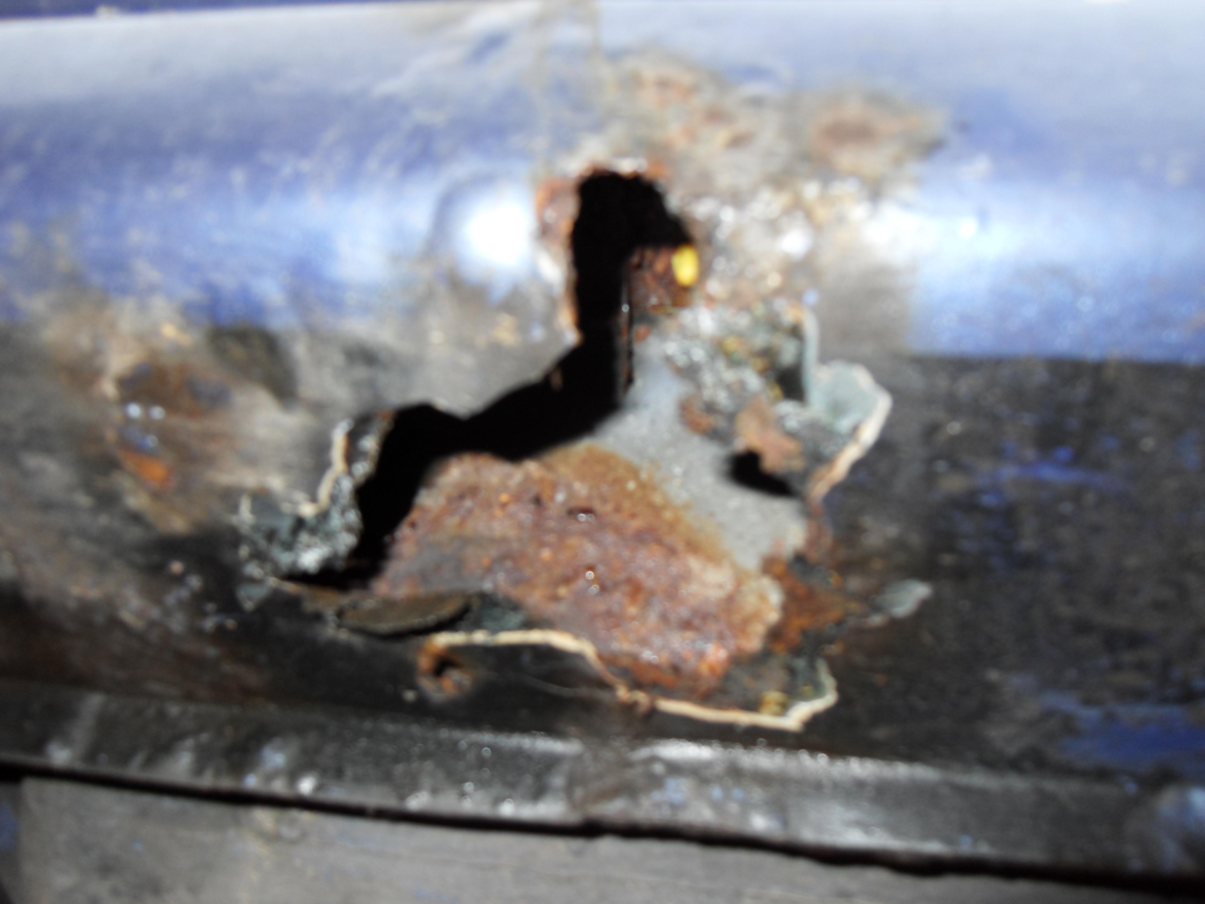

This is the damage after the MOT tester shot a bolt though it. when I took it to the test it was only bubbling paint. I believe its an old repair gone bad.

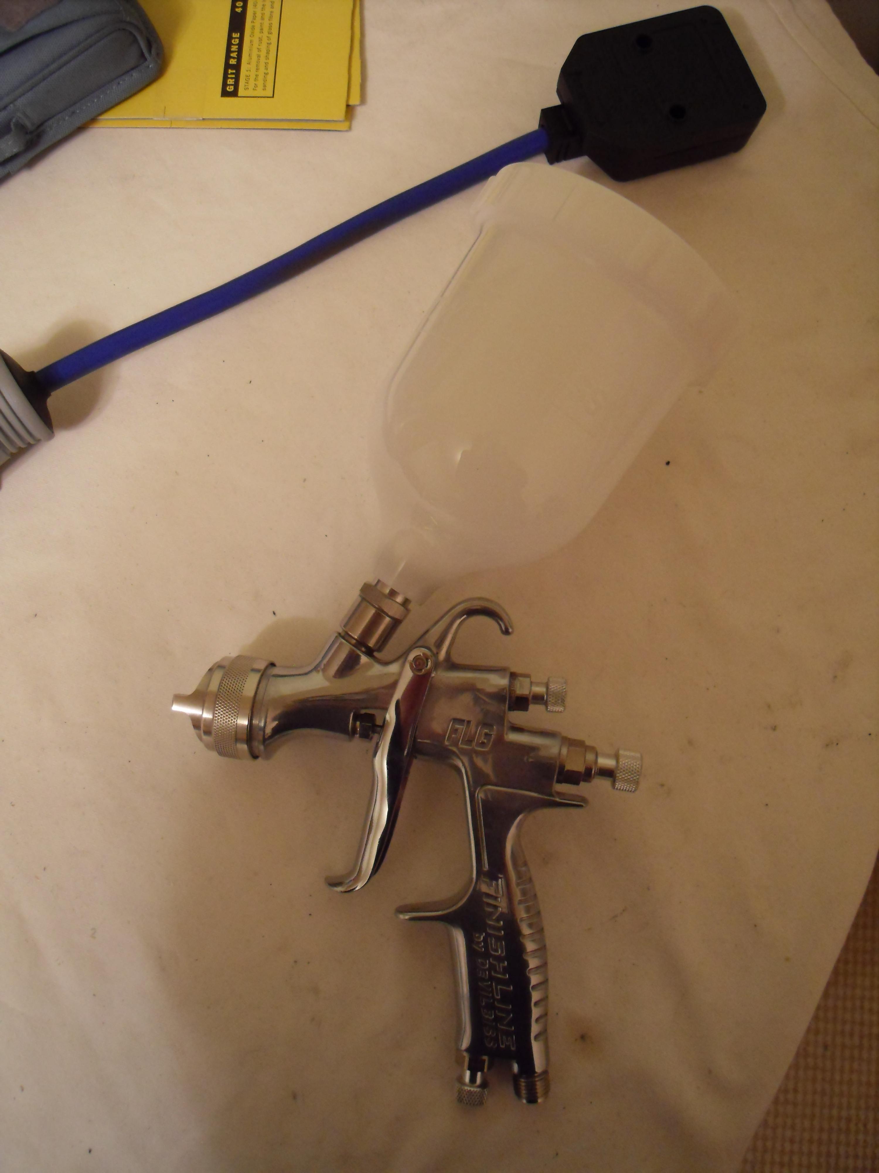

New spray gun
