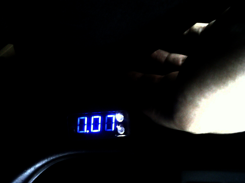

nastyrash 2003 Posted March 25, 2011 Posted March 25, 2011 will be boosting along side you soon fella, lov this motor and good to see a oil presure gauge in should com before boost presure gauge really on all cars do u now the presure ste or do u want me to find out for u so u can watch that bottom ends for going.will be boosting along side you soon fella, lov this motor and good to see a oil presure gauge in should com before boost presure gauge really on all cars do u know the presure ste or do u want me to find out for u so u can watch that bottom ends for going. Quote
Steve GT Posted March 25, 2011 Author Posted March 25, 2011 sexual!!!!!! that is all thankyou but what are your thoughts on the car? will be boosting along side you soon fella, lov this motor and good to see a oil presure gauge in should com before boost presure gauge really on all cars do u now the presure ste or do u want me to find out for u so u can watch that bottom ends for going.Yeh you can find out for me if you want mateyoil pressure gauge needs piping in properly to be honest i need to find a proper fitting kit for it first lol Quote
Socks Posted March 25, 2011 Posted March 25, 2011 it stays between 1.0 and 1.1bar on boost in all gears so thats cool it goes! Quote
Steve GT Posted March 25, 2011 Author Posted March 25, 2011 we'll make some on sunday night on the way to the sea front Quote
nastyrash 2003 Posted March 25, 2011 Posted March 25, 2011 it stays between 1.0 and 1.1bar on boost in all gears so thats cool it goes!u boys have my full admeration, this is how u learn by getting stuck in. the oil presure should be 2.5-4.9 bar @ 3000 rpm but more towards the 4.9 if it is lower thn 3.5 u can remove the oil presure switch and shim up the spring to get better presure recomended as the presures i normaly see on this engine are around 3 bar. remember that on cold start up the filter houses a oil thermo that will give u a higher presure on cold start up thn drop and settle. Quote

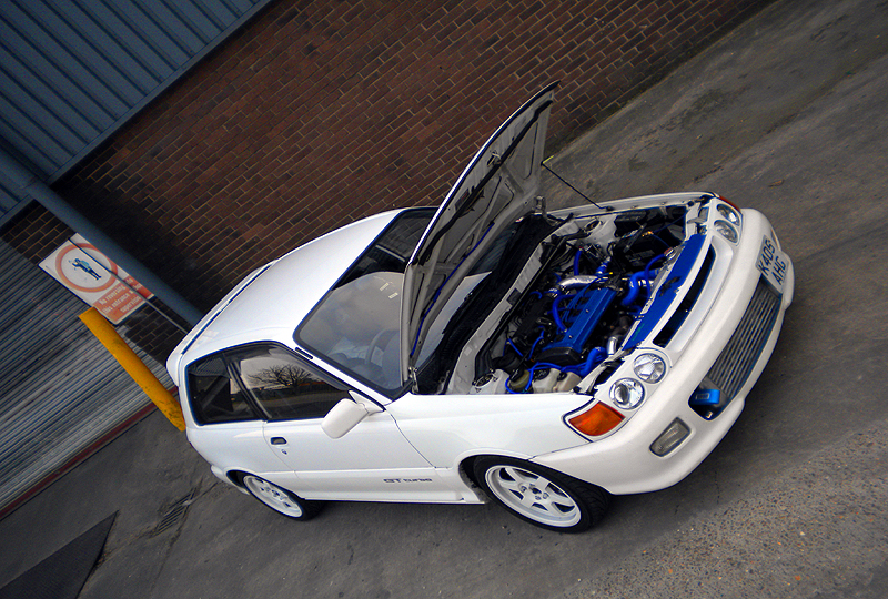

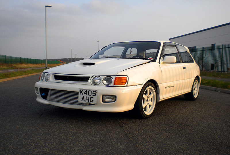

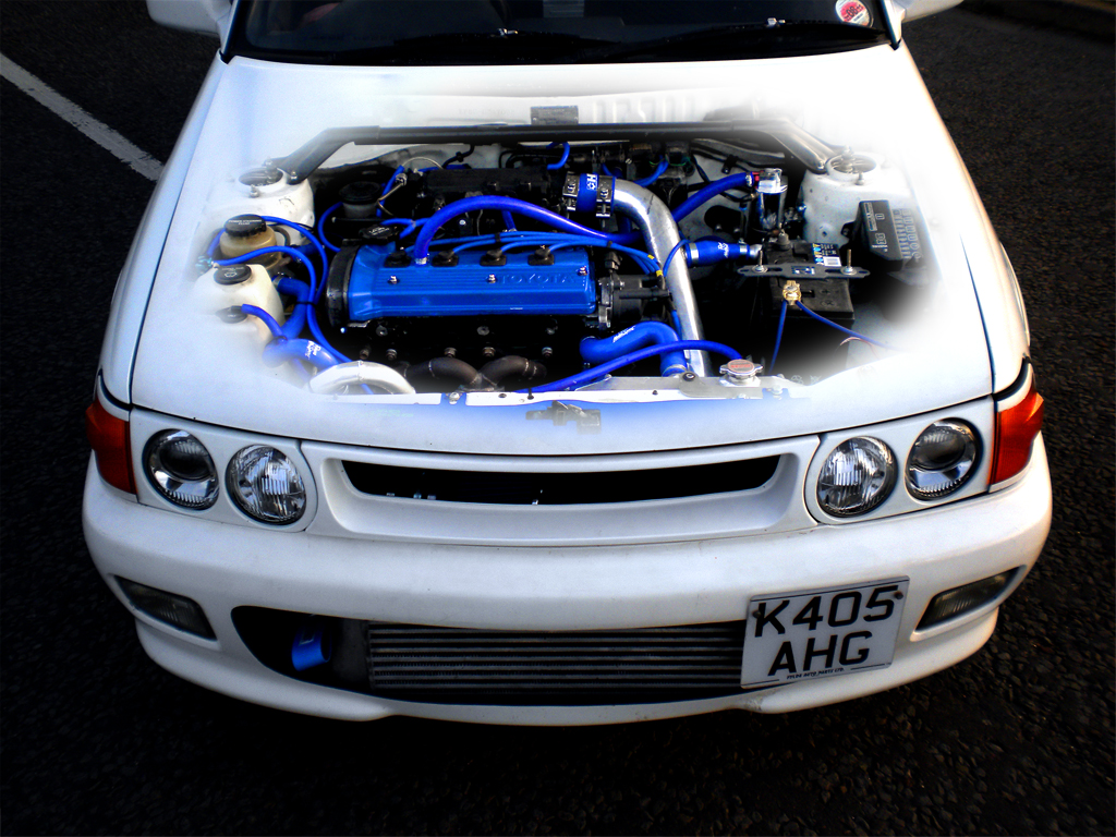

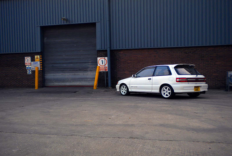

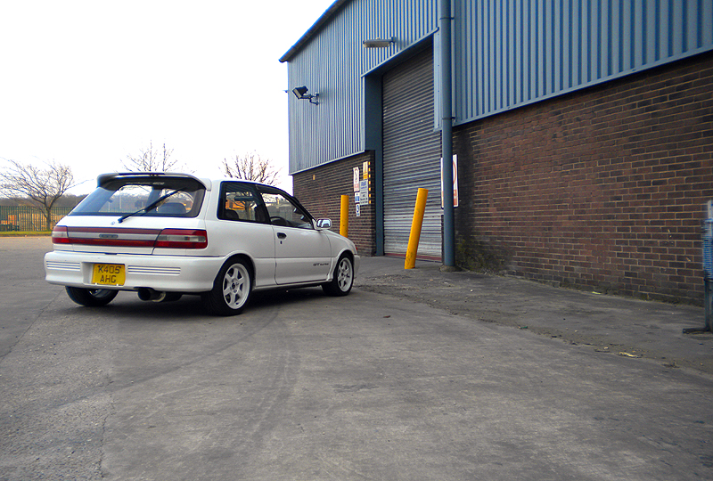

BigMan Posted March 25, 2011 Posted March 25, 2011 looking awesone dude, making me want to turbo mine Quote
drongo boi Posted March 25, 2011 Posted March 25, 2011 proper cant wait 2 c this again!!totally transformed since i last saw it lol Quote
Steve GT Posted March 26, 2011 Author Posted March 26, 2011 looking awesone dude, making me want to turbo mine DO IT proper cant wait 2 c this again!!totally transformed since i last saw it lollol it has indeed you not coming to rising sun by the way matey? Quote
Steve GT Posted March 26, 2011 Author Posted March 26, 2011 off in for a respray mid next month 2 Quote
BigMan Posted March 27, 2011 Posted March 27, 2011 looks awesome mate, the toms kit would ruin it id say but thats upto you lol Quote
LukeSR Posted March 27, 2011 Posted March 27, 2011 No TOM's parts therefor pics suck!!11 Only joking it looks MINT matey, love it Quote
Steve GT Posted March 27, 2011 Author Posted March 27, 2011 looks awesome mate, the toms kit would ruin it id say but thats upto you lolyour 100% right thats why im selling all my toms kit. will look mint on someone elses car but im a fan of standardness and want to keep it like that now Quote
BigMan Posted March 27, 2011 Posted March 27, 2011 your 100% right thats why im selling all my toms kit. will look mint on someone elses car but im a fan of standardness and want to keep it like that now good lad!!if it aint broke dont fix it! Quote
Amjad Posted March 27, 2011 Posted March 27, 2011 Videeeeeeeoooooooooooooooooooosssssssssssssssss! And the car looks lovely Quote
Giggz Posted March 27, 2011 Posted March 27, 2011 Looks well, not sure if it's the camera but on those pics it looks really wide :S Quote
