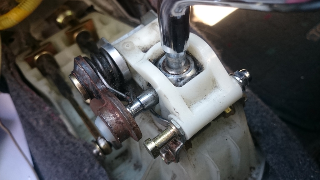

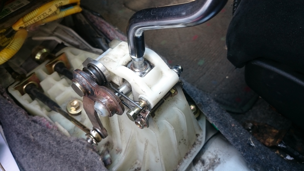

akyakapotter Posted June 18, 2015 Author Posted June 18, 2015 Hope it's made it back. It did till about 40miles from home. Think 5th synchro has decided it dosent want to play ball popped out twice so not sure if it is or not. This car has been sent to test me im sure of it. drives spot on though Quote

DevonGT Posted June 18, 2015 Posted June 18, 2015 It did till about 40miles from home. Think 5th synchro has decided it dosent want to play ball popped out twice so not sure if it is or not. This car has been sent to test me im sure of it. drives spot on though Feel for you mate. Surely not more gearbox problems? Quote

RobSR Posted June 18, 2015 Posted June 18, 2015 When you drive on motorways do you usually rest your hand on the gear stick? Common problem of then making them jump out of gear as it'll be a bent selector. Quote
akyakapotter Posted June 19, 2015 Author Posted June 19, 2015 I don't rest my hand on the gear stick no just one of those things I guess lol Quote
akyakapotter Posted June 19, 2015 Author Posted June 19, 2015 (edited) Had a look today over all the cables bushes and the shifter it's self. Found the spring that returns the gear stick center once in gear had snapped. meaning the gear stick wasn't returning central when 5th was selected now returns to center with the stpring off my stock shifter. Hopefully that has sorted that problem time will tell Edited July 15, 2017 by akyakapotter Quote

akyakapotter Posted June 19, 2015 Author Posted June 19, 2015 Not having trouble getting in gears it just popped out of 5th the gear stick didnt return to center it dose now. Haha I never hoover it should really. Quote

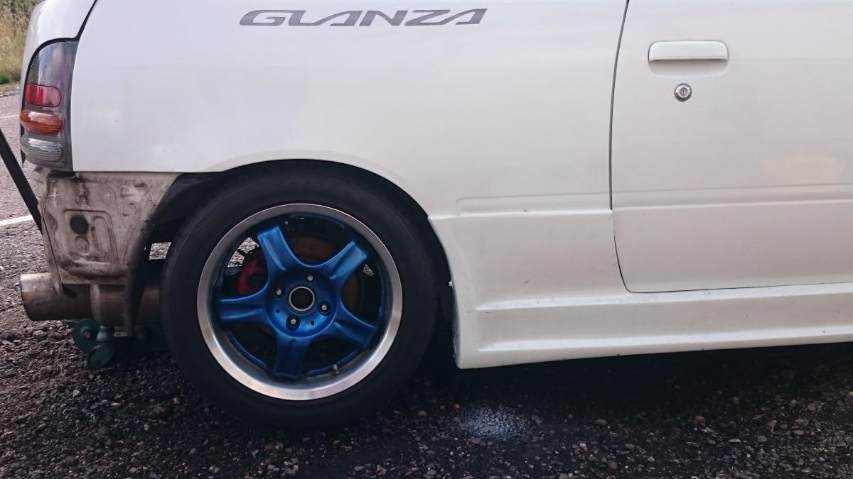

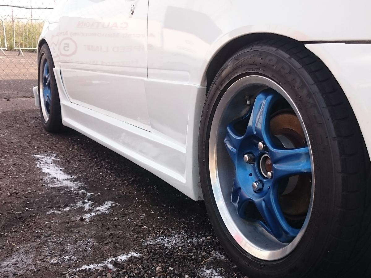

jimmymac101 Posted July 4, 2015 Posted July 4, 2015 They dont look half bad .... good work mate James Quote
akyakapotter Posted July 4, 2015 Author Posted July 4, 2015 They dont look half bad .... good work mate James Thanks mate chrome need attention but that's a job for another day Quote
