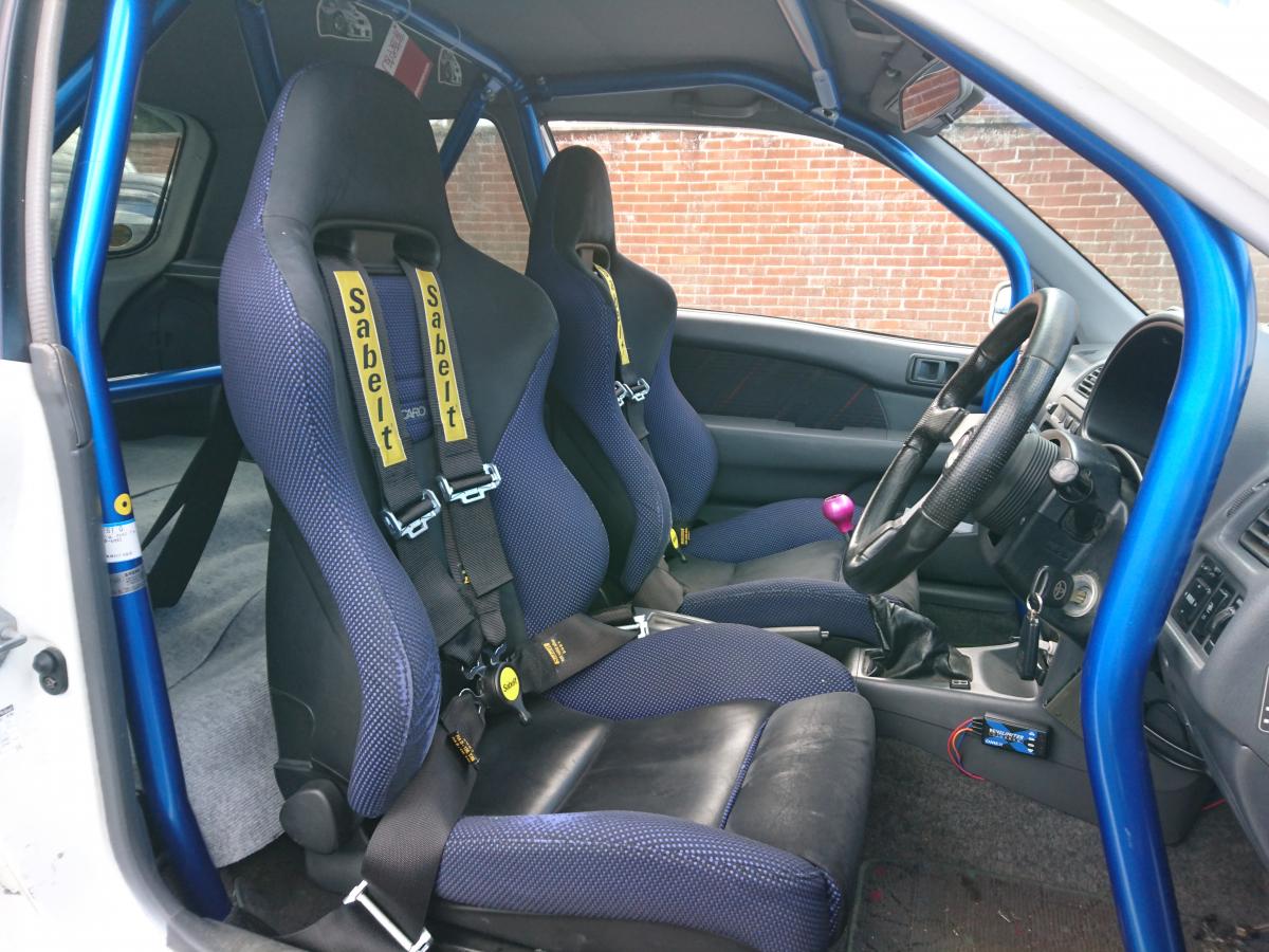

akyakapotter Posted September 30, 2016 Author Posted September 30, 2016 Bit of a late one as I picked these up day before jae exchanged my 98 spec seats and a few £s so now have a matching set of evo recaros looks much better and the position is much better than my genuine recaro rail these sit lower down. Quote
jimmymac101 Posted September 30, 2016 Posted September 30, 2016 Its the small touches that make a difference! Good work 👍 she behaving lately? James Quote
akyakapotter Posted September 30, 2016 Author Posted September 30, 2016 Its the small touches that make a difference! Good work 👍 she behaving lately? JamesI no mate looks miles better to be honest. I dunno I haven't driven it since Jae and it was a bitch on the way home really laggy had a boost leak and was being a bugger pulling off which I put down to the boost leak which I've now fixed. I'll find out if it's ok at the end of Oct when I drive it to Ramsgate in Kent for a mates wedding. Quote

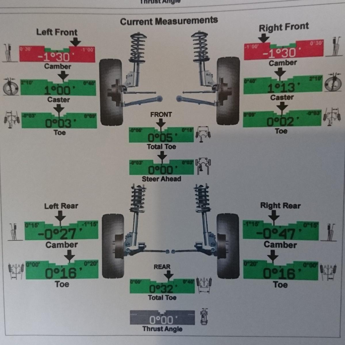

akyakapotter Posted April 1, 2017 Author Posted April 1, 2017 Not alot going on with mine start it up once a week took it to a friend of a friend today to have the alignment sorted out again drives much better now should be ok for my session on track at japfest Silverstone.Cheers nick. Quote
adzy Posted April 1, 2017 Posted April 1, 2017 Can you adjust castor apart from fitting an alk? Quote
Amjad Posted April 1, 2017 Posted April 1, 2017 Nice, -2 front camber did wonders to even out tyre wear on track for me Quote
akyakapotter Posted April 1, 2017 Author Posted April 1, 2017 No adjustment appart from alk kit can't wait to get out on track with this set up fees better Quote

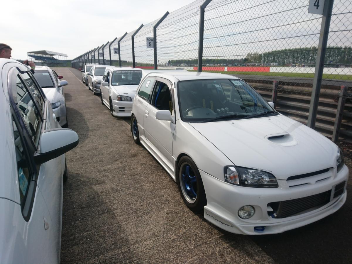

akyakapotter Posted May 3, 2017 Author Posted May 3, 2017 Took the car to japfest Silverstone weekend just gone car drove spot on until the end of my session think I cooked the clutch fluid and have some air in my brakes. Noting I can't sort out orderd my service items as per after a track session. Defo need to get some decent rubber for it took the proxies well past there grip potential lol.Mot is due on the 12th of this month aswell that's always fun.Cheers nick. Quote
