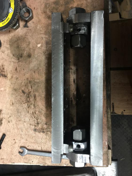

Few more bits!
New strut brace, Made the brackets out of 12mm billet angle.
9DFDAEB9-9178-4AC9-9A6D-92FDB68CAABF_zps
8A6B6D9E-FCFB-4292-9D90-B43839A9A75E_zps
04386620-584F-4126-A523-BAE7E474523E_zps
85855D45-E095-4C0E-A836-48C9293DBDD7_zps
57AF8EE5-19CF-46FF-AD1C-D90B317E8318_zps
081C8BA4-3156-45AC-8FBA-276B0E80B235_zps
6407807D-1EA7-4233-88F1-9BDB86B092B1_zps
Machined the ends for the bar out of solid bar.
51914C7B-025A-43E4-97C4-29401A269F2C_zps
4B56D5F1-10BE-42B0-A546-63FA5D4145DC_zps
200140E2-7FAB-4F65-A03D-97A2F6C03EDD_zps
F3180998-E800-4B60-8AFA-F962B1BEE84E_zps

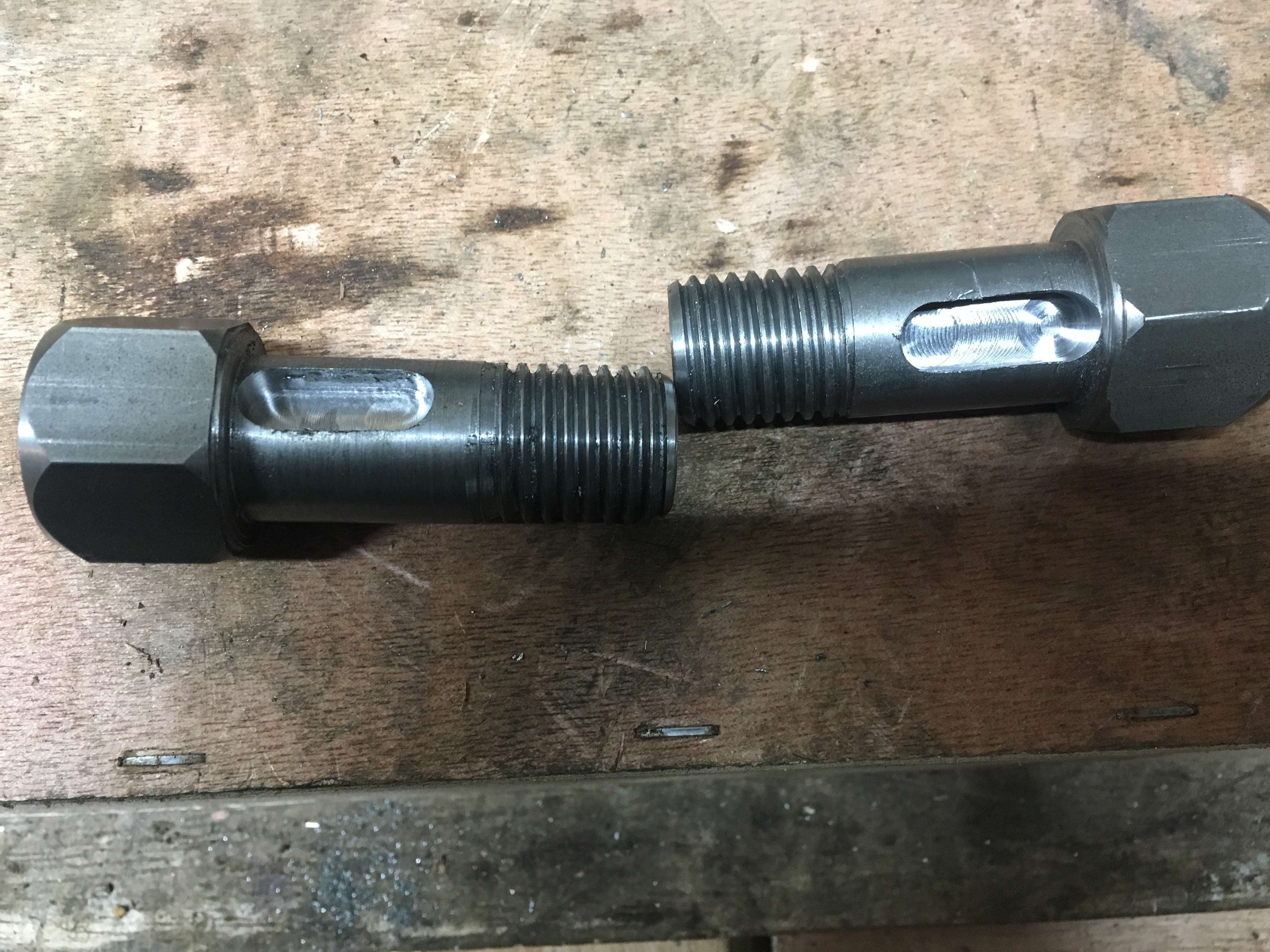

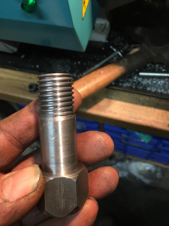

I machined the ends off the bolts too so there was nothing sticking out!
C1FD4FF5-AD43-4A25-BF9F-40FDDD4027EF_zps
Trimmed the brackets and test fitted the ends
94929D5F-FF4E-4506-81FF-7EE7FC7E913E_zps
65CB8CB3-069B-47E3-9438-DCC60F21EC85_zps
9CD6978A-FABA-47C9-A4DD-DE843FE10D46_zps
E2D7C08B-71C7-4D6D-A240-70C24AC4CC0C_zps
BA202725-D558-4CCA-BA41-96D899C197B7_zps
Bar welded in and the catch tank finished and fitted, just need to sort the pipes now and paint the brace brackets.
9582ACFF-9ABF-4EE9-AA0C-620BBD0245A5_zps
2765C21F-0902-4B09-B598-B11733F67BA0_zps
3FBF2522-D072-4478-A397-3976440750BB_zps
AC3E0D6E-F305-4FDA-BB87-BD3164E5993F_zps
C46A218A-2352-4187-B3BB-72ABDB7CF295_zps

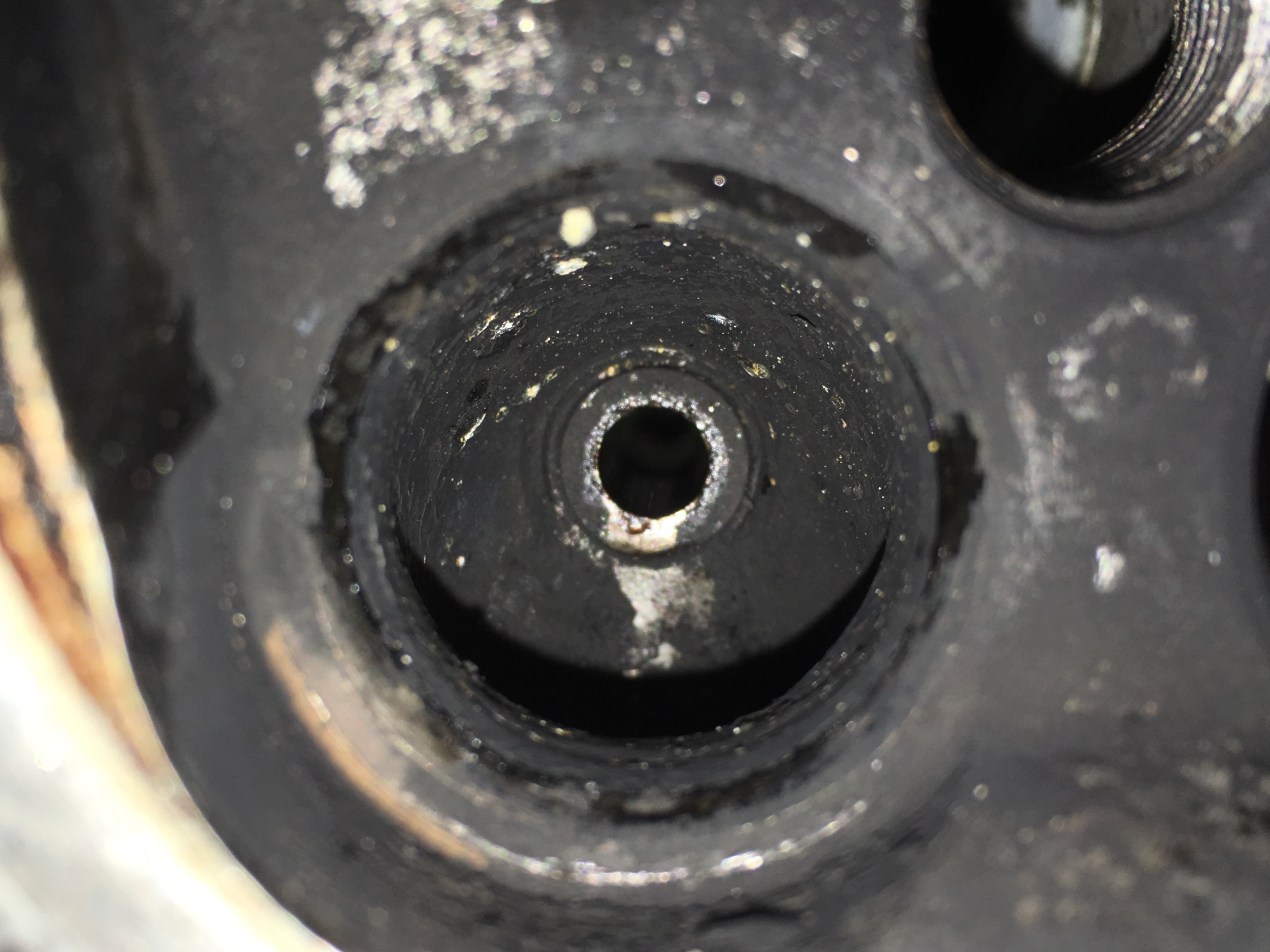

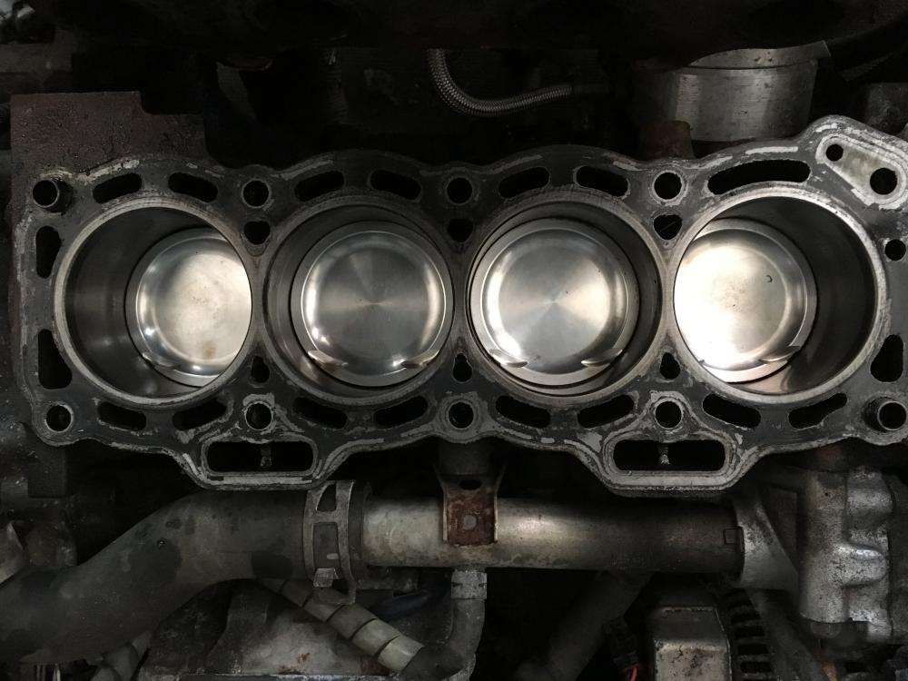

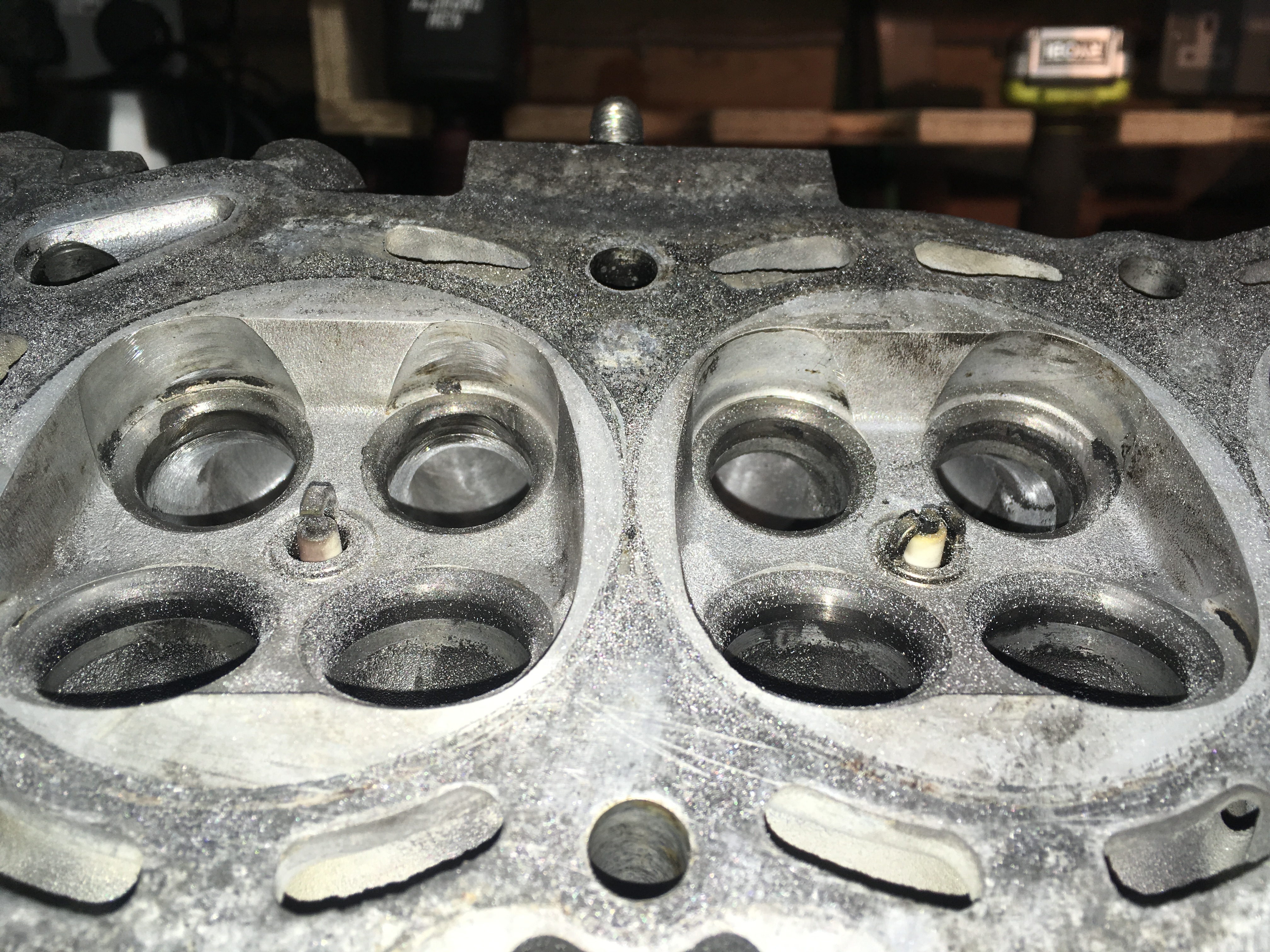

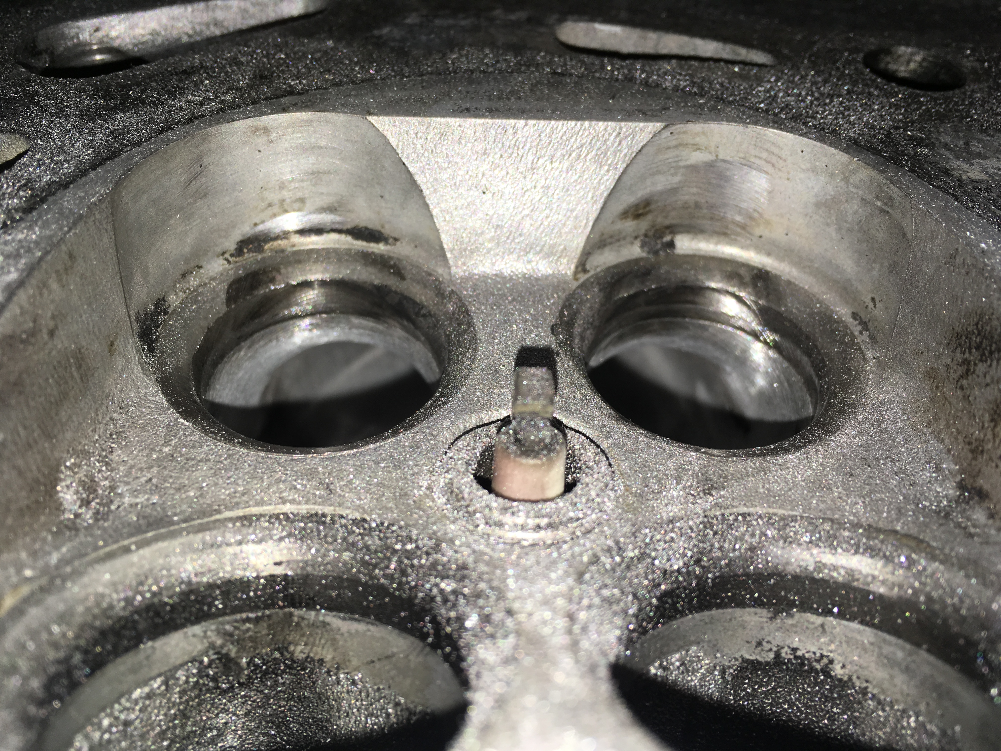

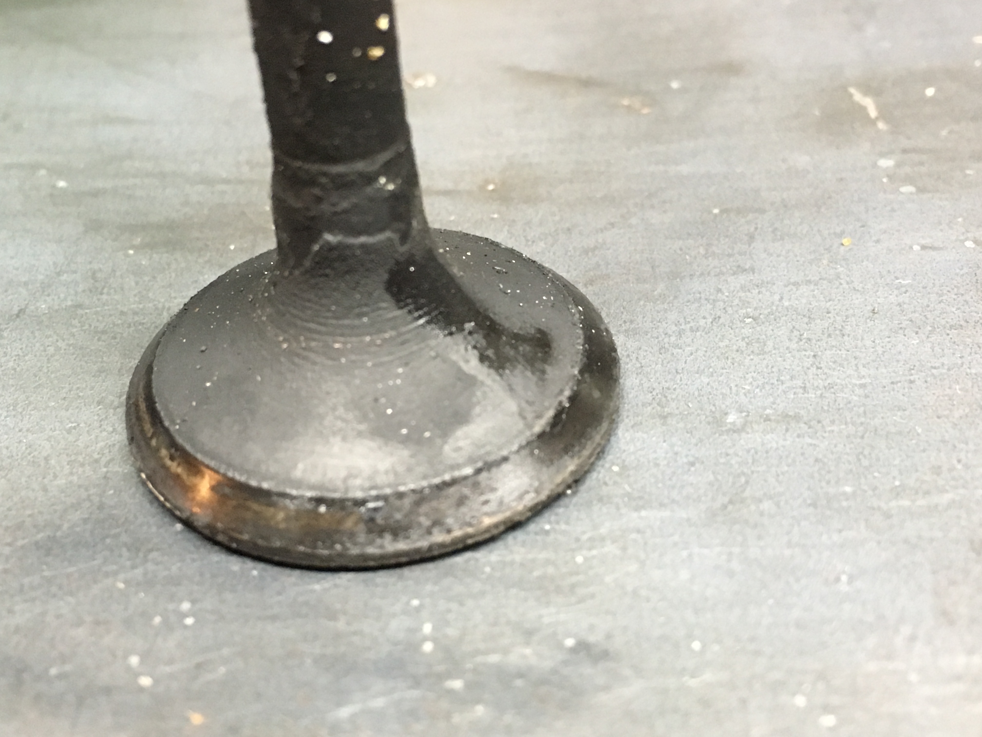

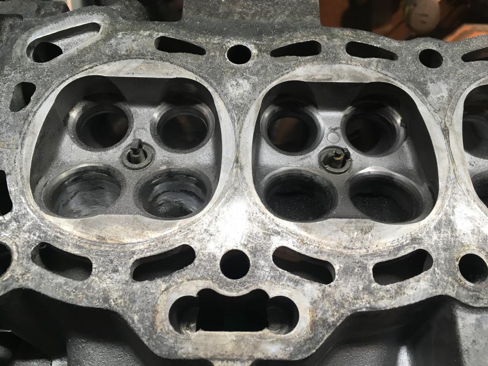

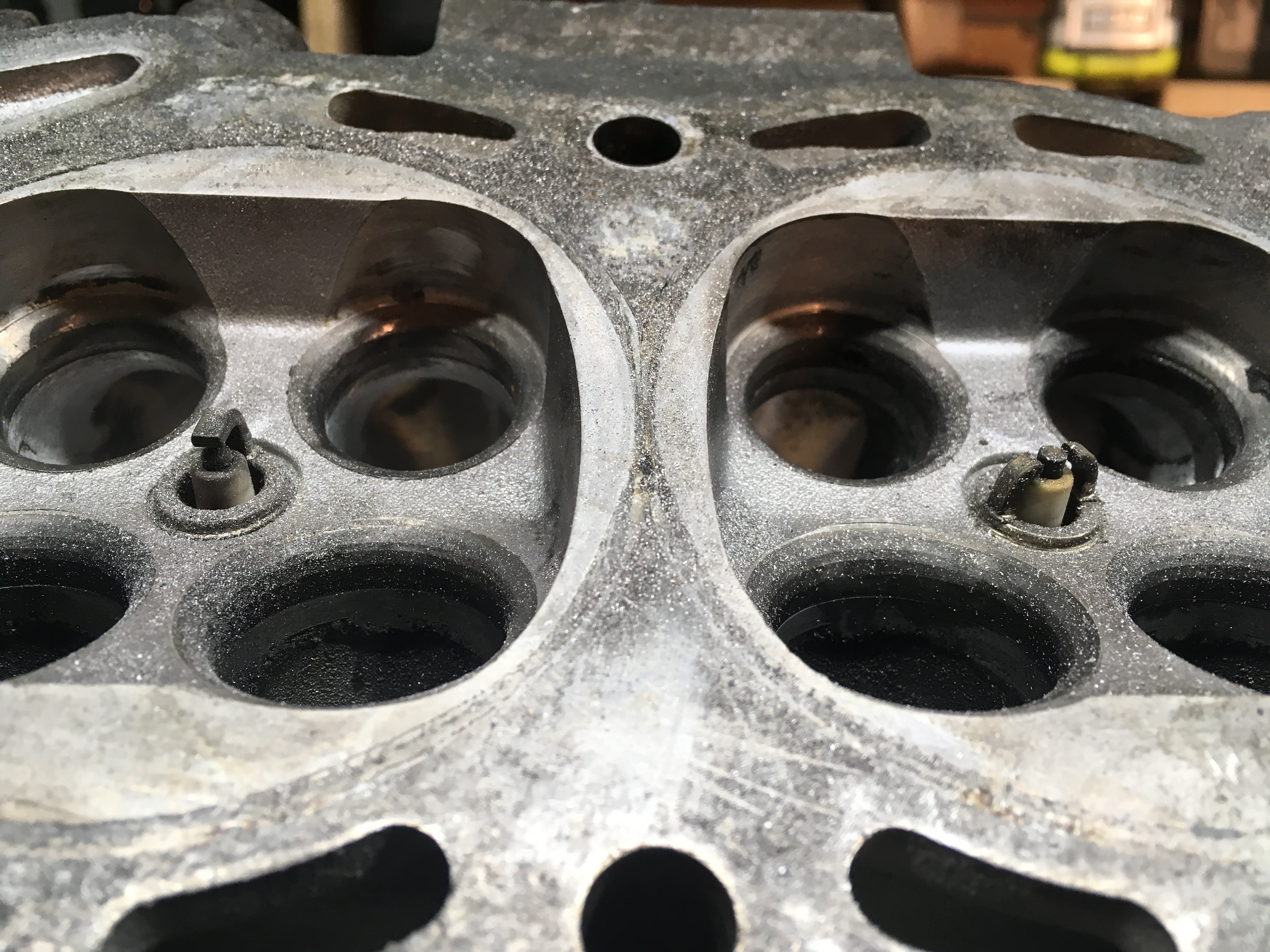

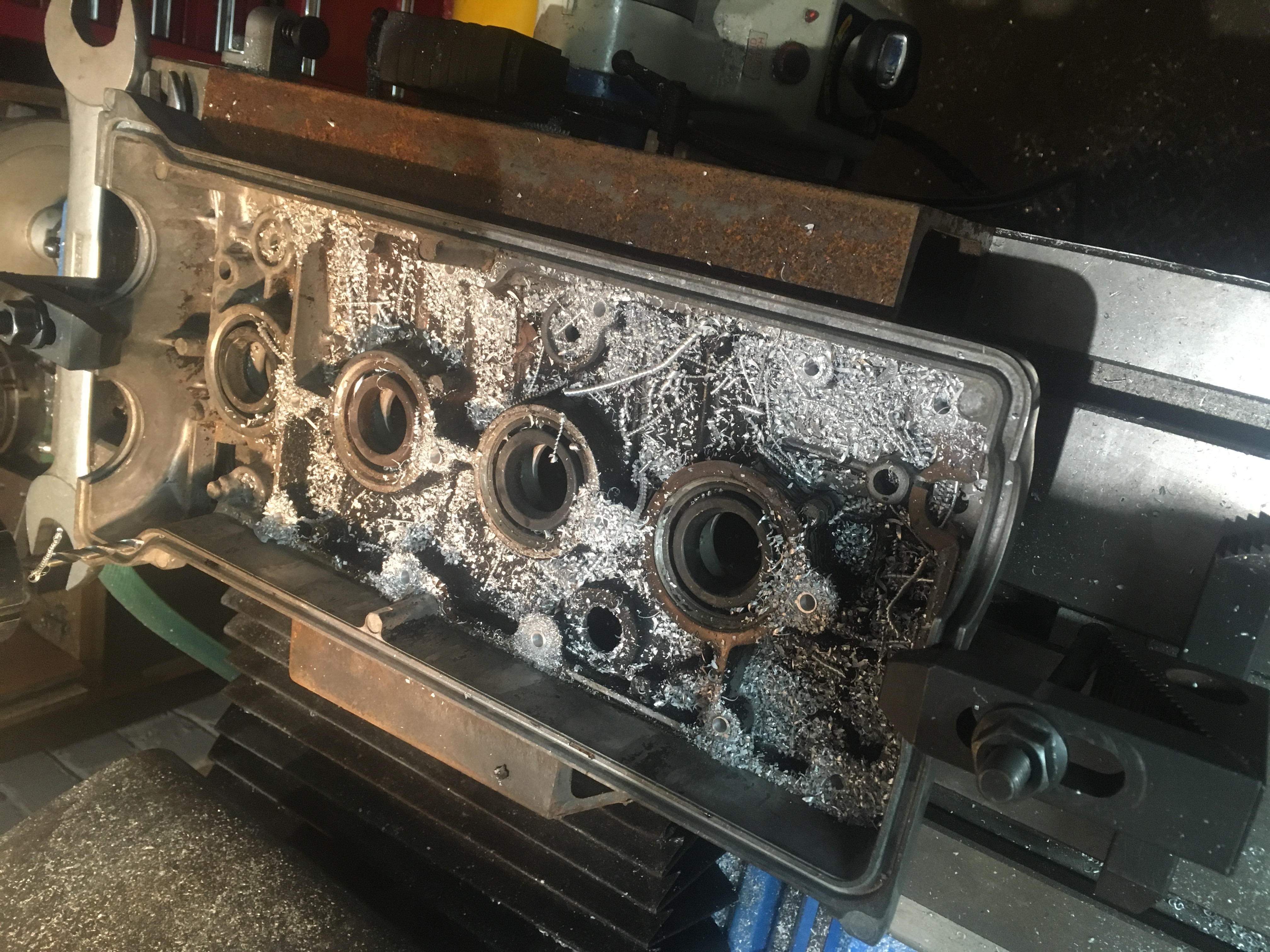

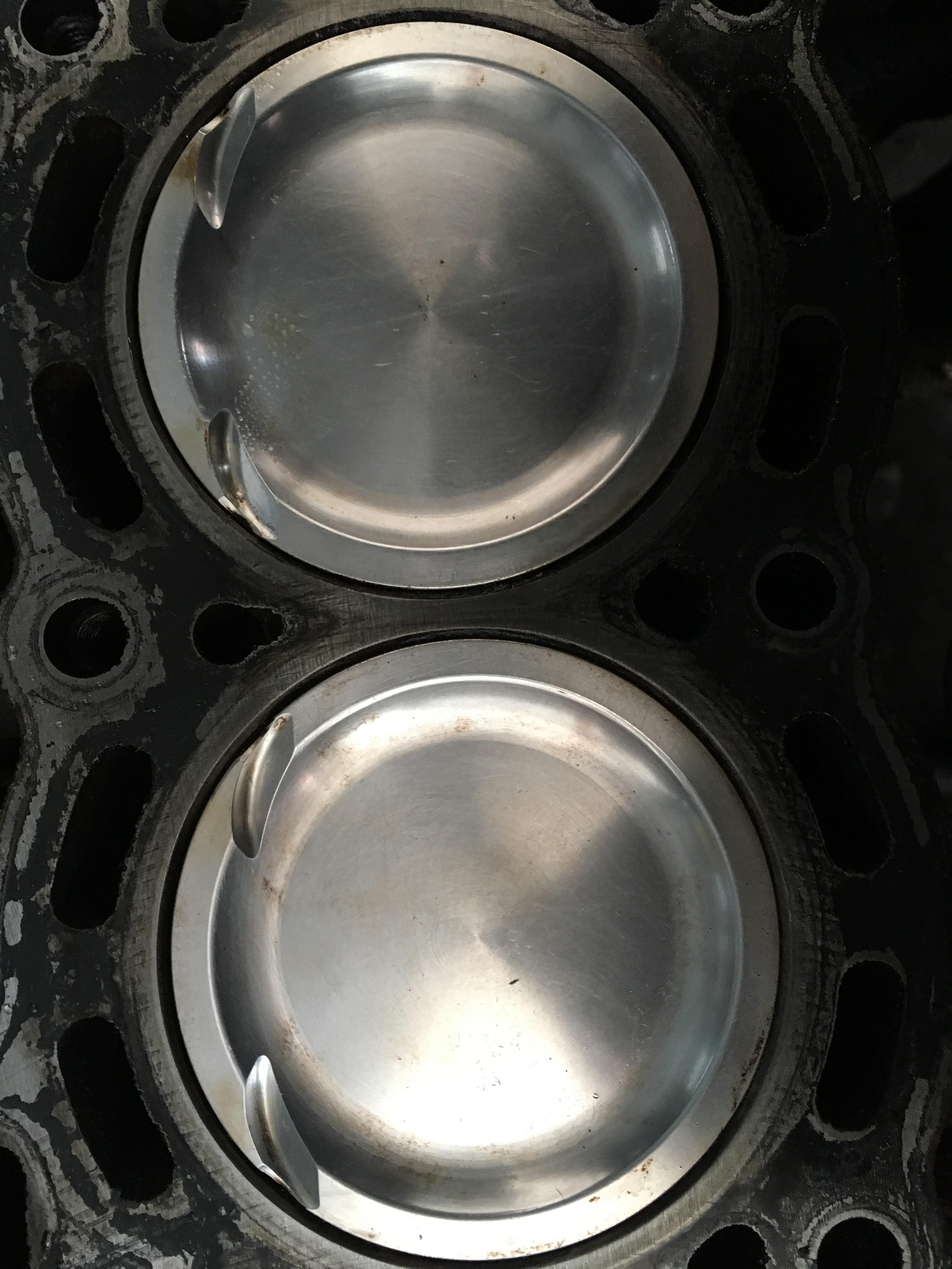

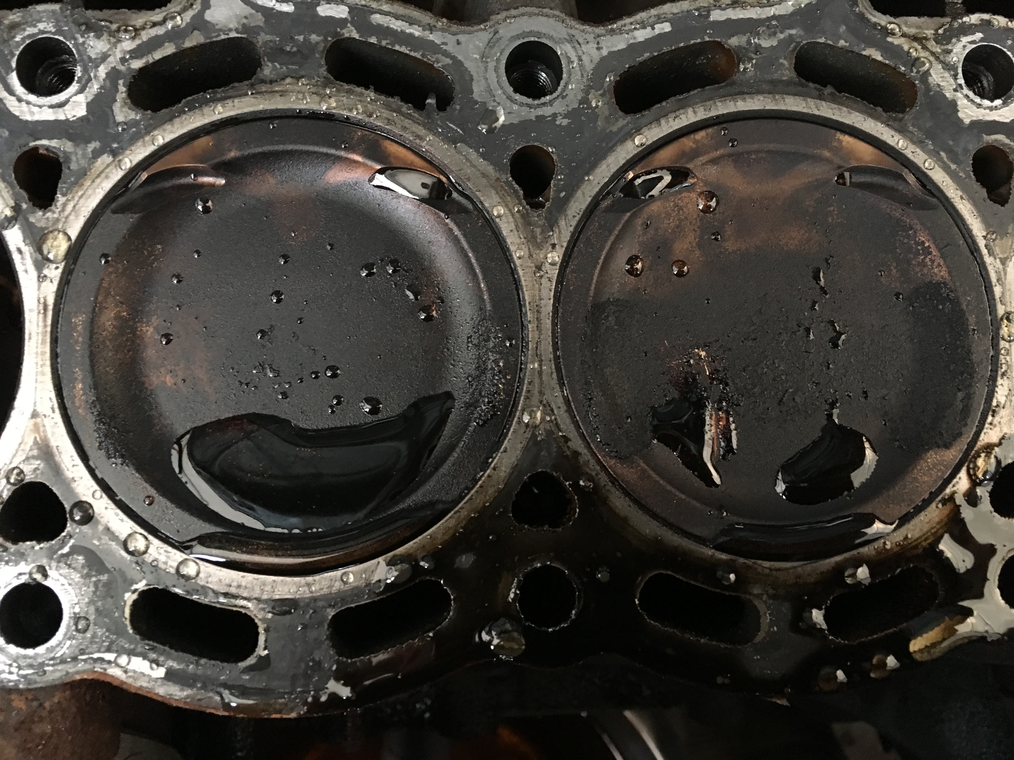

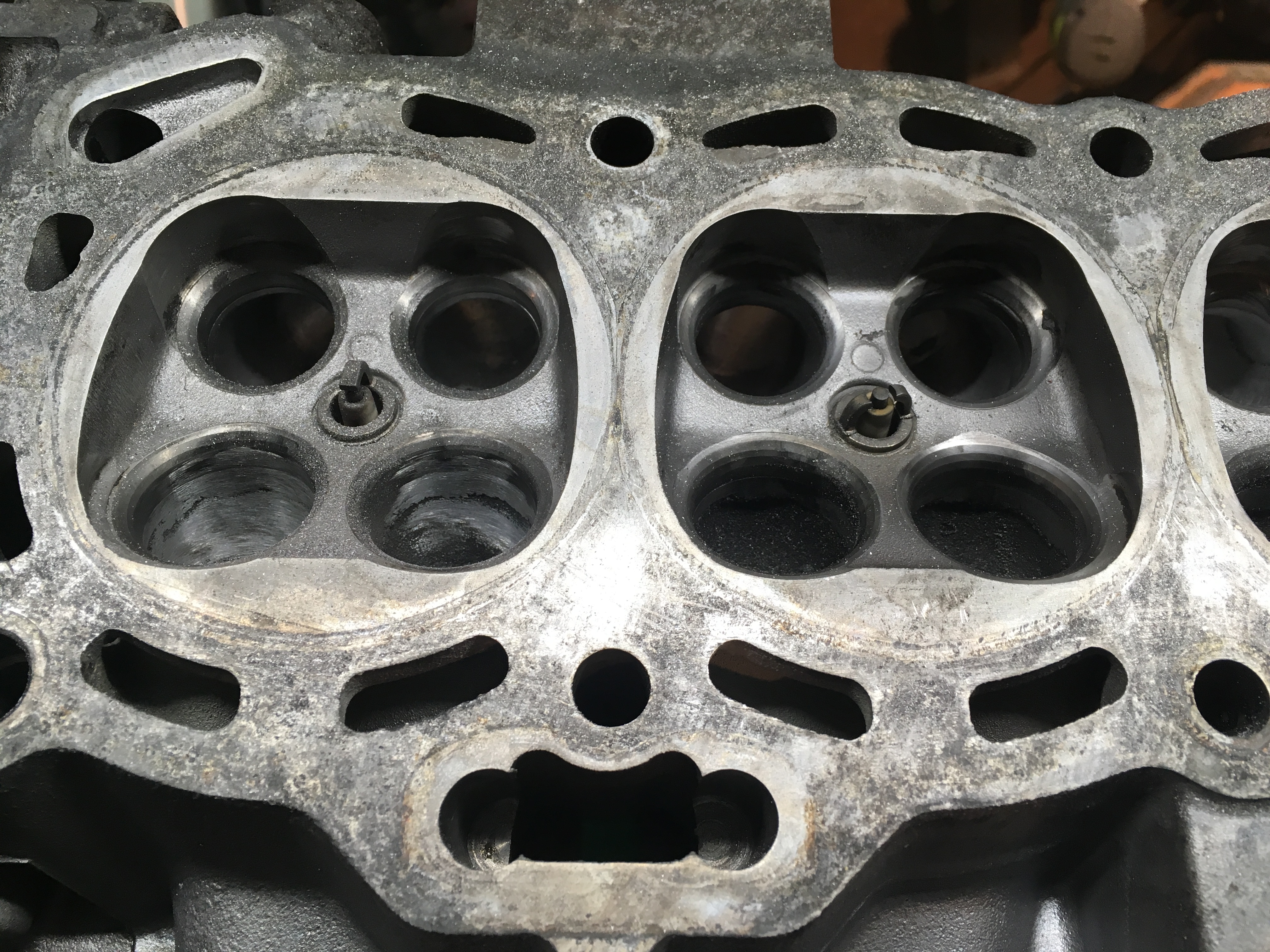

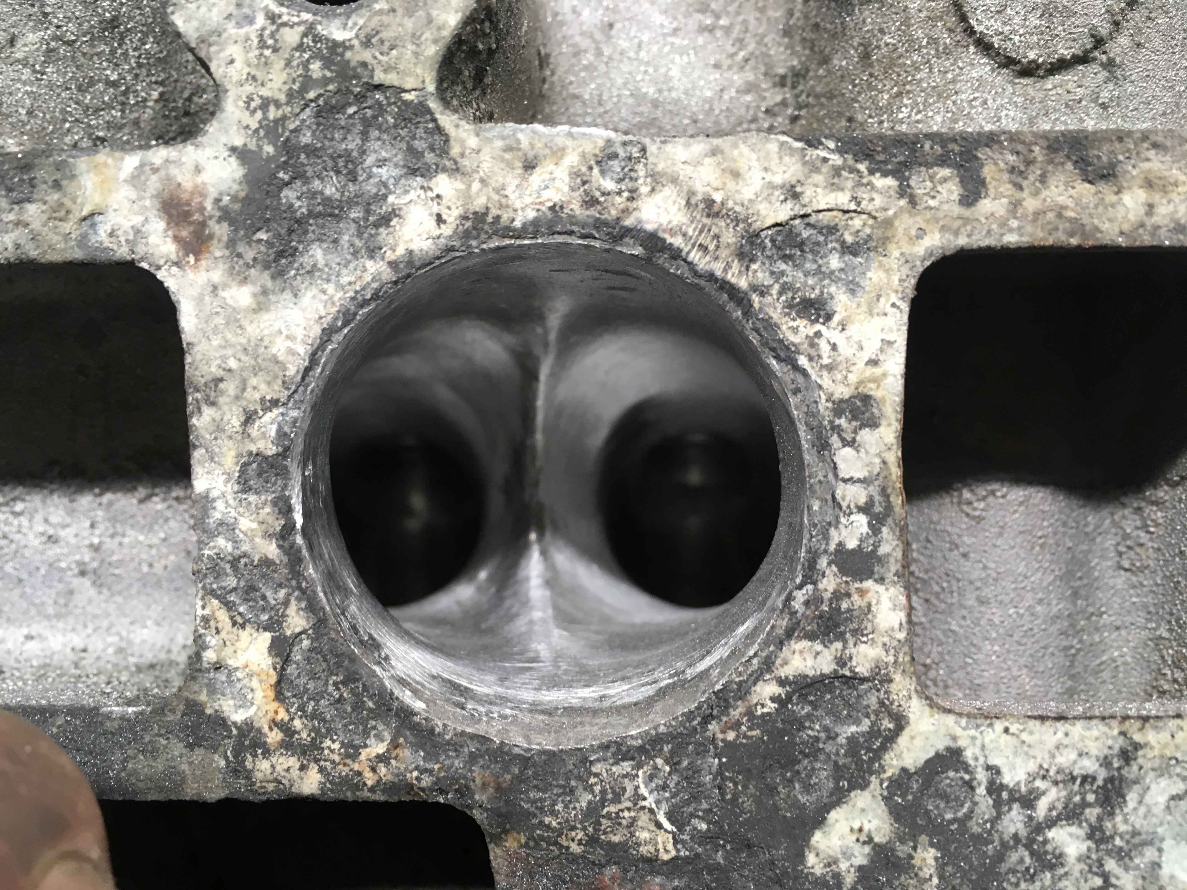

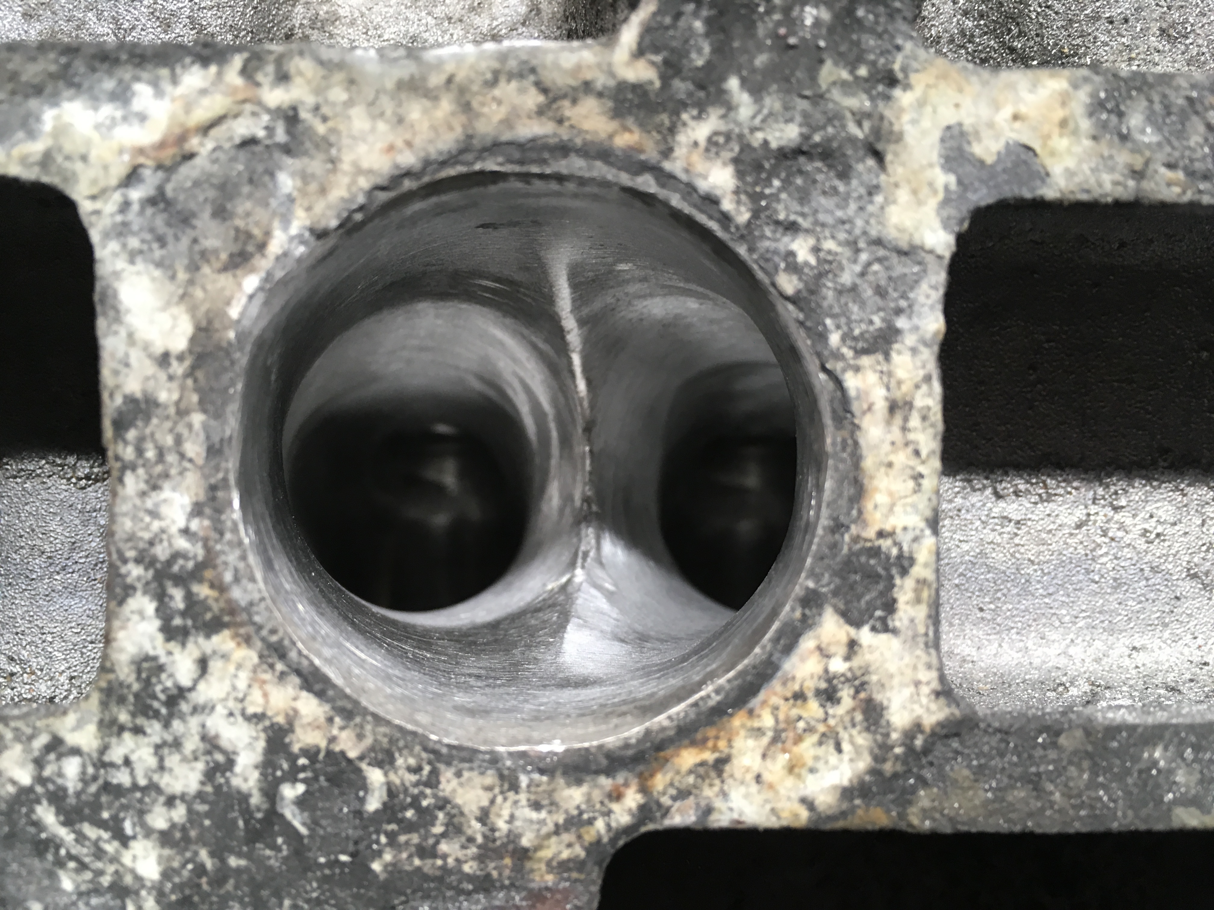

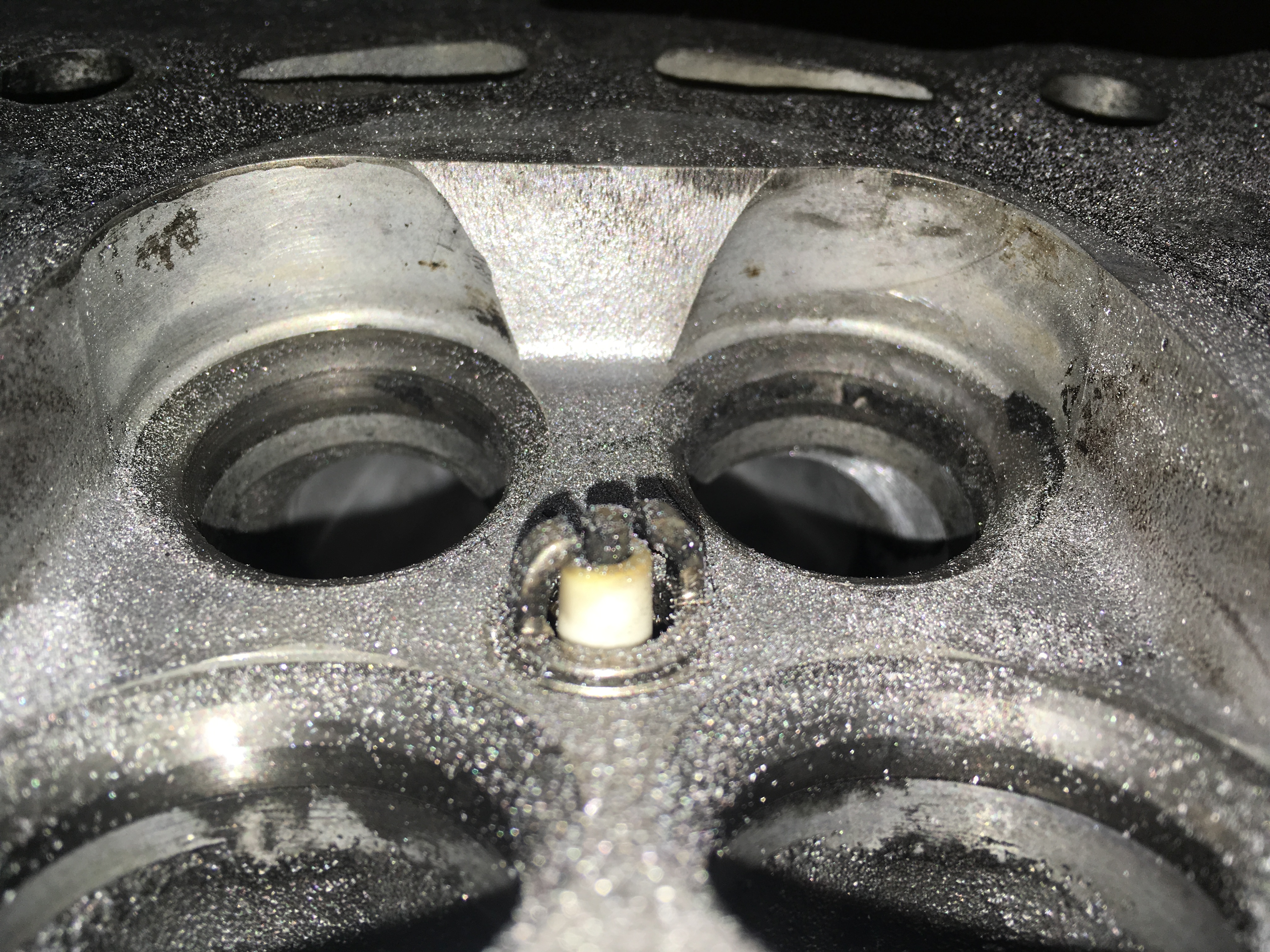

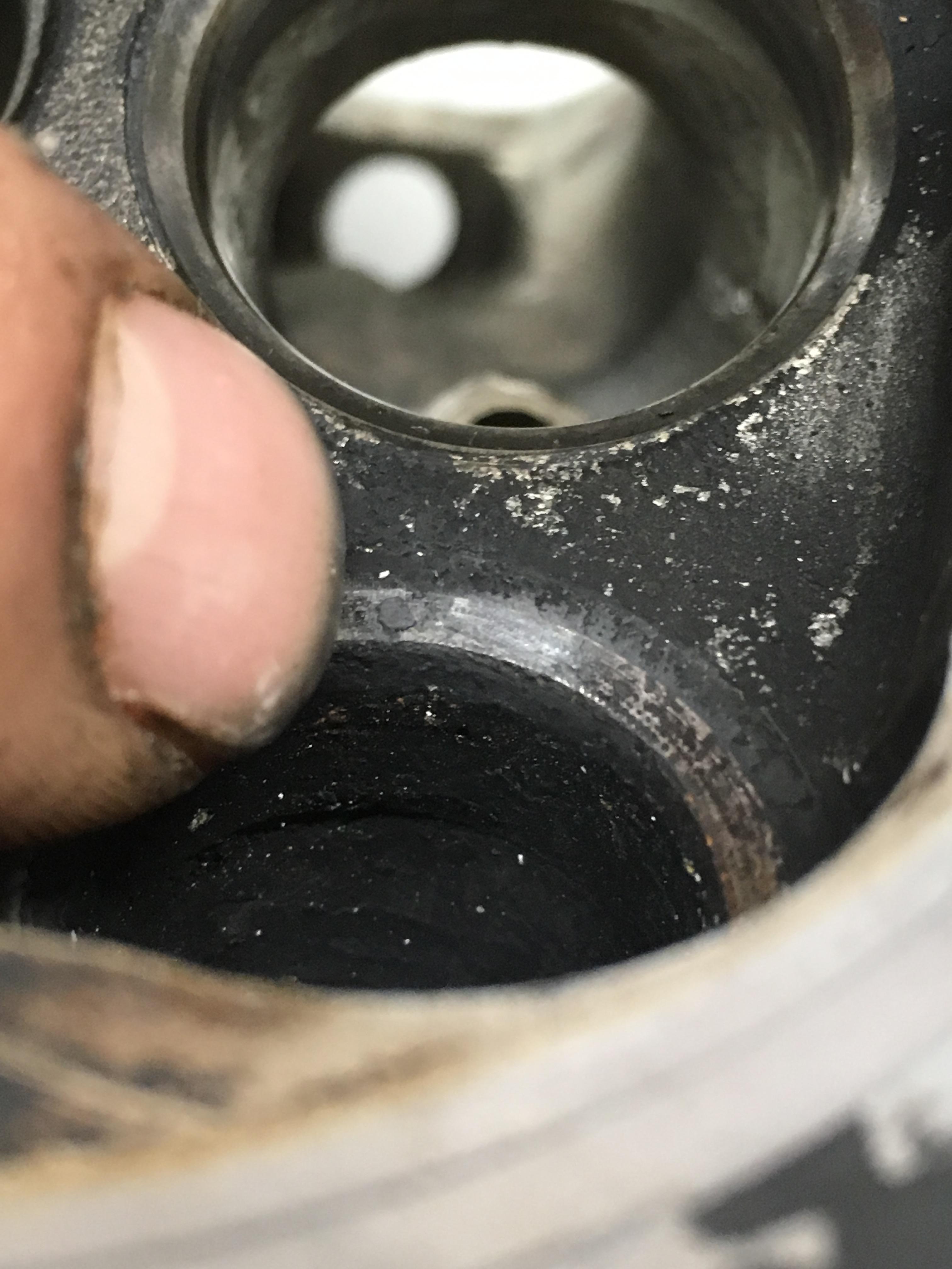

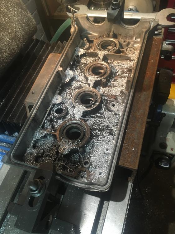

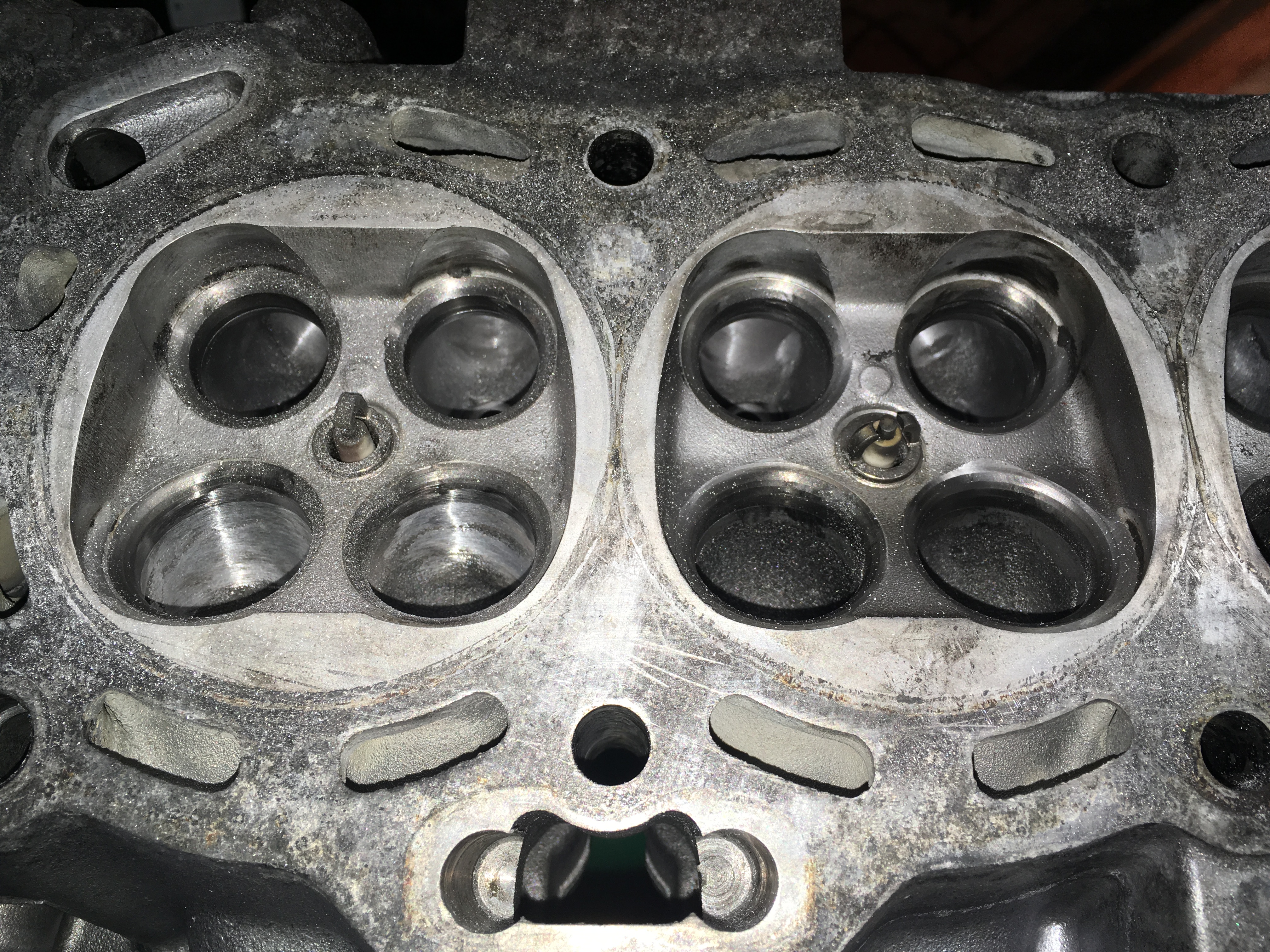

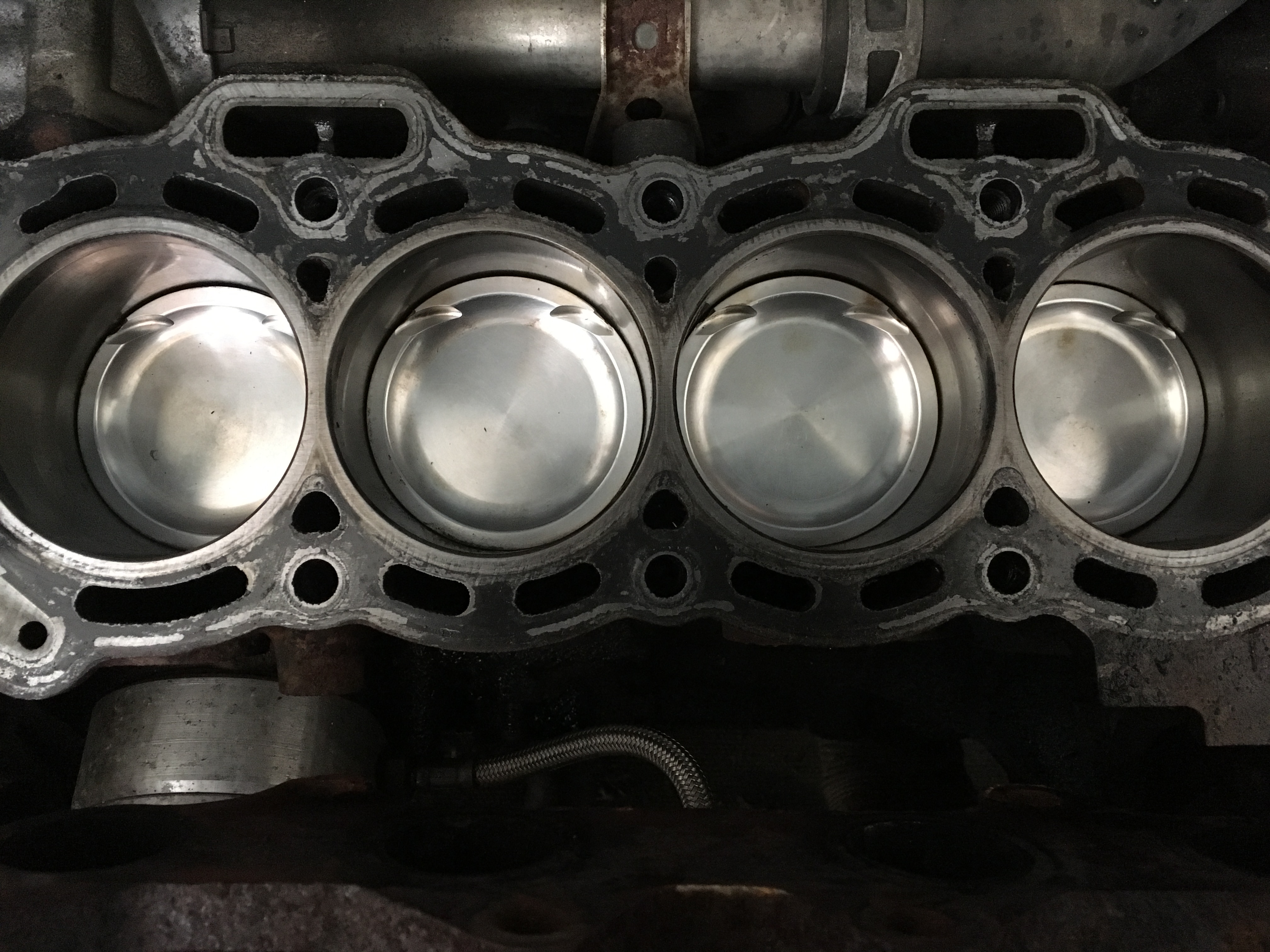

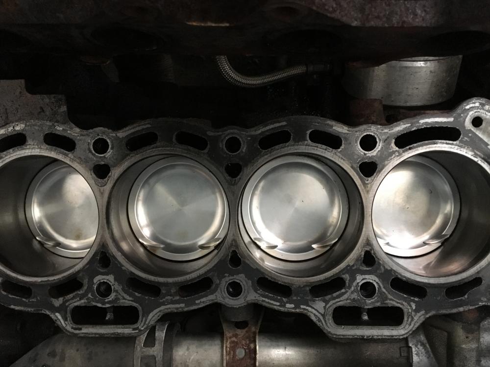

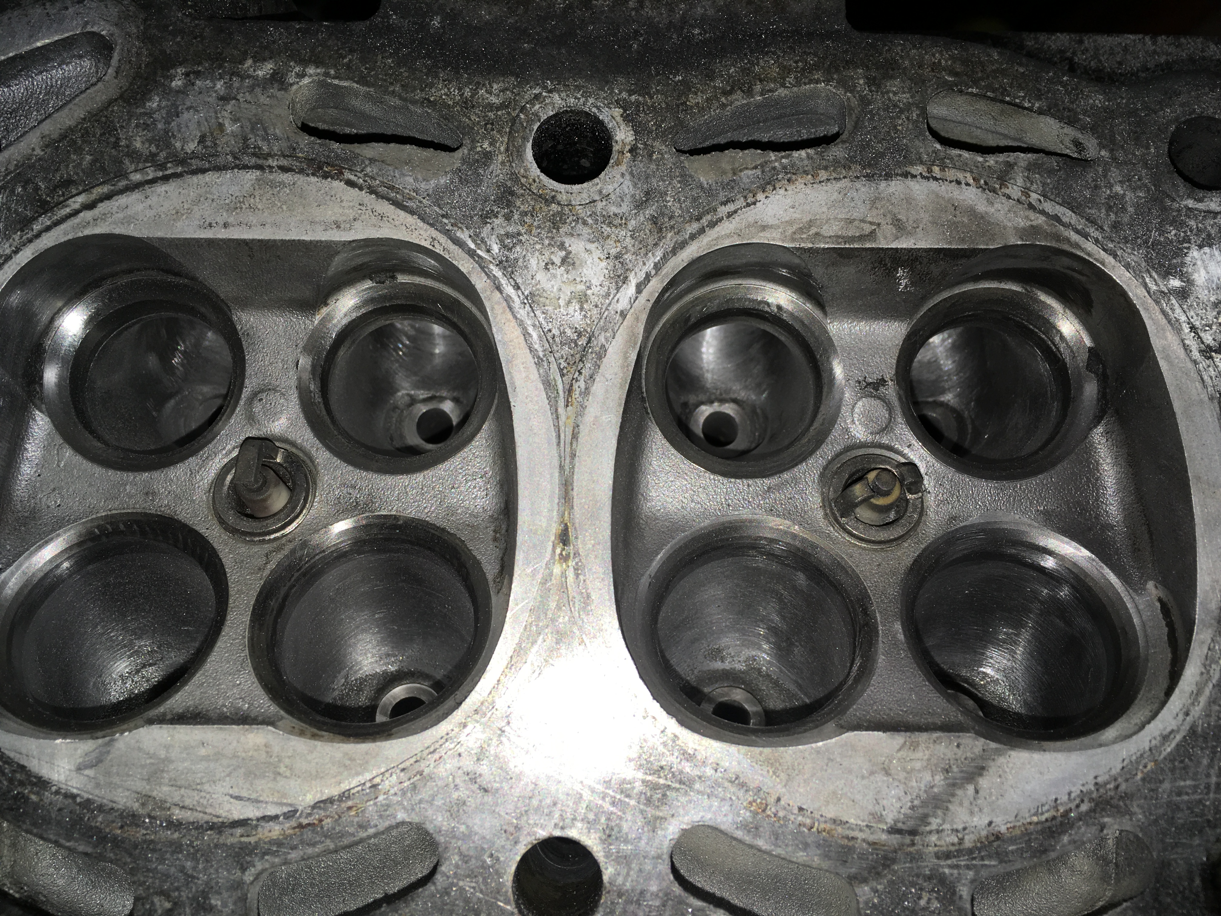

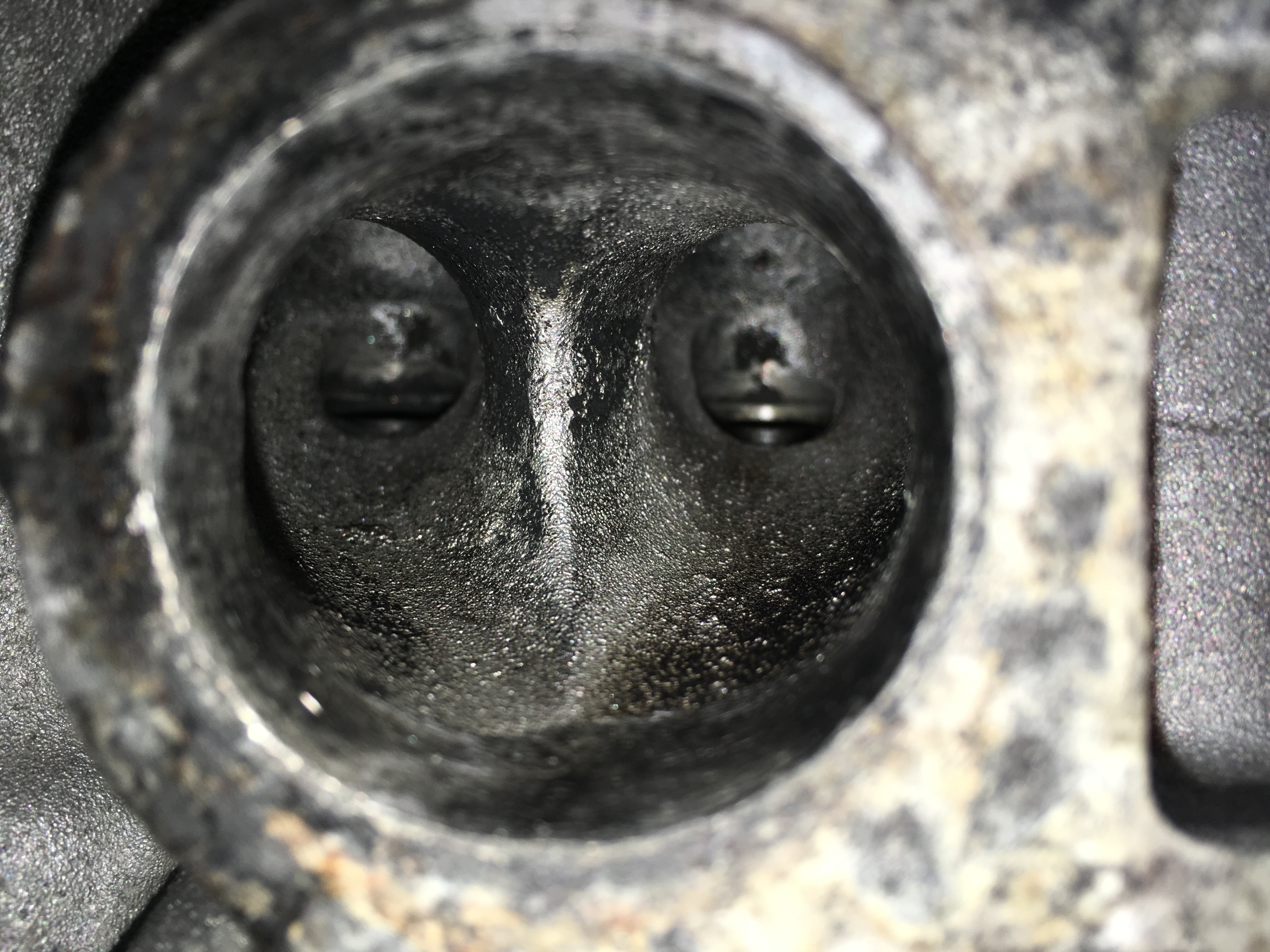

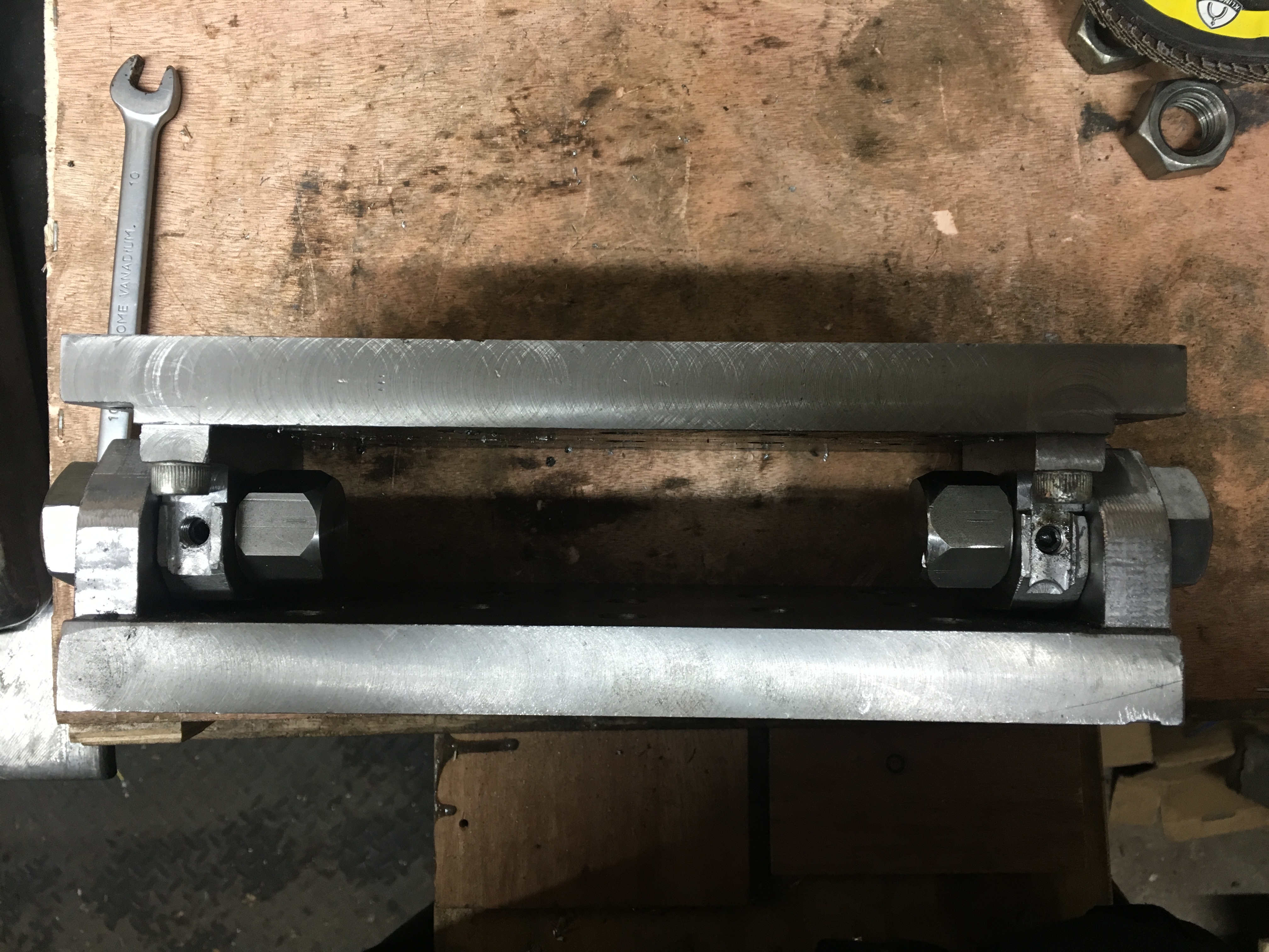

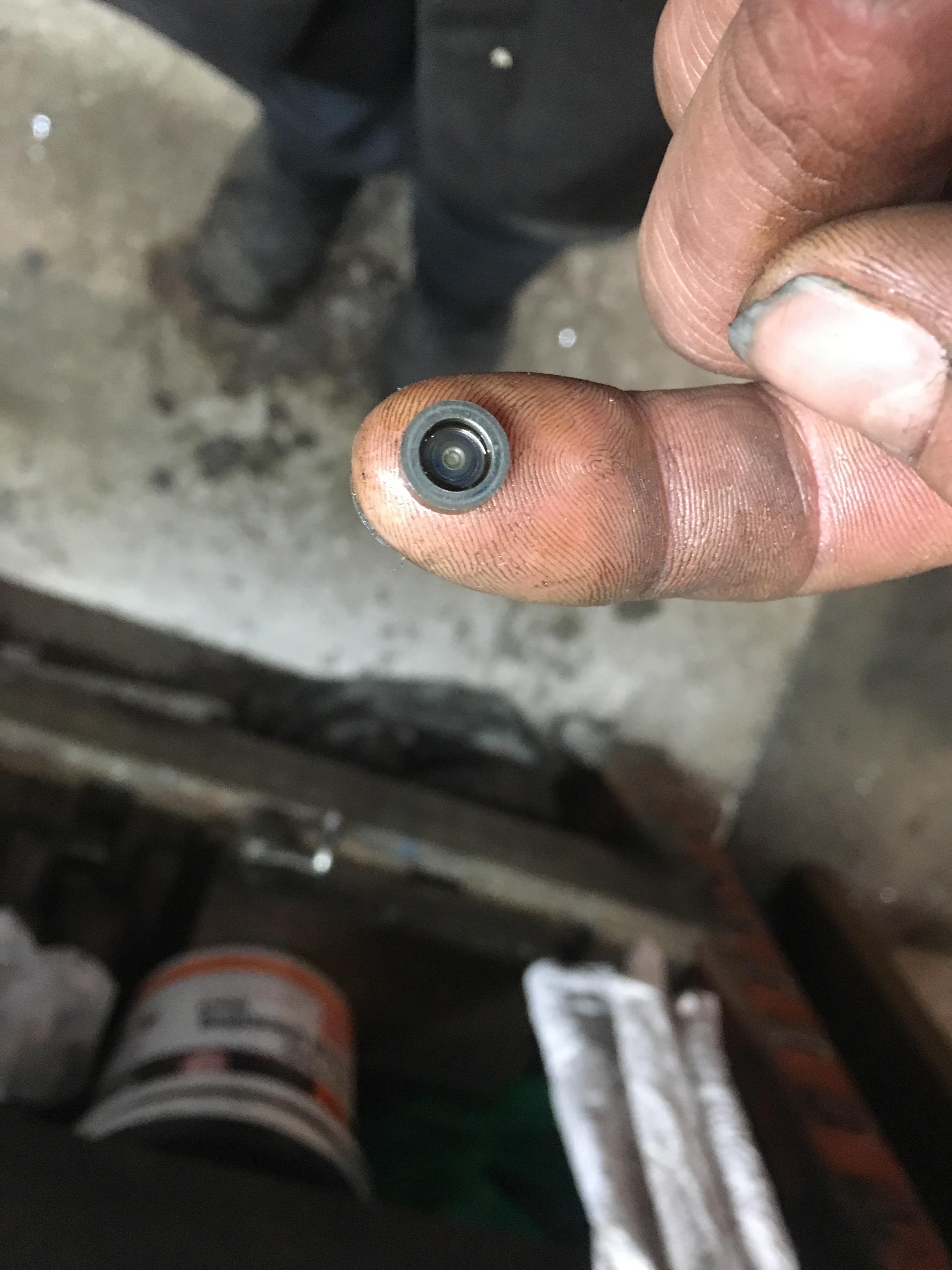

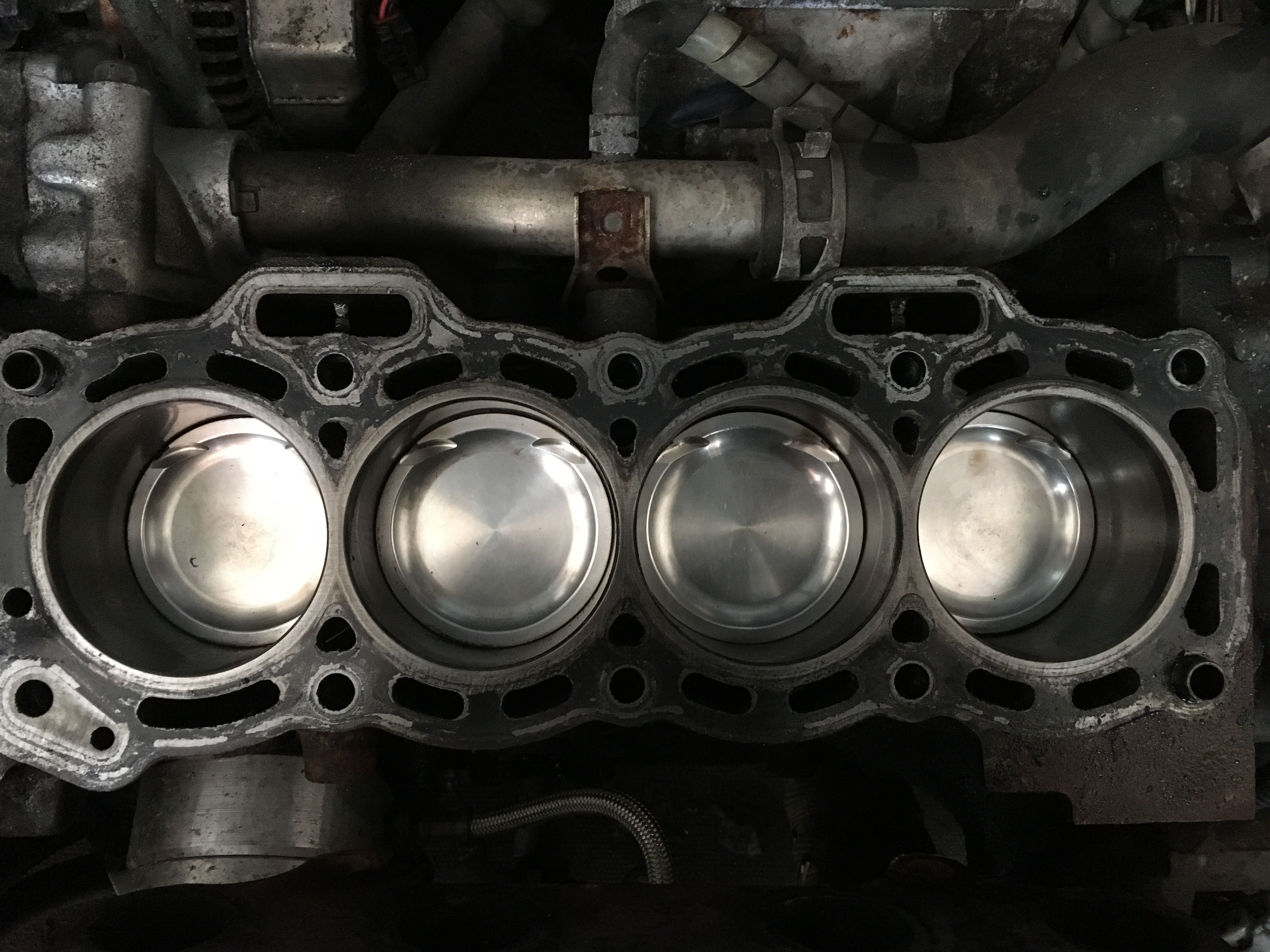

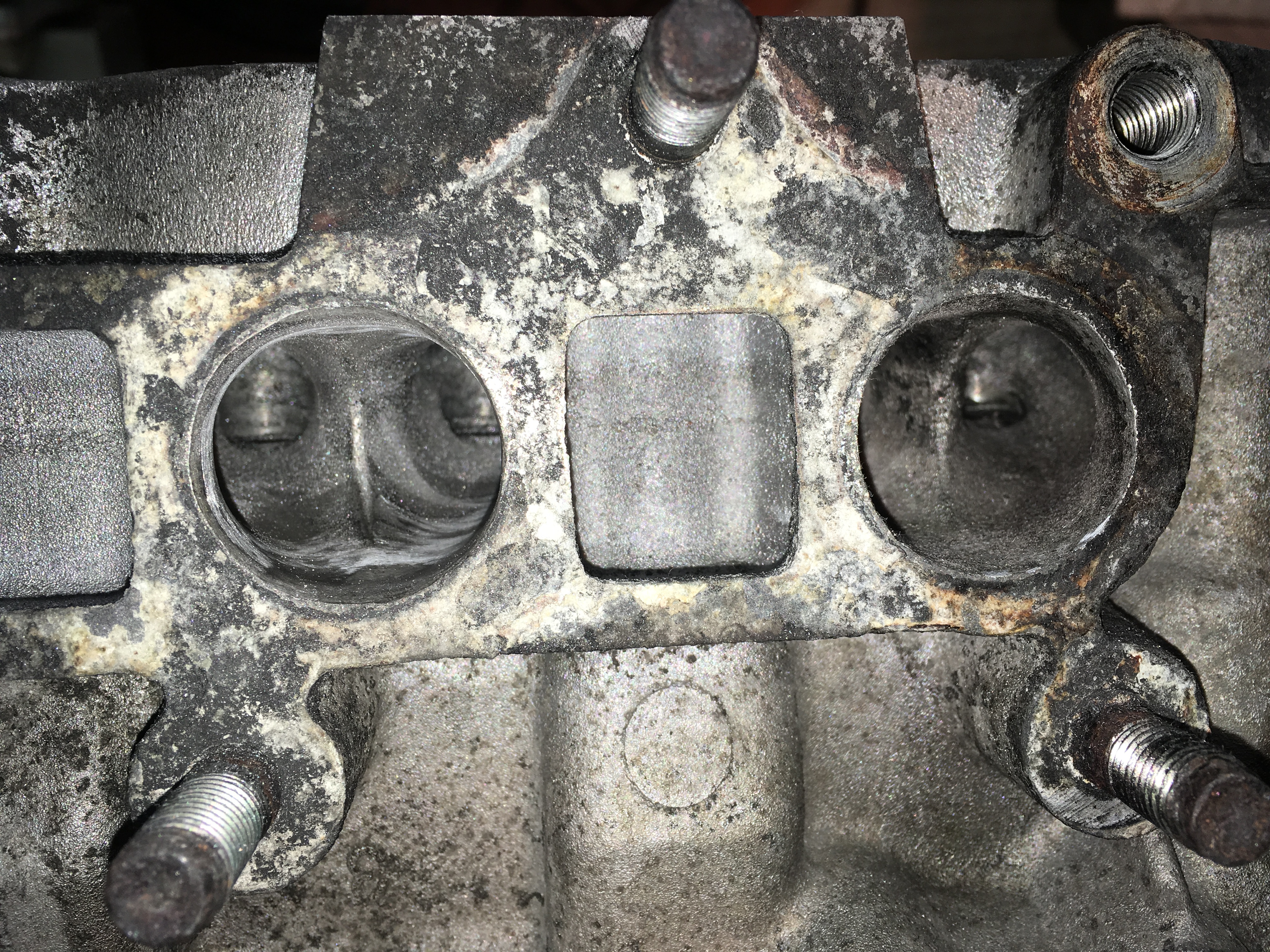

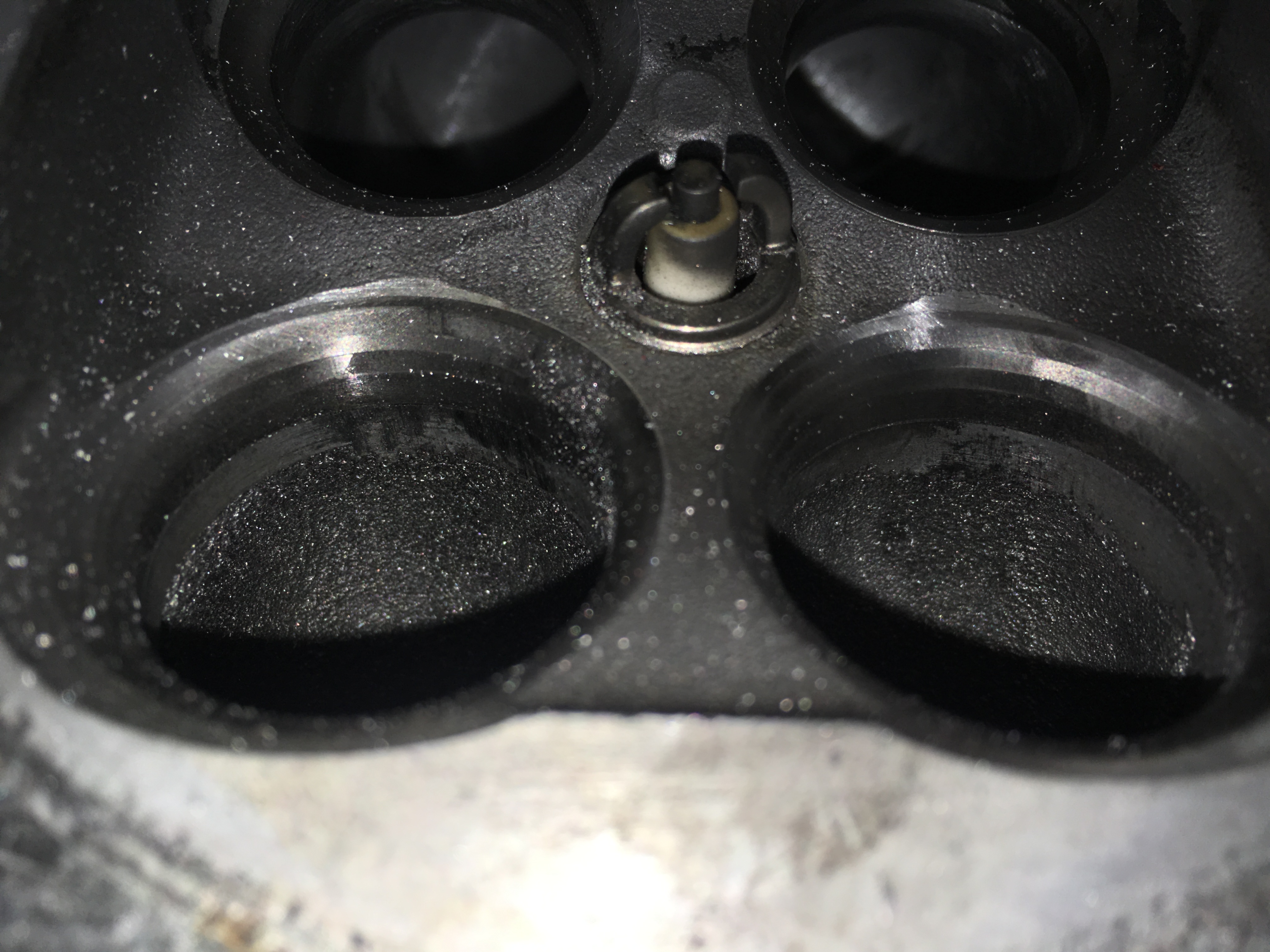

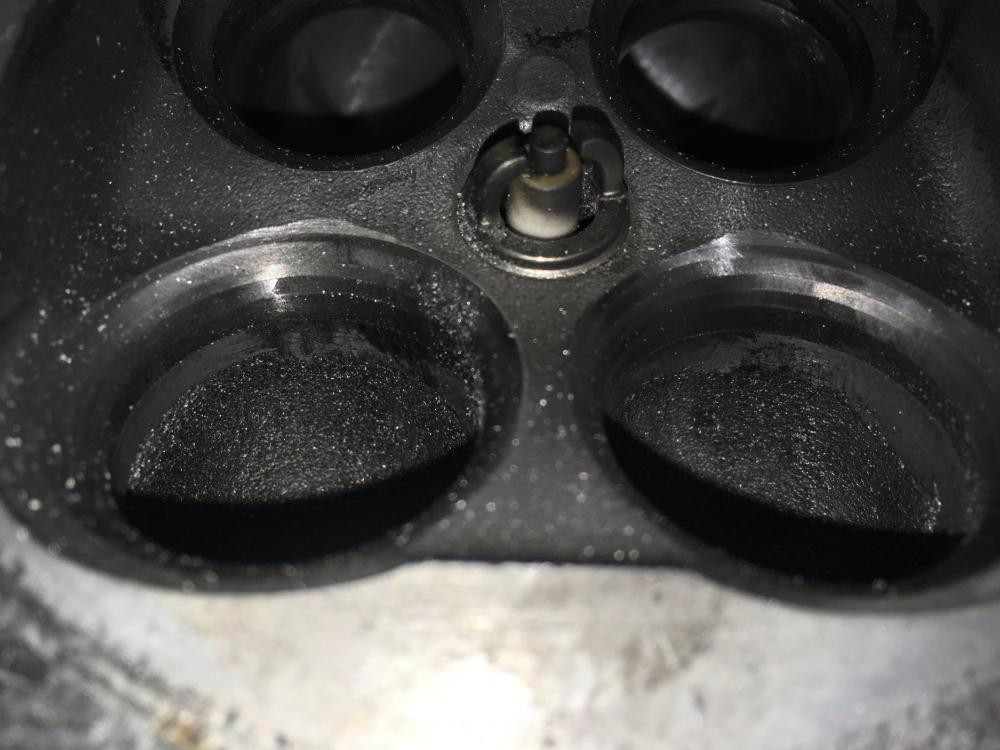

Well this is what happend! I’d been out in the SR for probably the first time in 6 months or so all was good till I was 1/2 mile from home, I gave it a boot full nice pop between gears as it does the booom It started missing! I got it home and got the compression tester out! All was spot on apart from numer 3, number 3 was showing 0! For it to have 0 I was expecting the worst! So it sat for probably 3 months without being touched, anyway I eventually pulled the head off and found nothing! Everything looked as it should be except the carbon build up, so I stripped the head down and all I could fined there was carbon deposits on the vavle face and seat. So I took the head to work and put it in the parts wash we have, unknown to me someone had filled it with concrete cleaner! So that was the end of the head it wrecked all the cam carrier faceses and anything that should have been a machined face!

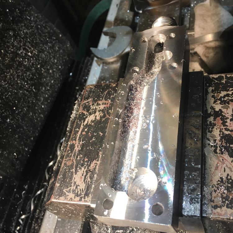

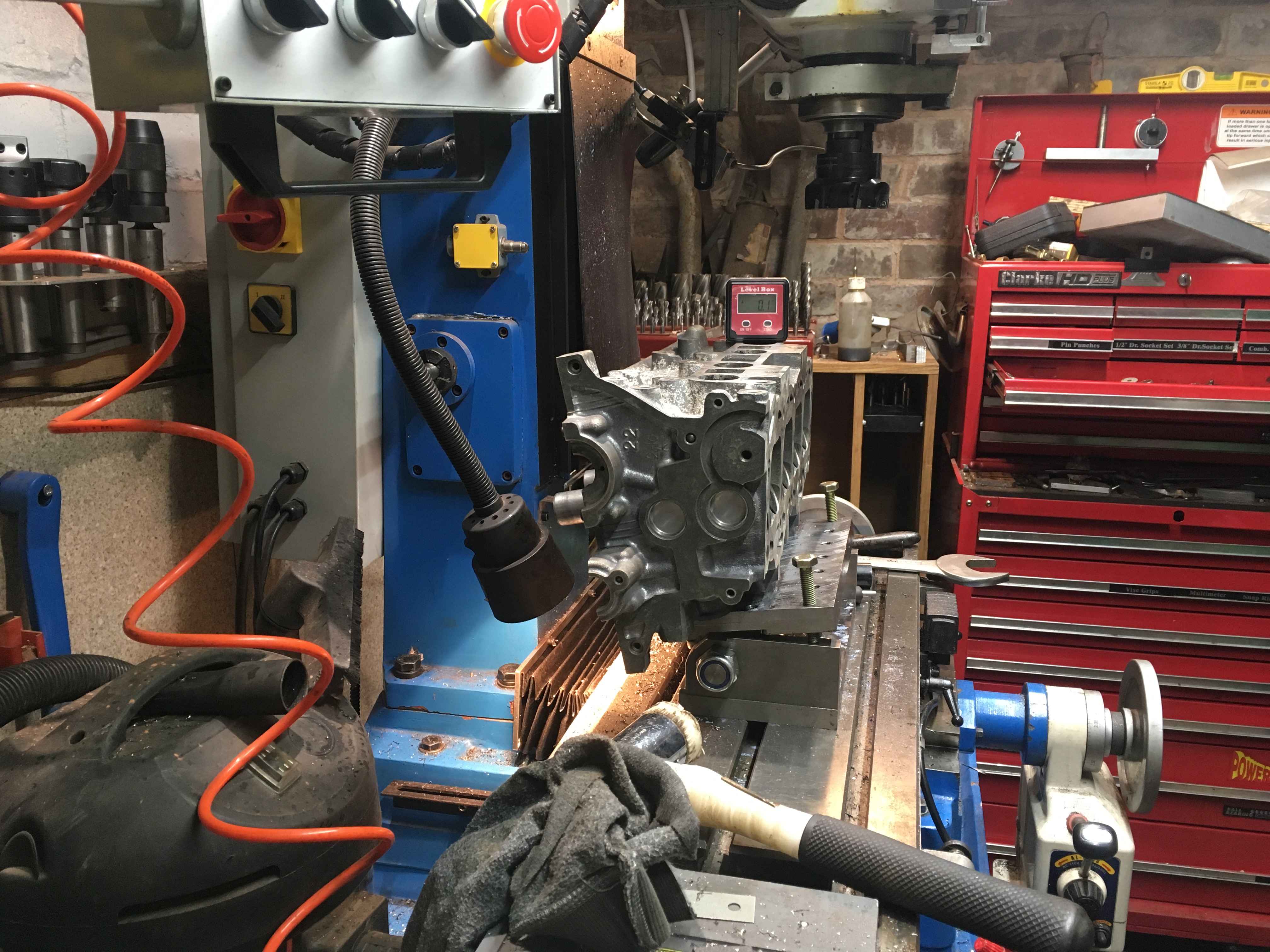

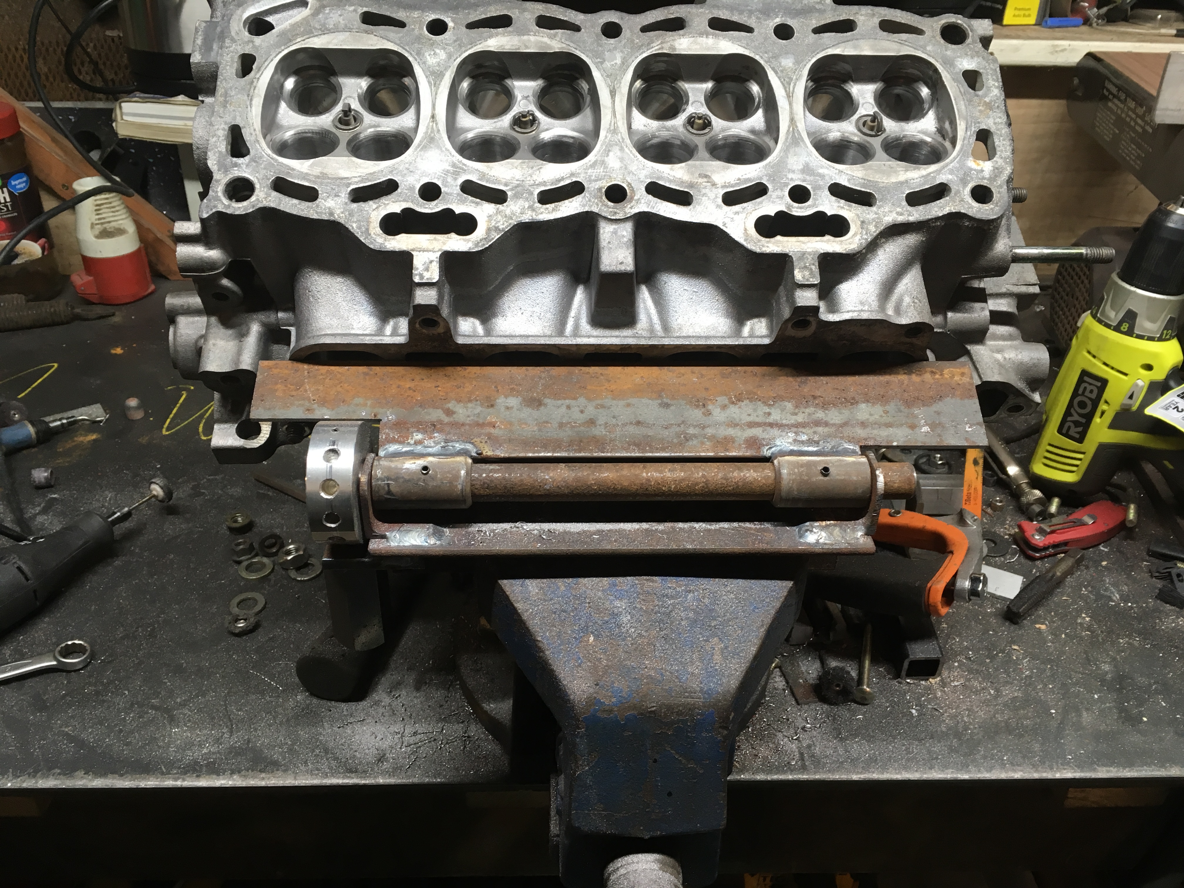

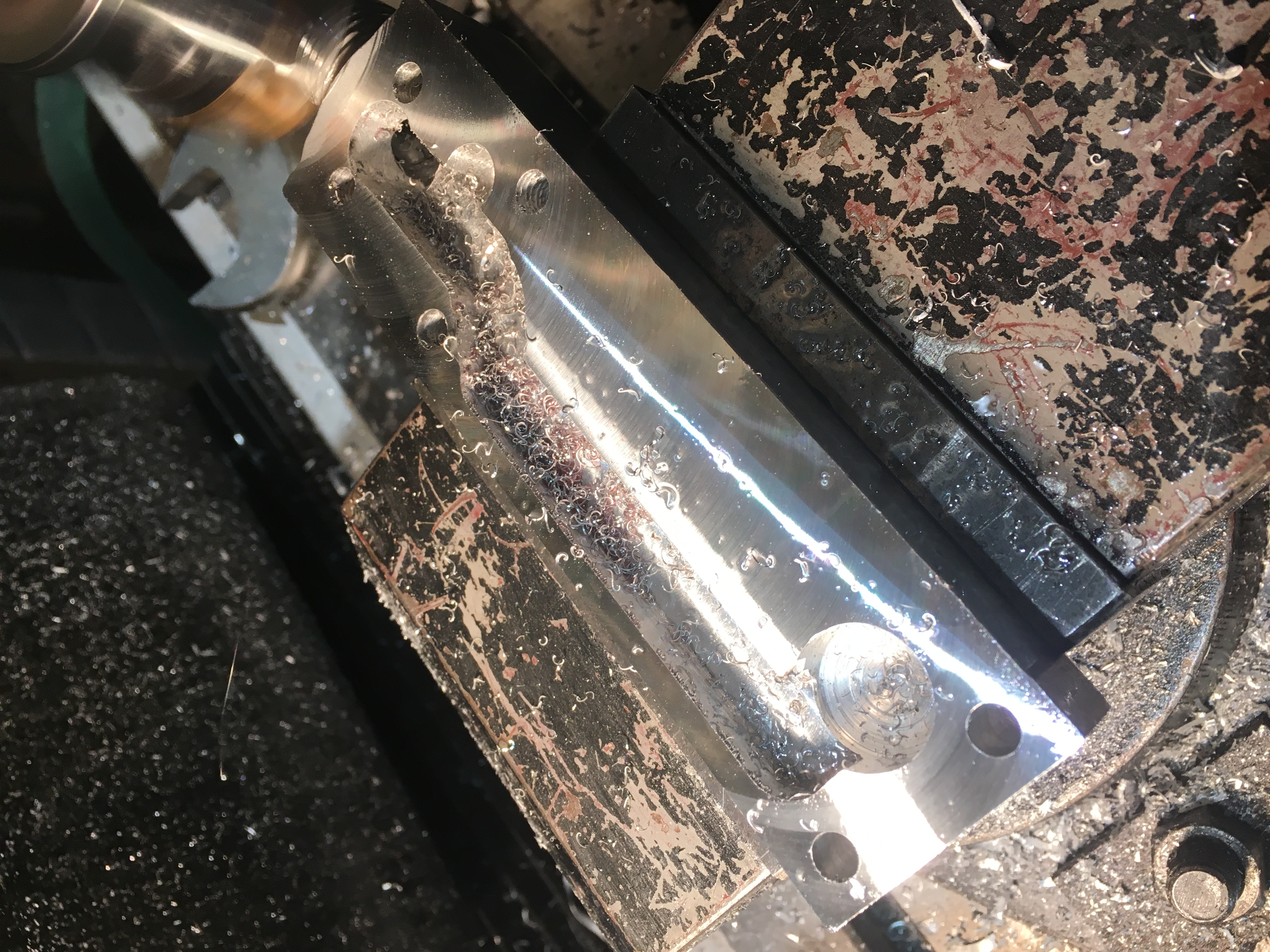

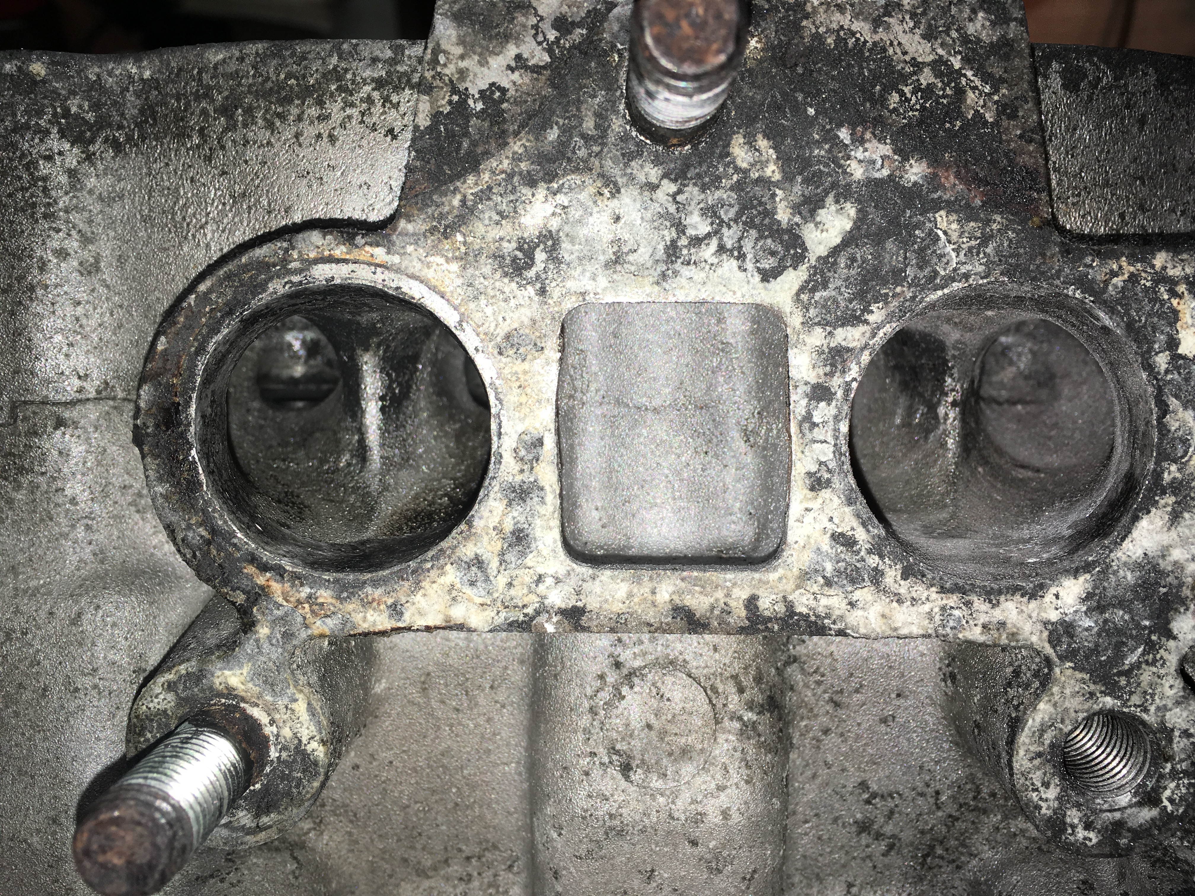

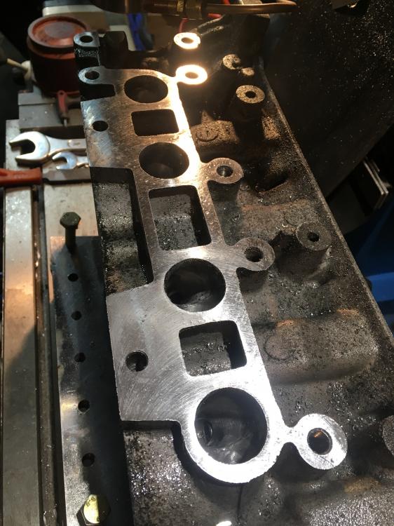

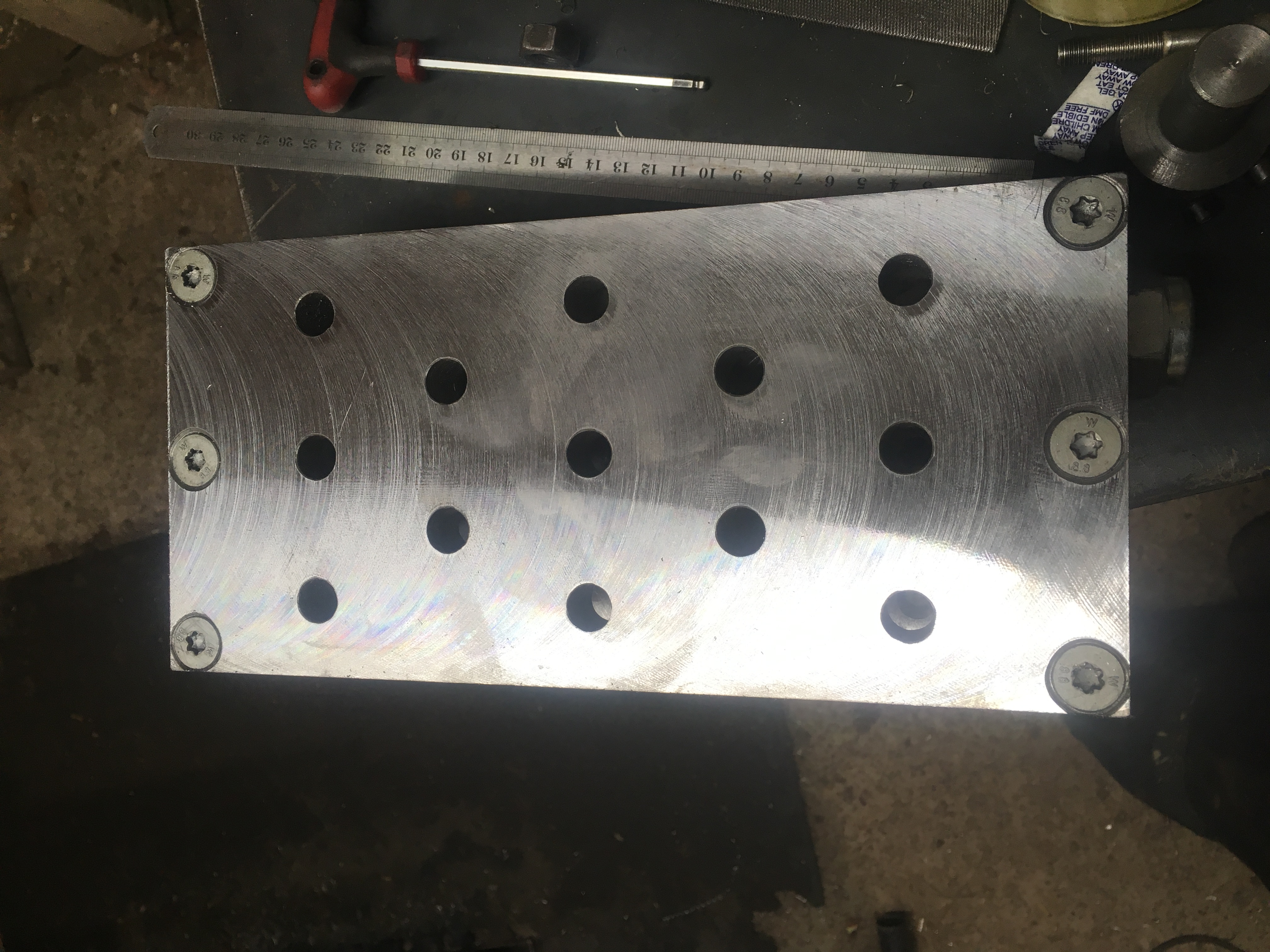

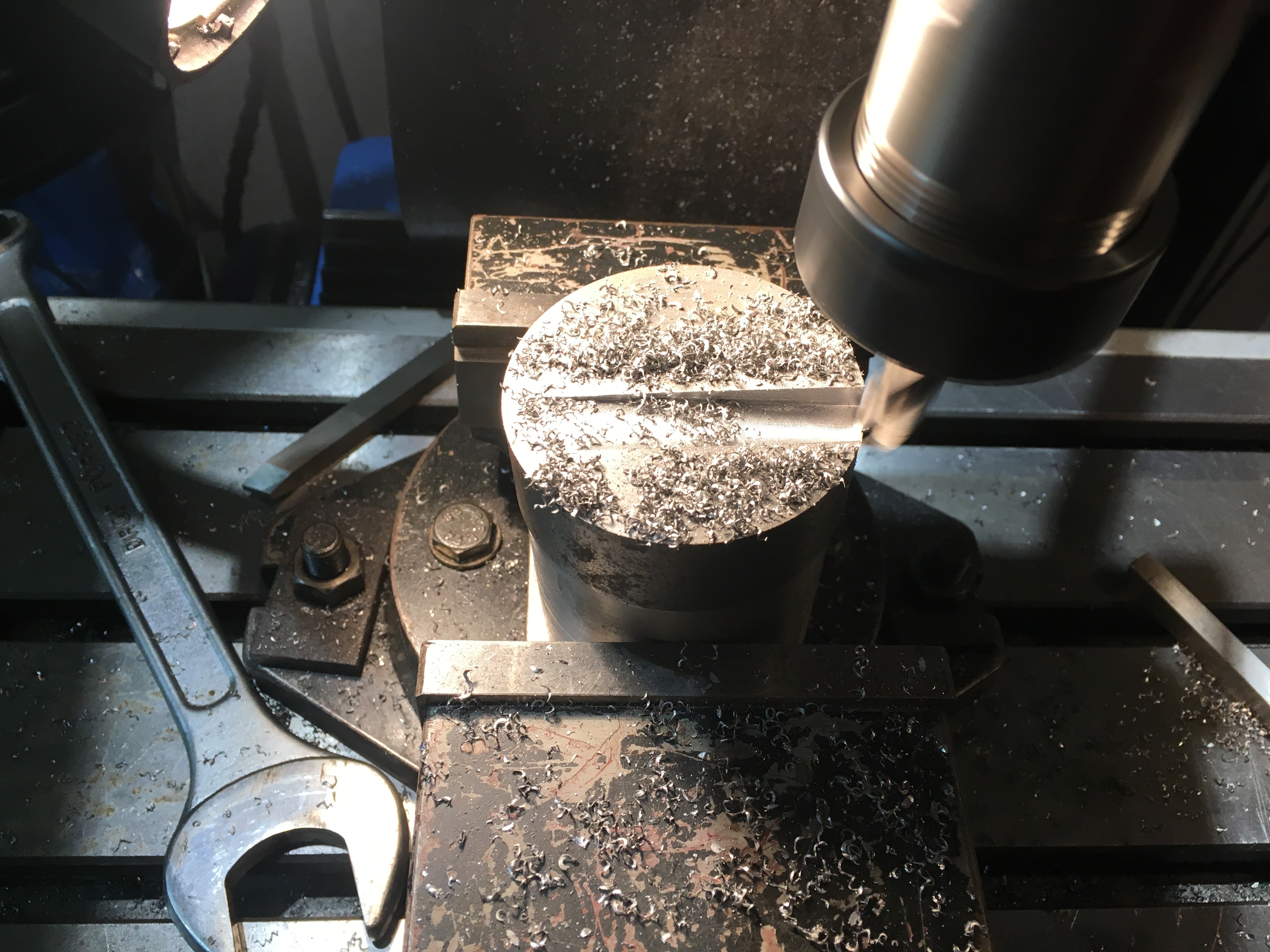

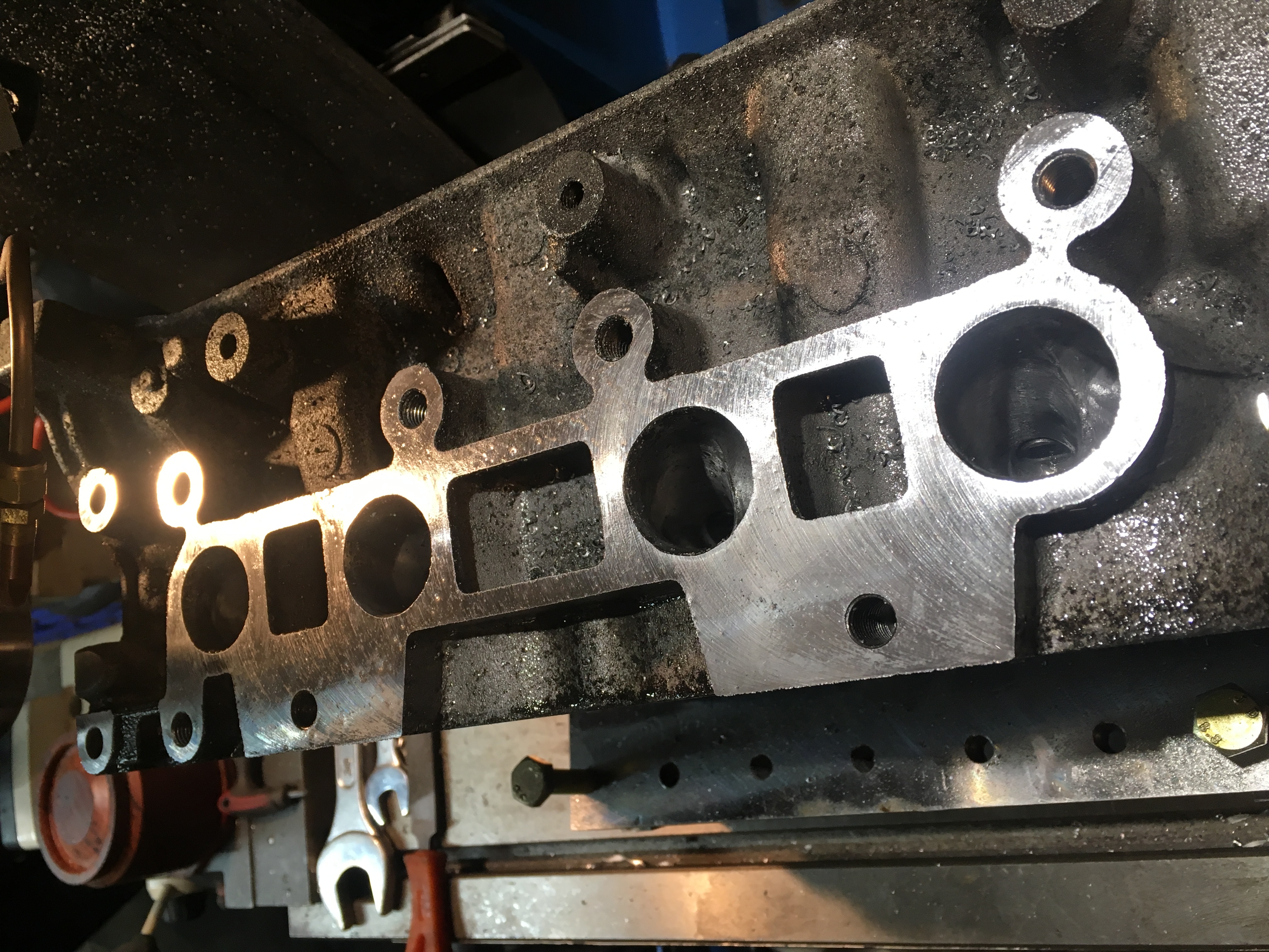

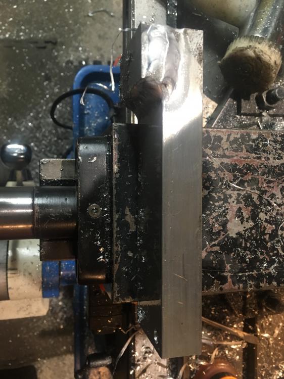

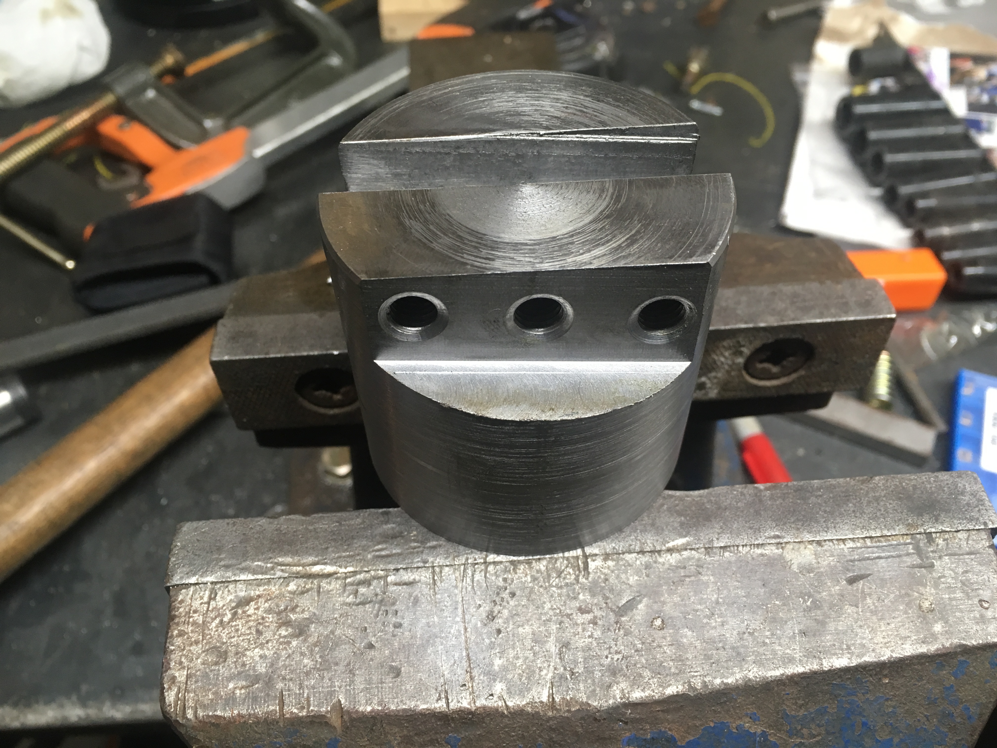

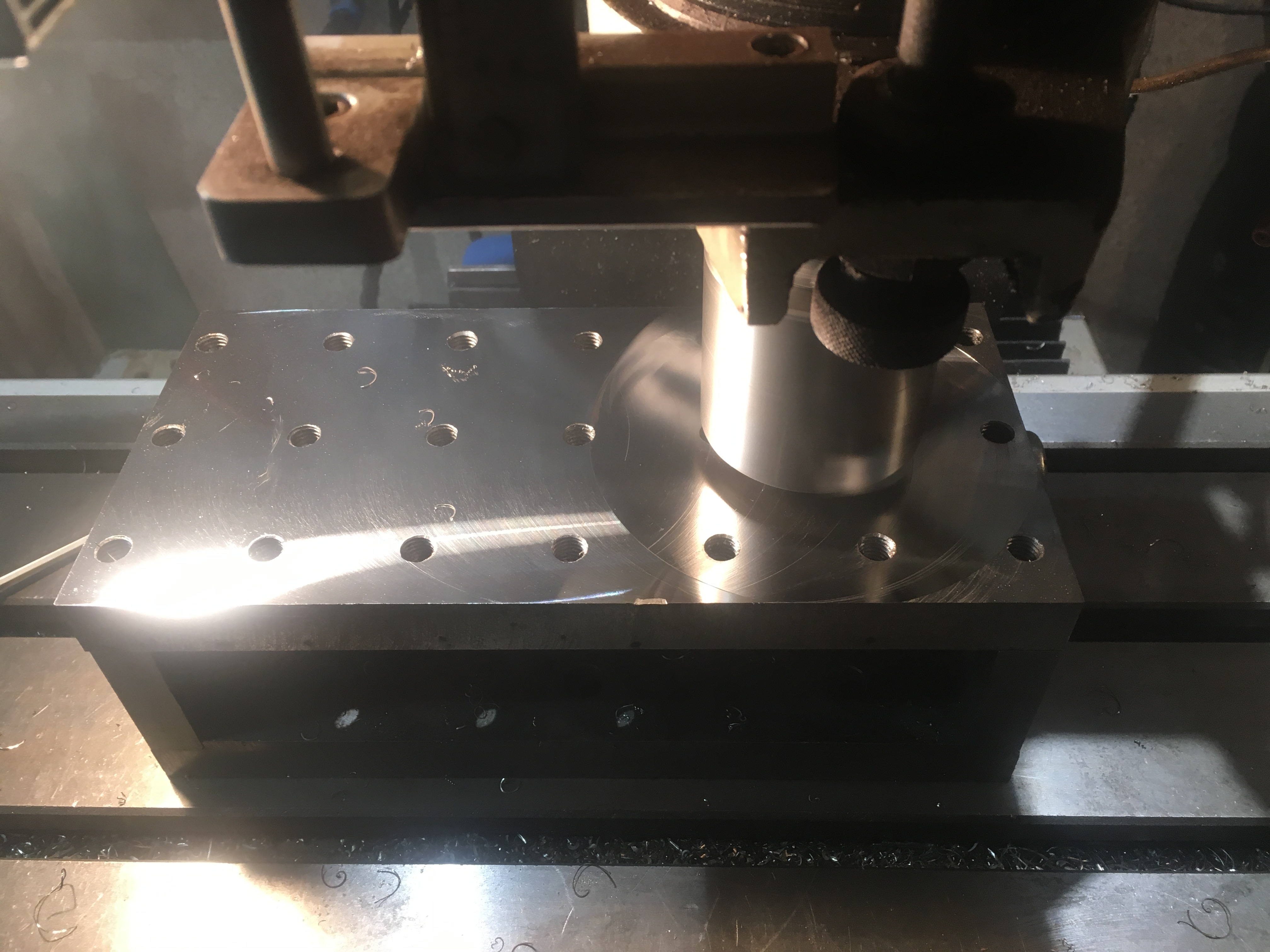

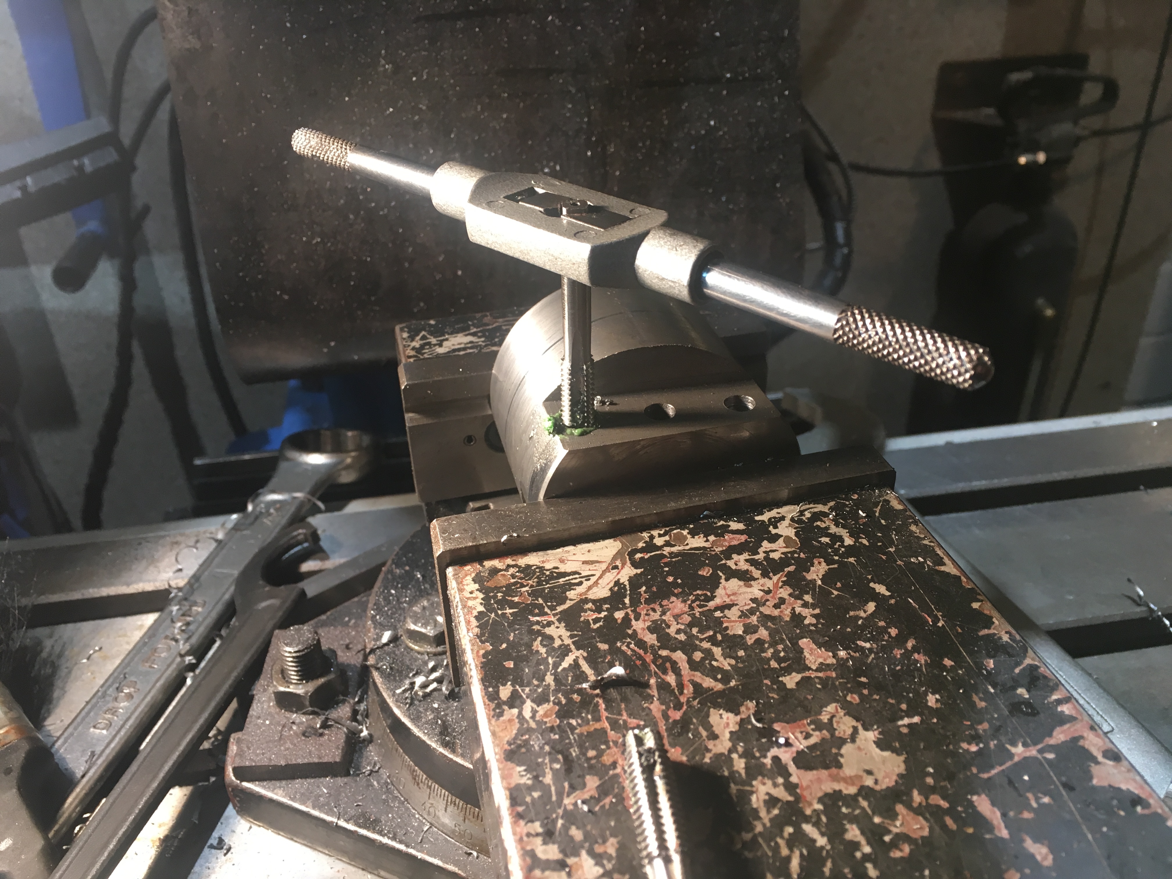

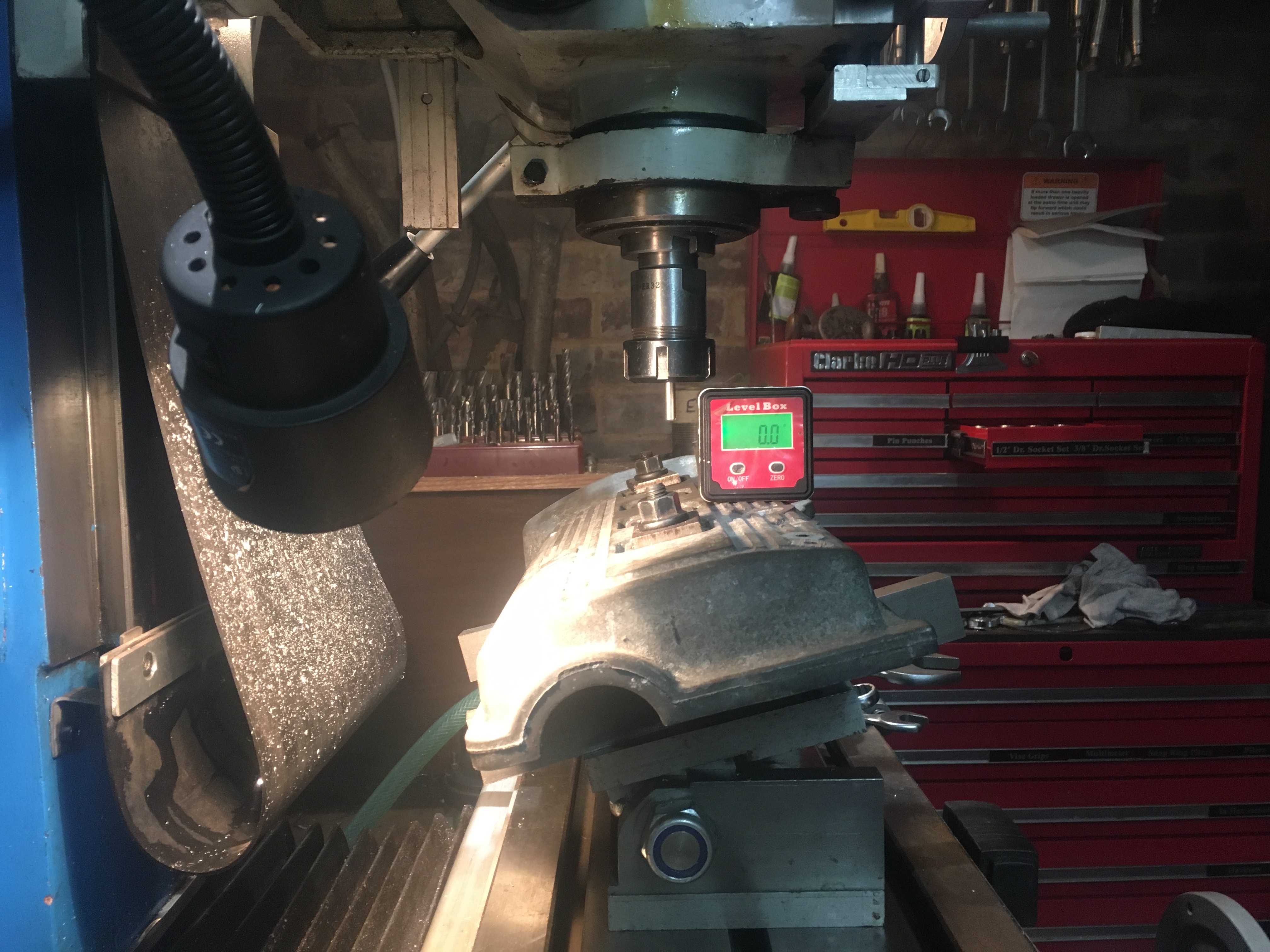

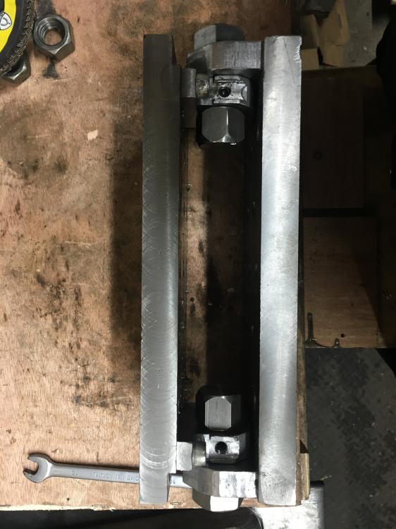

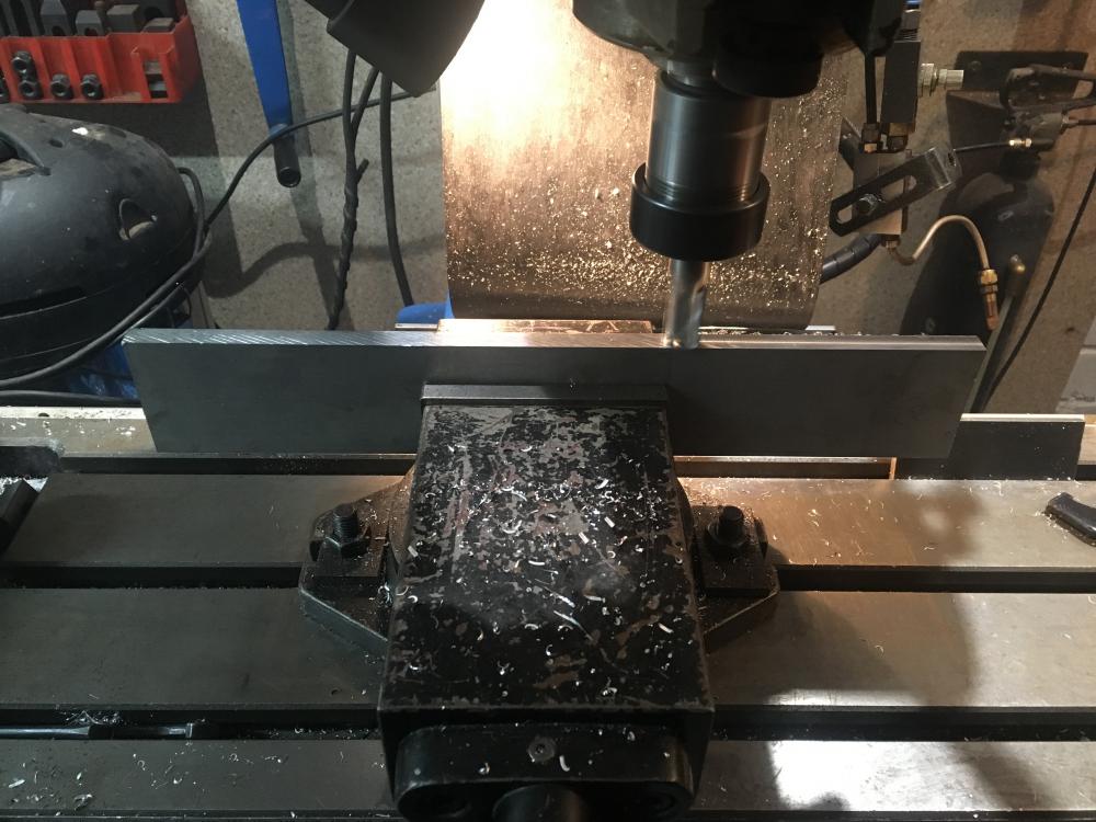

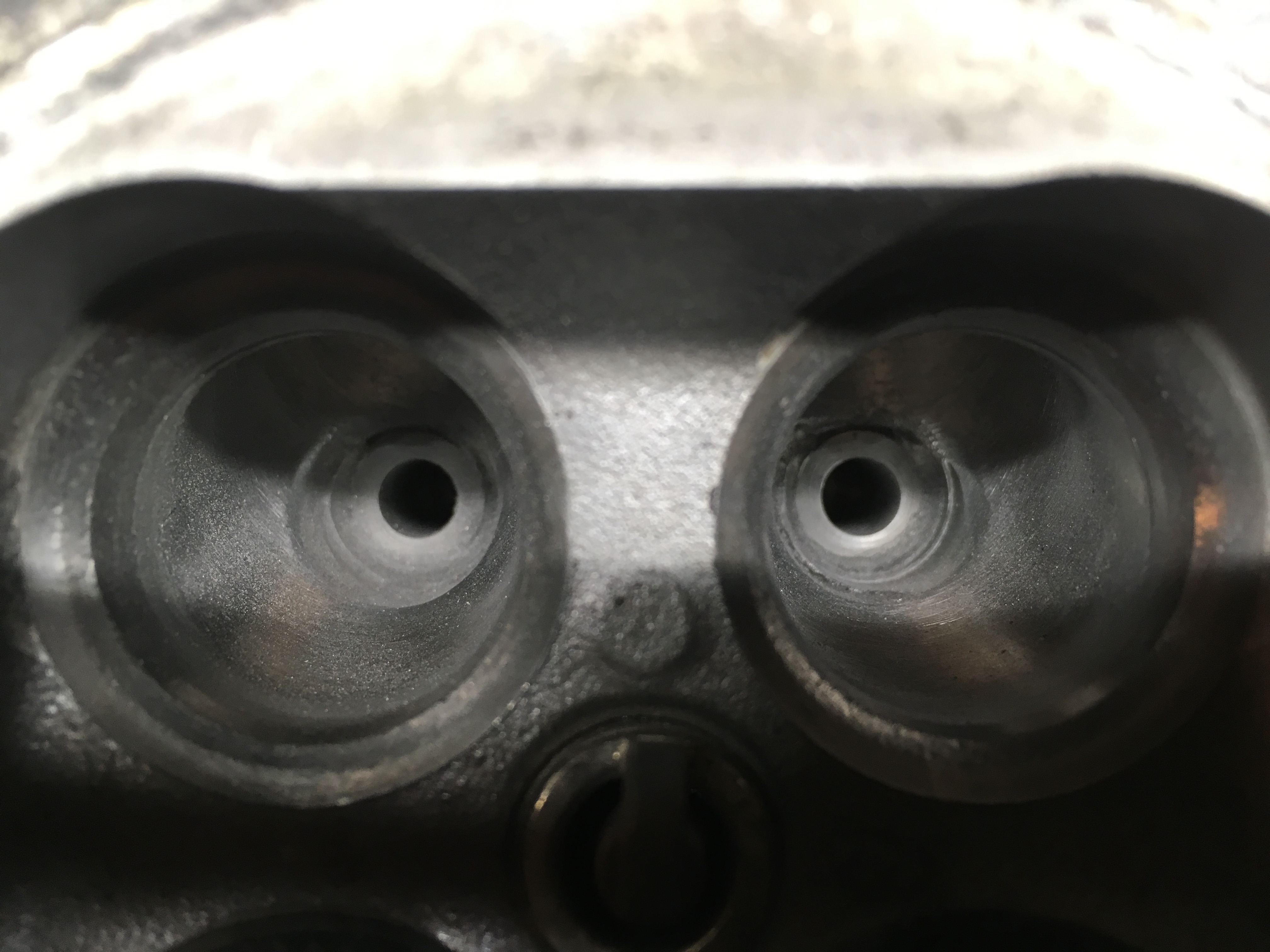

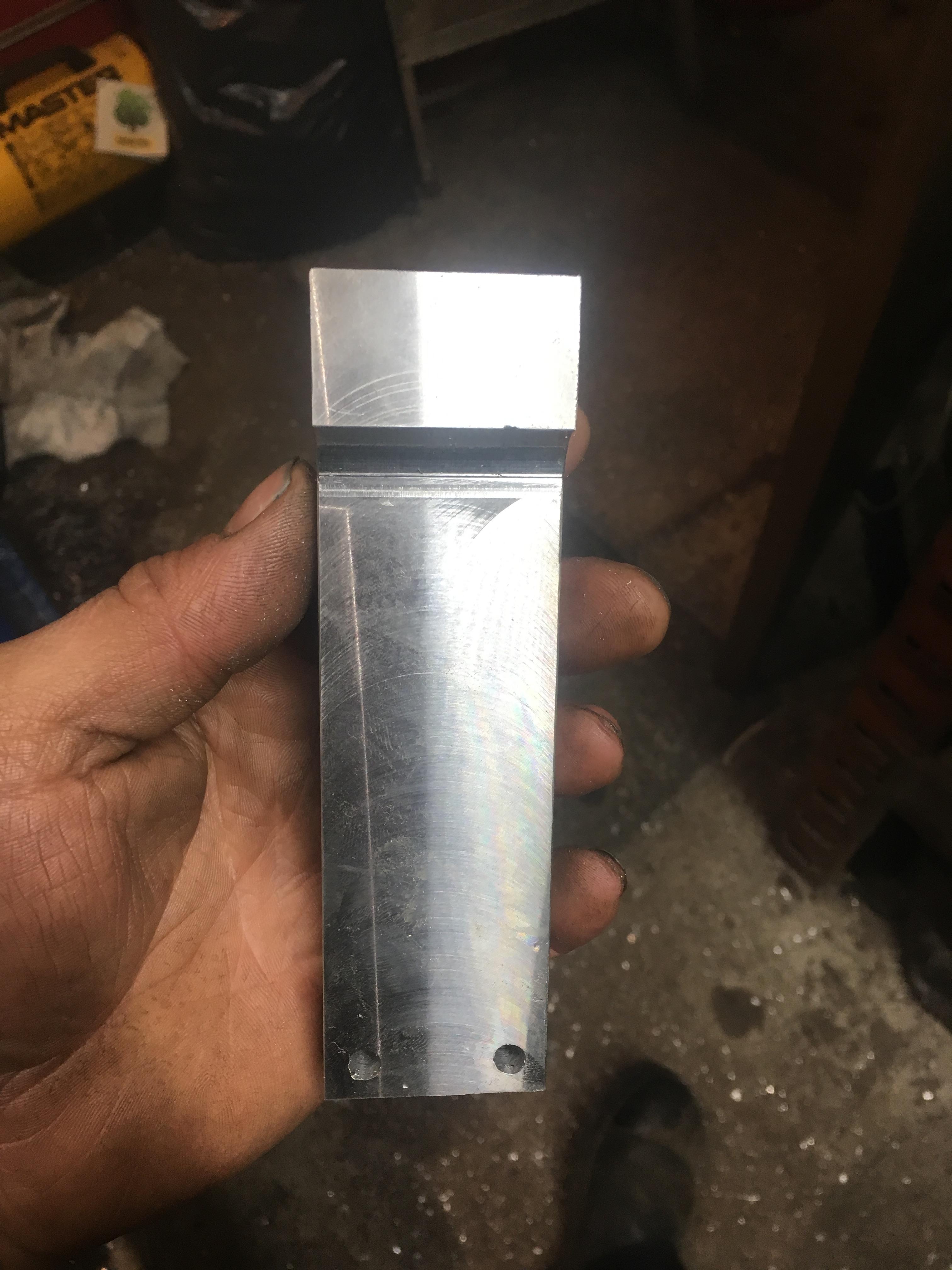

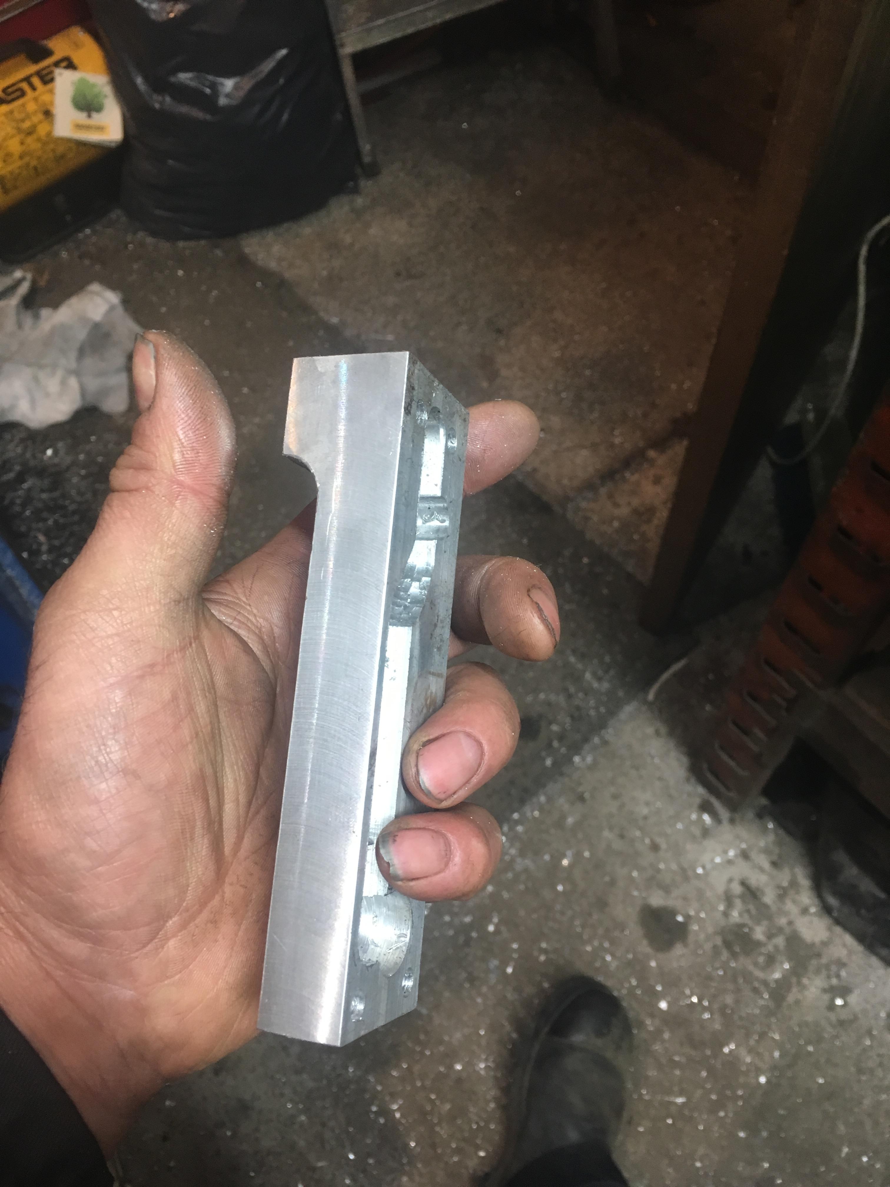

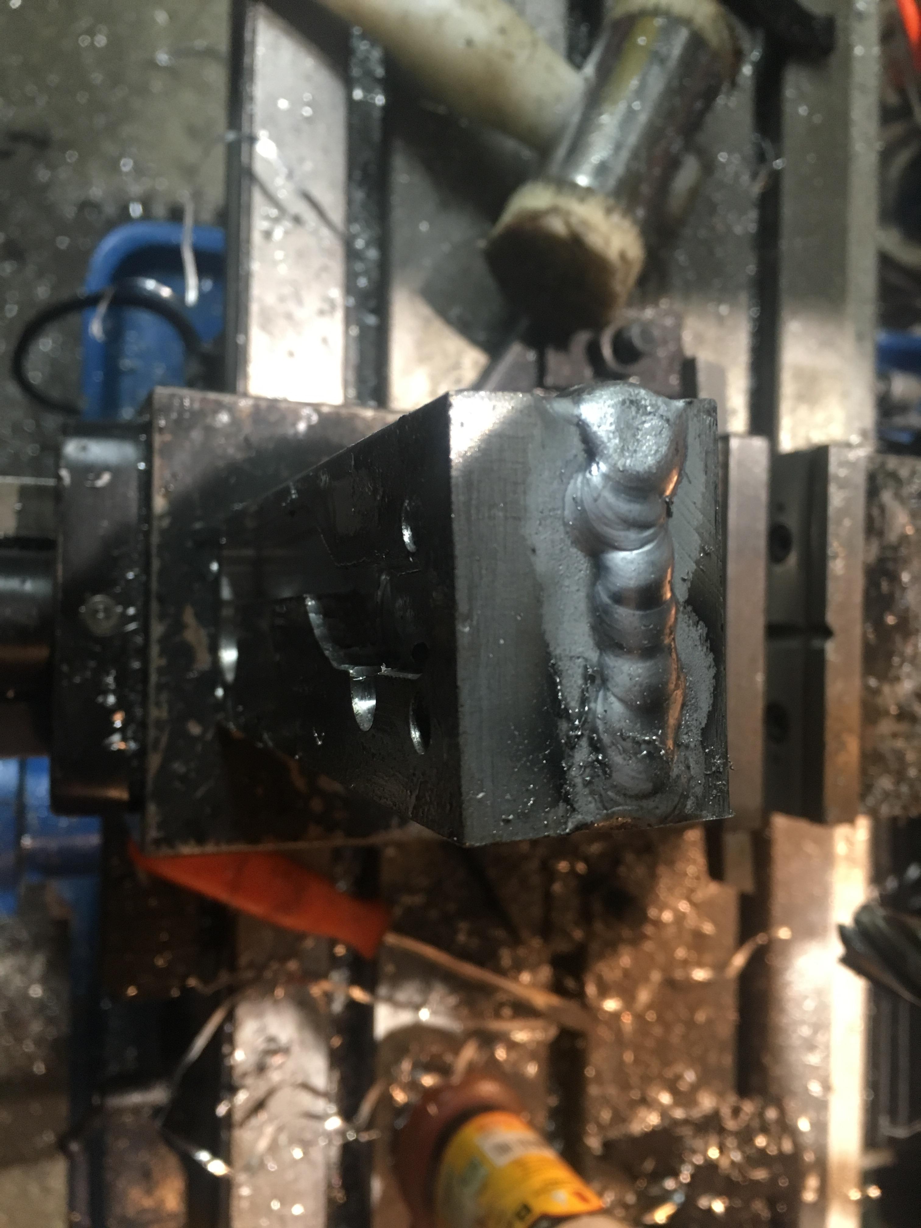

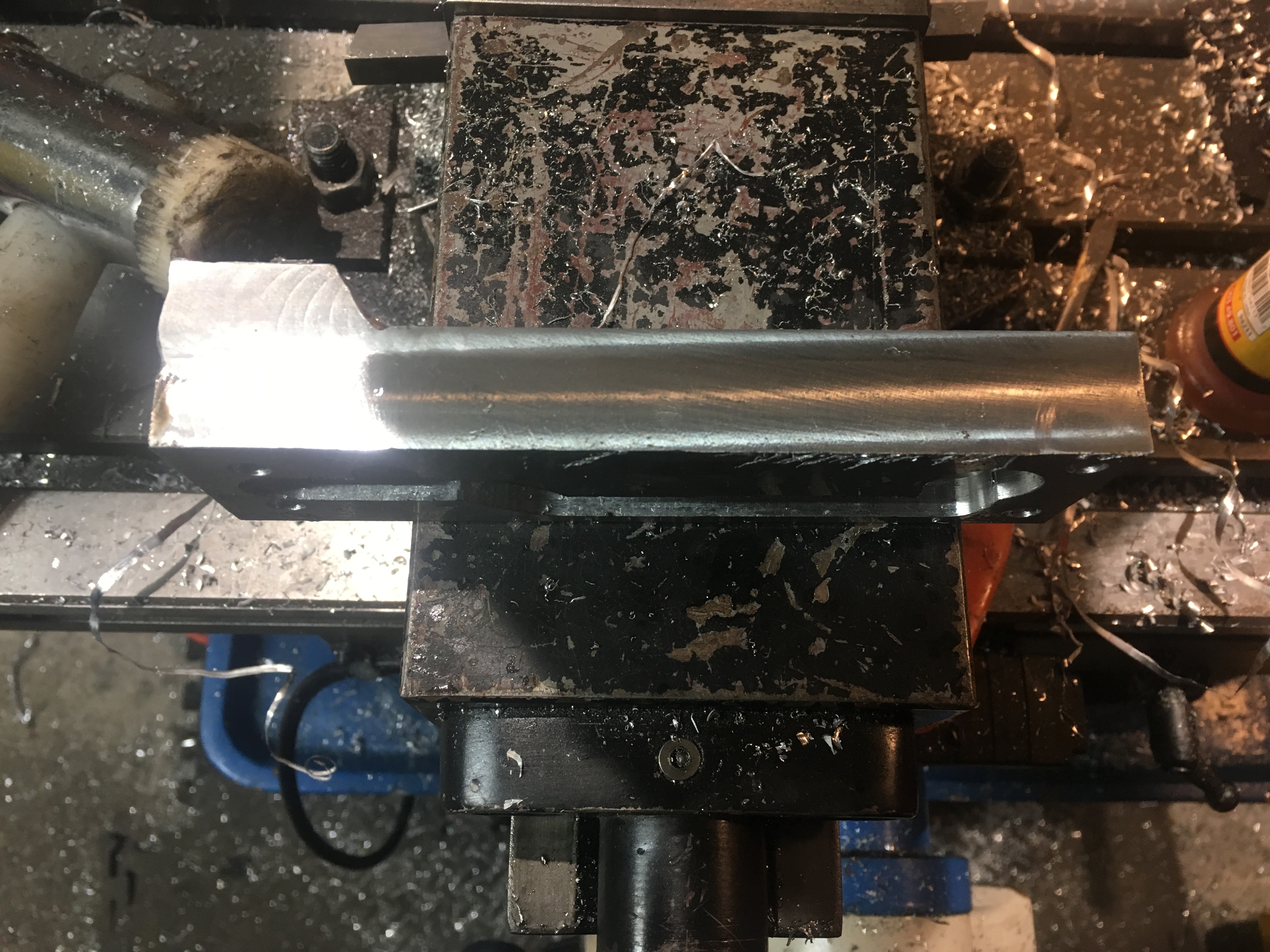

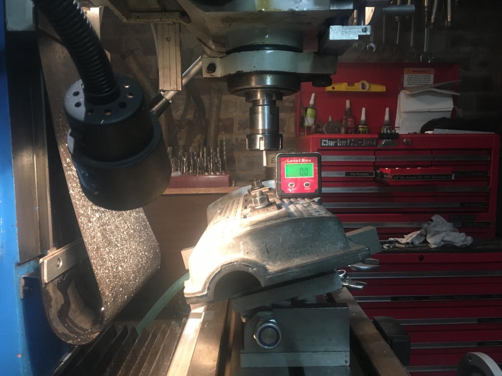

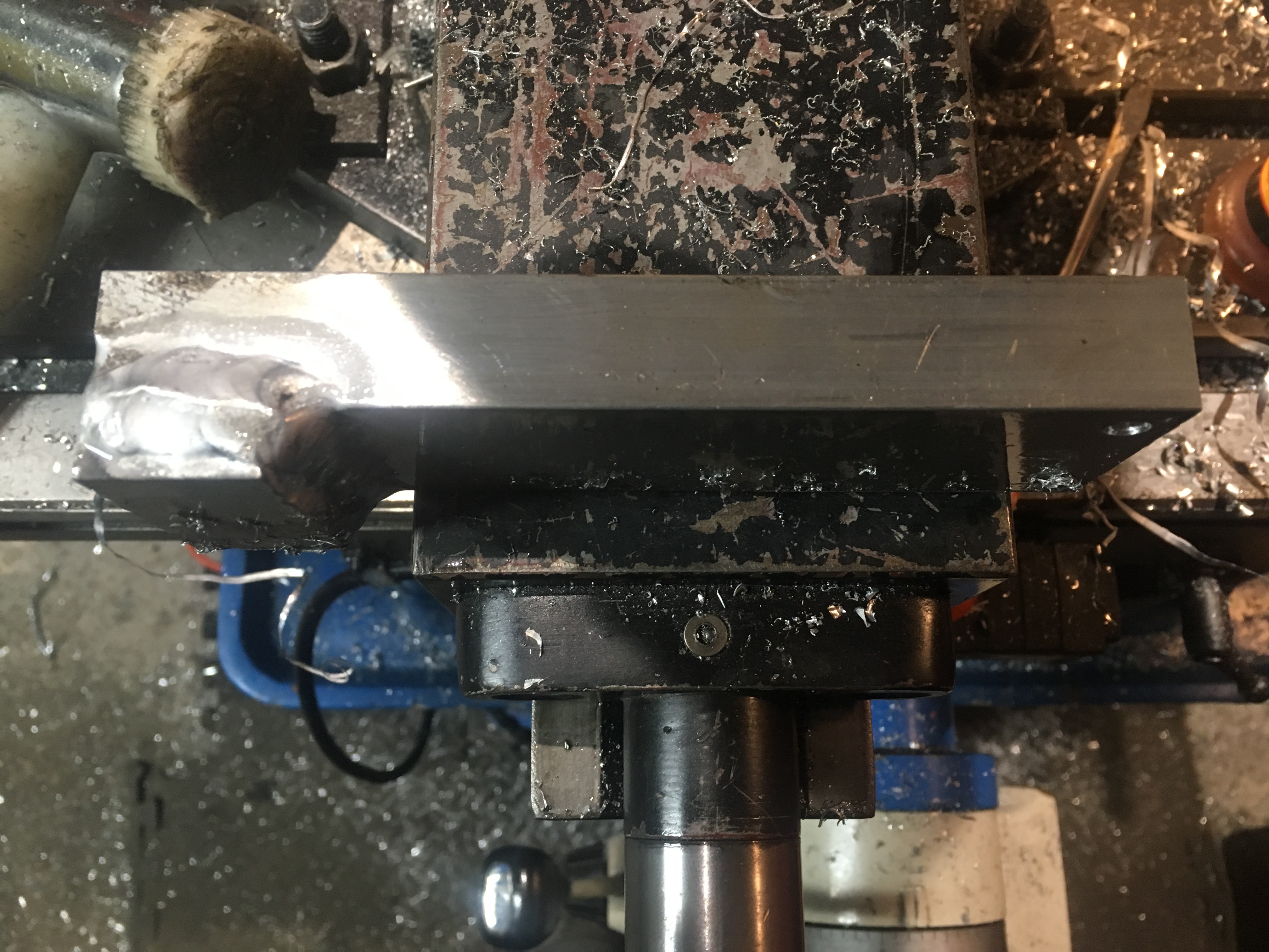

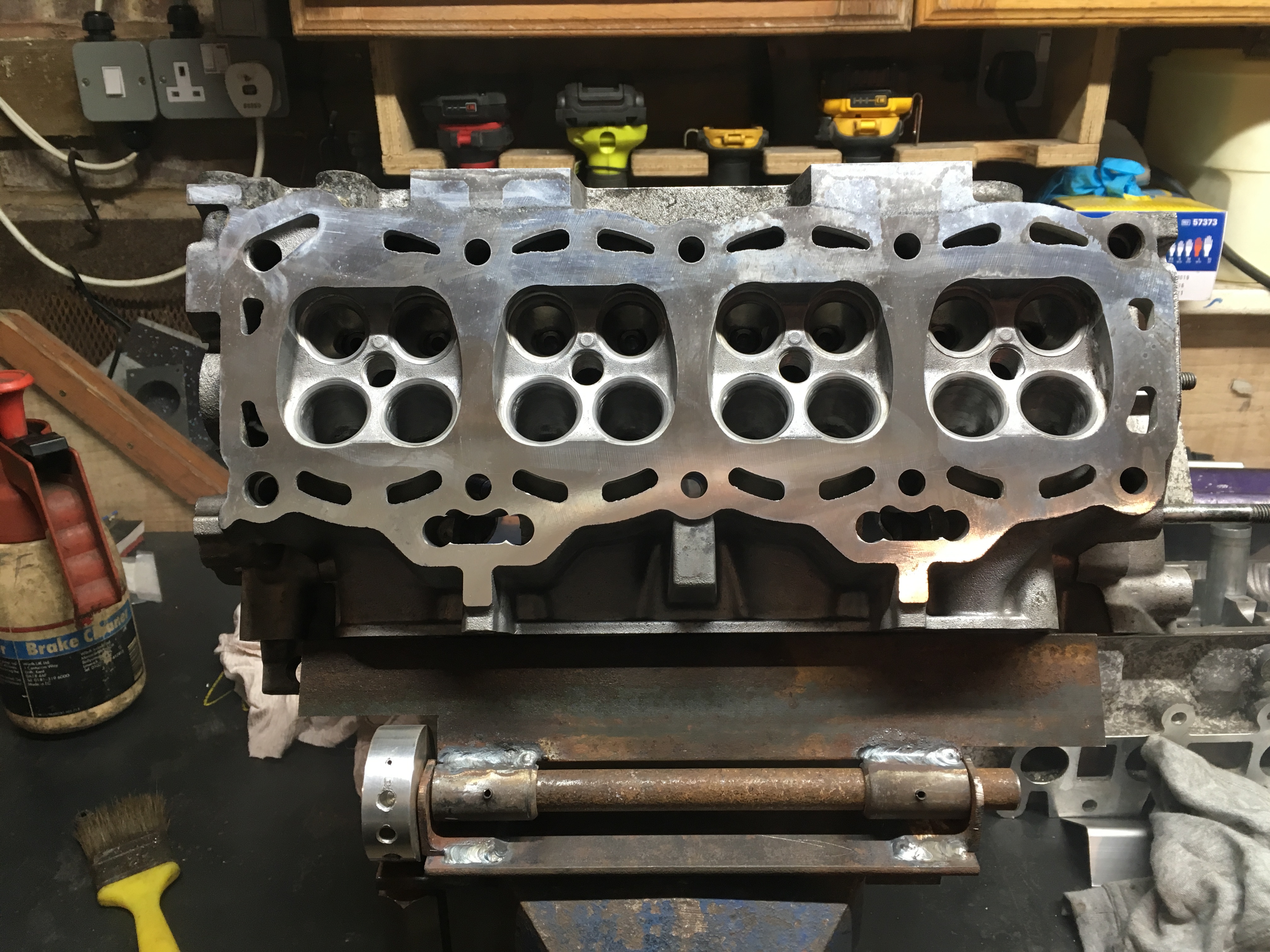

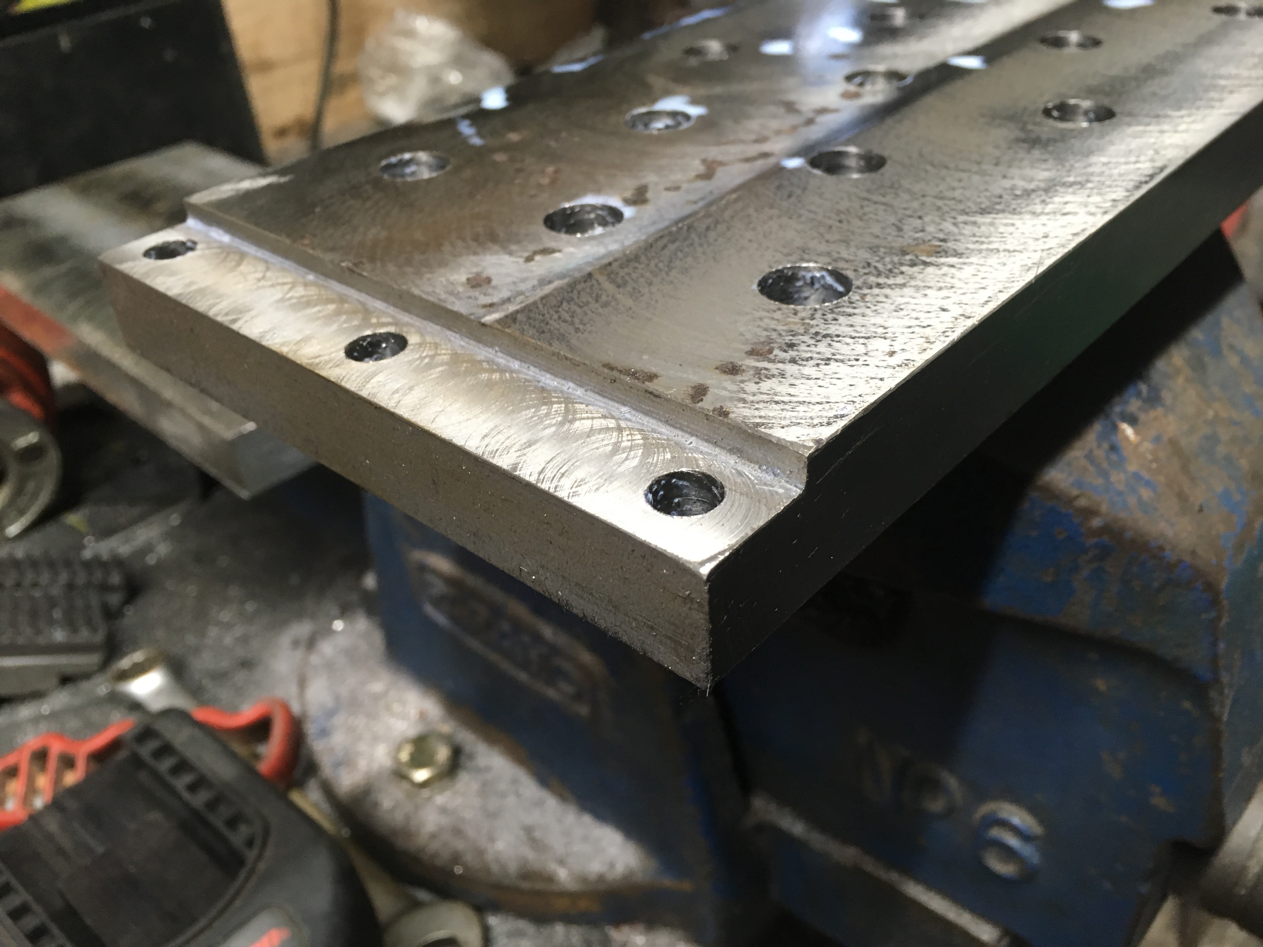

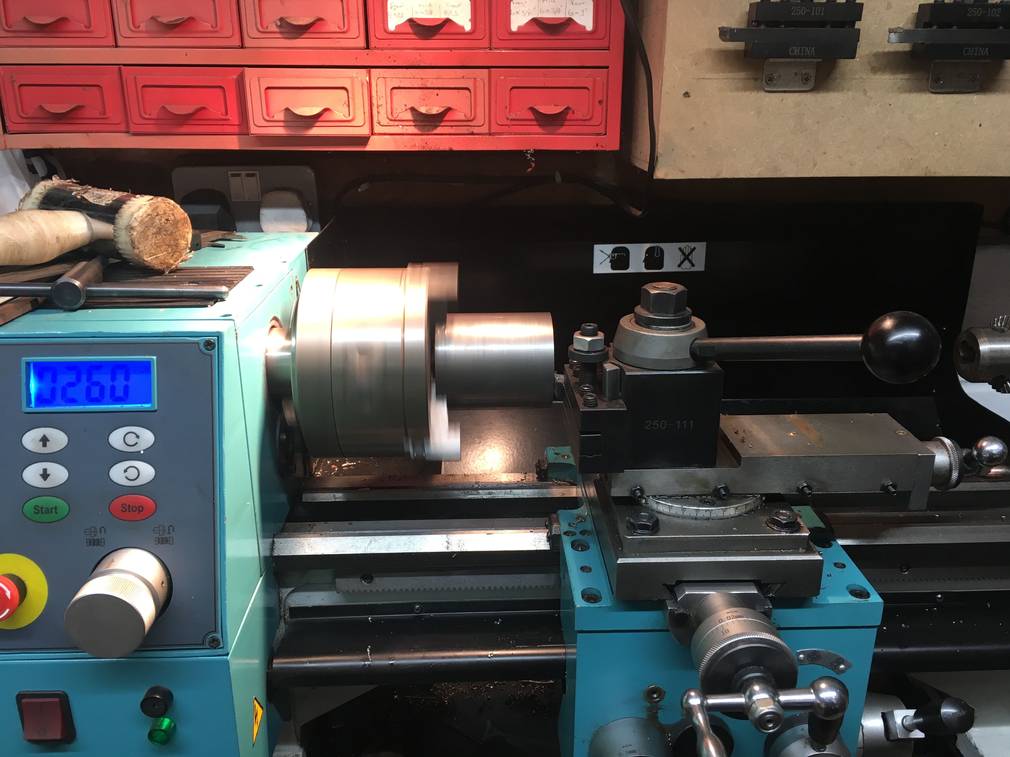

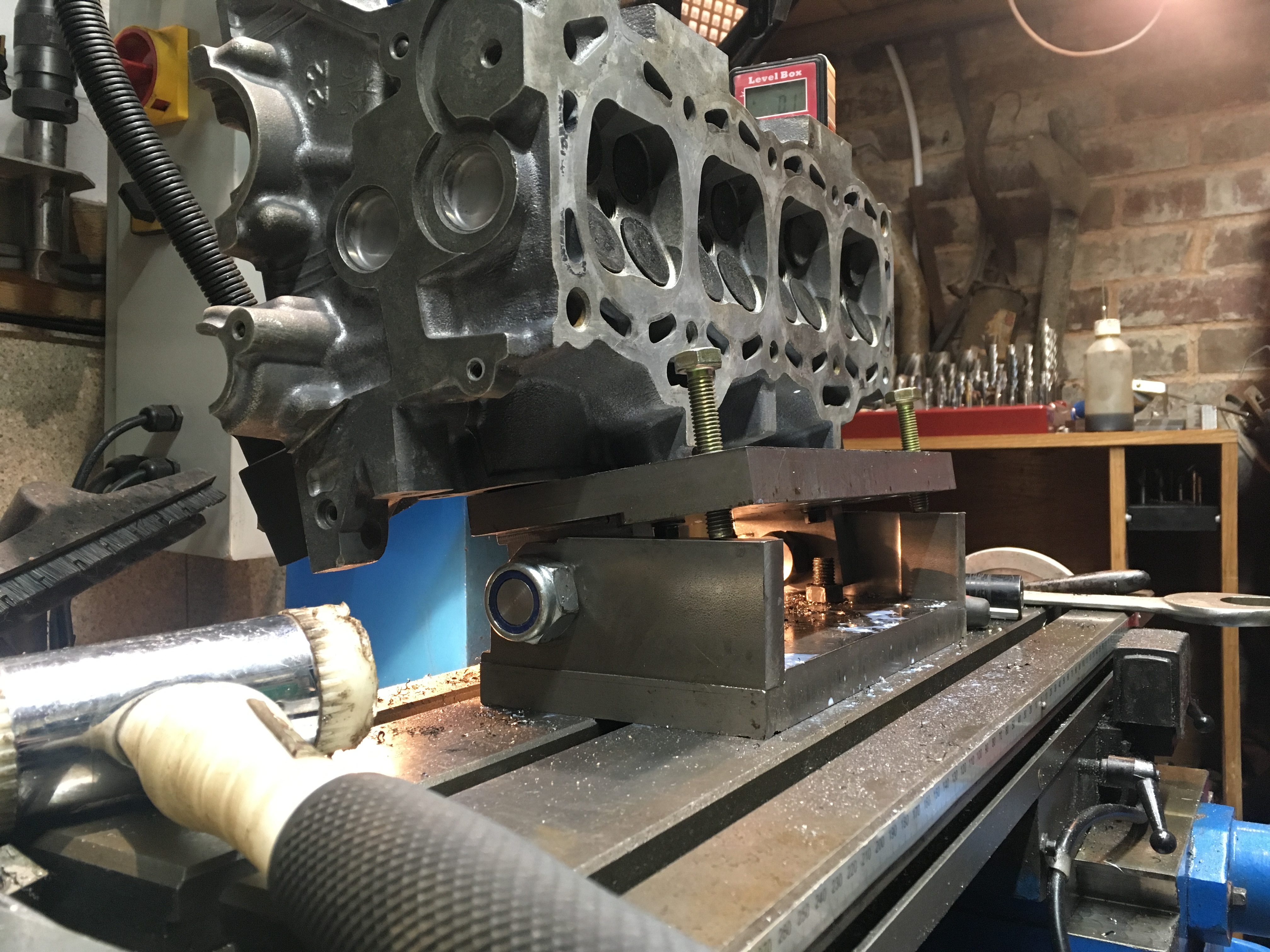

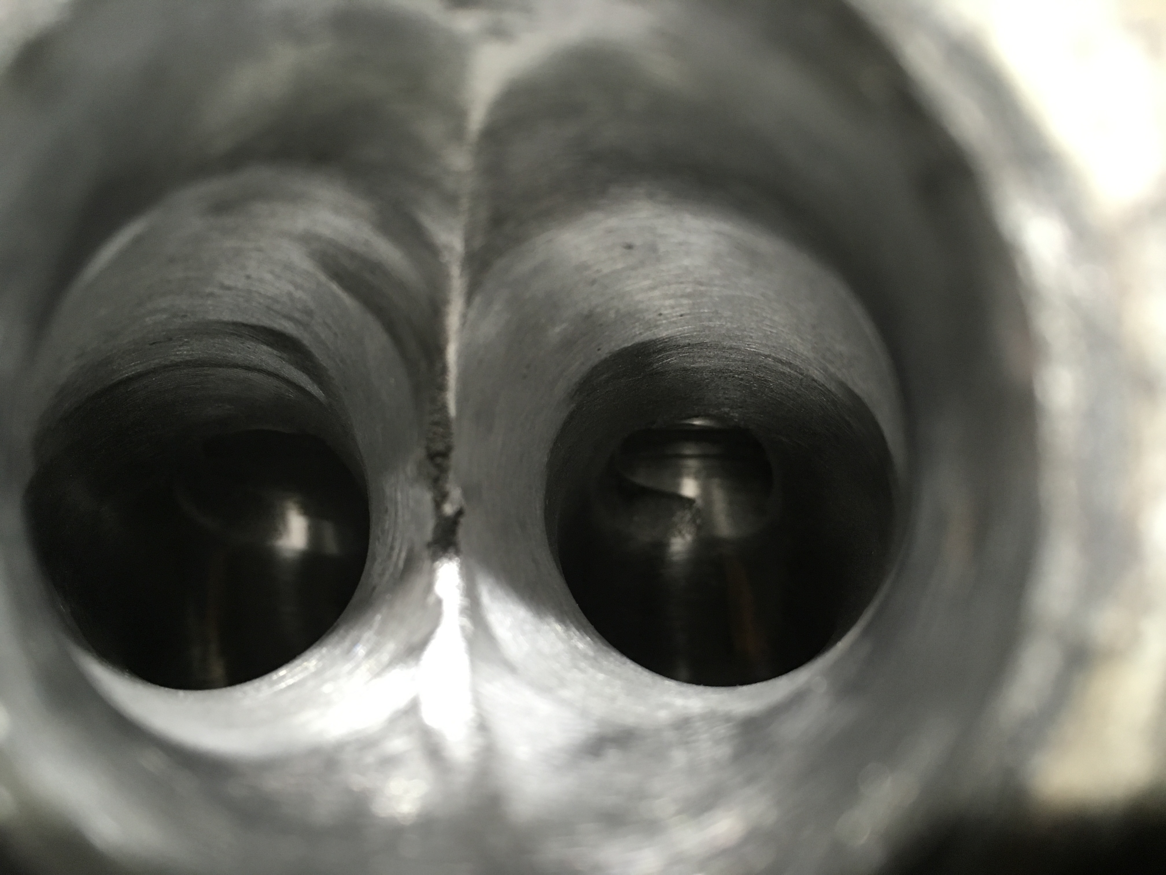

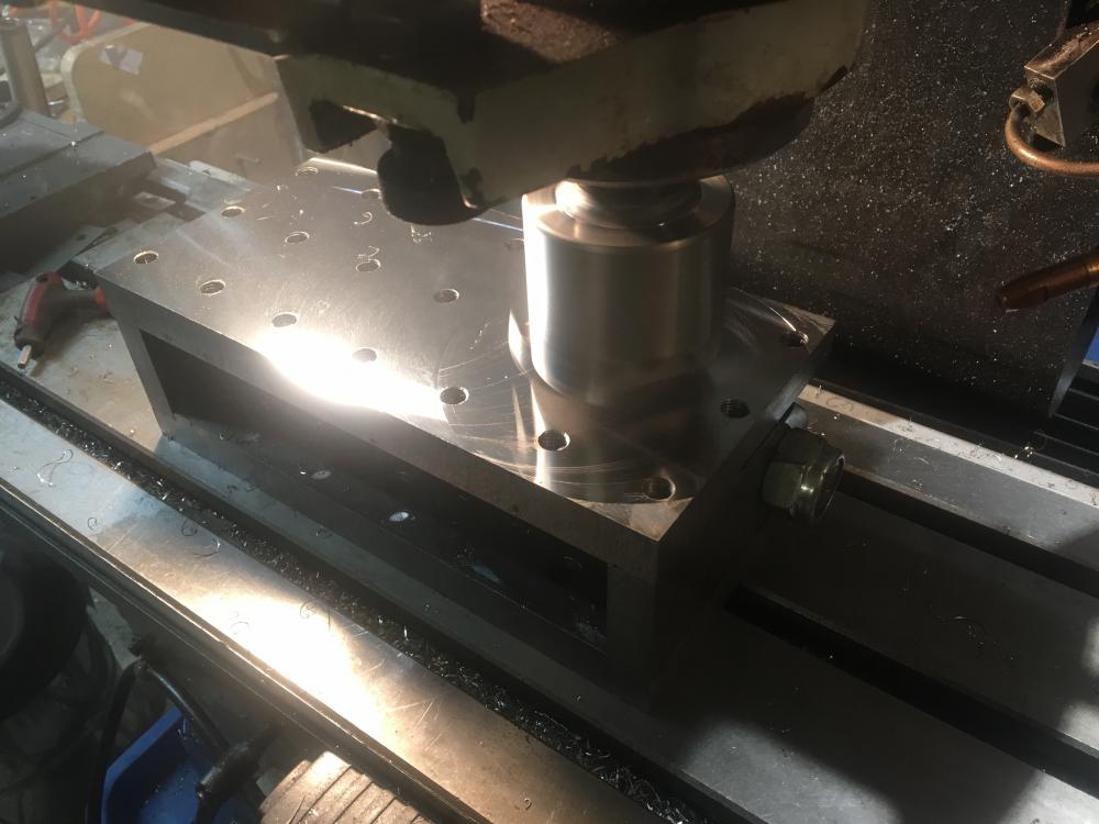

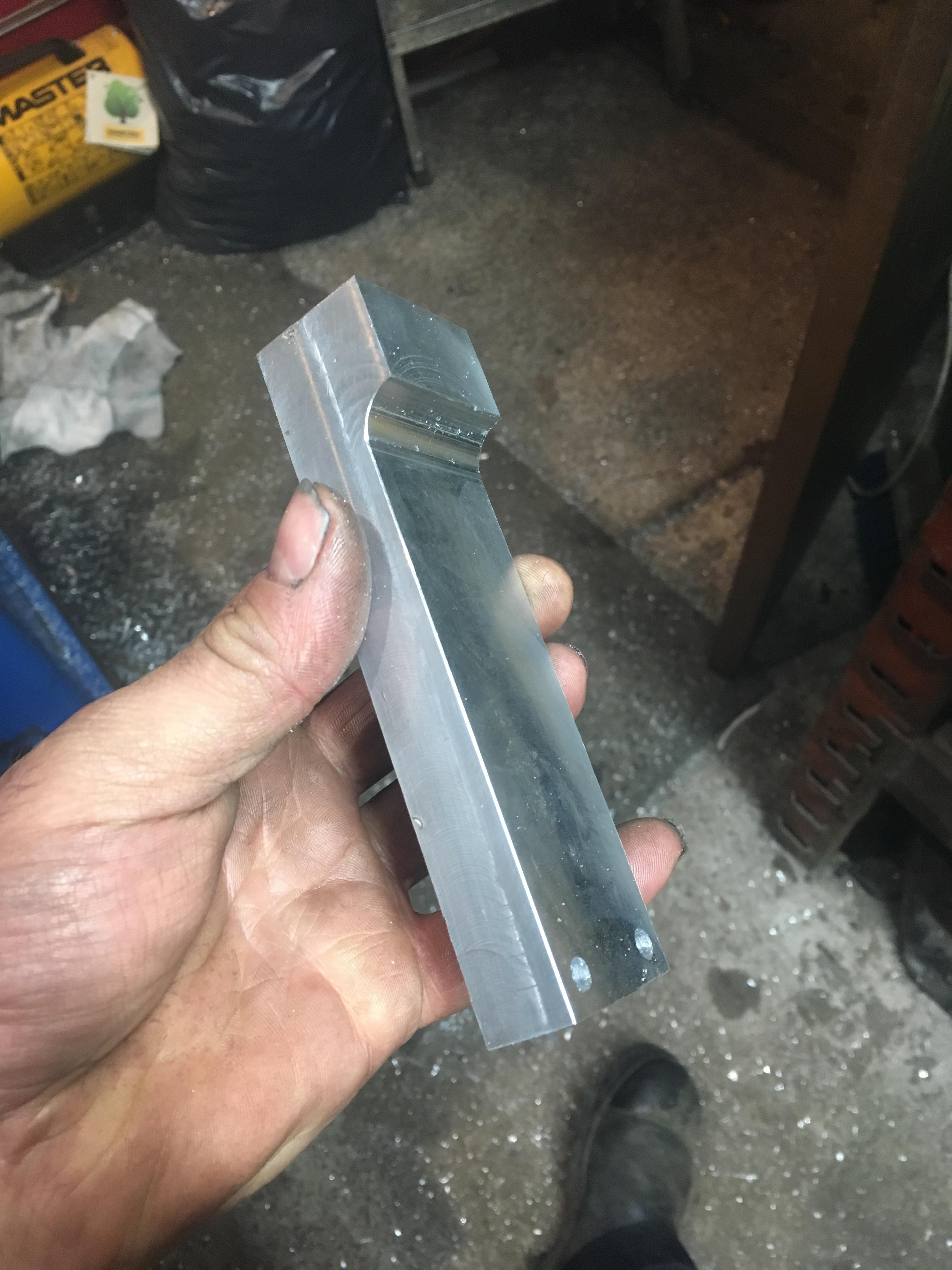

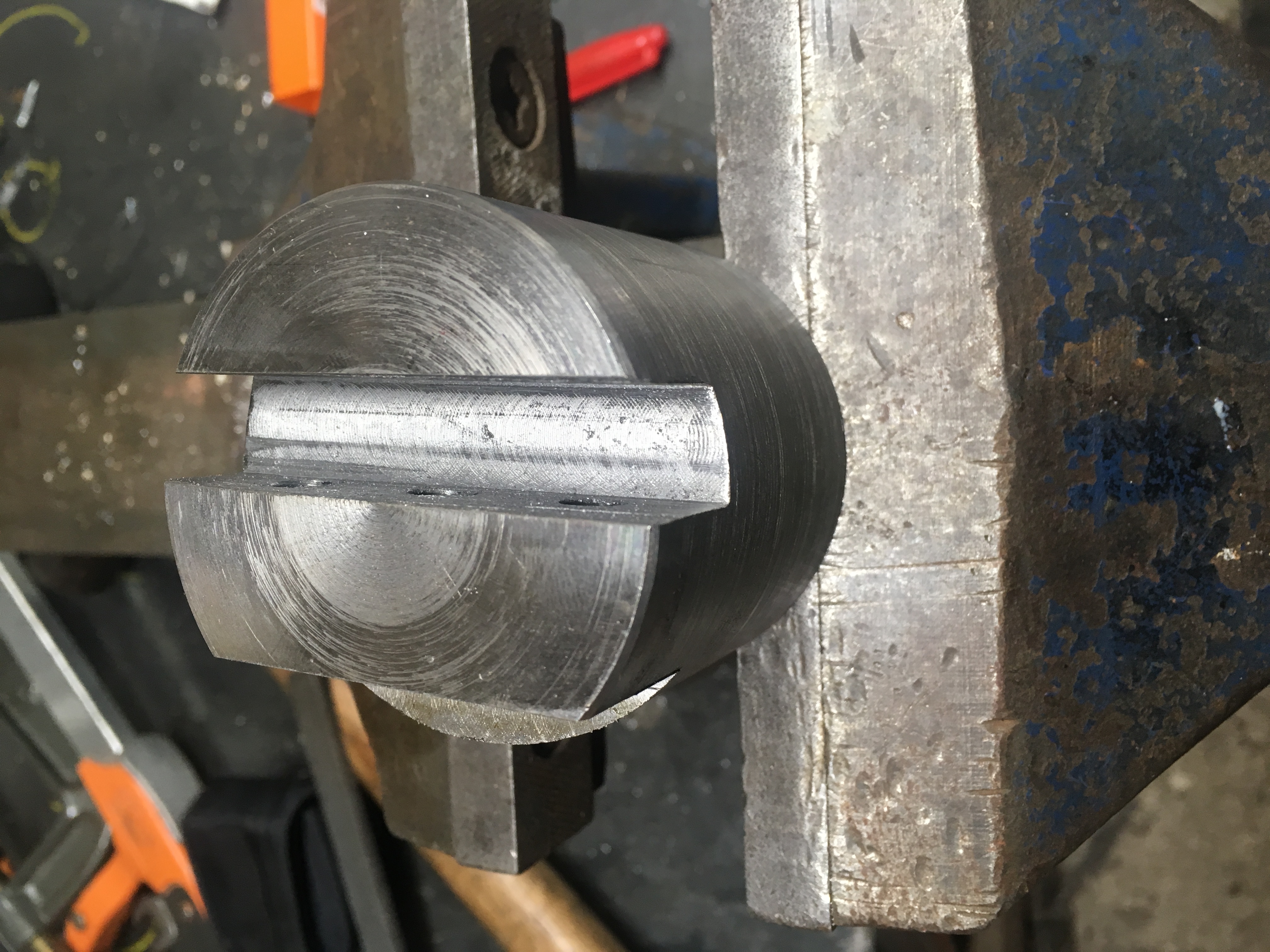

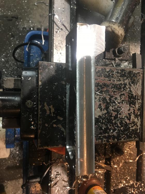

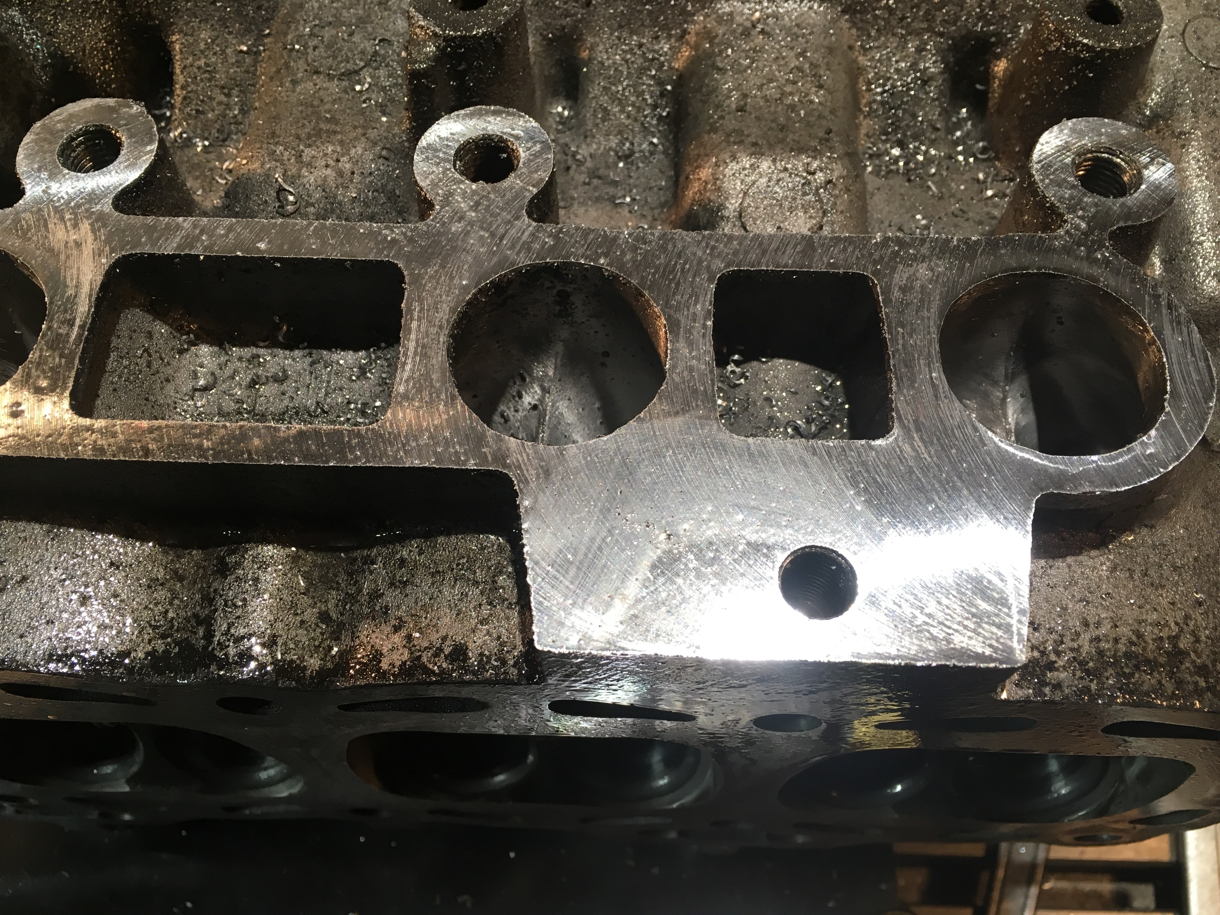

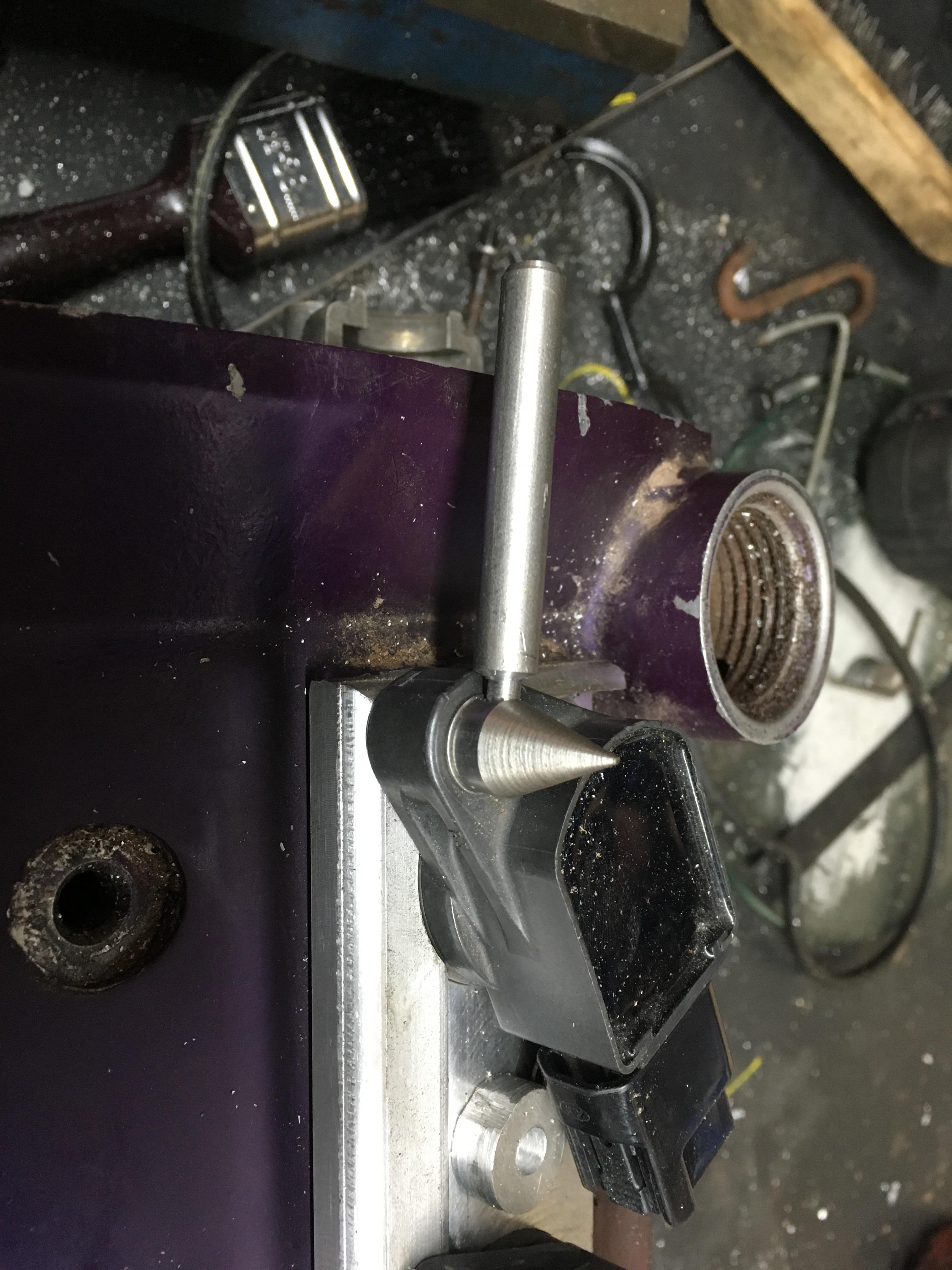

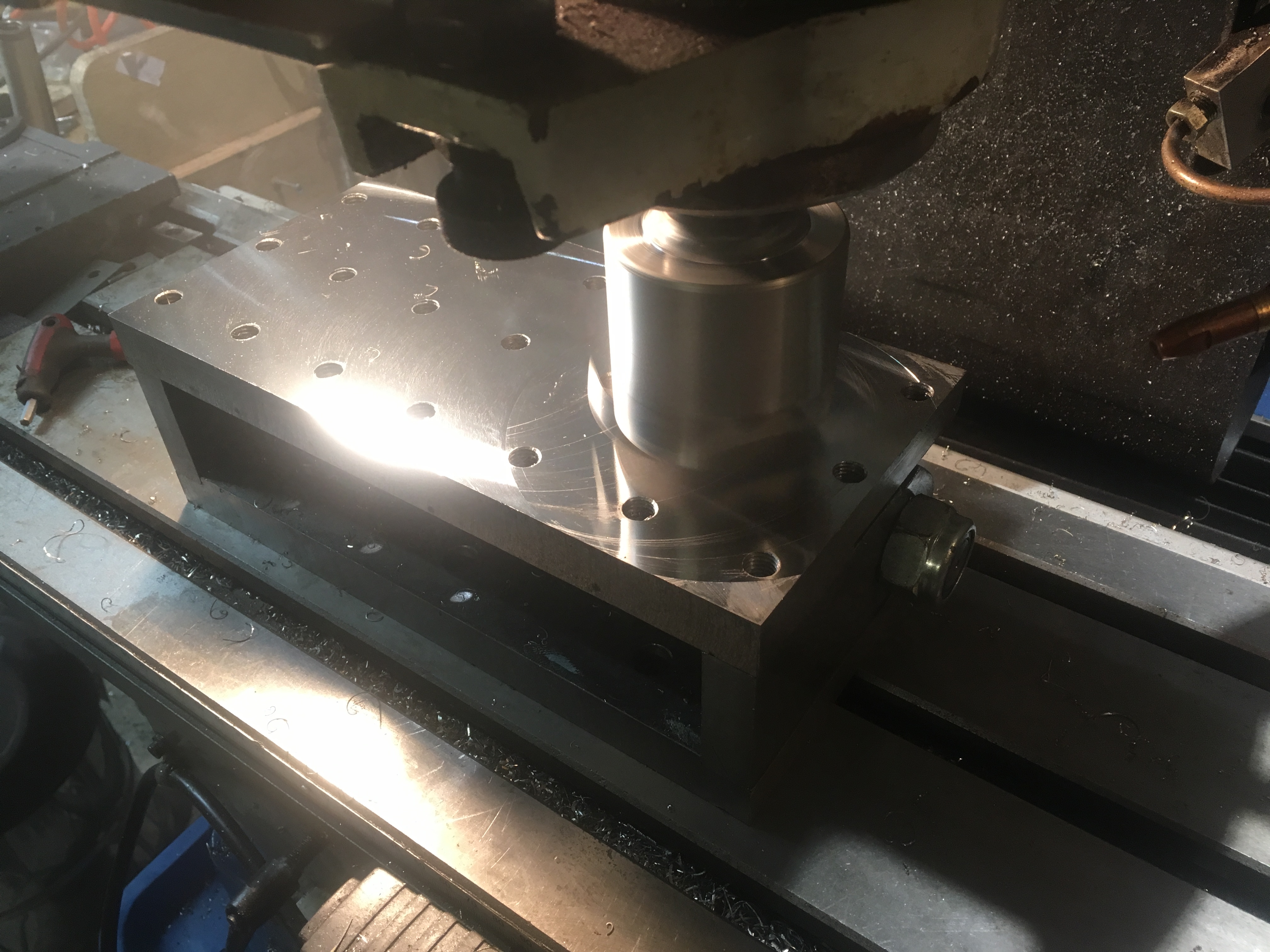

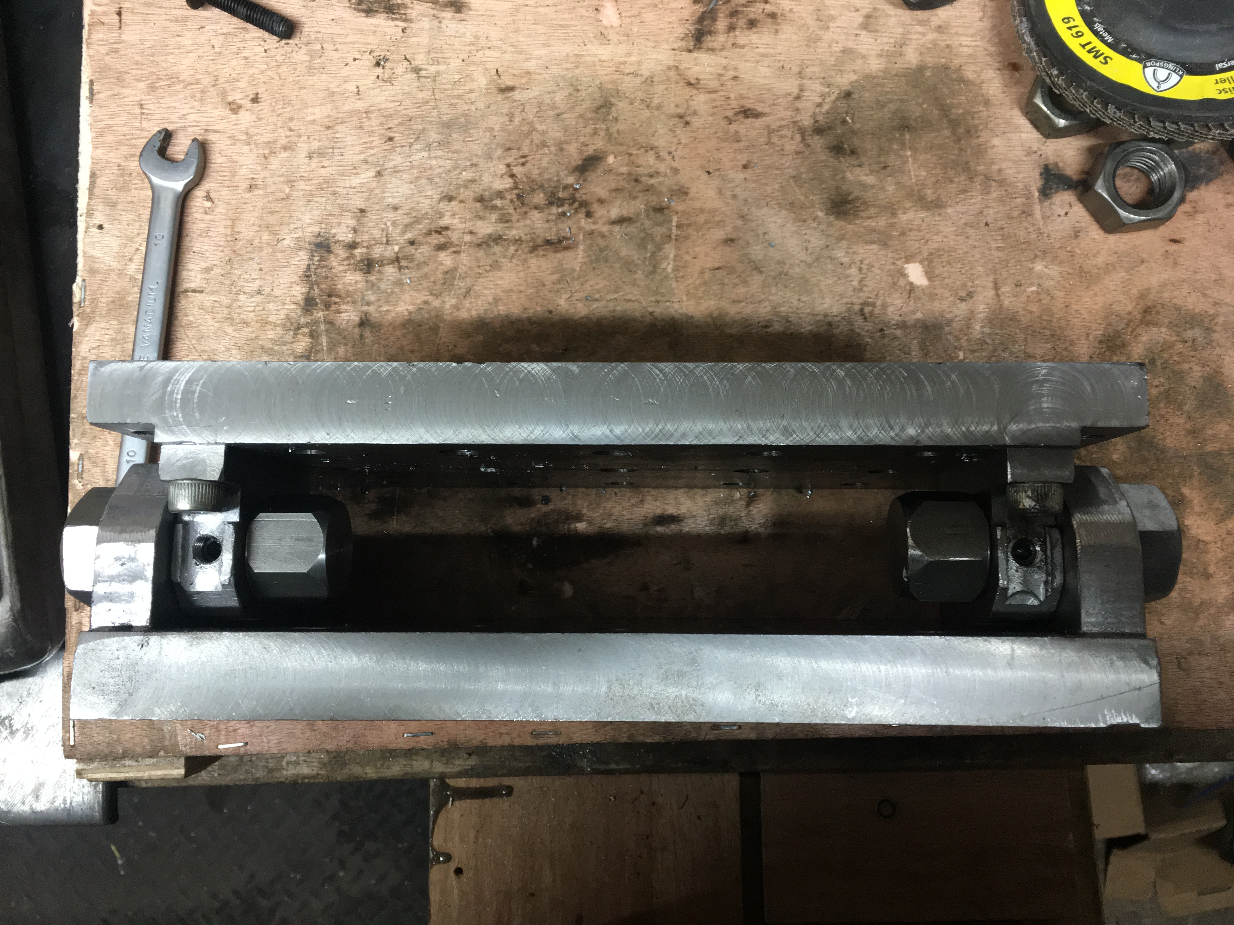

So out came a spare head! It got the same treatment as the last one a bit of a port and polish, I even made a tool for holding it in the vice so I could adjust it. This head had a very badly corroded

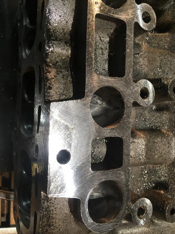

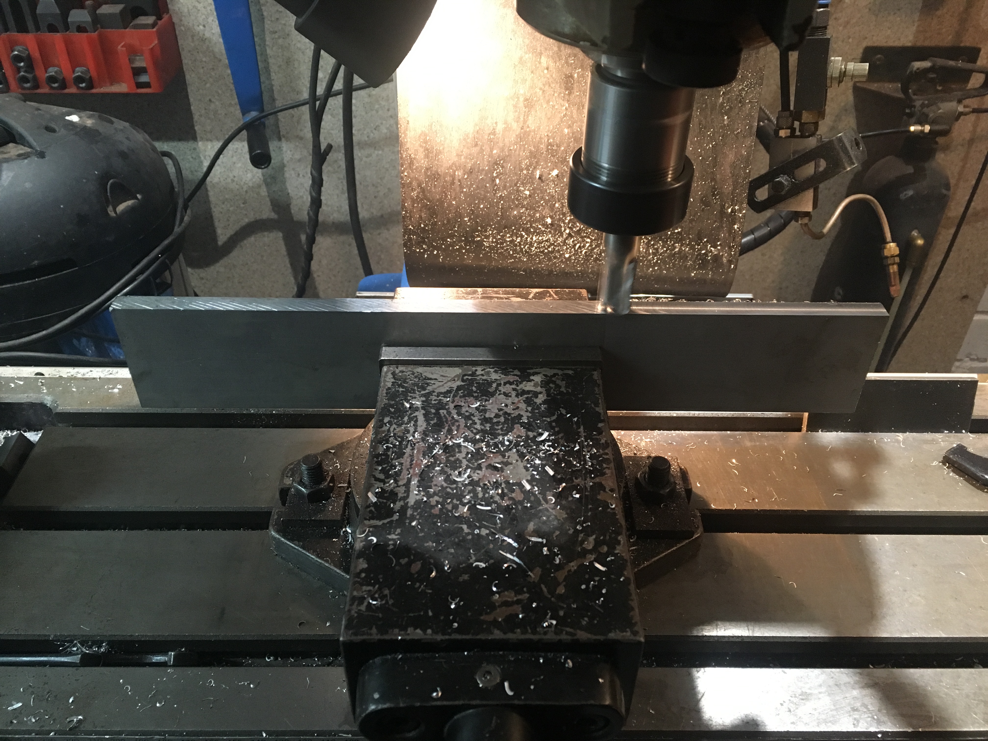

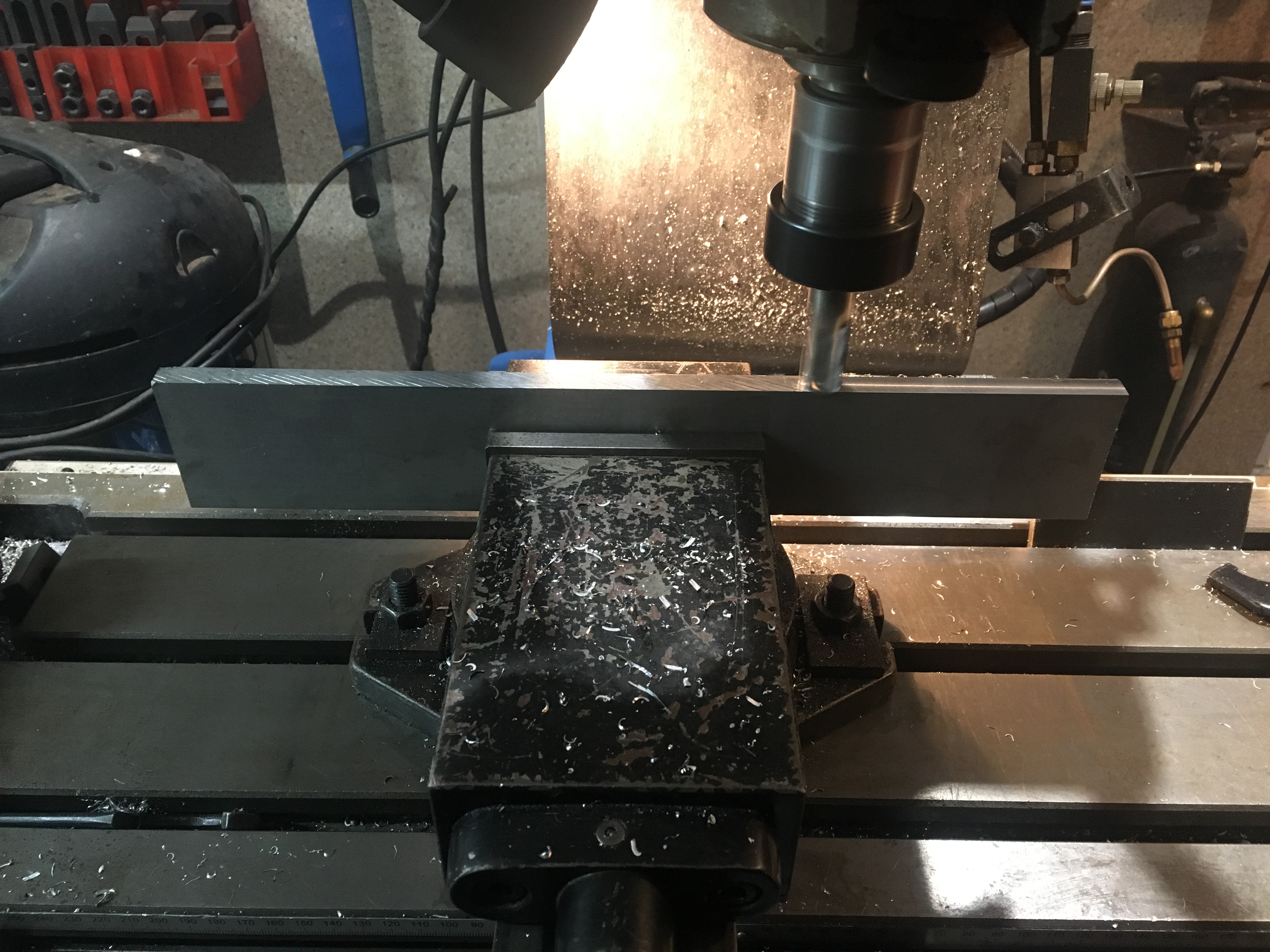

exhaust port side so! I made a tilting table to go on the mill so I could skim it!

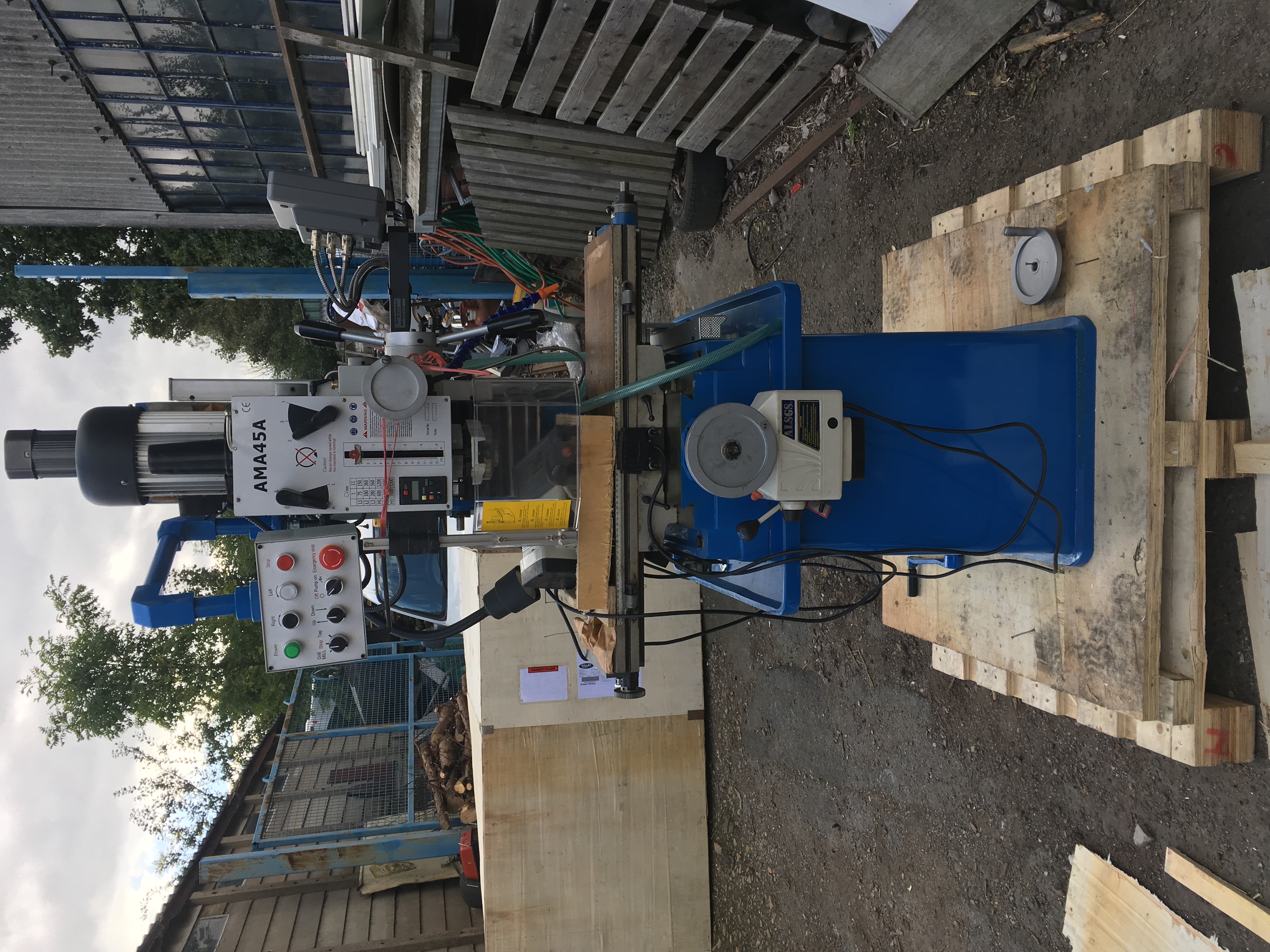

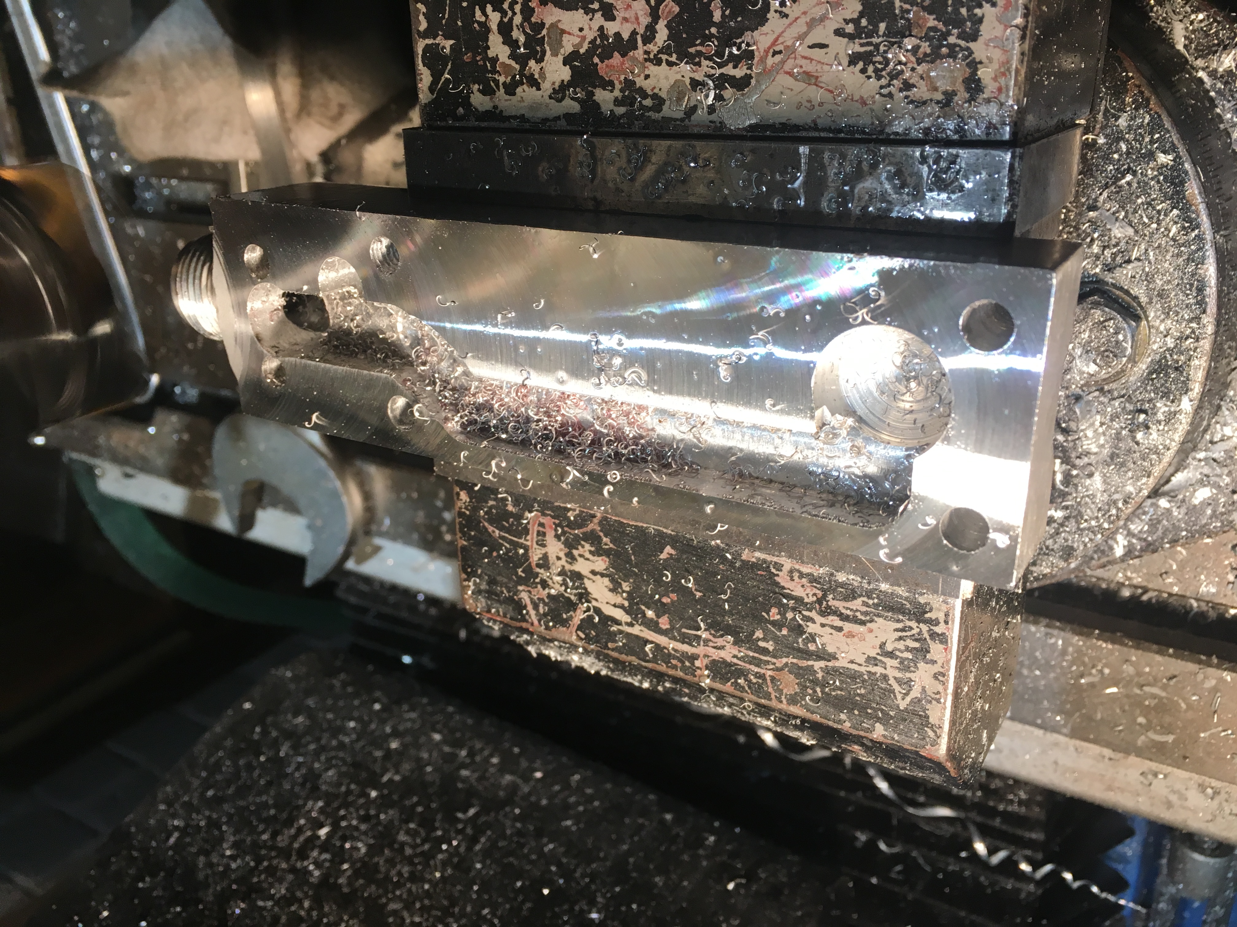

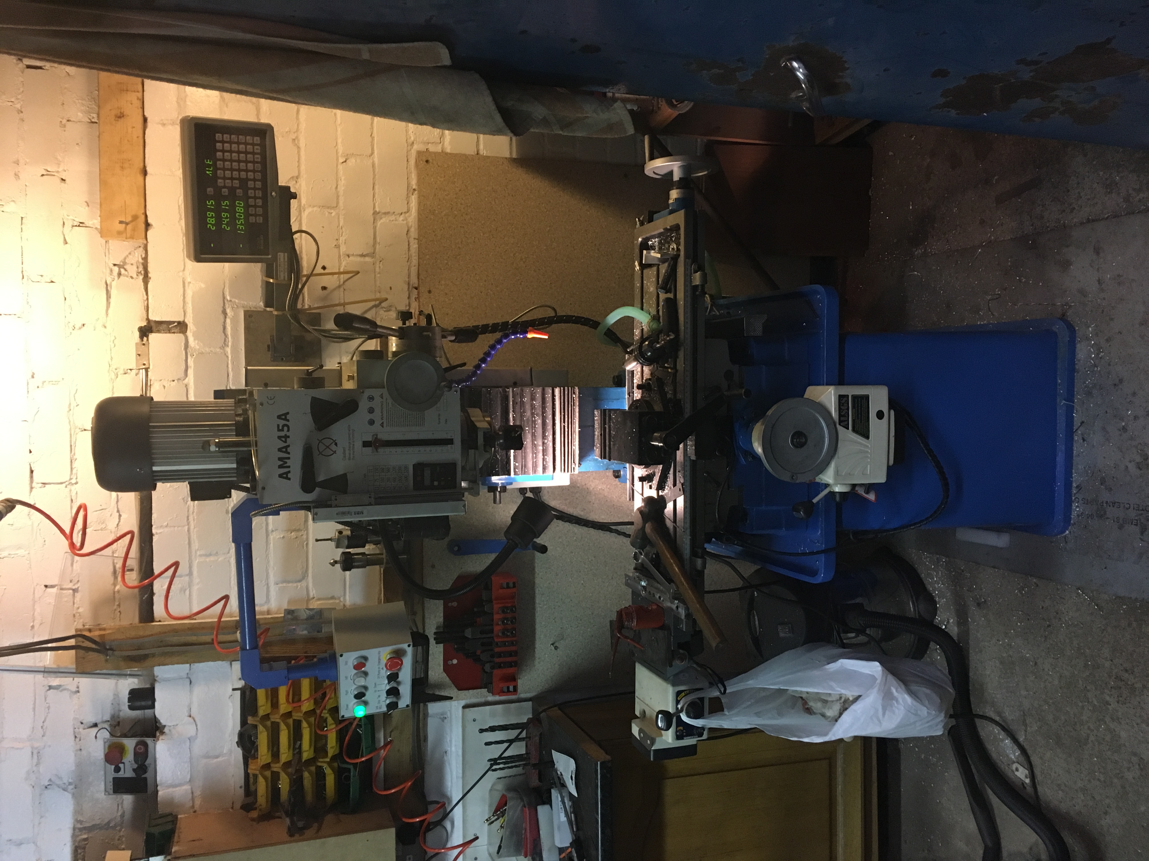

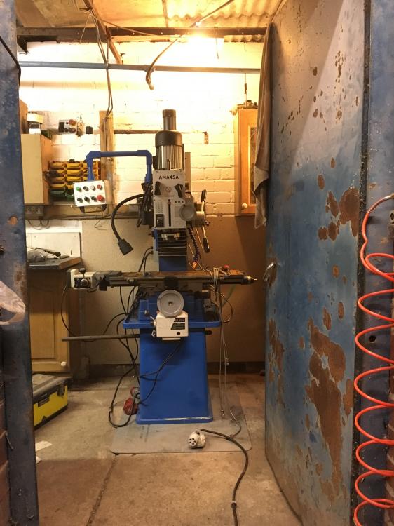

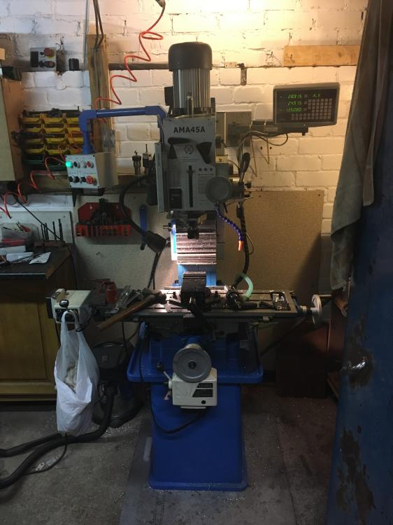

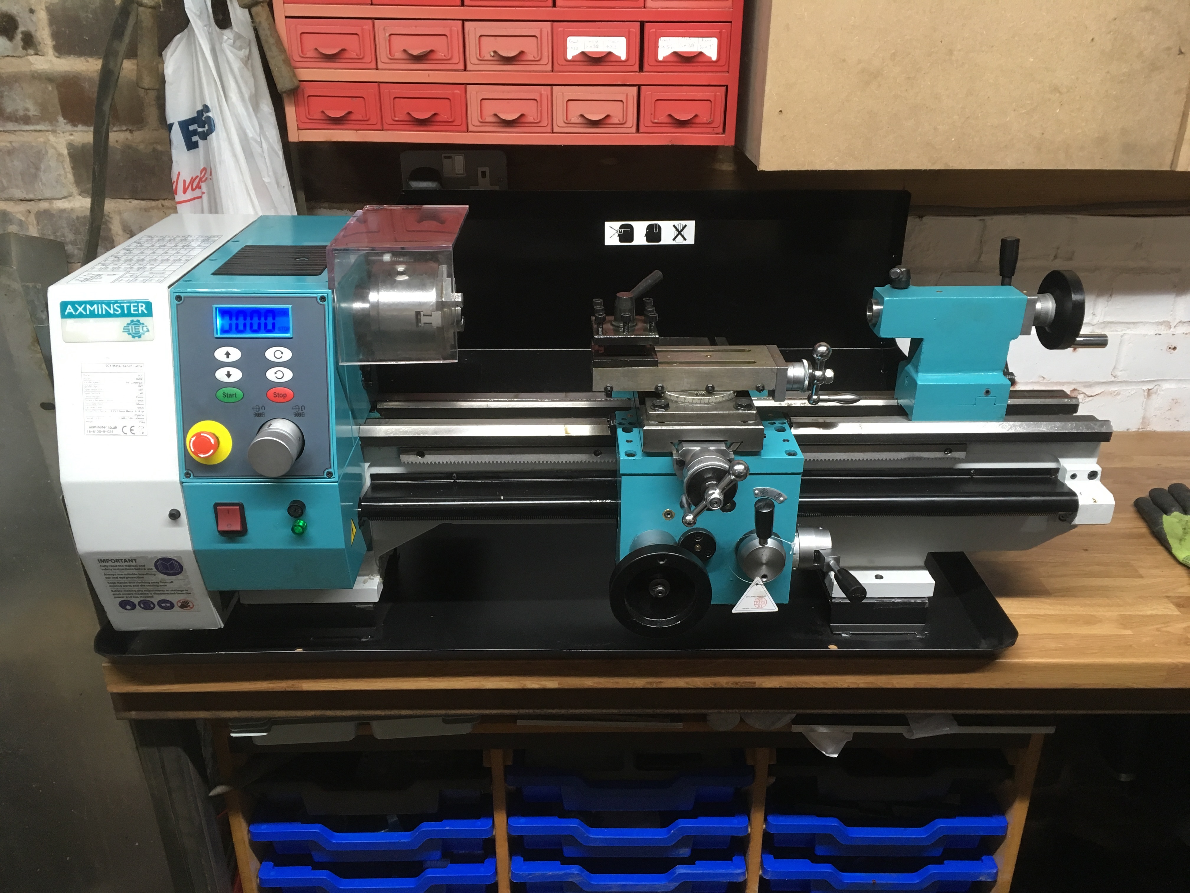

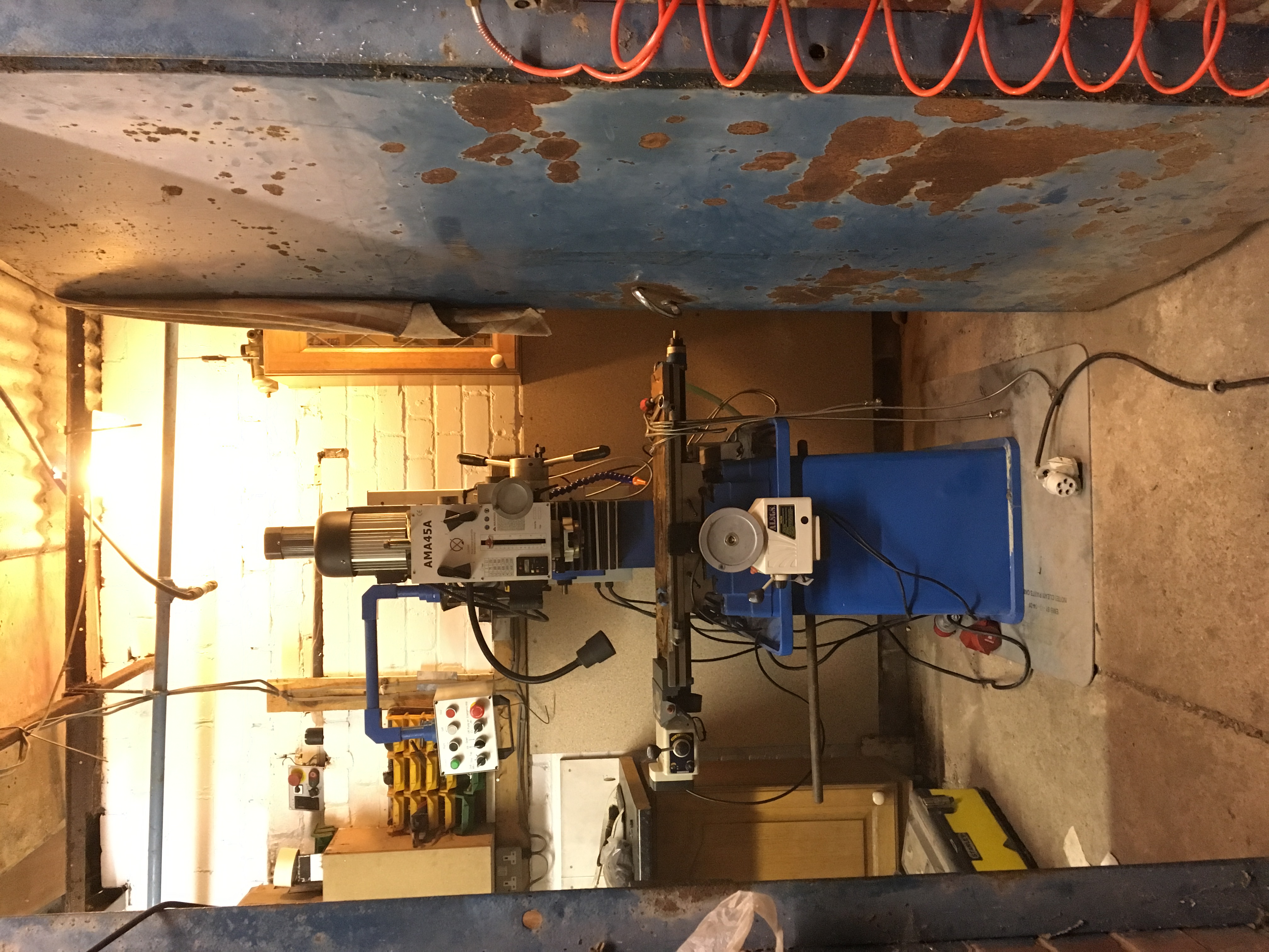

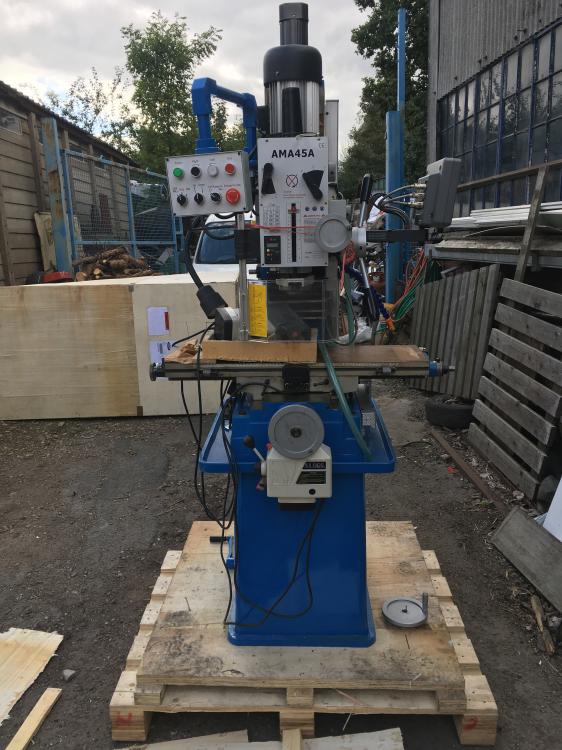

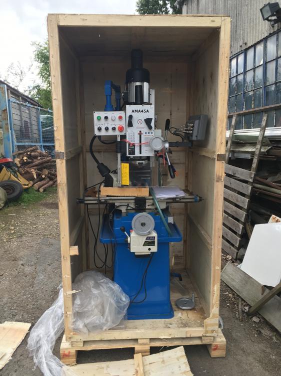

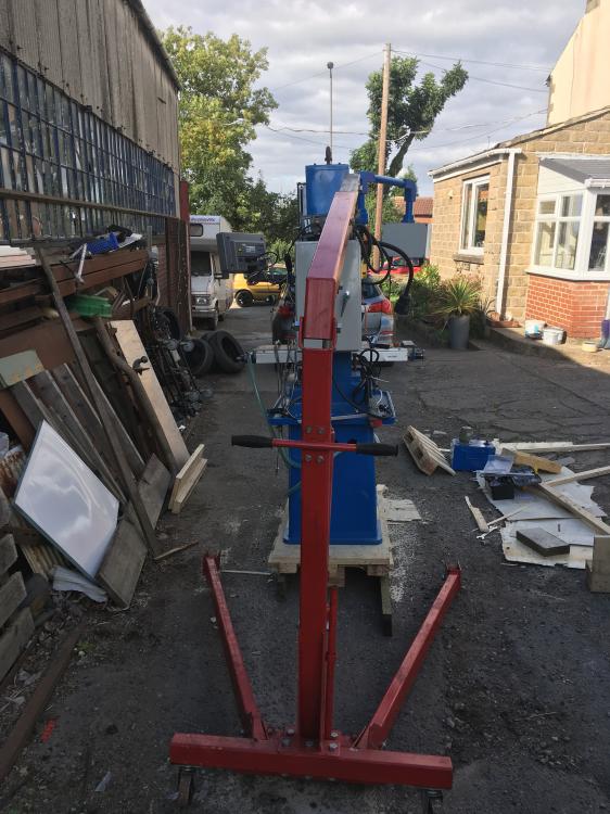

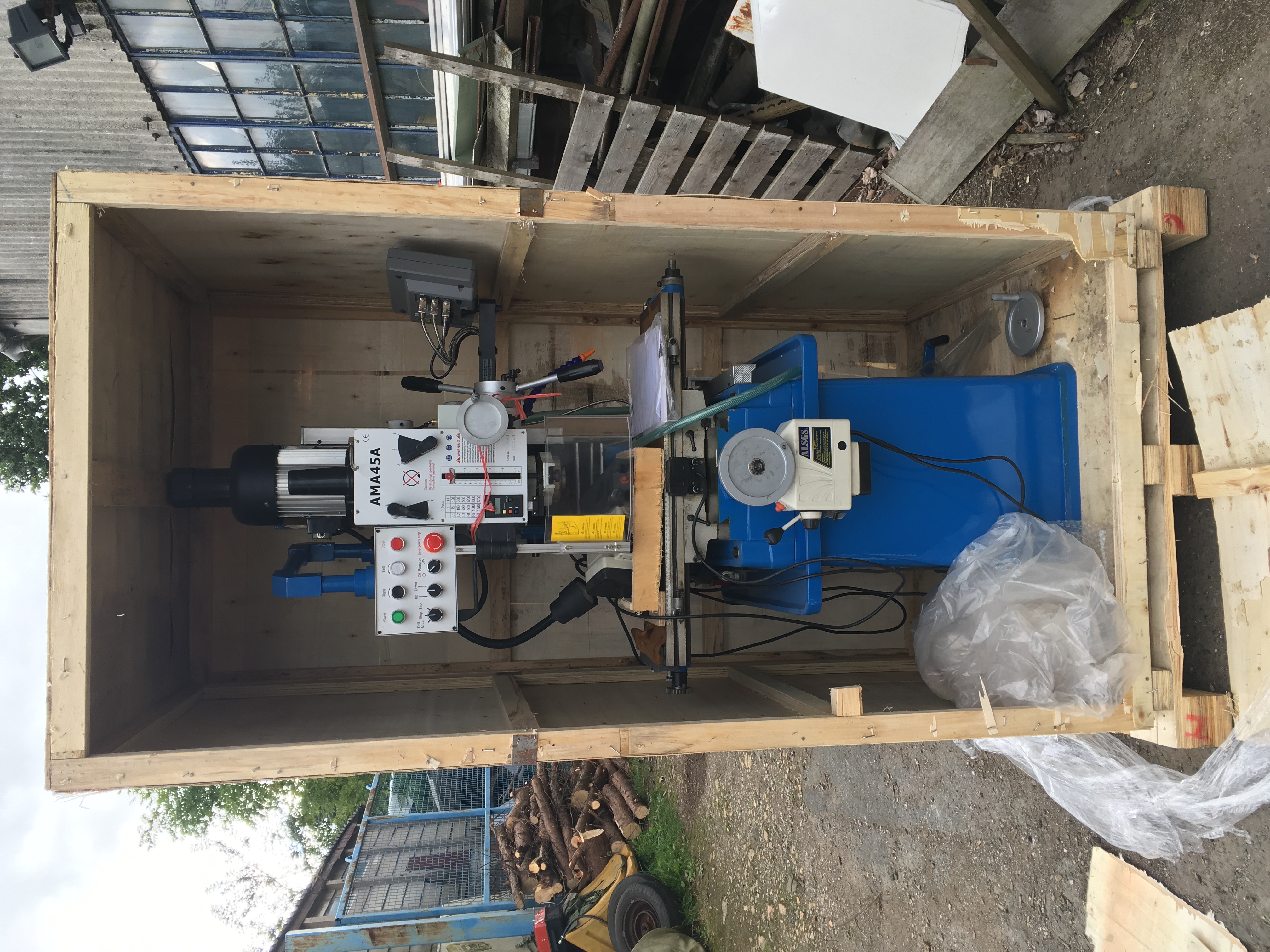

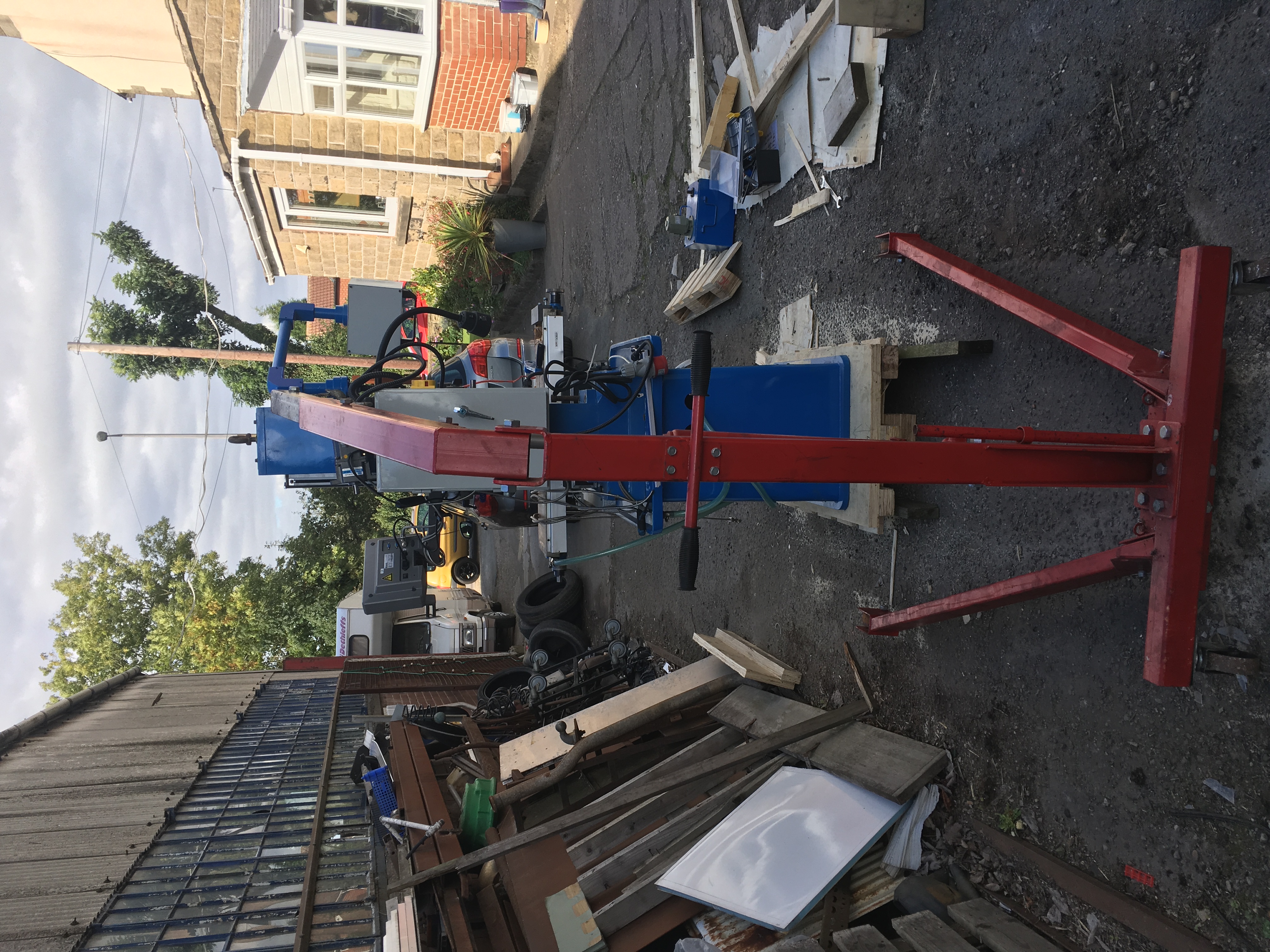

Anther thing that has changed is my workshop too! I have replaced the mill with a much bigger one! still not quite big enough to skim the head face tho but it will do most of it. I have also got a new small lathe for doing the smaller pieces on, I've got a new website  http://www.rchengineering.co.uk/  a facebook page! https://www.facebook.com/rchengineering/  and hopefully soon a traders section on here offering one off parts and services!IMG_3118.thumb.JPG.fcdf2ce859720d343770dIMG_3119.thumb.JPG.eaf144bf0da307b27ef91IMG_3125.JPGIMG_3127.thumb.JPG.d3d3853d87c2b909c8fa7IMG_3147.thumb.JPG.2025872c051e67e1d5bc4IMG_3620.thumb.JPG.d72fba238451ea84cab46

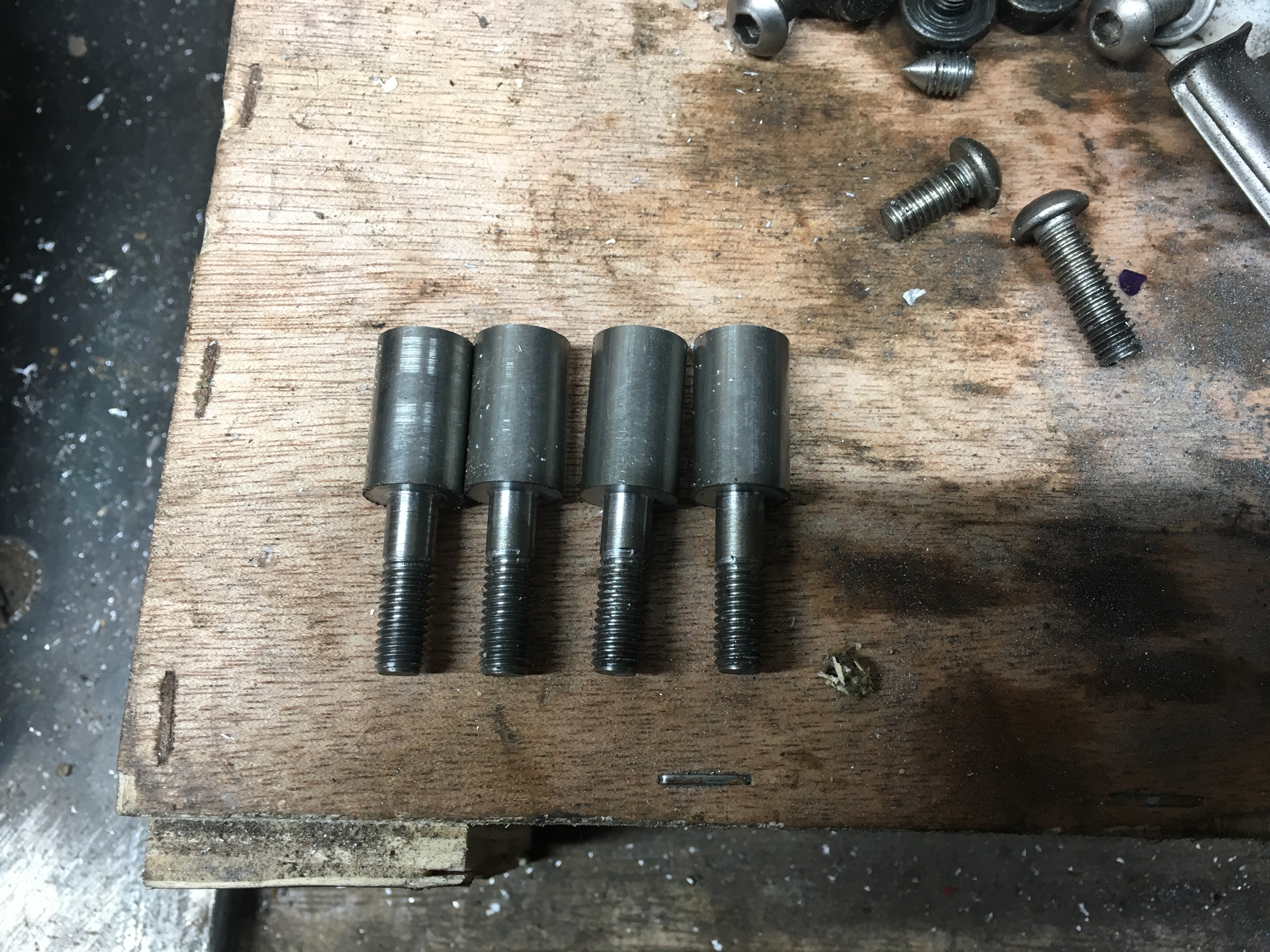

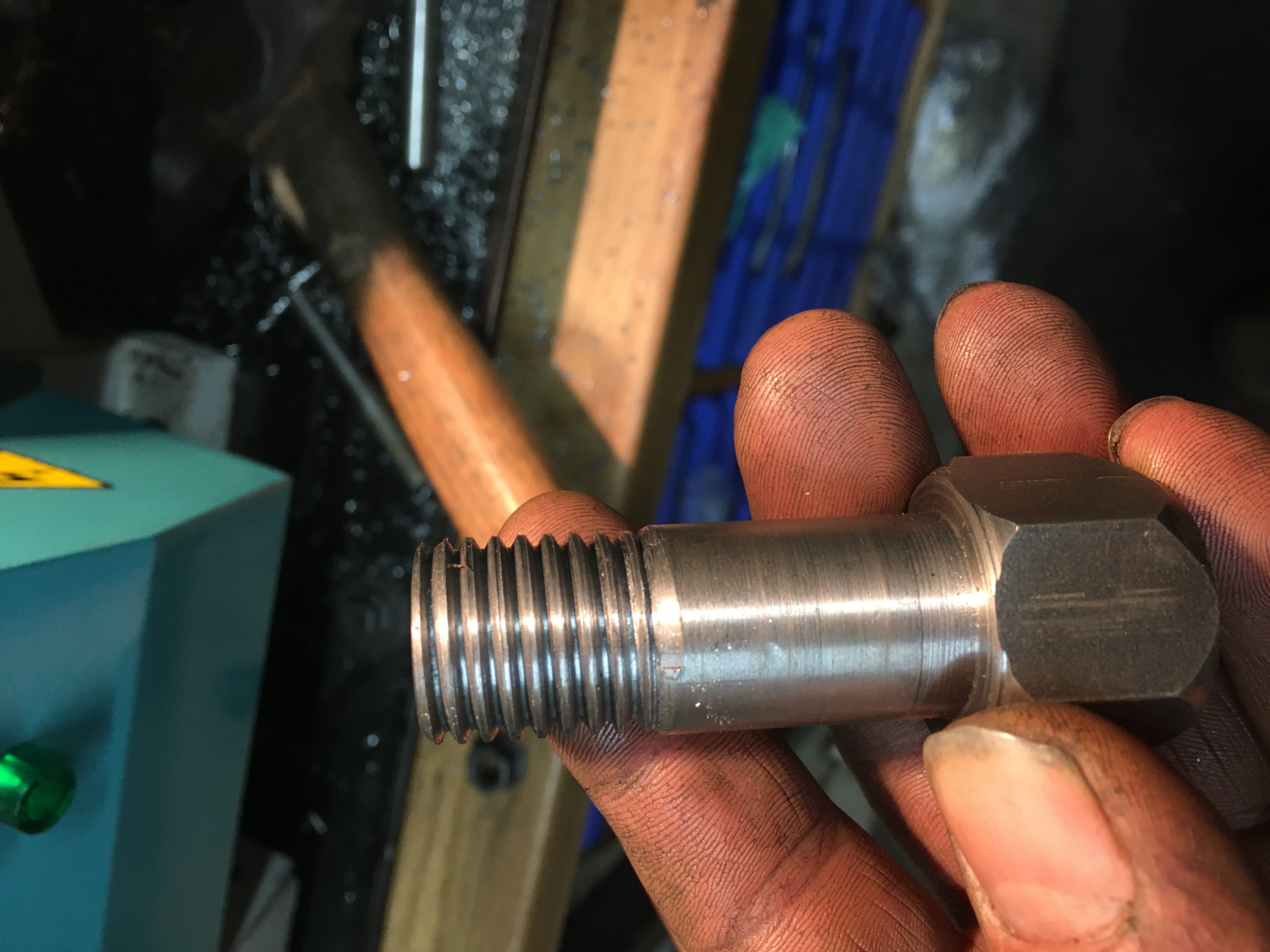

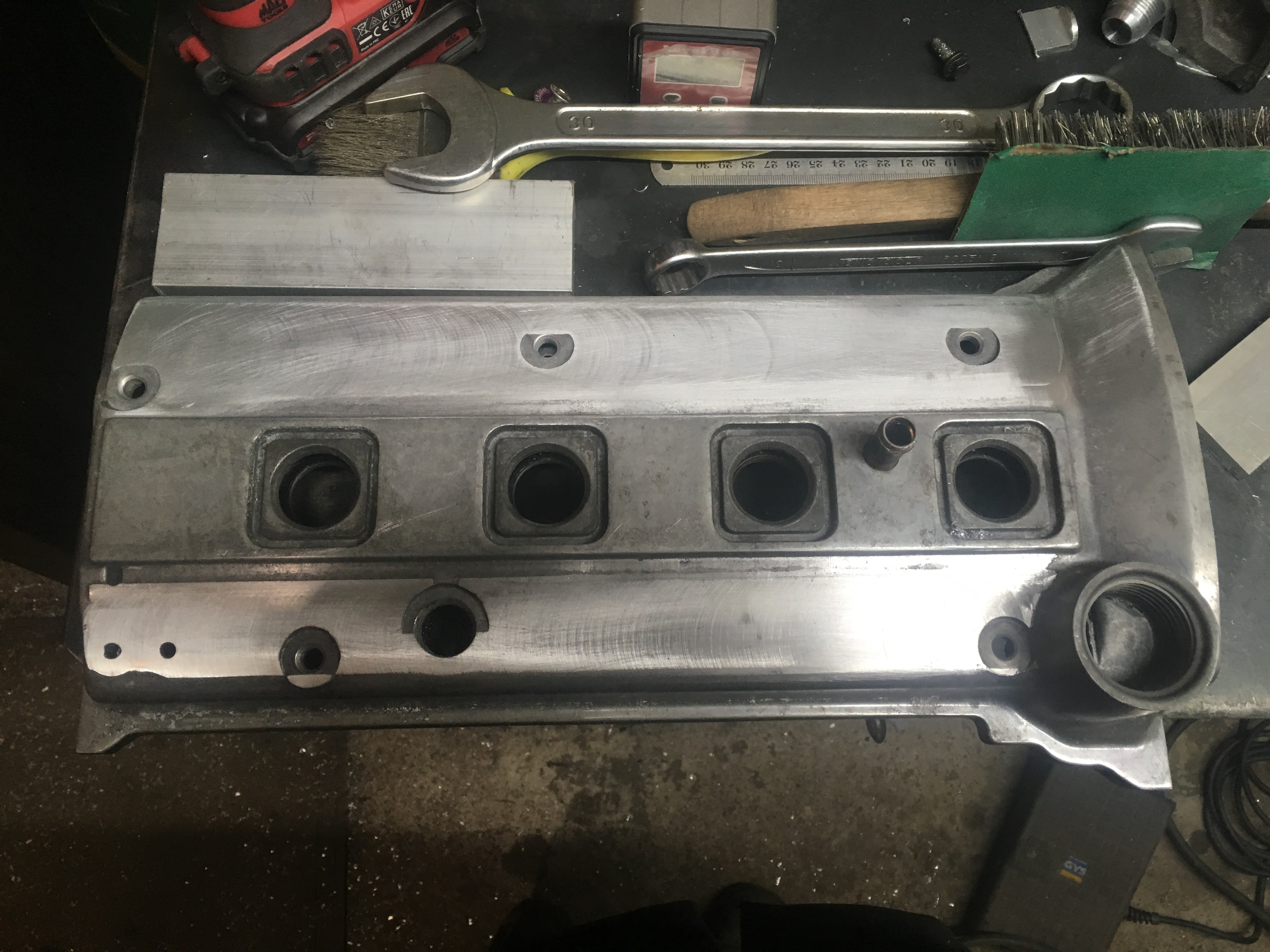

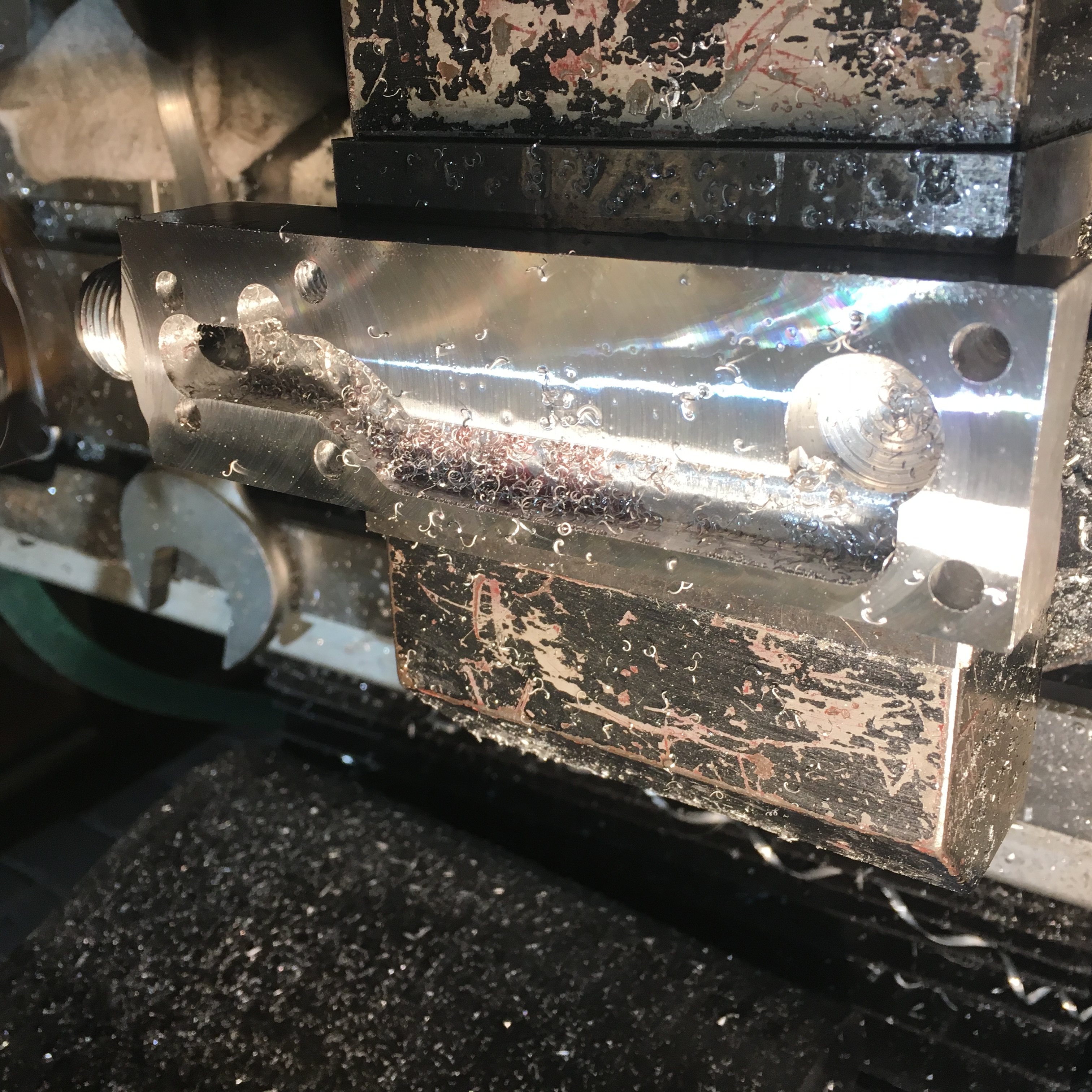

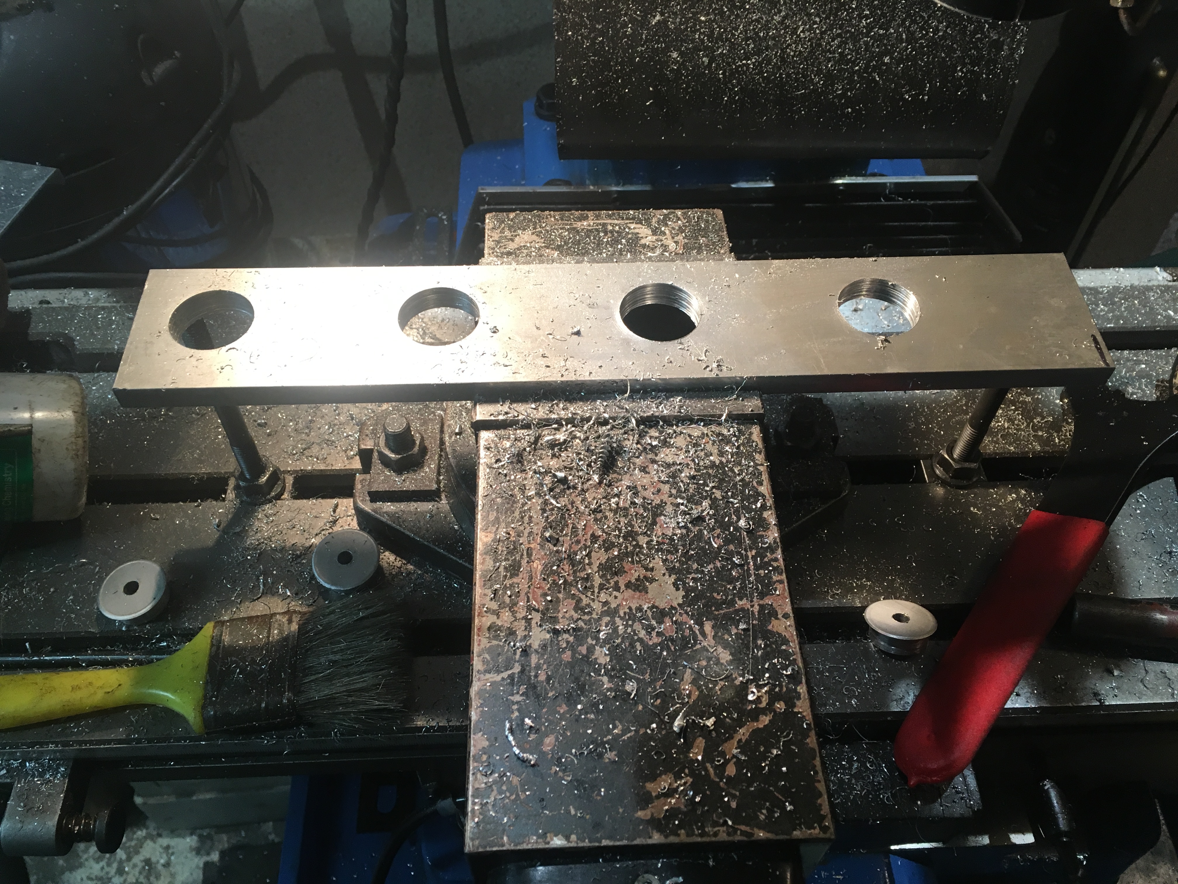

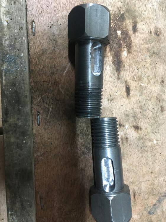

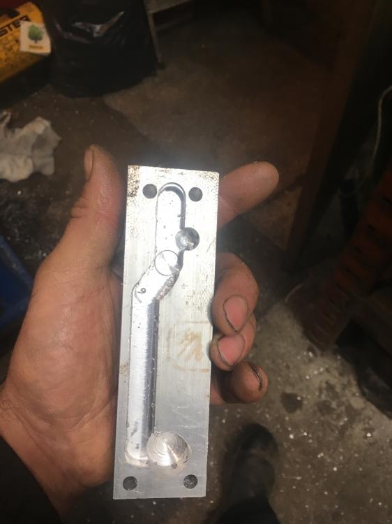

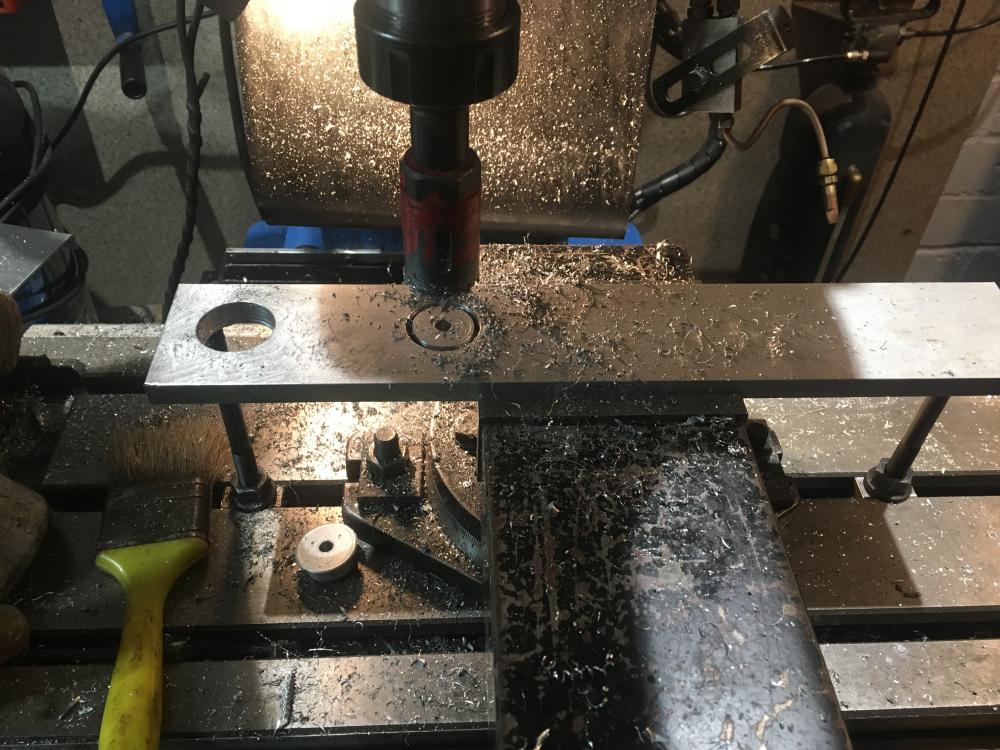

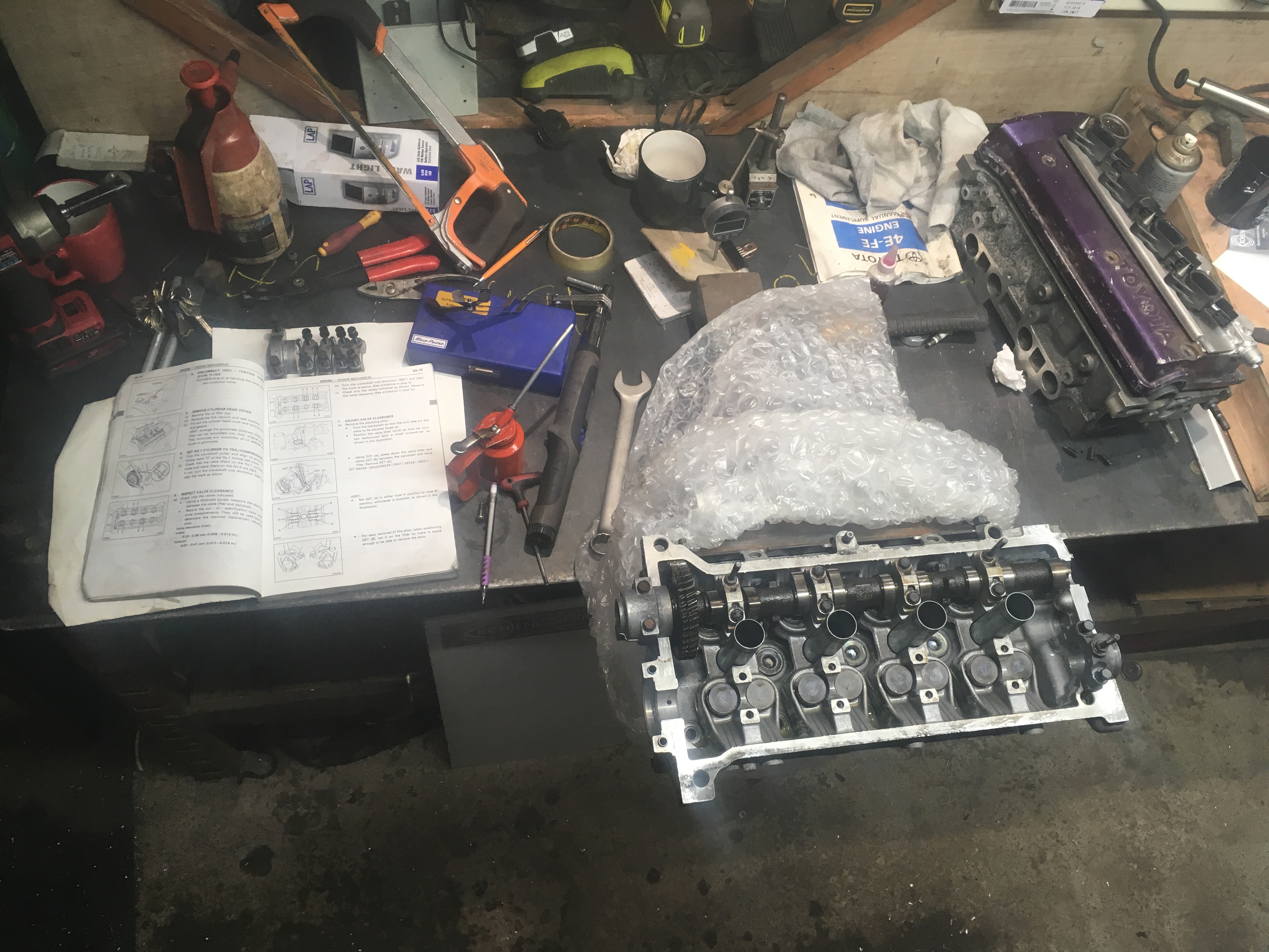

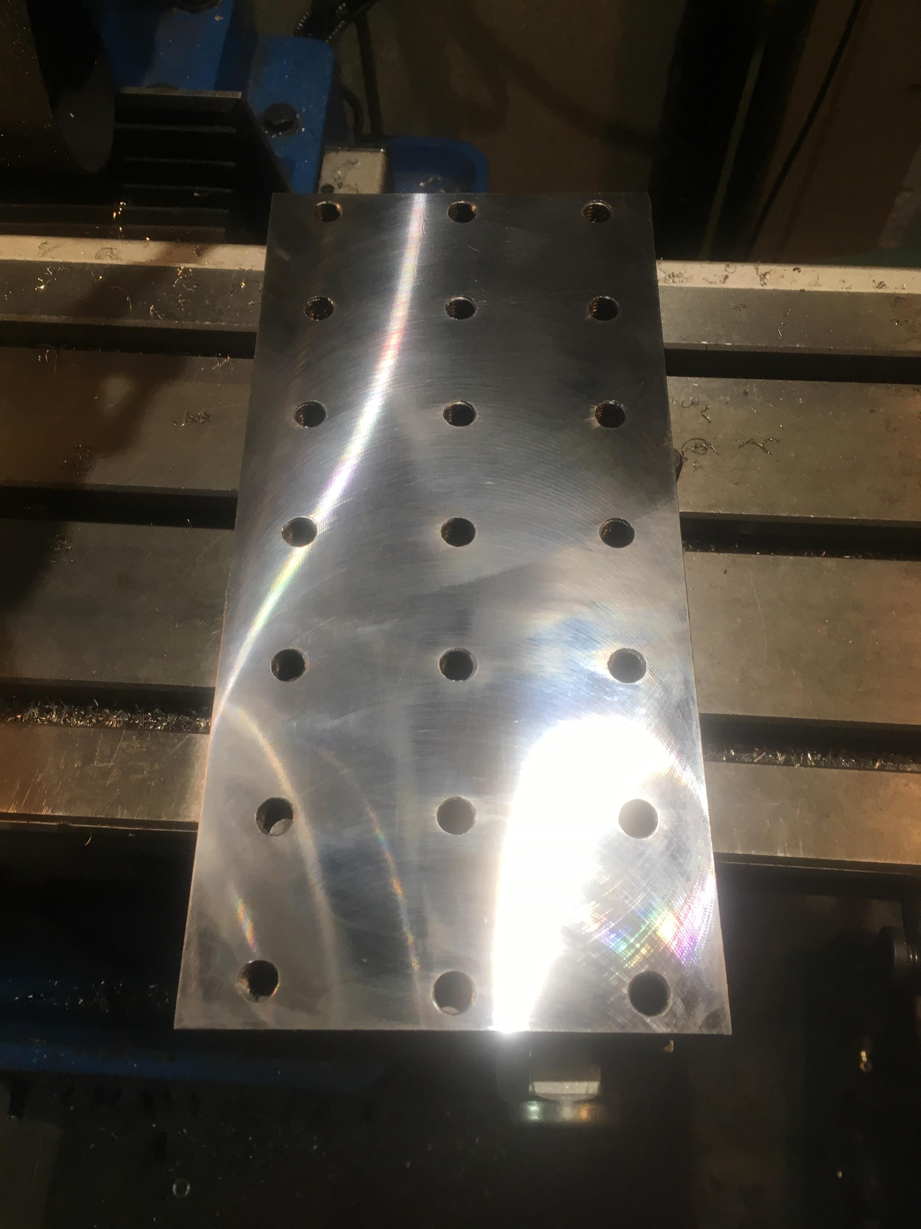

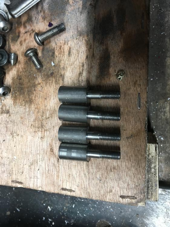

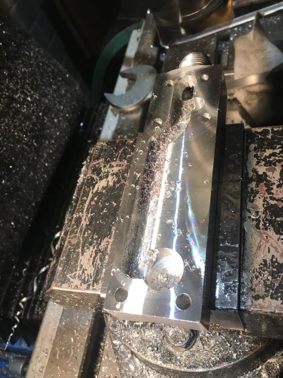

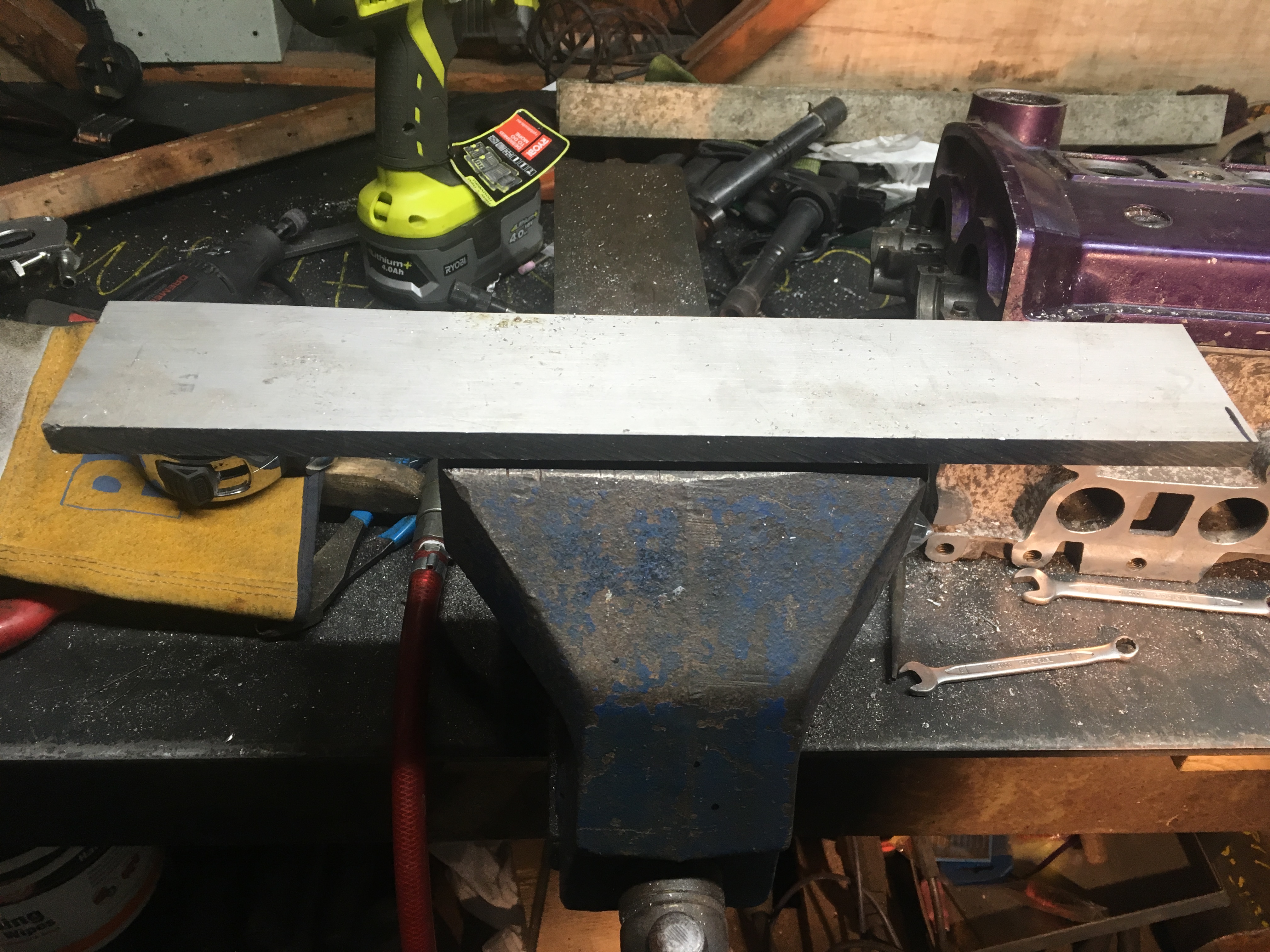

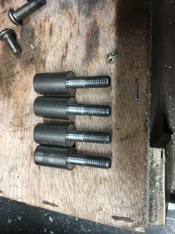

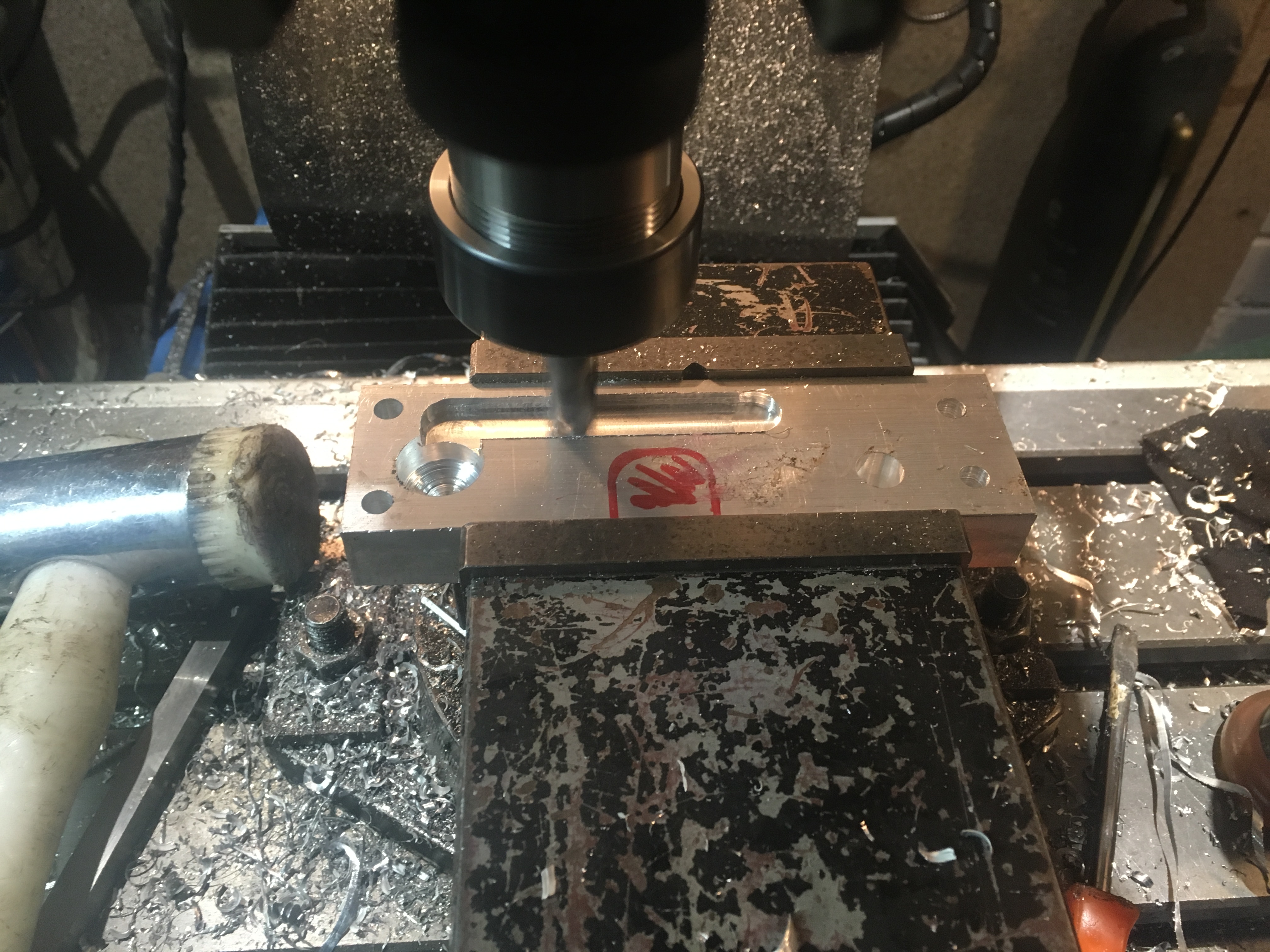

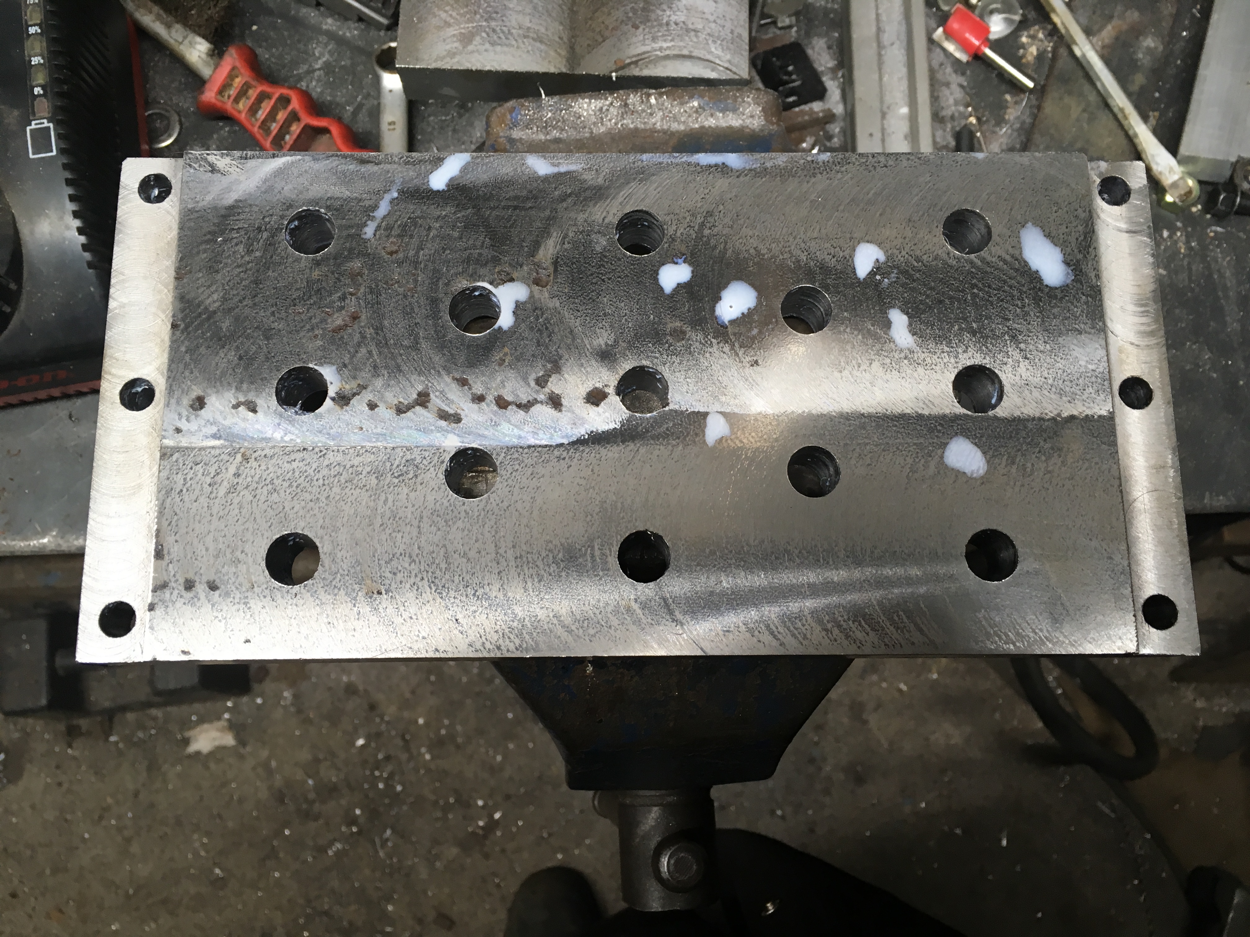

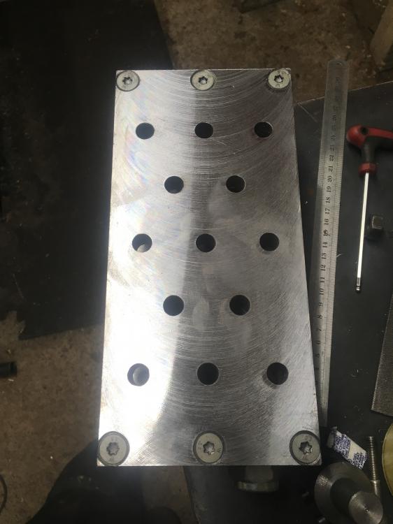

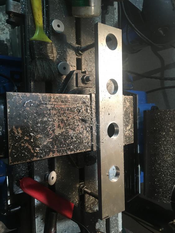

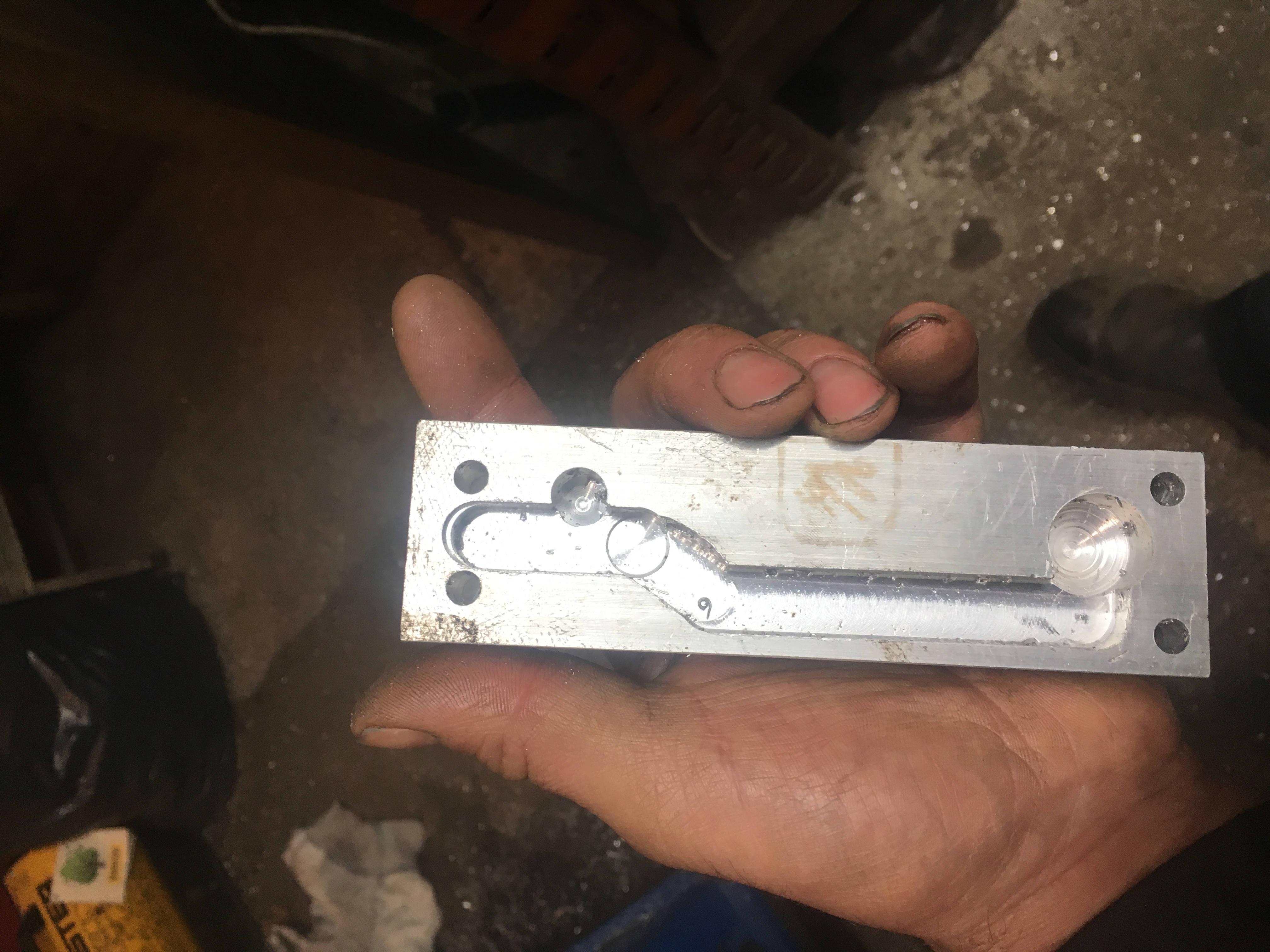

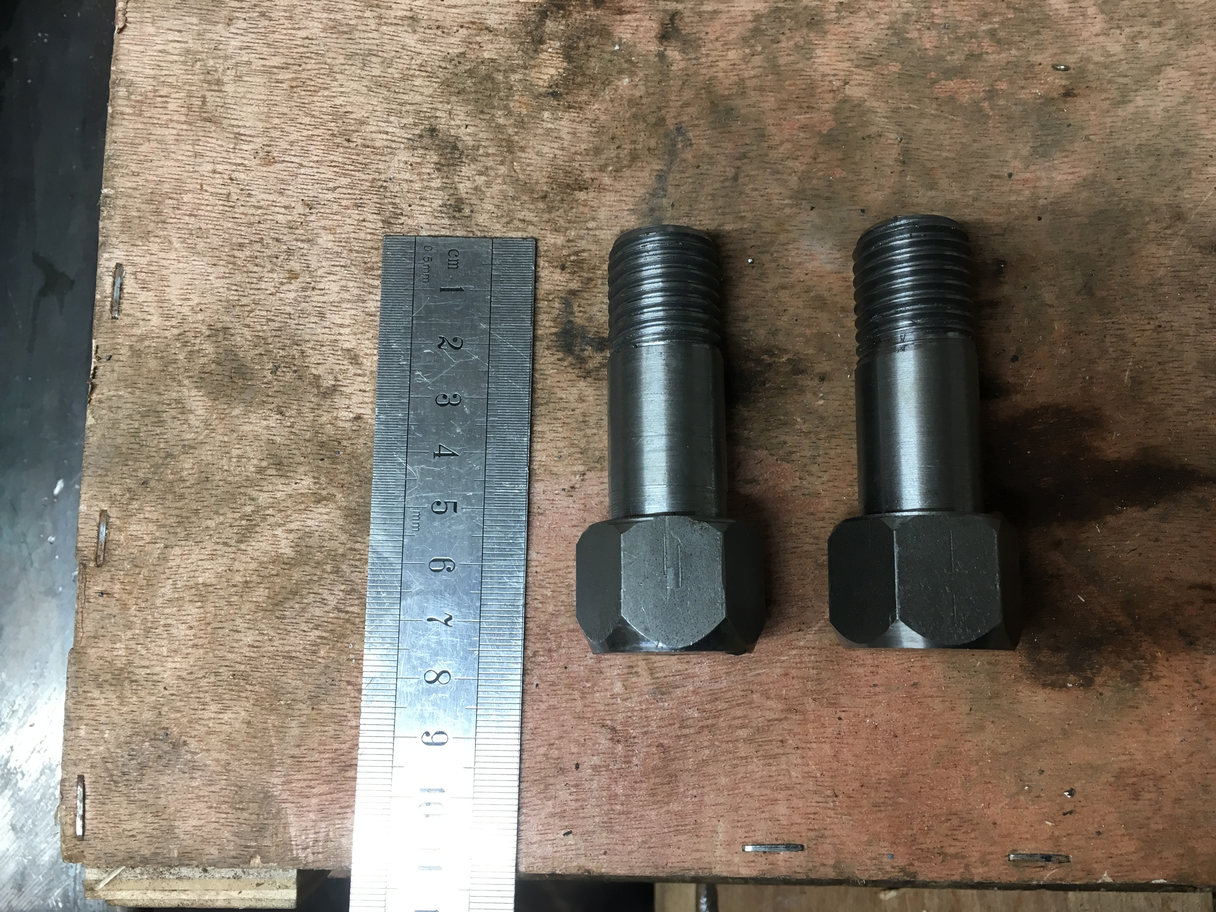

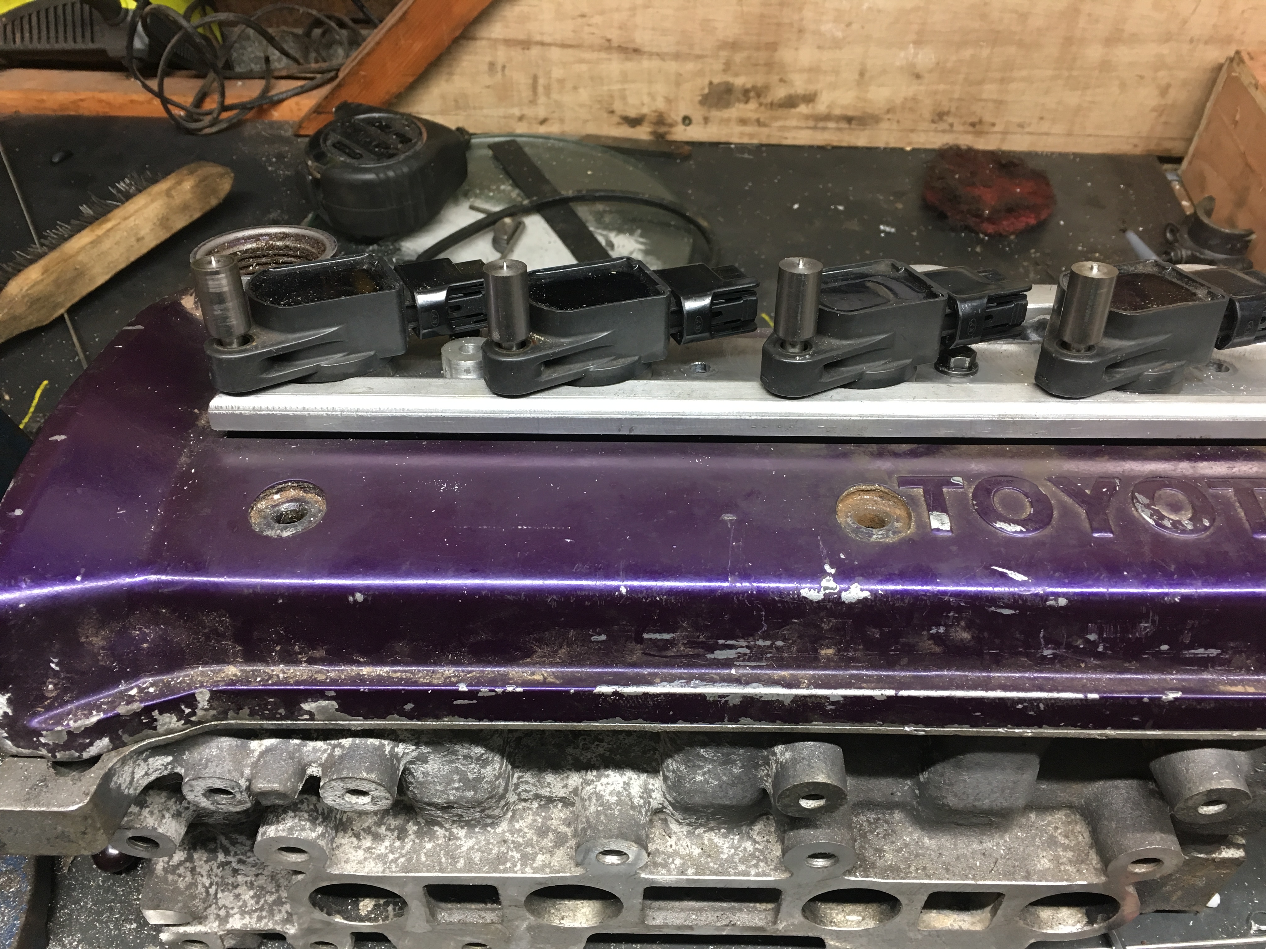

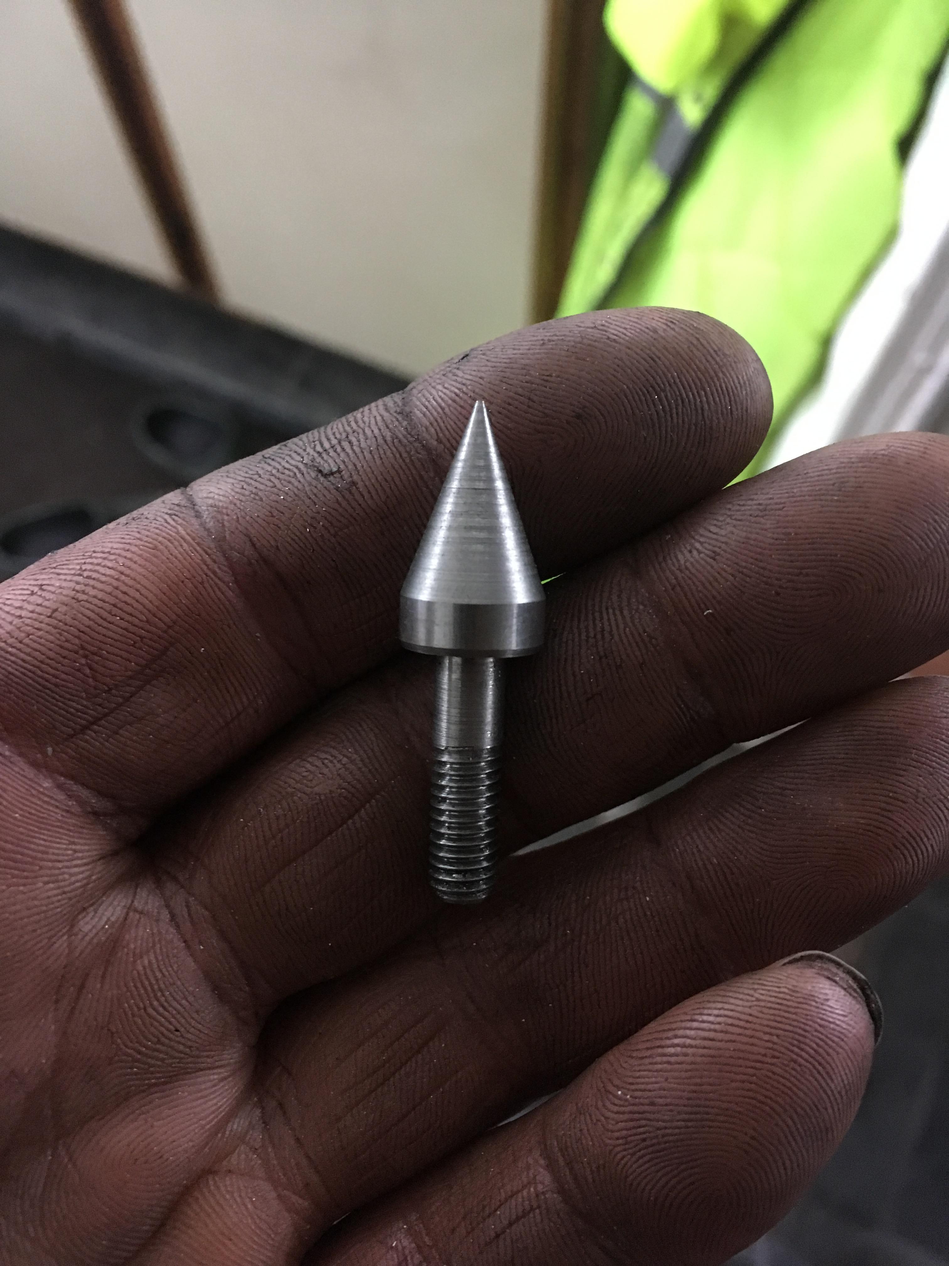

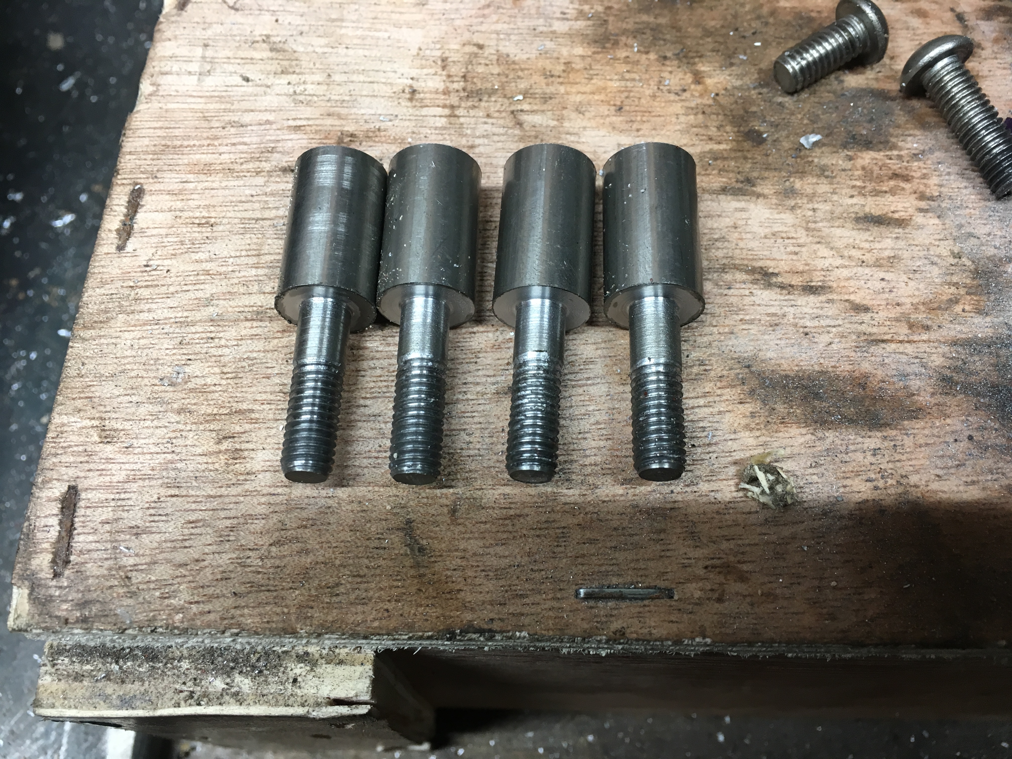

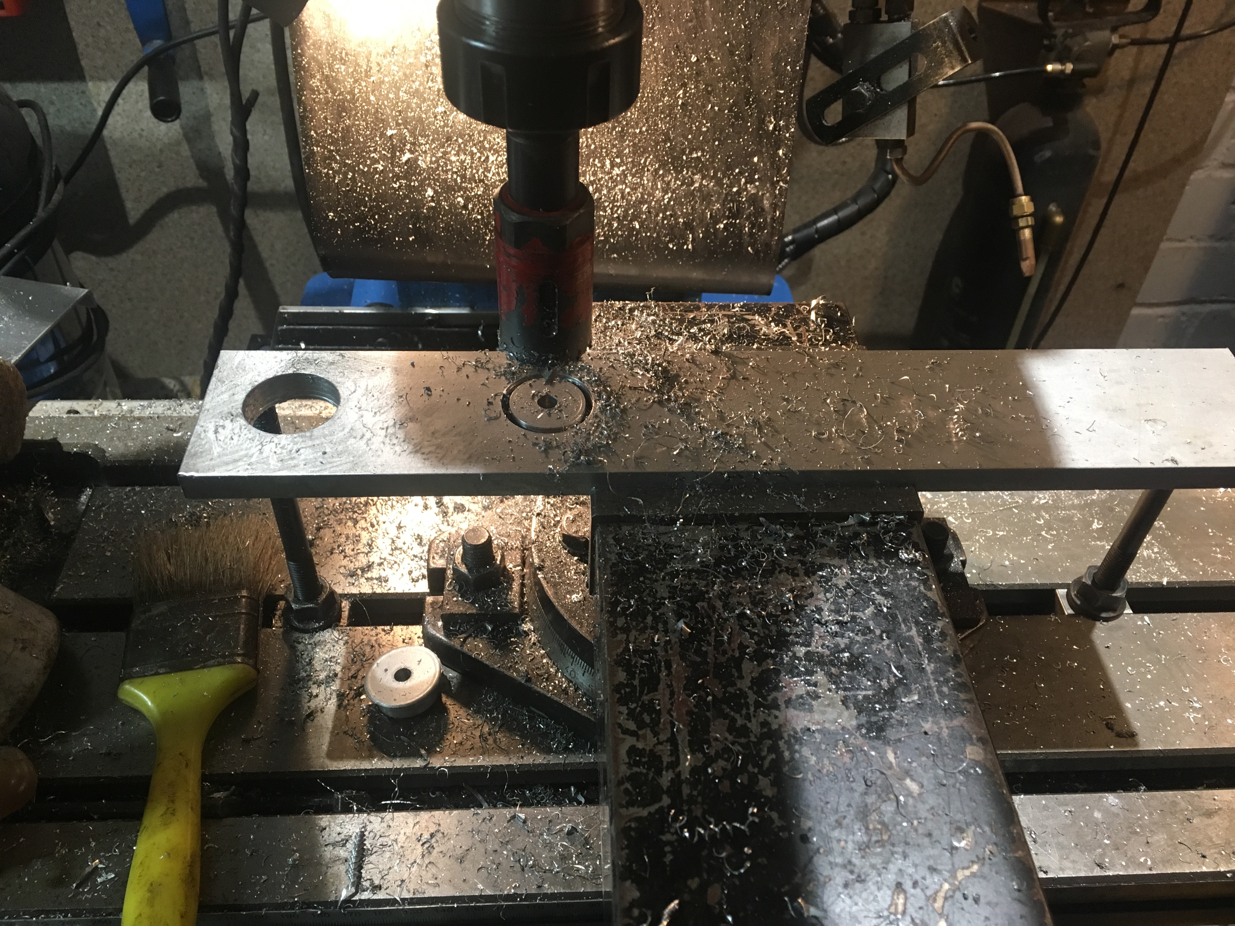

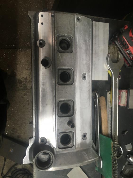

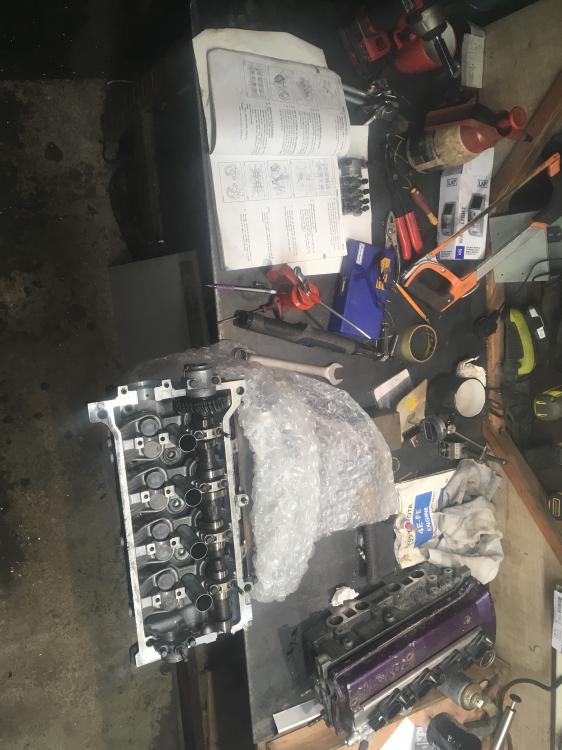

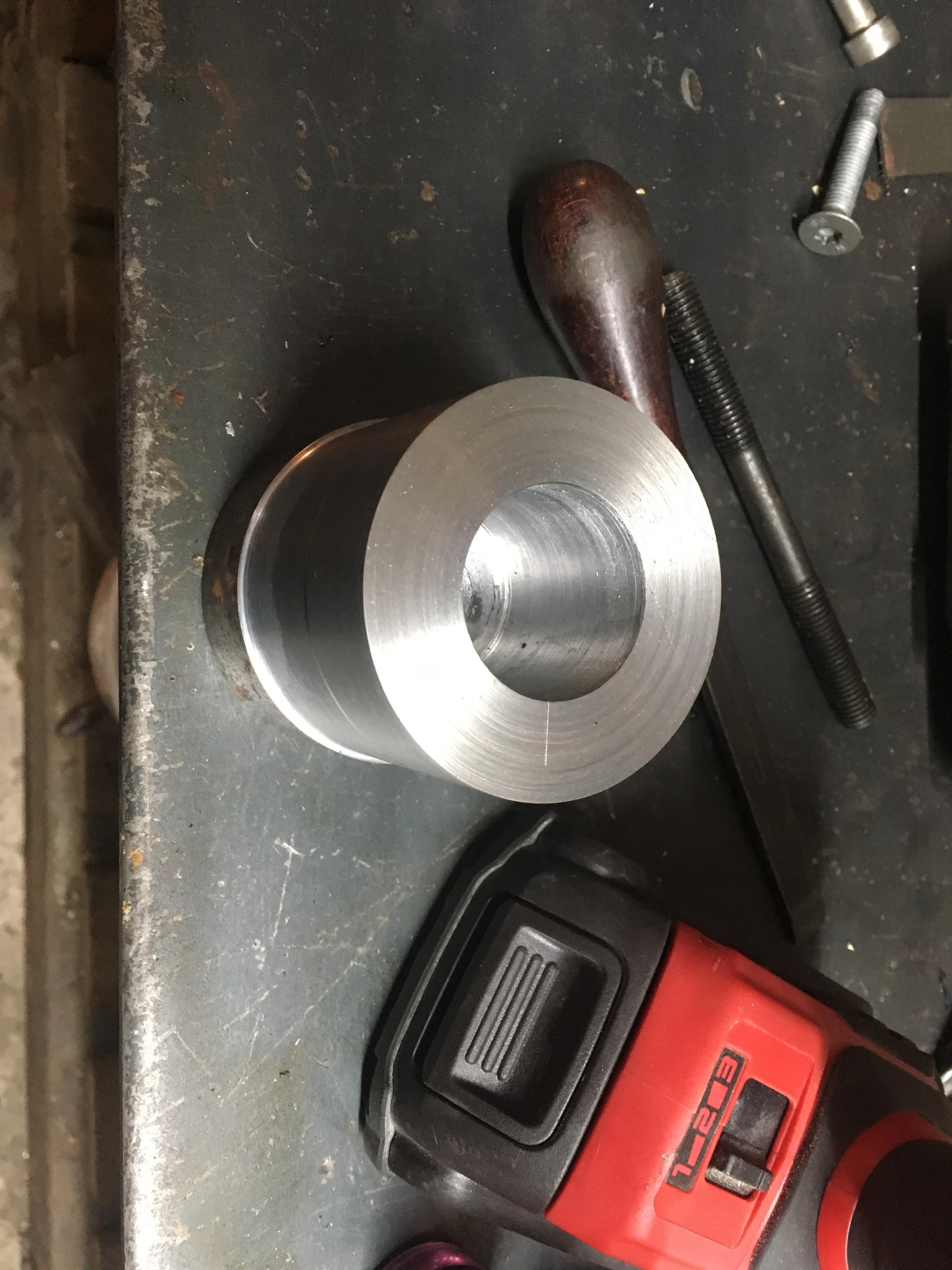

Got some more bits done! Made a new plate for the coil packs to mount on as someone seems to have stolen my last design :p, Ive made some nice spiked nuts and bolts too for the rocker cover and coils. The head is all built back up and the cruise cams shimmed to suite the fresh head! More updates to come soon!
