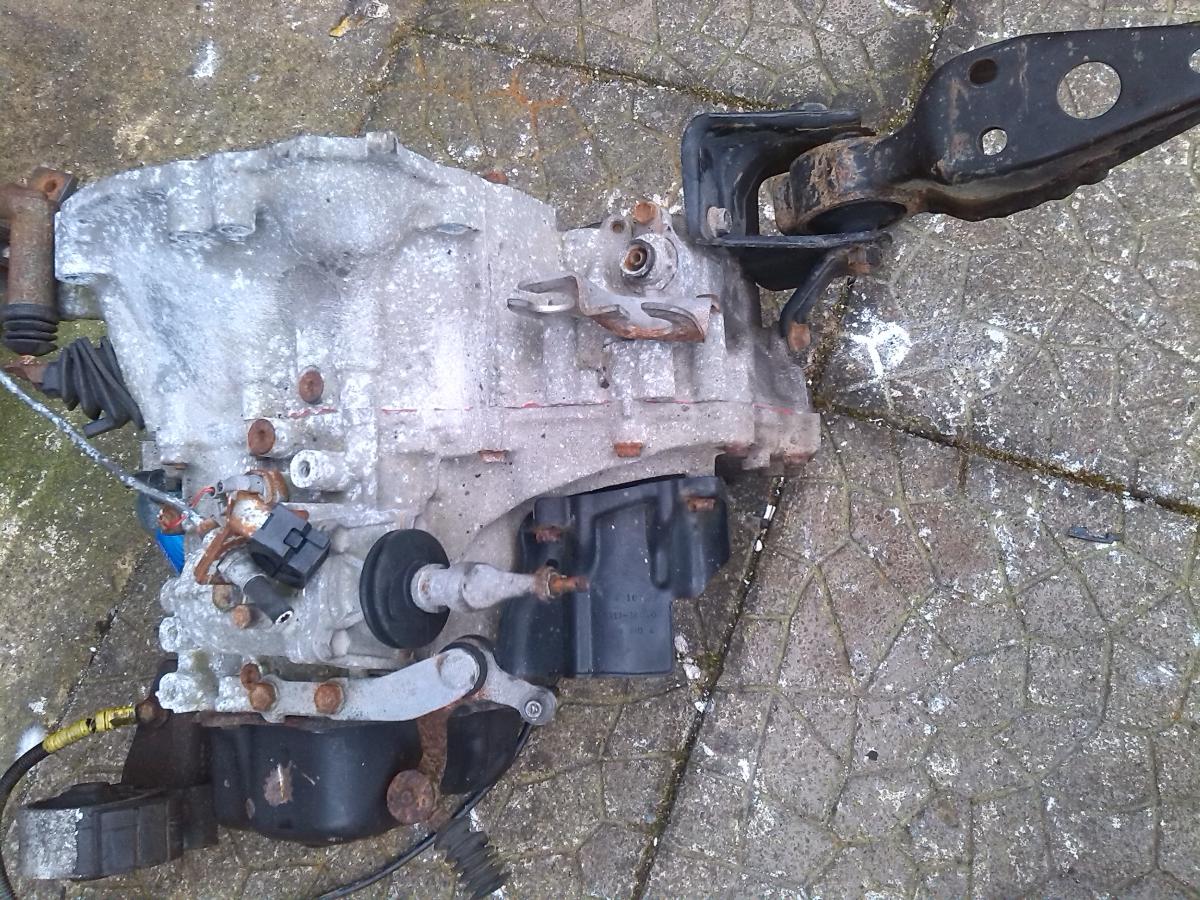

maddox710 Posted March 14, 2016 Posted March 14, 2016 Holy sheet, how many millions of miles on that box? Quote
5e colin Posted March 14, 2016 Author Posted March 14, 2016 not sure but its a scrapper box for sure must be more then 500k a DUD of a box waste of 100£ lets hope i can use the na box thats being dropped tomorow 5 weeks almost now without a car i just should of gone to the local scrappy and got a na box there on day 1 pffff Quote
Calum122 Posted March 15, 2016 Posted March 15, 2016 Not good! I think that is ready to be made into the coffee table. Quote
5e colin Posted March 15, 2016 Author Posted March 15, 2016 (edited) happy days just recieved my freebie spins smoothly and dont sound like grinding need a bit of a clean tho also not to fund on the higher rpms now brrr anyways better then nothing Edited March 15, 2016 by 5e colin Quote
5e colin Posted March 15, 2016 Author Posted March 15, 2016 everything na this box is from an ep91 na 97 c15@ something box doing 3300rpm at 62 mph ok upto 200bhp wich im beyond its limit im at 1.1bar hope i can score an affordable ( GOOD ) turbo box soon Quote
Calum122 Posted March 15, 2016 Posted March 15, 2016 But question is, what makes them weaker. And is there a way to strengthen them? Quote
maddox710 Posted March 16, 2016 Posted March 16, 2016 I know someone who had a n/a box on track car with 280bhp. It held up fine Quote
5e colin Posted March 16, 2016 Author Posted March 16, 2016 But question is, what makes them weaker. And is there a way to strengthen them? everything is weaker ( thinner ) to save weight Gears are thinner for a start indeed and diff is narrower shorter in/out shafts etc I know someone who had a n/a box on track car with 280bhp. It held up fine that sounds reassuring aslong as it lasts till my oem lsd is fixed then im happy with it :) Quote
Sudden Posted March 26, 2016 Posted March 26, 2016 Take your time shifting and you'll be fine. Selector forks and shafts, can be iffy. Gear width won't brother you till you are putting down lots of torque throughout decent tyres. N/A boxes have final drive ratios ranging from 4.312, 3.546 and there maybe a 3.700( labeling key changed between 95-96 starlets and tercels, so difficult to say for certain. Quote

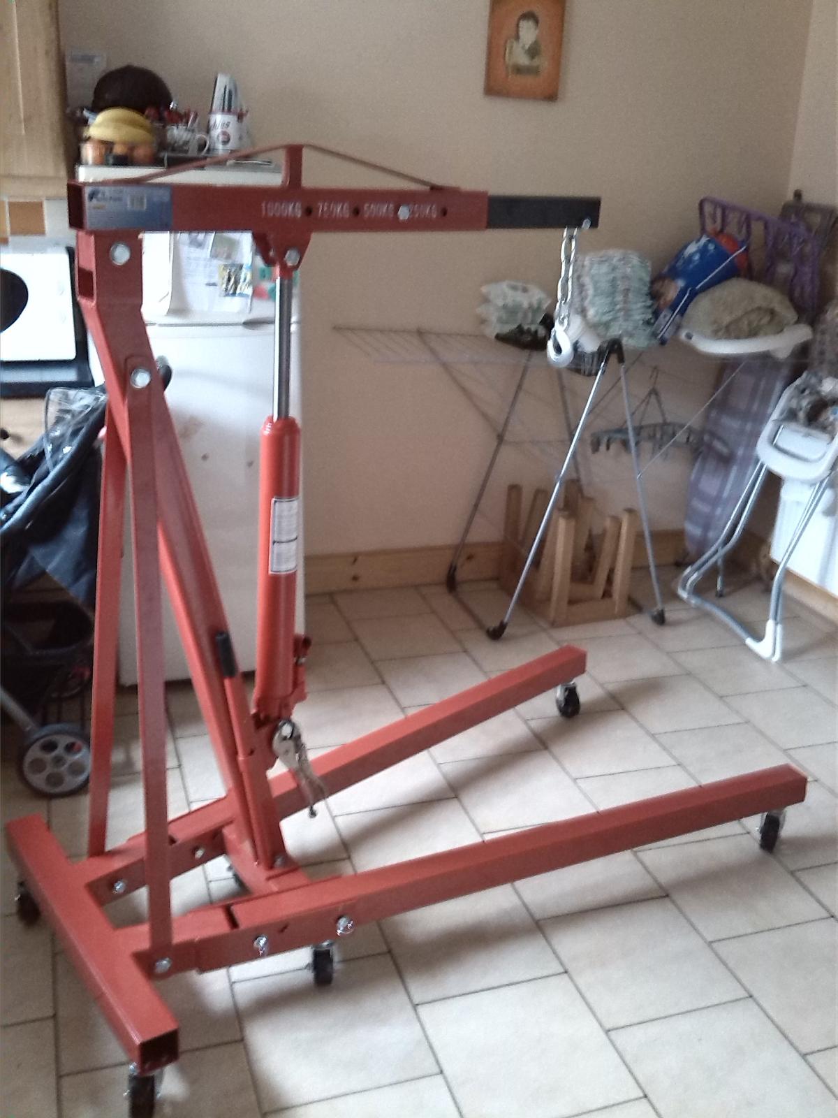

5e colin Posted April 1, 2016 Author Posted April 1, 2016 (edited) so got myself some helping hands , im getting to old now to be lying in the street under the car installing engines and gearboxes its not like im 30 anymore ha ha anyways wasnt a bad price 108£ at the door soon my car be driving again Edited April 1, 2016 by 5e colin Quote

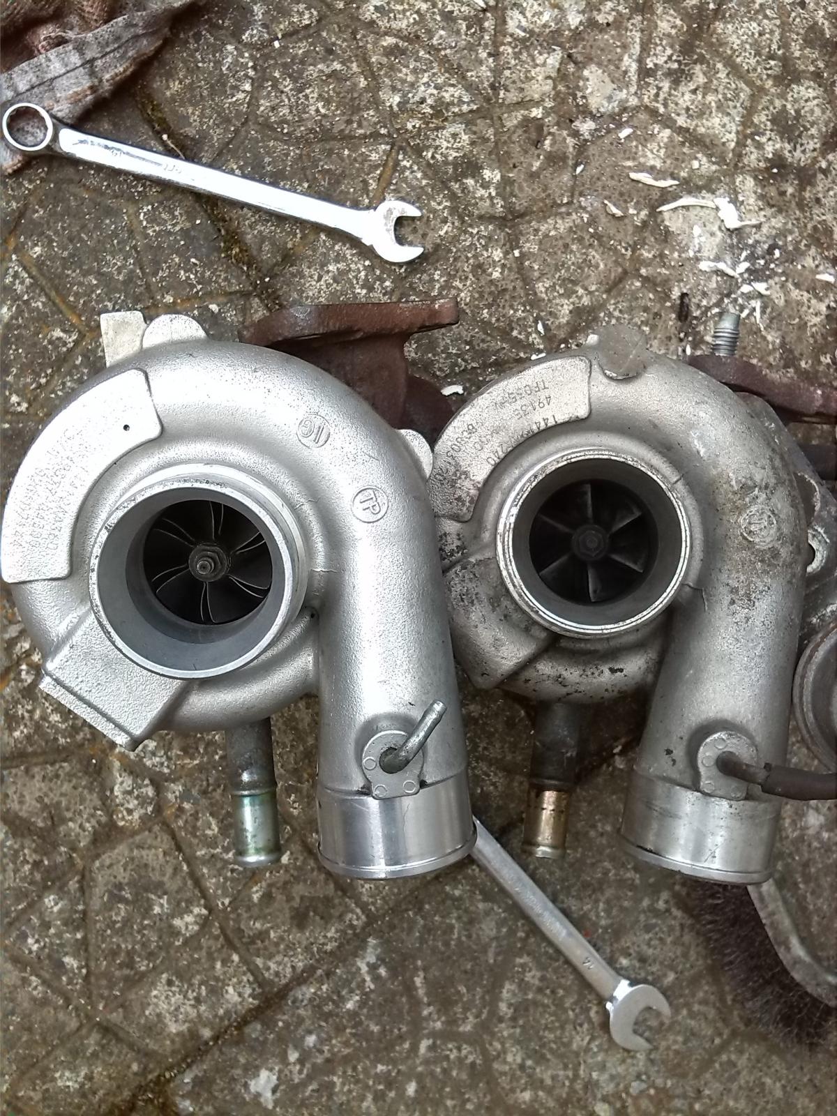

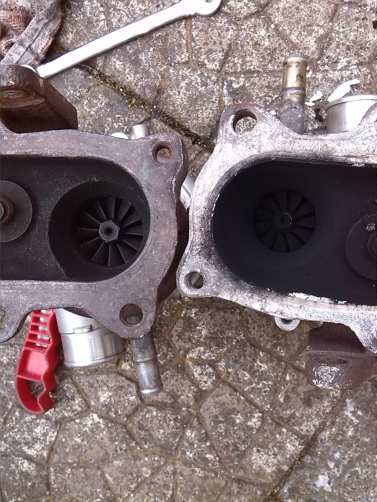

5e colin Posted May 3, 2016 Author Posted May 3, 2016 (edited) just to show some interesting finds between the tfo35hm and a tdo4l both use same size compressor wheel and housing but proppelers have diferent design the exhaust propeller is way bigger in the tdo4l making her spool a lot later after instaling the tdo4l and using the same actuator as was on my tfo35hm at 1.1 there isnt that much of a difernce in pull only to make my power band smaller will see how it performes when i get a uprated intake manifold to use more revs again Edited May 3, 2016 by 5e colin Quote

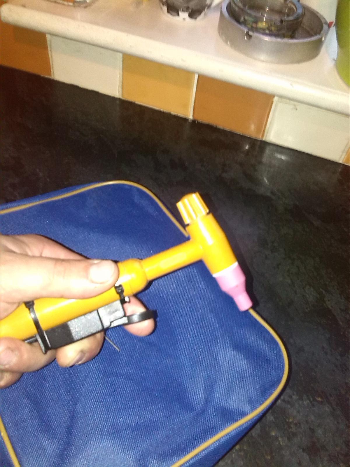

5e colin Posted May 9, 2016 Author Posted May 9, 2016 (edited) time to get friendly with my new toy lets go practise :) Edited May 9, 2016 by 5e colin Quote
richardc9052 Posted May 9, 2016 Posted May 9, 2016 (edited) Did you get gas? I went to my local and they do stargas. 130 for 7liter pure argon and then 50 for top up. Ordered my tig too Edited May 9, 2016 by richardc9052 Quote
5e colin Posted May 10, 2016 Author Posted May 10, 2016 mine is 75 yearly rental 55 top up ( boc ) your botle is a 1 off payment and its yours i need to get some wider pink bits as the nozzle is so tiny brrr ( whats it called ? ) Quote

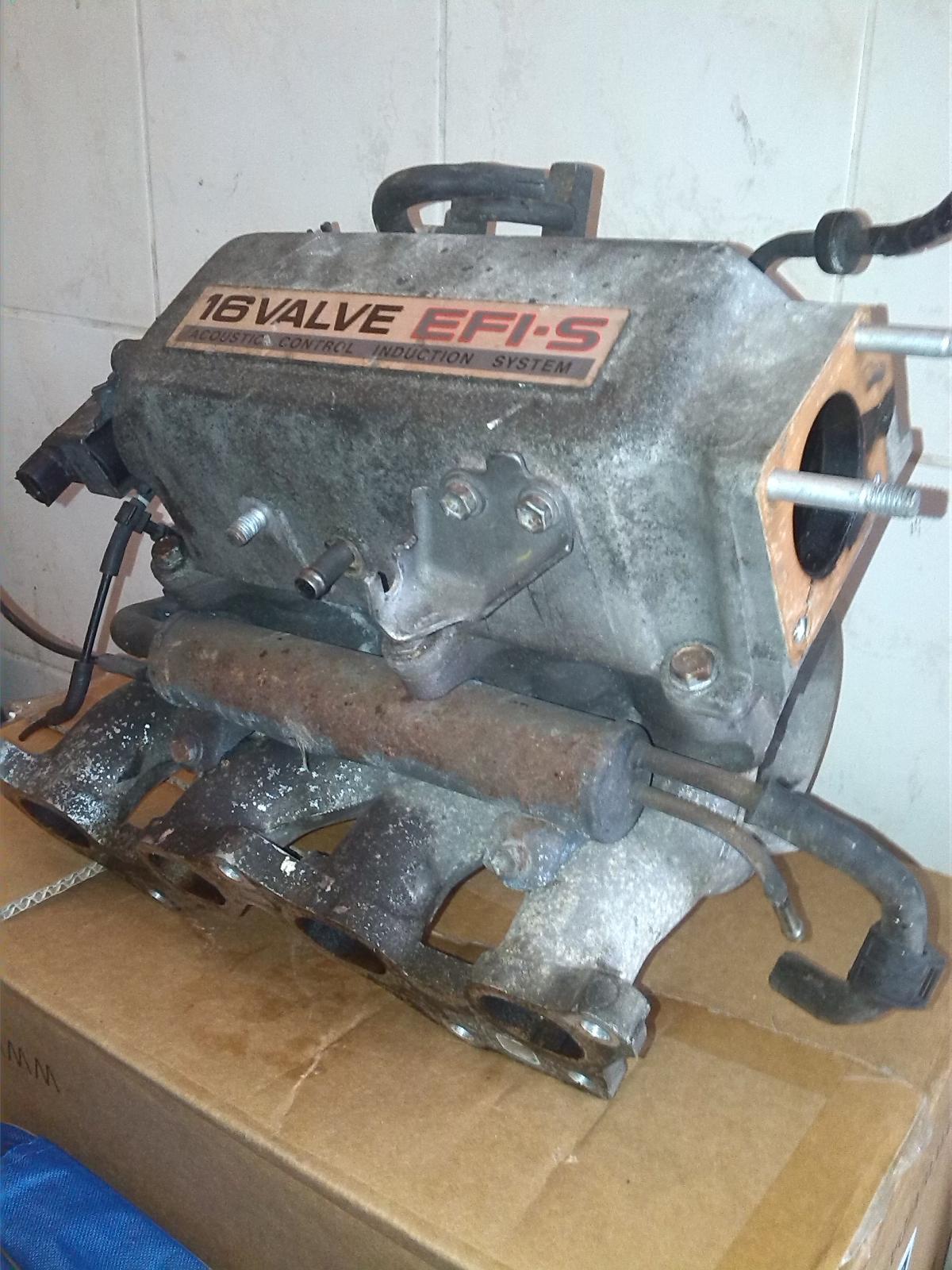

5e colin Posted May 10, 2016 Author Posted May 10, 2016 (edited) happy days my acis just landed ( wont be selling this 1 thats for sure ) plans are to clean it up get plate welded on for a 60mm throttle body Edited May 10, 2016 by 5e colin Quote
