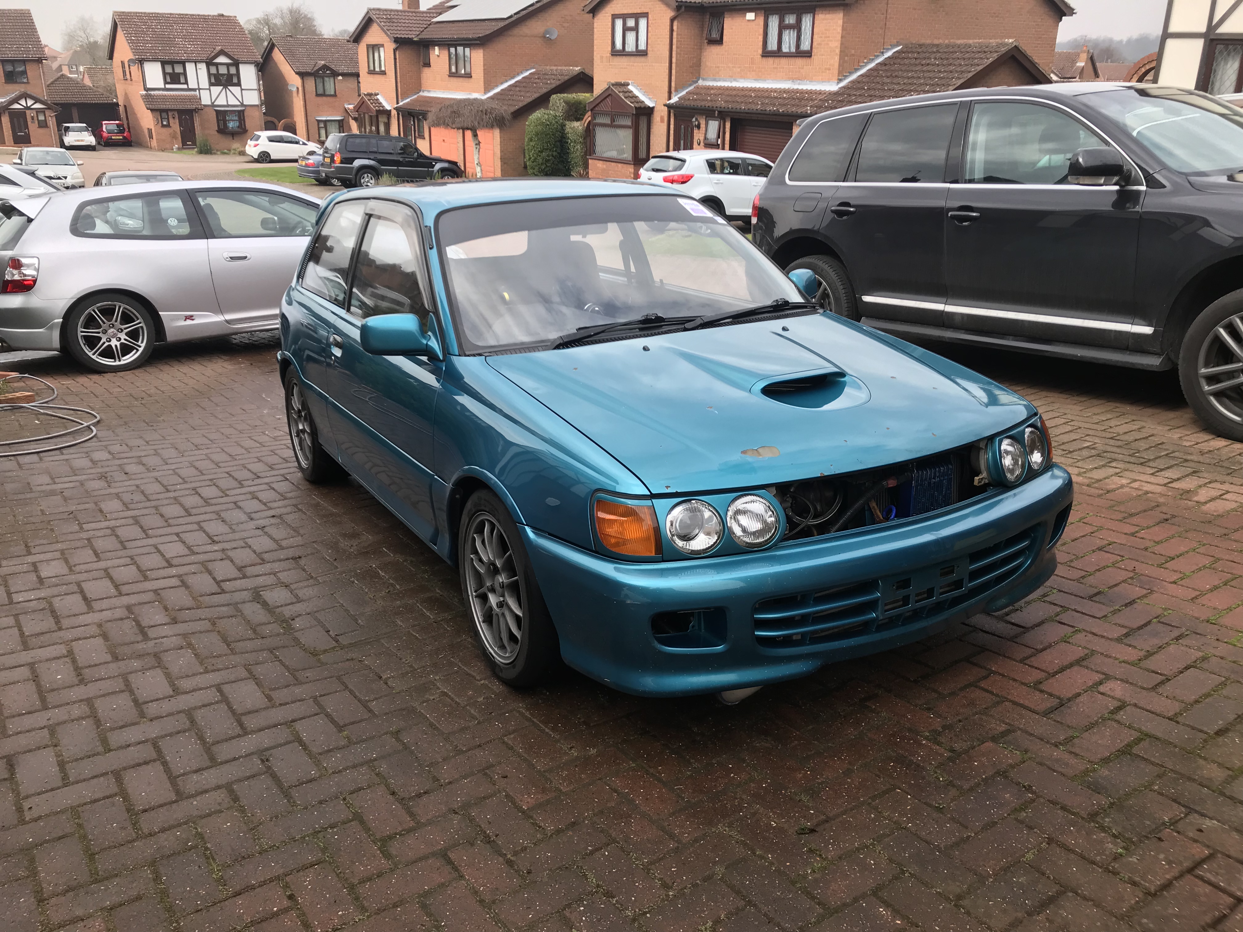

So gave the thing a bath.
post-2707-0-37950100-1496918935_thumb.jp

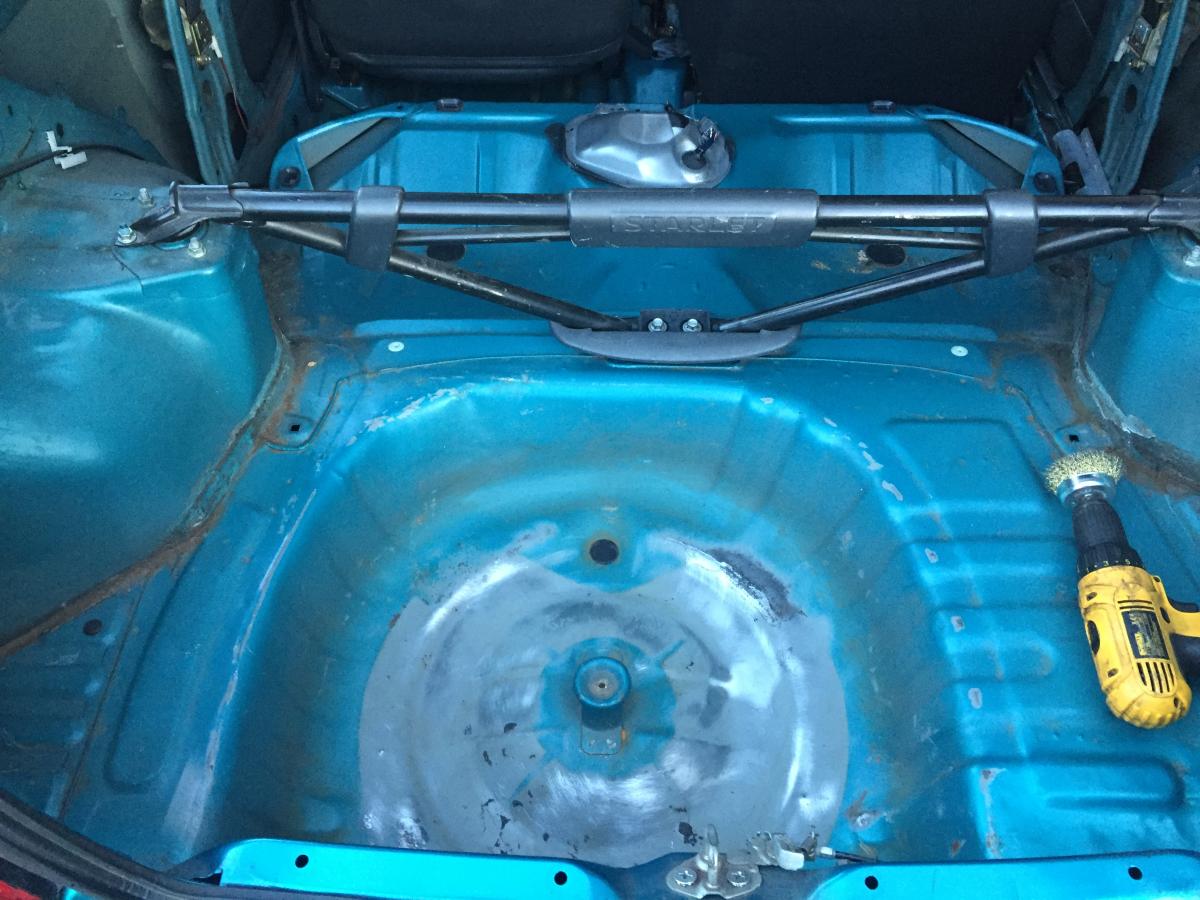

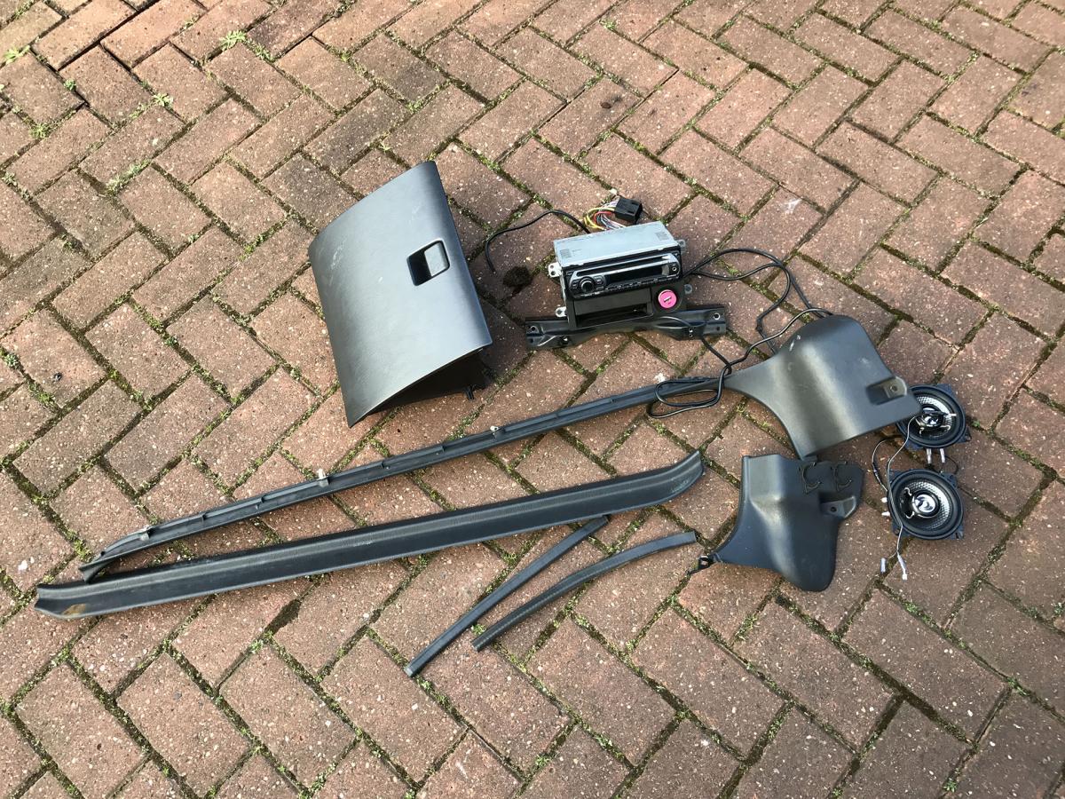

So weight saving started!

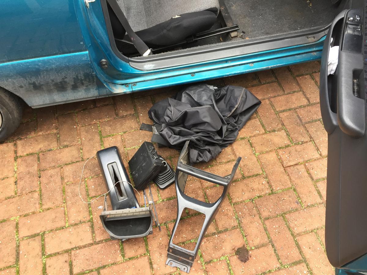

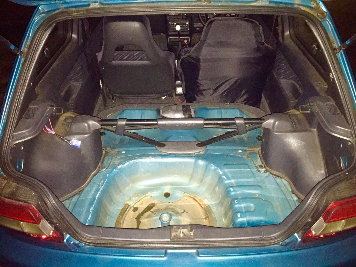

post-2707-0-19111500-1496919178_thumb.jp
post-2707-0-46145800-1496919187_thumb.jp
post-2707-0-01067500-1496919226_thumb.jp

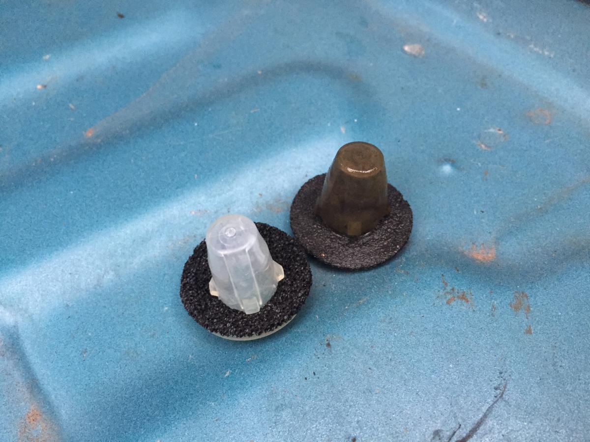

Once stripped, noticed a water leak into the boot. Was coming from the rear lights....
post-2707-0-06649900-1496919335_thumb.jp
New Seals
post-2707-0-48430400-1496919350_thumb.jp

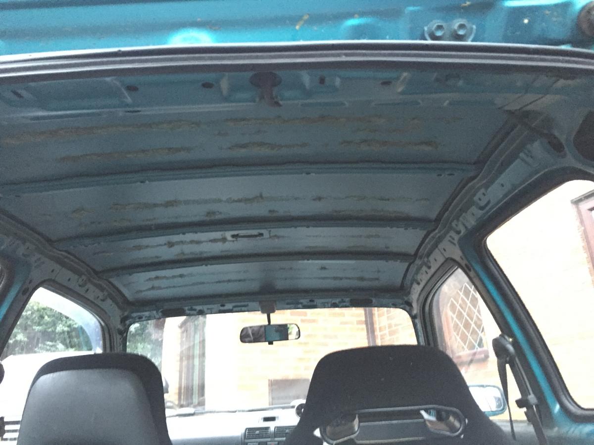

Then some sound deadening removal.
post-2707-0-88246800-1496919431_thumb.jp
Ill get this painted inside at some point!

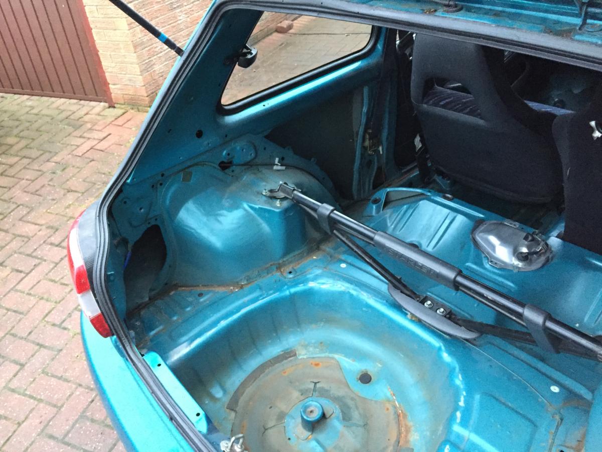

Rear Wiper Gone:
post-2707-0-92487000-1496919524_thumb.jp

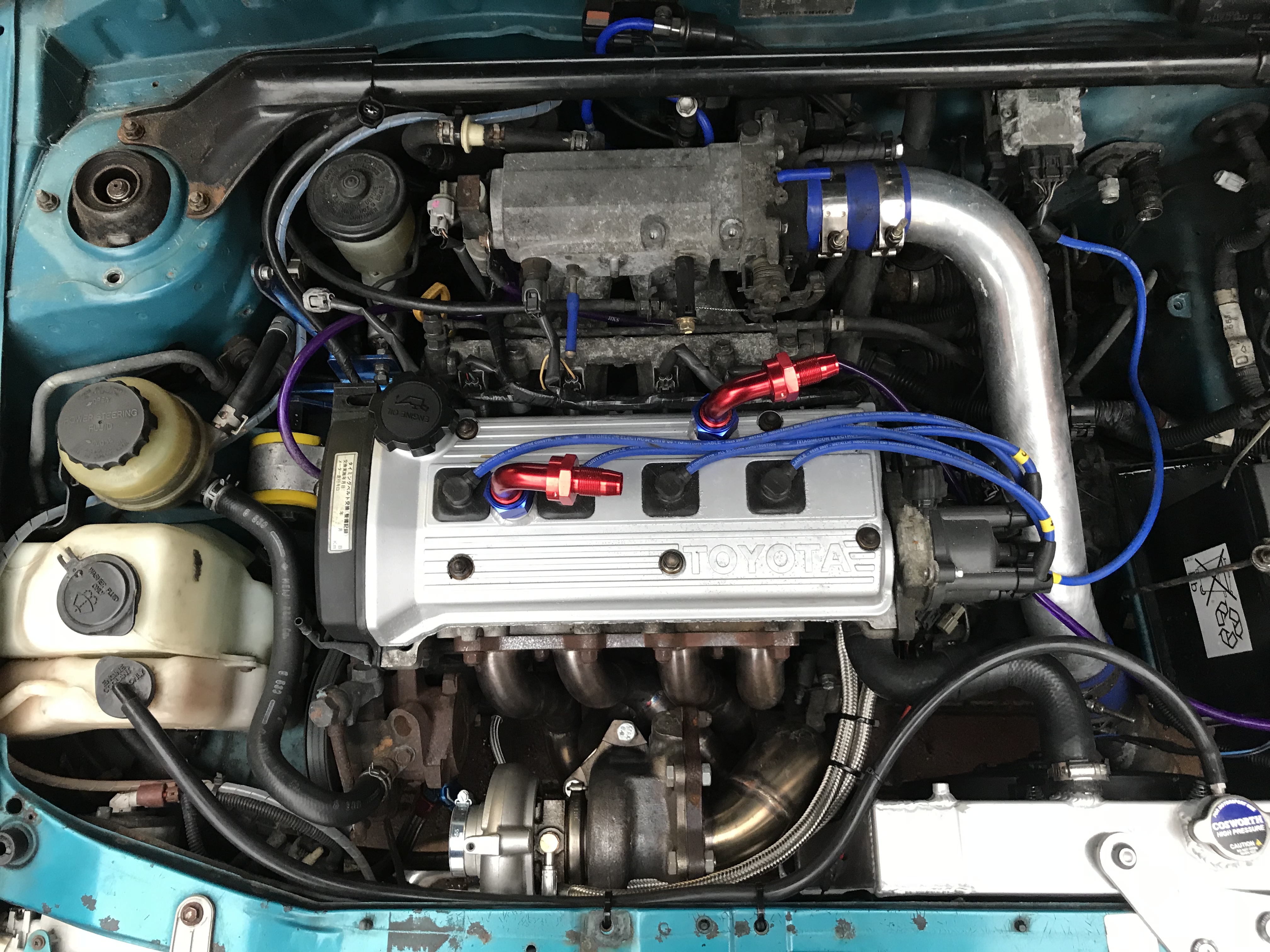

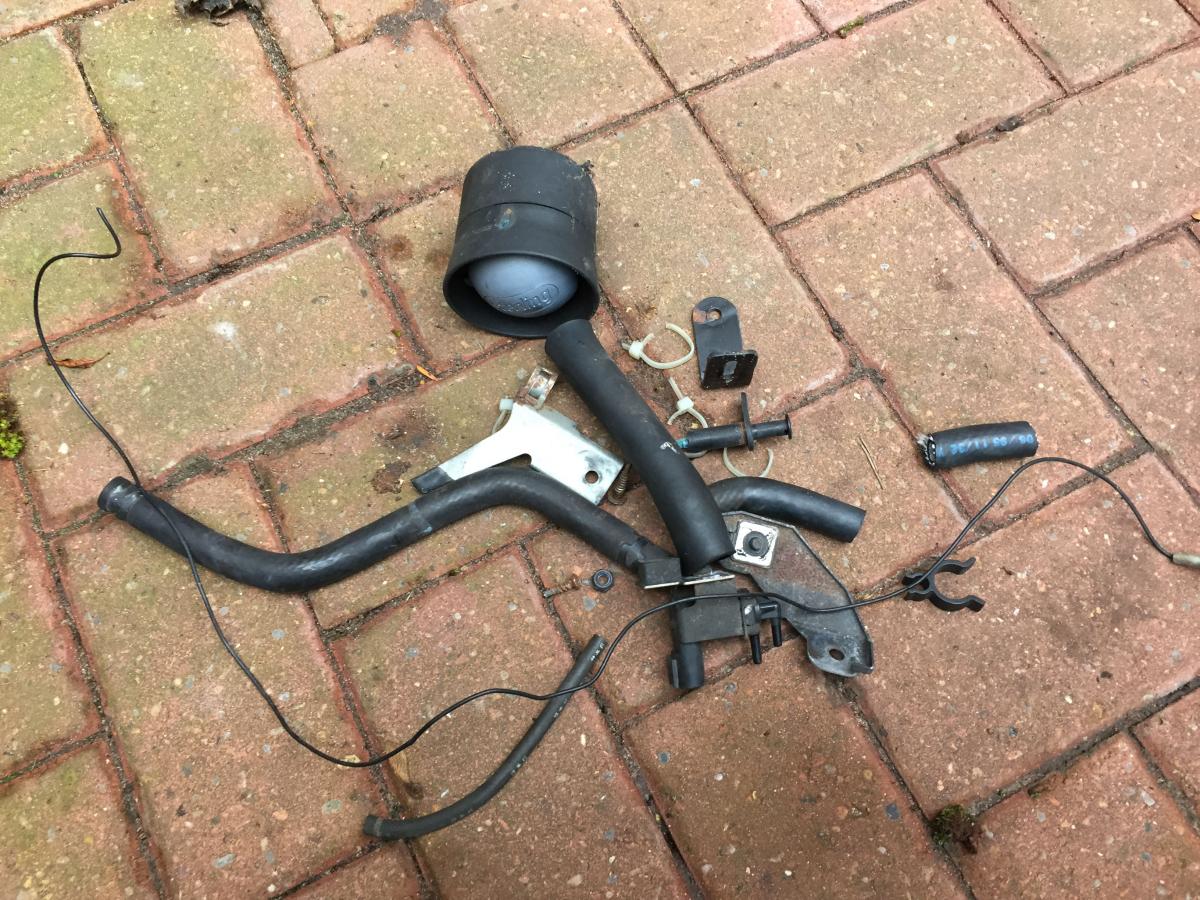

More Engine Bay Shite, including ancient alarm (I have immobilised the car in a different way)
post-2707-0-01827100-1496919575_thumb.jp

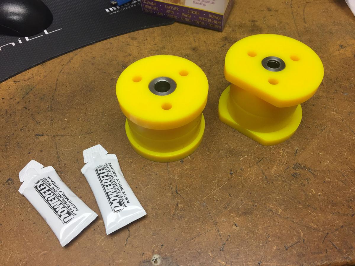

Fitted the other 2 Powerflex Polybushed mounts and some Magnecore HT Leads.
post-2707-0-98550000-1496919905_thumb.jp
post-2707-0-97536200-1496919930_thumb.jp

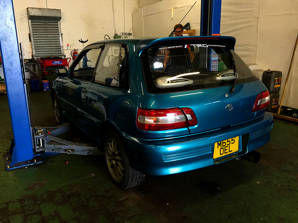

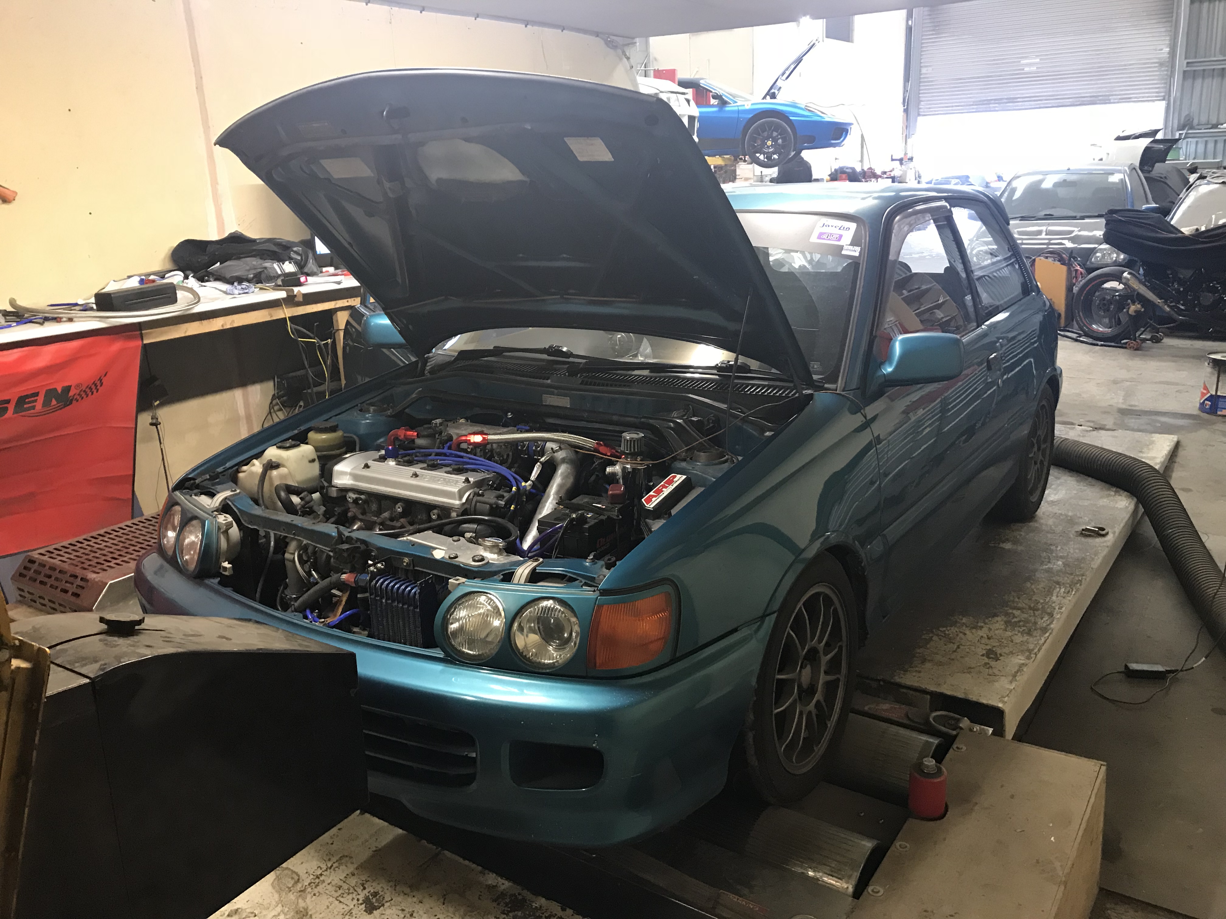

Then finally, a trip to see Nick & Mike @ TD to get this fitted:
post-2707-0-14157200-1496920028_thumb.jp
The car made 185.0bhp at 1bar.

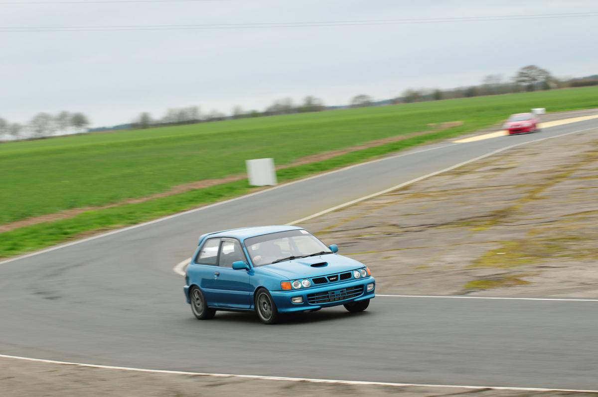

Then it was time for Blyton Park again!
post-2707-0-80432200-1496920464_thumb.jp
post-2707-0-42485900-1496920314_thumb.jp

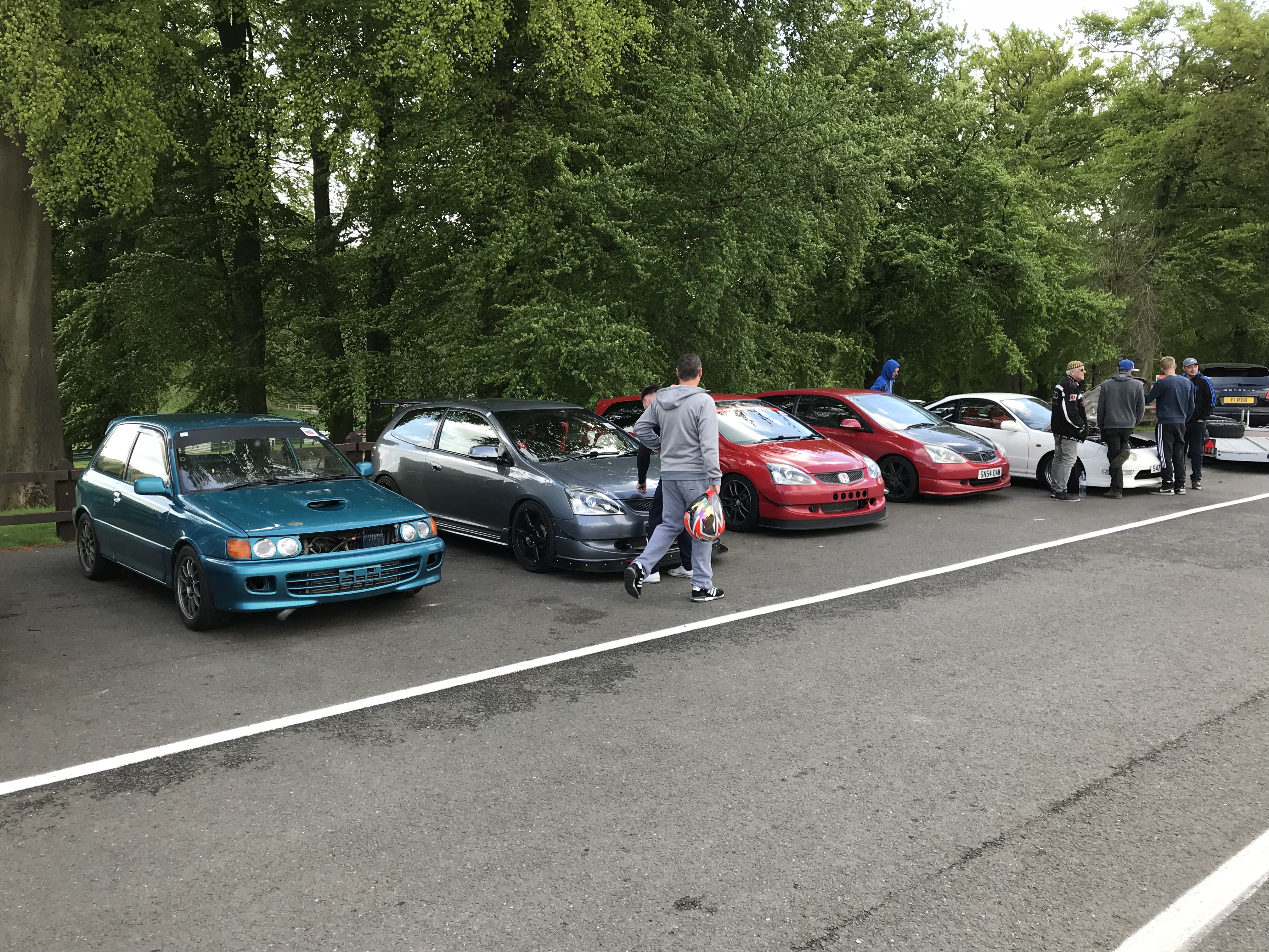

Got 2 very close mates who I do track time with who have Ep3's that are tweaked to a pretty high standard!
Had a great day, was a nice cool day. Had no troubles all day. It was very hard work to try and stay with the ep3, but considering money spent, certainly cant complain!

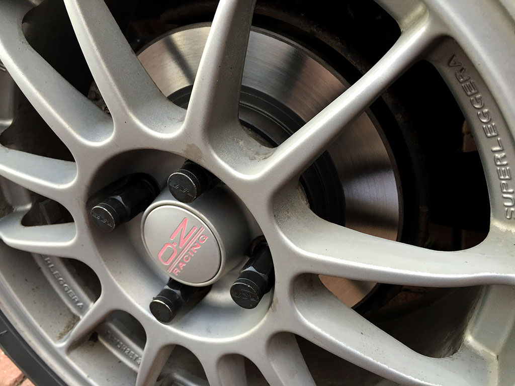

So, before the 3rd track day this year, the car needed some improvements!

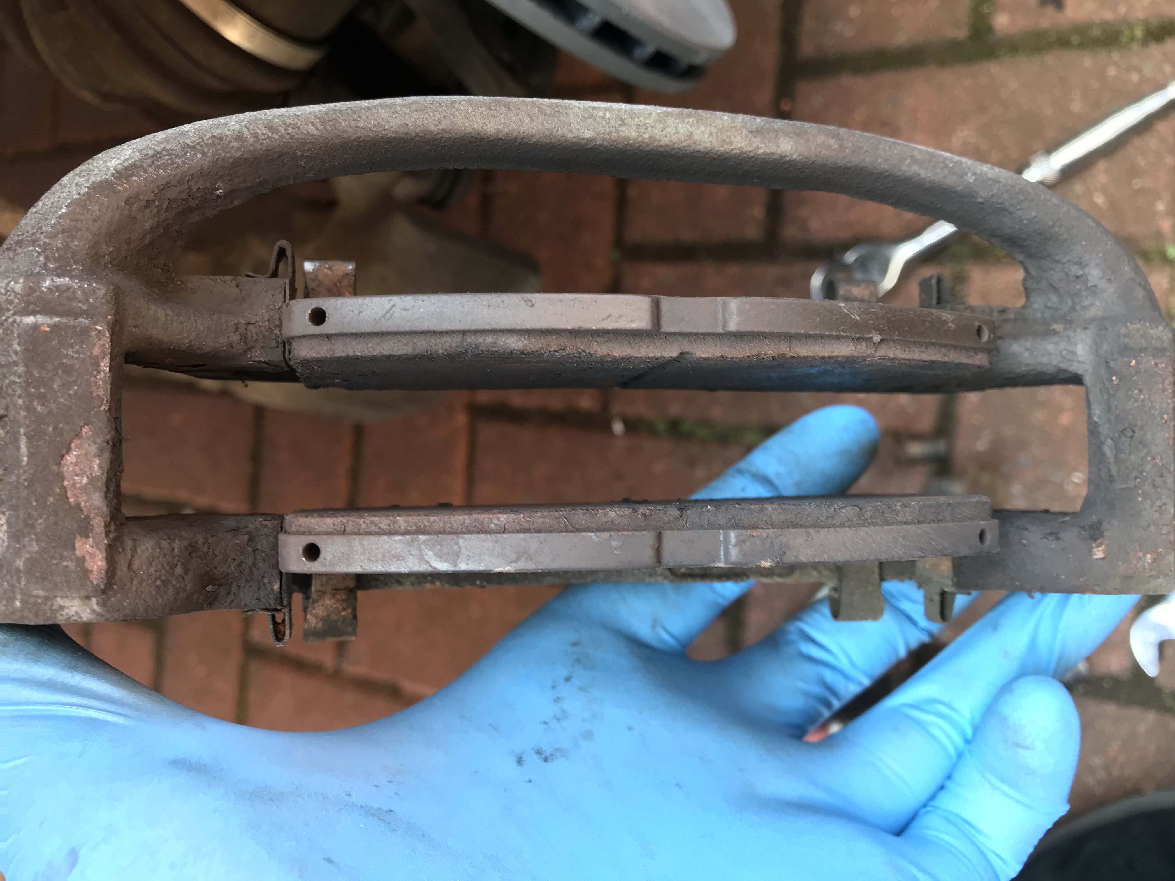

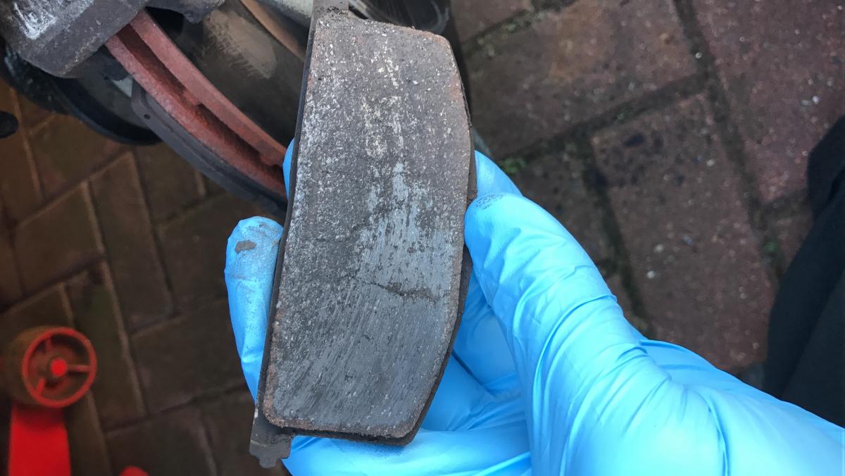

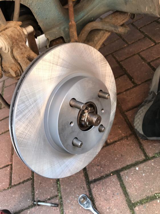

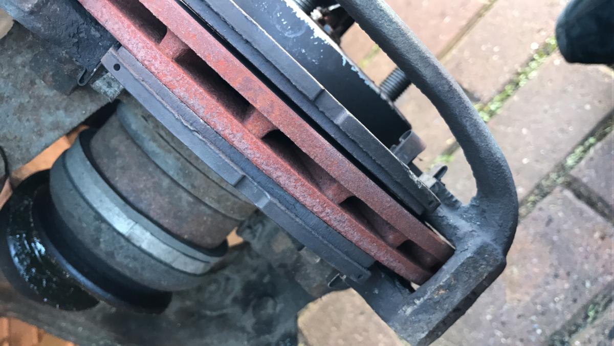

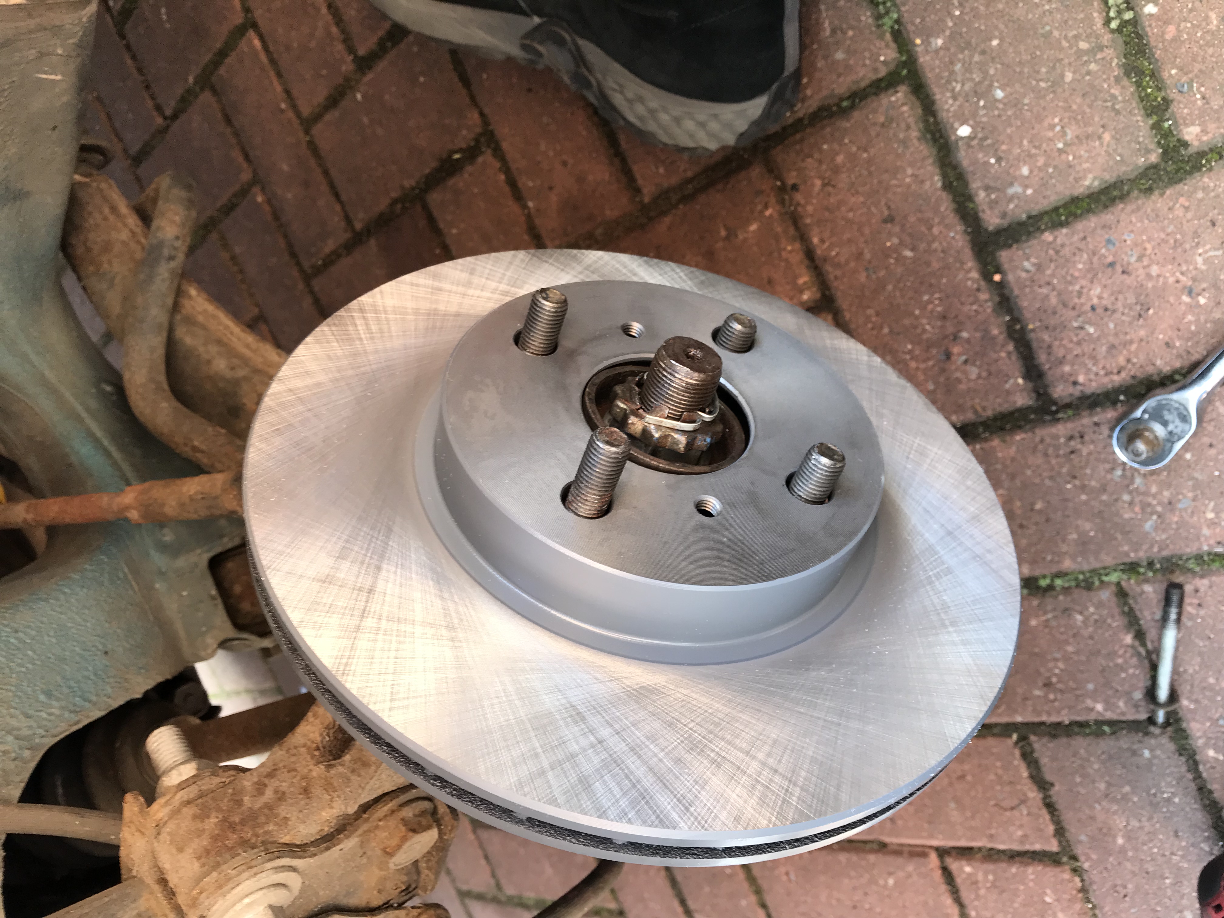

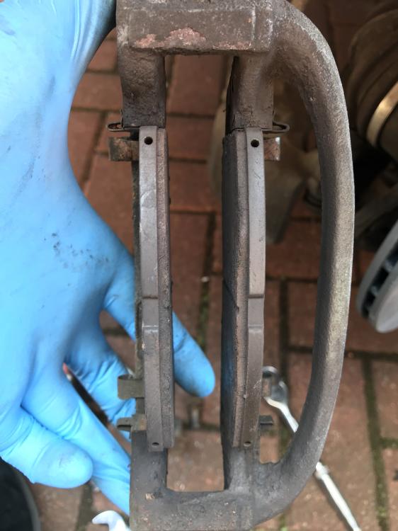

First off being Brakes. The stock Toyota Brakes were great on track but after a day, they sounded dreadful, it had taken its toll! They wouldn't have done another....
post-2707-0-70744700-1497003811_thumb.jp
post-2707-0-52981400-1497003818_thumb.jp
The discs were fine and in good condition. but the pads not so much!
So thanks to Amjad....
post-2707-0-17186200-1497003883_thumb.jp
The noises went away and these things are shockingly shit when cold but when up to temp.... Jeez.
You can feel the back go light, more then enough power to lock the front wheels completely. Even on semi slicks up to temp too!

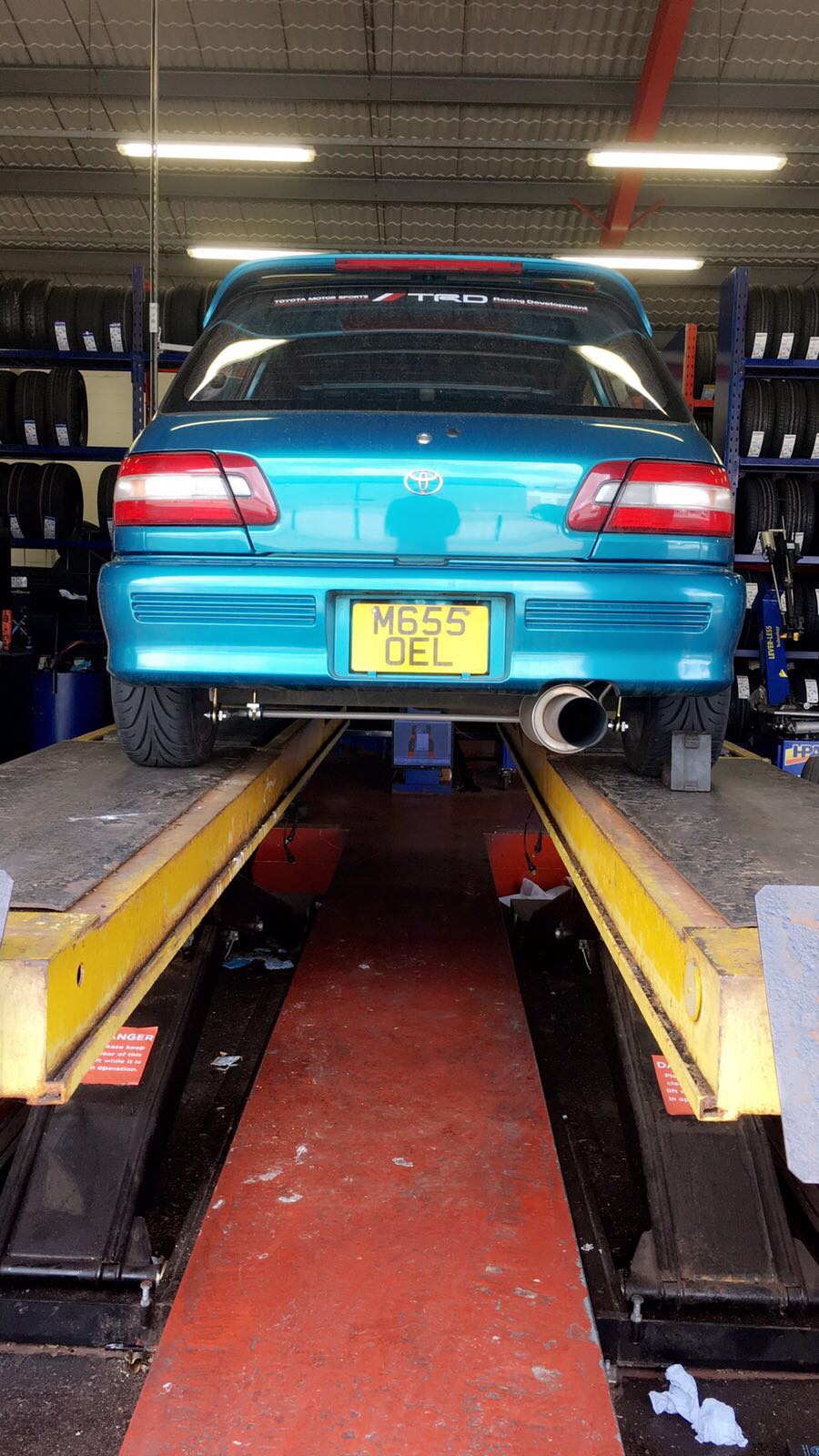

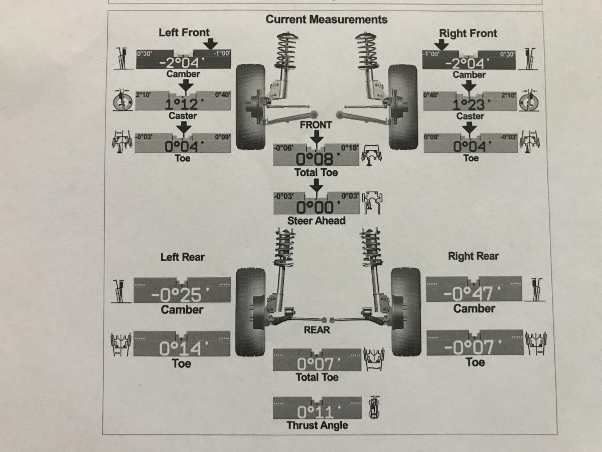

Then had the whole thing setup to my preferences at a local KwikFit on a Tiger Laser Align.
post-2707-0-53435800-1497004305_thumb.jp
Opted for No Toe Angle and -2deg front camber.
These changes made a huge difference to the cars behaviour that is for sure.
post-2707-0-71979900-1497004316_thumb.jp

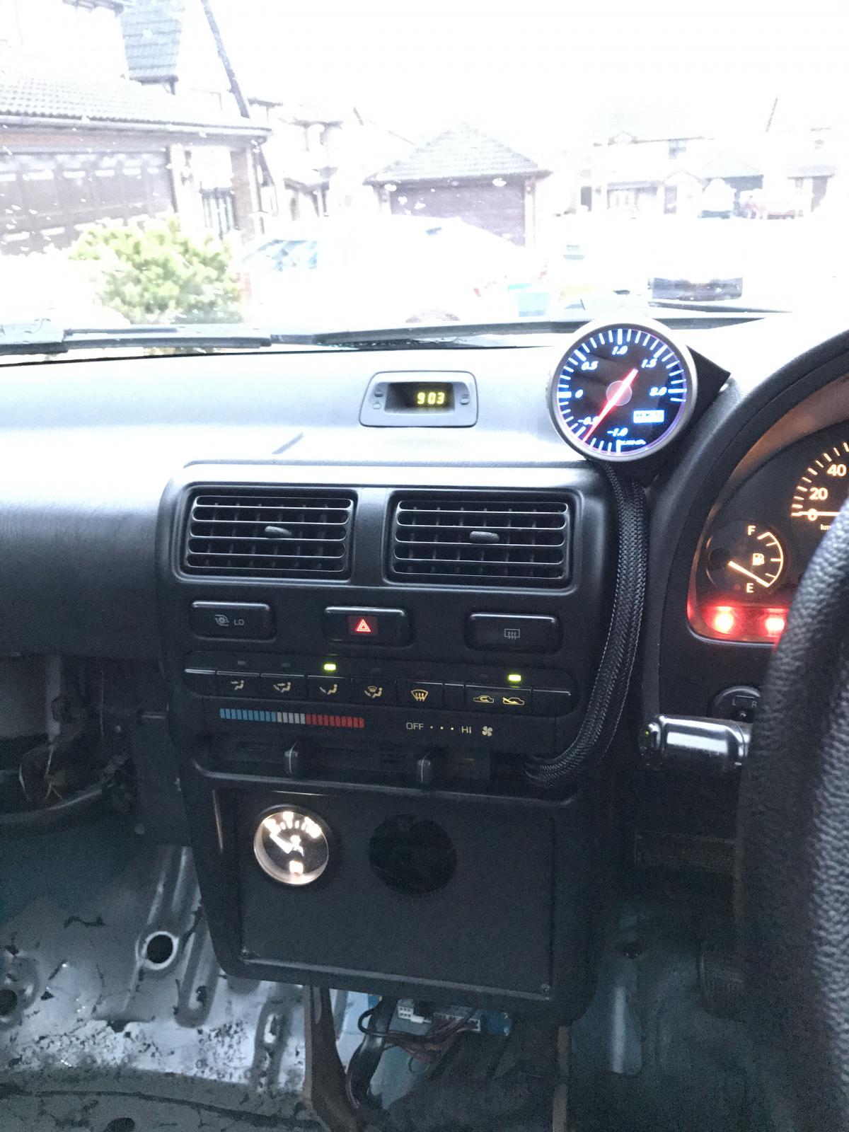

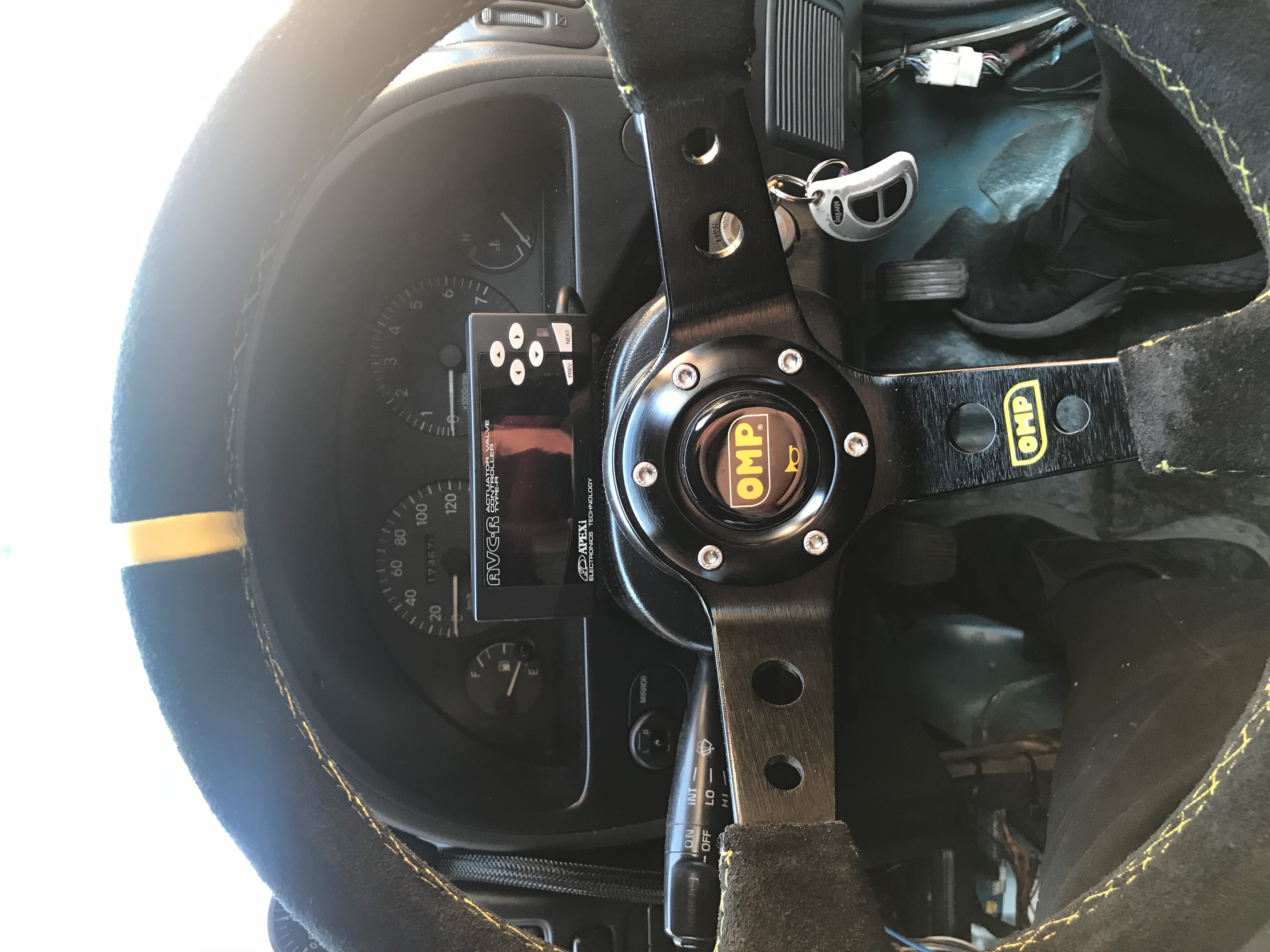

Then to keep an eye on things. Stack Oil Temp Gauge in a custom mounting plate...
post-2707-0-24807200-1497004494_thumb.jp
This would reveal an issue on the next track day where thanks to a heat spell of 30deg ambient. Oil temps were getting worrying!

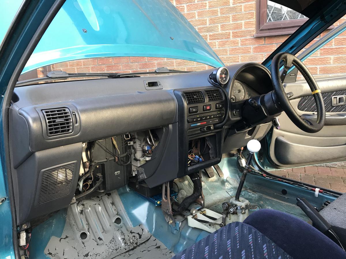

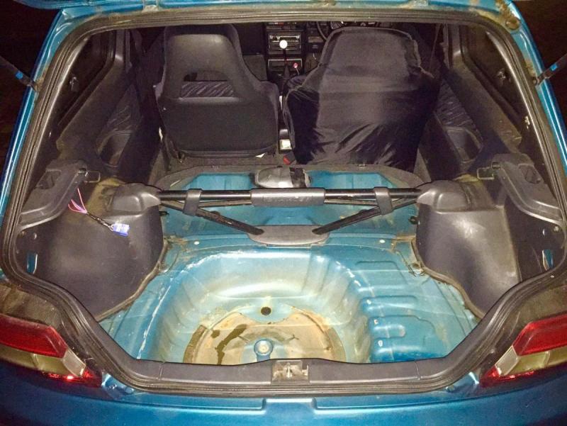

Bit more weight saving:
post-2707-0-28874100-1497004667_thumb.jp
Cabin looking proper now.
post-2707-0-30212800-1497004690_thumb.jp

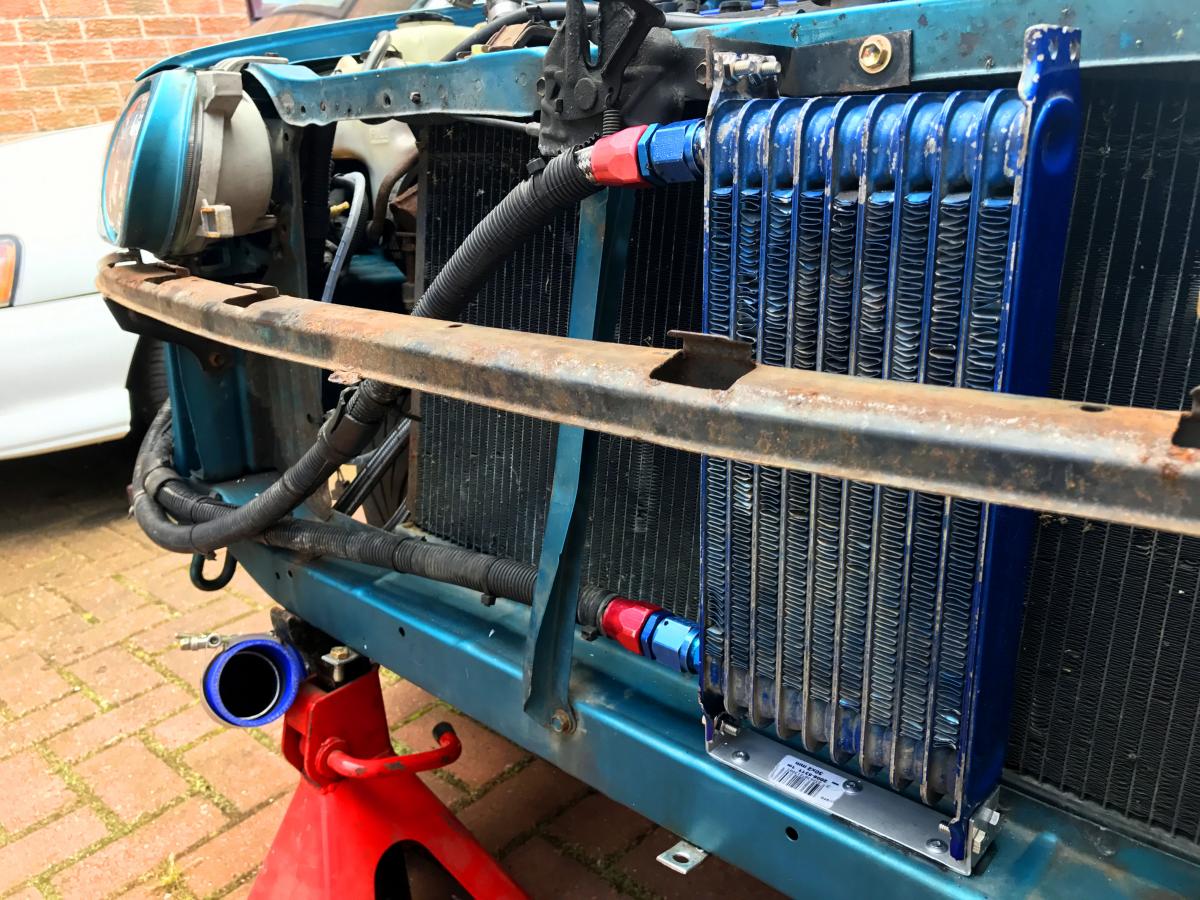

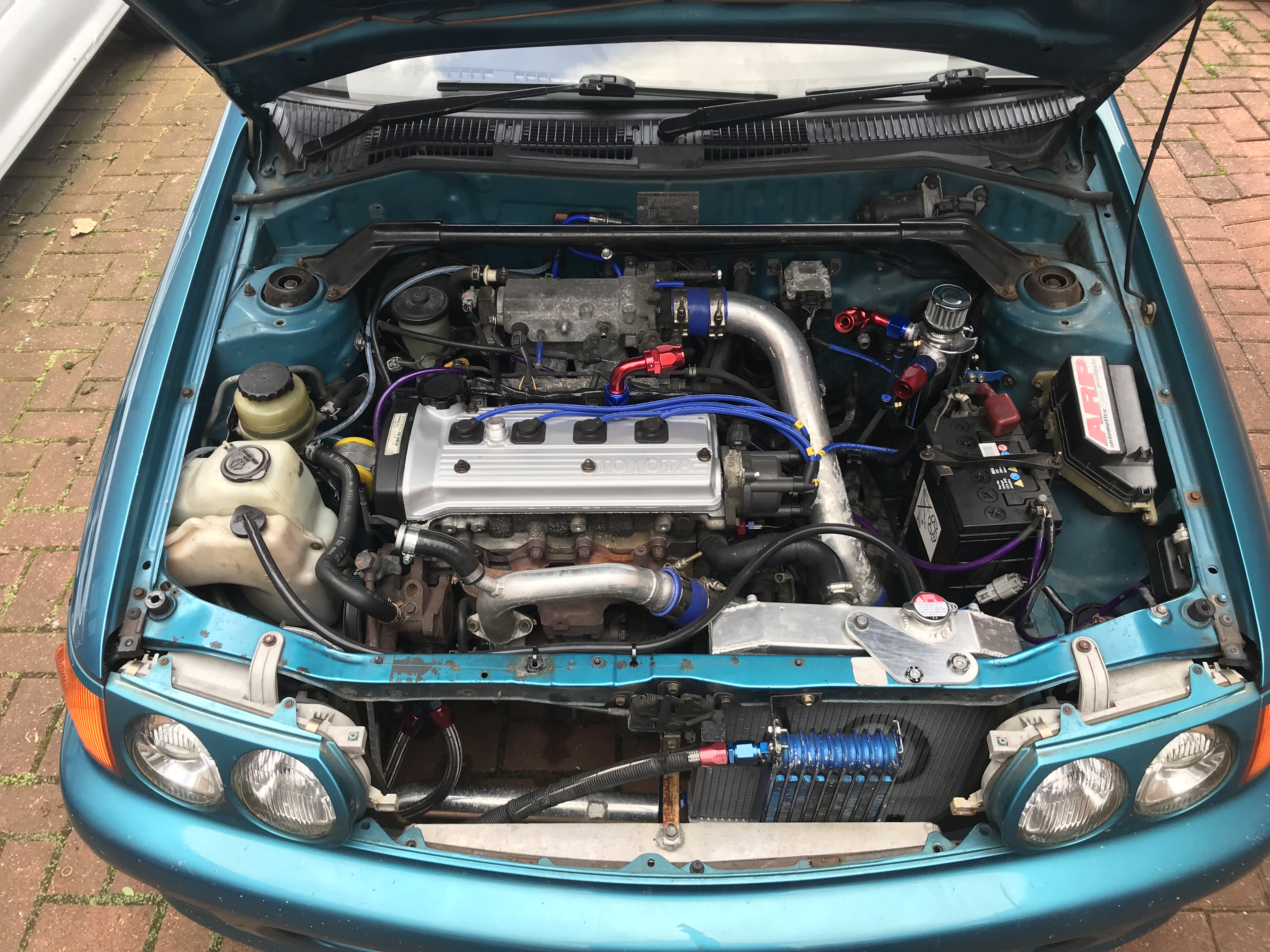

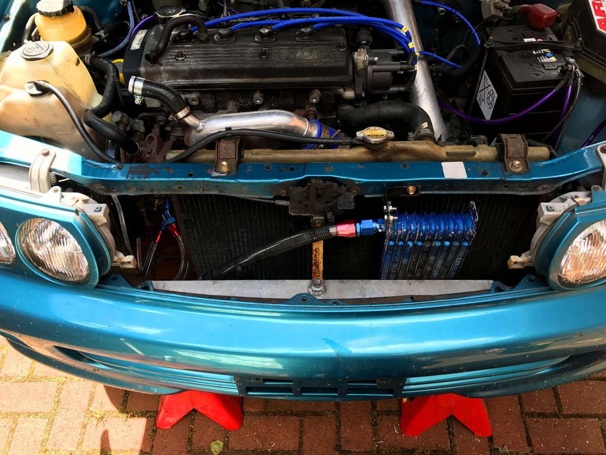

Got my Grex Oil Cooler fitted now!
post-2707-0-13157100-1499111931_thumb.jp
post-2707-0-81396600-1499111938_thumb.jp
Its certainly sorted out the oil temp issues. I cant get temps above 90c now hehe :)

Matt, how do you manage to run -2° of camber?
I've got the same setup as you..Shocks and springs with the whiteline camber bolts and I thought they could only adjust to -1.5° camber?
Marc.
  • 7 months later...
Marc.
Whiteline Camber Bolts dude. Swap them out to the other hole of the 2 in the strut/hub ;)

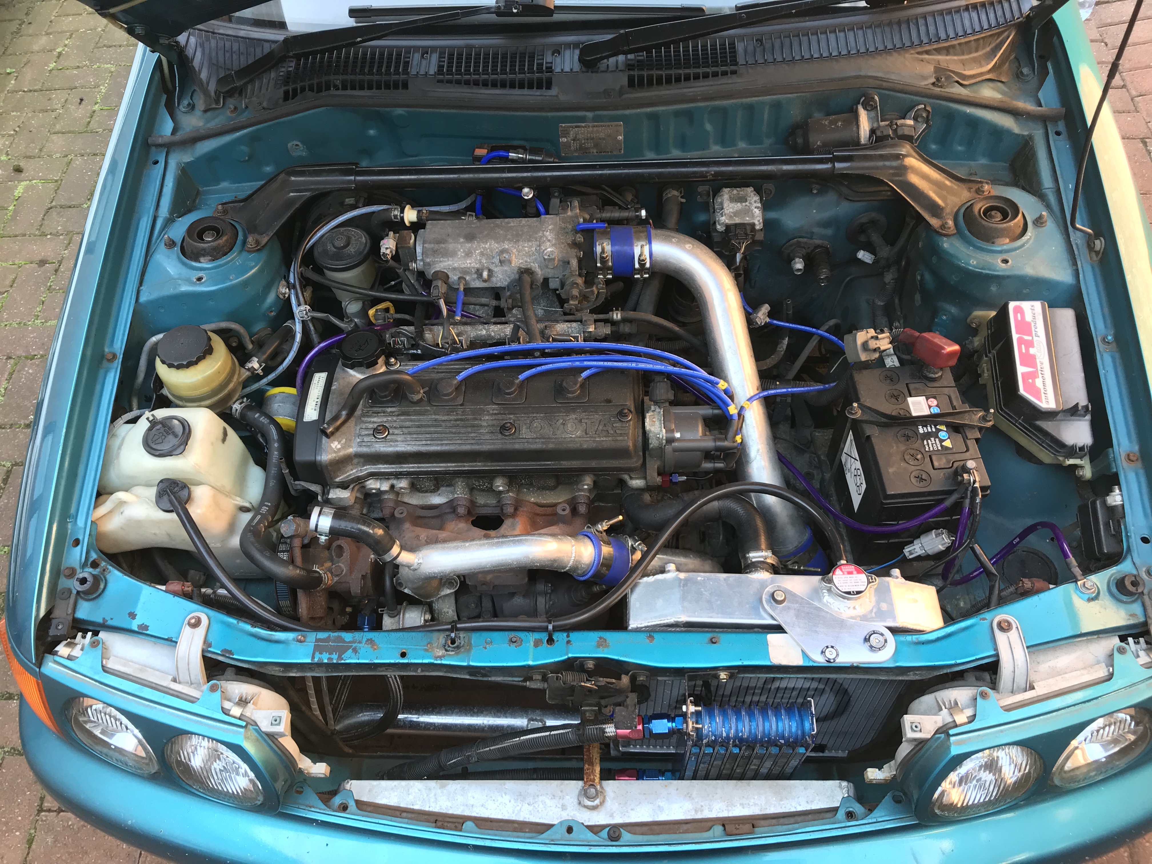

Cusco BMCS
Triple Core Civic Radiator (This one was important as temps on track are hard to manage)
Oil Breather System that can cope with added boost
Paddle Clutch again to cope with more boost#

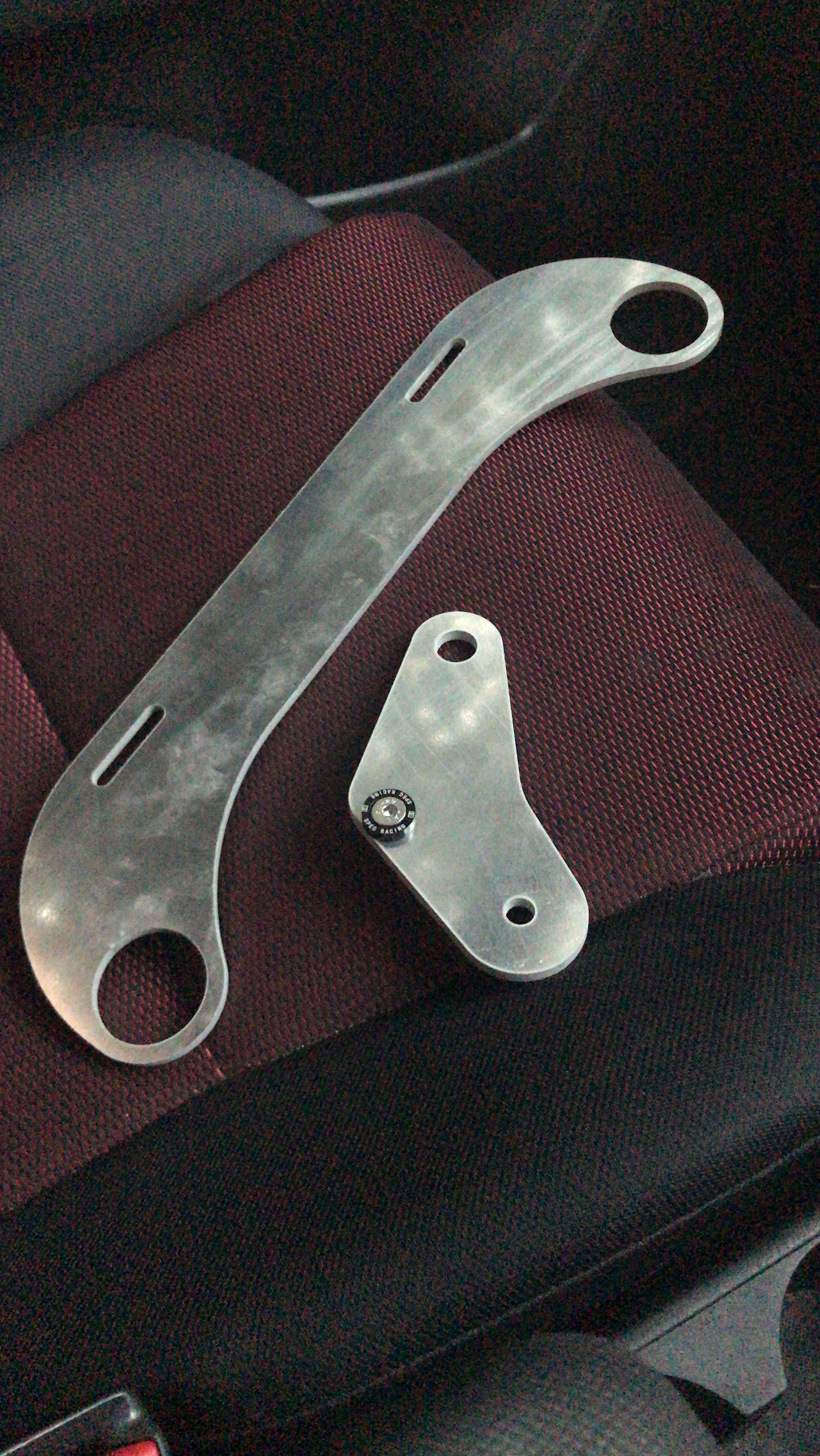

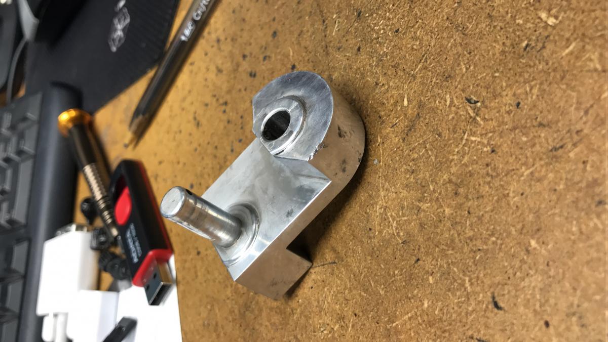

My own civic rad brackets:
5acc55ca1db24_Photo06-10-2017074329.thum
All fitted up.
5acc56242f40c_Photo_06-10-2017_11_46_01.

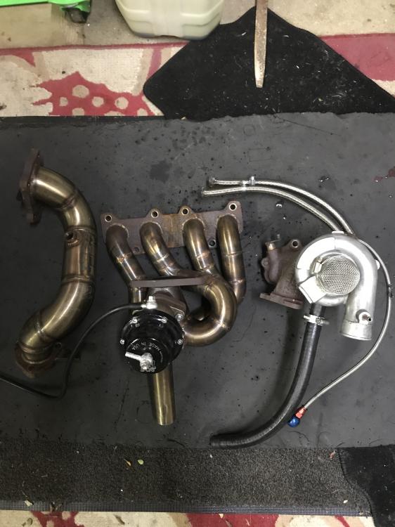

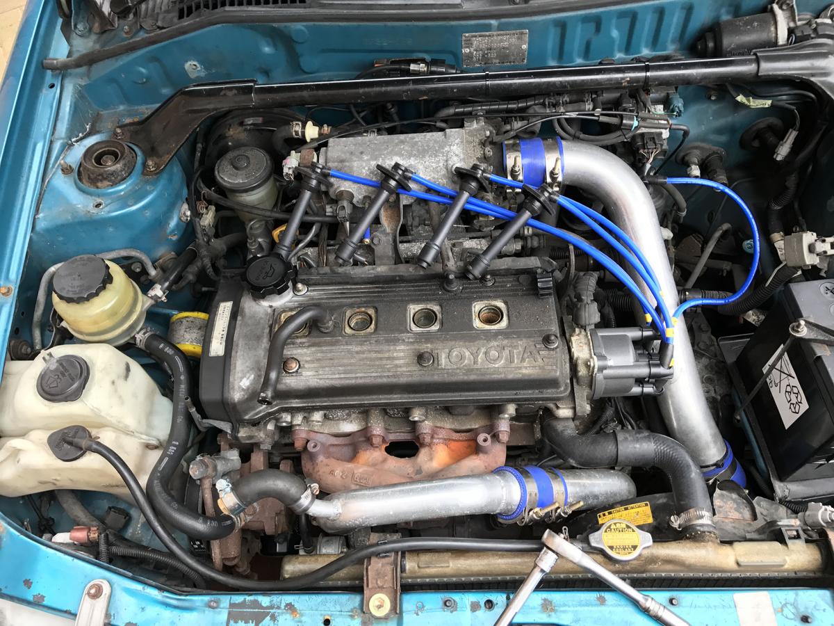

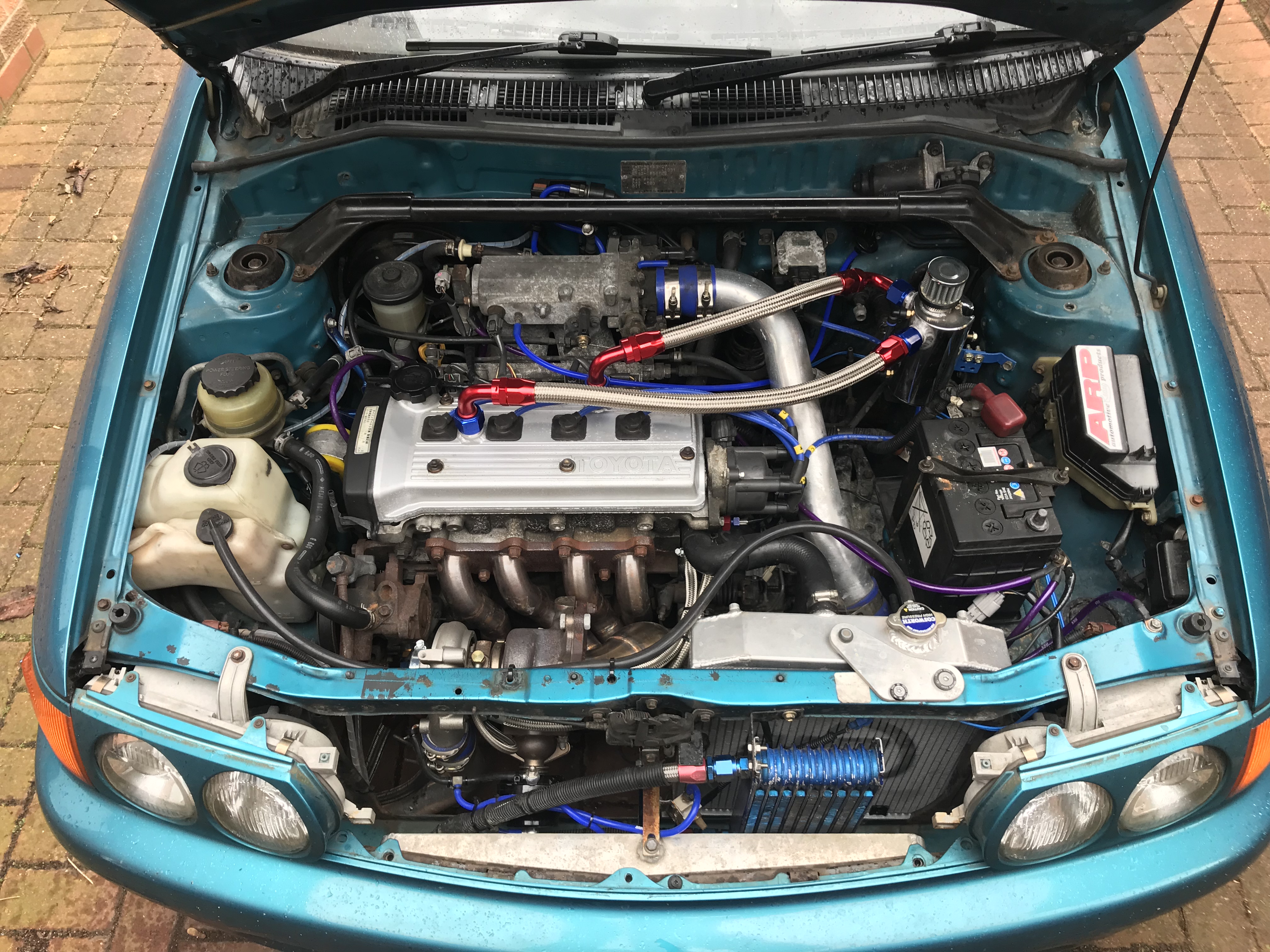

Then started putting breather system together which was a complete DIY job that turned out great!
5acc565c1dc1a_Photo_14-10-2017_14_22_12.

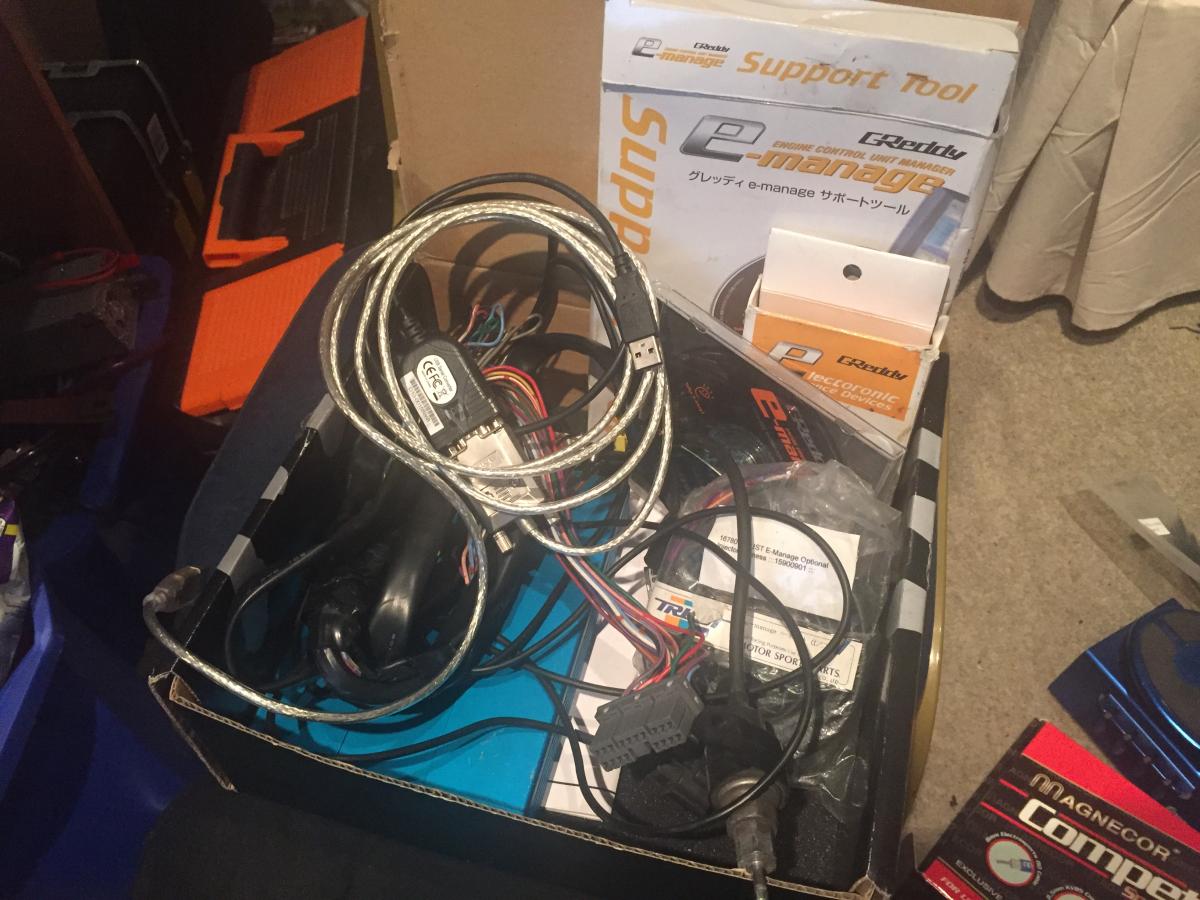

Then I ended up getting this kit for £250! lol. Couldn't turn that down that's for sure.
5acc570e554db_Photo08-01-2018182233.jpg.

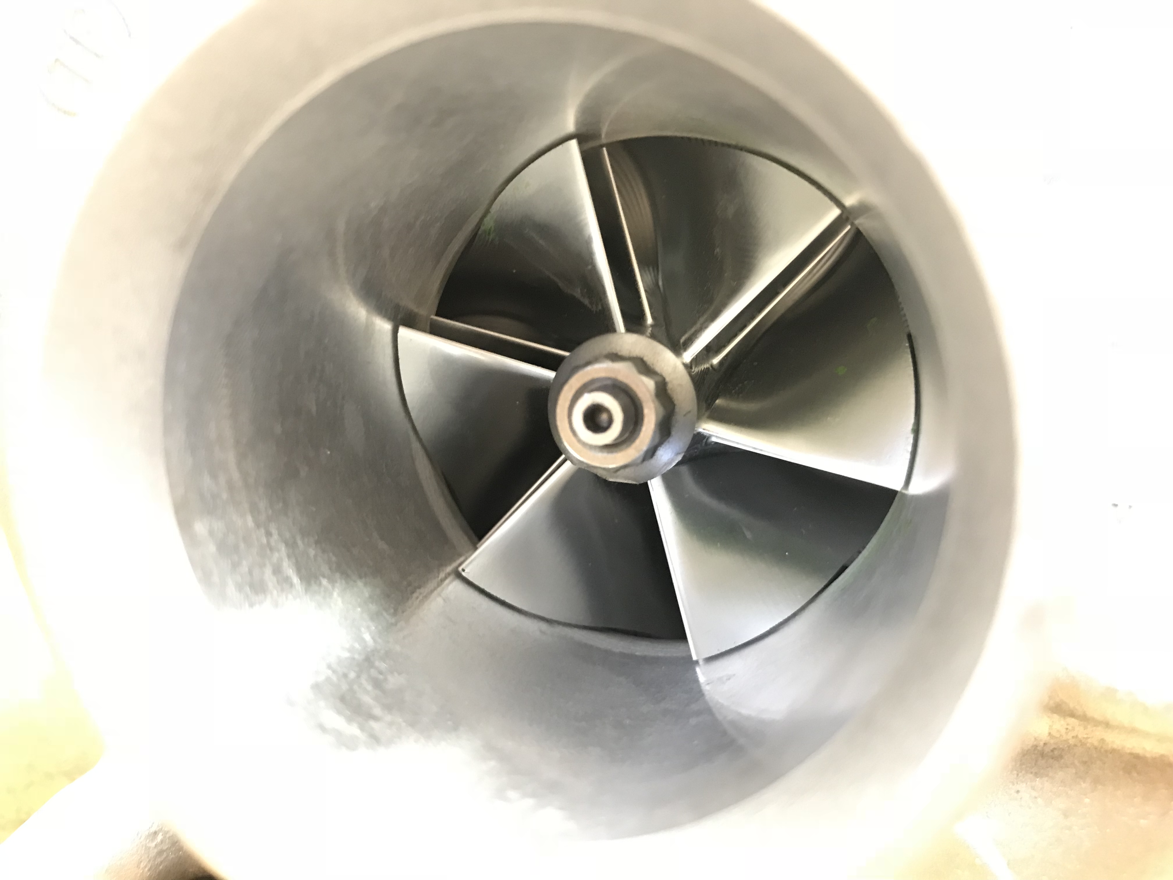

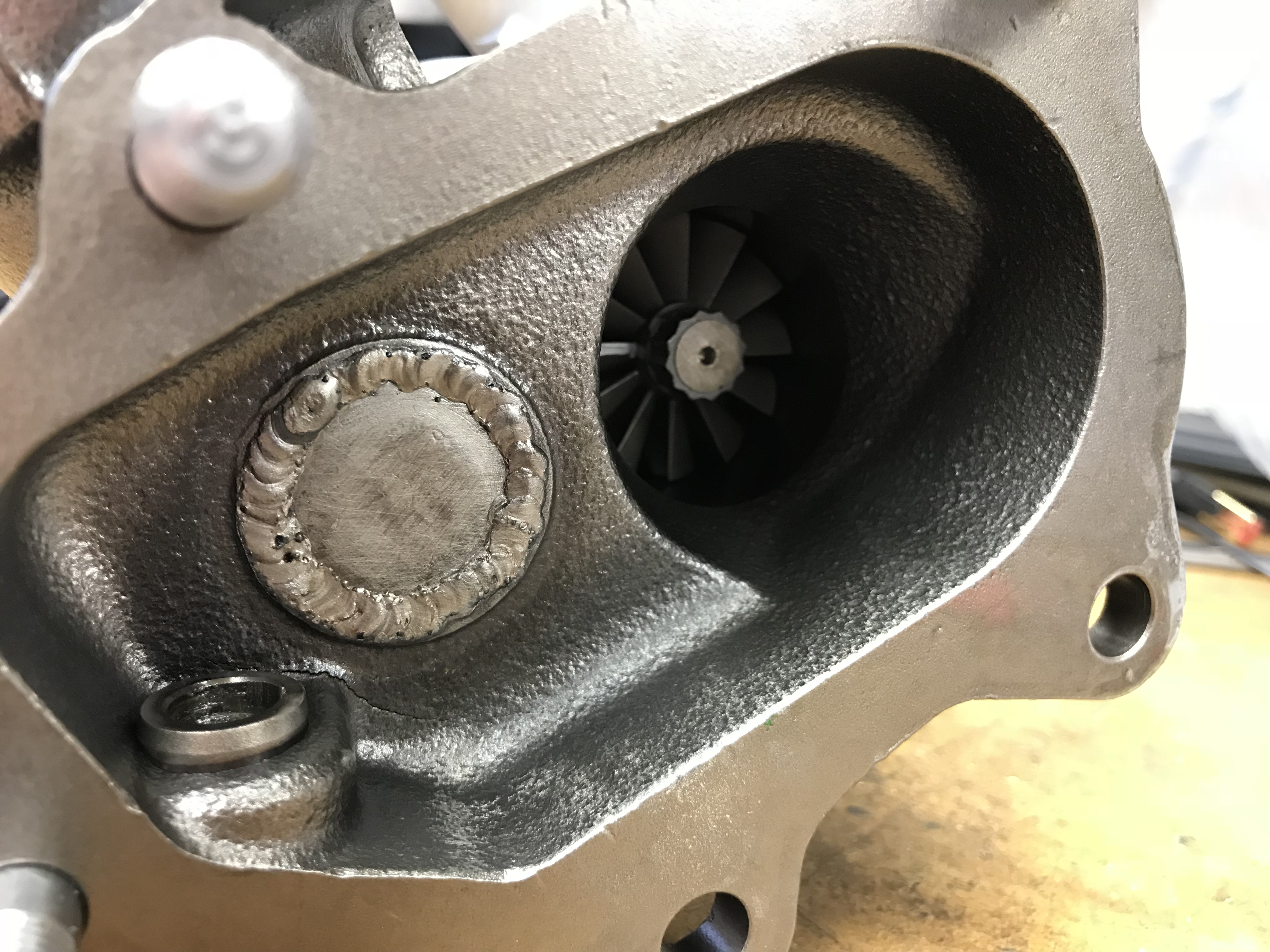

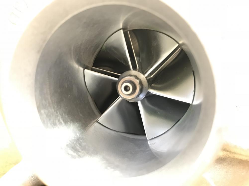

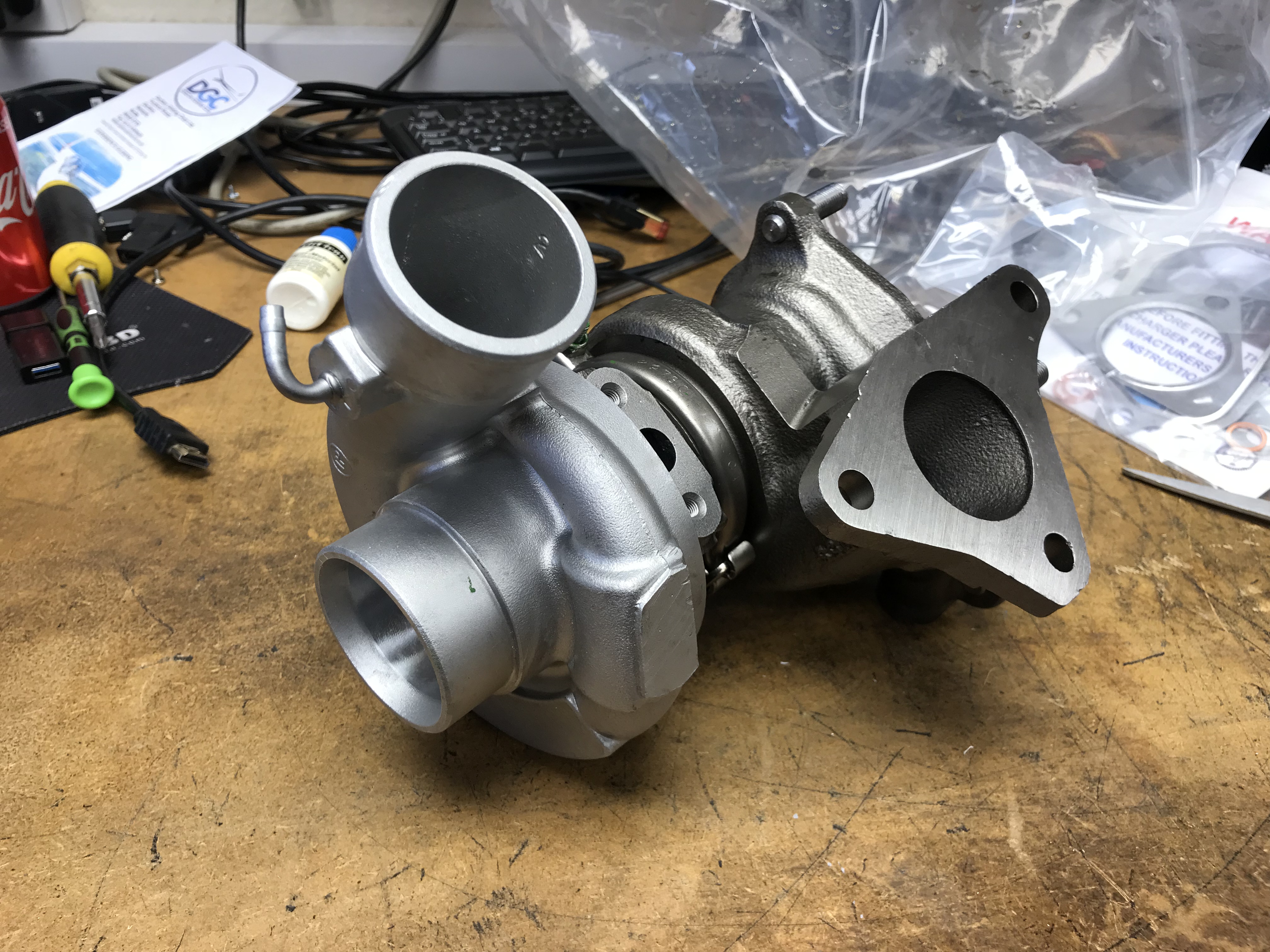

Sent the turbo off to good ole Liam to get rebuilt, with a Billet Wheel. Liam does a great job as always.
5acc57354ad0b_Photo_28-02-2018_11_37_28.
5acc573885b8f_Photo_28-02-2018_11_37_41.
5acc573e2e91b_Photo_28-02-2018_11_37_50.
Get it all fitted up:
5acc576d017bd_Photo_24-03-2018_17_23_35.
5acc5765e6dc4_Photo_24-03-2018_17_17_12.

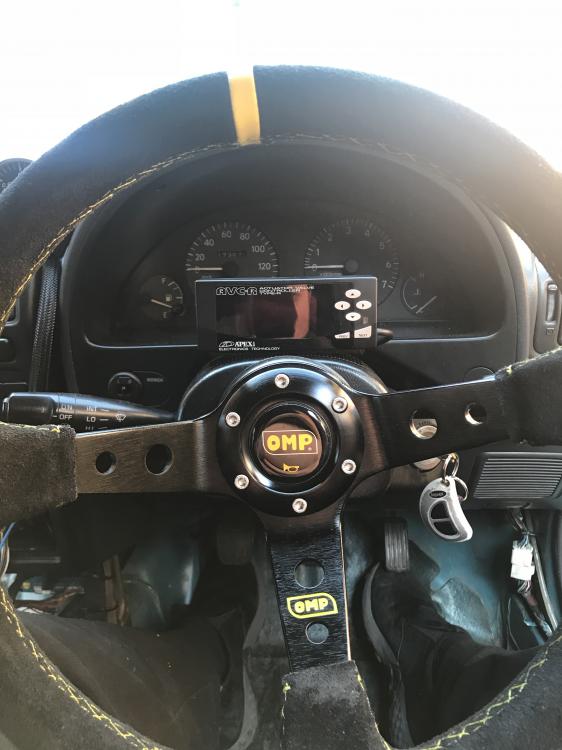

Got an AVCR off a local for sale page on fb for £100! :D
5acc585c9c82b_Photo_25-03-2018_10_31_05.
Got it all finished:

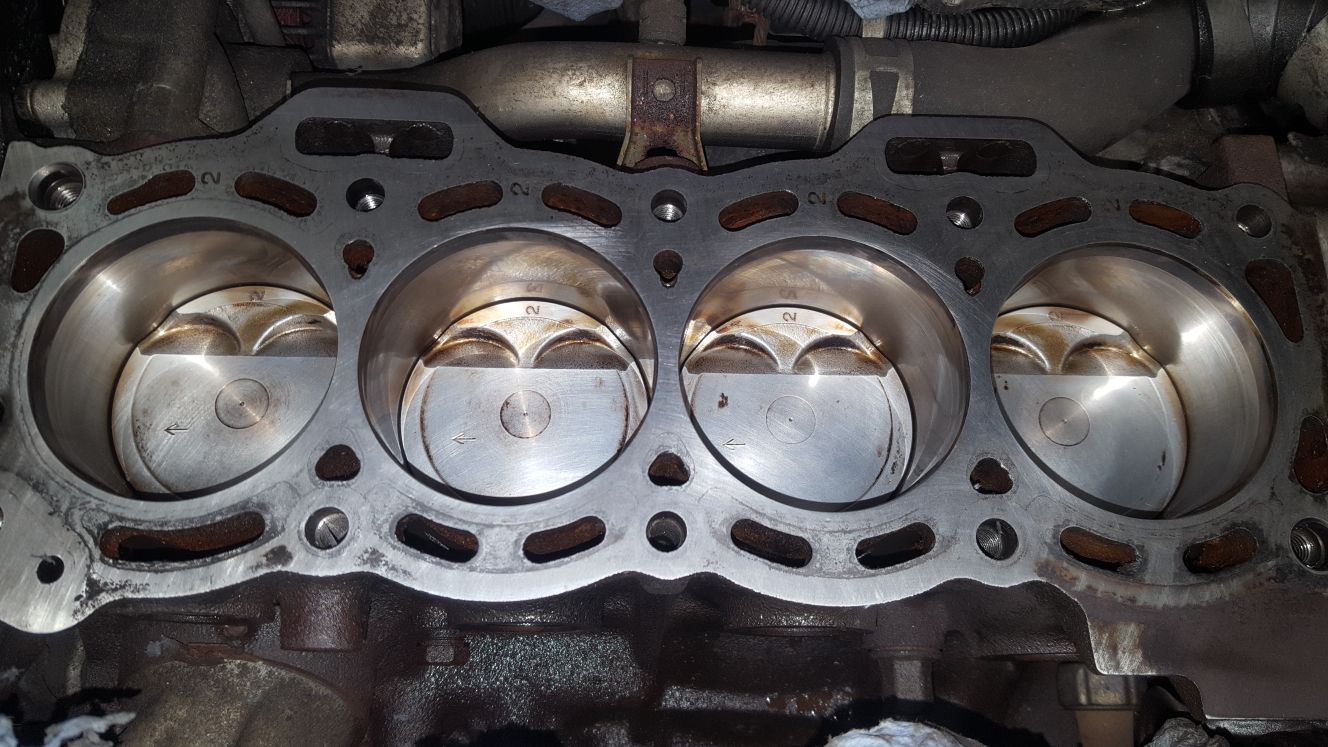

5acc59422bfee_Photo_07-04-2018_09_56_11.

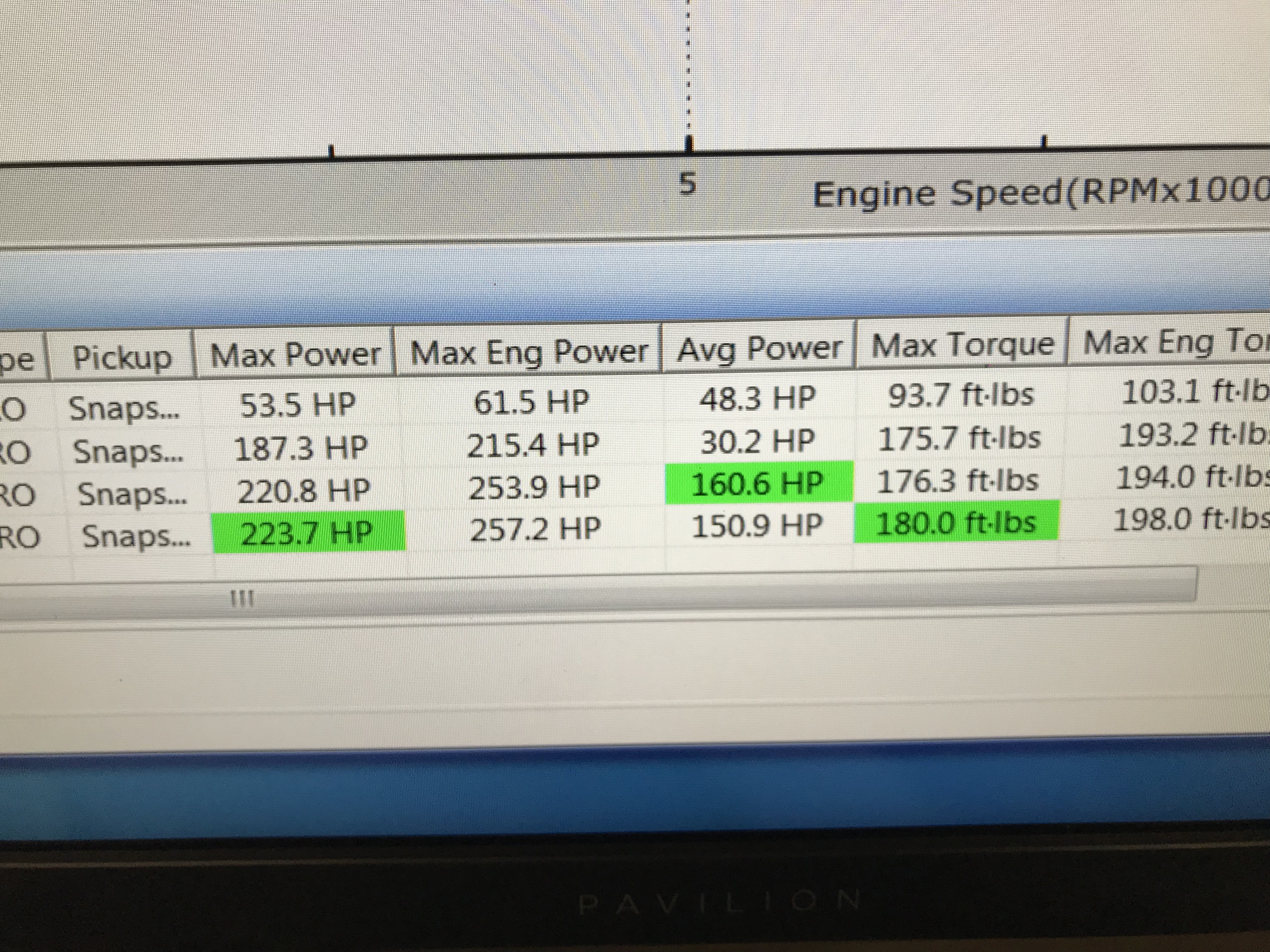

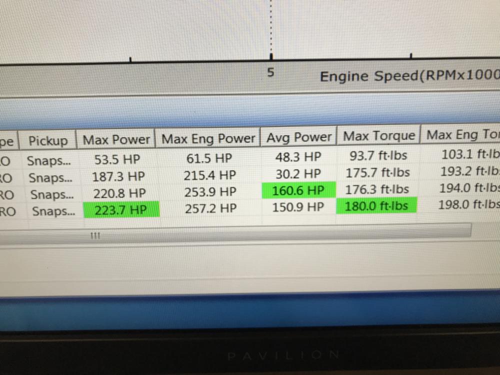

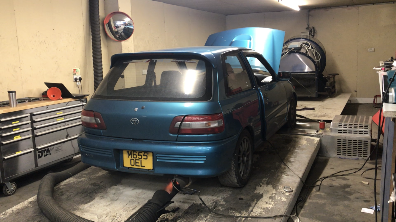

Then it was mapping time.
5acc5961cafd3_Photo_04-04-2018_15_36_35.
5acc596a07ce0_Photo_04-04-2018_17_05_34.
Made good power too!
5acc59b35c6d0_Photo_04-04-2018_16_44_39.
lol whoops. Sorry engine :D

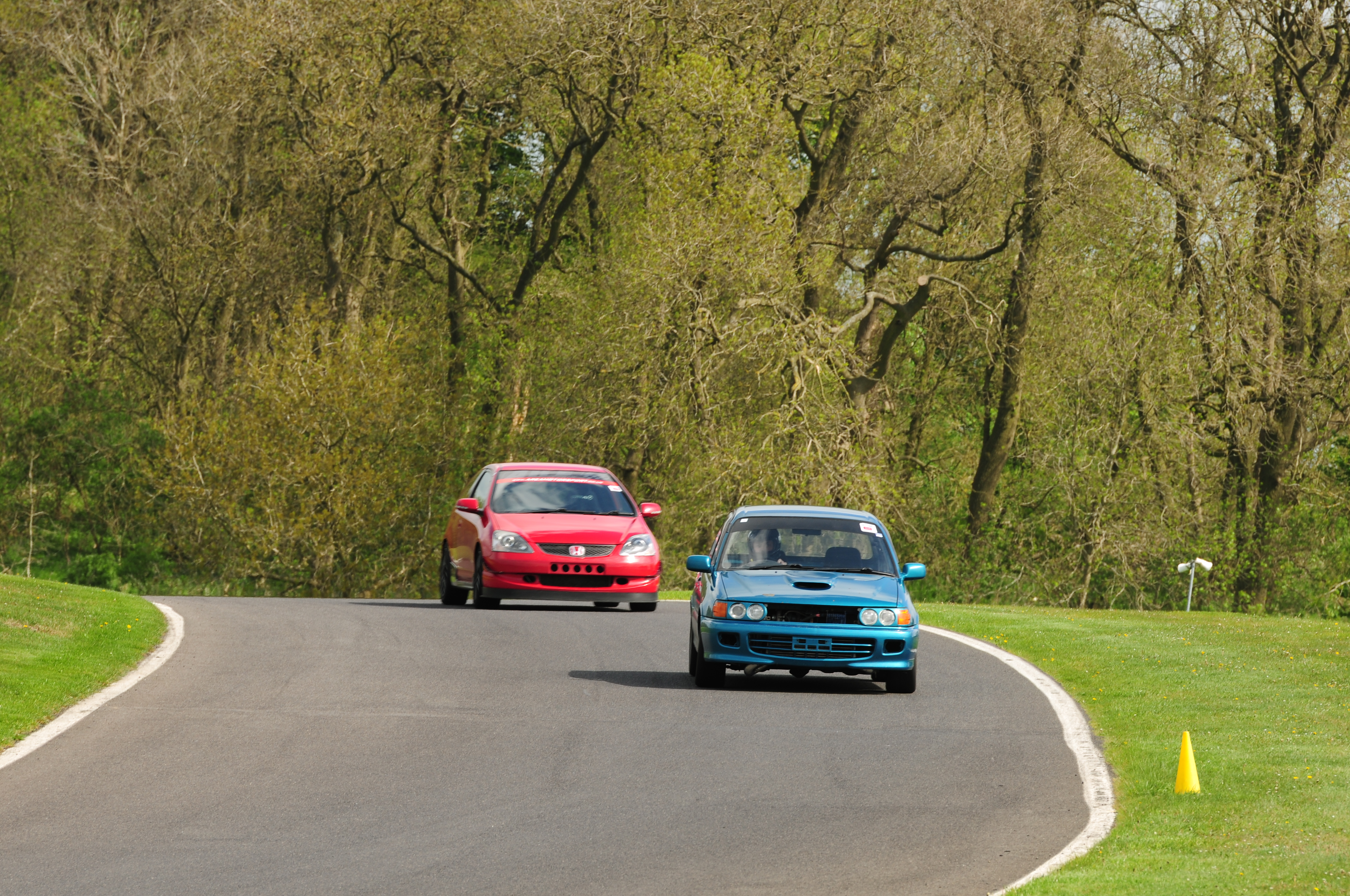

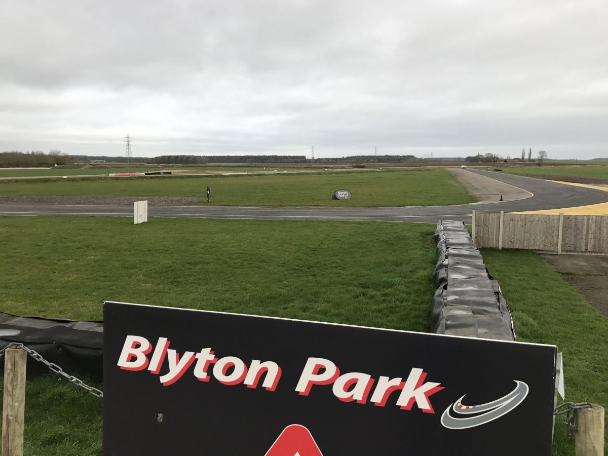

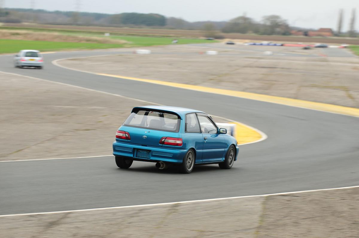

Anyways, onto Blyton for a shakedown!
5acc59e627549_Photo_07-04-2018_12_54_24.

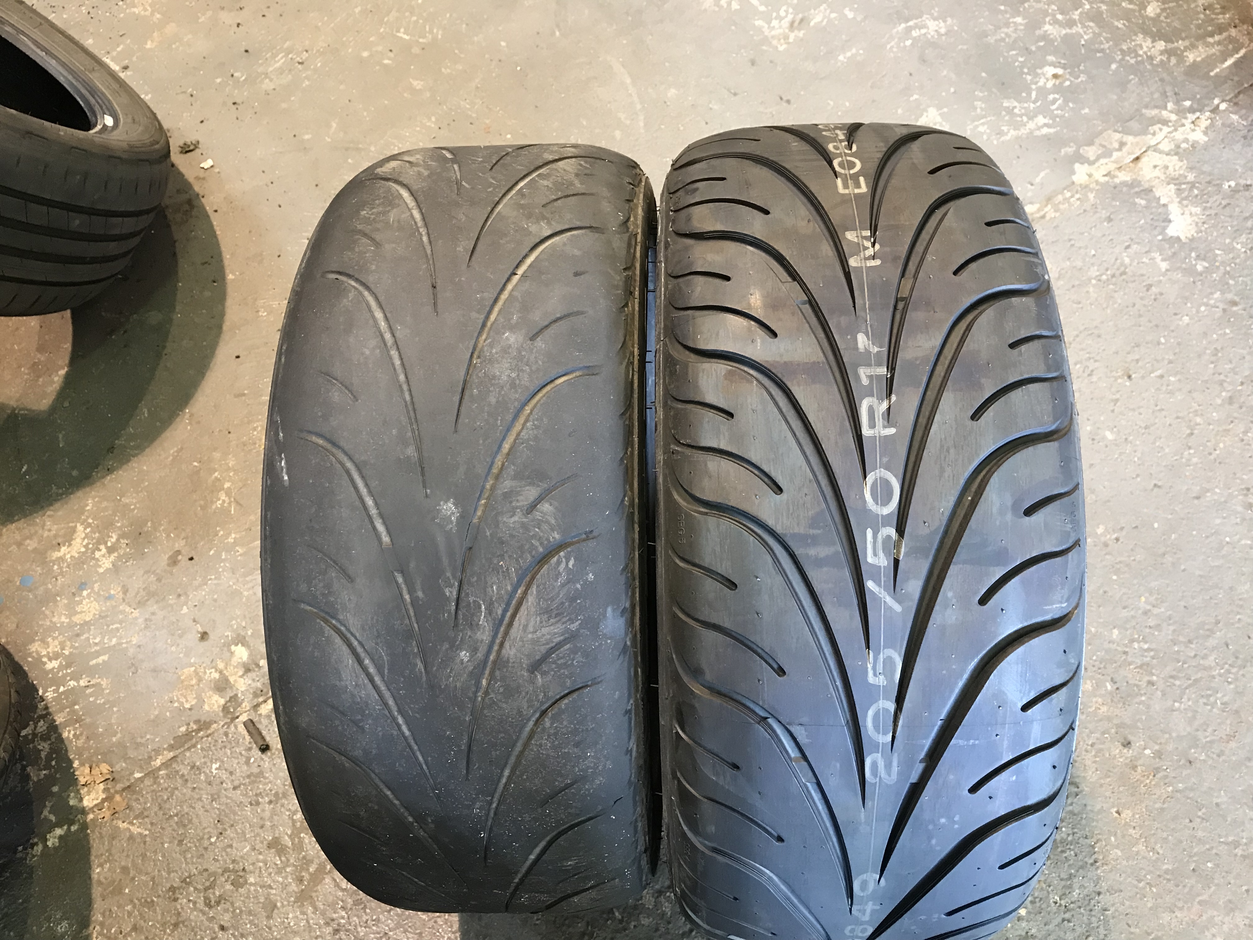

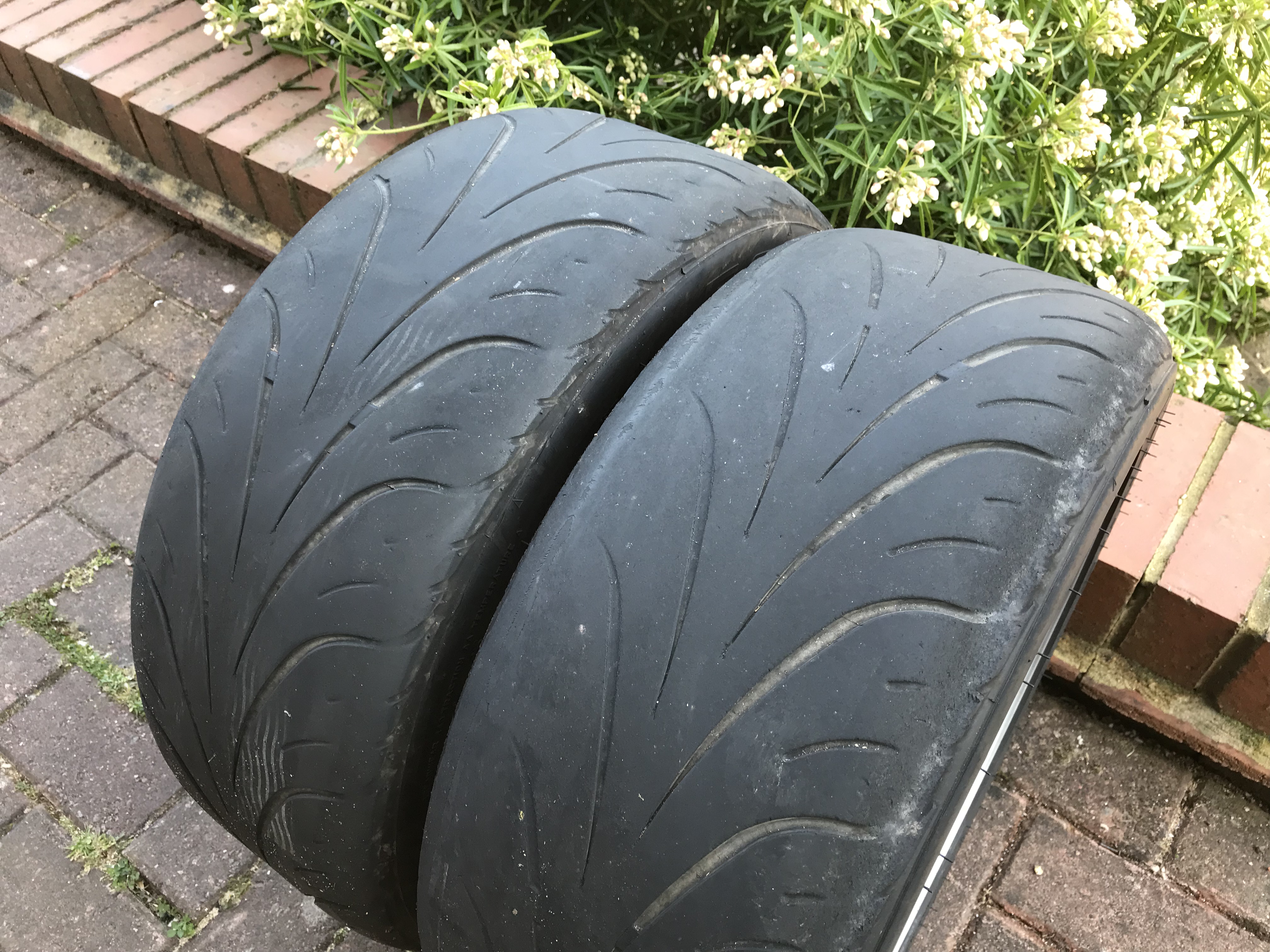

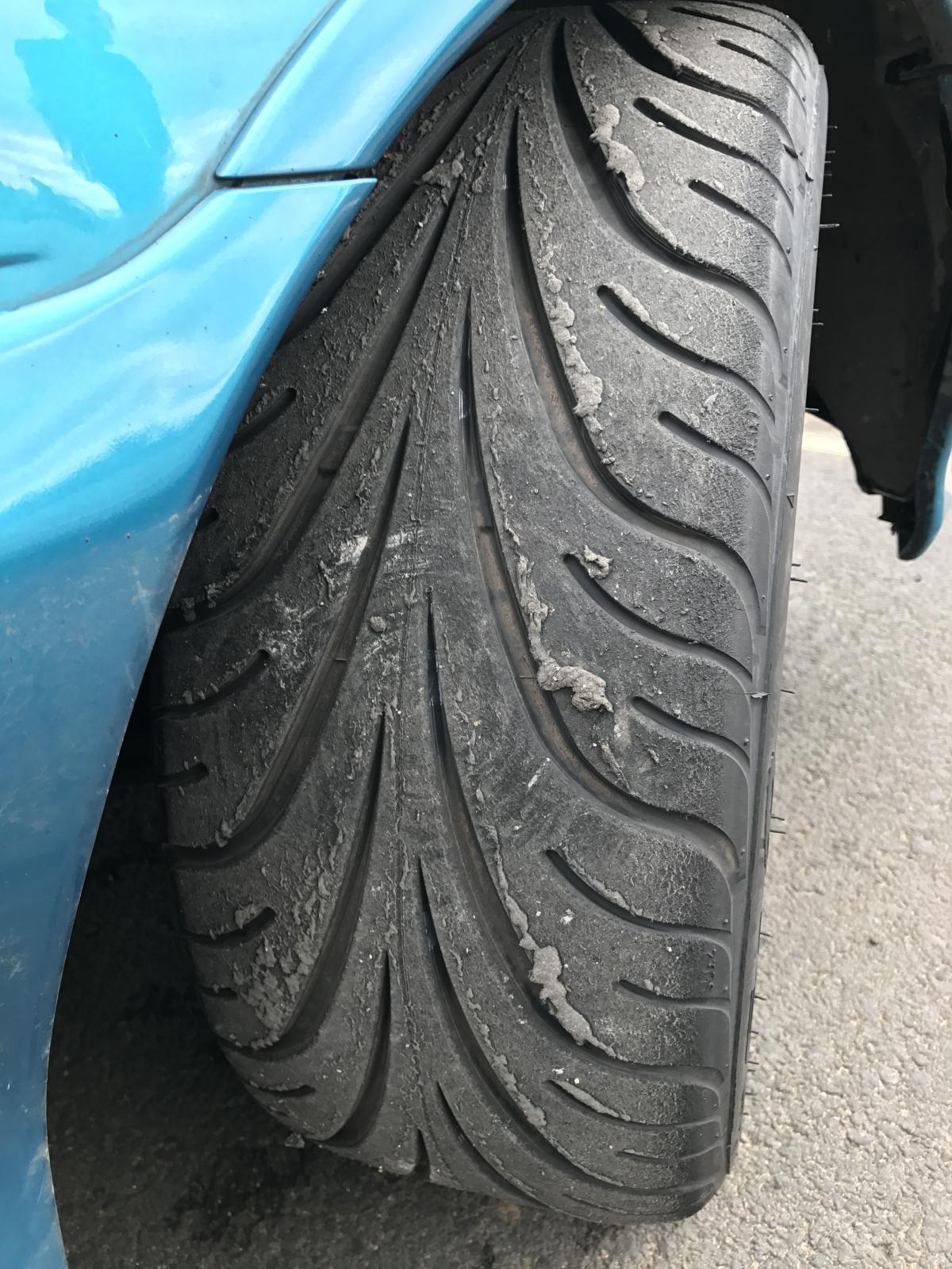

Car performed so well all day. The tyres on the front were fucked, this was there 5th track day. So i turned it down to 0.9bar, even then was spinning at this corner exit.
So much fun tho!

The amount of people that came over and asked first of all wtf was under the hood but then said its hilarious to watch on track.
Mixture of the tripod thing and the noise it makes. It puts on a show haha!

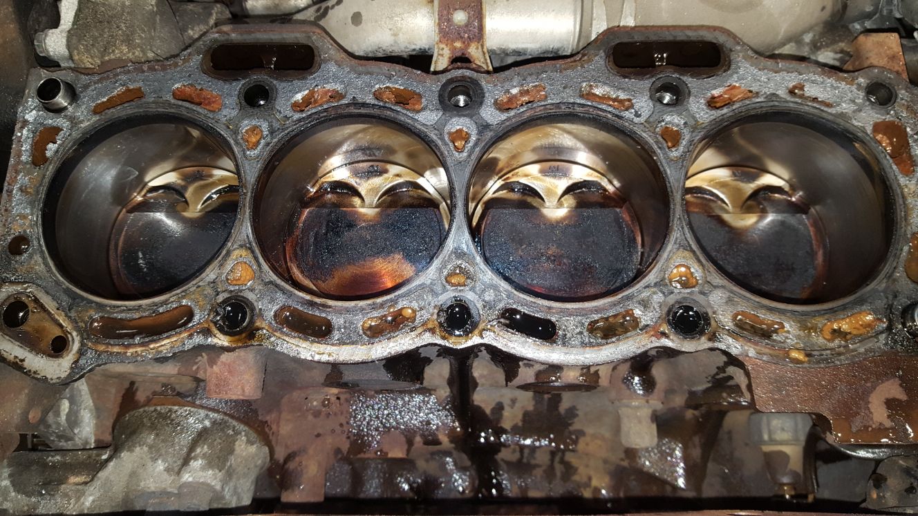

So! Id been having an issue with the coolant slowly moving into the overflow bottle over time (2-3 track sessions) but then not moving back.
Having replaced the thermostat, rad cap, radiator. etc trying to sort it throughout the year. I decided to bite the bullet and do the head-gasket just to rule it out.
Also would give me an opportunity to see inside the engine to see what the score is!
So! Off came the head!
5b027455b034e_Photo19-04-2018122434.thum
It looks great inside, obv carbon built up which backs up the mileage.....
But the bores and head looked great! So gave her a scrub up!
5b0274a8548fa_Photo19-04-2018144939.thum
Thats better :)

With new bigger tyres on the front, the old ones had done 5 track days :D
5b027643a0f2a_Photo_05-05-2018_10_15_14.
5b027646aa475_Photo_05-05-2018_10_39_05.
And new brakes, disks were warped big time after the late braking at Blyton last time, so new disks and inspect the pads....
5b0276735285d_Photo_05-05-2018_13_17_19.
5b02767f5bef6_Photo_05-05-2018_13_17_17.
Another day in them yet :p...... (which there was lol!)
So off we went to Cadwell, this with a good handful of mates. Think there was 4 EP3s, Dc2 & Mk5 Zetec S Fez too.
5b0276cdbce9e_Photo_10-05-2018_11_19_07.
My good friend Joe, (Red EP3 with black lip) again had some good fun on track with him as you'll see in the video....
Didnt go so well for the Fez tho!
5b0276d4ad124_Photo_10-05-2018_12_23_13.
He lost it through hall bends :s
Anyhoo, was a mega day! Car performed Amazing all day. Only used low boost again all day, it really was enough! Grip was so much better, altho a little scrubbage, I will get away with a slight arch roll! (on the front)

New Brake Pads and a few other little mods for the next one!
