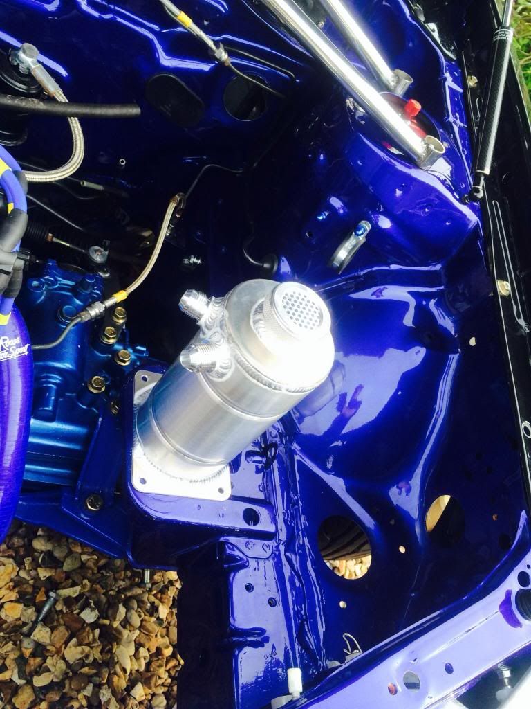

Liam_D Posted April 24, 2014 Posted April 24, 2014 Amazing, who's catch tank is that? Or is it custom? Quote
JordanEP91 Posted April 25, 2014 Author Posted April 25, 2014 (edited) This catch can will look nuts when mirror polished and mounted Edited April 25, 2014 by JordanEP91 Quote

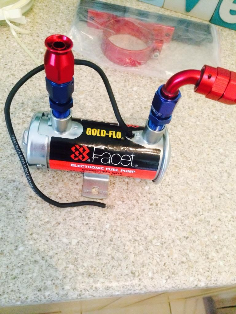

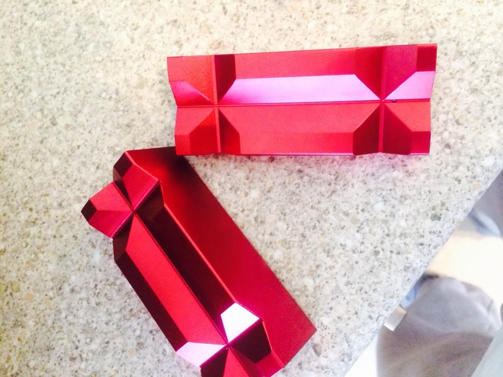

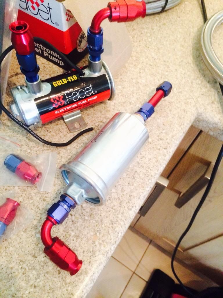

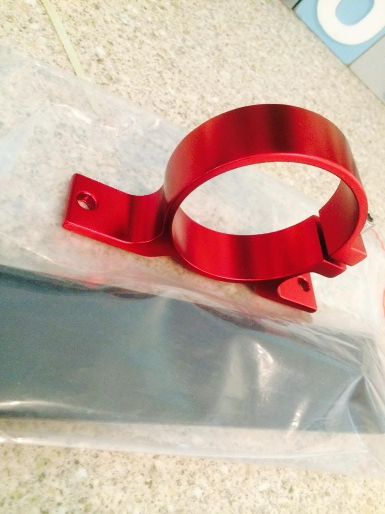

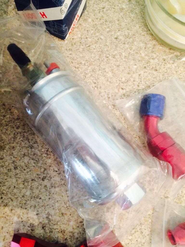

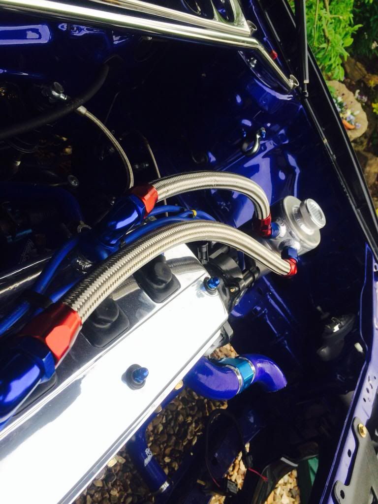

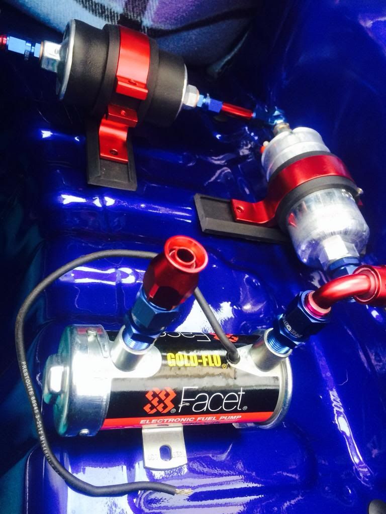

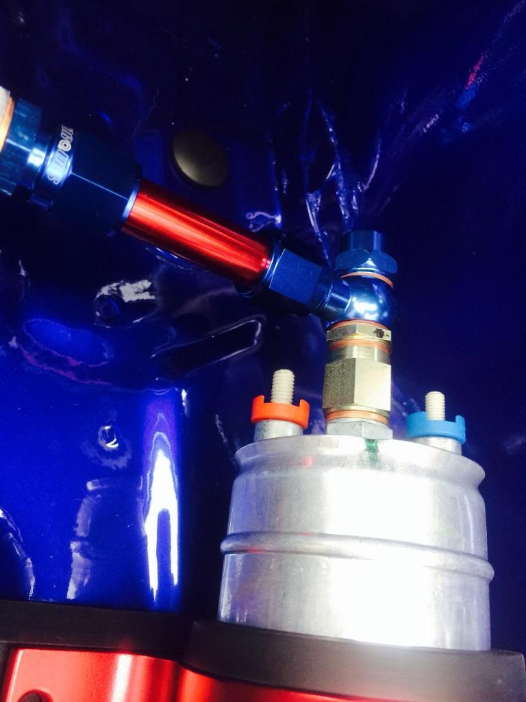

JordanEP91 Posted May 1, 2014 Author Posted May 1, 2014 Update Time Went To Get Some Fittings & That For My Fuel Tank Today Facet Fuel Pump Was Going To Run Twin But The Guy Said I Wouldnt Need It So One Should Be Enough Fuel Tank Fittings With Roll Over Valve Braided Fuel Hose Vice Clamp For The Fittings So When You Tighten Them It Doesnt Mark Them Loads Of Fittings Braided Hose For Oil Catch Can Everything Together Layout Oil Catch Can Done One Fuel Hose Done Random Picture also replacing the fuel lines from the reg to the fuel rail so its all the same hose and fittings Quote

littlegreenmonster Posted May 2, 2014 Posted May 2, 2014 Quick question, have you a built in strained in the fuel tank so that it cant get crap on it ?? because i havent seen a fuel filter atall (might have missed it) just an idea ?? Quote
Phil Posted May 2, 2014 Posted May 2, 2014 (edited) Quick question, have you a built in strained in the fuel tank so that it cant get crap on it ?? because i havent seen a fuel filter atall (might have missed it) just an idea ?? Inline filters id guess ^^ see above only the facet is a pump, no need for a second pump without a swirl pot. and no need for a swirl pot with a custom tank. is she baffled? Phil Edited May 2, 2014 by Philm Quote
