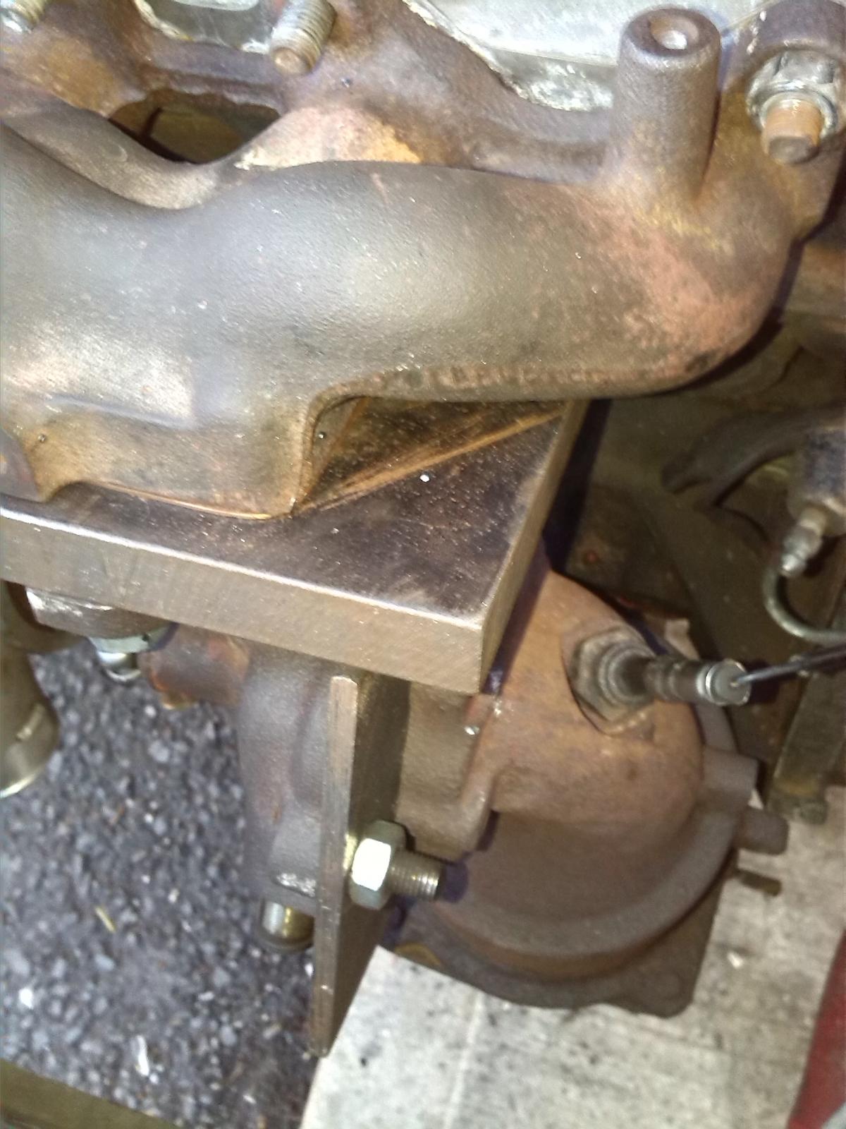

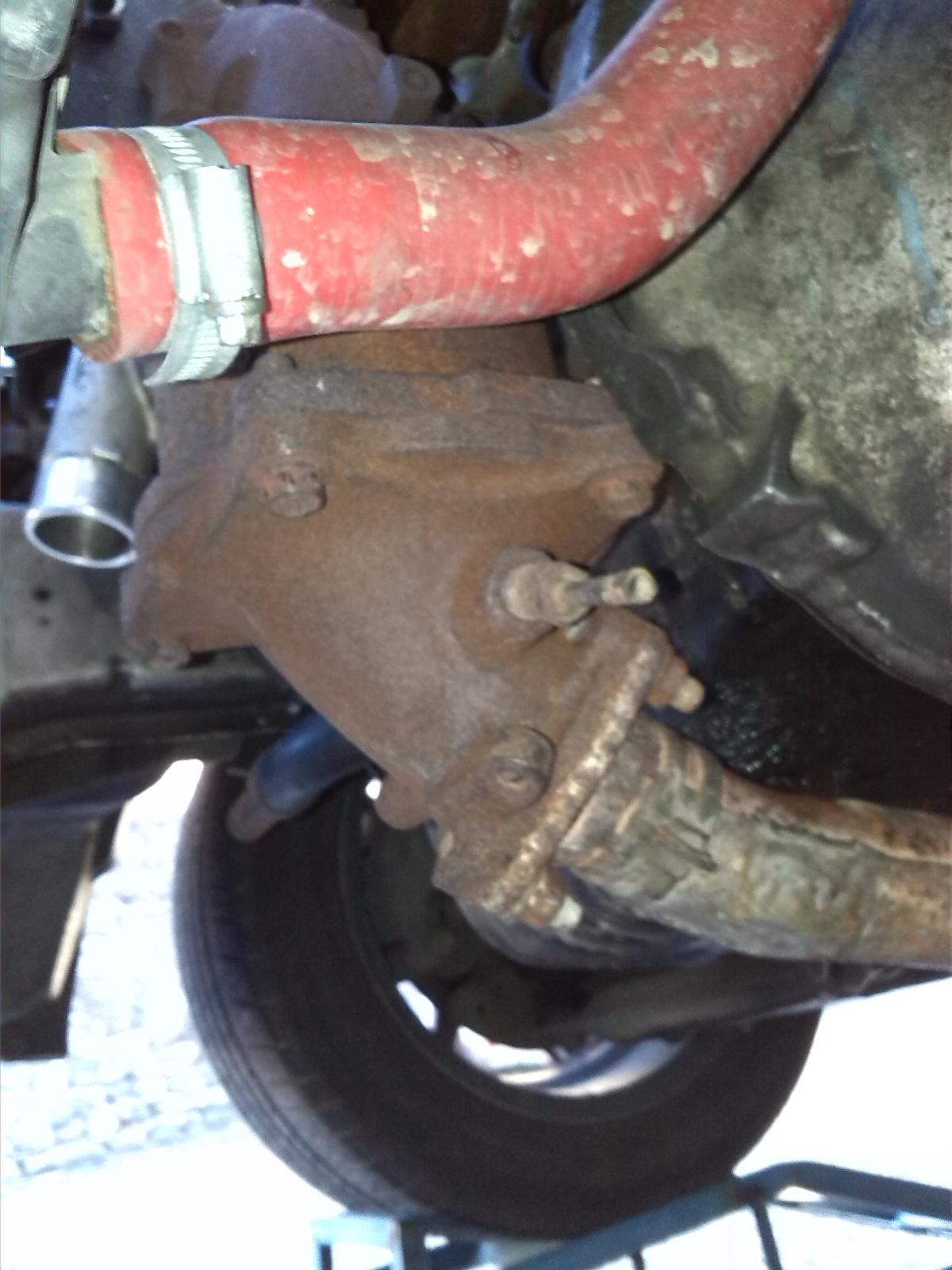

FrozenJakalope Posted July 1, 2015 Posted July 1, 2015 Could you tap a silicone pipe into the turbos output, one on each turbo? Thinking twin boost gauges Quote
5e colin Posted July 1, 2015 Author Posted July 1, 2015 ^^^^ thats actually not a bad idea mate a digital 1 in psi for accurate readings just tap nipples to the existing 1s Quote

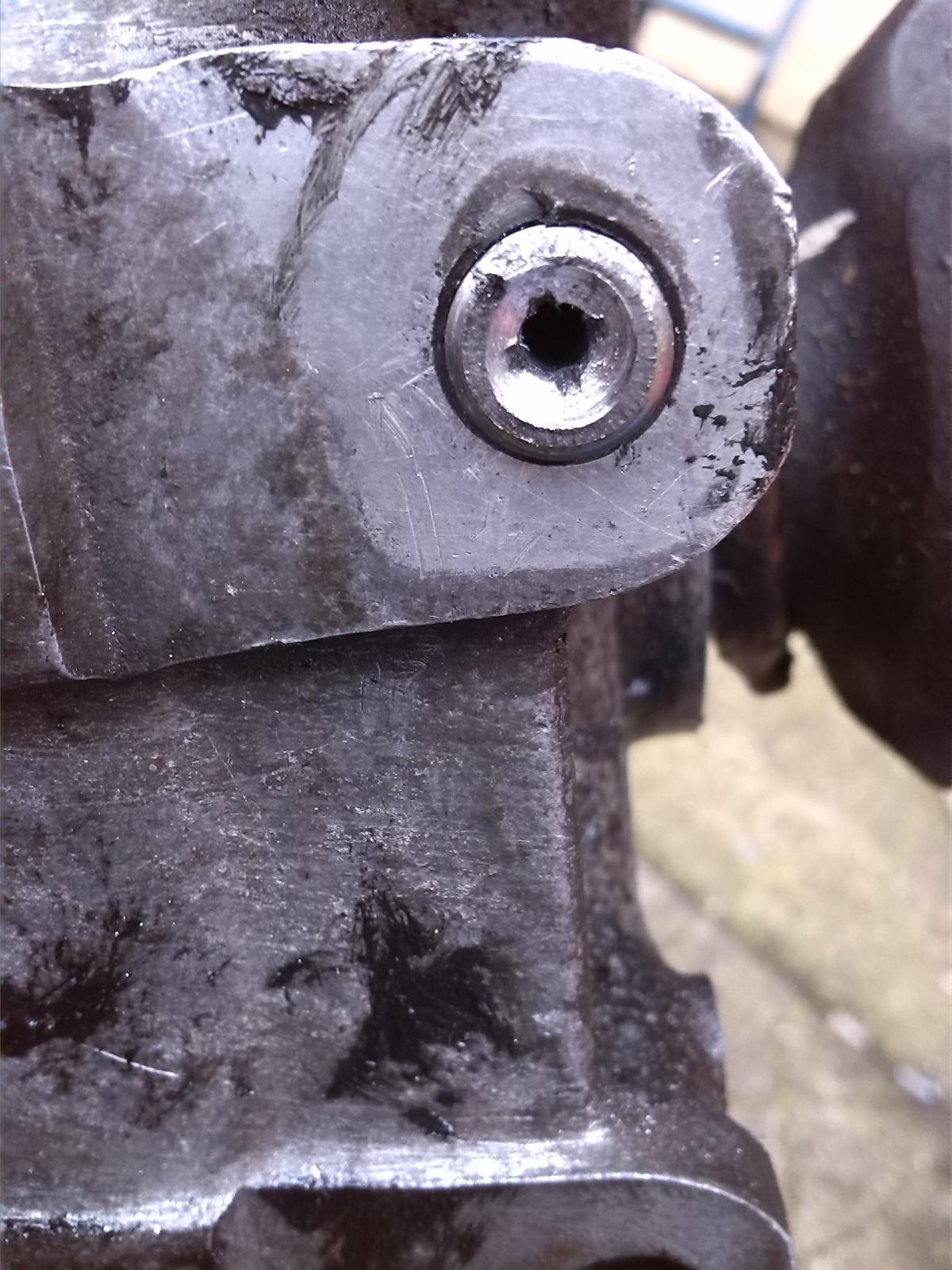

5e colin Posted July 20, 2015 Author Posted July 20, 2015 (edited) fidler use this diy bit i never cracked 1 like this Edited July 20, 2015 by 5e colin Quote

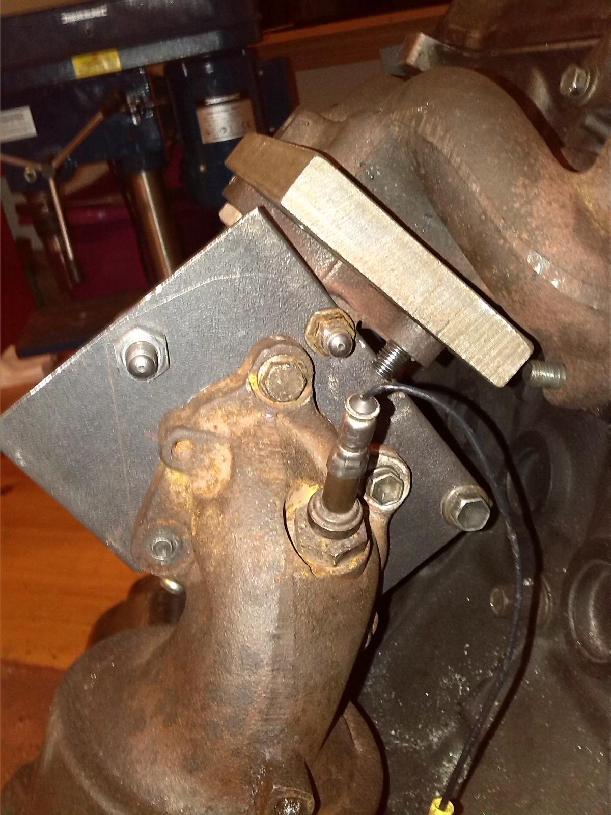

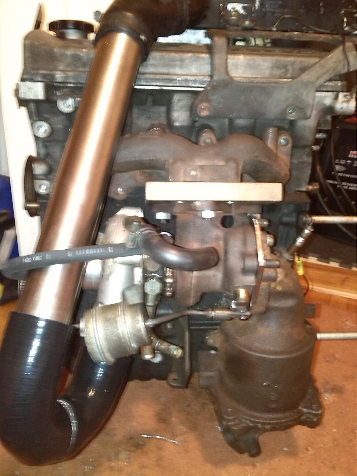

5e colin Posted November 7, 2015 Author Posted November 7, 2015 (edited) something else i bean tipping away at tfo35 on stock cat its works so a very cheap td / tf option can use ct9 decat to so no cat restriction Edited November 7, 2015 by 5e colin Quote
5e colin Posted November 17, 2015 Author Posted November 17, 2015 (edited) found another pic of the tfo35hm to ct9 cat complete mok up before it went on the car Edited November 17, 2015 by 5e colin Quote

5e colin Posted November 20, 2015 Author Posted November 20, 2015 dam i had a boost leak and didnt even know she worked hard from 36oo onwards 1.1bar i just swapped al my jubly clips over to Tbold jublys ( 10mm nut ) and my god i now have 1.1 at 3100rpm who hoe i am well happy now i still have the stock cat in there so woulld see even better gains with a decat Quote

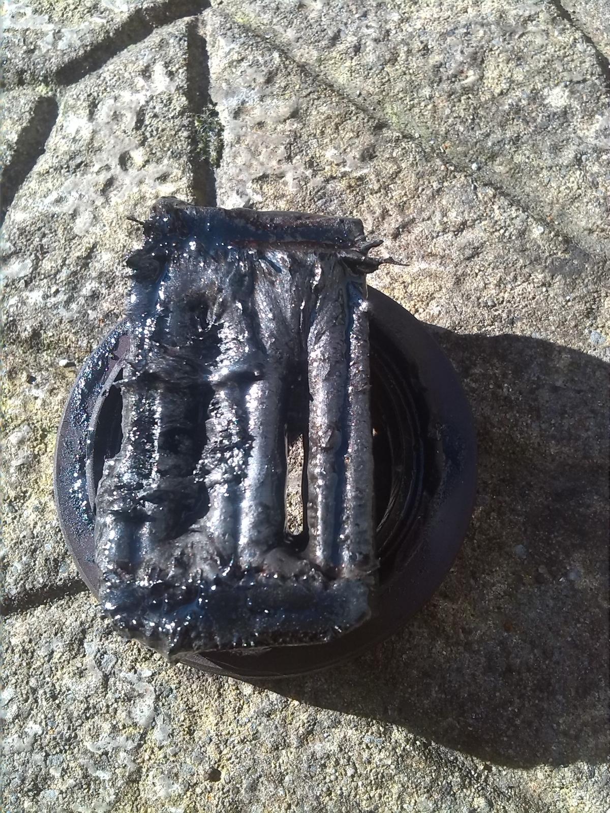

5e colin Posted February 19, 2016 Author Posted February 19, 2016 well today on my shopping trip cruising my oem lsd box decided to collapse a bearing she is grinding like a fucker managed to cruise home at about 1500rpm luckily i made it home some oem lsd setup parts will be available soon ha ha Quote

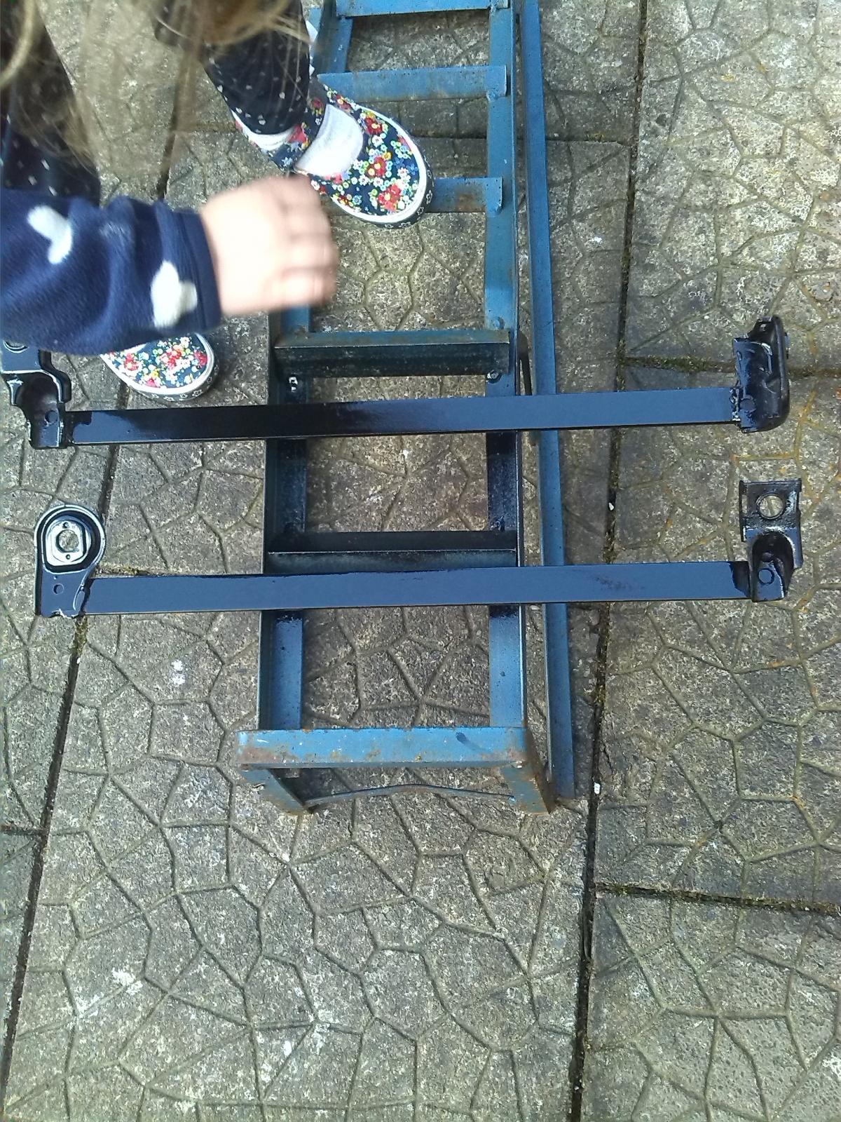

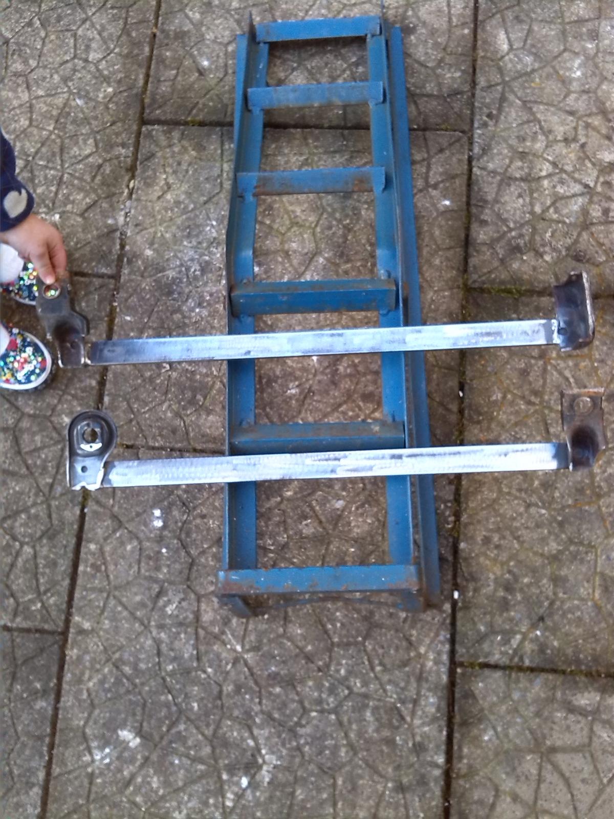

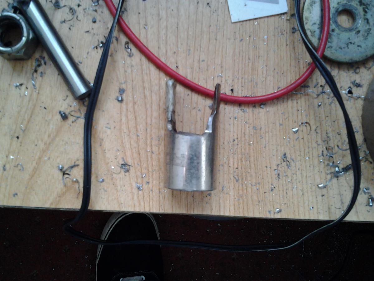

5e colin Posted February 24, 2016 Author Posted February 24, 2016 (edited) made some custom brackets for the celica seats worked well used the feet of the old 1s and welded some crossbars thinking of bolting the celica slider to it or weld ??? not sure yet anyways turned out well with a coat of black/lacquer Edited February 24, 2016 by 5e colin Quote

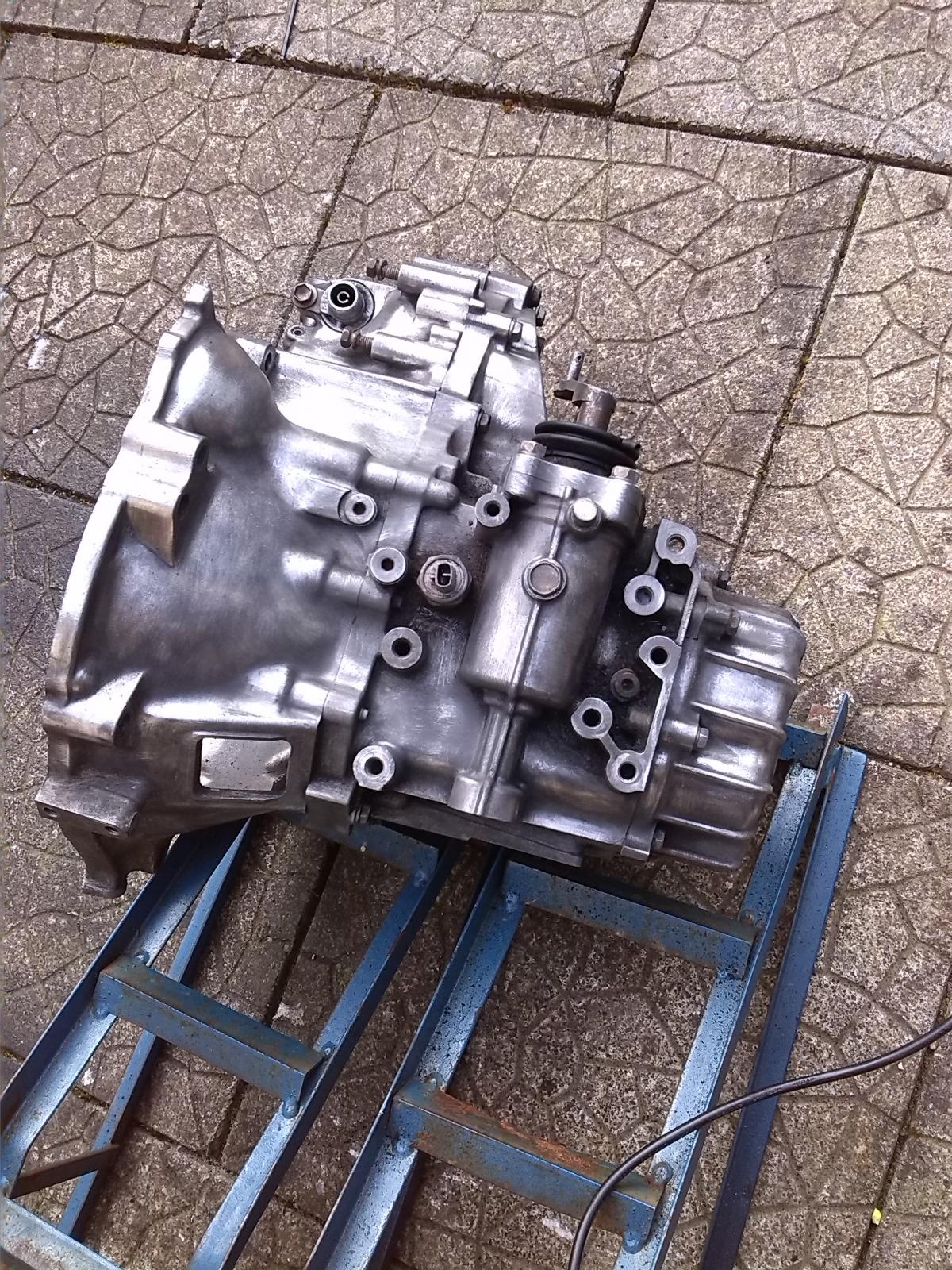

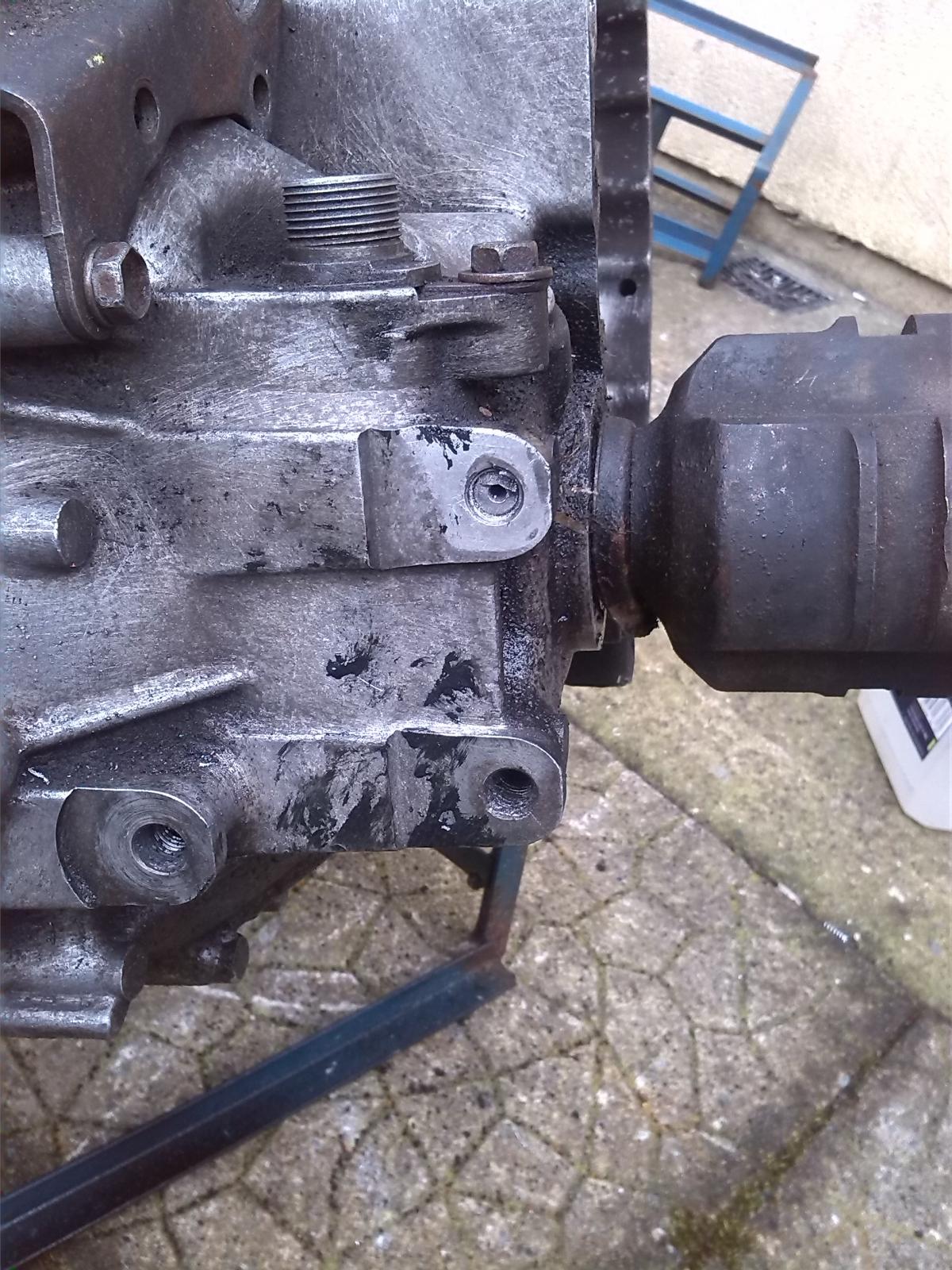

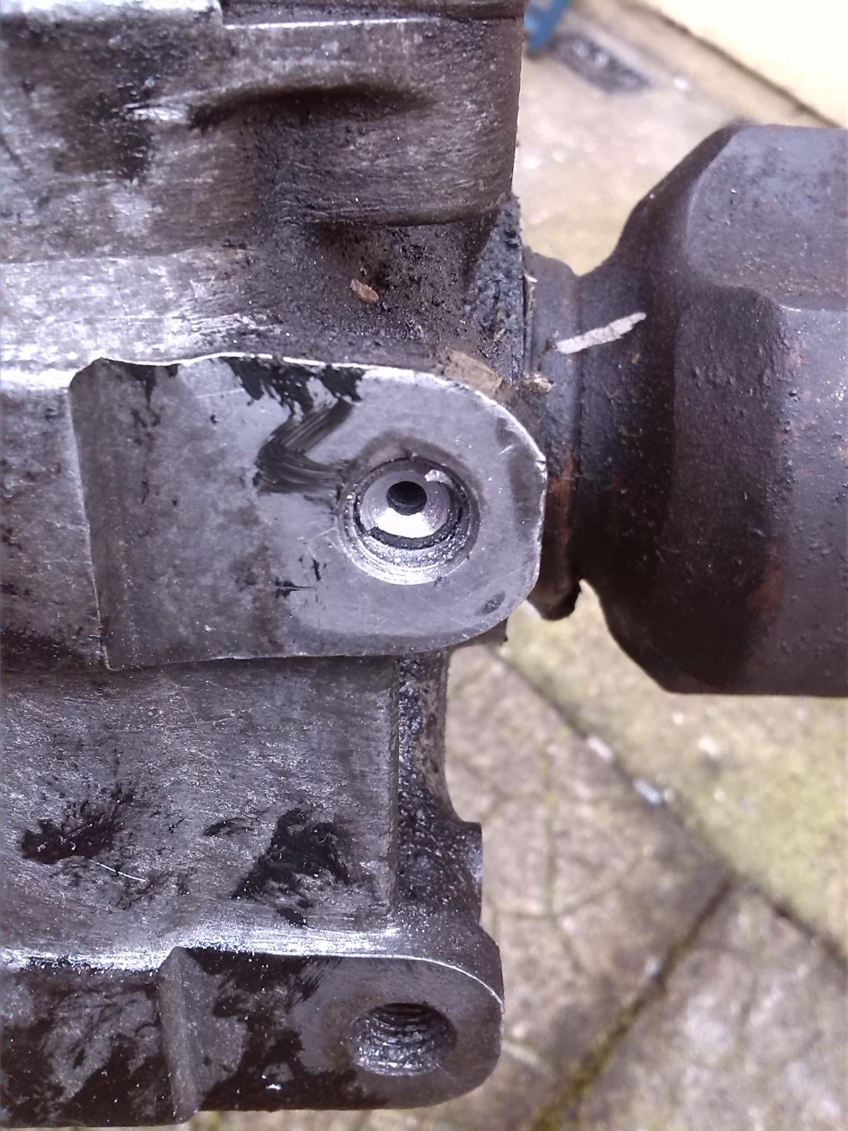

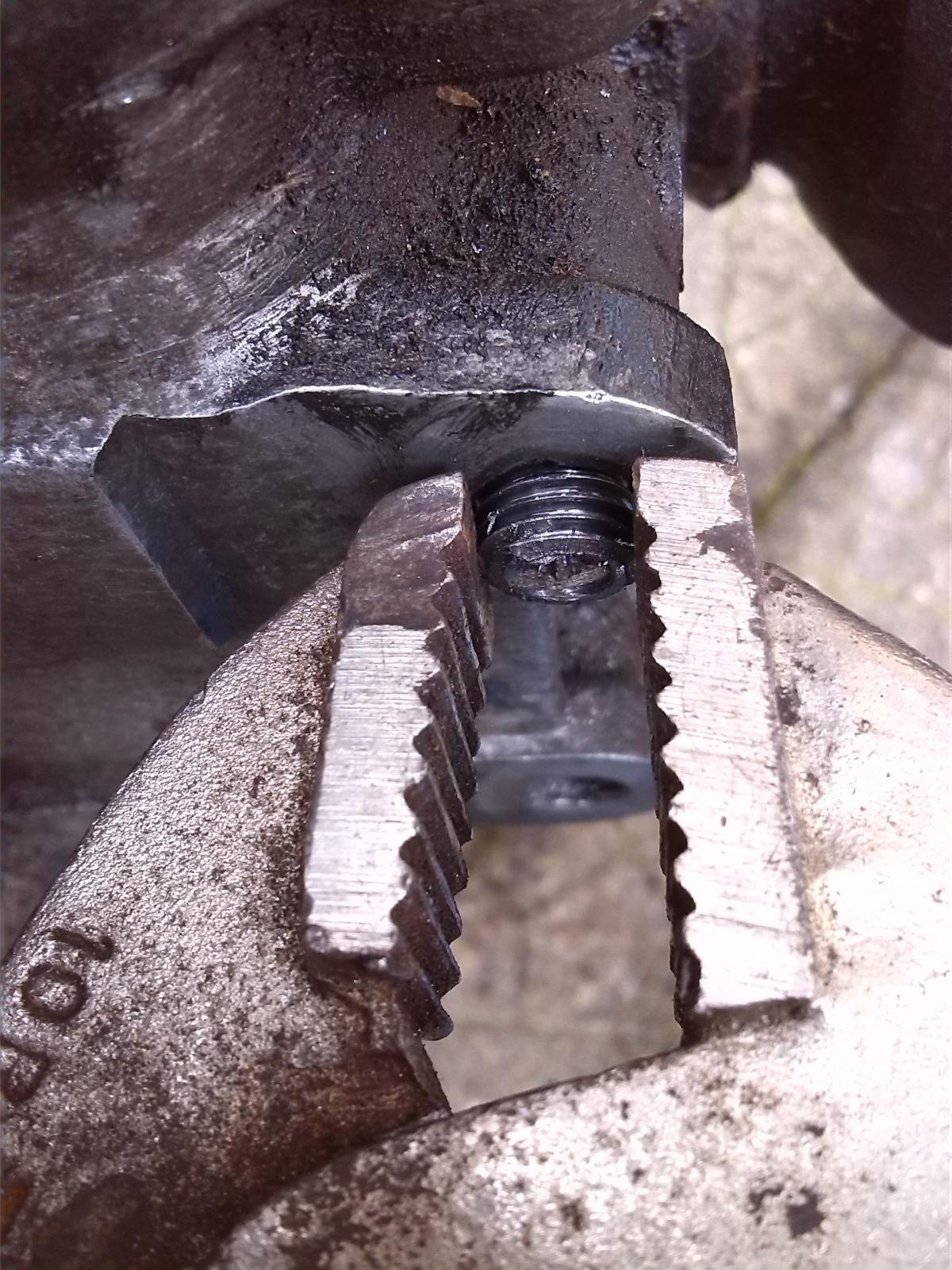

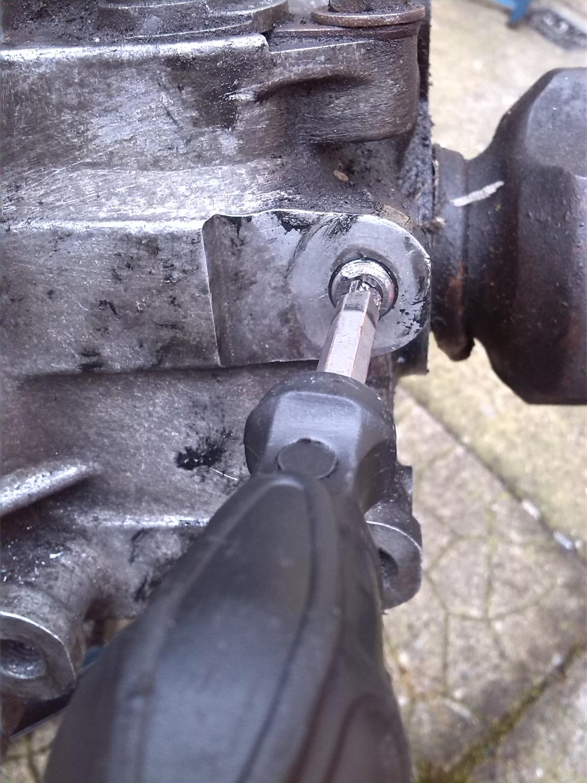

5e colin Posted March 10, 2016 Author Posted March 10, 2016 (edited) that box landed and wasnt sellers fault it had a big pink sticker on it hold in depot !!! nice and shinny after my clean she was caked in cv grease dam that was some job to get off also didnt come with the rear mount bracket but did come with the 2 inner cups and in 1 of thew was still the triballs stuck in the grease so big plus point to have them spare 1 off the bolts for the rear mount was snapped of so heres my attempt of getting it out Edited March 10, 2016 by 5e colin Quote

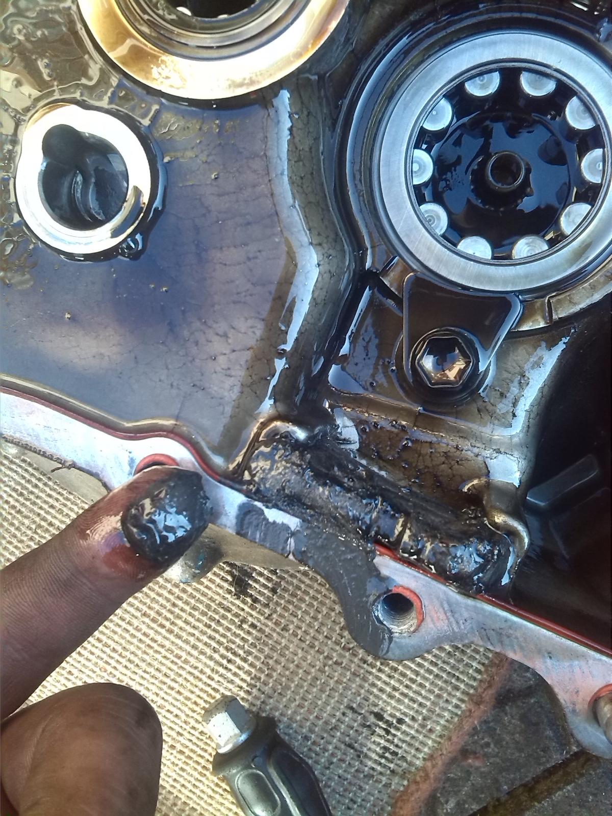

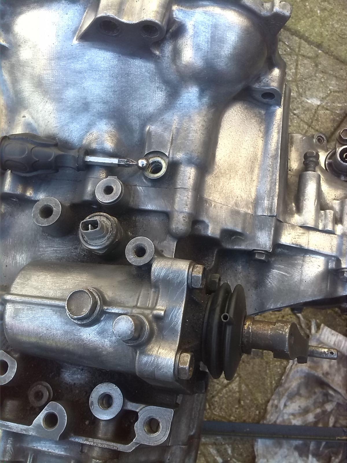

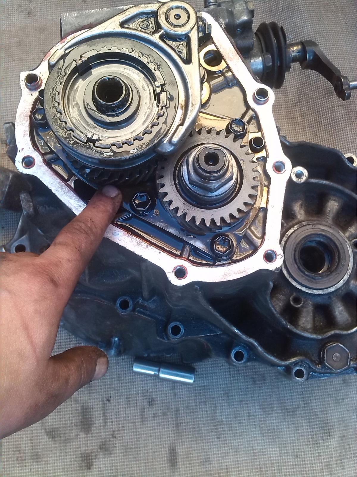

5e colin Posted March 14, 2016 Author Posted March 14, 2016 (edited) thanks richard but i got sorted for that getting a fulll freebie NA box tomorow with all the mounts just have to fit a wheel bearing as a trade i ripped open the turbo box i just got and its not looking good the oil was gray and full of metal filings inside the magnet was cacked in metal paste brrrr dunno if this is a saver box ??? also the bearing on the input shaft underneat 5th gear is sooo loose the output 1 is solid im not sure if its drivable till i can get my lsd 1 fixed fuck fuck fuck Edited March 14, 2016 by 5e colin Quote
