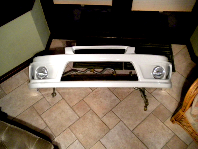

Socks Posted March 21, 2011 Author Posted March 21, 2011 are thm 3 angled valve seats i can see fella, uuummmmmm. i am getting the tools to do these soon. did you gride down the inlet valve guid boss to sit flush with the port. just a little note, wen looking at the combustion chamber can u see wer the milling tool cuts the valve seat, this can be removed along with the back side of the exahust valve helps spool up and volumetric efficent of the cylinder by quite a bit if u look at the pic of your exhaust valve open u can see how it only flow around 60% of its circumfrence. also wat port velocities did u manage on the flow bench i have found that around 70m/s (260ft/sec) gives great max hp, and around 50-60m/s (165ft/sec) for peak torque. but these are just calculation as paul sold his engine before we could do a dyno run. gutted.ill let ricky answer that looks clean, standard valves or oversized dude?standard i believe dude Iddy... i didnt want to bodge the 98 fogs in cus im a bit of a perfectionist... I believe me in my opinion... you have to bodge 98's to gettem to fit... the mounting locations are completely different got the 96's in the bumper tho, nice snug fit, perfect and secure and looks mint Quote
ollie ryan Posted March 21, 2011 Posted March 21, 2011 96spec fogs let it down abit, but this is an epic build Quote
Socks Posted March 21, 2011 Author Posted March 21, 2011 96spec fogs let it down abit, but this is an epic buildif u can find me a genuine 98spec varis front bumper.... please let me know Quote
Dan507 Posted March 21, 2011 Posted March 21, 2011 The 96 spec fogs are fine, you should get some yellow flim and wrap them Quote

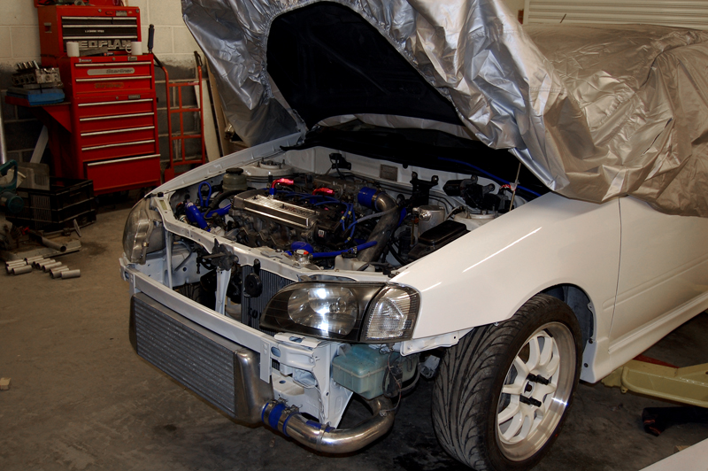

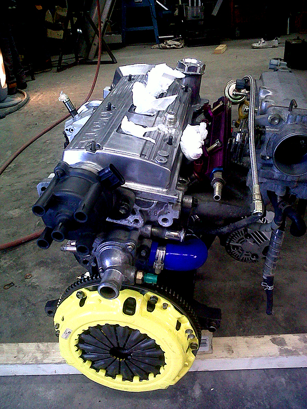

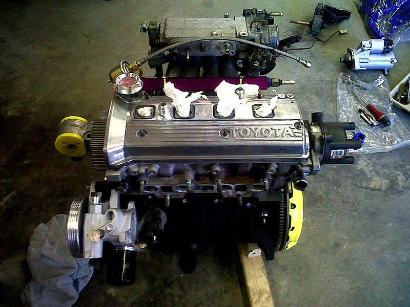

Socks Posted March 23, 2011 Author Posted March 23, 2011 ill do a photoshop and see!anyways... after dribbling over a 650bhp civic eg6, i got down to bring the few last little bits to ricky for my engine...spark plugs, front bumper, clips for skirts. etc odds and ends basically!Engine is all built up now!however we hit a snag! I misplaced my clutch release arm, after going through my whole garage, rickys garage, my car we couldnt find it!However 1 perosn came a long way out there way to help me out!BIG THANKS to LukEP, who came down from manchester just to bring me a spare clutch release arm! Because of this the engine is now in the shell Woop!More pics and updates to follow Quote

Socks Posted March 23, 2011 Author Posted March 23, 2011 as the car stands atm. very little left to do tbh!Ricky and his Crew are doin a great job! Quote

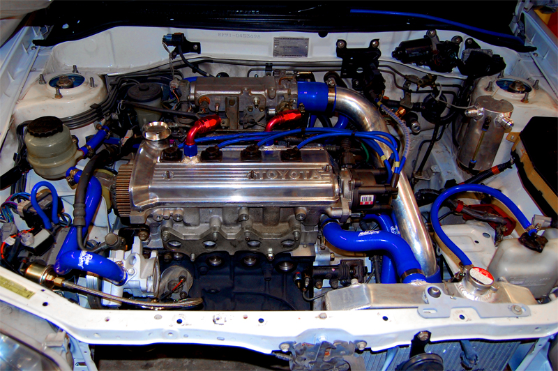

Sparky Posted March 23, 2011 Posted March 23, 2011 Bay looks fucking awsomeeee, cant wait to see a fat top mounted turbo there Quote
