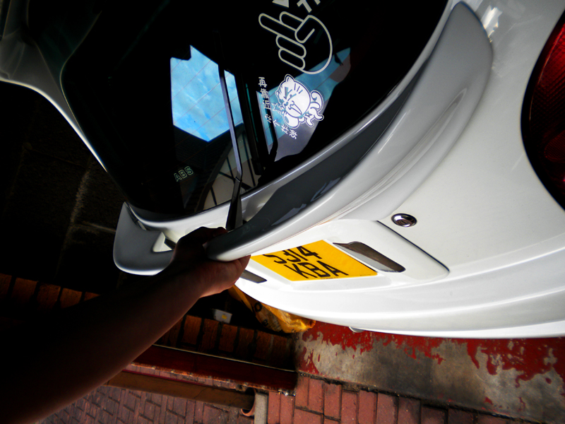

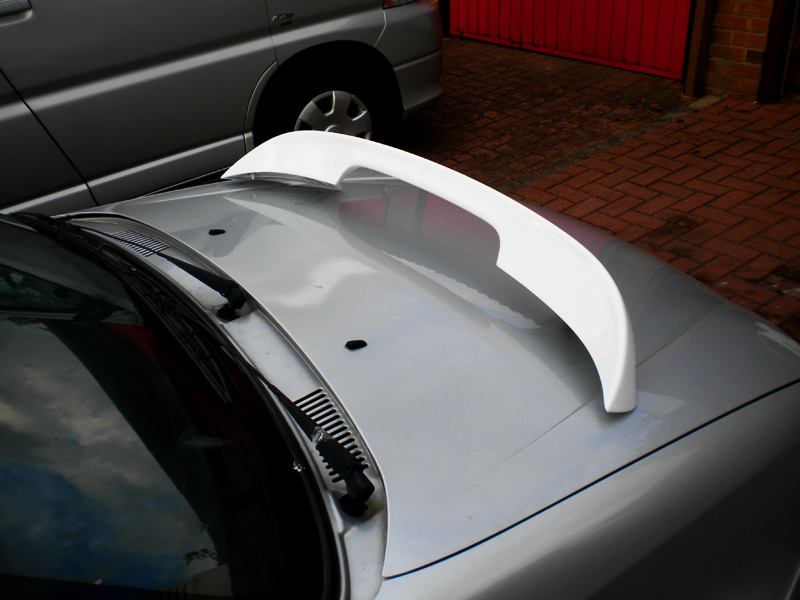

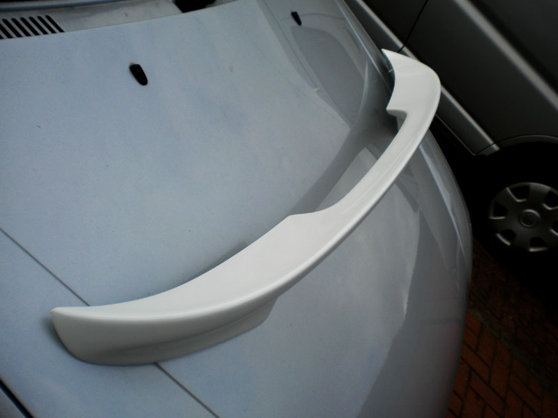

Socks Posted September 2, 2011 Author Posted September 2, 2011 Duck Spoiler is back from the paint shop! Cant wait to get this on! Shitting myself though, gonna have to drill holes in my boot! lolOn a bad note tho, ive had a failure.My turbo has decided it didnt want to boost all of a sudden and its looking like a bearing or comp wheel failure... Completely un explainable, but its going back to be sorted under warranty.Its nothing Ive done, nor is it anything Ricky@Race-Tech has done, its somthing wrong with turbo, so im taking it off this weekend to be inspected properly!But it means the car wont be at Trax, JAE or Japshow Finale...Ill try get myself to JAE, as its looking like it will be great! But without my car wont be the same :harhar:Unfortunatly for me, its a 4-5week wait on a new core for the turbo! Fucking Cars ehy, but unlike alot of you pussies out there, it isnt getting broken for bits, im gonna get turbo sorted and get back on track. I ordered a new distributor yesterday form toyota to cure my slight missfire. So hopefully when the turbo is sorted, we'll be ready for mapping properly!Good and Bad news tbh, but thought id update ya! Quote

shorty Posted September 2, 2011 Posted September 2, 2011 Heres a tip, i used two slim filter tips (swan,rizla what ever) pocked them in the bolt holes on the spoiler so they stuck out a bit and blobed tipex on them then when you push the spoiler in place it will leave to marks where the holes need to be drilled, if its a proper oem spoiler it will only sit properly in one place :harhar: you cant realy go wrong as it lines itself up pretty much Quote

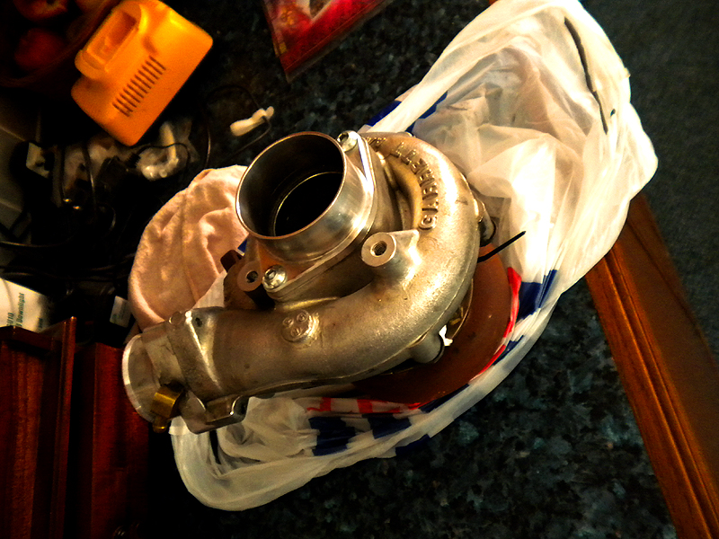

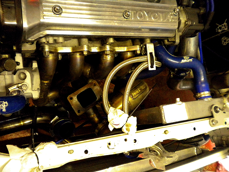

Socks Posted September 3, 2011 Author Posted September 3, 2011 Cheers for the tips!Well the turbo is off now.. Its so easy to take off when top mounted. The bolts we all facing up or at 90deg non facing down lol. Took me about 20mins! and 1 goosed blower:Ricky has it now, going to strip it down and examine. Should know more soon enough!Replacement should hopefully be made up and sent out to me asap! Quote
