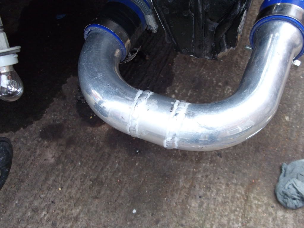

Steve GT Posted March 14, 2011 Author Posted March 14, 2011 turbo pushes the end of the hot pipe too far back so need to modify and extend pipe. which means ally welding it and the people I've given it too have had it a week and half and not nothered yet Quote
lukEp Posted March 14, 2011 Posted March 14, 2011 Yeh get the pipe back and take it else where or just cut it and extend it With silicone joiners mate Quote

Socks Posted March 15, 2011 Posted March 15, 2011 wat a ball ache!the turbo is rotated too much (alot more then stock)so the hot pipe is rubbing on the front support bar (too far forward) and the bottom of the hot pipe is pushed back towards the engine. meanign the fmic pipework has to be extended by 1.5inchs!we cudnt use a silicone joiner luke cus its right on a curve/bend and wouldnt join properly and securly with a joiner fights us every step of the way fucking thing.. Quote

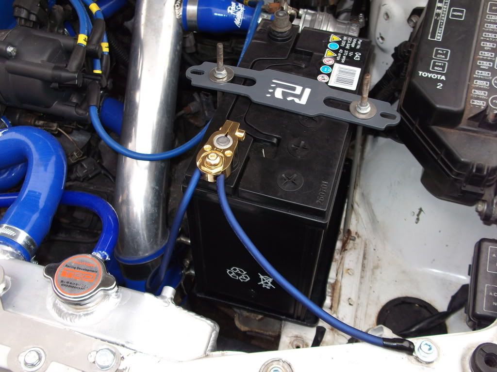

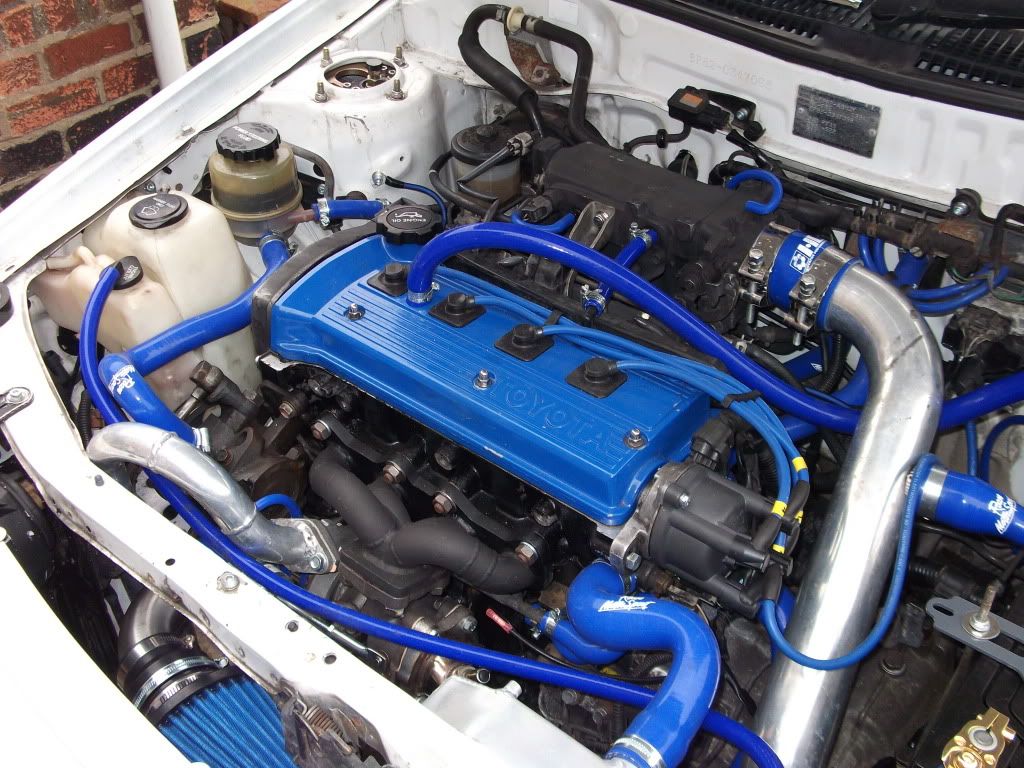

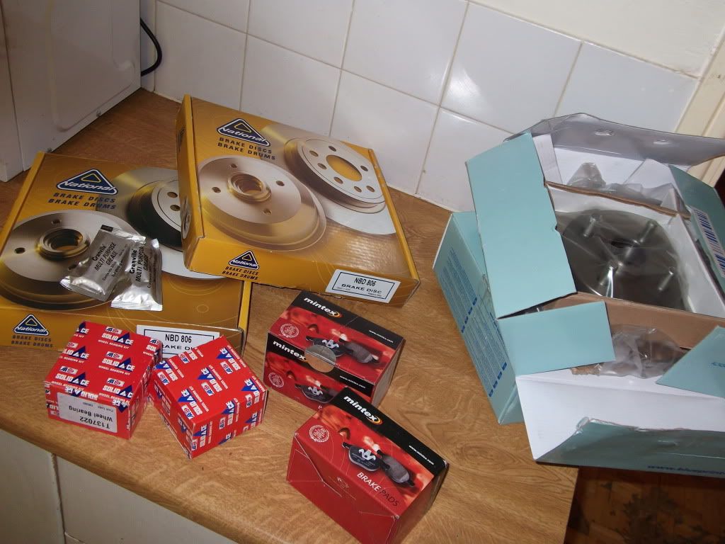

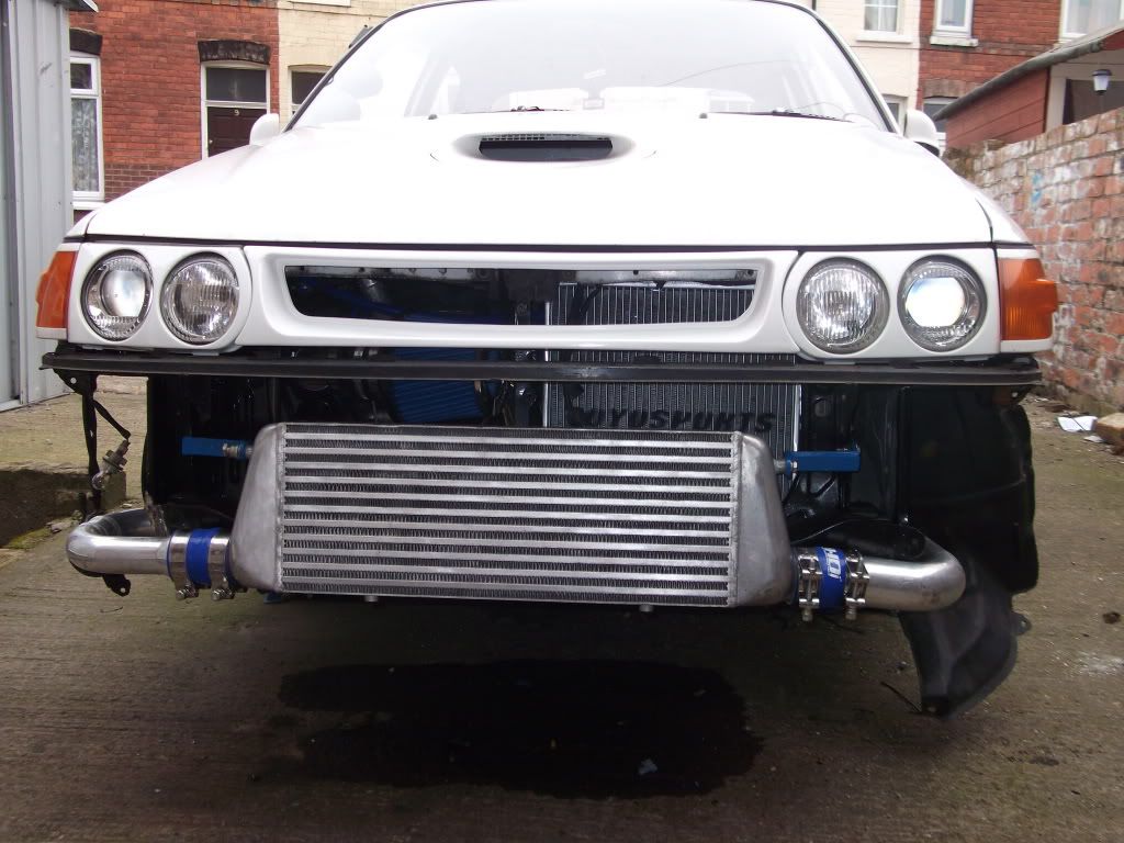

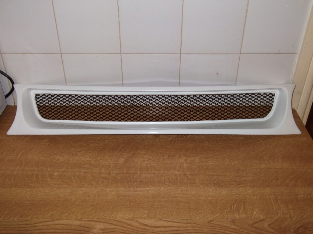

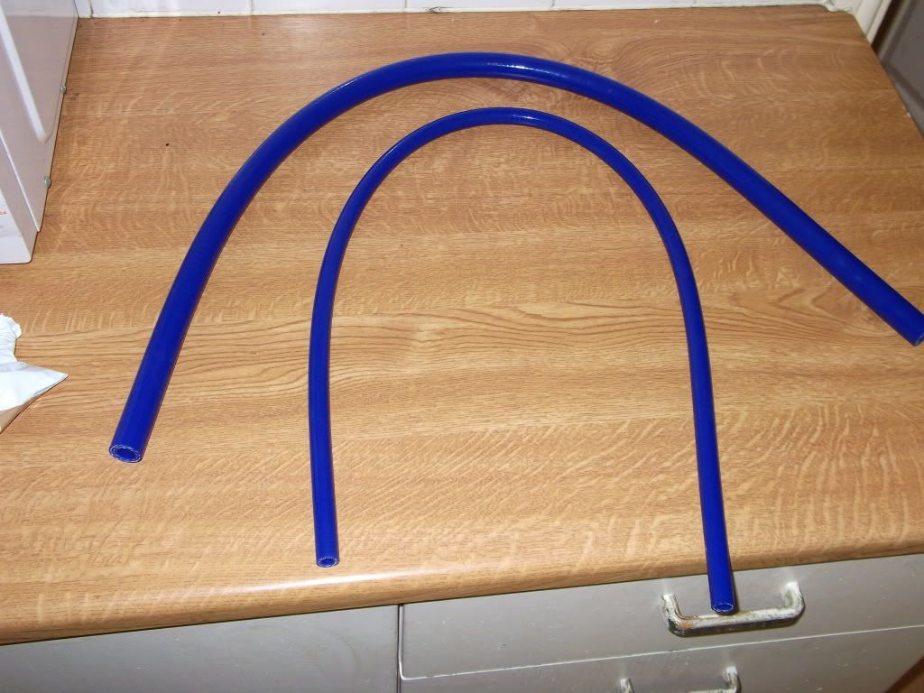

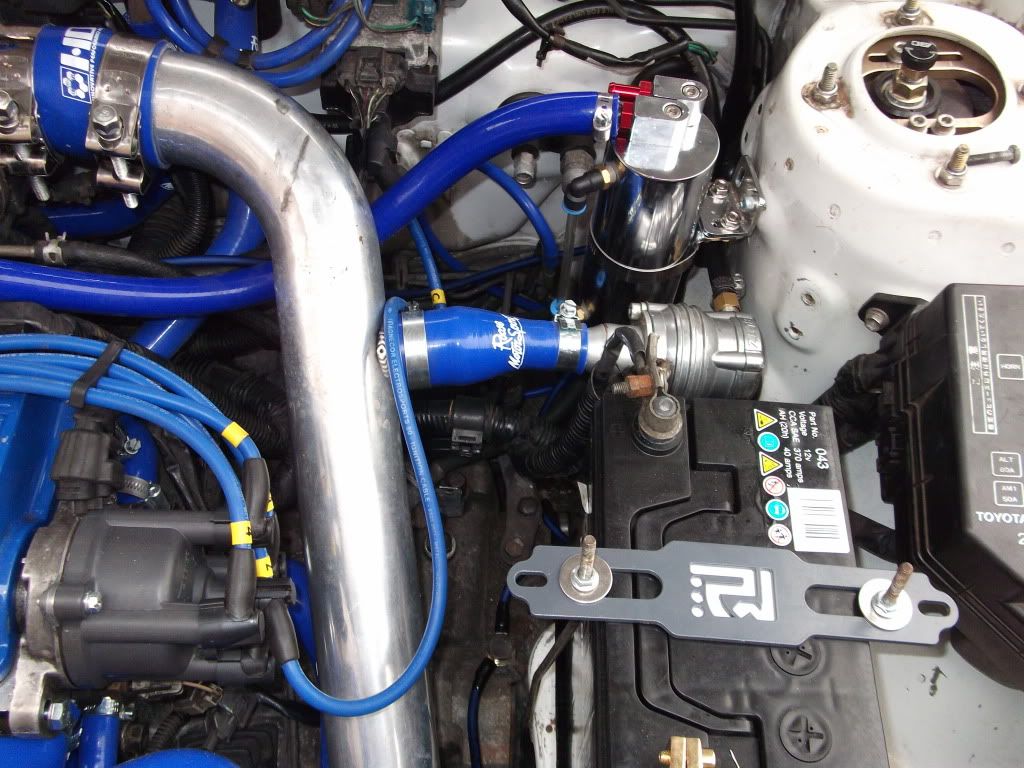

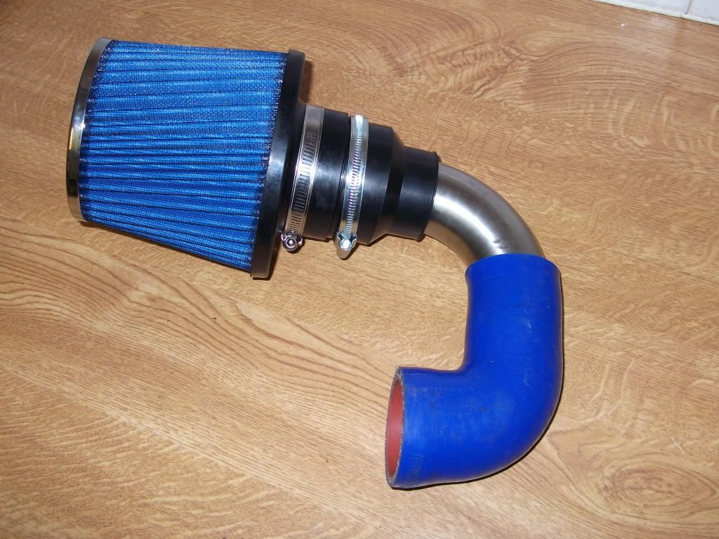

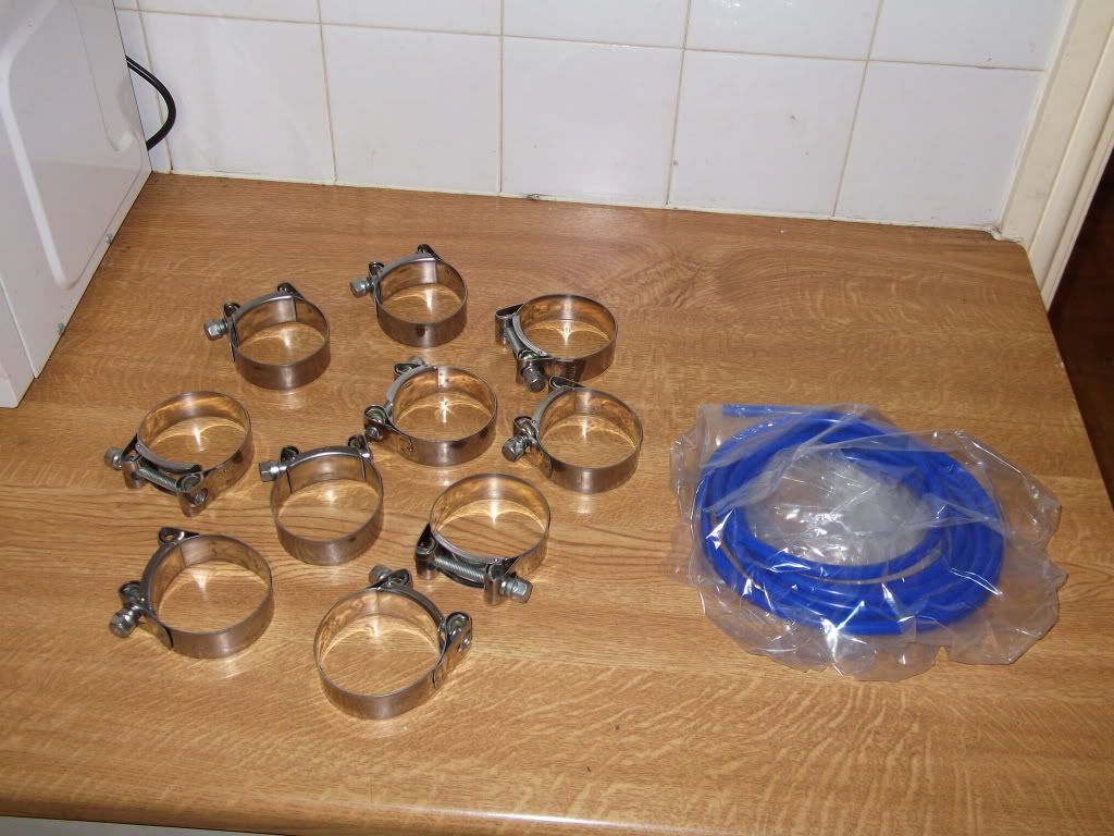

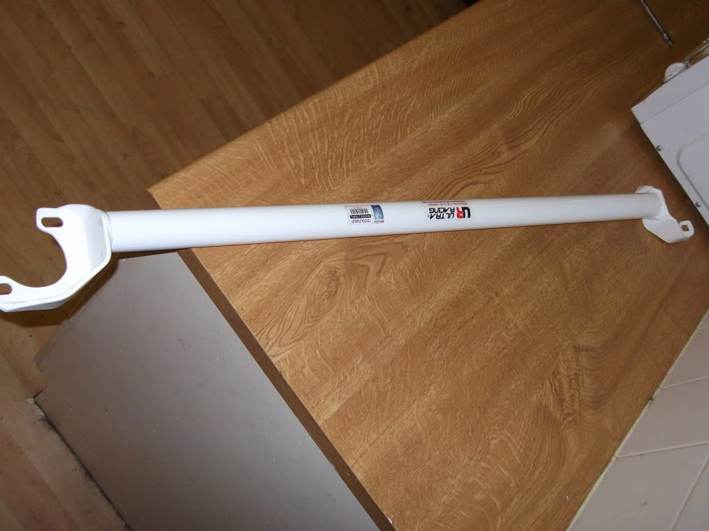

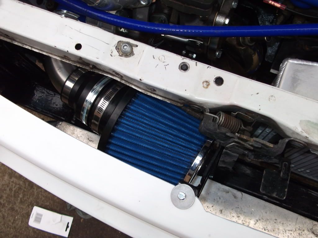

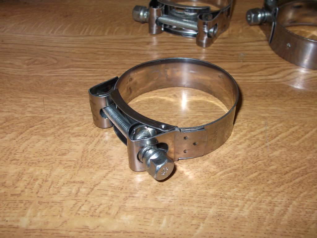

Steve GT Posted March 16, 2011 Author Posted March 16, 2011 Right update timefirstly few bits came throughAir filter to fit my relocation kitUltra racing rear strut brace (finially)Front and rear pads and discs and wheel bearingsID workz toms style grill sprayed and meshed (thanks socks )Mikalor jubilee's from roose motosport and some more vacuum hosing. the clamps are so strong and stable its unreal. deffo worth buying to fix a FMIC pipes togetherAlso from roose motosport they made me up 2 hoses for my Oil catch can and as the standard hose for the radiator was too short for my civic rad i got another one made up for that Then started to get things fittedFirst earthing kitAlso new battery, Intercooler pipes, dumpvalve and oil catch canAll hoses fittedNew extended intercooler pipe to fit hybridFilter relocation kitEnd of day resultAlso my mines ecu came through from Riko666 yesterday. Thanks for the lovely message by the way sweethart Todays plans are to fit the brakes and also try sort out the high idling problem Quote
iamlegend Posted March 16, 2011 Posted March 16, 2011 looking mint mate big well done!!yea them clamps came with my FMIC and they are mint are strong Quote
Steve GT Posted March 16, 2011 Author Posted March 16, 2011 cool. the clamps that normally come with them are the hdi ones. there 10mm fittings pretty good. but these mikalor ones are 13mm much bigger and much stronger. deffo worth the upgrade Quote
nazzurro19 Posted March 16, 2011 Posted March 16, 2011 ahh man this is gettin sweeter by the day socks : do you fancy meshing my grille for me its a standard mk2 ine but butchered really small will pay for service lol Quote
Steve GT Posted March 16, 2011 Author Posted March 16, 2011 cheers lads its looking lush now loving itGot some rota grids on order too which will look the dogs nads Quote
Sparky Posted March 16, 2011 Posted March 16, 2011 Looking awsome mate I just ordered a load of new T clamps etc bye bye boost leaks lolHope your going for Bronze grids Quote
Steve GT Posted March 16, 2011 Author Posted March 16, 2011 nah was going to be gun metal but I've fell in love with the white ones Quote

Johnboy GT Posted March 16, 2011 Posted March 16, 2011 Nice one Steve i was looking for ages for Mikalor clamps.. Didnt know about Roose Motorsport though. Few questions, what size clamps and how many of each did you order because i have a HDI intercooler but cant remember the 2 sizes... 2" or something?Next question is what did you ask for, for the hoses for your Power steering reservoir and that? Just a length of what ever sizeAnd im going to be running a Tongs hybrid with my HDI FMIC, was a wee bit of a struggle getting the pipe on the turbo but i got it on... This gonna be stressing the turbo with the pipe pulling at it?Great write up as ever... Should be a comp for the best build thread Quote
