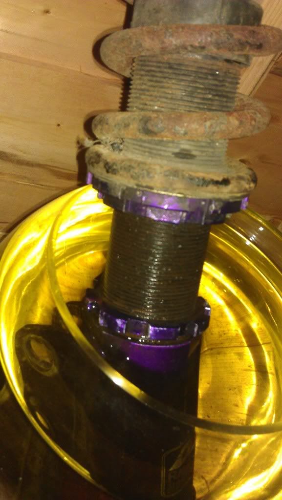

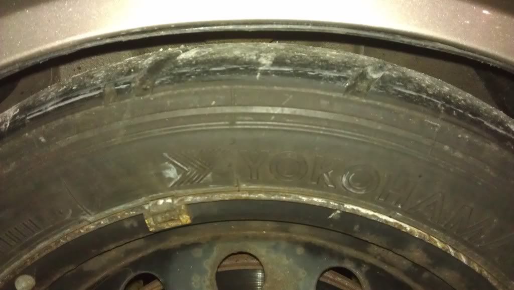

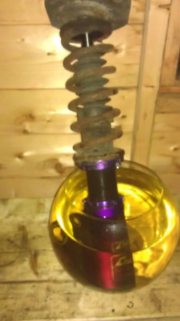

Taggy Posted January 17, 2012 Author Posted January 17, 2012 Yay got my car page back got my suspension adjusted too, its was completly seized on the left hand side, soaked it in parrafin over night and then heated it up with a torch and bang! it came loose Here is me soaking the naughty D2 CoiloverIt was jammed on the bottom bit which spins around to adjust the heightA quick pic of why my car was rubbing, too low!!Sorted now, happy days Also i have started spraying my stealth steelies fresh black, got a wire drill on them to clean them up an then started spraying, got one done tonight, will do another tomorrow I'll get some pics up they look really nice considering they are steel rims! Quote
Josh@TunerLifestyle Posted January 17, 2012 Posted January 17, 2012 nice work mate! amazing what abit of paraffin and a torch can do Quote
