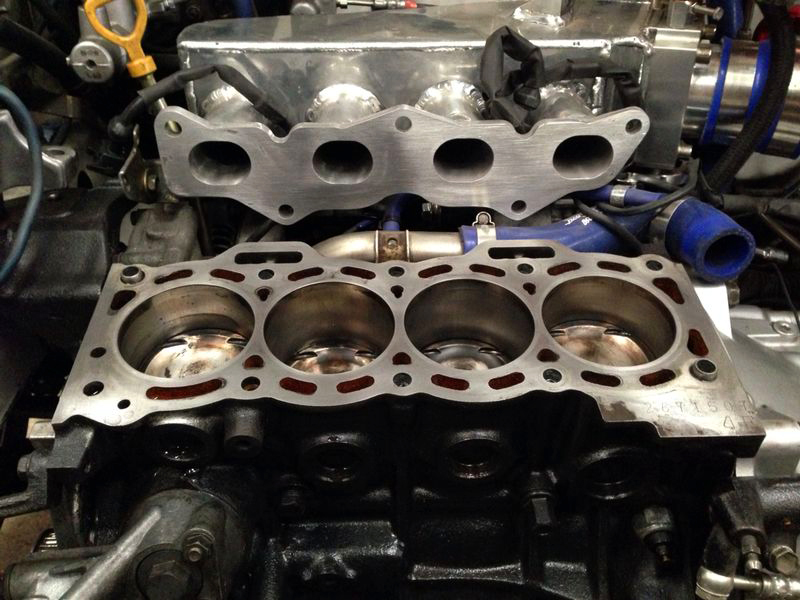

AdamB Posted May 13, 2014 Posted May 13, 2014 Sorry my mistake I thought it was the electrode that had failed and not the ceramic gauging by what was posted.High EGT's can cause the electrode to go into a molten state and drop off into the cylinder if hot enough, however since it wasn't the electrode that had failed then that's irrelevent now. Heat range 9's certainly wouldn't have been ideal I don't believe and should only be used when running exotic fuels and or nitrous, I believe Spuddy before had ran 440bhp on heat range 8's with no problems at all.Saying the plugs look perfect can be quite misleading in some cases, that's not the actual condition of the plug. How does the insulator look, what colour is it? Is there any deposits on it? Is the nose pitted or blistered? Are the electrode/s discoloured or eroded? etc etc. The condition of the combustion chamber looks like its wet in the pictures Matt posted, is there any signs of oil leakage from the valve stem seals or excessive clearence on the valve guides? Or is it just the way the picture comes across? Quote

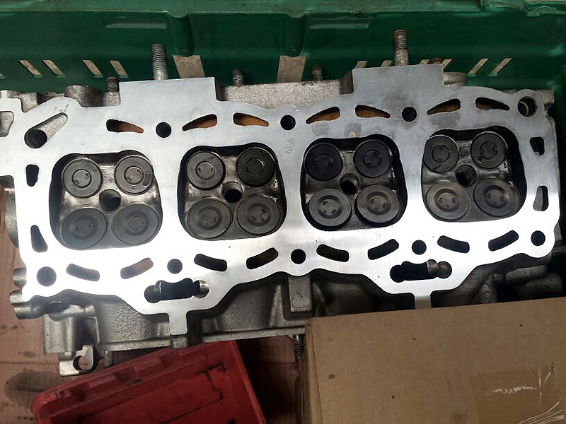

Socks Posted May 15, 2014 Author Posted May 15, 2014 That's Better All The Machine Work has been done. All the rest of the valves have been inspected and cleaned up. All is well again in the head on Sock's Glanza! Quote

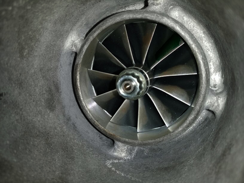

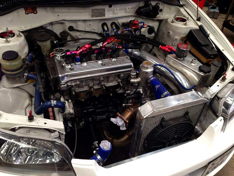

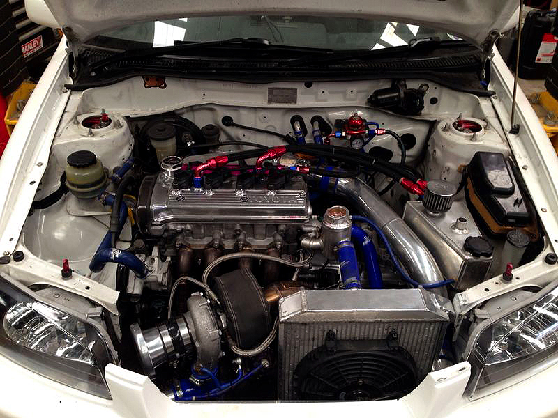

Socks Posted May 23, 2014 Author Posted May 23, 2014 Ok! So after lots of pretend crying and being really down about the car over the last week or so. (Having stunning weather hasn't helped!)Ricky's been keeping me posted, keeping me updated on progress of shipping of my new turbo from Garrett USA. I was told they wouldn't crack on with the engine reassembly until the turbo had arrived however, so they could blast it in one go...So I've practically been whatsapp'ing Ricky everyday, asking if there is updates on the turbo tracking number. Nope Nope, Left USA, Nope, Nope, Arrived in Customs, Nope, Nope, Nope, Nope..Message him this afternoon, is the turbo still in customs? Yeh man, not good....30mins pass and I get this pic:Turns out the sneaky fuckers at Race-Tech had been planning to get it done for me as a bit of a surprise for the bank holiday weekend. However they just ran out of time.So yeh, the engine has been reassembled for quite some time.The turbo arrived yesterday and the car has been run up, it sounds sweet apparently!Few Snaps of Assembly:Turbocharger wise, I've gone for the GTX version this time, (a Billet Wheel version) of pretty much the exact same turbo. The Compressor wheel is slightly bigger but I shouldnt be loosing any spool time!All being well ill get her back next week Excited! Quote
