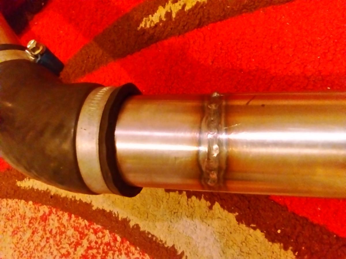

5e colin Posted December 11, 2016 Author Posted December 11, 2016 (edited) so my first ever diy tig weld ( ss ) for on the car section of pipe for the topmount im actually very pleased for a nooob can only get better from now on still have LOOOOOOTS TO LEARN but getting there now ish dipping every 20seconds now instead of every 3 ha ha Edited December 11, 2016 by 5e colin Quote

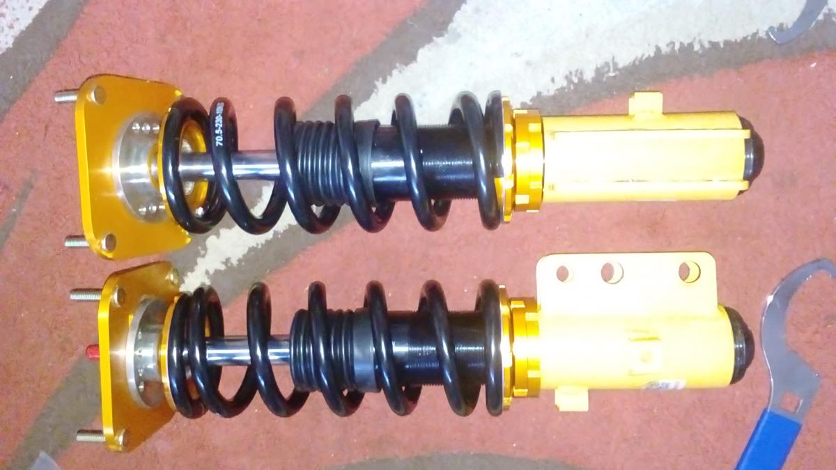

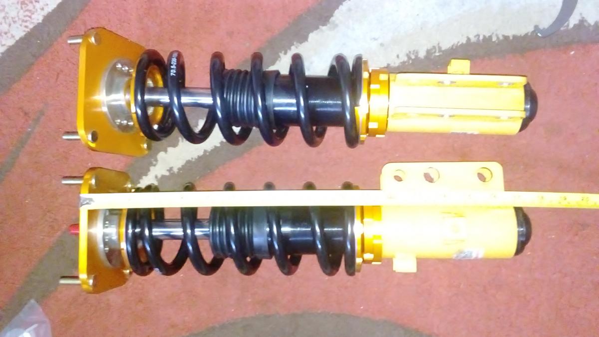

5e colin Posted February 6, 2017 Author Posted February 6, 2017 (edited) fc3s and they drive fecking great 21 level damping works well i have the 10/8 setup and love it you can also get the 8/6 these are much chunkyer and build better then those ( TA technics , fk , and jom ) eurocrap coils i tryed fron the polo never again also i noticed with these if they burst they can be opened for koni inserts etc etc up front my tires tuck in the arch wel low if wanted on the back i am goin to have to swap to a shorter spring ( 230mm atm ) and a helper spring to get lower 150mm spring 8K and a 80mm helper spring to go extra low Edited February 6, 2017 by 5e colin Quote

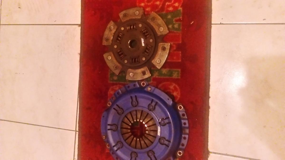

5e colin Posted February 17, 2017 Author Posted February 17, 2017 (edited) got myself a spec stage 3 clutch disk is worn ( disk was freebie ) not much left on it good for templete ( as seller told me ) so if anyone knows where i can buy replacement disks please tel me Edited February 17, 2017 by 5e colin Quote
daniel_g Posted February 17, 2017 Posted February 17, 2017 Surprised you aint supergluing a few brake pads on that to use again haha Quote
Aamir Posted February 18, 2017 Posted February 18, 2017 Surprised you aint supergluing a few brake pads on that to use again haha 😂😂😂😂😂😂 Quote
5e colin Posted February 18, 2017 Author Posted February 18, 2017 Surprised you aint supergluing a few brake pads on that to use again haha you know of any glue ?? discs can be re padded read it somewhere so might be an option Quote
daniel_g Posted February 18, 2017 Posted February 18, 2017 you know of any glue ?? discs can be re padded read it somewhere so might be an option Defo use rivets. Quote
5e colin Posted February 18, 2017 Author Posted February 18, 2017 (edited) 😂😂😂😂😂😂Hey amir you guys sell puc discs.??? Edited February 18, 2017 by 5e colin Quote
adzy Posted February 18, 2017 Posted February 18, 2017 You can get a clutch re-lined.Place in Belfast does it, but that's a bit far for you! Quote

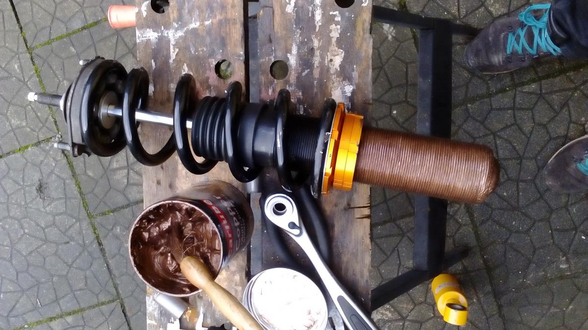

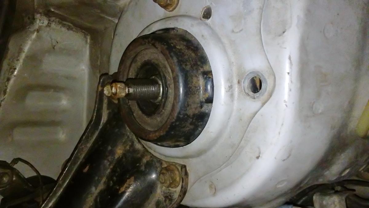

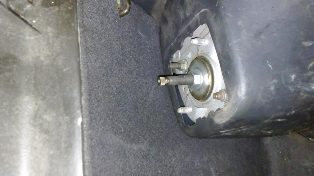

5e colin Posted February 20, 2017 Author Posted February 20, 2017 (edited) You can get a clutch re-lined.Place in Belfast does it, but that's a bit far for you! thanks will look into it here some pics from the rx7 coils bolted in the car with starlet topmounts ( rears 1mm drilled ) Edited February 20, 2017 by 5e colin Quote

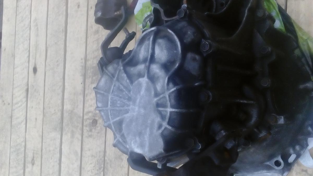

5e colin Posted April 5, 2017 Author Posted April 5, 2017 (edited) so going to rebuild this here c52 got few new parts for it so going to do it the next few days if the weather stays good any easy tips on cleaning the outside of the box lads ??? i bought the alu paint for it but theres lots of backed on ancient dirt and grease Edited April 5, 2017 by 5e colin Quote
