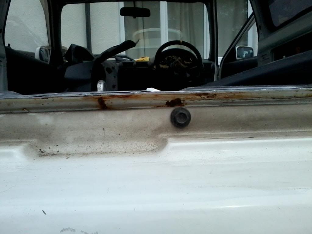

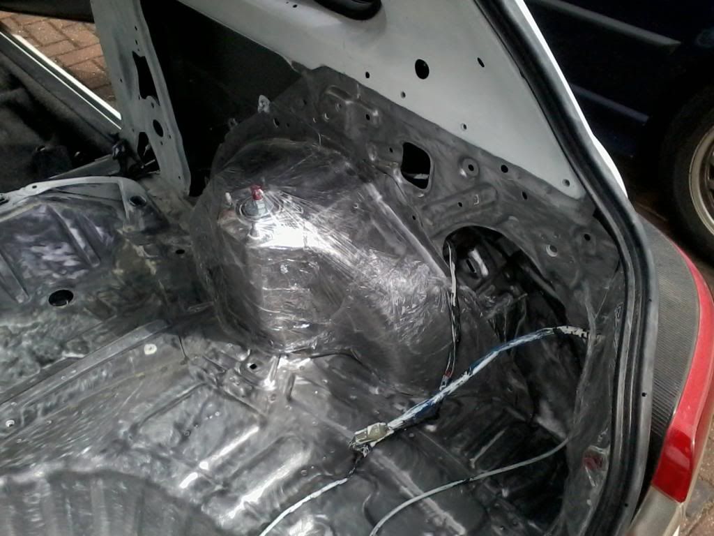

AdamB Posted July 26, 2013 Author Posted July 26, 2013 Finally got off my ass and done some more to the car, and have finally finished removing all the paint from the rear. Then I removed all the seam sealant which I couldn't get at with the wire brush, using acetone and a scothbrite I went over all the area's around the outside and tried to get into the seam as much as possible to remove any of the glue residue that was left behind. I then gave it a quick wipe over with a sponge and dried off to remove any dust that has been left over. http://s164.photobucket.com/user/BoobZ18/media/Toyota%20Starlet%205E%20Build/2013-07-26135343_zpsd6263867.jpg.html'> After seeing some parts starting to get surface rust after removing the paint, mainly around the strut tops I decided to spray WD40 and wrapped it up to try and keep oxidation at bay. http://s164.photobucket.com/user/BoobZ18/media/Toyota%20Starlet%205E%20Build/2013-07-26140927_zps1a2a5cc6.jpg.html'> http://s164.photobucket.com/user/BoobZ18/media/Toyota%20Starlet%205E%20Build/2013-07-26140931_zps7ff61f88.jpg.html'> http://s164.photobucket.com/user/BoobZ18/media/Toyota%20Starlet%205E%20Build/2013-07-26140939_zps622e7ca5.jpg.html'> Then I removed all the shit that was in the front to the back to give me some space to now work at the front. I need to hoover the carpet before I pull it up as its full of dust, mud and all sorts. http://s164.photobucket.com/user/BoobZ18/media/Toyota%20Starlet%205E%20Build/2013-07-26142240_zpsf6a4a72f.jpg.html'> When I was going over the car with a sponge I pulled the rear boot rubber off and noticed that behind had gone pretty rusty and started to flake off, I reckon there's about 2-3mm left of material there before the rust goes all the way through. Can anyone recommend some good rust removal stuff as I think this will be the next job on the list before it gets any worse. http://s164.photobucket.com/user/BoobZ18/media/Toyota%20Starlet%205E%20Build/2013-07-26135401_zps6dca5a18.jpg.html'> http://s164.photobucket.com/user/BoobZ18/media/Toyota%20Starlet%205E%20Build/2013-07-26135355_zps4da0c4de.jpg.html'> http://s164.photobucket.com/user/BoobZ18/media/Toyota%20Starlet%205E%20Build/2013-07-26135404_zps63f8bc8f.jpg.html'> I think what's happens is that the boost rubber is not keeping water out, and when its rained water has sat behind the rubber and had no where to go so its started to rust. Quote

Lew91 Posted July 26, 2013 Posted July 26, 2013 Nice work Adam, shame about the rust tho. I used this stuff on all my mild steel bits, seems to have done the job. http://www.bilthamber.com/hydrate-80It's had some good reviews to and it's easy enough to apply. Quote
AdamB Posted July 26, 2013 Author Posted July 26, 2013 i get like that, havnt done much in the last few weeks. It's a lot of work seam welding a carI know mate, it's weird, sick an tired of looking at a heap of metal though lol. Nice work Adam, shame about the rust tho. I used this stuff on all my mild steel bits, seems to have done the job.http://www.bilthamber.com/hydrate-80It's had some good reviews to and it's easy enough to apply.Thanks mate, I'll look into that a bit more tomorrow. My dad swears by something called jenolite but doing a quick google search a lot of people say its not that good and the rust comes back pretty quickly afterwards. Quote
Lew91 Posted July 27, 2013 Posted July 27, 2013 I've never heard of it lol. Hammerite also do kurust which is meant to do the same job never used it myself tho. Quote
maddox710 Posted July 28, 2013 Posted July 28, 2013 We do jenolite at work,a few people have came in and said its really good stuff Quote
shorty Posted July 28, 2013 Posted July 28, 2013 My cousin and uncle have mg b's and swear by bilthamber products mate. Seen results firsthand and its bloody good stuff. Not the cheapest tbf but seriously good product.cars coming on lovely now Quote
