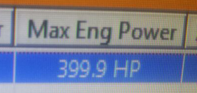

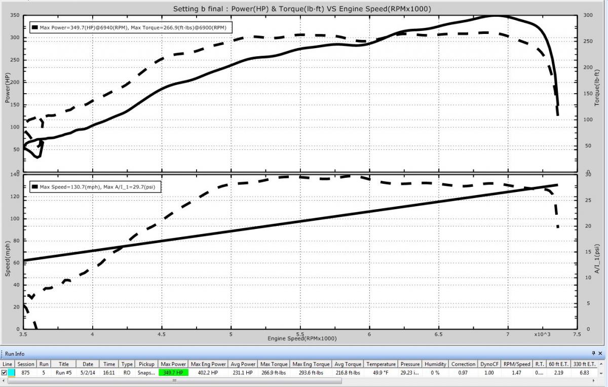

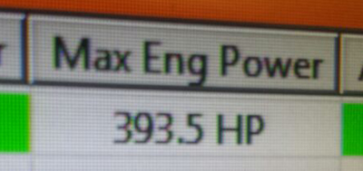

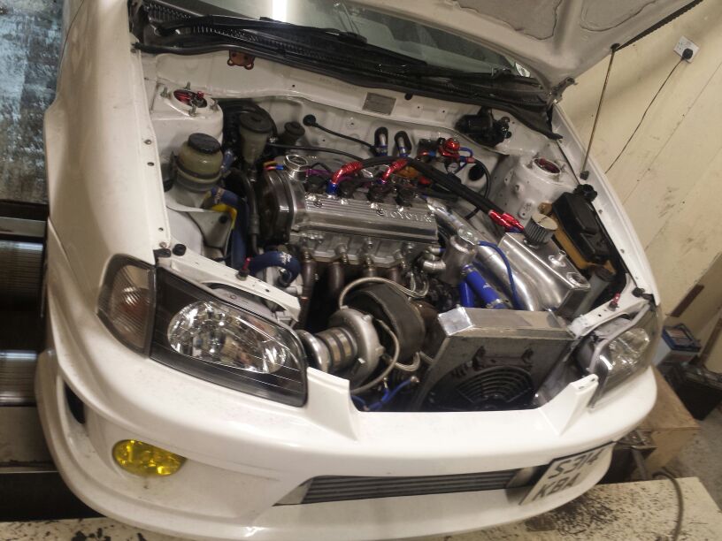

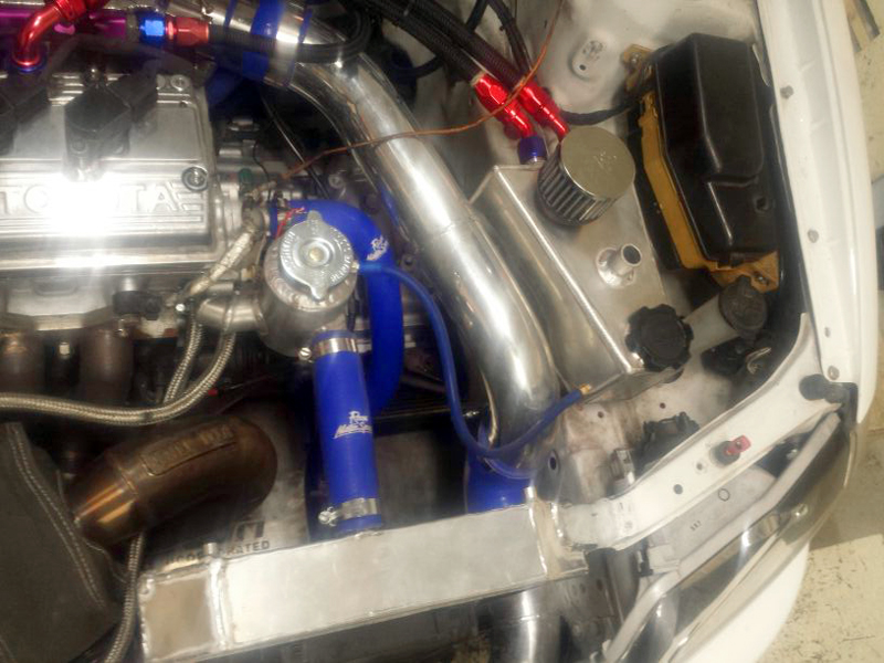

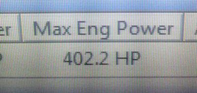

Socks Posted May 2, 2014 Author Posted May 2, 2014 All So Kind Comments! Thanks Folks..... So! A well overdue update on my car! However, this is a good update that's left me smiling! My Custom Oil Catch Tank/Coolant Expansion Tank is finished and on the car... It looks like 1 big tank and the oil and water would mix in there, not the case. The Oil Catch Section is at the top. The Coolant Expansion Tank is at the bottom, with the filler pipe coming up through the Oil Section. Clever, Tidy and Unique! Uses the same fitting as a 4efte rocker cover so ill add an aftermarket cap at some point! So then came the mapping. There were several hurdles that we had to jump. Had a couple of little issues last week that were rectified and this afternoon, Ricky got to run some boost through it! Did some base mapping and some low boost mapping before starting to up the boost pressure. Set the Boost Pressure to 2 Bar, did a pull and I received this picture on whatsapp: Which for those who aren't in the know. Is .3bhp off Ryan-11's current record of 393.8bhp... Our setups are very similar in a few ways. 4E-FTE, Inlet, ECU, Turbo Size. etc Ricky said there was more in it, so he continued. With the Boost Pressure set at 2.15bar and a bit later on in the day I got this picture on whatsapp: Which was thank you very much record, but a kick in the balls for the pub chat bullshit... I can hear it now at japfest, hahahahaha, its not 400bhp... So Ricky carried on and even later on in the day... With the Boost Pressure set to 2.05bar and more tweaks, I got this picture on whatsapp: Which is exactly where I wanted to be, on pump fuel!... The turbo is completely maxed, the injectors are not far behind... However Ricky didn't want to push it too much as lifting the head off the block was a worry, I have ARP head bolts but even still, since we are in unknown territory... Might be worth considering studs! Still a bit more mapping to be done start of next week to finish it off, but power wise we are there... Im collecting the car Tuesday Evening all being well! Roll On Japfest 2014 Folks, Ill be seeing you there! Final Graph: Little Dyno Tease for you all: http://youtu.be/_31g8jG0EW4 Roll On Summer! Quote
mattyD Posted May 2, 2014 Posted May 2, 2014 Nice, quick question.......how has it made less torque with more boost?? Doesn't make much sense! Quote
turbo Grant Posted May 2, 2014 Posted May 2, 2014 Nice, quick question.......how has it made less torque with more boost?? Doesn't make much sense! Probably because the timing has been retarded a bit to compensate for more boost. Don't want no detonation Nice result! Quote
