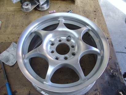

Stu Posted August 5, 2014 Posted August 5, 2014 (edited) Not sure what you have available in your area but bead or media blasting will take all of that off really quick without damaging the metal. Its usually reasonably cheap and will save you hours of work. Keep up the good work! EDIT: Found a pic of what mine came up like - were shitty as beforehand... Edited August 5, 2014 by Stu Quote

Dale SR Posted August 5, 2014 Posted August 5, 2014 if you take your speedlines to a powder coaters get them to acid strip them for you. i have had it done to a set of mine. never affected the speedline badge. and its much easier to smooth off with primer. will save you hours of rubbing the old shitty paint. plus you will have a better finish when it comes to painting them. Quote
morgey Posted August 5, 2014 Author Posted August 5, 2014 Ahh acid dipping thats an idea. Cheers dude ill see what I can find local Quote
Rich-k Posted August 5, 2014 Posted August 5, 2014 They will be fine to paint over jyst make sure no sharp edges from where there are layers of paint and finnish them off with p500 as 400 is a bit too corse Quote
morgey Posted August 5, 2014 Author Posted August 5, 2014 They will be fine to paint over jyst make sure no sharp edges from where there are layers of paint and finnish them off with p500 as 400 is a bit too corse Yeah I was happy with this one other than clearing around the text, but theres another 4 to do lolIll probably finish with 600 as I can get that from work for free! Still dont know what colour im doing them yet anyway, will just get them sanded/acid dipped and primered until I decide Quote
