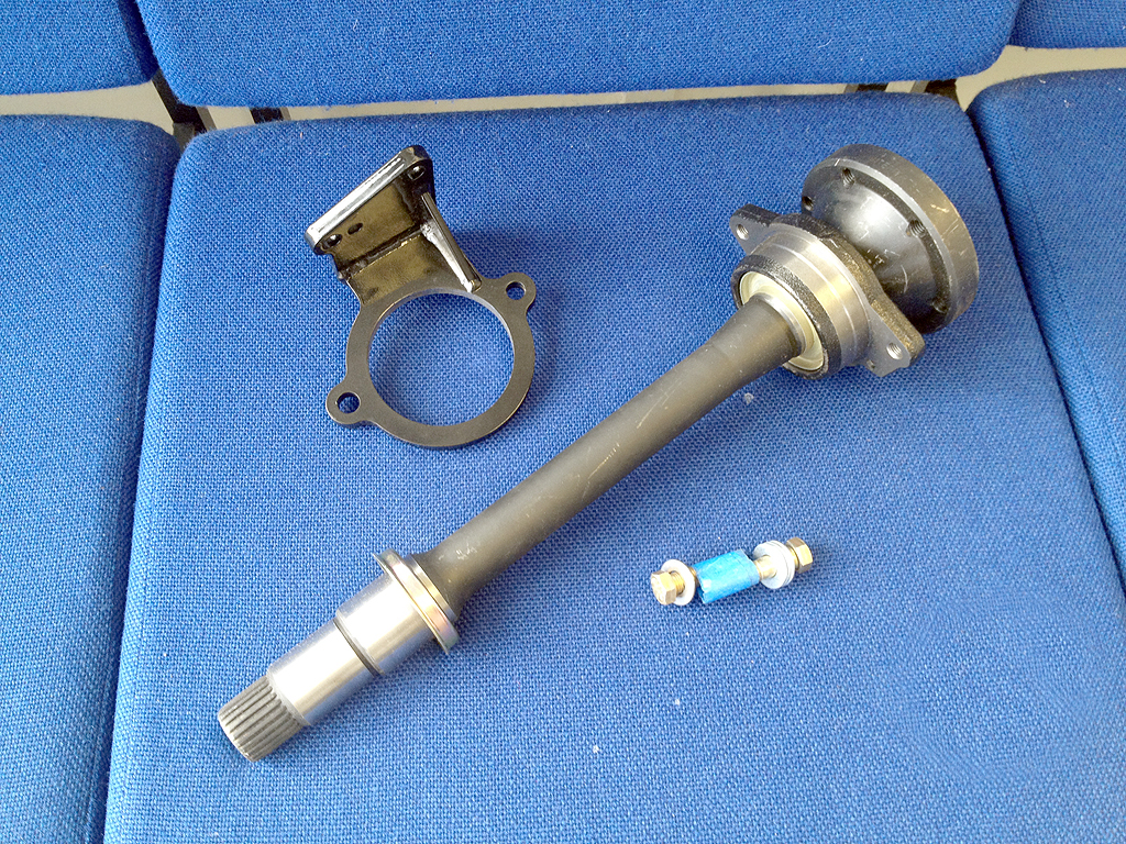

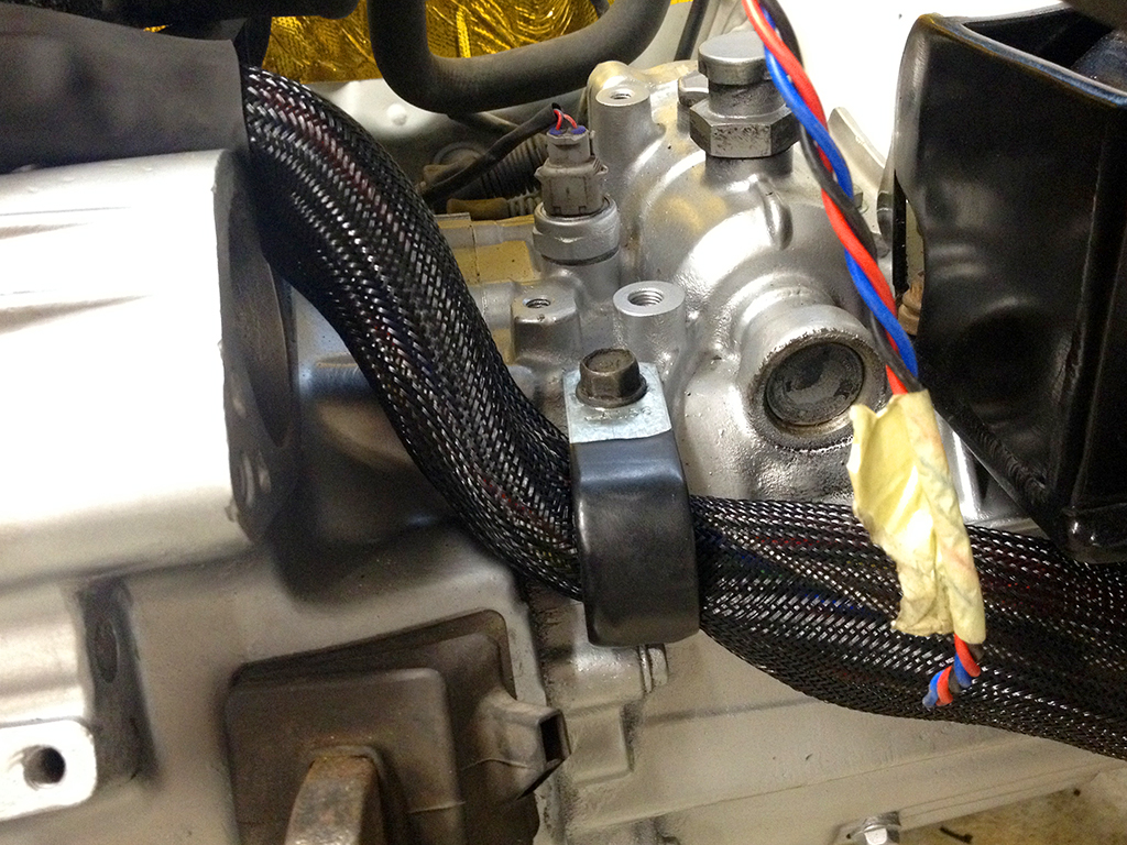

Socks Posted October 16, 2014 Author Posted October 16, 2014 Cheers Chaps. The boys at Race-Tech are doing a sterling job, as always! No I really cannot wait to drive this car now! Driveshaft's are on going atm. There taking measurements carefully, to make sure the shafts are going to be the right length to go though the full motion of steering lock & suspension travel! More goodies from the states too... Custom Half-Shaft to work with the MR2 Turbo E153 Gearbox and bearing/mounting adaptor to mount up to the 2ZZ-GE Block. Going to be such a strong drivetrain even had Ricky a little jealous himself Quote

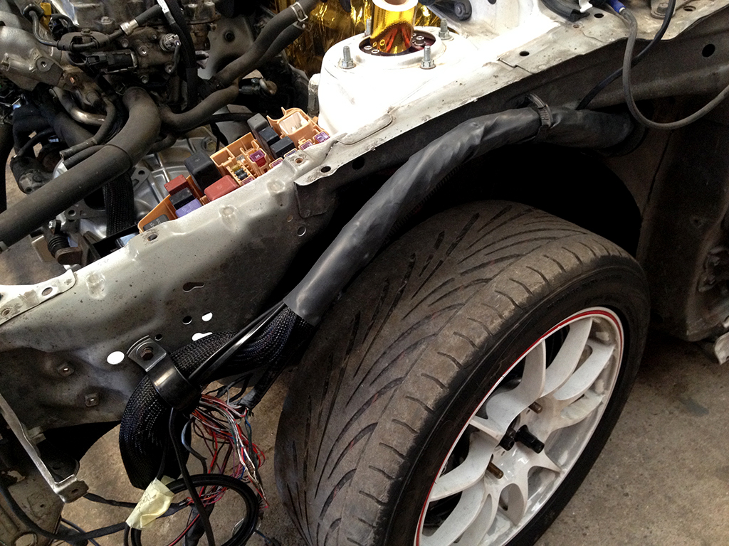

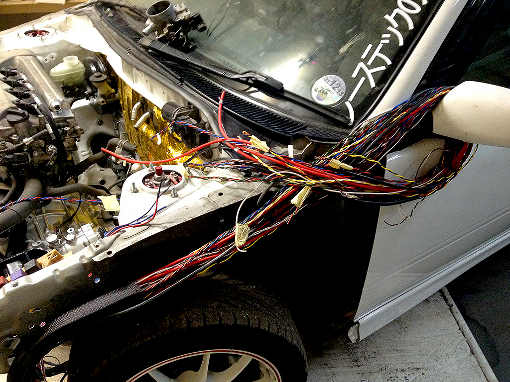

Socks Posted October 21, 2014 Author Posted October 21, 2014 Cheers Chaps! Loom is done on the engine bay side now. Just need to finalise my choice of ECU and get a connector pinned! So many wires, that are coming into the bay hidden via the passenger side wheel arch. Continuing on driveshaft's this week & starting turbo kit soon! Quote

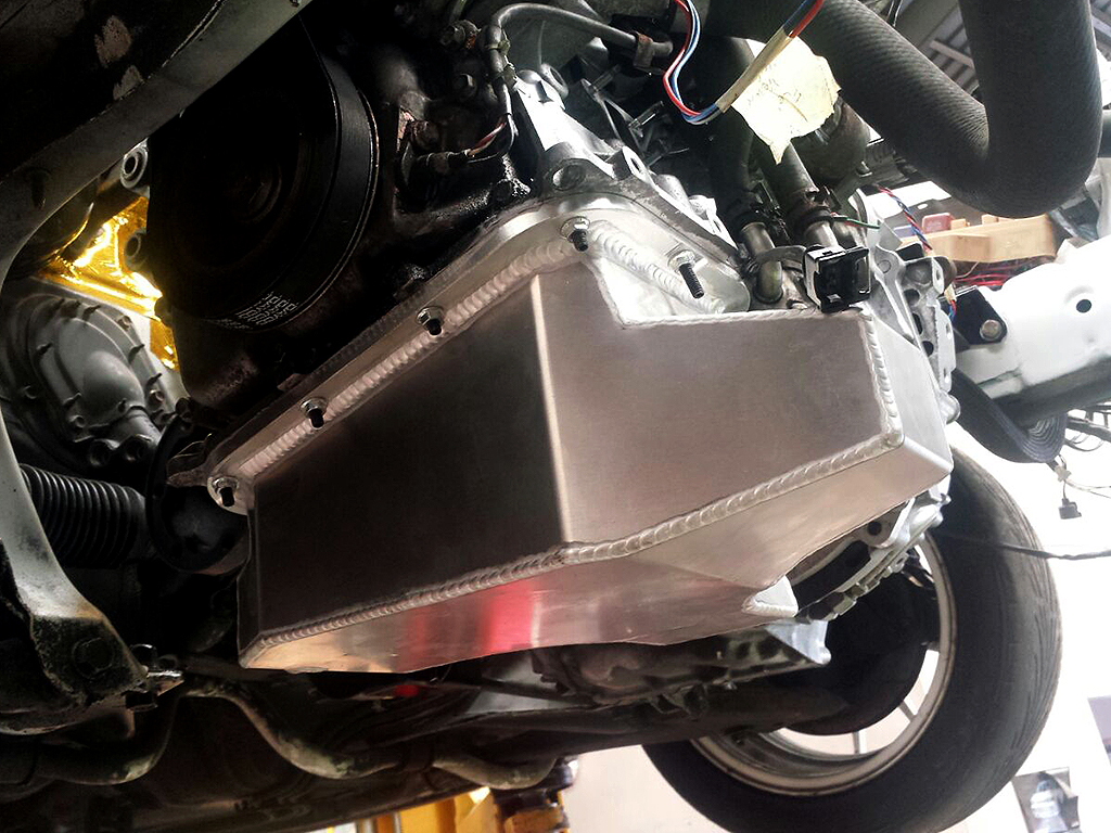

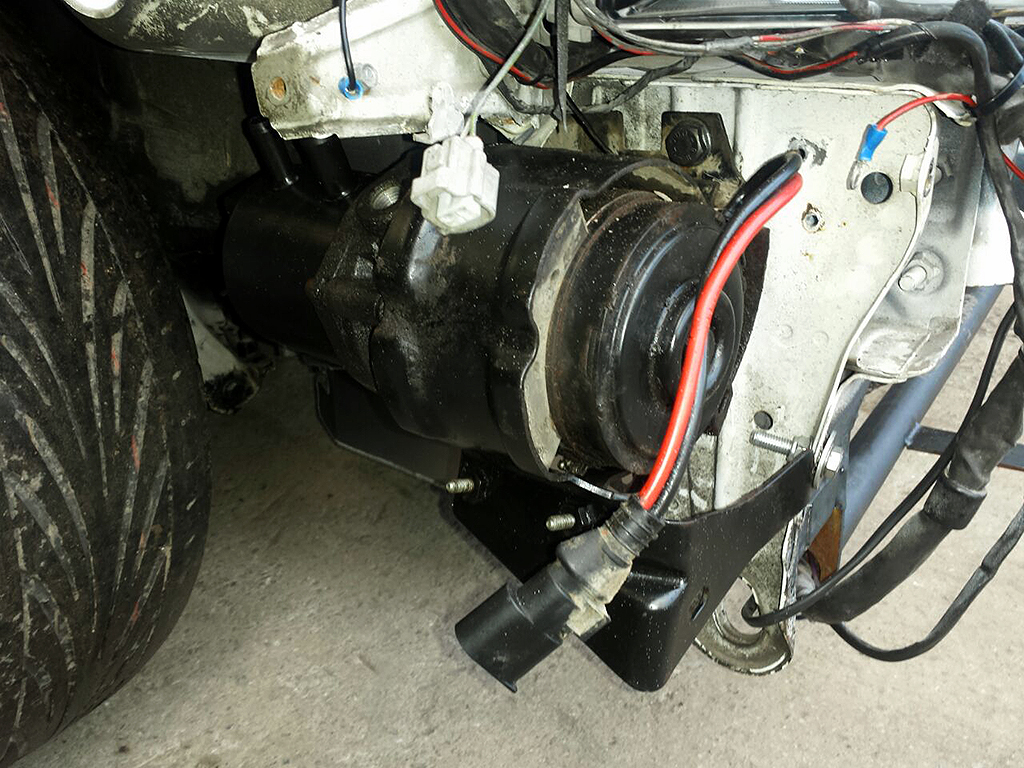

Socks Posted October 27, 2014 Author Posted October 27, 2014 Awesome work, RT are wasting no time with this which is good to see! Cheers idrees! Well over due a magazine feature! Team starlet for the win, good luck Its been offered many times and ive turned it down, as it wasn't finished! But saying that, when the hell will it be?! Truly stunning mate the attention to detail is phonominal!!nice work looking good!Awesome work as always!! Cheers Chaps! Well, since the engine is all mounted up now, the Moroso Sump is no fitted. Im a bit annoyed that MWR told me the sump was no lower then the stock one, when in fact it is. Only by a tiny amount, but still the car needs to have reasonable clearance! Going to try this out first, see how we get on with it on the road. Worst comes to worst, i'll swap it back for a modified stock item Also the 106 electric power steering pump is stealth mounted infront of the drivers side wheel! Lovely Jublie! Onward! Quote

ro55ifumi Posted October 27, 2014 Posted October 27, 2014 Matt See that power pump position somewhere else ;) Keep the updates coming, only thing keeping me keeping hold of mine!! John Quote
_shaun_ Posted October 27, 2014 Posted October 27, 2014 Another 106 power steering set up ha! I don't supose when u have lines made up you could price a 2nd set? I have the pump sitting but nowhere local makes lines so it involves a lot of arsing around for me to measure and have them made. Quote
TrisK Posted October 27, 2014 Posted October 27, 2014 Another 106 power steering set up ha! I don't supose when u have lines made up you could price a 2nd set? I have the pump sitting but nowhere local makes lines so it involves a lot of arsing around for me to measure and have them made.Same. If your offering Matt Ps great job. And the speed of the progress is mental Quote
akaye4000 Posted October 28, 2014 Posted October 28, 2014 Matt See that power pump position somewhere else ;) Keep the updates coming, only thing keeping me keeping hold of mine!! JohnIve the same but on passenger side in same position works well:)Love the work going into this car Quote

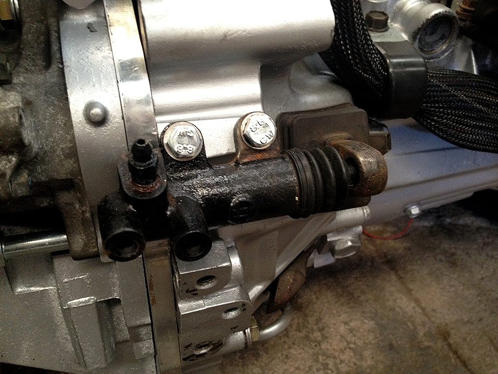

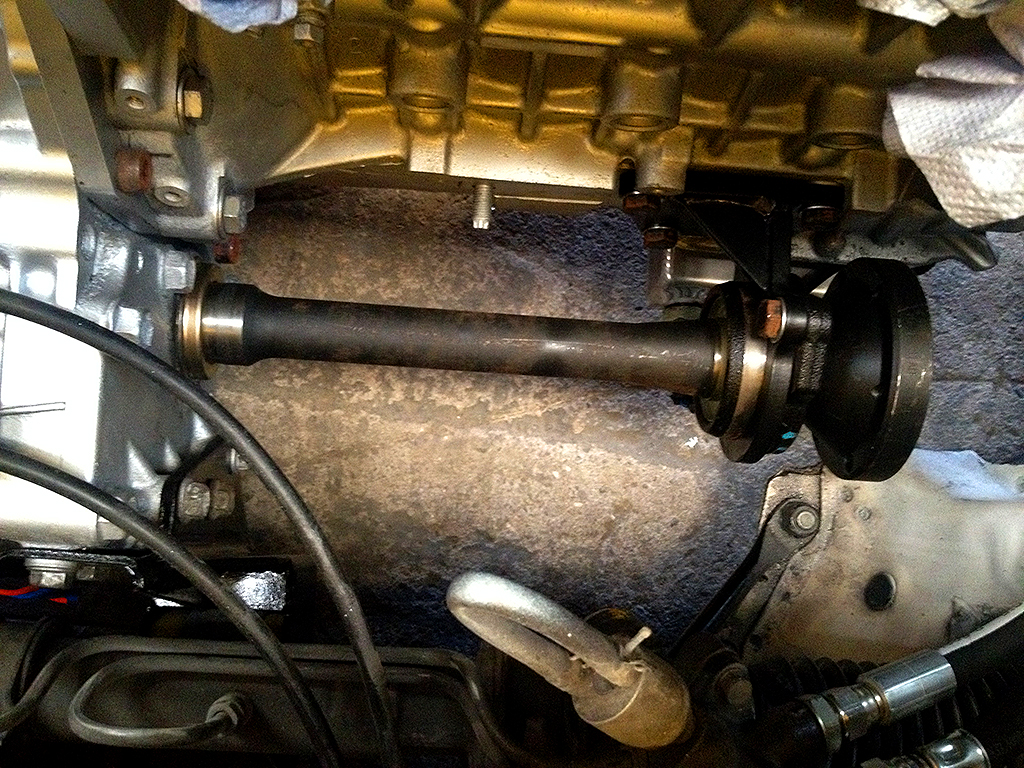

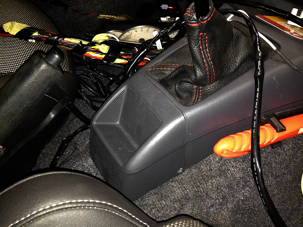

Socks Posted November 3, 2014 Author Posted November 3, 2014 Overdue an update! Little interior part... A P-Sport Center Console... Onto more pressing matters... Ive sourced a slave cylinder! Modified and fitted now. Line is on route too! The Solid Shaft that bolts to the back of the engine is also now fitted! Wiring is nearly there now. Wiring is all in the passenger footwell waiting for ECU Plug & ECU! The best news though is the Turbocharger has been chosen and has been paid for and ordered from Precision More on this when it arrives. Its a large one though haha! Quote

amatthews45 Posted November 3, 2014 Posted November 3, 2014 Curious how your new center console looks from further away? Whats near handbreak now? Quote
