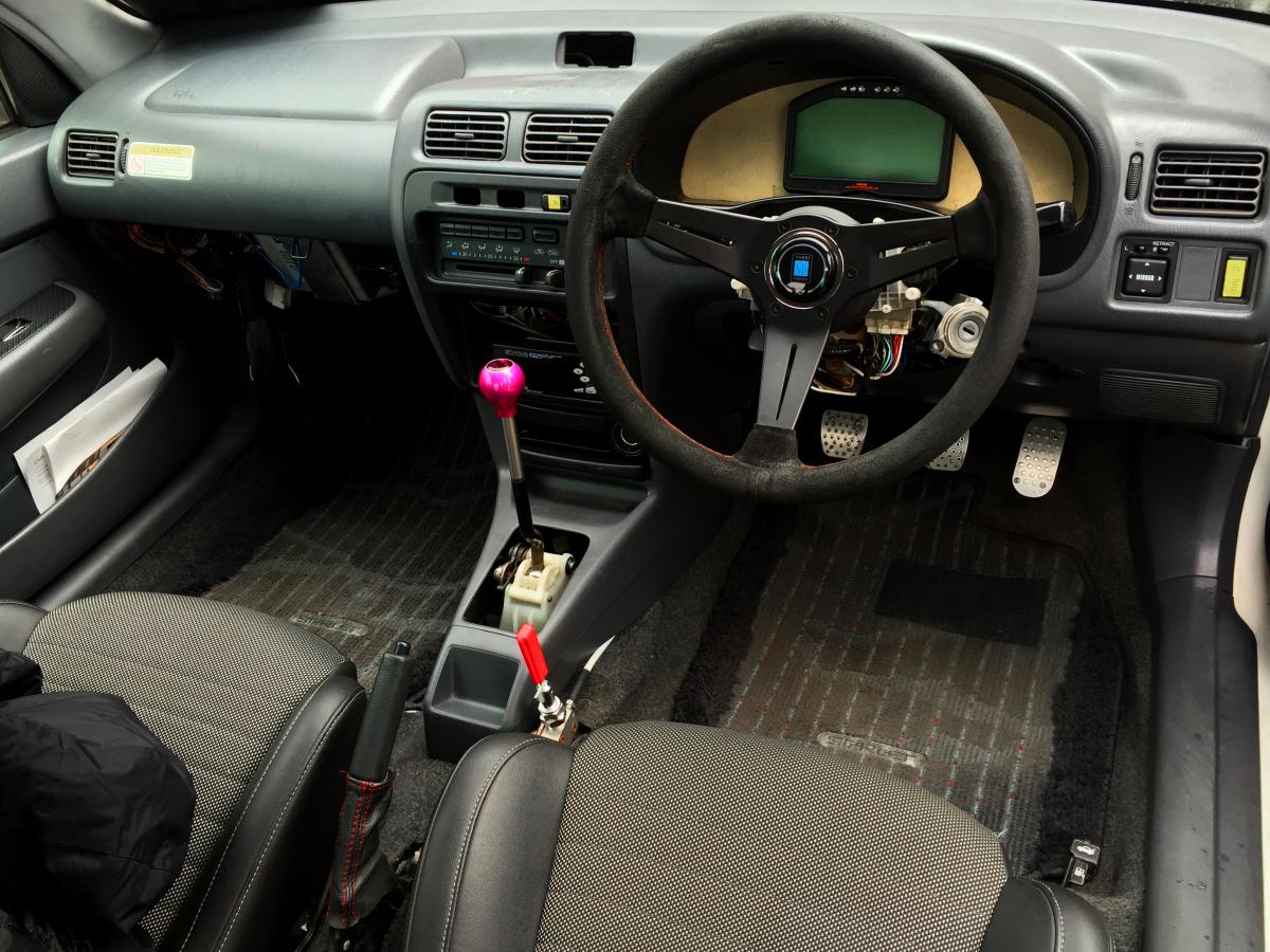

Socks Posted May 1, 2016 Author Posted May 1, 2016 Well managed to get an hour on the car today. The interior space is looking much better now! Clean. Nearly all re-assembled. etcReturning the car to the pristine condition it was in last year! Be it Slowly. Went to grab some V-Power after the trip back from Japfest also. Managed to get a lil video of the car just before the rain started to settle in!It really is quite a thrill/alarming to drive, Huge Smiles. No Dump Valve and there is no lag going thru the gears at all. This is on cold 205/50/15 T1R's in the damp too haha. >https://www.youtube.com/watch?v=OmNfaaUESss Such a huge power band compared to a 4e. From the seat time ive had, in terms of straight line speed its comparable to a 4e/garrett mix at 370ish bhp but without the lag. Quote

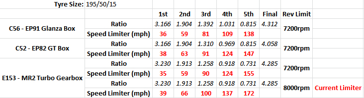

Socks Posted May 2, 2016 Author Posted May 2, 2016 Sounds ace, hows the gearing compare between C and E series? Any longer or about the same? Good tbh Morg. The E153 is much nicer in terms of feel/synchro/throw. etc Compared to a C52. On the chart I left the ratios and rpm limit the same as a 4e. Then added the 8k limiter its at now at the end. Ratios are a touch longer, which is what you want really for high power. 5th gear is much nicer when cruising! Much more choice in the E series box in terms of gears so! See how we do when its turned up! Quote
Faiyaz.123 Posted May 21, 2016 Posted May 21, 2016 Good tbh Morg. ratios_onstarlet.jpg The E153 is much nicer in terms of feel/synchro/throw. etc Compared to a C52.On the chart I left the ratios and rpm limit the same as a 4e. Then added the 8k limiter its at now at the end. Ratios are a touch longer, which is what you want really for high power. 5th gear is much nicer when cruising!Much more choice in the E series box in terms of gears so! See how we do when its turned up!Epic build as usual.I don't know much about gearbox,but a quick question .Can the e153 mr2 gearbox be mated with a 4efte with a few modz to make it work ? Quote
MARC MOSS Posted May 21, 2016 Posted May 21, 2016 Well managed to get an hour on the car today. The interior space is looking much better now! Photo 01-05-2016, 12 46 08.jpg Clean. Nearly all re-assembled. etcReturning the car to the pristine condition it was in last year! Be it Slowly. Went to grab some V-Power after the trip back from Japfest also. Managed to get a lil video of the car just before the rain started to settle in!It really is quite a thrill/alarming to drive, Huge Smiles. No Dump Valve and there is no lag going thru the gears at all. This is on cold 205/50/15 T1R's in the damp too haha. Such a huge power band compared to a 4e. From the seat time ive had, in terms of straight line speed its comparable to a 4e/garrett mix at 370ish bhp but without the lag.Fucking hell Matt lol, that was very quick to 70mph lol Quote
