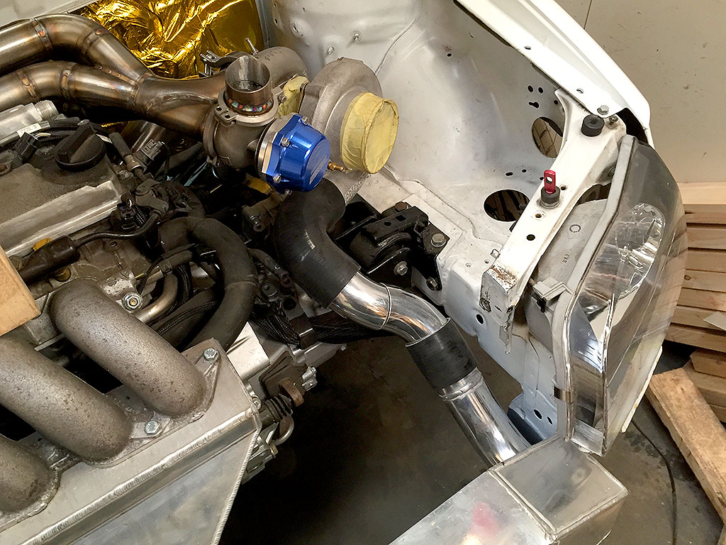

5e colin Posted March 11, 2015 Posted March 11, 2015 wont it catch fire ???? ??? ( bonnet ) looks like its lying ontop of the turbo ???? it wud have me paranoid Quote
Socks Posted March 11, 2015 Author Posted March 11, 2015 wont it catch fire ???? ??? ( bonnet ) looks like its lying ontop of the turbo ???? it wud have me paranoid The underside of the bonnet will get the same layer of gold heatproofing the firewall has Quote

FMuscle Posted March 11, 2015 Posted March 11, 2015 The coupling on the turbo changed color... has more progress been made than you're telling? Quote

Socks Posted March 11, 2015 Author Posted March 11, 2015 The coupling on the turbo changed color... has more progress been made than you're telling? Wow, someone is eagle eyes! Yes, the build is ahead of this thread, but im not saying by how much They were trying different options with iping for hotside... Hotside boost pipe nearly there though! Quote

jiggaman_16 Posted March 12, 2015 Posted March 12, 2015 Nice progress bro..... 1) notice your turbo sits forward more than the Honda K-series normal turbo position (further back to the firewall)....Any particular reason for this? (Not sayin it should be further back, just askin.......)2) Is the turbo / manifold supported underneath (weight / overhang consideration)?3) U plannin on runnin anything to replace the slam panel / upper radiator support? Quote

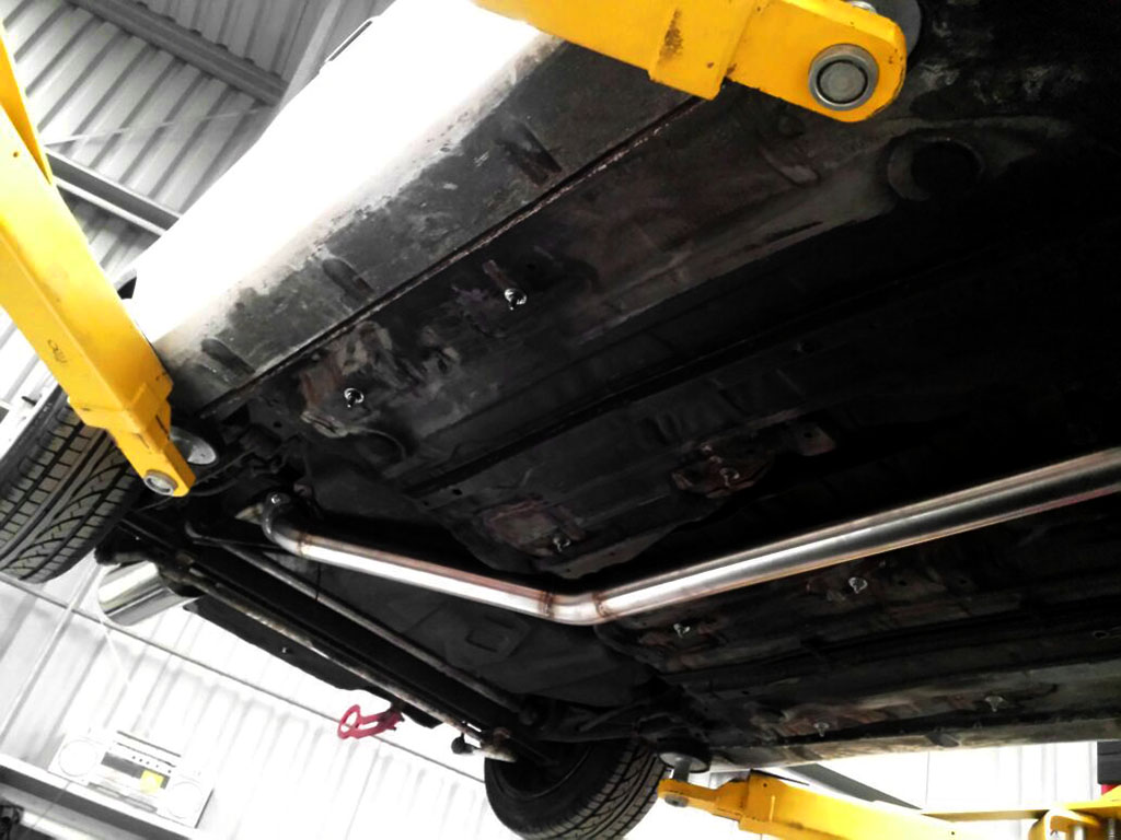

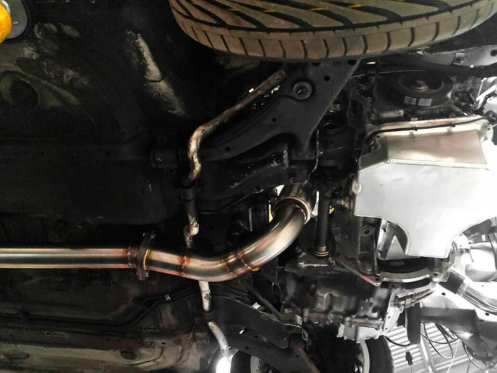

Socks Posted March 16, 2015 Author Posted March 16, 2015 Cheers Chaps! Nice progress bro..... 1) notice ur turbo sits forward more than the Honda K-series normal turbo position (further back to the firewall)....Any particular reason for this? (Not sayin it should be further back, just askin.......)2) Is the turbo / manifold supported underneath (weight / overhang consideration)?3) U plannin on runnin anything to replace the slam panel / upper radiator support? 1, Purely Space. The glanza engine bay is SO much smaller then a civics. Yet the 2zz and k20 are similar in psyical size. 2, Not as of yet. This is something that im still in talks with Ricky about.3, Nope. The radiator will be mounted kind of flush with the light support bars. The strength was in the lower bar and thats been replaced by a stronger bar So, exhaust is pretty much there. 3" from turbo to the back, of course! Lovely Jubily Quote

akaye4000 Posted March 17, 2015 Posted March 17, 2015 no silencers thats going to be epically loud on full chat:D Quote
MARC MOSS Posted March 18, 2015 Posted March 18, 2015 Screamer & Downpipe are done... Exhaust is next! IMG_0771.JPG Of course, it exits thru the bonnet IMG_0772.JPG Matt, you need to get one of those flap things that you see on trucks for that screamer pipe lol Not Long Now! Quote

Mad Mike EP82 Posted March 18, 2015 Posted March 18, 2015 Shouldn't have a problem mine is same exhaust 3" straight through 97db static 4800rpm 😎 Quote
