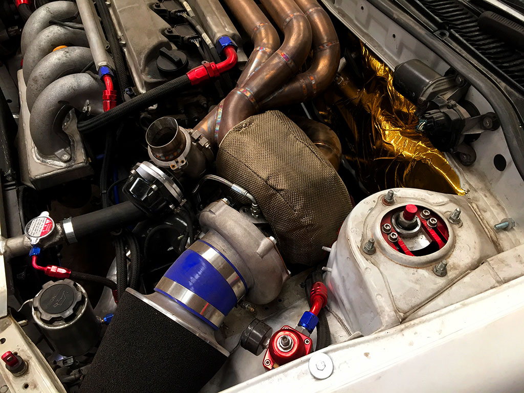

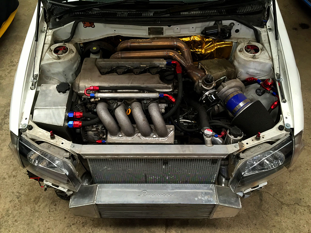

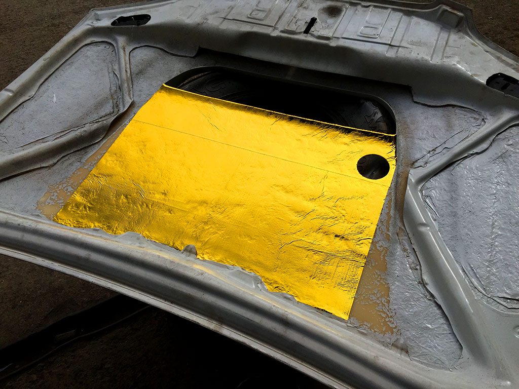

Socks Posted September 3, 2015 Author Posted September 3, 2015 Cheers Folks... Well. Me Vs Heat Today! Fitted a big turbo blanket first. This worked amazingly well on my old setup!Lowered under bonnet temps massively! However, due to its size, the manifold is the main culprit this time tbh! Took to the inside of the bonnet with a DA Sander also, and a 80grit pad. Got it nice and smooth, rub clean with alcohol.Then applied some more heat protection, to try and protect whats left of the paint! DIY'd some 1 inch bonnet lifters and fitted my JD Tuning Bonnet Strut Kit.The gas struts are WAY too strong for a fibreglass bonnet, ill worn you now. So going to need to talk to Jez about some softer ones! She's back on the dyno at the moment... Wish me some luck please. Id like to see it make JAE! Quote
5e colin Posted September 3, 2015 Posted September 3, 2015 BEST OF LUCK CAR and u to boss ha ha looks amazing cant you heat wrap the manifold to contain heat a bit ?? no need to show of that ss mani ha ha Quote
jimmymac101 Posted September 3, 2015 Posted September 3, 2015 cracking update mate, fingers crossed for the dyno!!! i can image taking that mani off for heat wrapping would be a nightmare lol James Quote

Jamie_VF22 Posted September 3, 2015 Posted September 3, 2015 Get the manifold ceramic coated is an option Quote
RobSR Posted September 3, 2015 Posted September 3, 2015 Cheers Folks... Well. Me Vs Heat Today! Fitted a big turbo blanket first. This worked amazingly well on my old setup! Lowered under bonnet temps massively! However, due to its size, the manifold is the main culprit this time tbh! IMG_3648.JPG Like mentioned ceramic coating could be an option. Looking at that pic its probably a good idea you've put a blanket on the turbine side! You've got a fuel line rather close to it! You not worried about it there at all? Residual heat or a fitting to come loose / fail and its kaboom. Quote
ro55ifumi Posted September 4, 2015 Posted September 4, 2015 Rob Think that line is an oil line to the catch can on the left hand side, how did it go Matt?? John Quote
Socks Posted September 4, 2015 Author Posted September 4, 2015 BEST OF LUCK CAR and u to boss ha ha looks amazing cant you heat wrap the manifold to contain heat a bit ?? no need to show of that ss mani ha ha If you've used heat wrap before.... You know exactly why im not using it Goes brittle and falls off after 6 months lol. Get the manifold ceramic coated is an option It is. Its expensive and does come off over time also... Something I am considering tho, we will see how we get on now! Like mentioned ceramic coating could be an option. Looking at that pic its probably a good idea you've put a blanket on the turbine side! You've got a fuel line rather close to it! You not worried about it there at all? Residual heat or a fitting to come loose / fail and its kaboom. Its not as close as you think. Its like 4inches. The blanket is quite big and makes it look alot closer. But fire is something that always worries me, I cant think of a worse thing to watch that it going up in flames in front of my eyes tbh! The car has 2 extinguishers inside at the moment. Quote

RandomDan Posted November 29, 2015 Posted November 29, 2015 Have you not thought about putting a sheild over the manifold pipes to stop some of the heat?Or possibly zircotec heat coating? Quote
